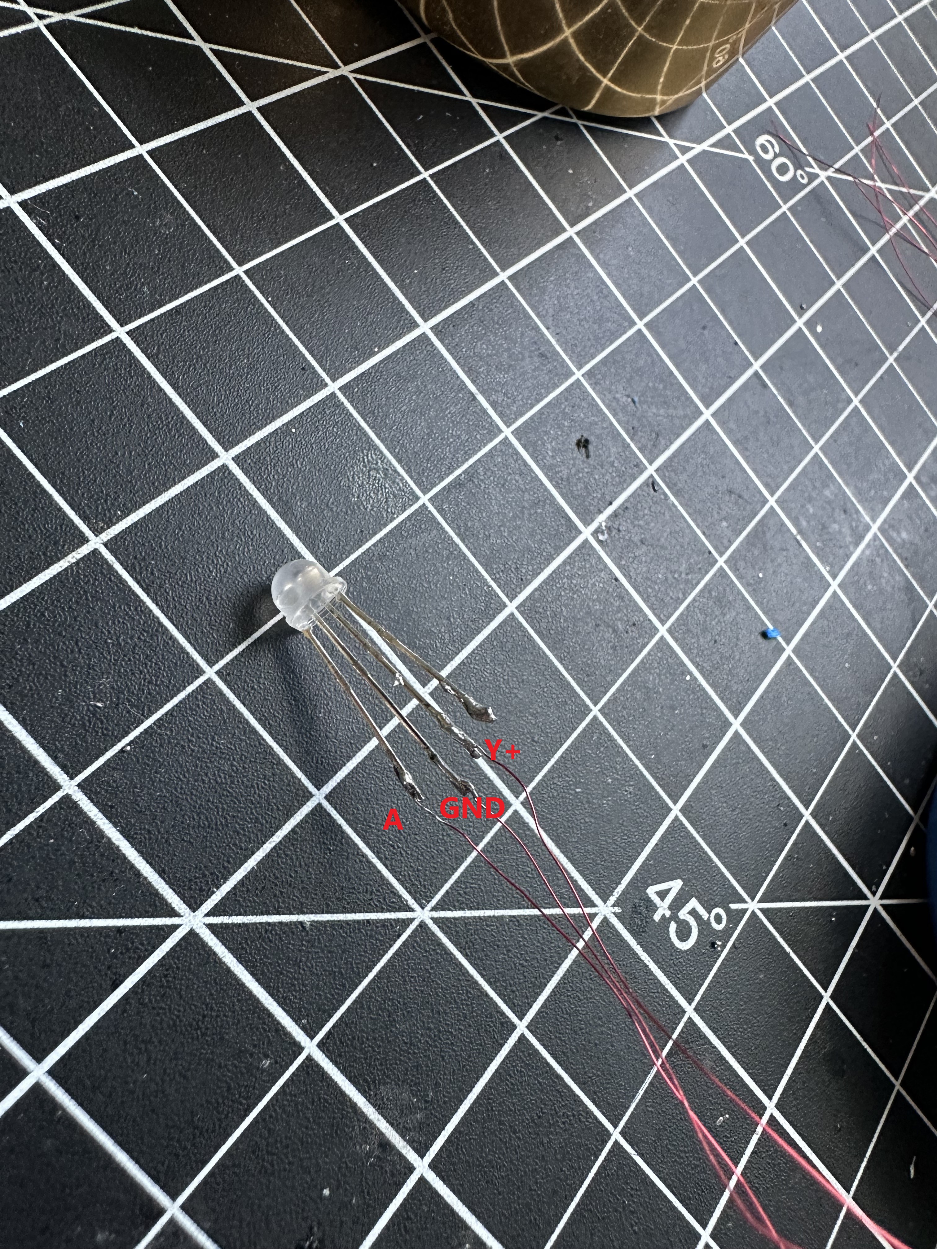

atkfromabove . Joined Oct 5, 2019 Messages 135 Likes 124 Portables 2 May 1, 2023 #3 Here is a picture of the wires labeled to the PMS side. Excuse the sloppy wiring I'll clean up once I get it working.
Gman RTFDS Staff member . . . . . Joined Feb 25, 2016 Messages 1,465 Likes 3,020 May 1, 2023 #4 Did you change the settings in RVLoader to addressable LED?
atkfromabove . Joined Oct 5, 2019 Messages 135 Likes 124 Portables 2 May 1, 2023 #5 I did not. I'll have to check out that setting once I get my screen working again.
