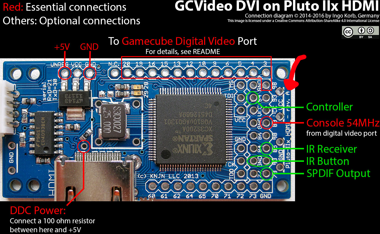

Wired all data, pwr, and gnd with 30awg braided.
Ensured the 54mhz pin was routed separately from other signals.
Tested continuity with a dmm.
Verified 2 led’s light up with 1 steady light and 1 blinking.
Tried both plugging hdmi in to a hp monitor and tcl tv.
Attempted plugging in the hdmi after powering gc as I had read that worked for some people.

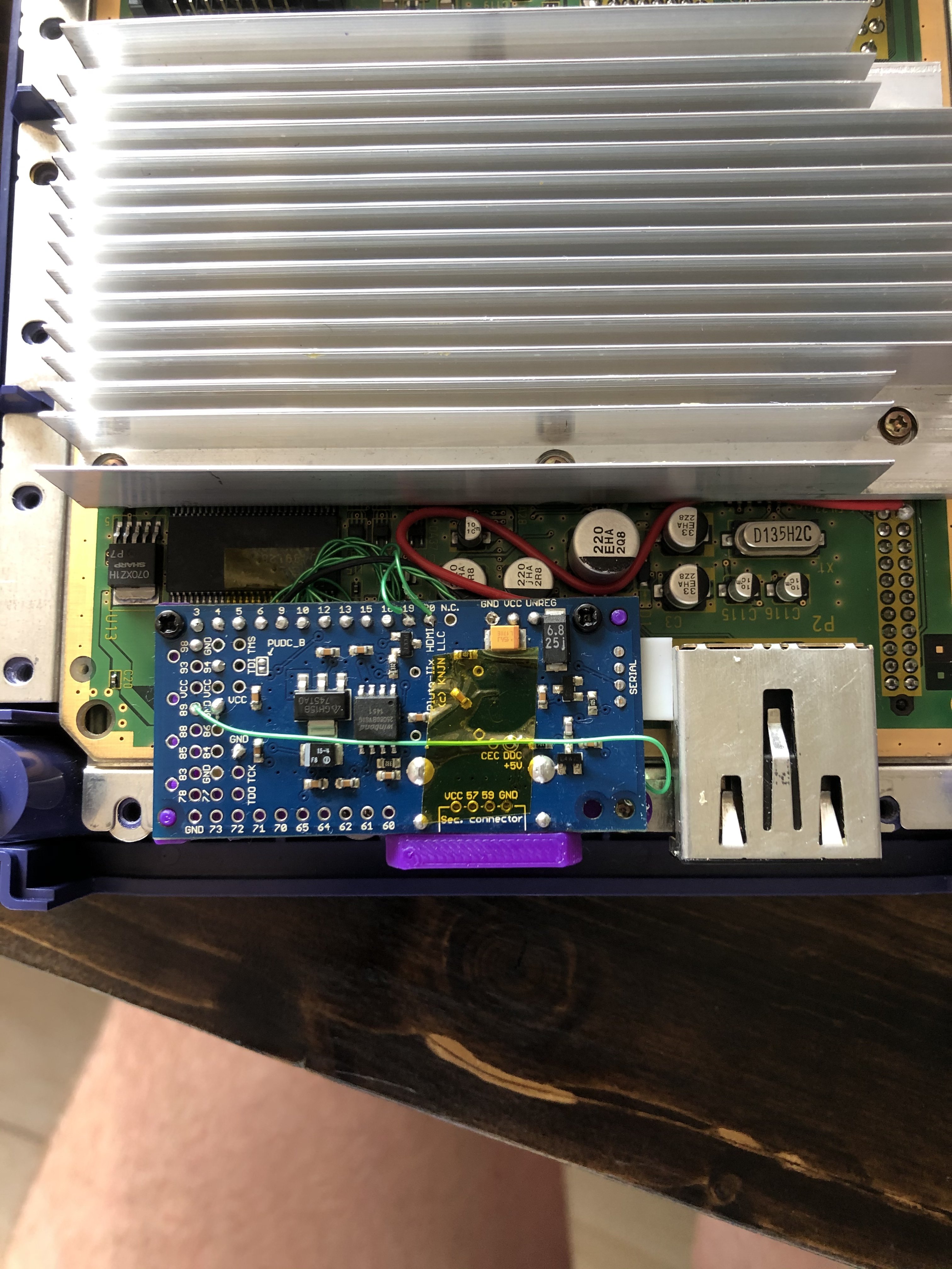

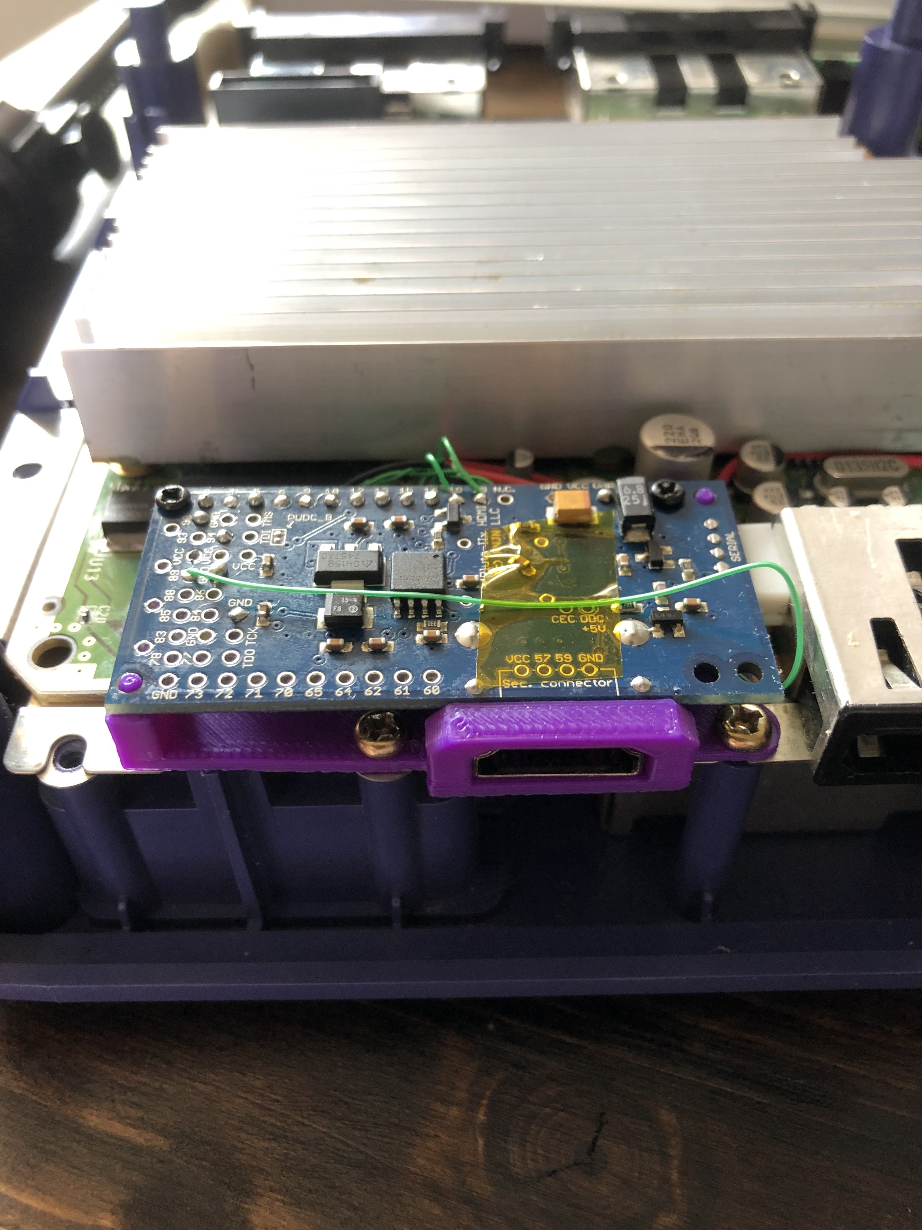

2nd attempt (the one shown in photos):
Twisted 30awg data lines, and switched to 26awg braided for pwr and gnd.
Tested all continuity with a dmm.
And got the same results for everything from the first attempt.
Anyone got a recommendation for my third attempt? I read that it can be finicky trying to get the dvi signal from these boards, do you think I just need a better monitor?

I had an older revision pluto that would only ever work without the DDC resistor, maybe yours is similar?
