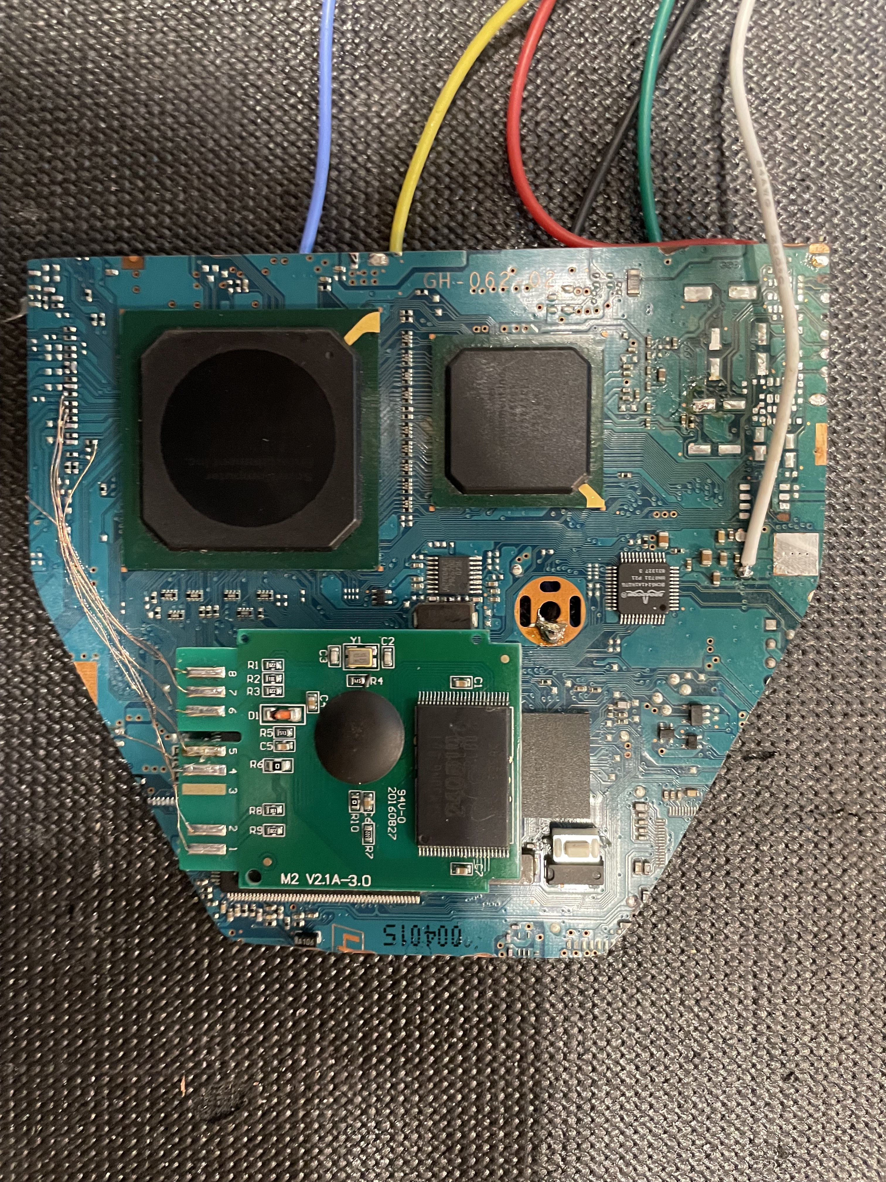

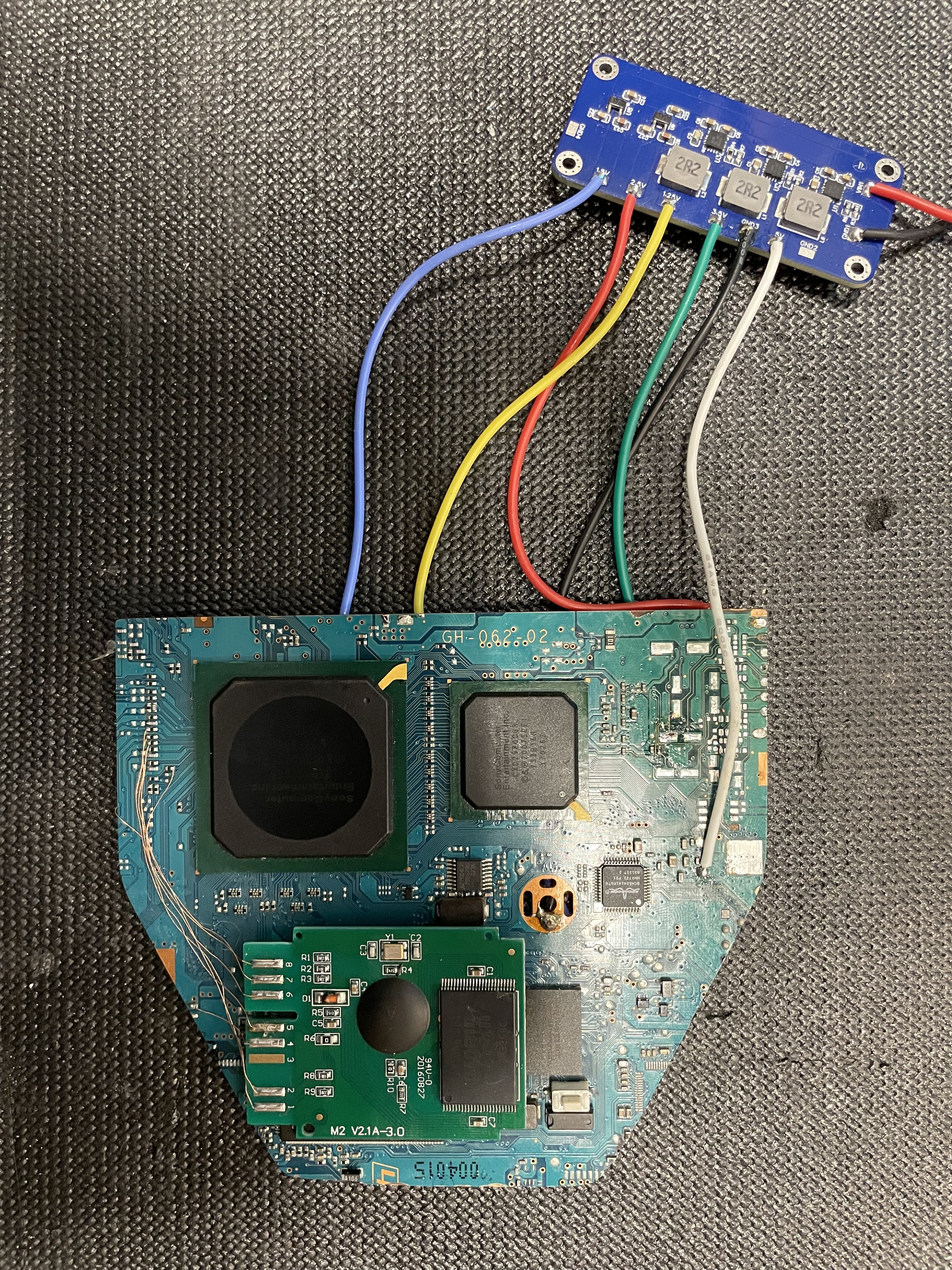

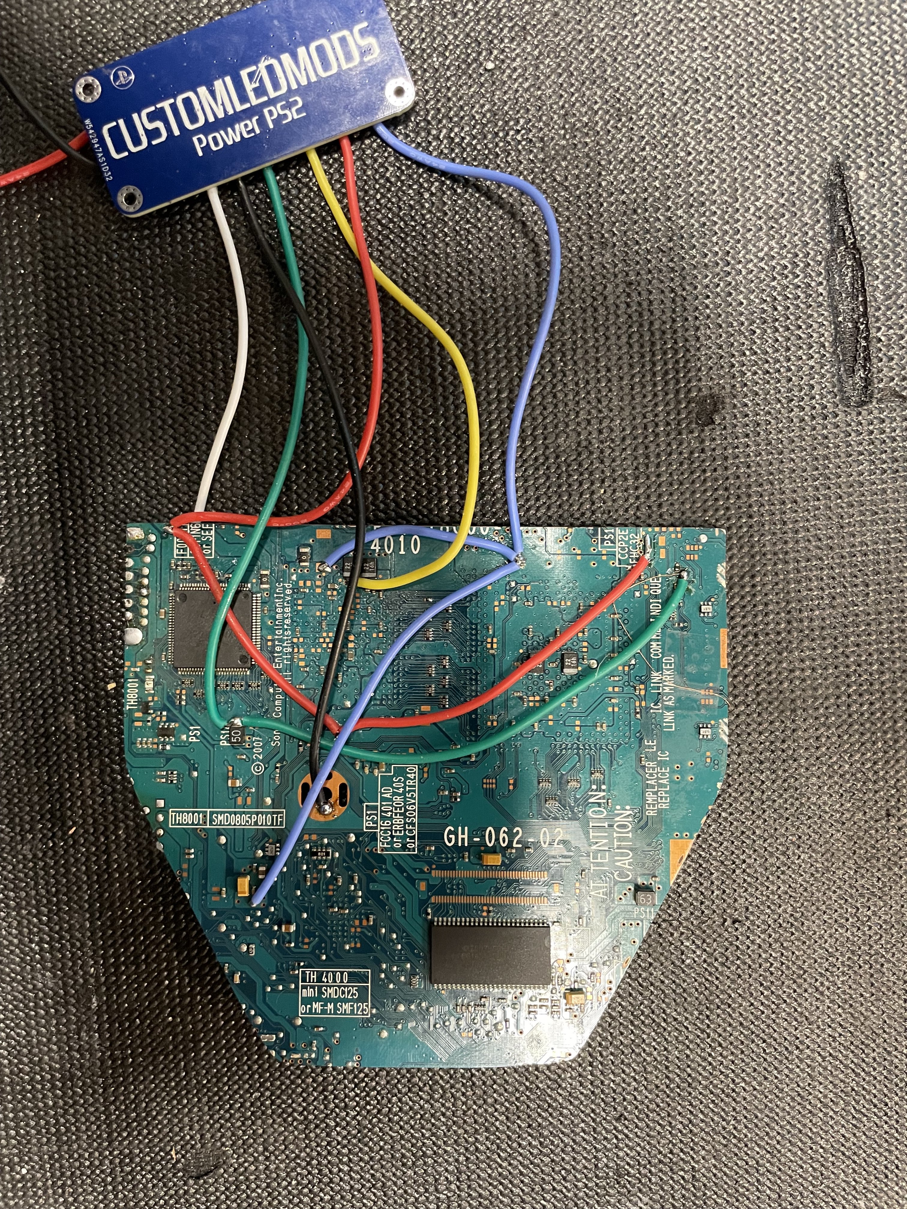

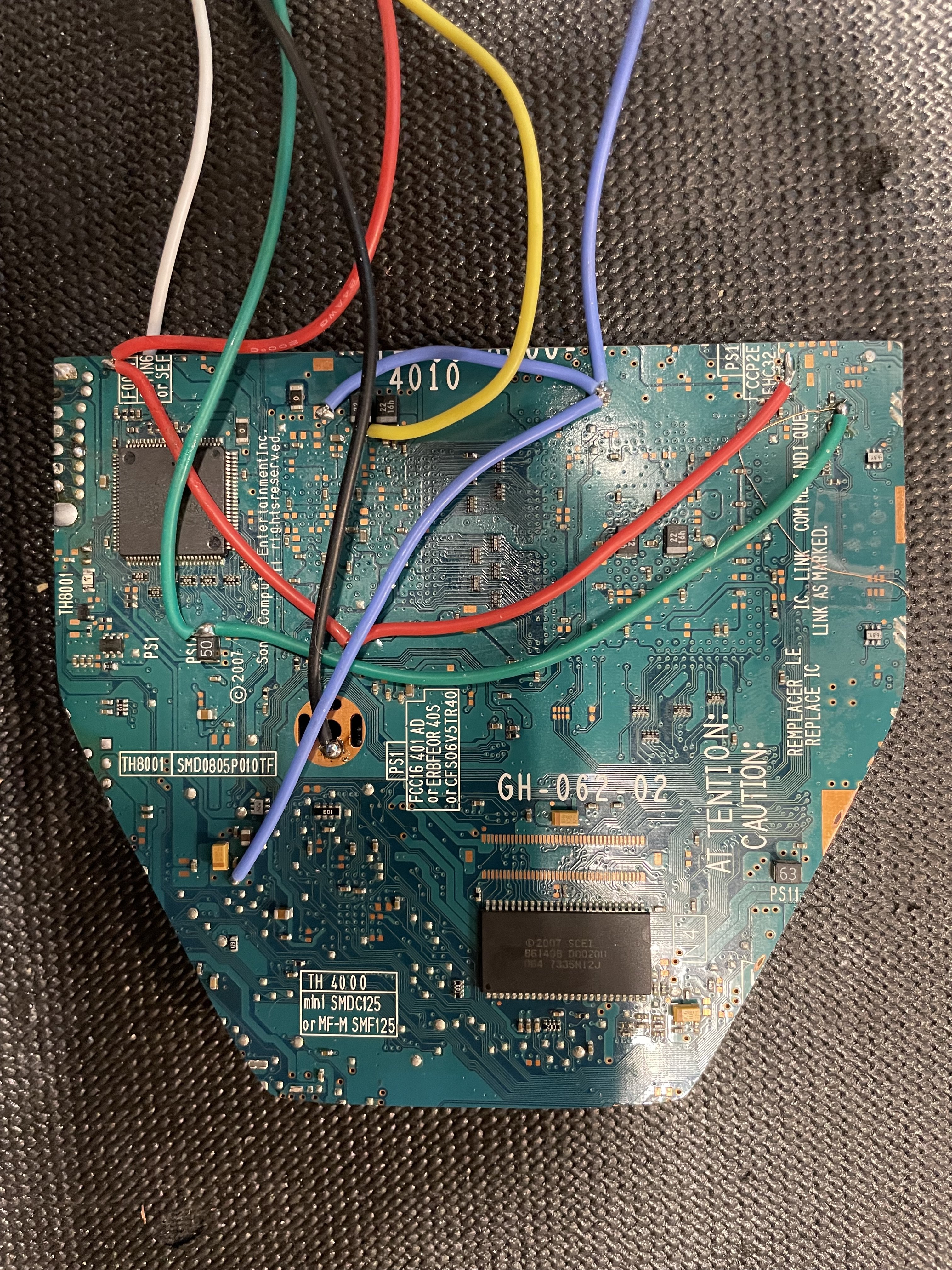

Hi, today I did an advanced cut on a PS2 board.
I just tested it, and nothing appears on the screen…
The main components are heating up.
I tested all the voltages, which are:
Yellow: 1.25V
Purple: 1.75V
Red: 2.5V
Green: 3.5V
At first, I did a standard cut on the board, and it was still working.
Does anyone have any ideas?
Maybe a missing wire?
Thanks for your help.

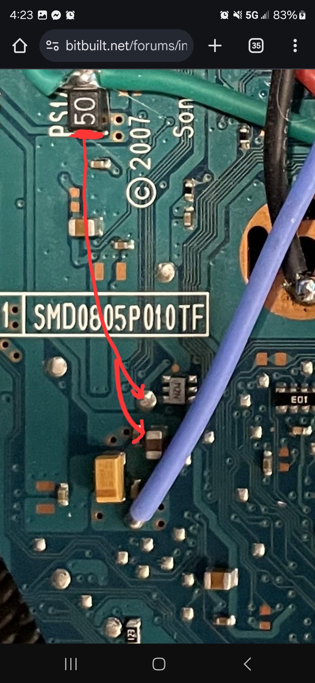

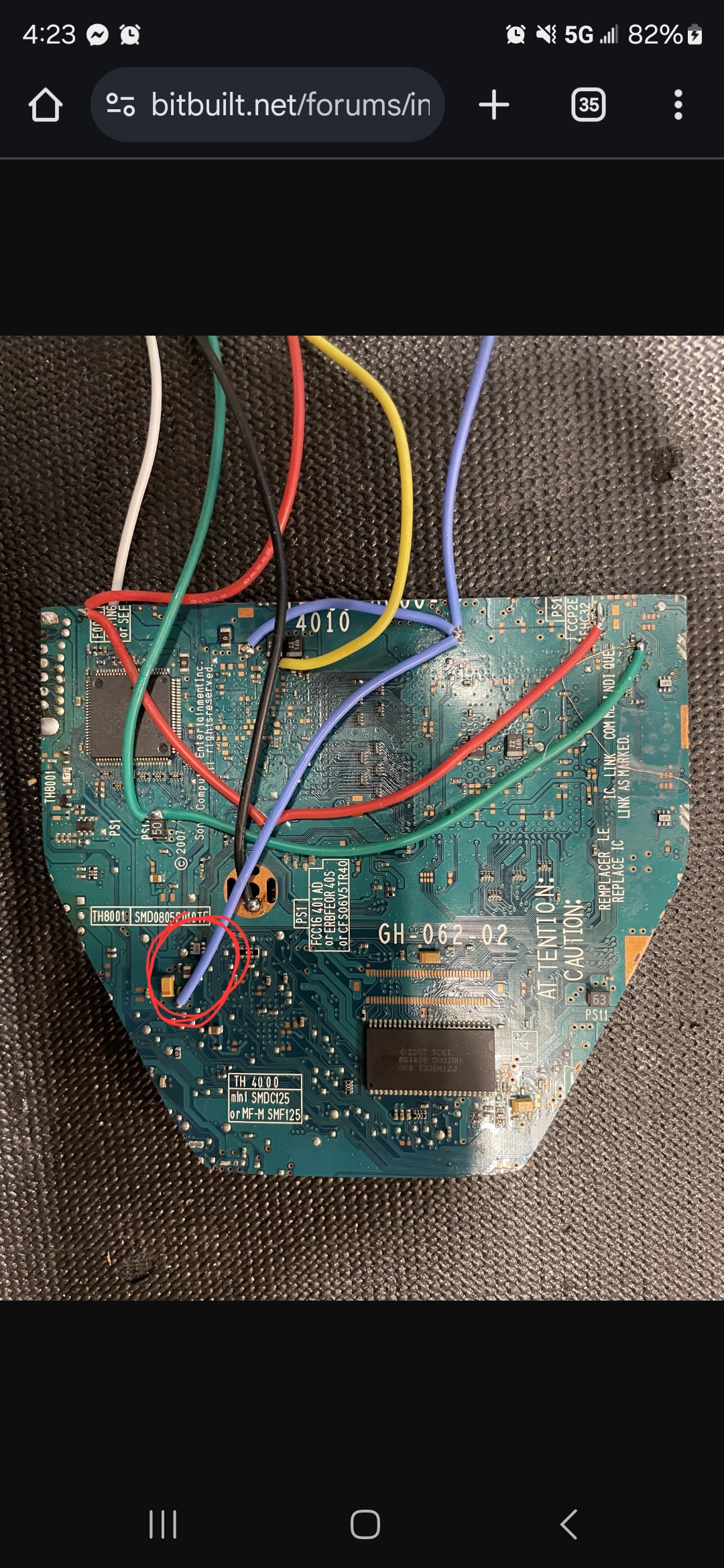

Everything looks good, but it seems your missing a 3.5V connection on the board:
You can connect 3.5V from the other side of the PS14 fuse as shown in the picture I shared to either the little pad, or to the capacitor shown in the second picture.
