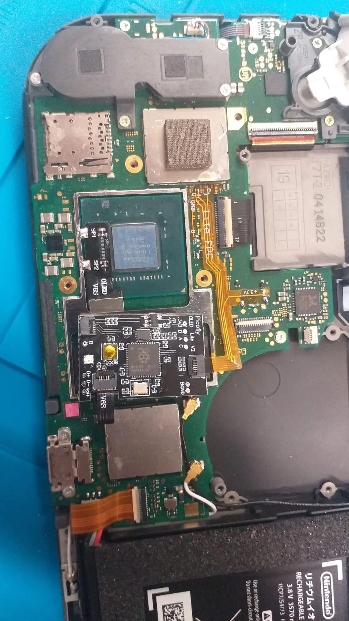

Hello my friend!
it's been a minute, but i have finally purchased a Picofly Modchip. I actually installed it myself an hour ago.
I have some soldering experience but not with something this small, so it was a challenge.
However, it runs again! I haven't done the unbrick method you sent me yet, but i plan on doing that in the near future.
Thanks a lot for your help! I will keep you up to date.
Sincerely
Very nice work! I'm glad you got it booting! One thing of note is that pink sticker by the charge port. That's a liquid damage indicator, and solid pink means it has been activated. Was it like that when you opened it up? If so, there may be corrosion beneath the NAND, and software won't be able to fix it. An EmuNAND (off the MicroSD card) should still work though.
I didn't pay attention to it when I opened it at first but I assume that this is the previous owner's doing since the back cover didn't have any screws on it so they must have opened it themselves for whatever reason. Unless isopropyl alcohol can cause this damage and I somehow did ruin my switch
Either way, I can't thank you enough for leading me to the modchip. This thing runs now and that's what matters most
