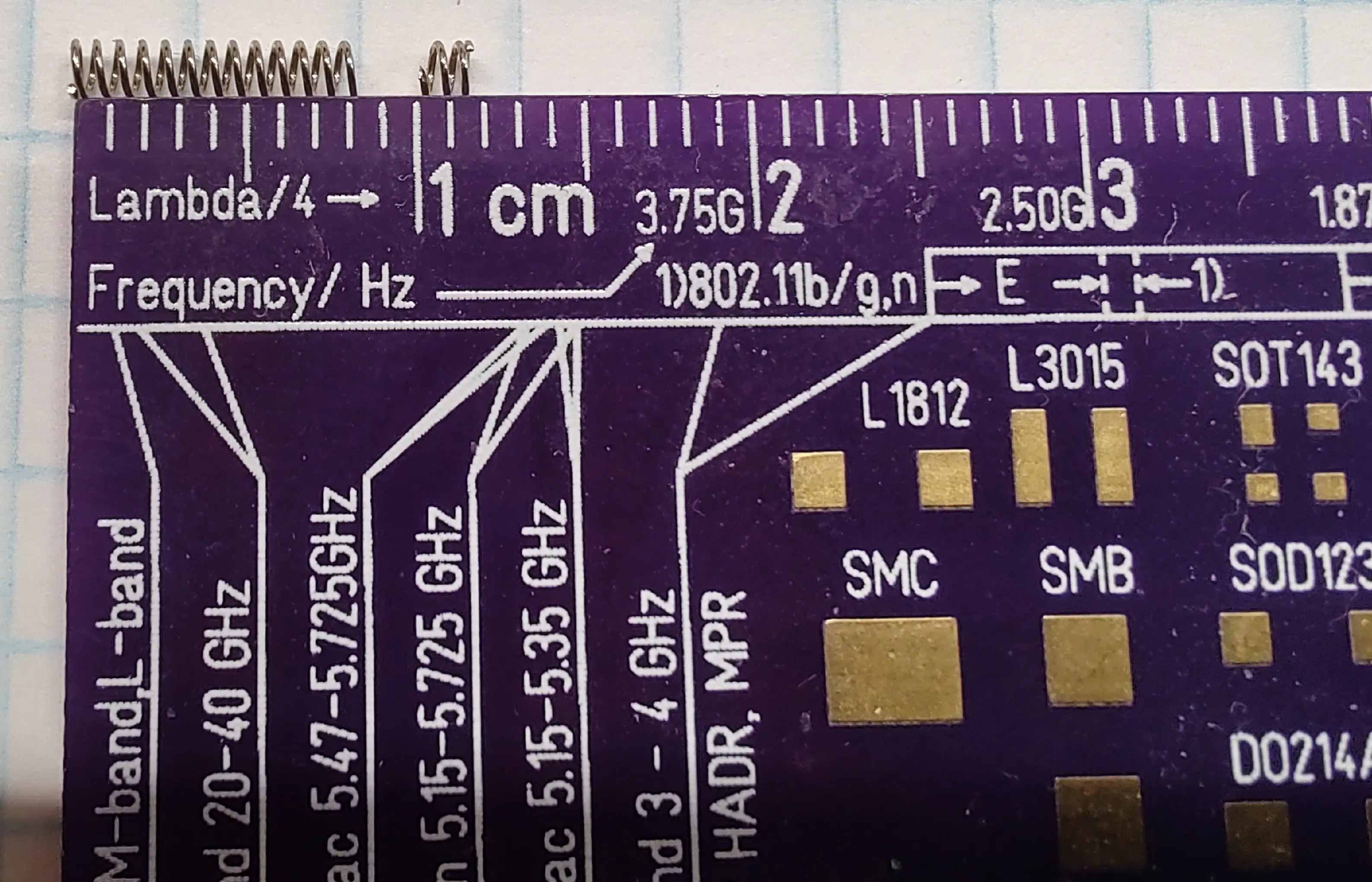

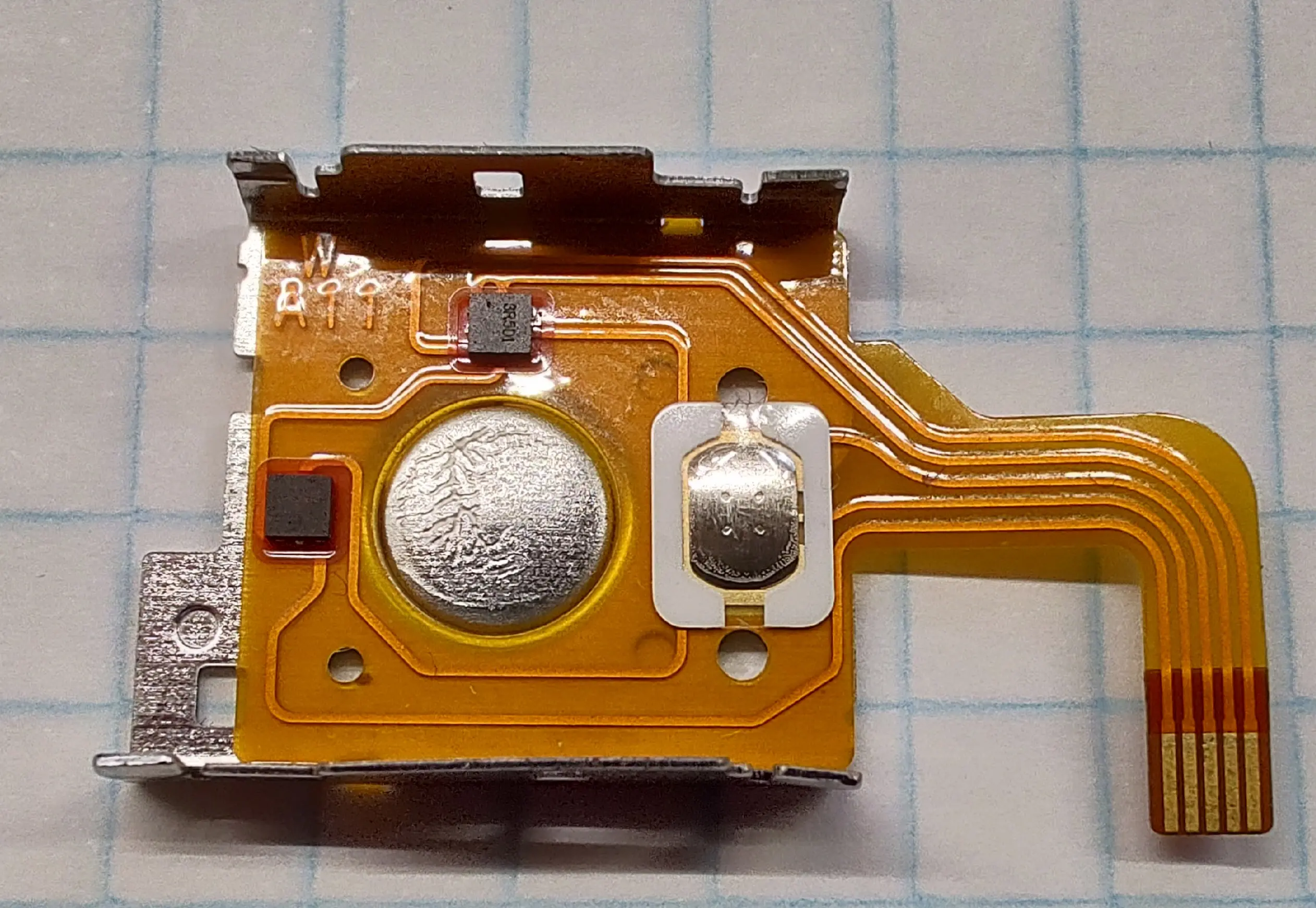

Inside you see the flex PCB with the two sensors on it, above is a white plastic pin and behind it is a small spring. To reduce the force, I shortened the spring by 1 to 2mm (best to start small and try, you can always cut more). I also wiped off some of the lubricant from the center of the metal backplate, it made the analog stick feel a bit “sticky”. I reassembled the analog stick and afterwards it’s quite usable.

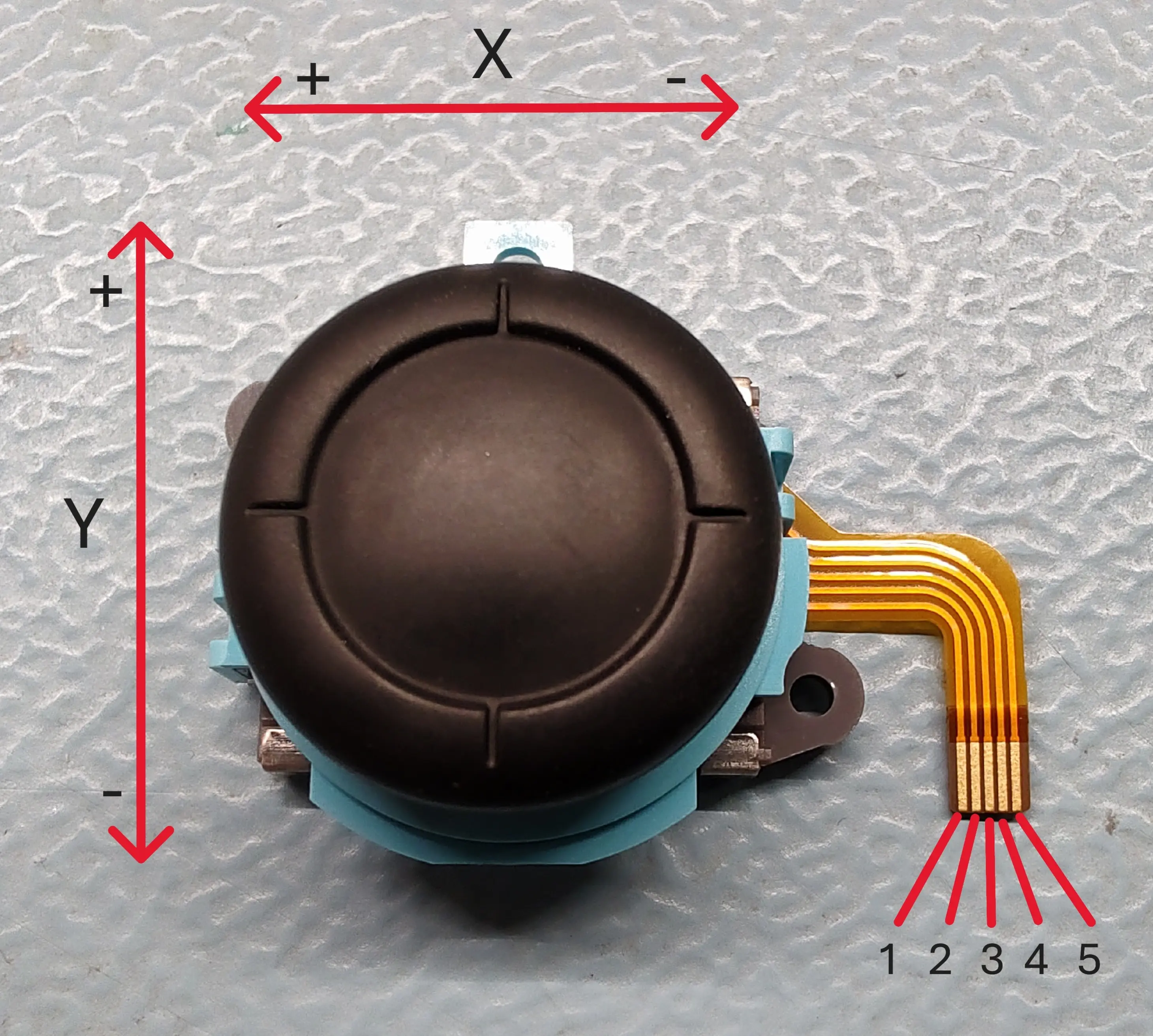

Unfortunately the pinout doesn't match the Nintendo Switch 1 analog stick pinout. Here is the new pinout:
Pin (left to right)Signal
1Y Axis
2Button (to GND)
3GND
4VCC
5X Axis
The pin count, pitch, thickness and width of the flex luckily haven’t changed, which means the Switch 2 sticks will fit the same FFC connectors as the Switch 1 sticks. I personally like to use the connector ‘5034800540’ from Molex (top & bottom contact).

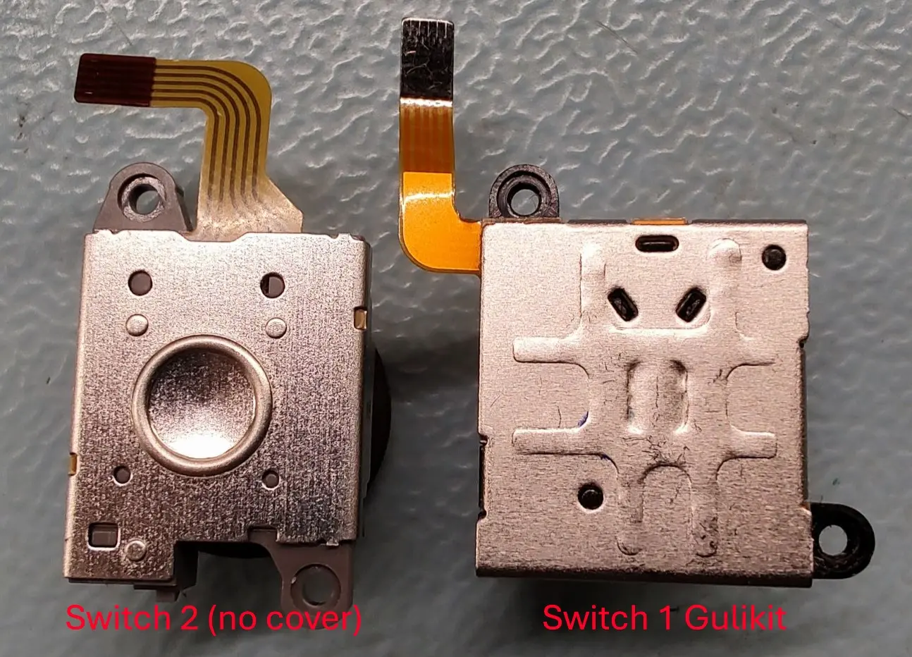

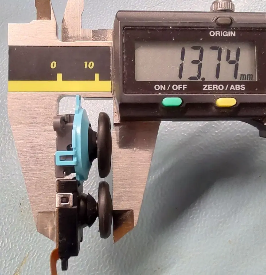

  • When removing the colored cover, the base housing of the Switch 2 sticks is actually slightly smaller than the Switch 1 analog sticks (see picture)
  • The overall height and the distance from stick cap to top surface of the housing is pretty much identical between Switch 1 and Switch 2 sticks (see picture)

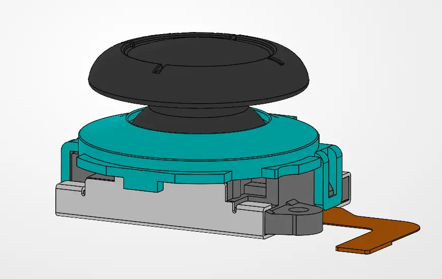

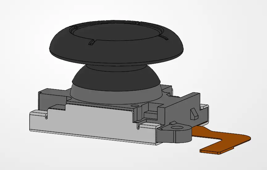

I spent an evening to draw a little 3D model of the new Switch 2 stick (Aliexpress variant). While I’m sure it’s not perfect, it should provide a good basis for integrating them in a design. I designed it so that the cover is a separate body, in case it needs to be removed.

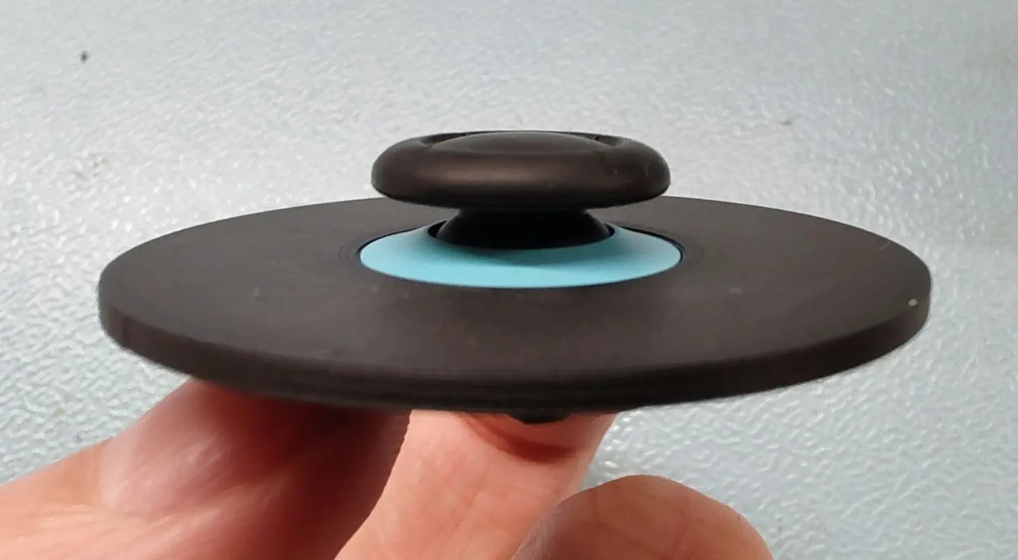

Once installed it looks quiet nice:
Attached you find the 3D model of the stick and the little test-print I did to verify the fitment.
