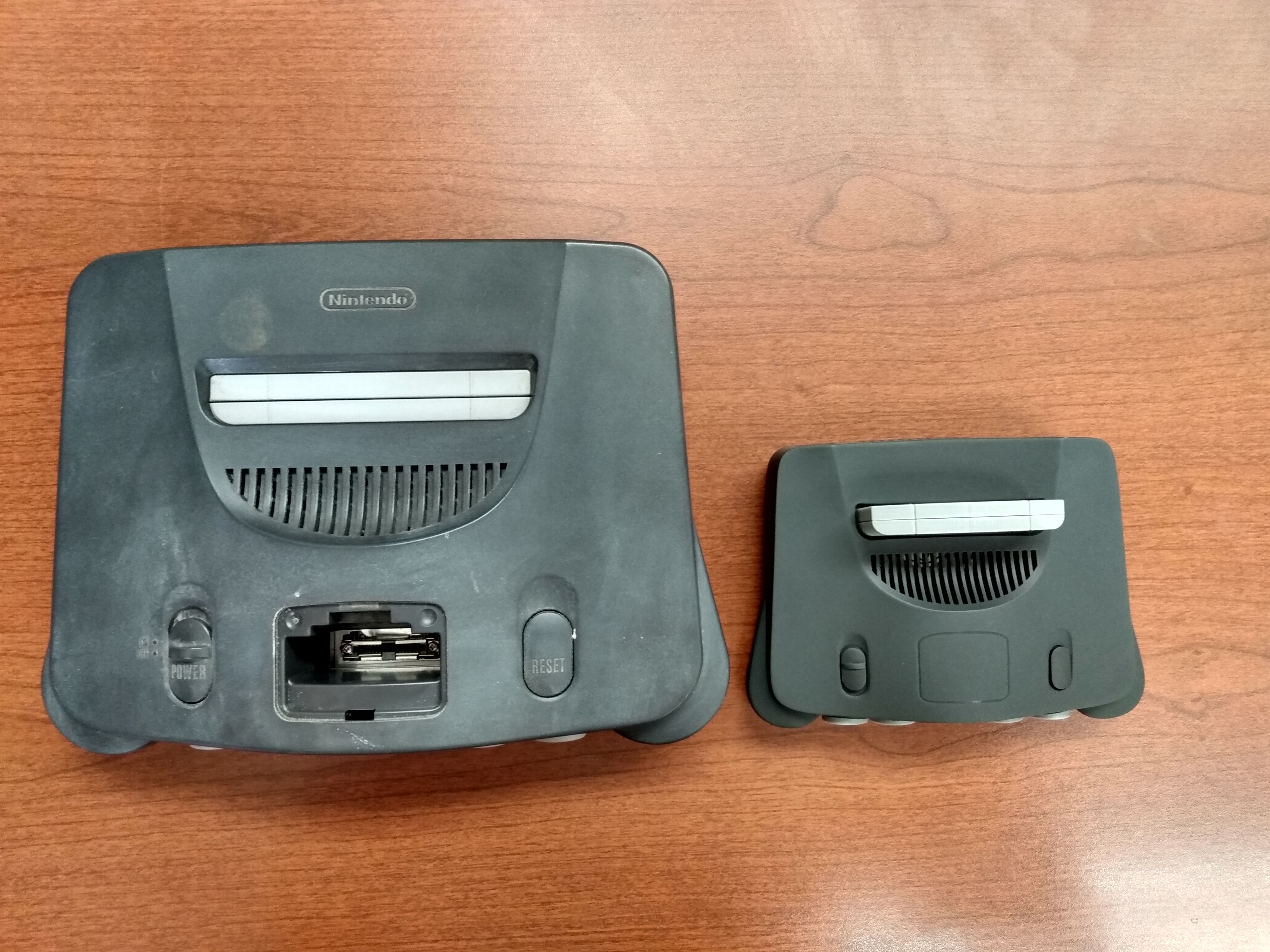

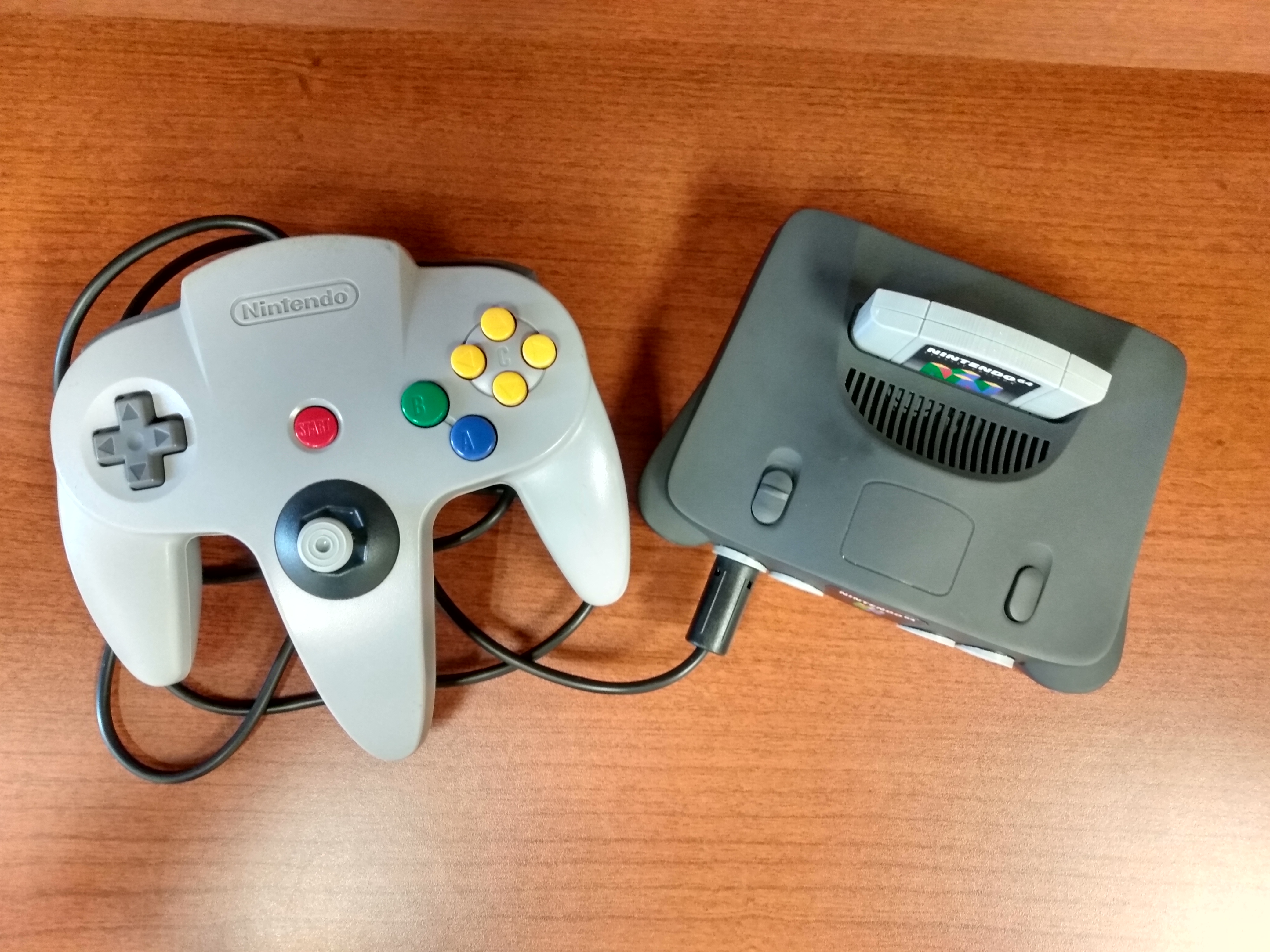

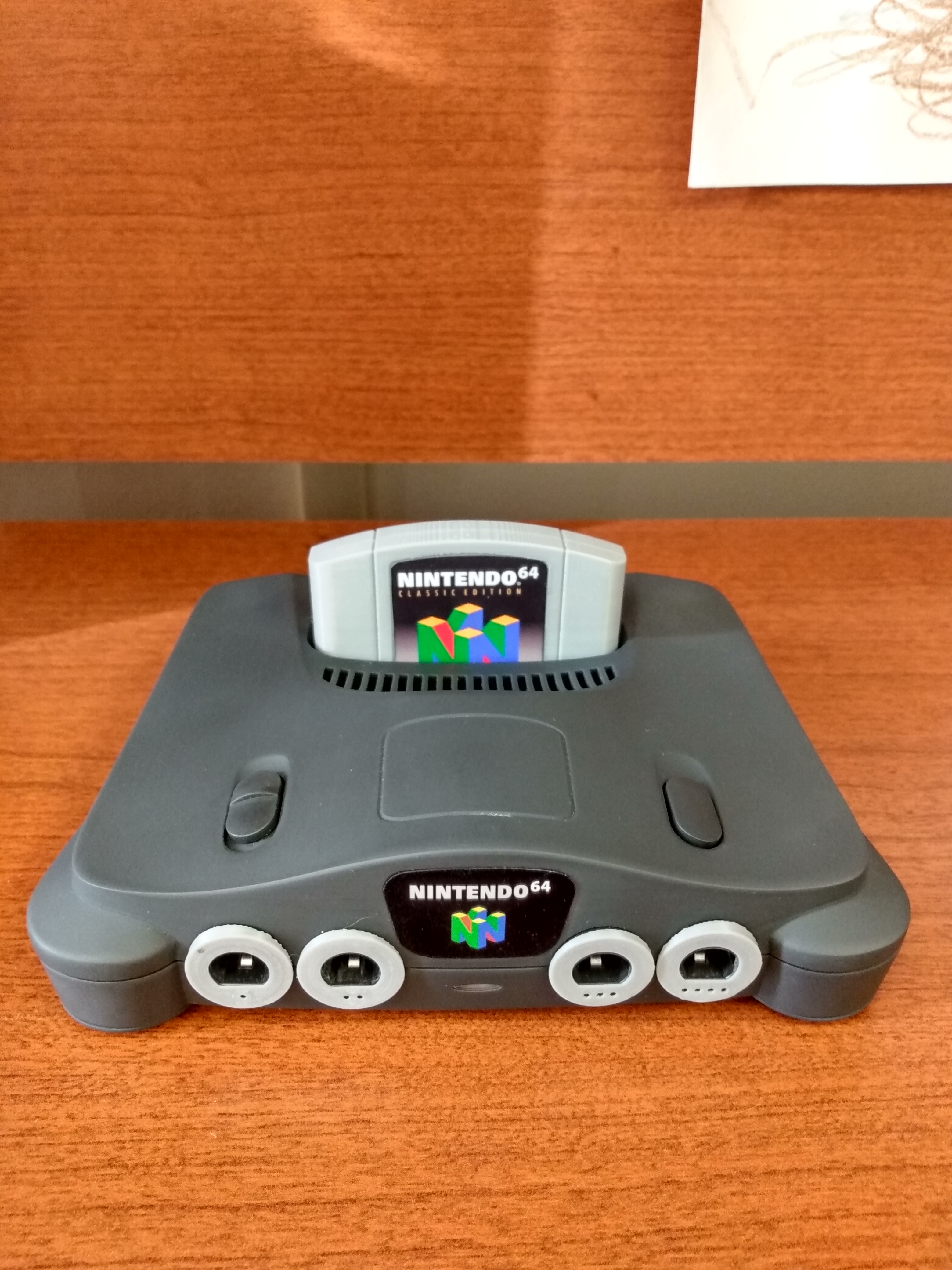

I present to you the Nintendo 64 Classic Edition. It is a trimmed OMGWTF wii with all the virtual console N64 games. Whenever Bob released his Wii Minii I always wanted to build one, but with N64 Virtual Console being hit or miss with early versions of RVloader, I waited until Aurelio released RV Loader 2.0 and worked out all the kinks before I started. First is my render and second the real deal!

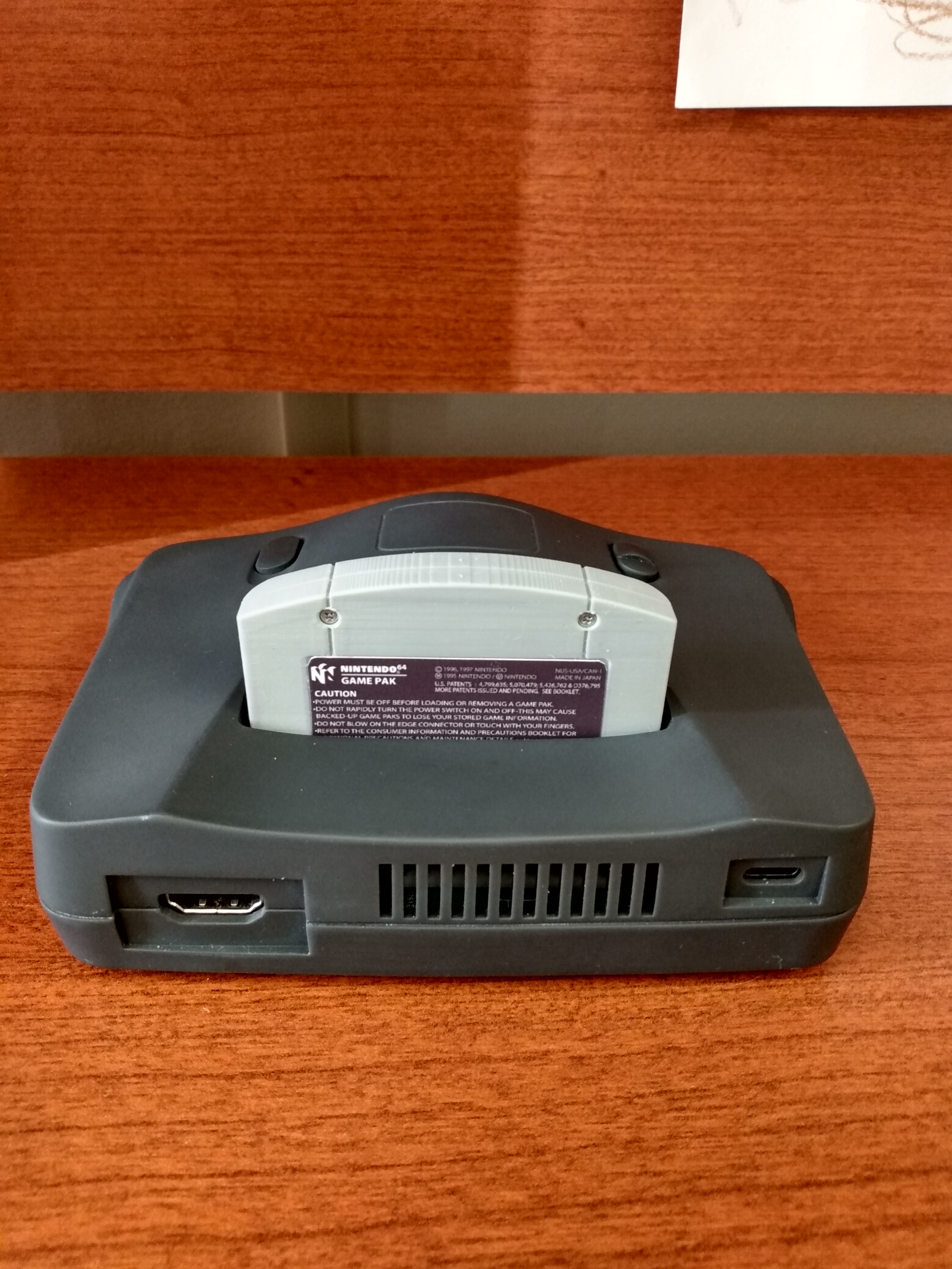

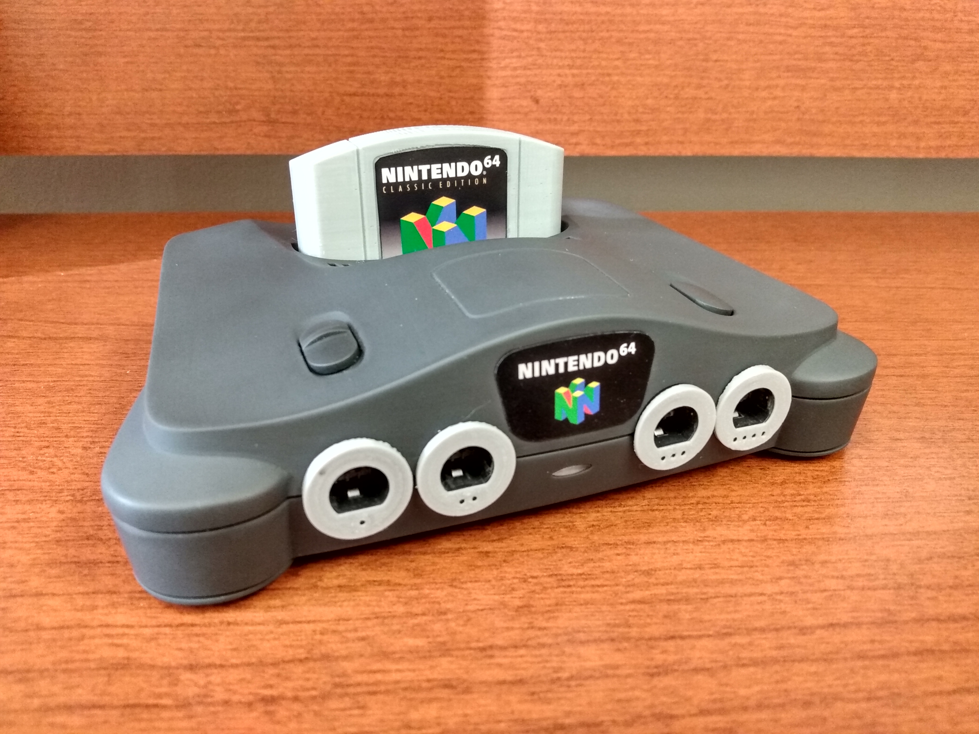

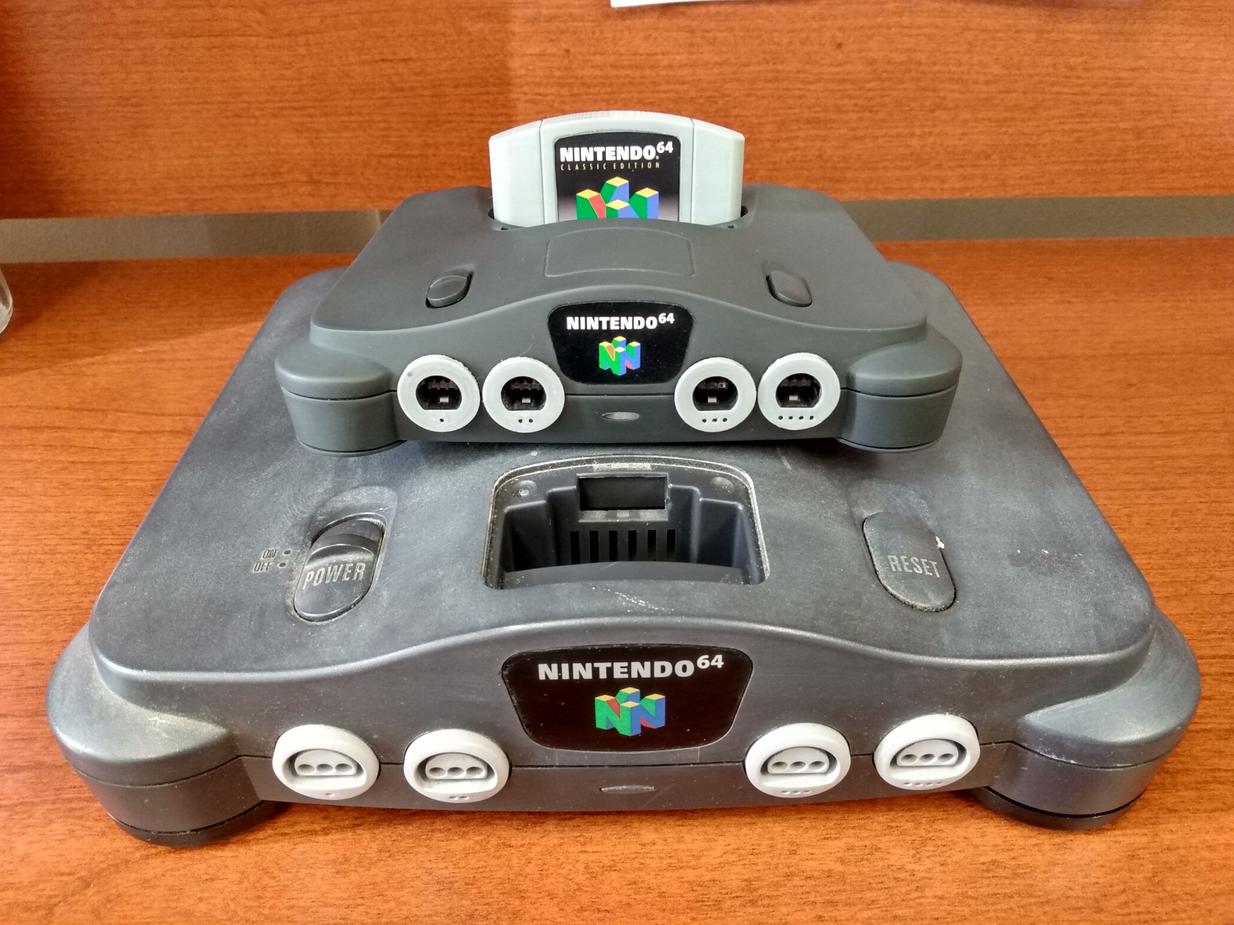

I made some adjustments to the CAD case that I thought would make it even better, and adjusted it to being printed through JLC’s SLA resin 3d print services. I think it is really clean and matches really closely with the original console. I added some details like the text on the buttons, the bumps on the expansion pak door and most importantly, a little “cartridge” to make it feel like the real deal. It looked a little naked to me without the cartridge on there, so I thought it was a nice touch.
All the decals are just 1 hour photo prints from Walmart and cost a whopping 42 cents! It came out really nice and I will definitely do this in the future for things that don’t have to have super durability.
I also added some 3d printed caps to the front so it would have the 1,2,3,4 player dots.

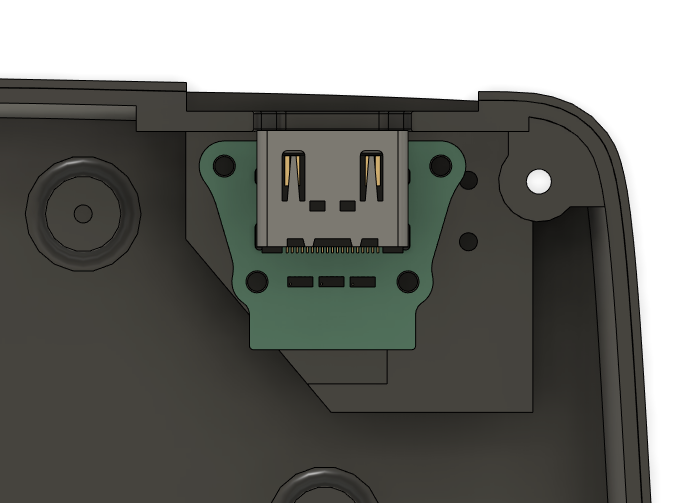

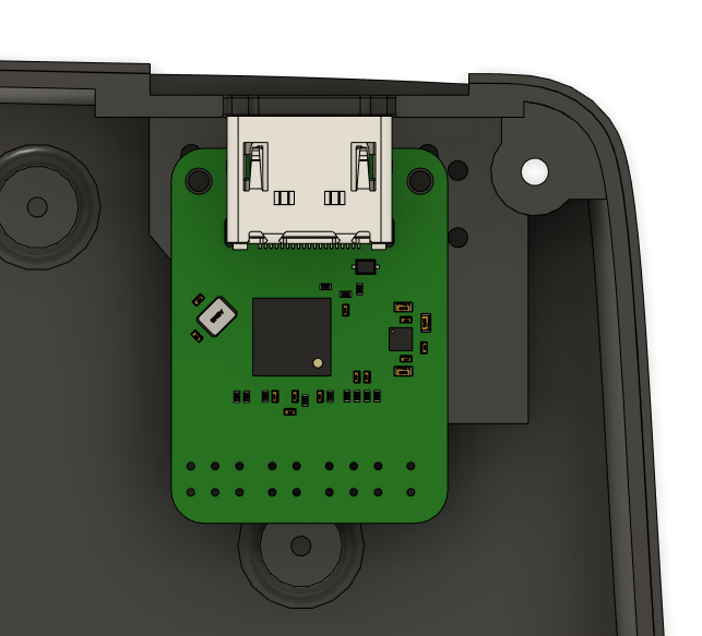

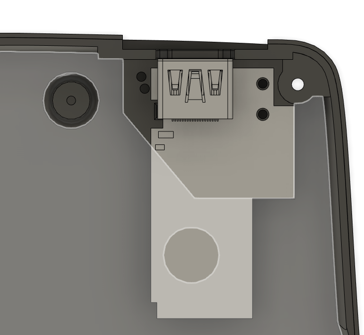

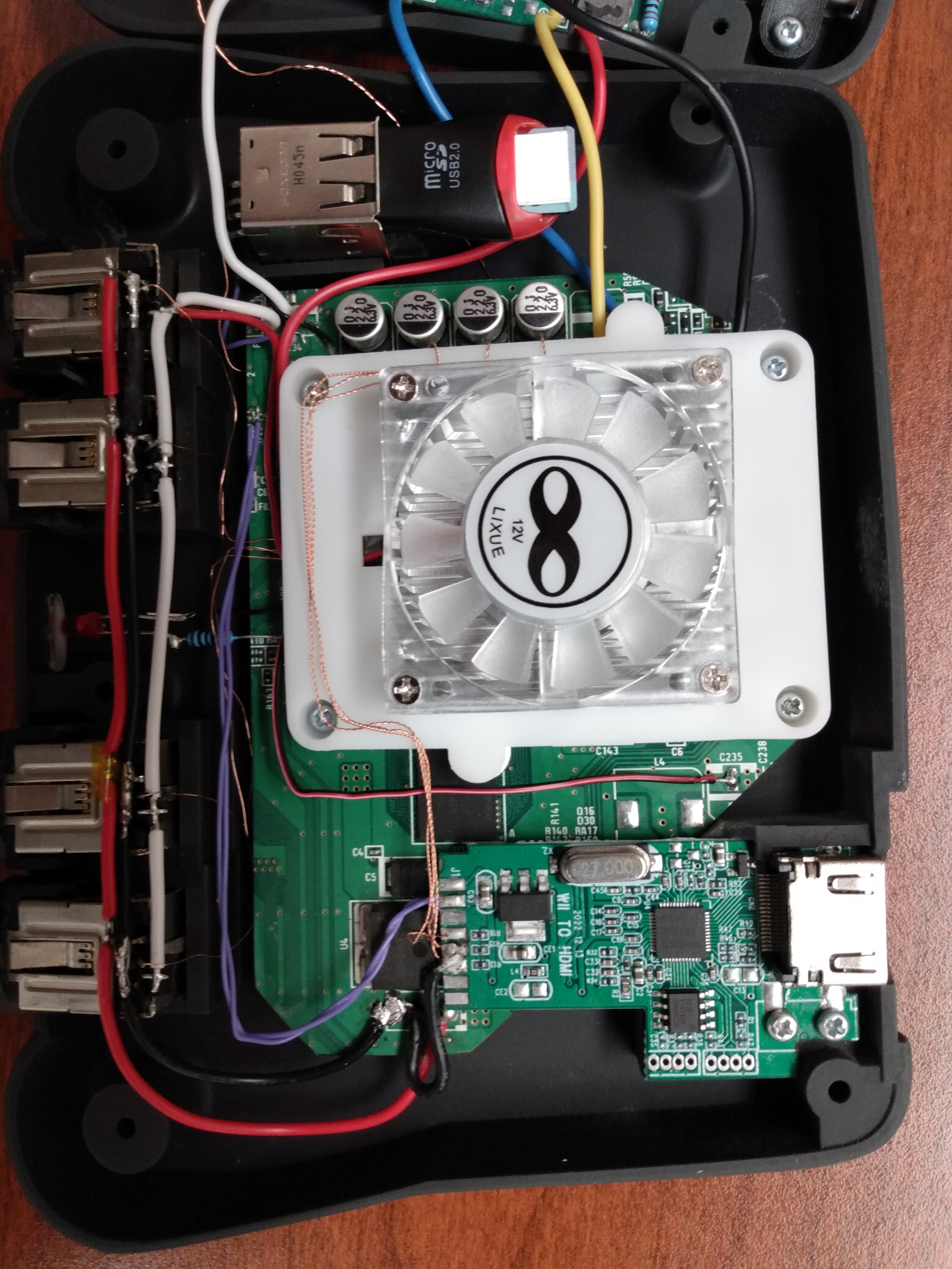

The biggest change I made on the inside was that I wanted it to have HDMI out instead of the original av port. I used a Wii2Hdmi dongle in this build, but the files I have attached can either use this, a AVE to HDMI board from Electron Shepard or the Fuji Flex. I am definitely doing a Fuji Flex for the next one! You can just plug in the unused holes with a little bit of super glue and 3d printer filament, that is what I did in my prototype, and it worked really well to make sure that the holes that were close to each other didn’t cave in or crack.
I also redesigned the heat sink/fan combo so that it would blow hot air out of the back instead of just recirculating inside.

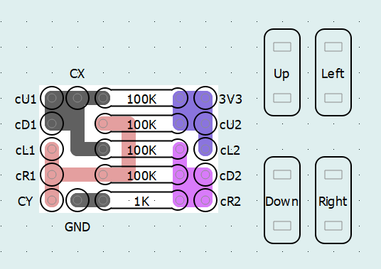

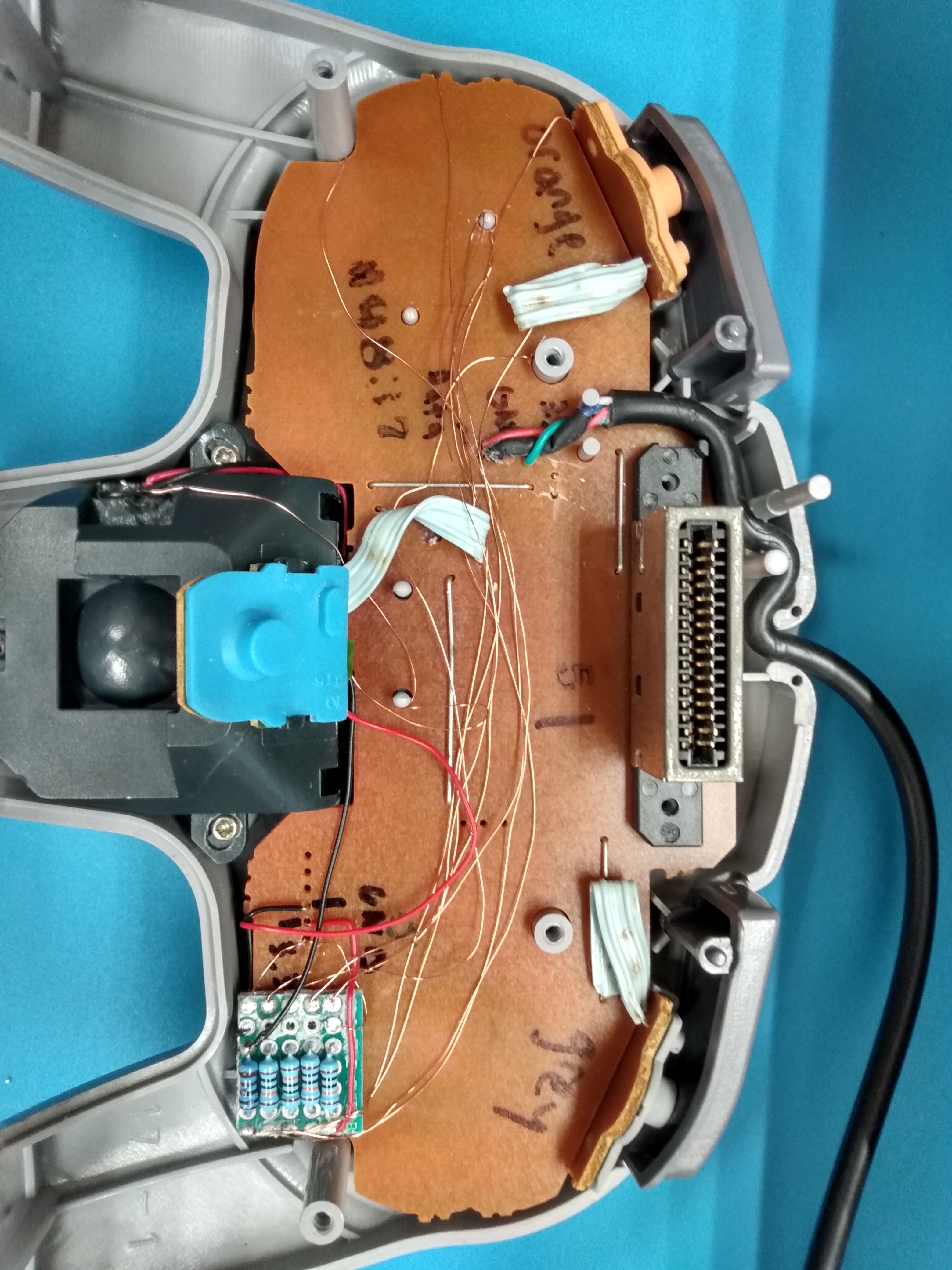

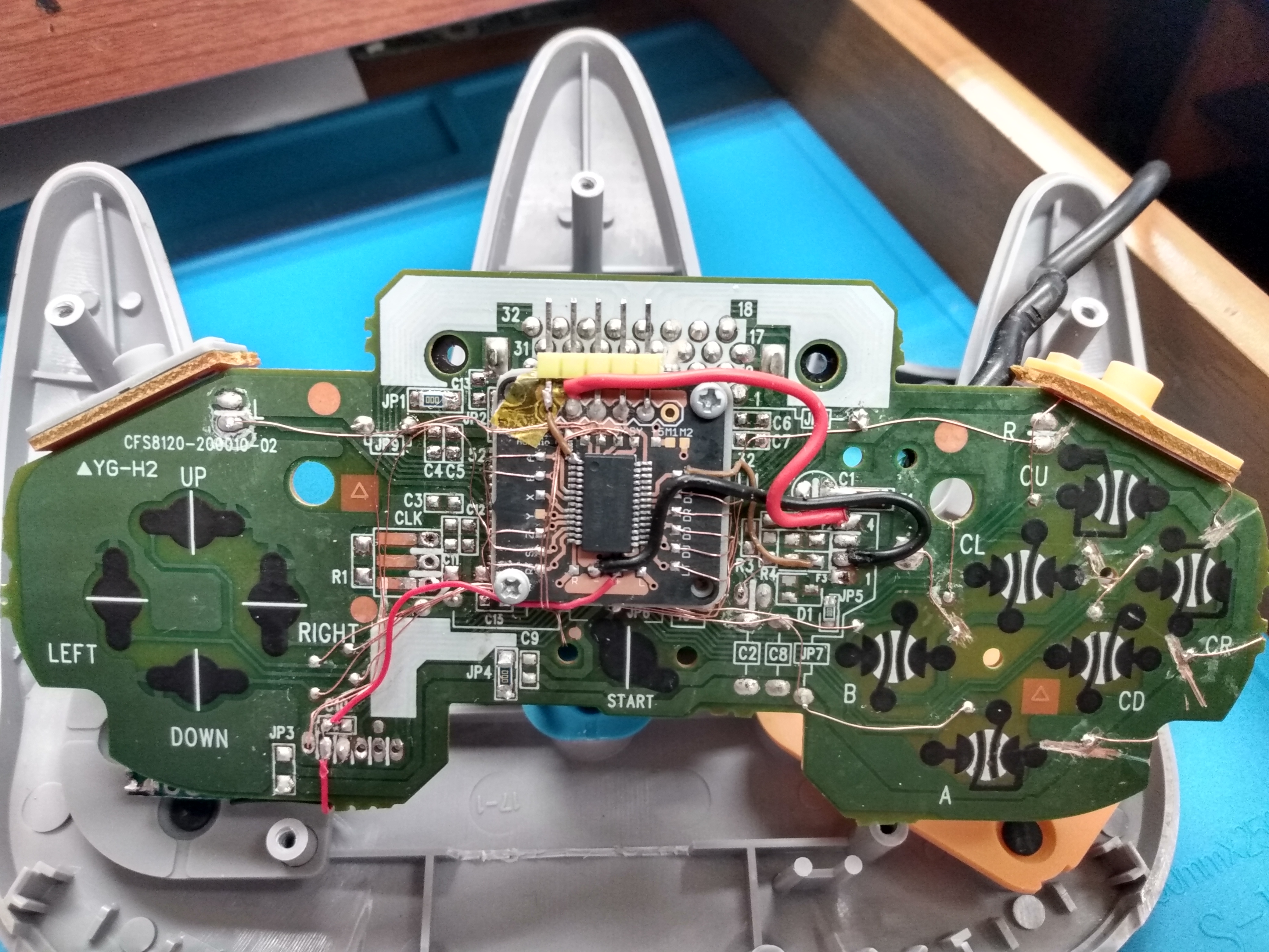

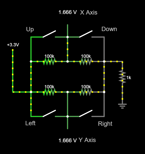

To make it complete I also put a GC+V2 inside of a N64 controller. I used a third-party replacement joystick since that had regular potentiometers instead of the rotary encoders, and I had to design my own little circuit to convert the c buttons to map out to the c-stick. You can see the schematic and little perfboard design I whipped up to make this work. After running the joystick wizard in RVloader it all works great!

- Powered by USB-C 5V 3A
- HDMI Video Out
- All 4 GC ports for sick multiplayer action
- Has working slide power switch and reset button
