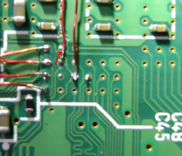

I am pretty sure I fried my audio amp and would like to purchase a new one but don't see one on the store. I didn't read the instructions properly on my first attempt and put the magnet wire through the vias and shorted something out. It was initially working. I bought another wii and started over but still no audio. I've got the volume icons displayed and it does go up and down as it should but no sound. I have checked 1.8 and 3.3v and both fine and my connections are all in the proper spots and have continuity back to the chip.

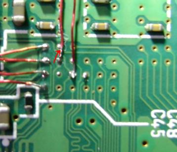

here's some pics. I have tested voltage to amp and it is good. I tested continuity from the amp all the way back to the chip on the wii.

Make sure you scraped the solder mask off the vias, tin them, and then solder the wire on. The copper needs to be fully exposed before you solder. You can do this with an xacto blade carefully. I'm sure you know this but it doesnt look fully exposed from what I can tell in the picture.
I'll go over it once more. I took the wires all the way back to the chip on the last wii board and had the same issue though. This is a new wii with the same issue which is why I thought I fried the amp somehow. The volume icon worked in both
I hear you. The volume icon displaying means that the Wii is successfully communicating with the amp over I2C, meaning that it is not entirely "dead".
ok just went over it again, scraped more solder mask, cleaned , retinned, resoldered. same result! volume icon works but no sound!

I think my initial post wasn't very clear. This is my third wii board. The first I had everything working but then started having video issues. I decided to start over and chalked the first up to a test run. My second attempt I figured it would be easier on the sound part to just run the wires into the vias and this is where I screwed up. After getting no sound at this point I decided to rework the sound wiring. That's when I had a wire break off in the wii board. Using some desolder wick I was able to pull the wire out of the via but realized I had inserted that one way too far, like a quarter inch. I'm pretty sure it hit the cpu die and shorted something out. I tried to save that board and actually took all the wires to the chip but same result. So now I am on the third board but still have the same problem. The speakers and amp did initially work though on the first board.

Is that exposed wire touching the neighbouring solder blob?
