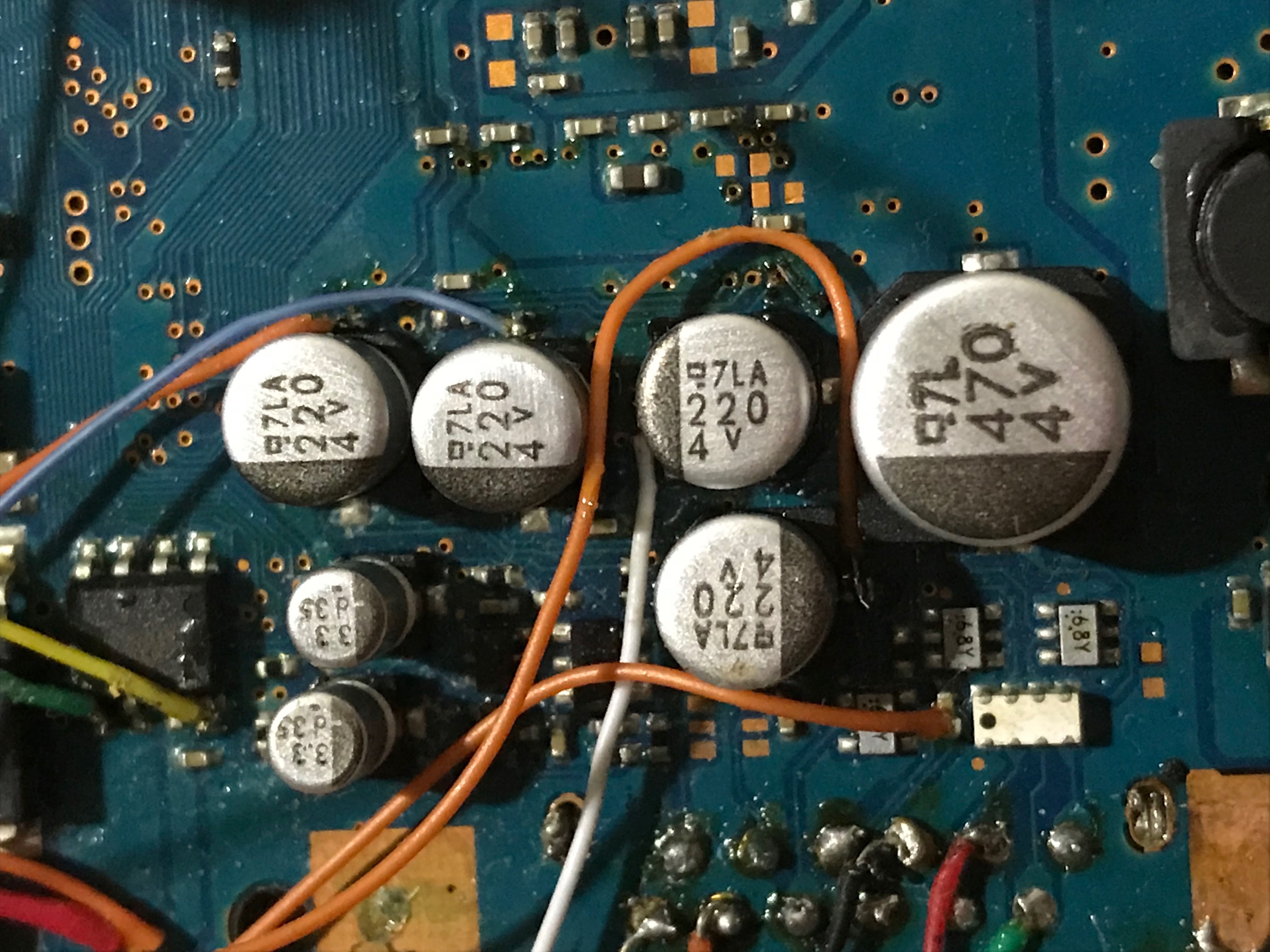

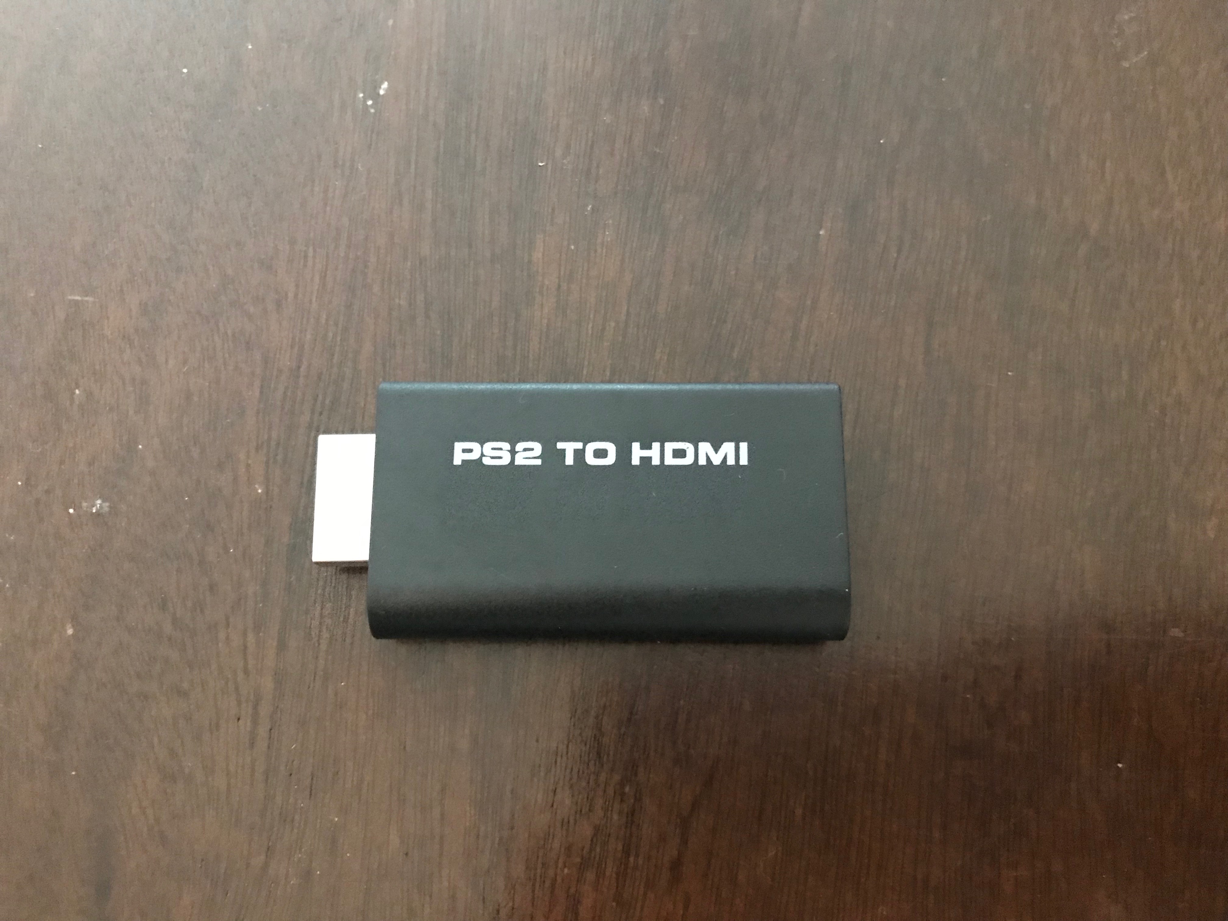

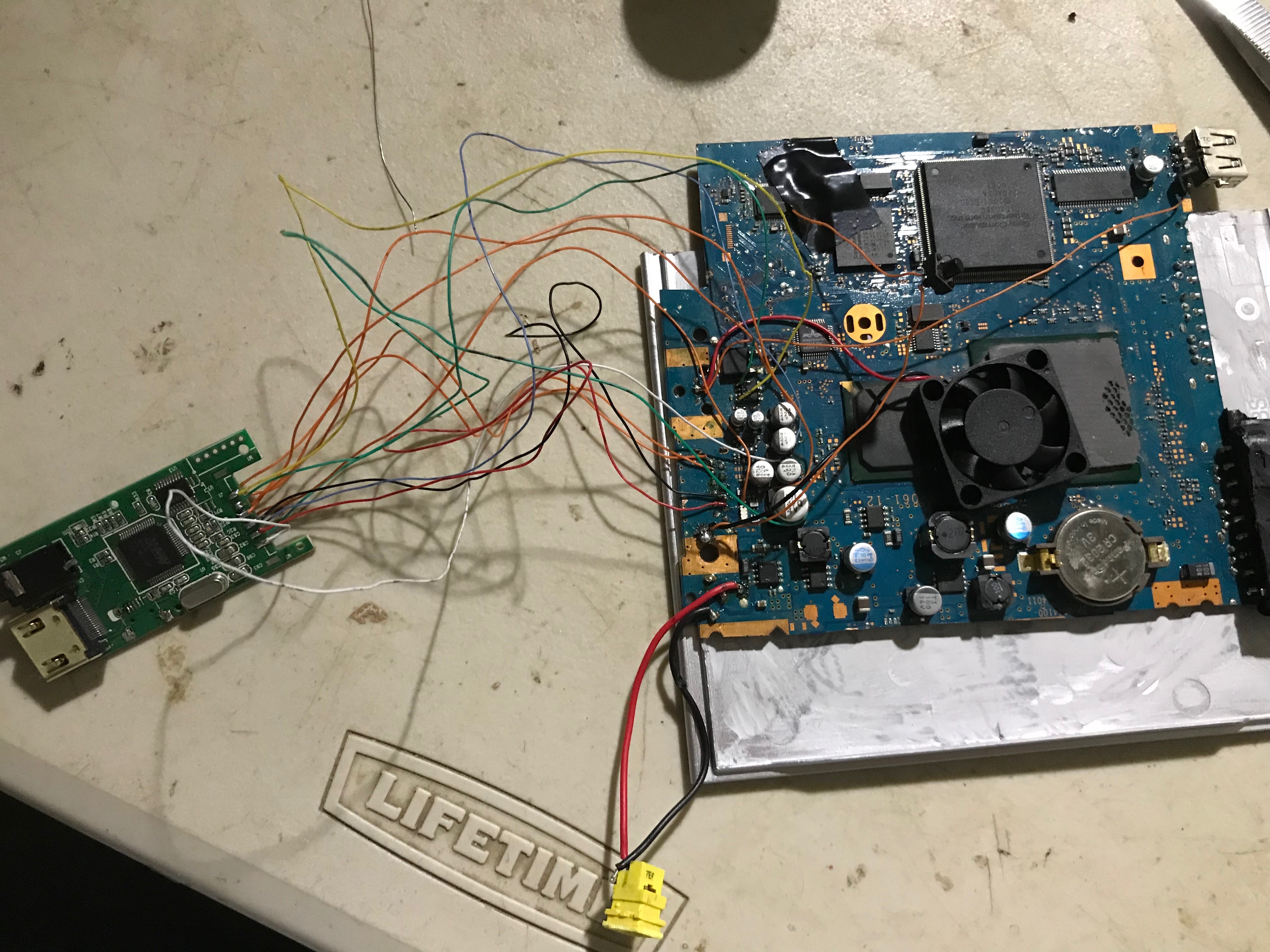

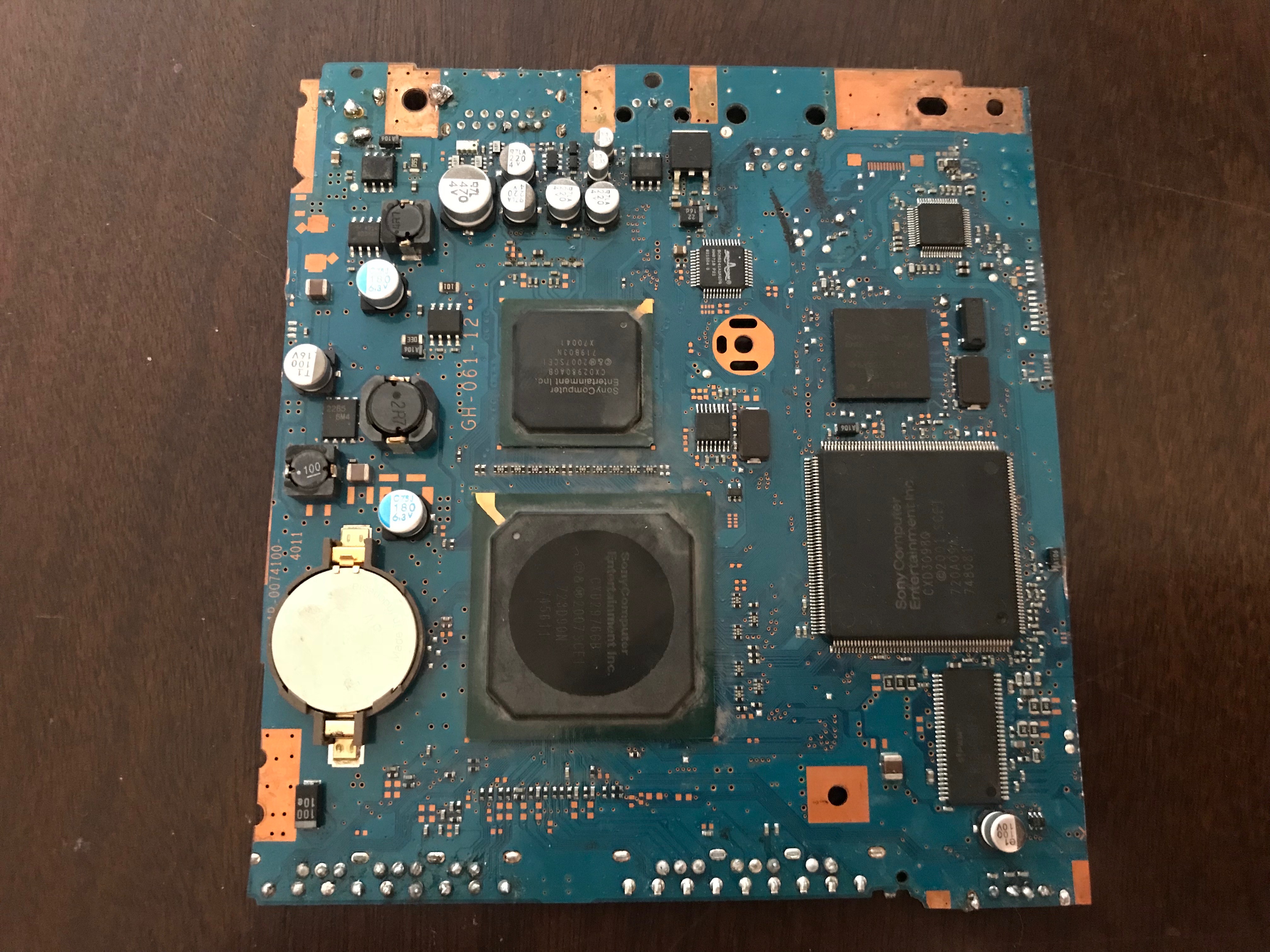

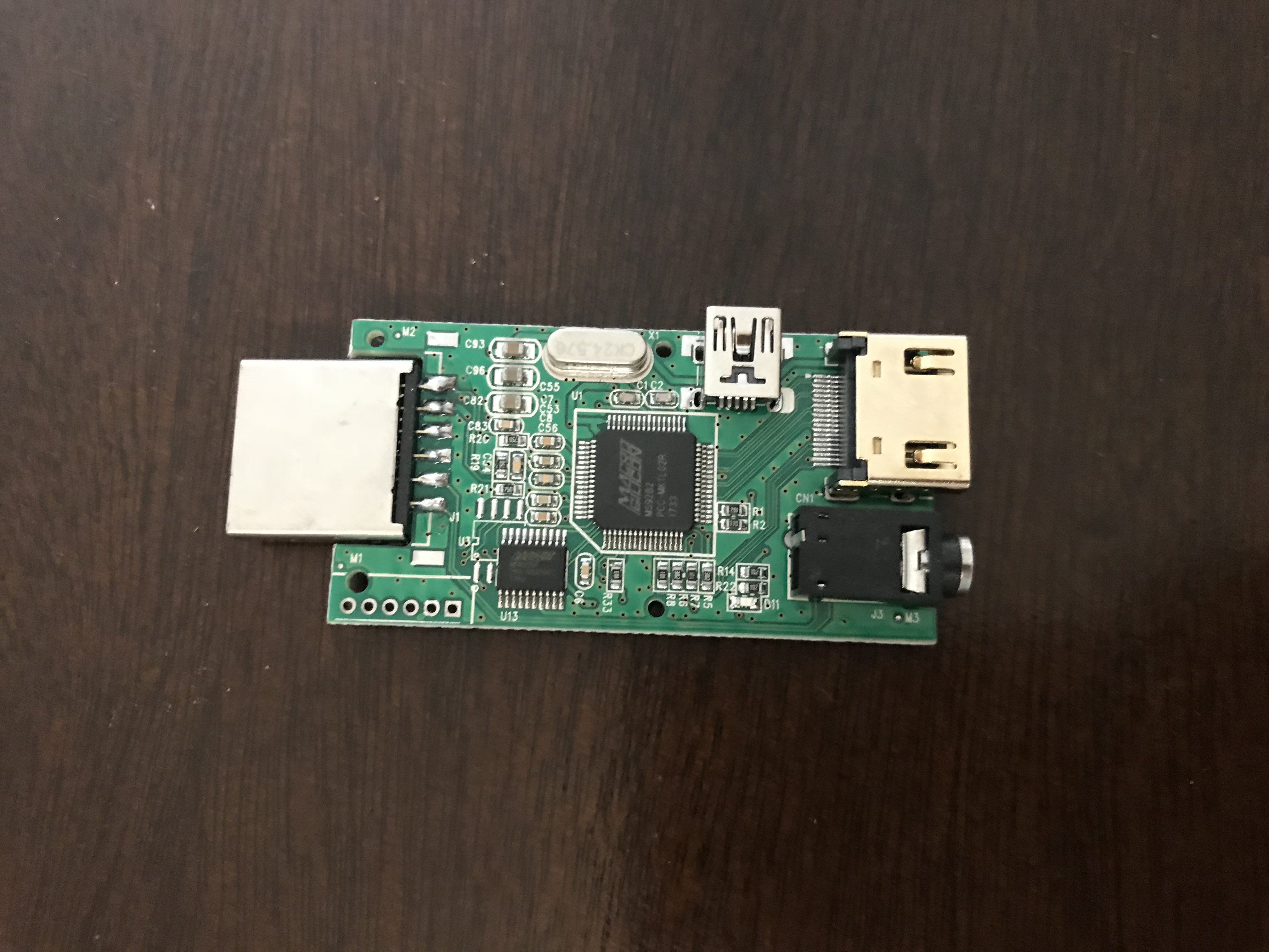

I need help trying to connect hdmi adapter to ps2 and it doesn't work I tried everything already and still no signal I get audio from the headphone jack. I get regular av out and audio but the adapter doesn't work. I just squared of the motherboard.

What model PS2 was it? Did you test the adapter before trimming? The board still has heaps of dust on it, I'd give it a good clean with IPA before trying anything else.
I did not try the adapter before trimming the board it's a 79001
The adaptor you've got looks to be the same as the one I used. This one is a pretty one to one wiring job, with four on top, and four underneath. I've noted the pins it connects to underneath (I think in left right from the bottom order as I like to wire things with reference). For troubleshooting it might pay to drop your audio connections back to the AV connector position and see if it works there :) As a side note: For some games you will need to hook 5V up to the HDMI adaptor, and it also doesn't work with some screens.

Very true, if the adapter doesn't have line doubling it won't work on a lot of screens because interlaced HDMI isn't really a thing anymore.

Thanks for the help and showing photo. Audio does work on the av pins I've tried it with 3 different tvs and with 2 different hdmi cables. I did noticed I wasn't getting continuity from the av pins to caps and ps2 main screen would freeze, but after cleaning some left over thermal paste and flux the ps2 doesn't freeze anymore and I get continuity. I'm going to give it a try again with your wiring from photo and hopefully it works. If not I'm just going with regular av to finish project I've been trying for about a week now.
