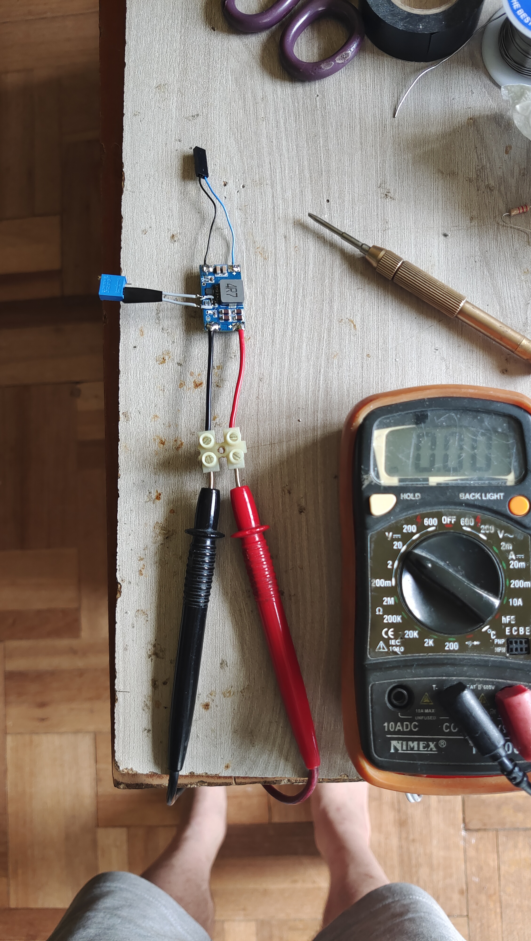

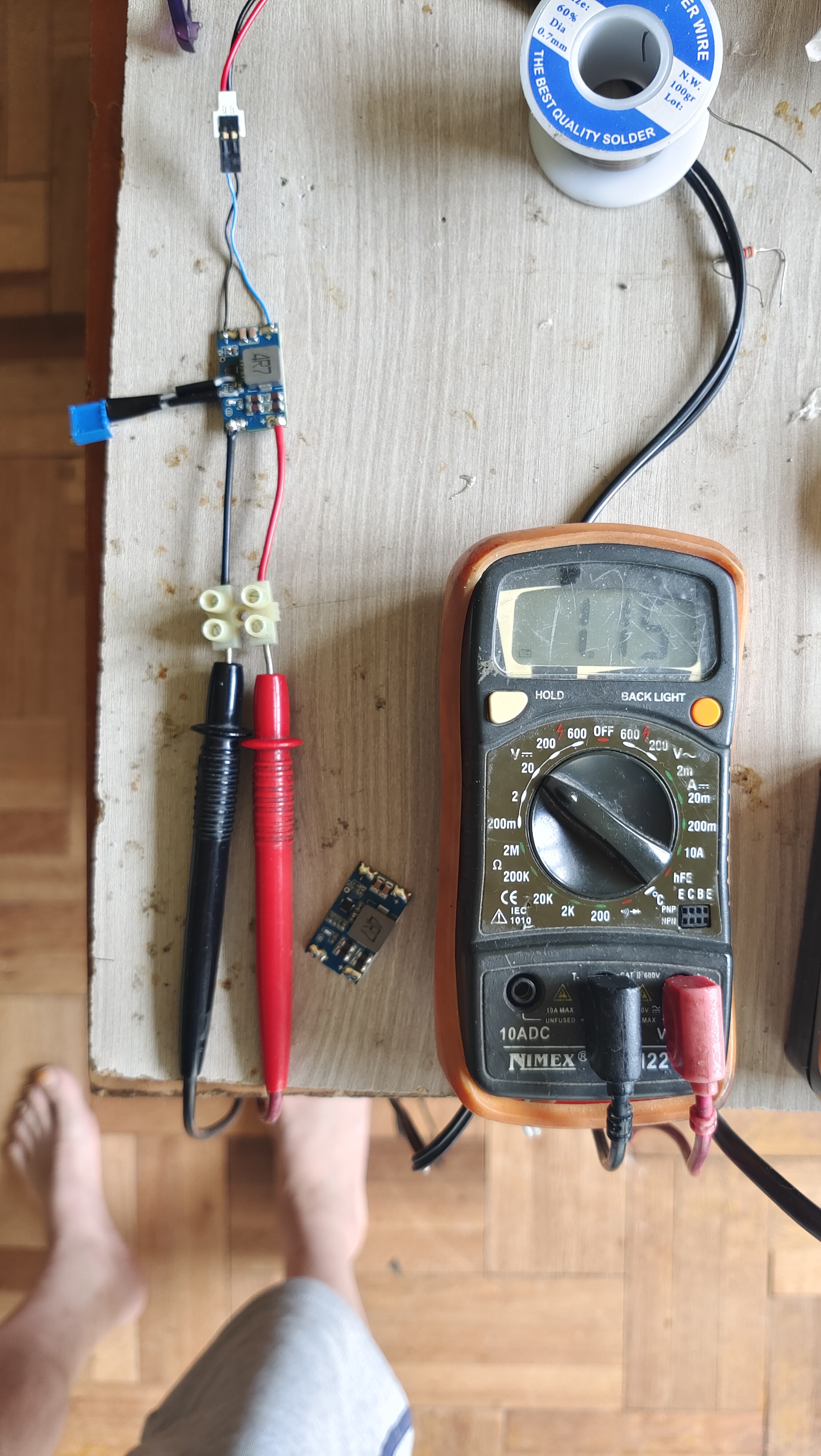

Hi, I've received the resistors but I'm having difficulty finding the correct voltage
These are my tests 2K 2.2V 3.3K 3.0V 4.7K 3.9V 4.4L (2.2+2.2 in series) always 3.9V
what do I have to put on the mini 560 to get 3.3 V???
If you could kindly give me the list of resistors you put in to get the correct voltage 1V 1.15V 3.3V 5V
Thank you I add that I got the mini 560 at 5V but the output voltage gives me 6.25 very strange this happens on all the mini 560s that were in the package
Looking at Jakara's video when he connects it he gives it 5.25 and it makes me strange
Those chinesium regulator modules are often made using multiple different chips in slightly different configs over time. It's possible that you have modules that require different resistance value to set the output voltage. This is one of the reasons why we don't recommend using cheap regulator modules like that.
Without knowing exactly what regulator IC is on your modules, finding the correct datasheet is pretty much impossible. Although, you could use a trim potentiometer in place of a static resistor and live adjust it until you find the desired output voltage.

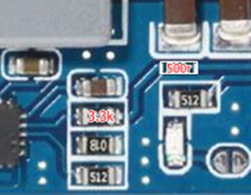

3.8k โอห์ม คุณอาจต้องใช้ 3.3k โอห์มบวก 500 โอห์ม วิธีการทําเช่นนี้เป็นดังภาพนี้ ฉันทําสิ่งนี้ด้วย

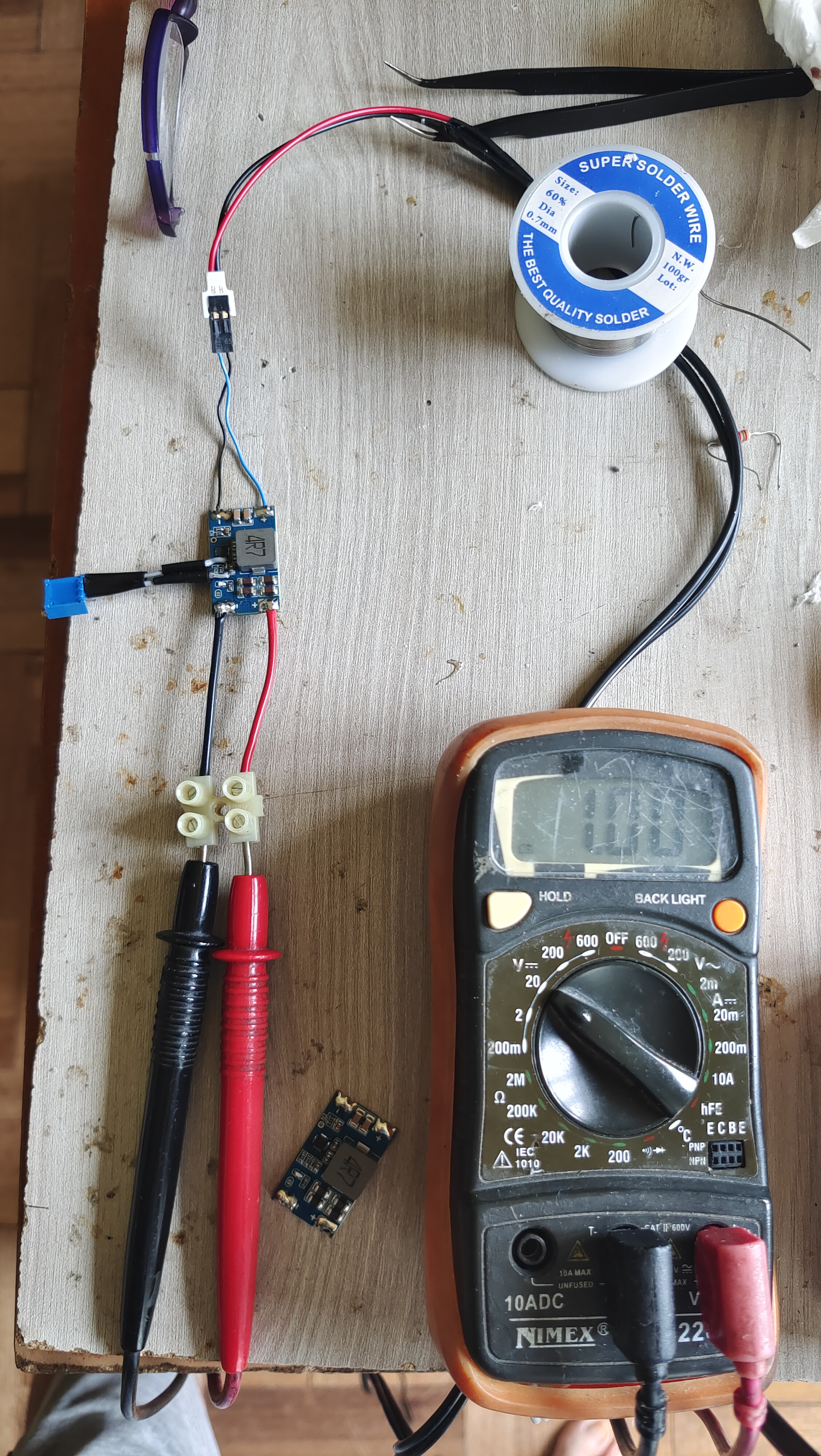

Then we are approaching the correct value of the resistance to reach 3.3V
This morning I put a 3.3K + 510 ohm resistor (3.810) the voltage is 3.40 V (too much?)
I have the possibility of trying with a 470 ohm instead of the 510 ohm one in order to have 3,770
Otherwise I have 330 ohm ones but I assume 330 is too low ?
would end up with 3,630 K
The voltage doesn't have to be exact in this use case. 3.4v is within margin

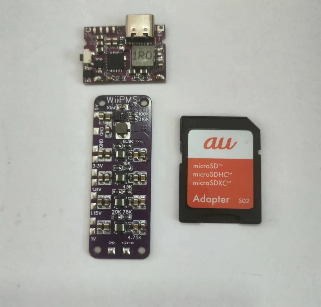

I’ve used that regulators to power my wii, and I had no issues while setting up my voltages, maybe your modules have a second feedback resistor which is slightly different compared against other modules
I remember that I’ve placed a 10k pot and I was able to regulate from 1V to 12V so maybe your resistor values are A LOT different
