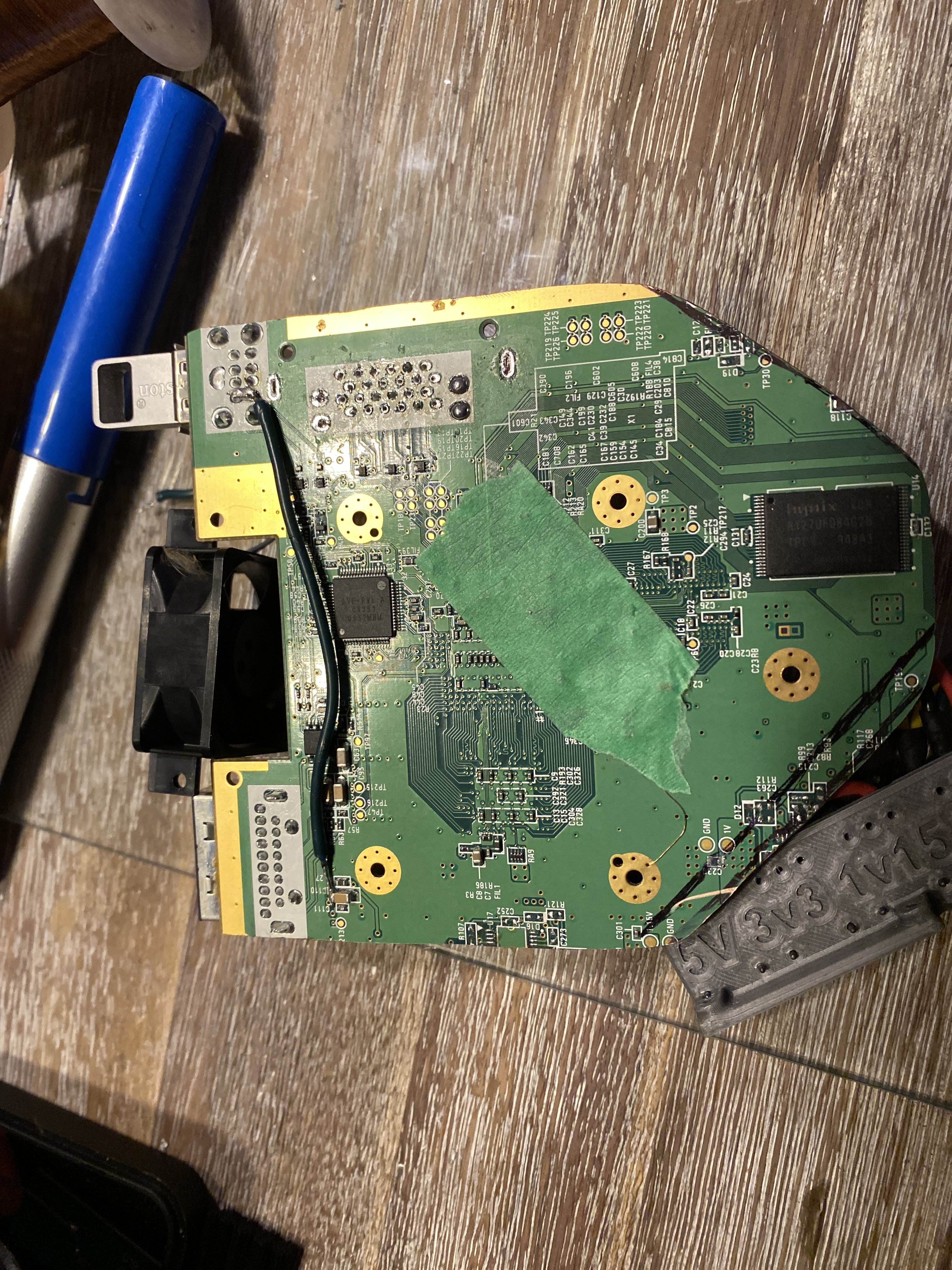

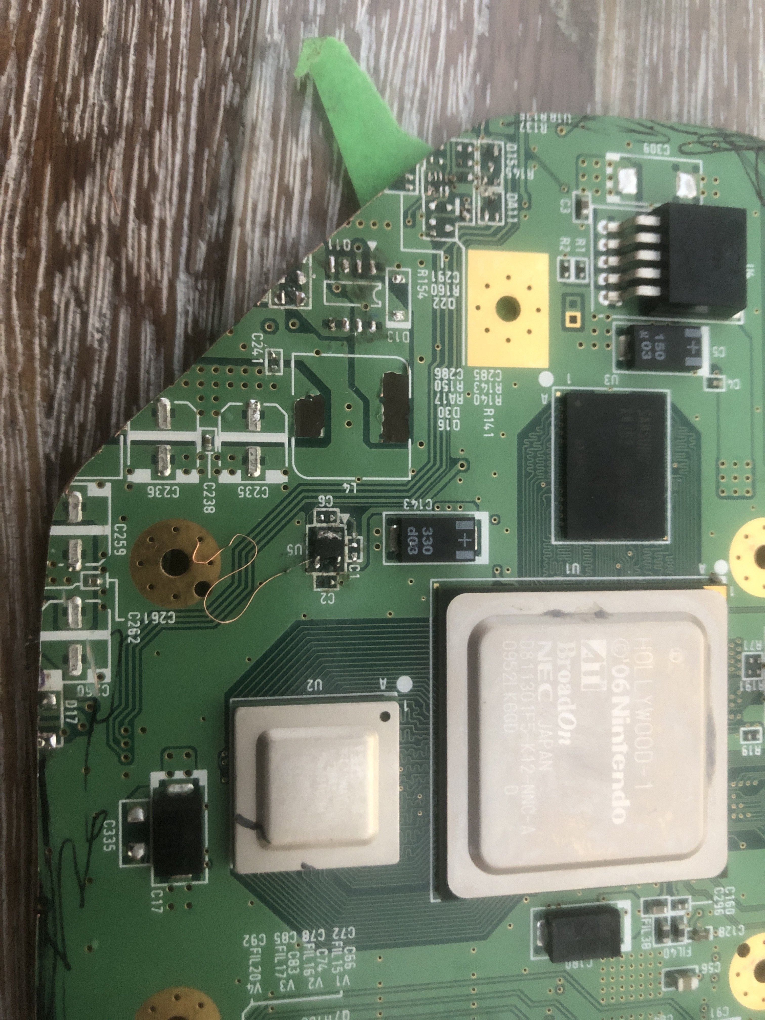

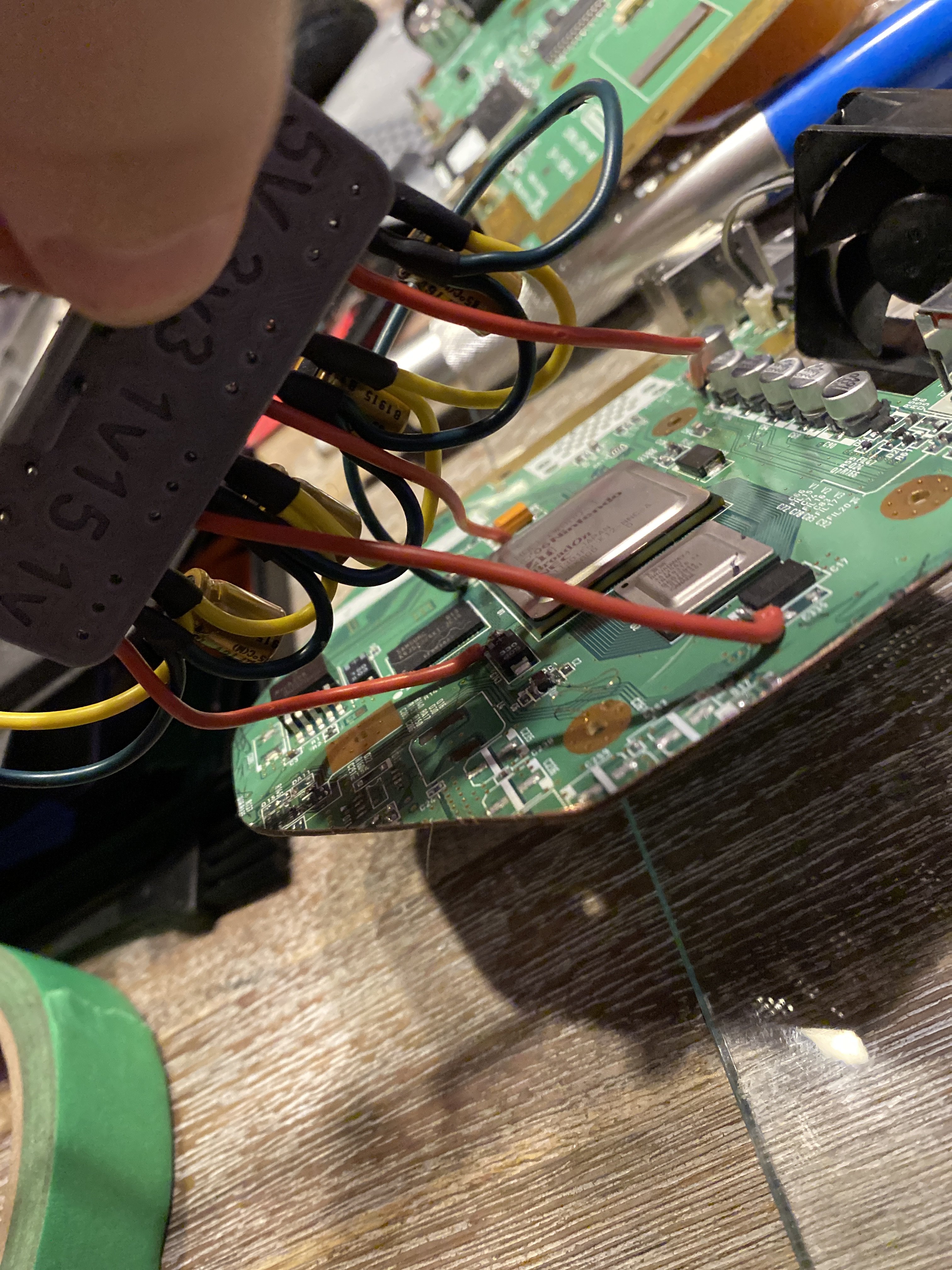

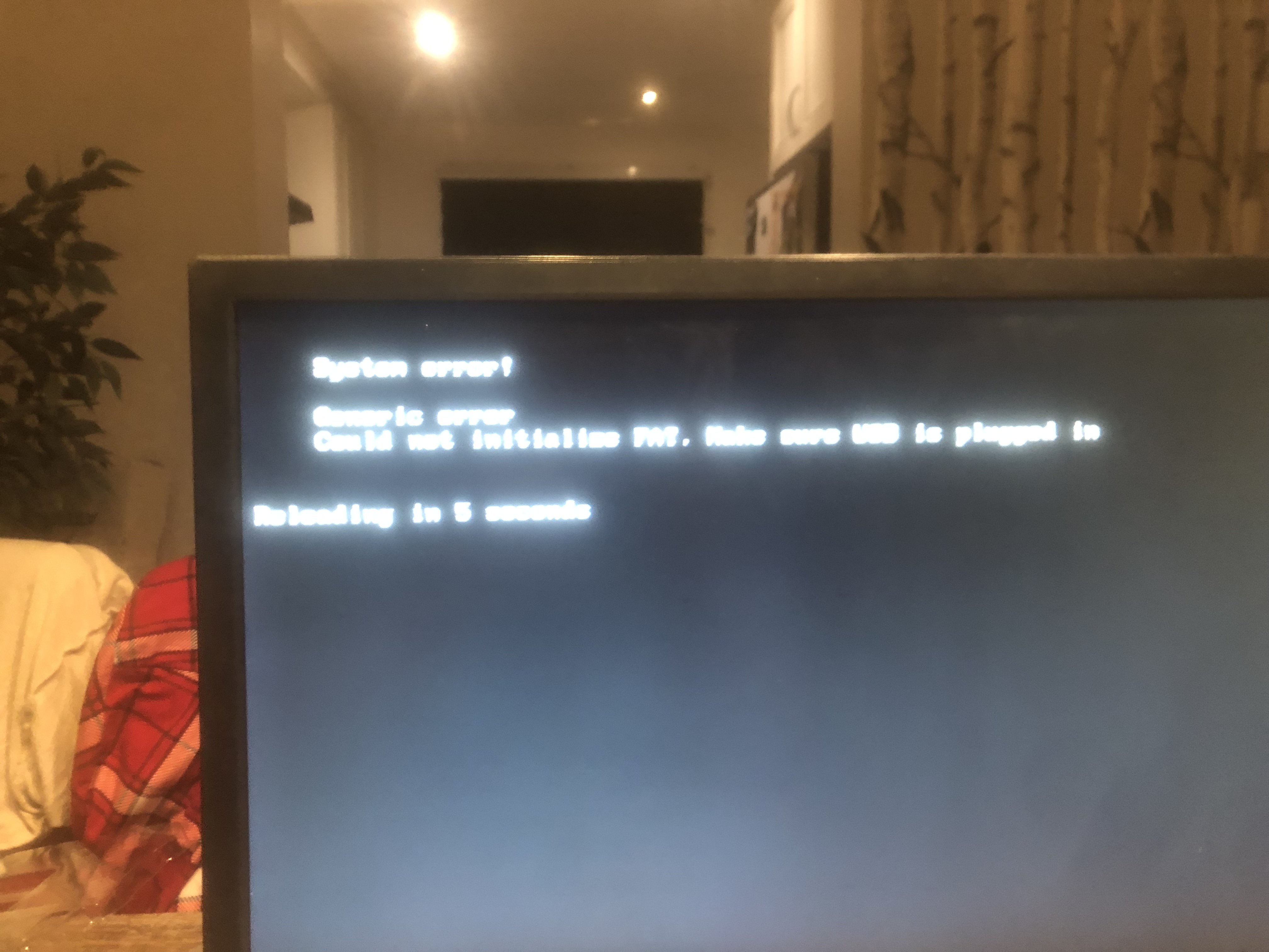

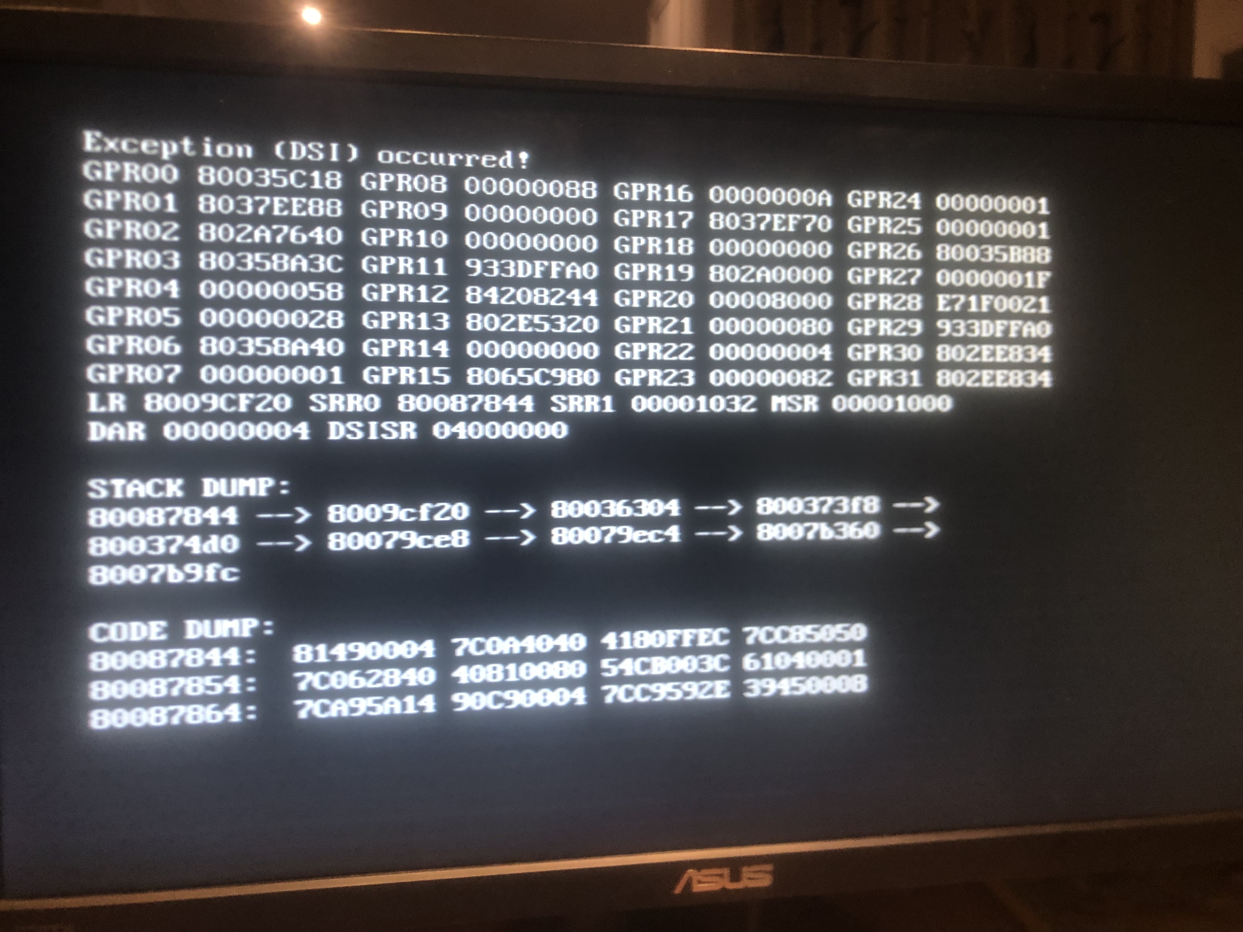

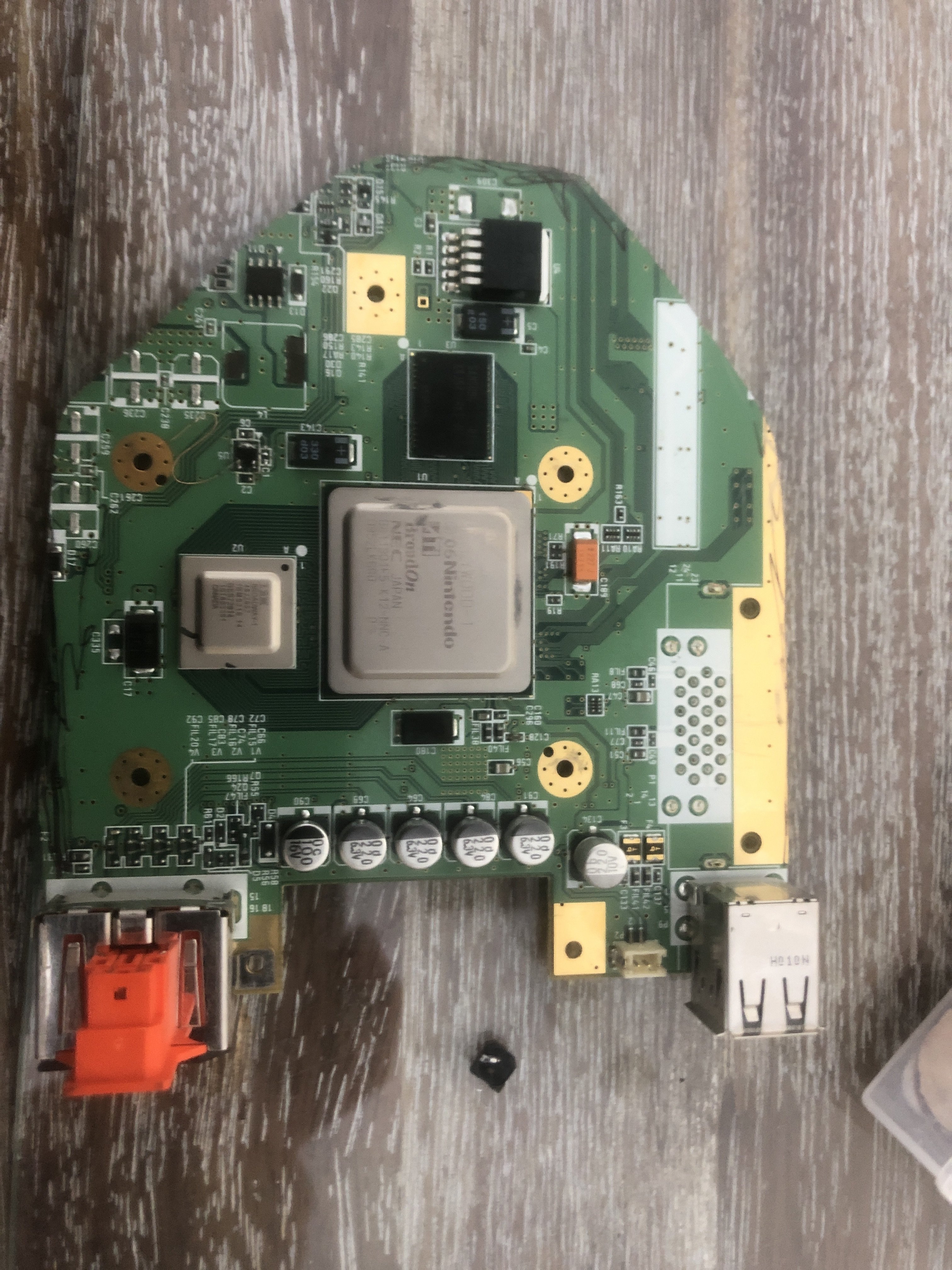

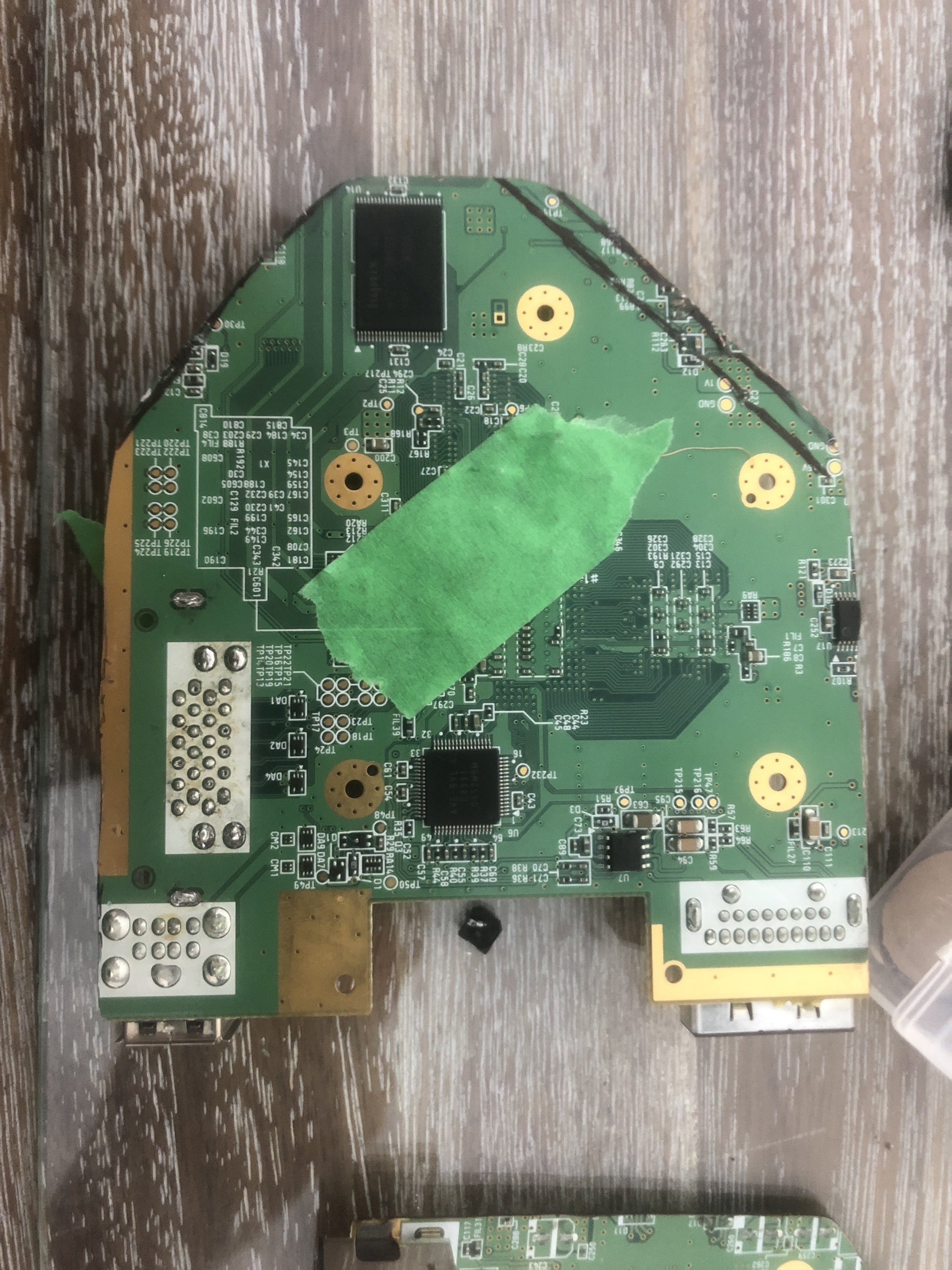

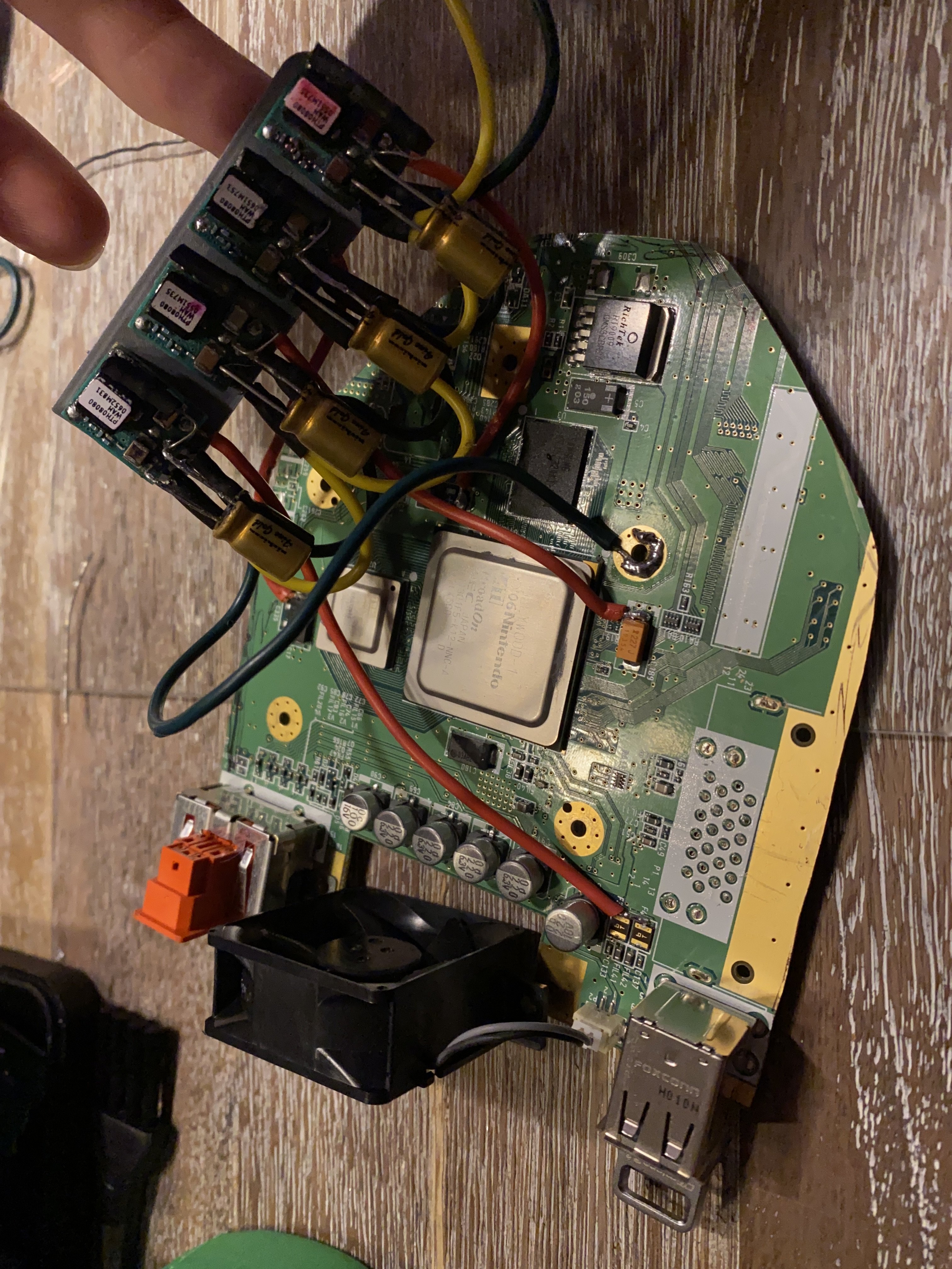

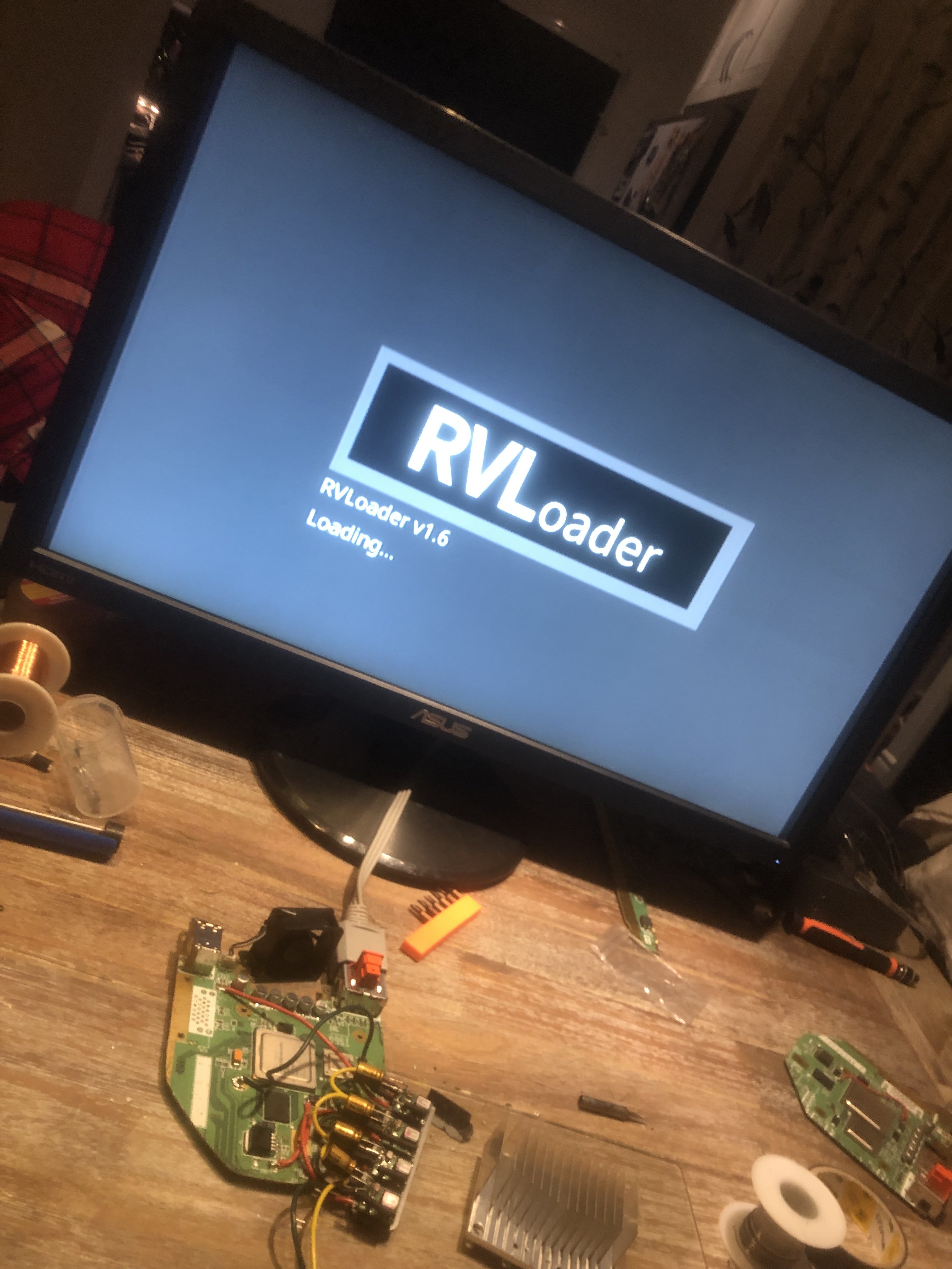

I have listened to you and there is an evolution. my wii boot almost all the time (otherwise a black screen) but it gets stuck on one of its images
What USB drive are you using and how is it formatted? This is likely an issue with it.
I don't think it's my usb key because I tested it before cutting my wii and everything worked fine
Do you have an untrimmed Wii you can try it on again? If so, give it a shot. If it works there, then it's probably your trim. If it's bad there too, then maybe your files on your USB got corrupted. If you don't have another Wii, skip right to replacing the RVLoader files on your USB.
