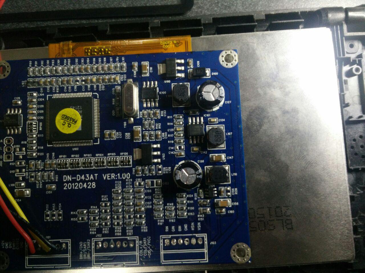

sounds interesting... so, you can guide me to find the first stage regulation if i post a image of the driver board?

Yeah I might be able to do that. Just make sure to take it as clear as possible :D
this is my driver board made by some asian people from aliexpress (gooddisplay i think)
If you follow that big trace on right of the top side, that should be 12V and it goes through a diode. After that I can't really see where it goes. Can you post a picture near that diode (take it right from the top so that I can see better)?

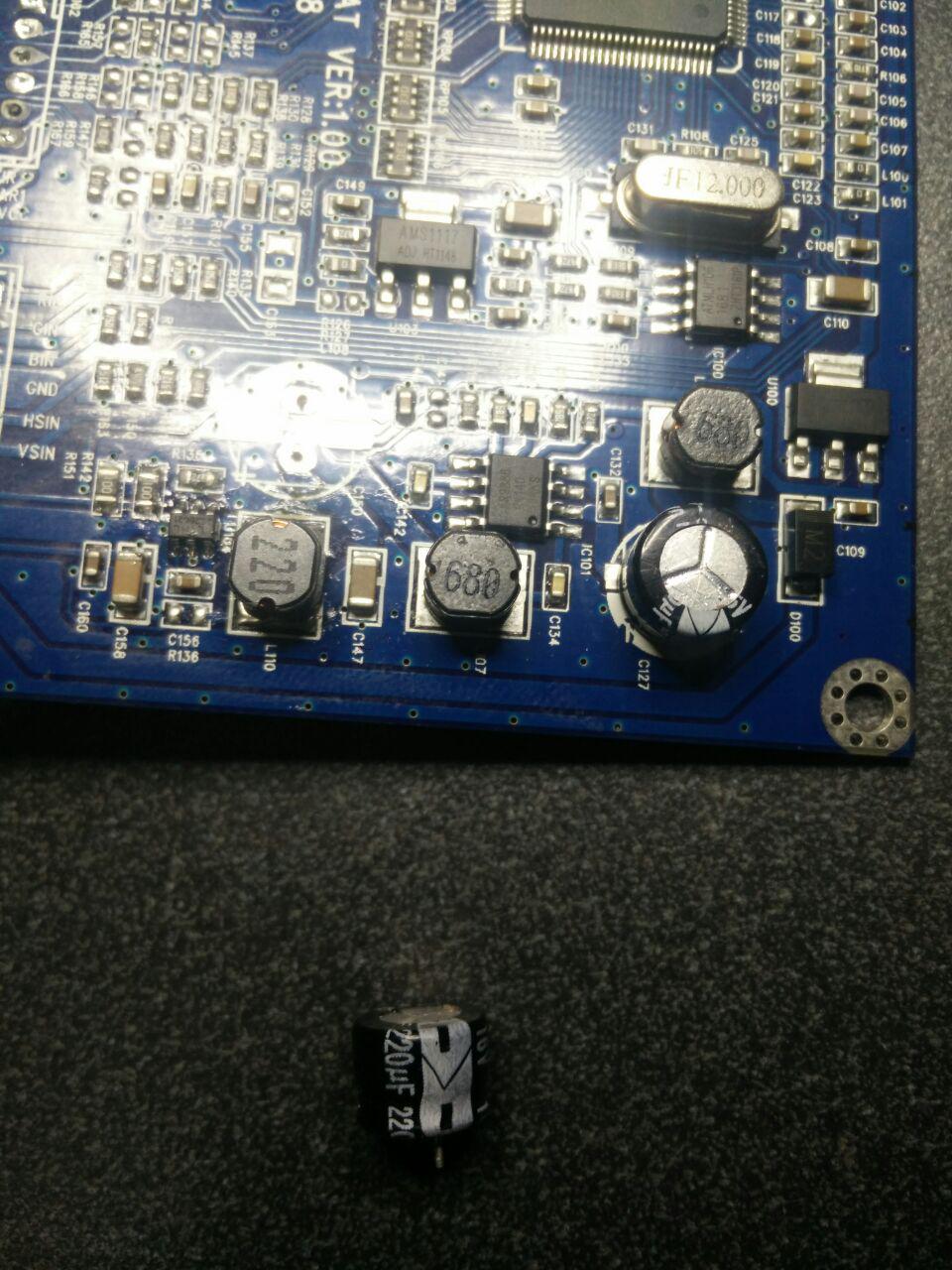

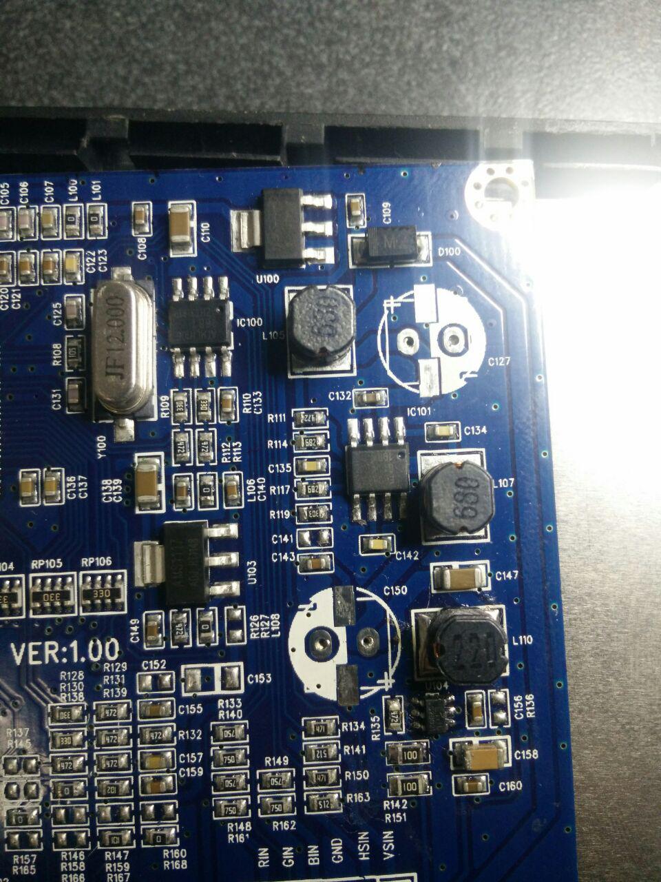

Im working right now and dont have the driver, but have another pics, maybe can be helpful
Aurelio is right. I figured this out a while ago for running the screen off 5v. The regulated voltage output is 4.2v on mine.

Here is a link to a cheap 5" screen. It says you need 12v but if you open it up and run 5v to power bus, it works great!
Nice! Remove at least that inductor, you don't want to have an input voltage on the switching regulator output
