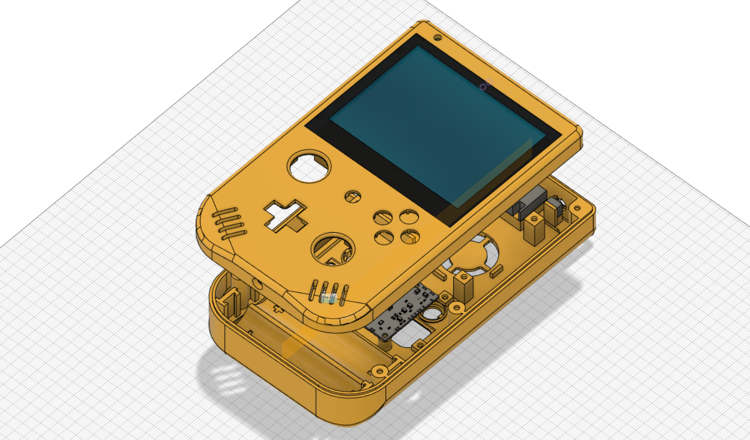

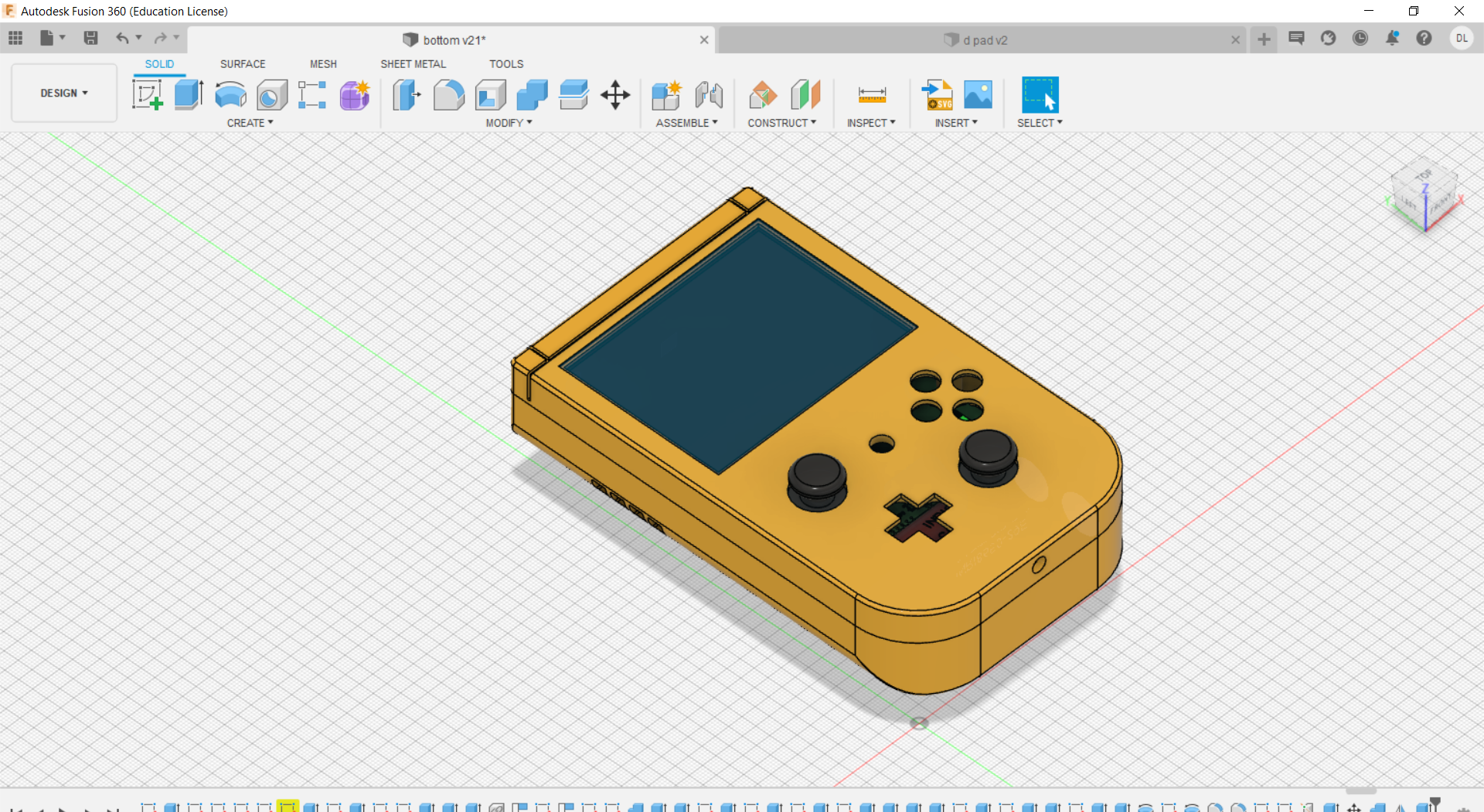

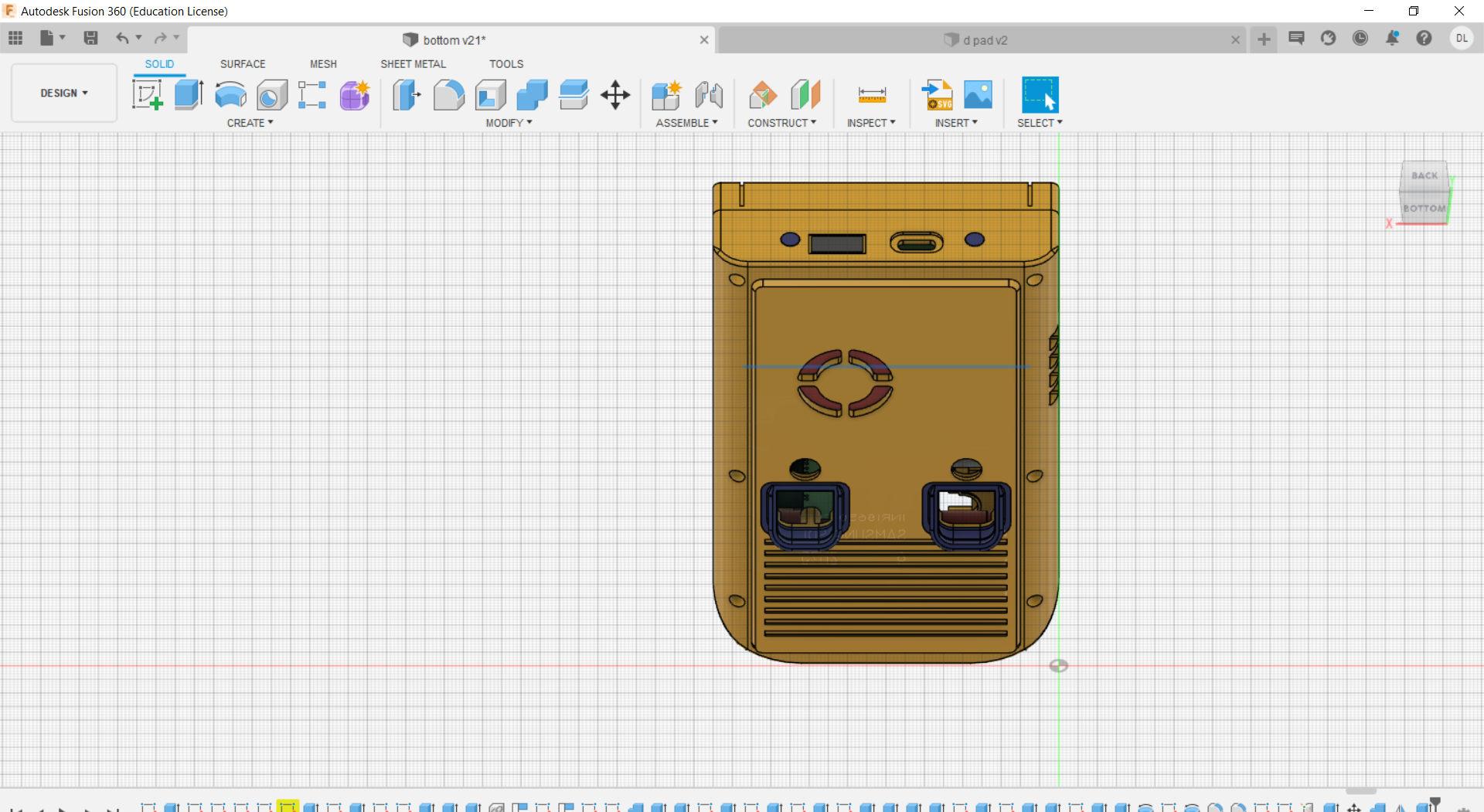

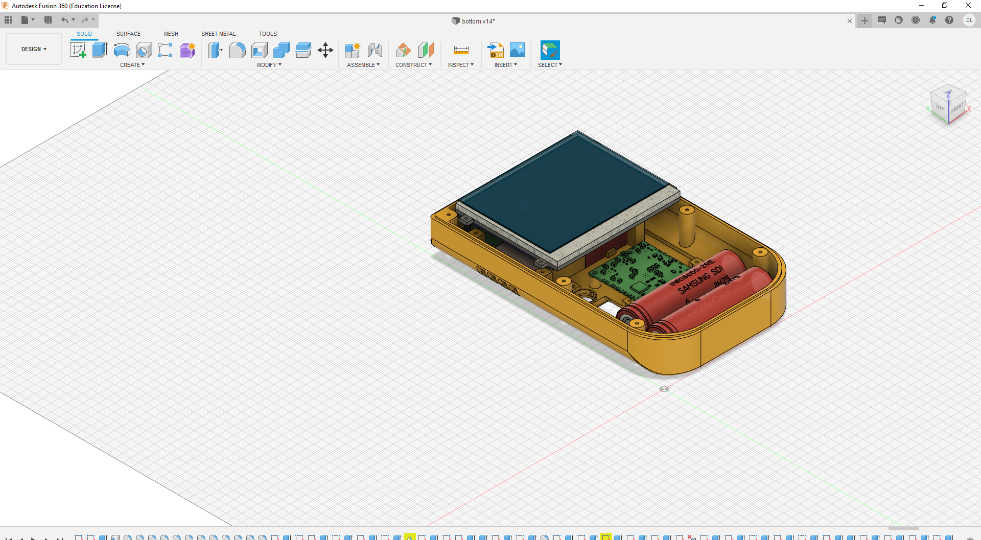

Finished case design. Gonna print some test prints and see how it is. It's made for .55 thick glass and I think I found a source.
http://valleydesign.com/gorilla-glass.html - Does anyone know if this is ok?

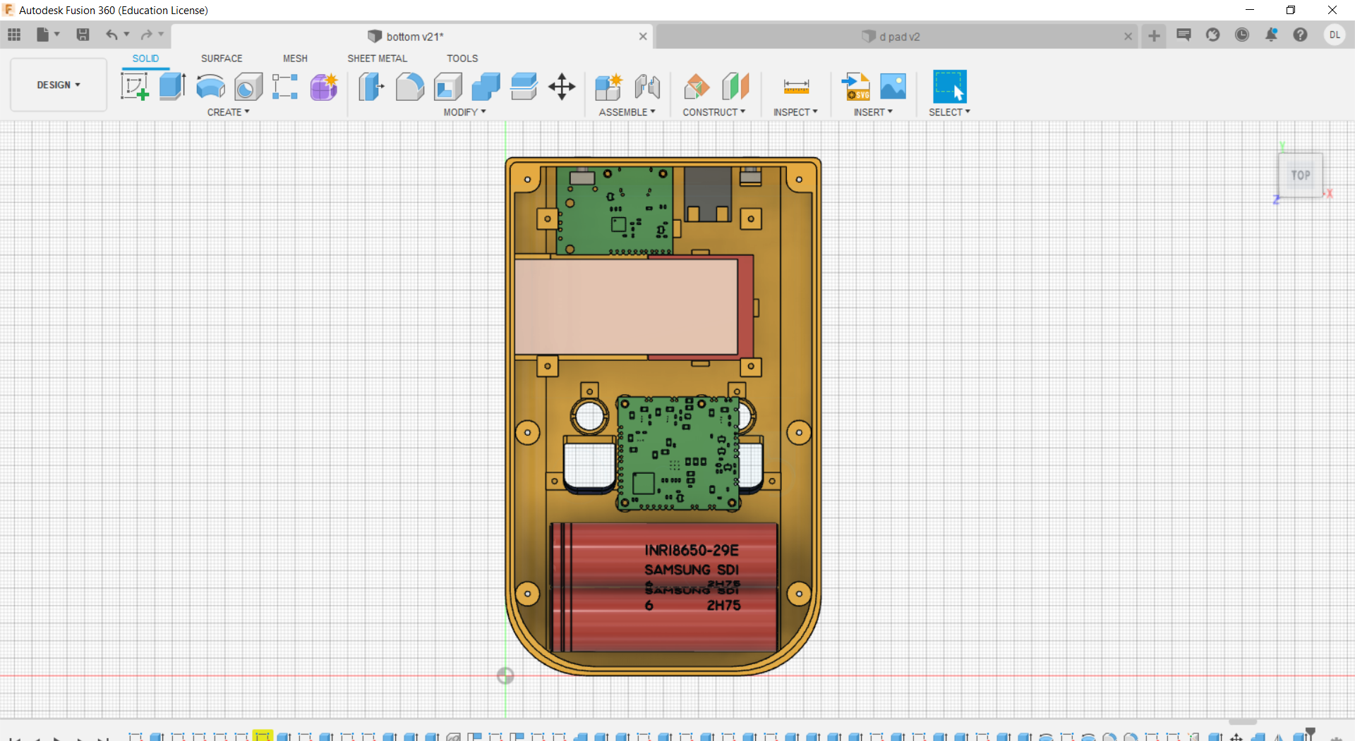

Starting pcb design now. Basically gonna be pcbs that utilize 4layertech.

Didn't get a lot of time to work on this but I'm making steady progress.

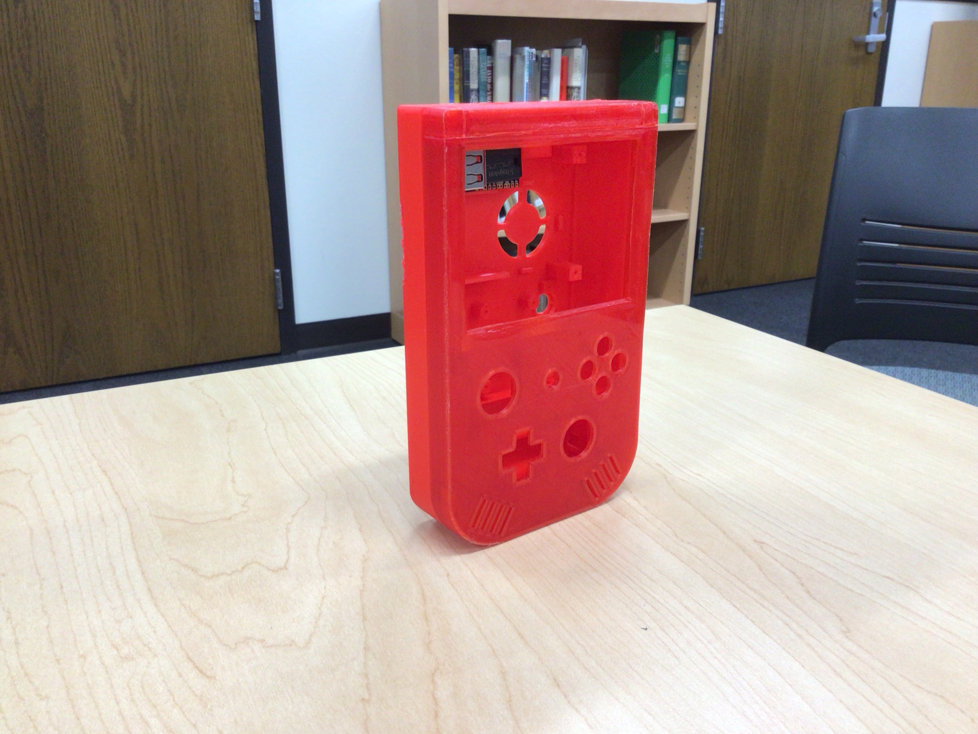

Did a test print and it seems that many of the tolerances are too tight. Have to make them more loose next time.
Also seems that sections of the case are warped by the bed. Does anyone have a fix for case warping?
Supports also seem to damage the case when I try to remove them. Gotta be more selective where they are in Cura.

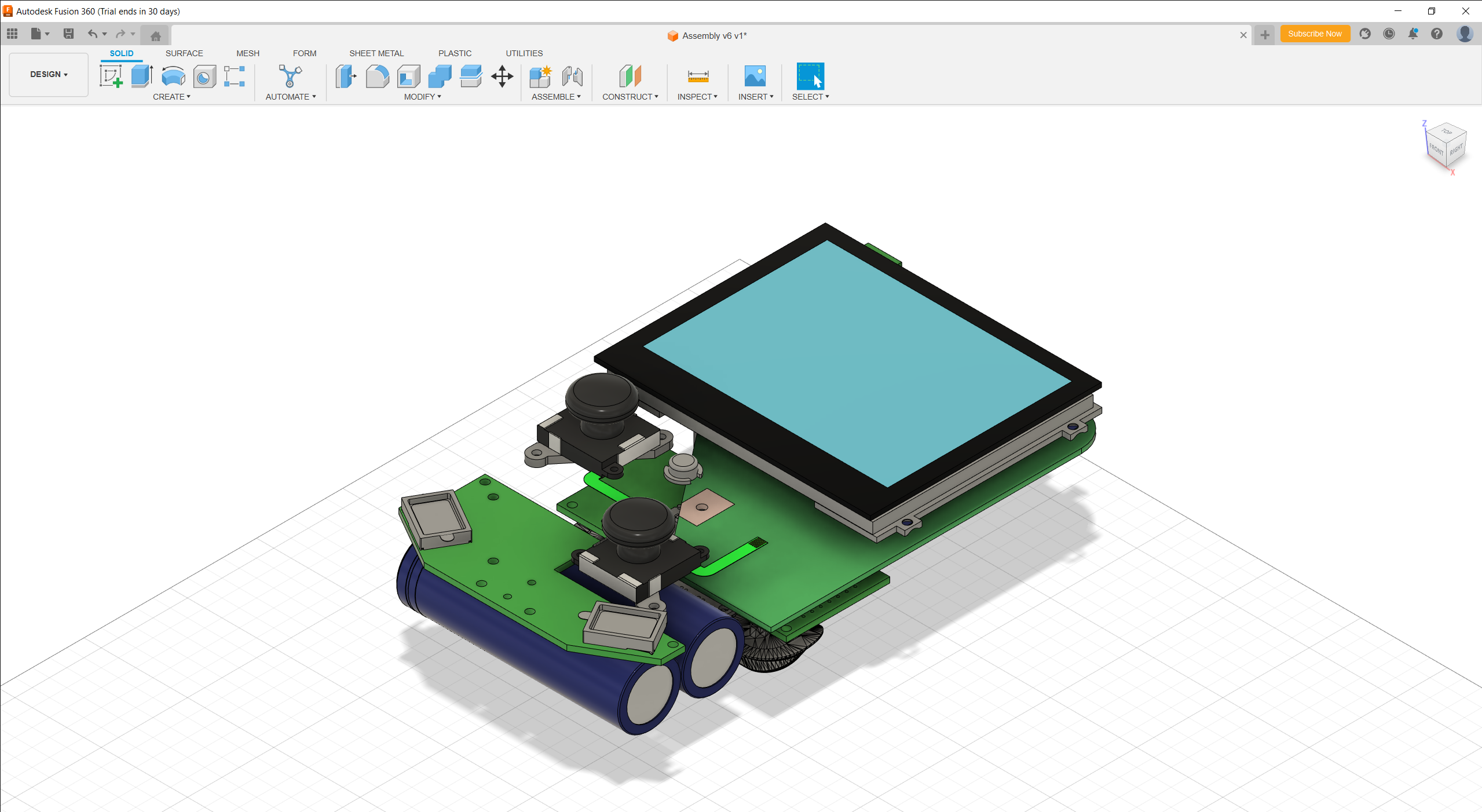

Work on PCB schematics have been steady, mostly just making footprints and stuff like that.

What filament are you printing the case in?
Warping is caused by the plastic cooling irregularly, causing a temperature differential. If it's warping, the bed might not be heating uniformly, or the bed might be set to an insufficient temperature. There's also the potential of drafts. Gusts of air can cool the plastic irregularly and cause warping, but unless you're using really temperature sensitive plastics like ABS/ASA, warping like that shouldn't really happen unless you have like an airconditioner blowing on the printer. If you have a cardboard box lying around that's the right size, you could try making a ghetto draft enclosure to keep the heat in.
Supports also have a lot of options to make them more removeable. You can increase the amount of space between the support and the print by an extra 0.1mm at a time and see how that goes. It leads to a slightly worse looking first layer, but usually I call that a worthwhile trade. Especially when using PETG.

All the PCBs and CAD work is done. I have most of the parts needed to make one now. Will probably construct one in a few week's time.
I'm releasing all my current files just in case I have another "life happened" moment. As stated two years ago, this is a remix of Gman's work.

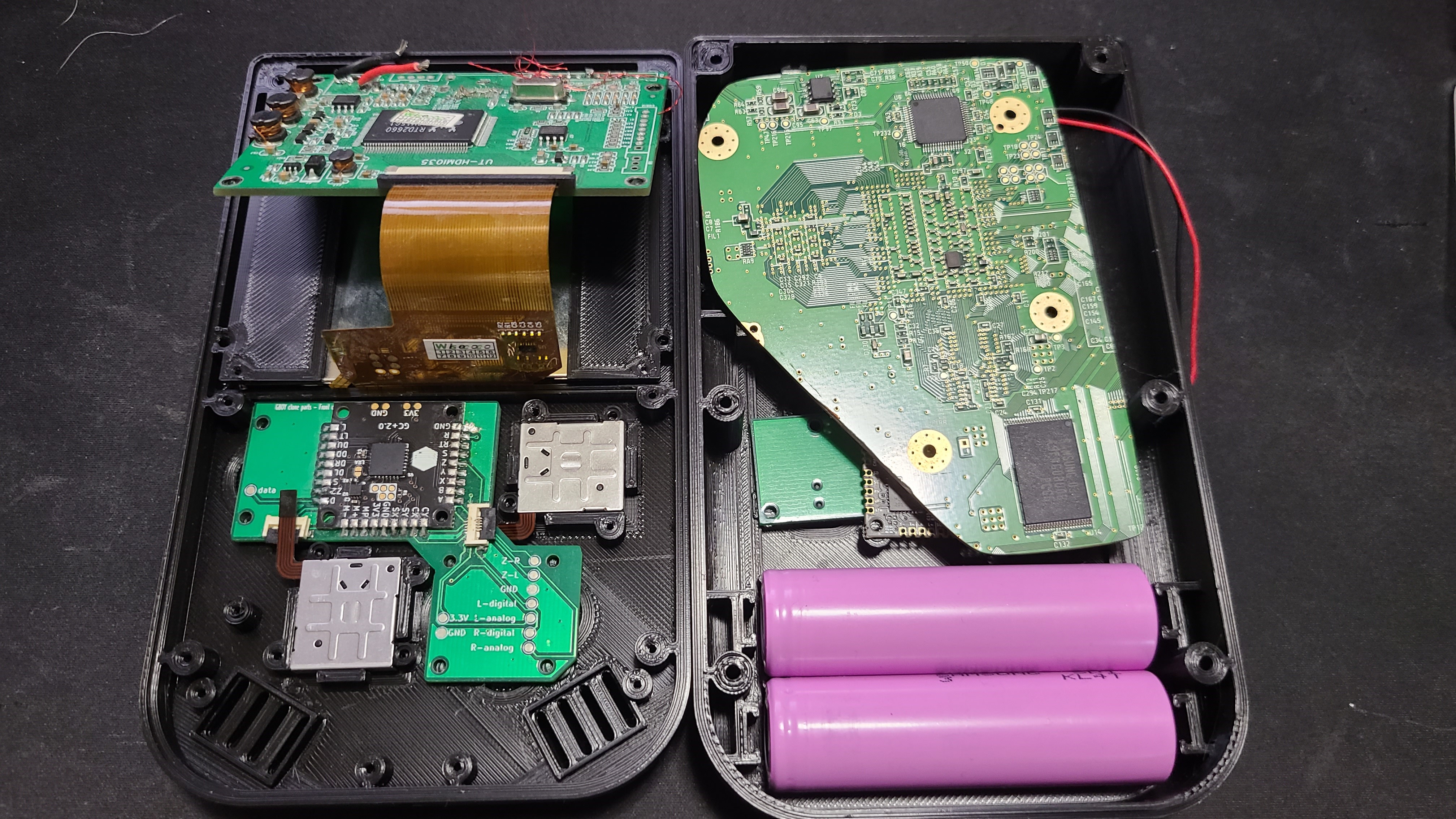

  • Dedicated sync button
  • USB port
  • Screen Protector
  • The screen holder has mounting screws for that Wisecoso 480p screen
  • Two Z buttons
  • Uses 4LayerTech boards
Includes all files needed as well as some components (screen, batteries) in the assembly for dimensioning. Hope others will find it useful.
I noticed that many files on bitbuilt are in .STL, making it hard for easy modification in F360. All files here are in .STEP for easy modification.
