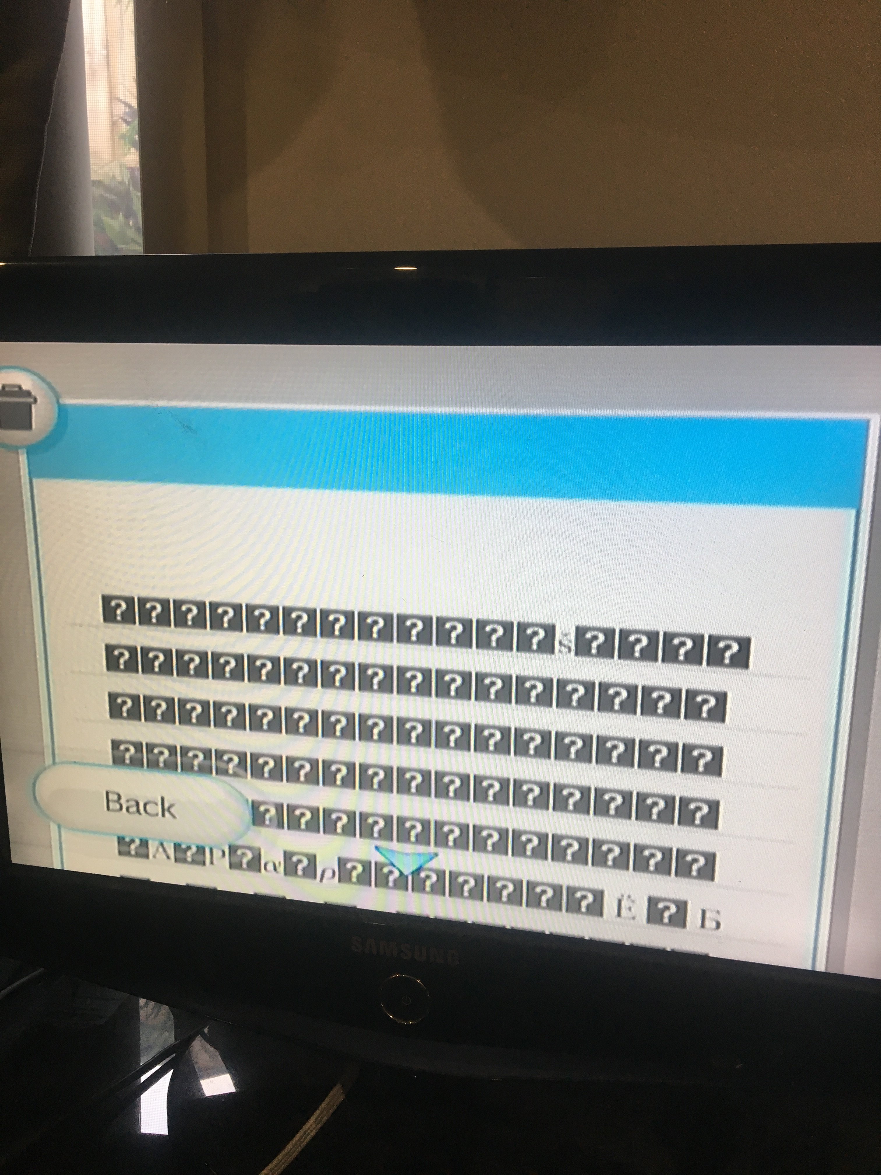

Hey guys and gals,
So over much time of planing I just said screw it to start my wii portable today.
I got a RVL-CPU-40 board and took it all apart to get to the internals.
As soon as I tried to install portablizemii I come up with this problem.
I get the whole sd and USB set up fine, plug it in and go to the date page but then as I try to open letterbomb I just get it open as a memo with heaps of ????
Is there a fix for this ?
EDIT:
So i have just resolved the problem. I went to just download the homebrew channel just using letterbomb and then still no luck. i changed around the folder "private" from letter bomb with the one from portablizemii and it booted in right away.
Try making sure the date and time are correct and making sure your system is up to date. It should be on version 4.3U or E or whatever region you're in. I would also reformat your SD again and copy the files you might've missed a file.
My best guess that I stole directly from cheese is that you probably selected the wrong region when you downloaded it. There's a little flag thingy at the top, if your shit is Europeepin' you gotta click the flag thing.
