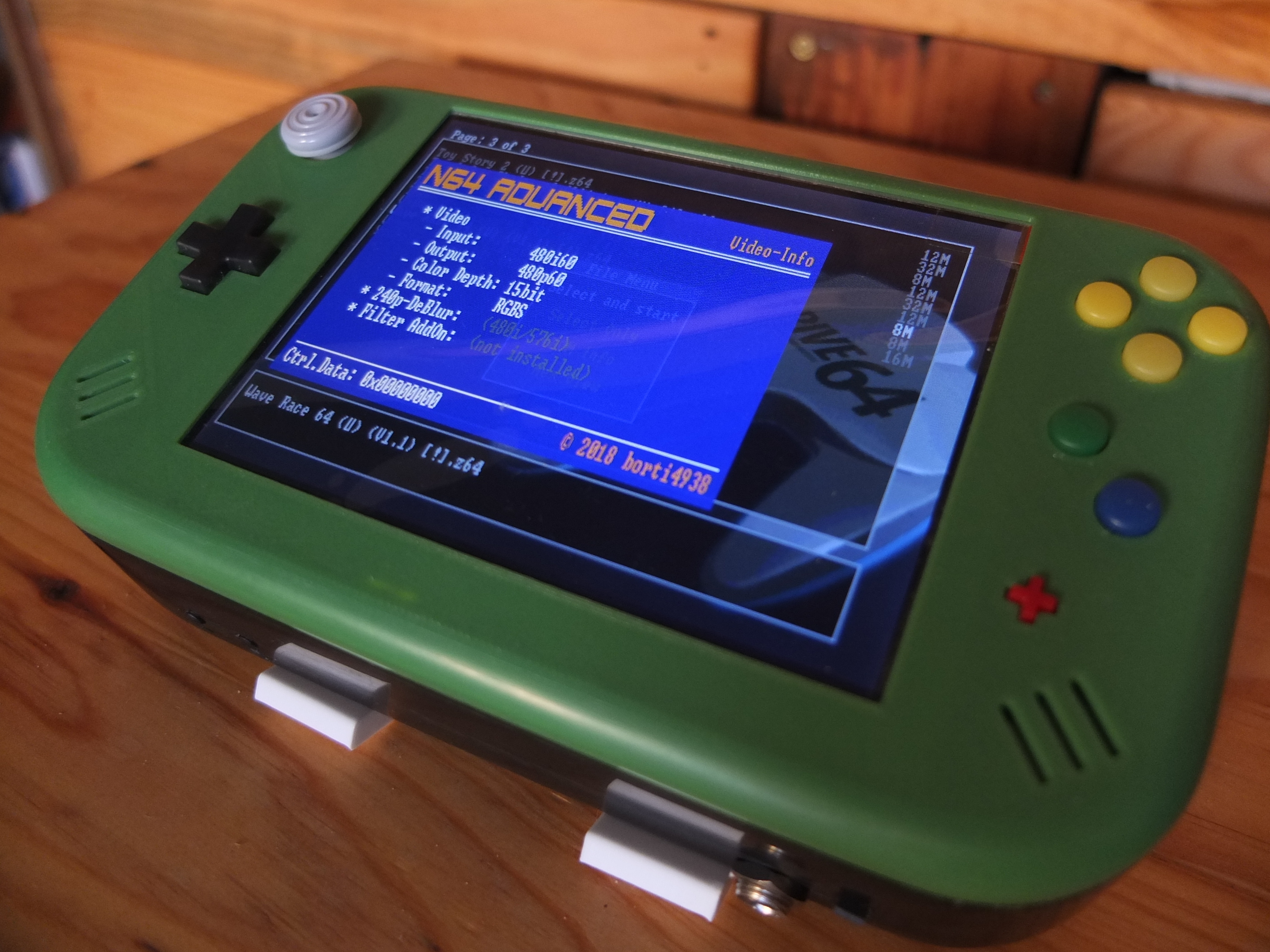

Finally! I had quite some trouble building this portable, but it's finally working & i hope it stays that way :D
Final Specs:
- Custom 3D Printed & wet sanded case
- Trimmed n64 with 90deg. bended card slot
- Memory pak, also 90deg. bended
- N64 Advanced powered VGA output (480p)
- 5" 4:3 VGA Screen (640x480)
- Everdrive64, internalized
- Custom Switch Buttons (thx @Madmorda )
- 2x 18650 2900mAh [approx 2h battery life]
- classic red board + PTH regulator
- Speaker & Headphone via PMS (thx @Gman)
- Second player adapter stolen from @Booshman
- 3DS slider via N64 stick converter [+ original n64 joystick cap]

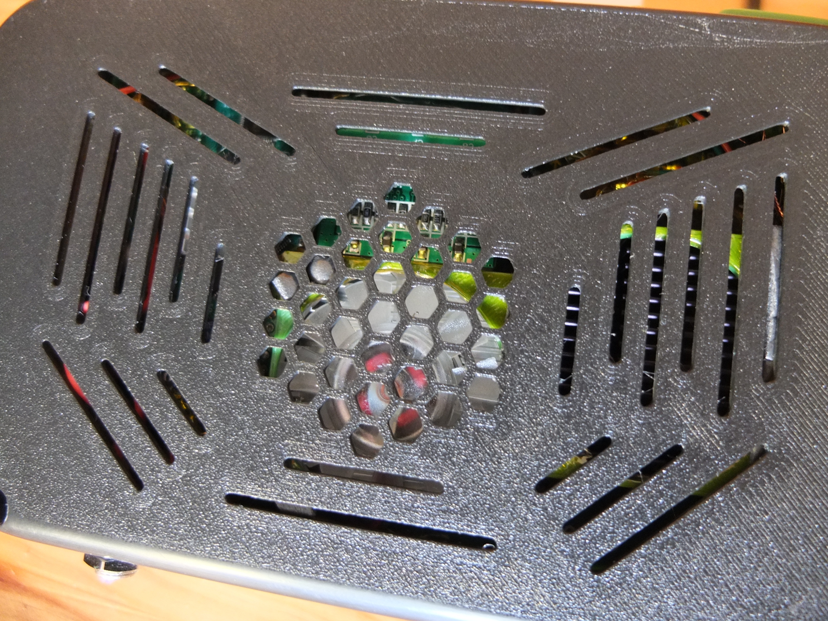

The nice N64 logo had to go in favor of some air vents...

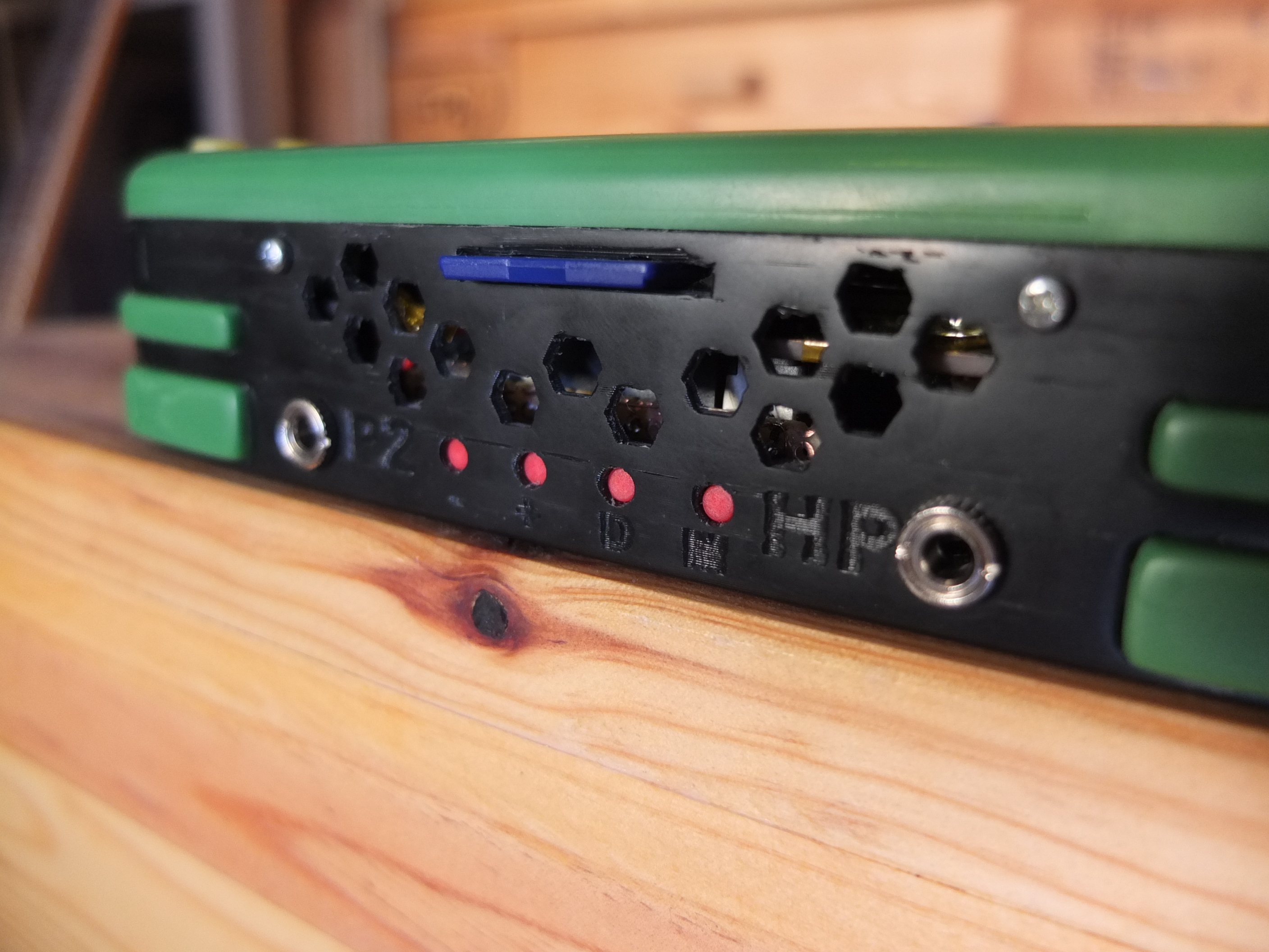

On the back are the jacks for headphones/2nd player adapter, screen controlls and everdrive SD-card slot.
No more overheating!!1

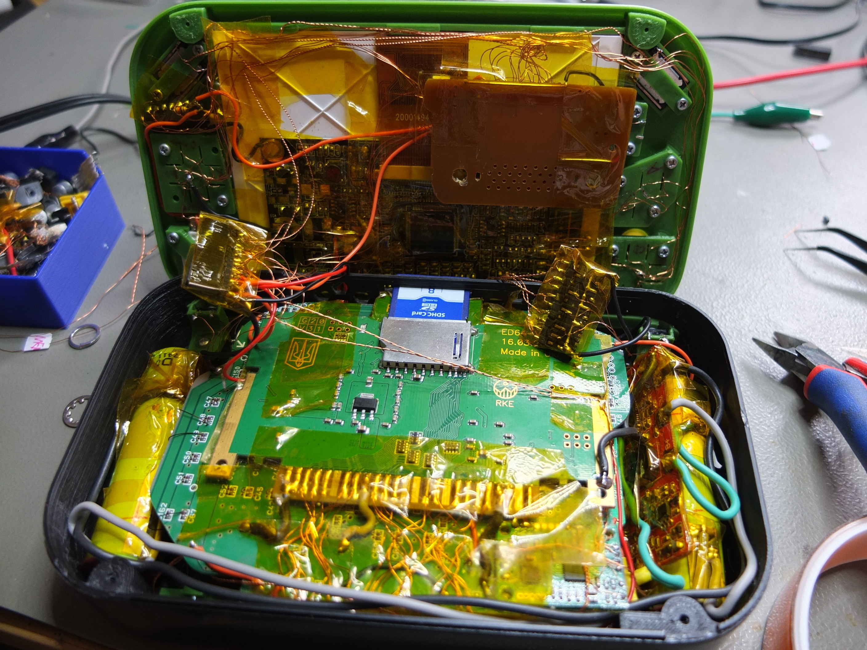

final internals aka magnetwire madness

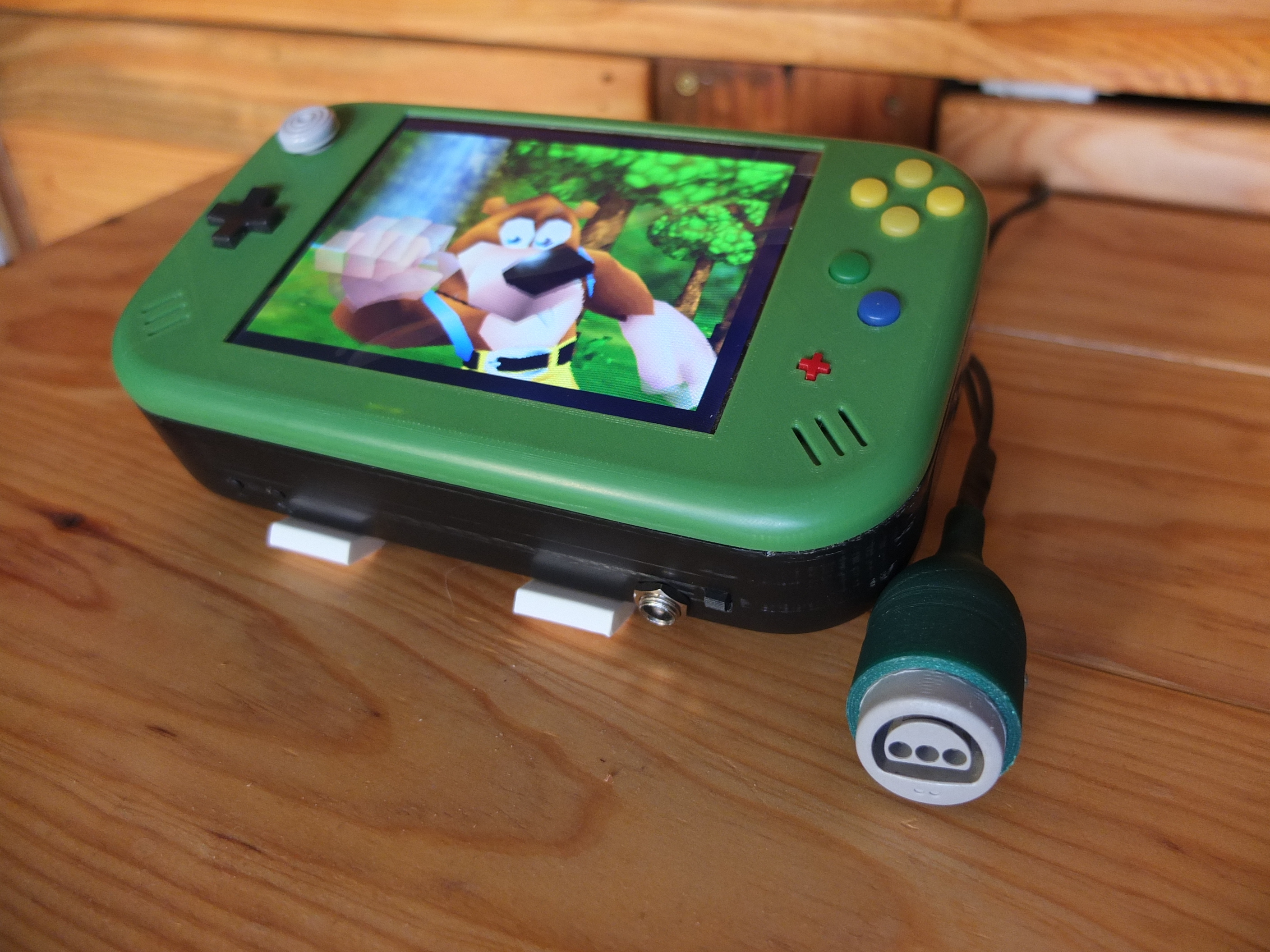

Mmmmmmmmmm delicious chamfered boxy goodness. Feelsbetterdaysman
