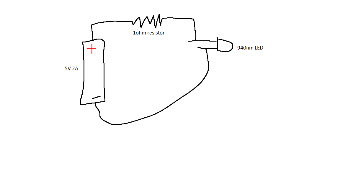

So I am using 940nm leds(IR204-A to be specific) to make a custom Wii sensor bar. I am having troubles wiring them up and am hoping I can get some assistance.
So I know that I need a resistor with the led so that it doesn't burn out. I went here https://www.digikey.ca/en/resources/conversion-calculators/conversion-calculator-led-series-resistor entered in my values and it told me that I need a 1ohm resistor. So I bought these https://www.arrow.com/en/products/cf14jt1r00/stackpole-electronics to use with it. Im using a 5v 2a power supply as my power source.
This is a bad paint drawing of my wiring.

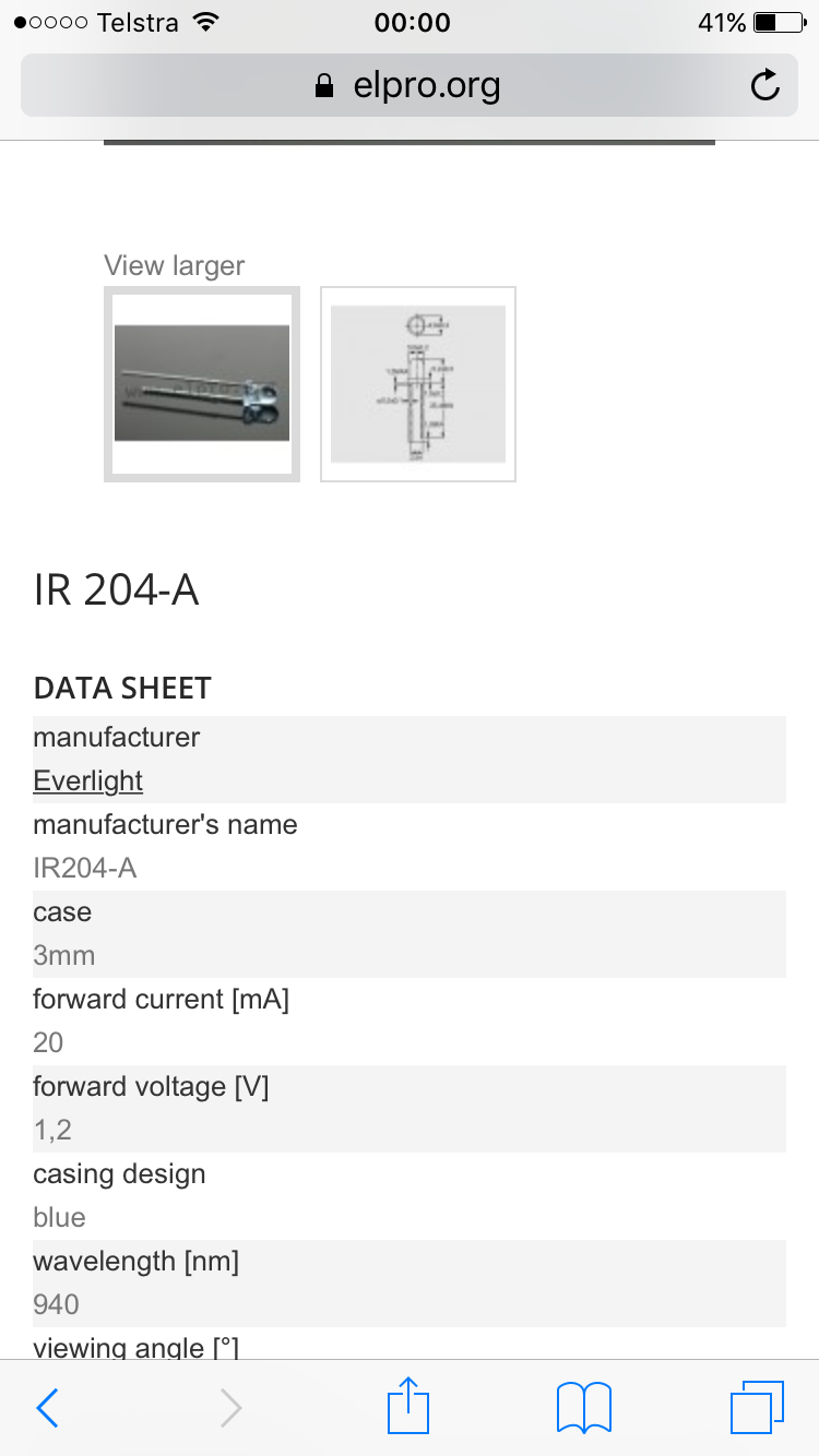

I think the issue is that the resistor is letting too much current/volts into the led killing it instantly. From reading the datasheet of the leds it seems that for 1A I can use 2.6v-4v to power it. Or for 100mA I can use 1.4v-1.8v.

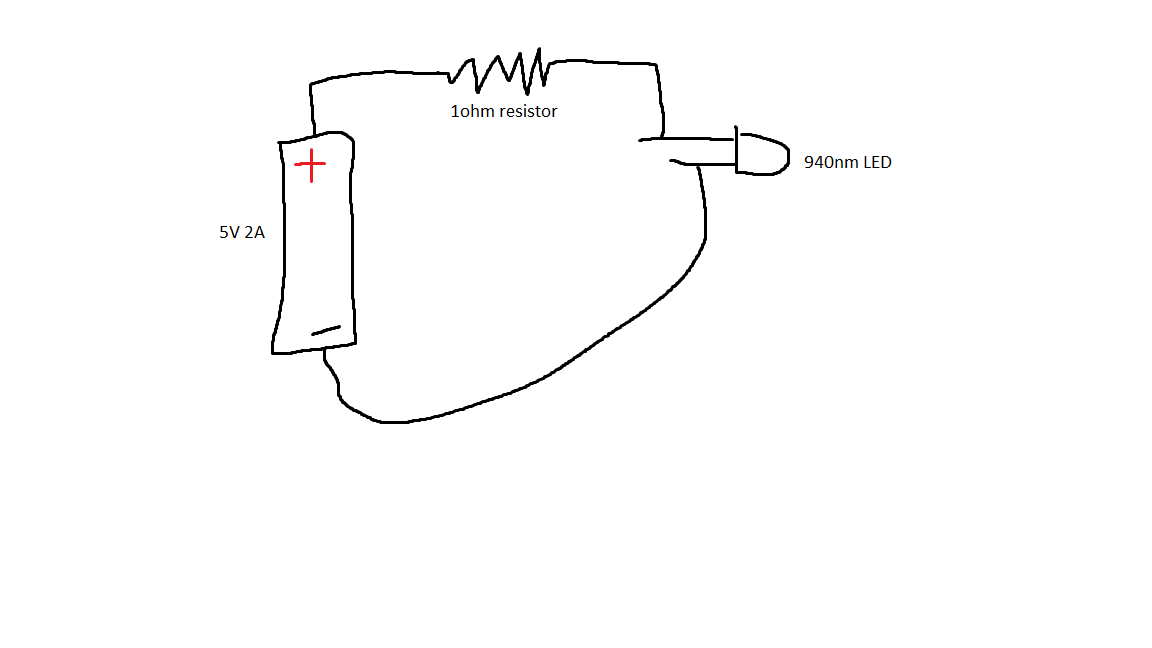

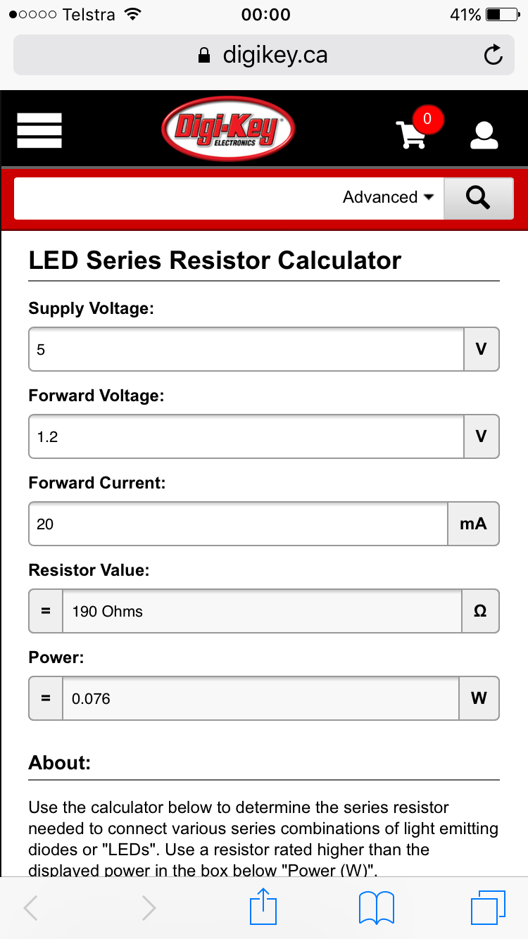

Based on a quick google, you can see that the LED requires a 190 ohm resistor in series with the power source. 1 ohm would kill your LED. NM is the wave length of the LED in nanometers.

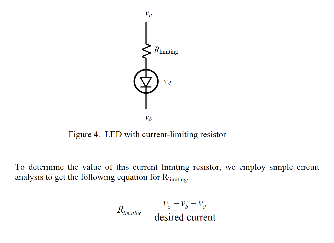

This is equation you use to find your R-limiting for an LED just plug in the values found on the data sheet where Vd is your bias voltage, Va is your initial Voltage and Vd is probably ground.
