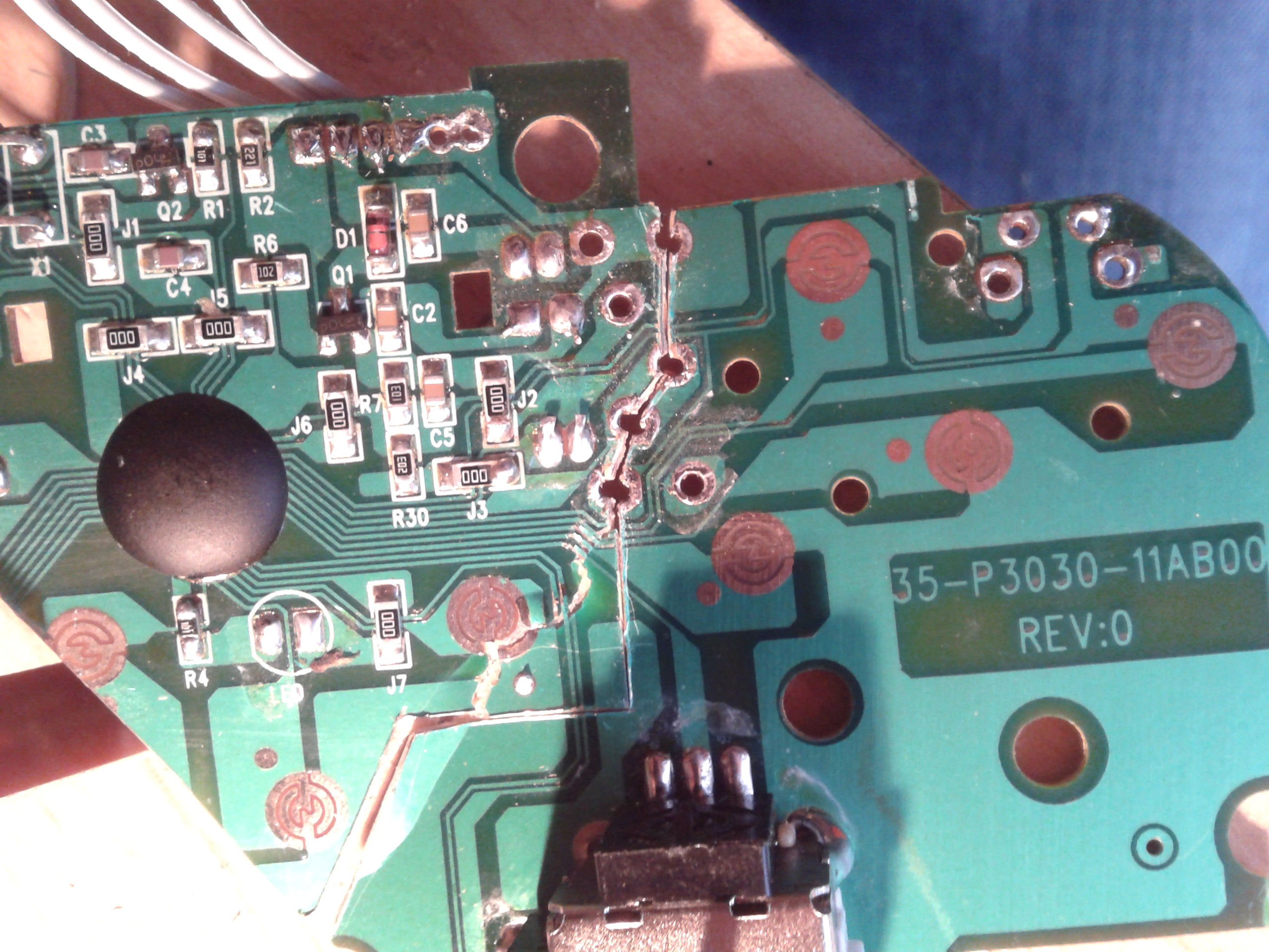

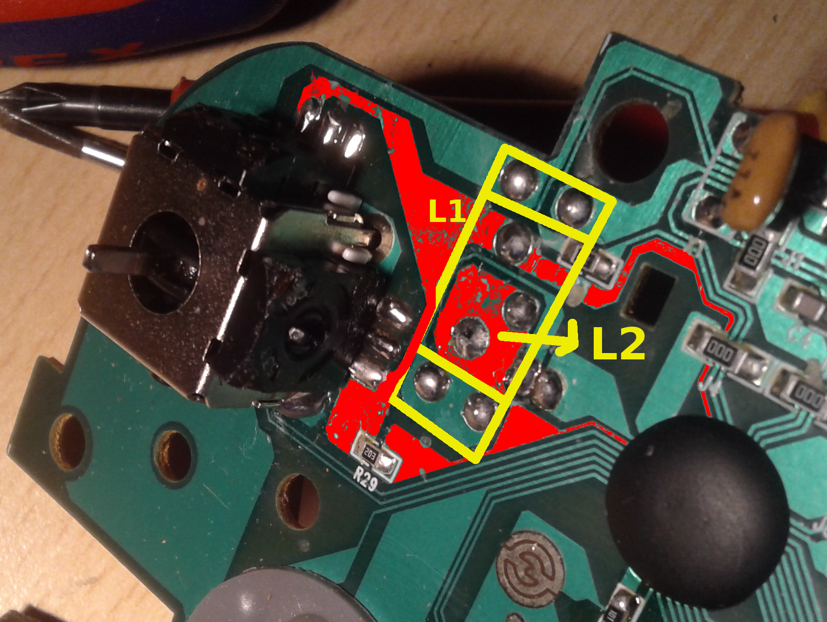

Hi,
I've digged out an old GCp project and nearly completed it... but I can't get the R/L-Triggers to work..
Here is what I got.. the red traces ares the traces, connected to the trigger-pot... the yellow outline is where the pot would normaly sit, so the lower and upper two pins, are common ground / pot-case...
But both traces connected to the pot, are also connected to the analog stick?!?.. How should it work?!.. the traces on the right side look a little different, but there it also doesn't work.. I tried zenlocs method with an BC547 - no success... also a other verson of this schematic... I even connected a potentiomenter to the two pins L1/L2 and it didn't do nothing...
I'm now thinking about removing R29 - but it has to work in this way... I just don't get it...
I hope you guys can save me, from building a whole new case... Thanks a lot!
//Edit1: Removed R29 = Analogstick stopps working.. Everything I try on L1/L2 just results in a change of the analogstick/c-stick value -.-''
