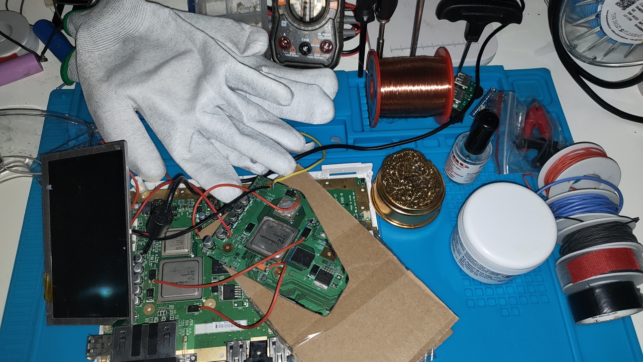

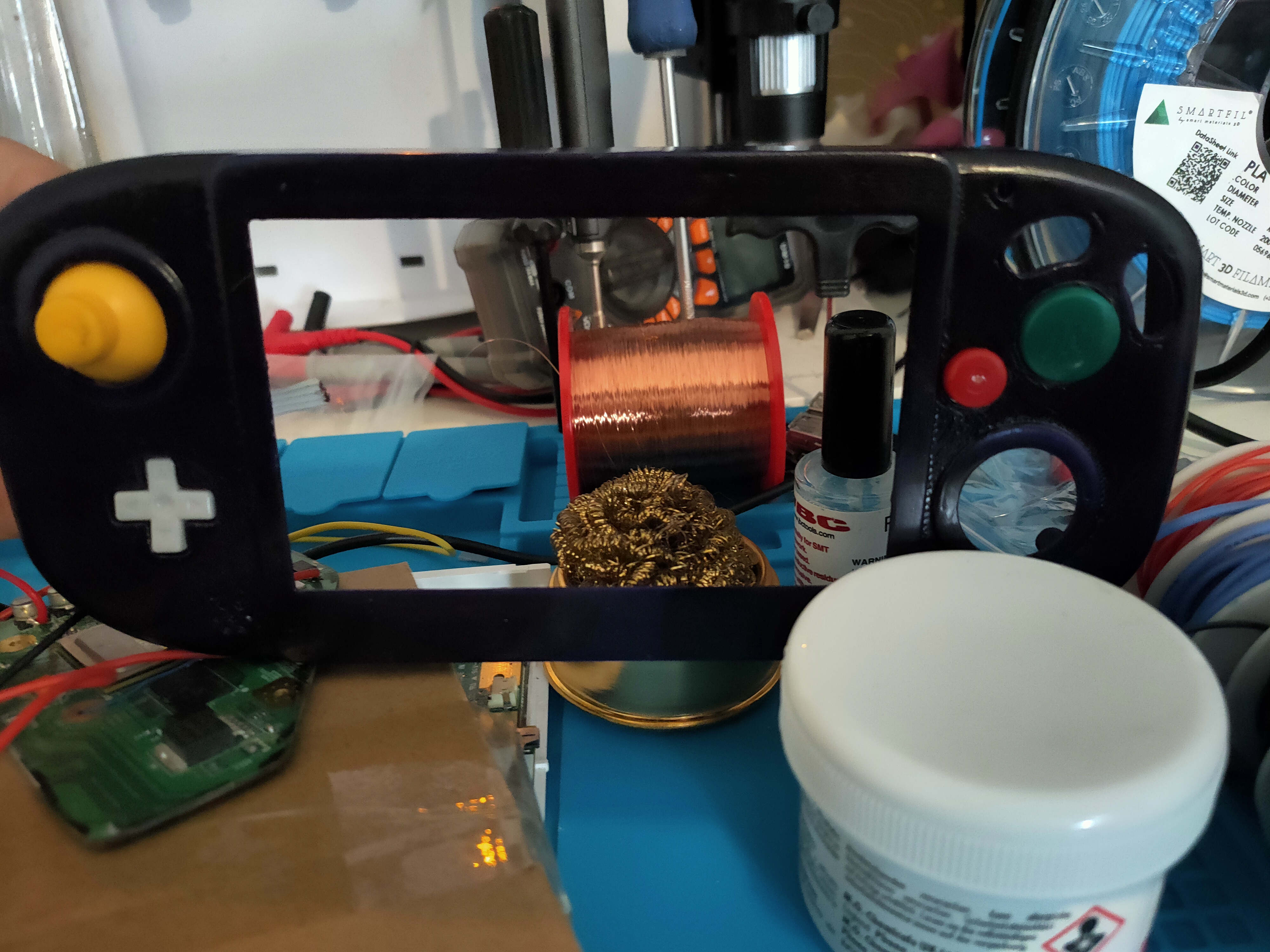

Hi guys , thats my first portable so don't be hard with me please :D , actually thats what I will use for my project :
-Amazon screen 16:9 5" ( no VGA using, for my first portable I will use composite ).
-4 layers standard trimmed wii
-Pms
-U-amp with Nintendo Switch speakers
-Gc+ 2.0
-Usb C board
-Gwii Rev 2 case ( thanks to @Gman ) and the top of the case edited to 16:9 formato (thanks to @Wesk )
-cooling system ( made with a copper sheet ,a thinn fan and some heatsinks)

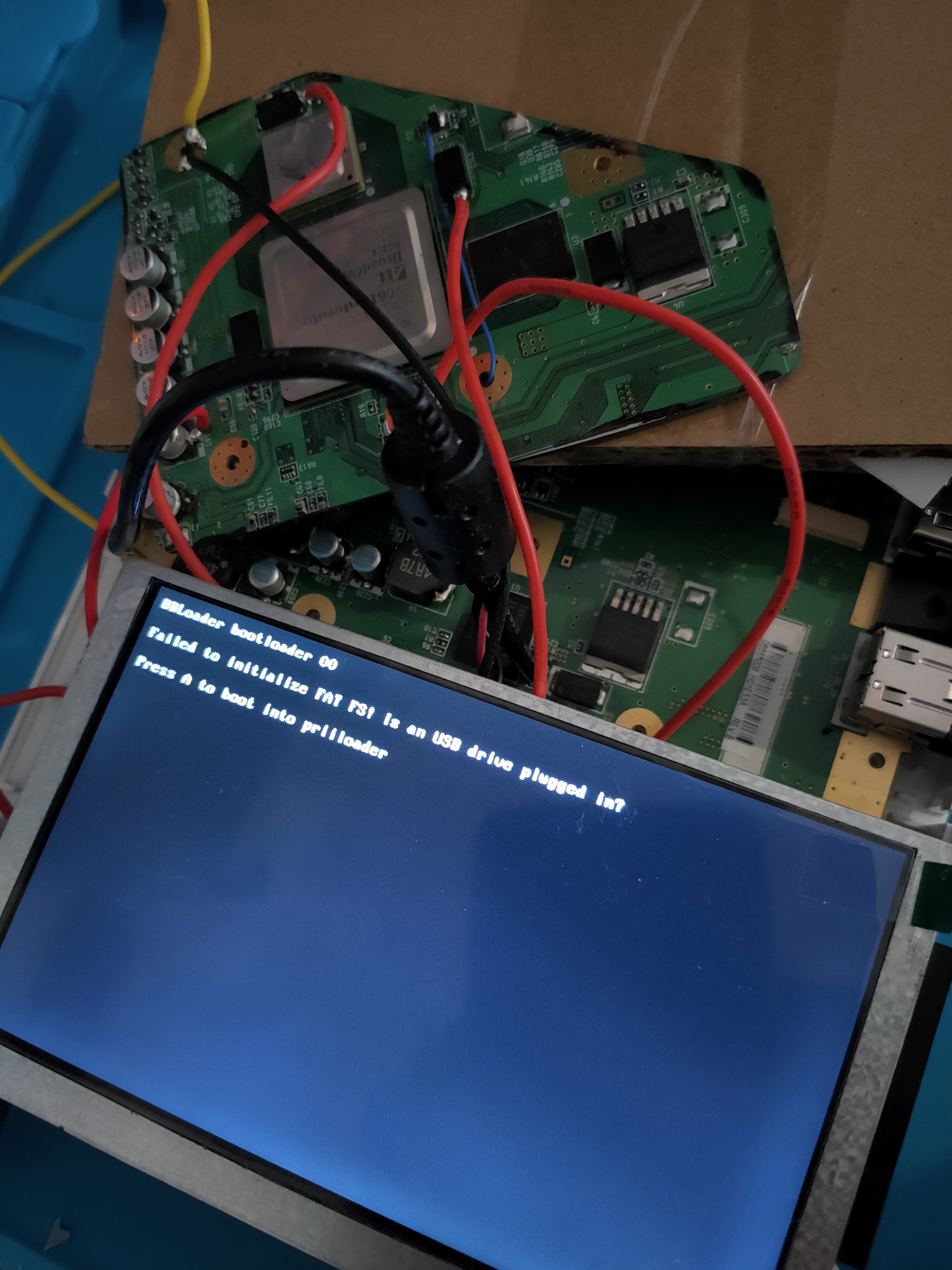

For now I have trimmed the wii, with the u10 relocation and BB installed.
I tested It wiring all the voltages to a full wii powered ON .
Bluetooth and wifi Will not be relocated as is not needed now thanks to the GC2.0
When I receive the pms and more stuff from BB ill update the post

Do you have CAD files for the GWii edited for 16:9? I've been looking for a composite 5 inch 4:3 ratio screen and have been coming up short. If not no worries!
I was looking for this kind of case for so long, thank you for the file!
I think I will modify to have the classic 4 buttons on the right, instead of the gamecube's one.
What kind of material did you use?
