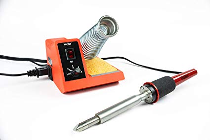

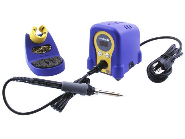

The first and most important tool you will need is a soldering iron. Many people have an old Radioshack iron that “works fine”, but for portablizing a decent iron is absolutely needed. “Buy nice, or buy twice” is a simple saying that applies heavily when delving into portablizing. A bad soldering iron is not only unreliable and difficult to use, but is a common cause of ruined boards and projects among beginners.

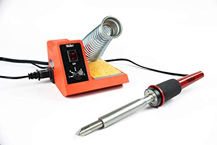

So what iron should you get? If you’re on a budget, the cheapest iron you can purchase while still getting something of good quality is the WLC-100 Weller Iron.
This generally retails on Amazon somewhere in the ballpark of $40, and is the perfect iron for anyone looking to save money on tools. Most veteran portbalizers upgrade from this eventually, but this iron will do absolutely everything you need to build a portable. If you’d like to get an even better iron than this and have a more flexible budget, then the Hakko FX888D is an excellent choice.

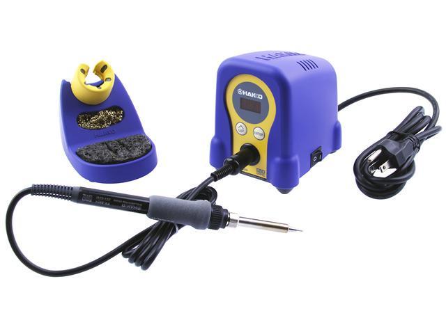

The downside is that this Fisher-Price-esque iron will run you around $100, so if you don’t think you’ll be in electronics for the long haul then sticking with the Weller is probably the best option for you.
If for some reason you can’t get your hands on either of these irons, then be sure to choose an iron that does *not* plug into the wall directly from the handle. These irons have been given the title of “lightning rods”, as that’s about all they’re good for. Also be sure to get an iron with temperature control, as ones without this feature tend to not get hot enough to handle the intensive soldering needed to build a portable.

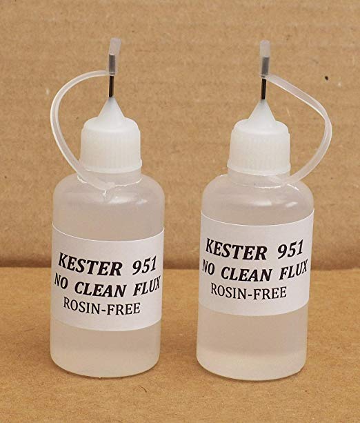

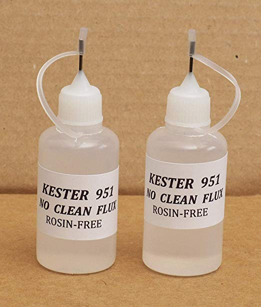

Flux is a crucial ingredient for solder, but you can also buy it separately. Flux essentially acts as magic solder juice, it helps solder to flow where you want it by placing it on the component you are trying to solder. Flux comes in many forms: liquid, paste, and pen are the main ones. Kester 951 flux is highly recommended, as it is inexpensive, easy to use, and easy to clean off. Flux is important for a lot of the finer soldering work required for working with home consoles.

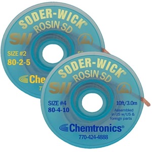

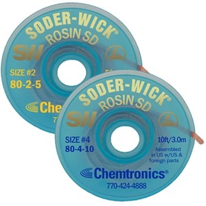

The last soldering related item that you should get your hands on is solder wick. Solder wick acts as the undo button when soldering, as it allows you to to soak up any solder that you no longer want on the board. You’re inevitably going to need to remove some solder from some part of your project, so getting some solder wick beforehand will save you from waiting for it down the line. There are other methods of desoldering, but wick tends to be the most versatile option. Solder suckers are a tool of the Devil. With wick, so long as you have flux the cheap stuff will do a good enough job, though of course the pricier stuff will be easier to use and work better.

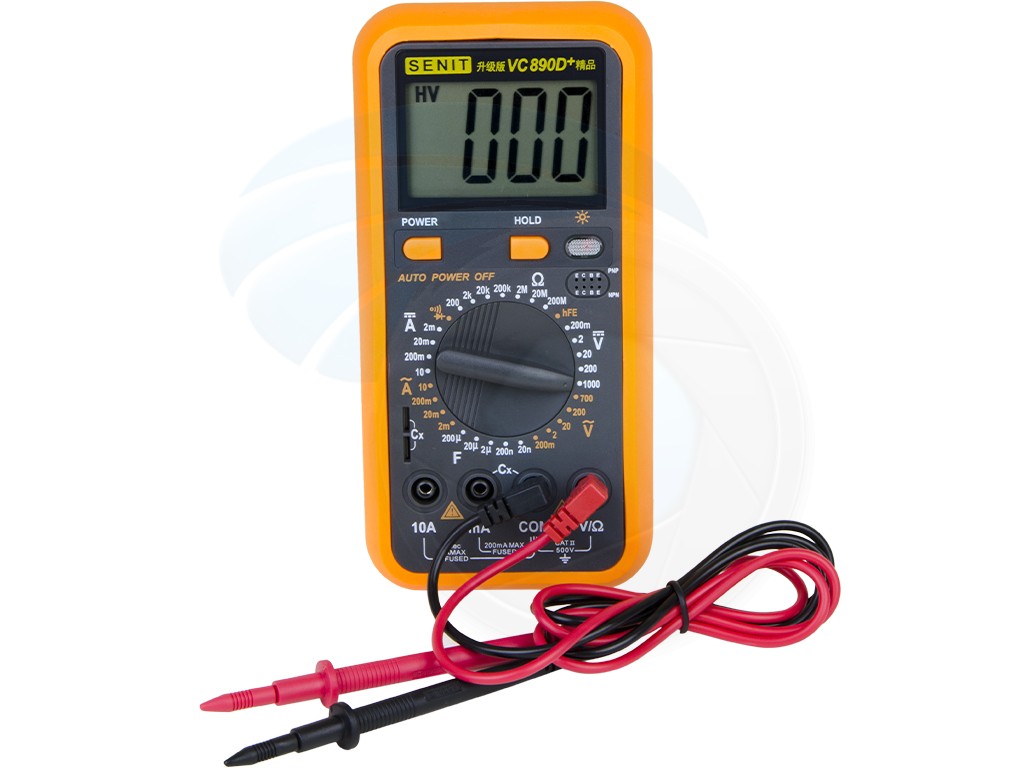

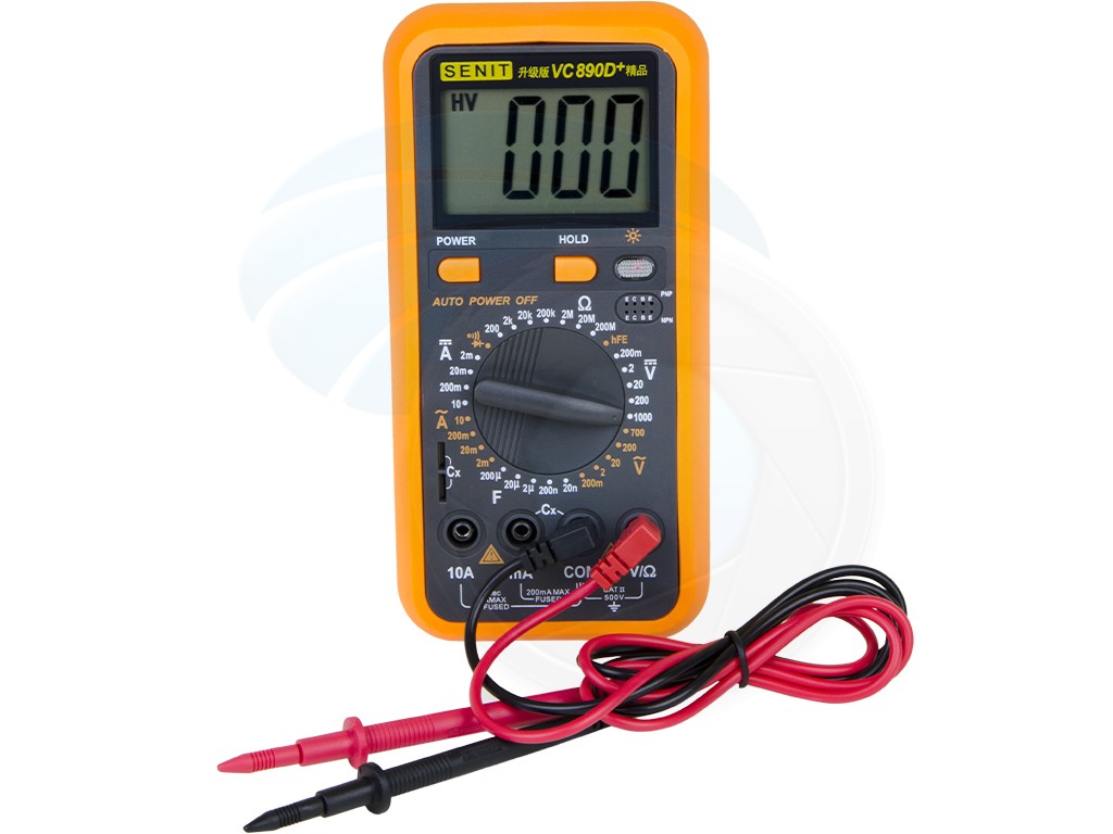

Another tool you will need is a multimeter. Multimeters are a critical part of debugging and testing, and you will absolutely need one for this undertaking. Unlike some of the other tools though, you can definitely get away with using a cheap one for this project. Just be sure that your meter is capable of measuring voltage and resistance to a decent accuracy, and you’ll be good to go! Fully fleshed out multimeters are neat, and useful for more involved projects, but at this level you can certainly get away with a cheap one.

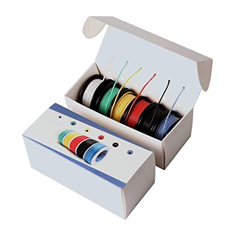

Wire is another thing you’re going to need, and you will need a few different types. The first size you will need is 22 gauge wire.
This wire is for all the heavy duty power lines needed for the portable, for things like voltage wiring and batteries. I recommend stranded wire, as solid core wire can be break without you ever knowing, and is an absolute nightmare to troubleshoot. I only had this happen to me once, but since then I have avoided solid core wires of this size at all costs. Another wire gauge you will need is 34 or 38 gauge magnet wire.
This is an extremely thin wire size, used for wiring to console vias, data lines, and a handful of other applications. The last variety of wire you will need is 30 gauge wire, and wrapping wire is recommended for this. Wrapping wire holds its shape nicely, and is relatively easy to strip and use. This wire will be used for some of the odds and ends, for things where using 34-38 gauge wire is too thin and 22 gauge too clunky.
Beyond these wire types, if you have a type of wire you are particularly fond of that’s between 22 and 38 gauge then feel free to use it! You can never have too many different kinds of wire.

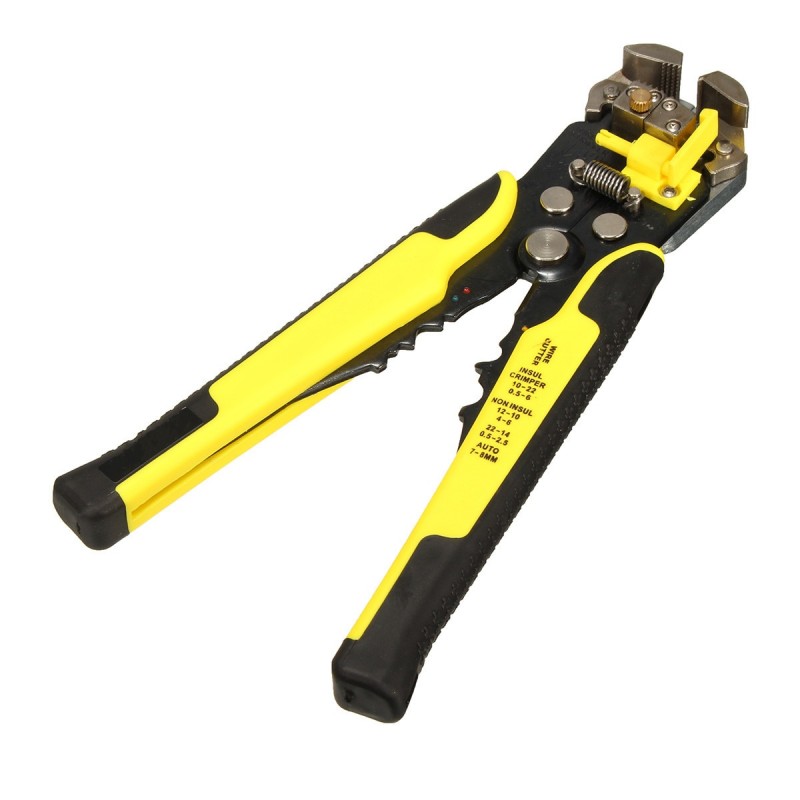

For your wire, you will want a set of wire strippers. You can go with high quality or low, but please don’t use your teeth. 0/10 dentists recommend using your teeth to strip wire.

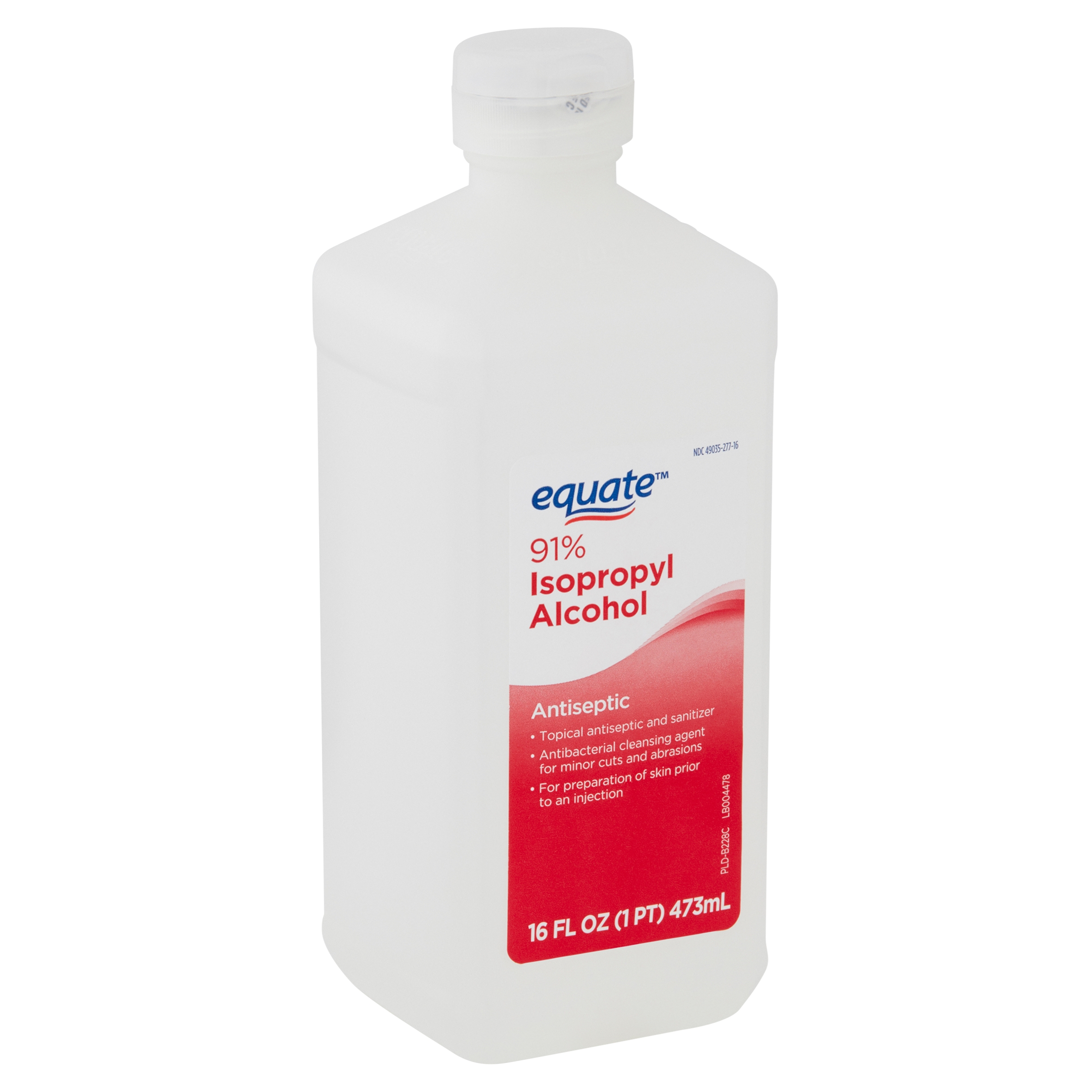

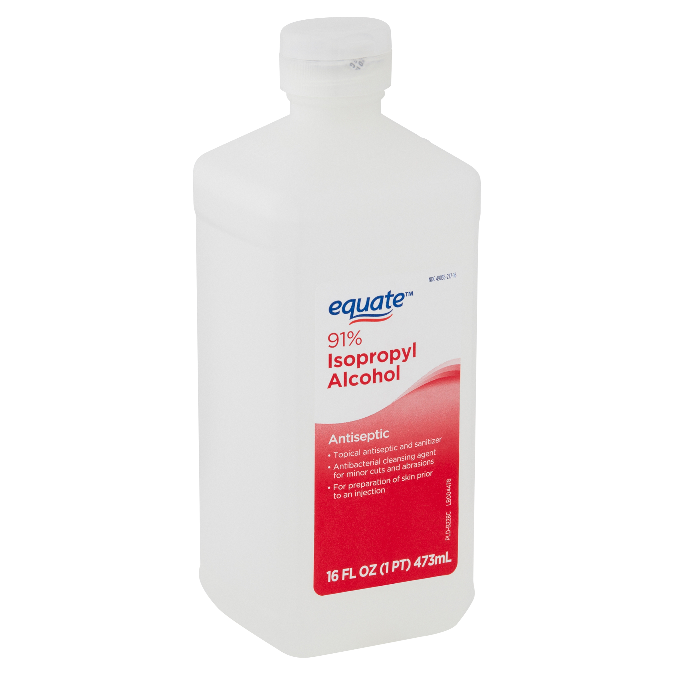

Another important material for this job is Isopropyl alcohol. You can find this in the pharmacy section of most stores for pretty cheap, and it has a variety of handy uses. Most importantly, it is used for cleaning circuit boards. It also does a really good job of loosening hot glue, should you ever need to undo a glue job.

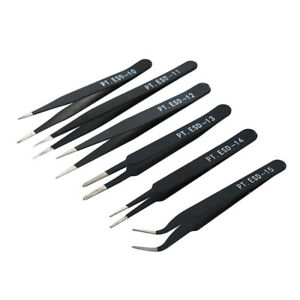

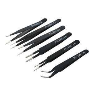

Tweezers are amazing for holding wires and navigating small components into place. They’ll keep you from singing your fingers when tinning wires, as well as help hold things steady that you never could with your fingers. I recommend purchasing a set of soldering tweezers, as they are fairly inexpensive and the variety is very nice to have.

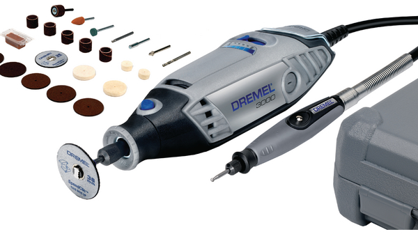

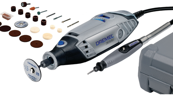

For trimming boards, a Dremel is highly recommended. Any quality rotary tool should work, you just want something that can make a clean cut. Diamond cutting wheels work the best.

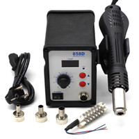

You may also want a hot air reflow station for building a portable. While it definitely isn't required for a portable, it can be very useful for things like the U10 relocation. It will also be needed if you decide to venture into other things like PCB assembly.

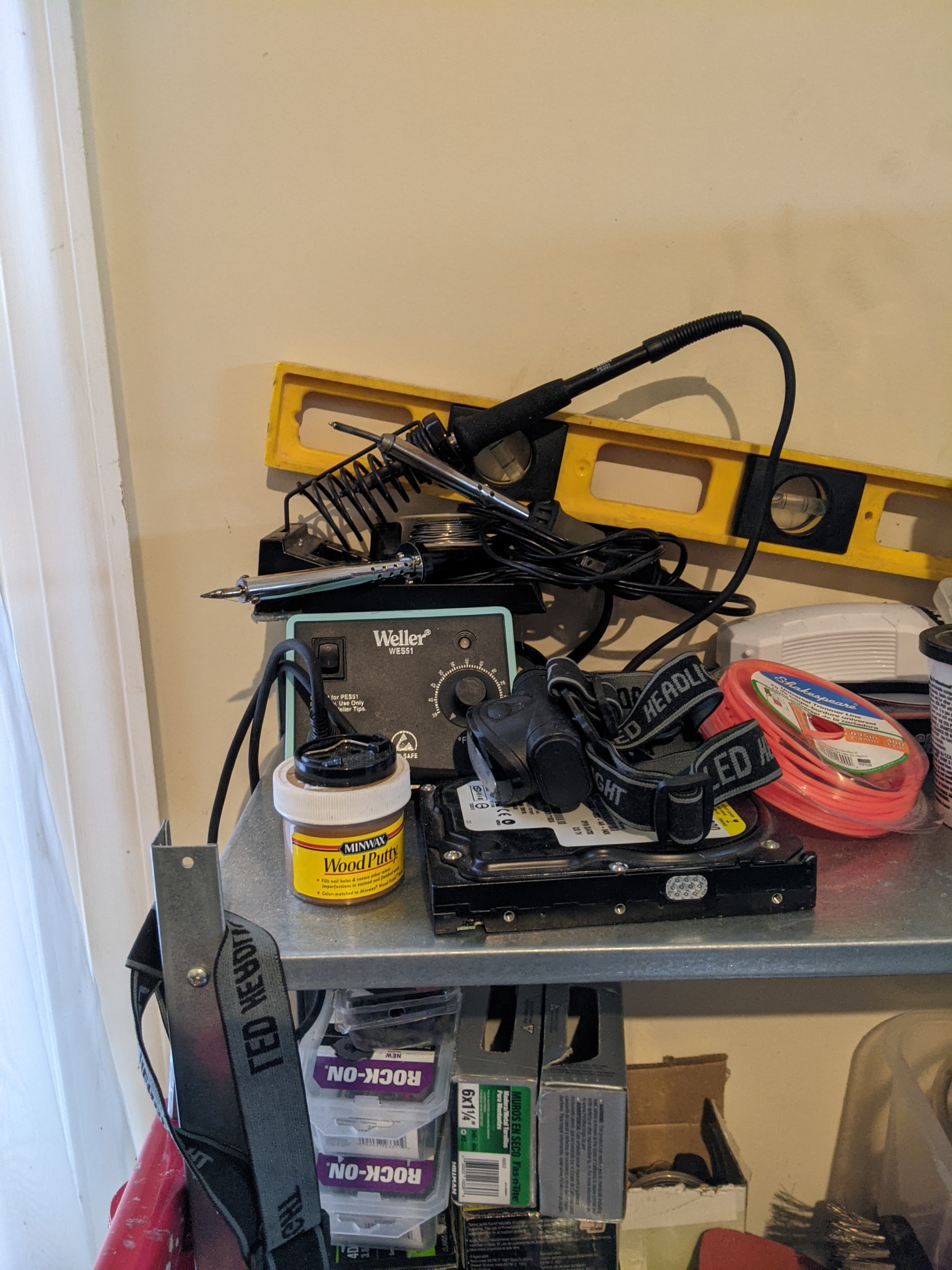

Well that's awesome to hear cuz my dad already owns a lot of the stuff listed due to his job. I already own a weller (pic related) and most of the "expensive" things are mostly covered. I do need to check what type of solder I have and need to buy flux, but that shouldn't be much of an issue. I also own isopropyl, tweezers, a multimeter, and wire strippers. I just need to buy wires, a wii, Kapton tape, flux, "maybe" solder (I own some but I don't know if they're from a reputable brand, gonna have to check), solder wick, a dremel, batteries, a case, some pcbs, and the hot air station. I'm probably covered for the case because my friend owns a 3D printer and I think I could ask around for a dremel. I'll have to search around for a hot air station, but that shouldn't be too bad either. I just have to wait a little to get enough money to do this lol. Thanks a lot btw, this really helps a lot!
