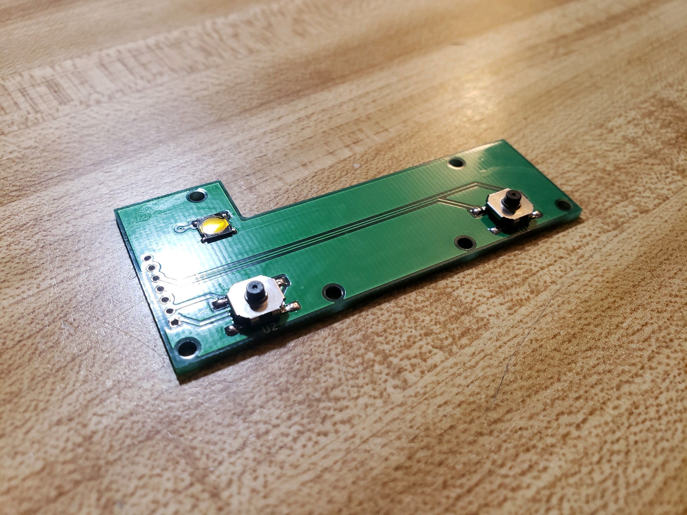

That particular tact was only available on a couple of European sites. We bought the entire stock of these tacts that were available, and are working on getting them ready to sell on the BitBuilt store.

it is rarely impossible for me to buy those tact from bitbuilt store because of the shipment, so can you give me the model number of this tact switch? maybe i can find it on chinese webstore

https://en.maritex.com.pl/product/show/44634.html
They are these ones. If you find them elsewhere please let me know (even though I am the one who bought the entire stock lol)
tons of thanks for you, if i find any, i will tell you. but i have a question :is "c,c " pin of this tact switch internal connected or not ? i think it shoud be internal disconnected

IIRC C is Common, which is shared ground. They're probably internally connected.

Yes, this is correct. This switch connects A to C and B to C when the button is pressed (can't remember which one first, but it's in the datasheet)

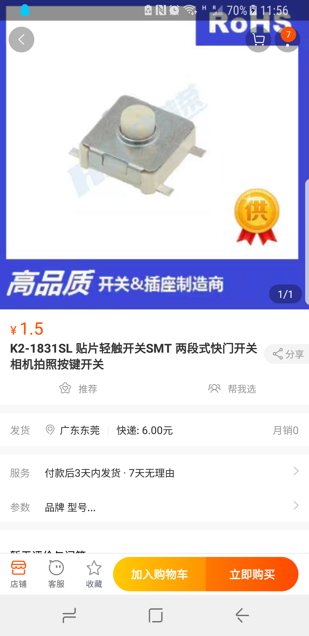

this is nearly same type dual tact switch on taobao webstore
Oh damn that looks nice. I will send you the custom firmware in a bit.
