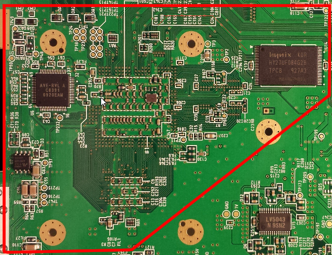

Hey there! I'm finally getting around to putting together the G-boy and am a little worried I trimmed the Wii board too far.
In the attached image, the red outline shows the OMGWTF trim with the blue line showing what I did on the top side.
I went straight through the center of the 3 "DA_" components circled in pink. The G-boy trim is very similar/ slightly different than this, but I noticed that these 3 components are still intact in later steps of the G-boy guide. Nothing appears to get wired to them directly so I'm uncertain whether they are used or needed in any capacity.
Am I still okay to proceed or do I need a new Wii board? Thanks in advance for any advice!
Those three components do not matter, but it looks like you sliced through your NAND traces. Here's a rough outline of said traces (thin red lines toward the top, sorry for MS Paint quality):
2022_05_06_13_46_45_The_Definitive_Wii_Trimming_Guide_BitBuilt_Giving_Life_to_Old_Consoles.png
It is possible to rewire these traces, but it's not the easiest task in the world. Here's what a similar repair looks like (Thanks @SparkleBear for the resources lmao):
index.php
index.php
This is extremely helpful, thank you so much!
I will check again when I get home but am pretty confident I indeed did slice through those traces.
It's just those 6 locations that are critical to be spliced? I can definitely handle that. I'll try to provide more updates on this as well as final results as I go along. Thank you again.

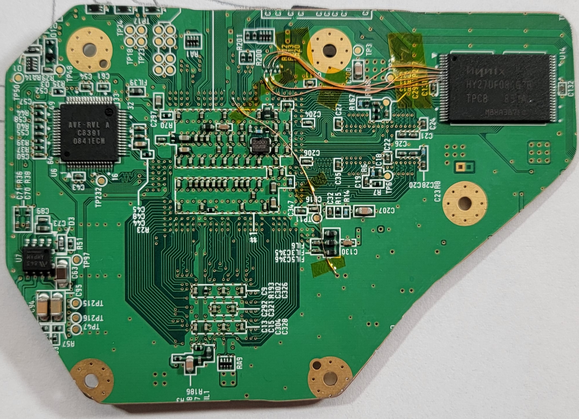

Update:
Thanks to CrazyGadget for providing exactly what I needed within seconds of my original post. With that info I was able to determine which NAND traces I had damaged using a multimeter (there were 5 in total). I reestablished each discontinuous trace on my board with fine enamel-coated copper wire as shown in the attached image. Note that the single wire in the middle of the board is part of U10 relocation and unrelated to this issue.
I also included an image of the mental map I made after troubleshooting with the meter that I followed while doing the solder job. Disclaimer that making these connections can be extremely challenging depending on your quality of tools and experience. I definitely struggled on a few solder joints here!
All new connections appear to be good after a final meter test, but I have yet to assemble the full G-boy, so I intend to update again when I got to that point.
Cheers all!
