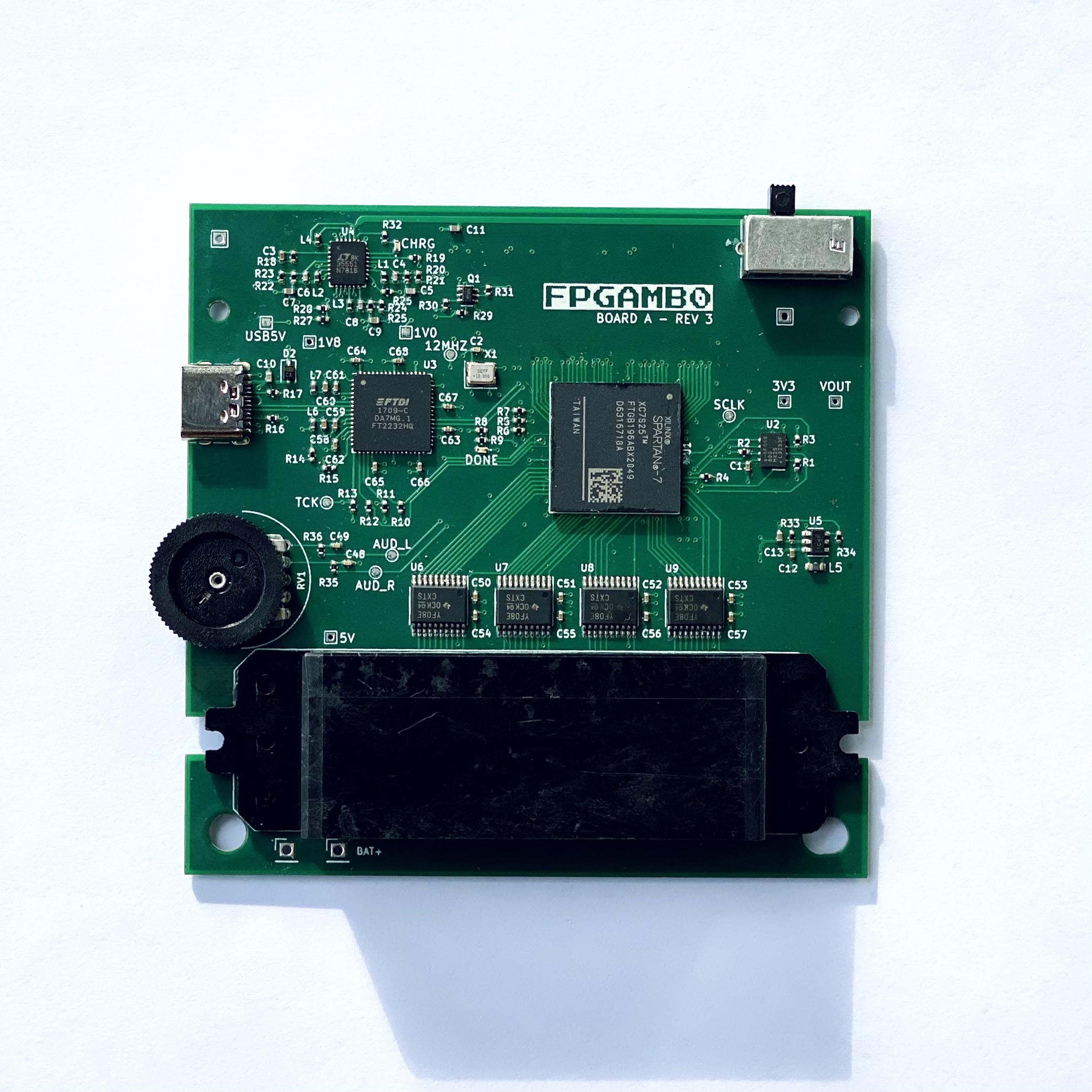

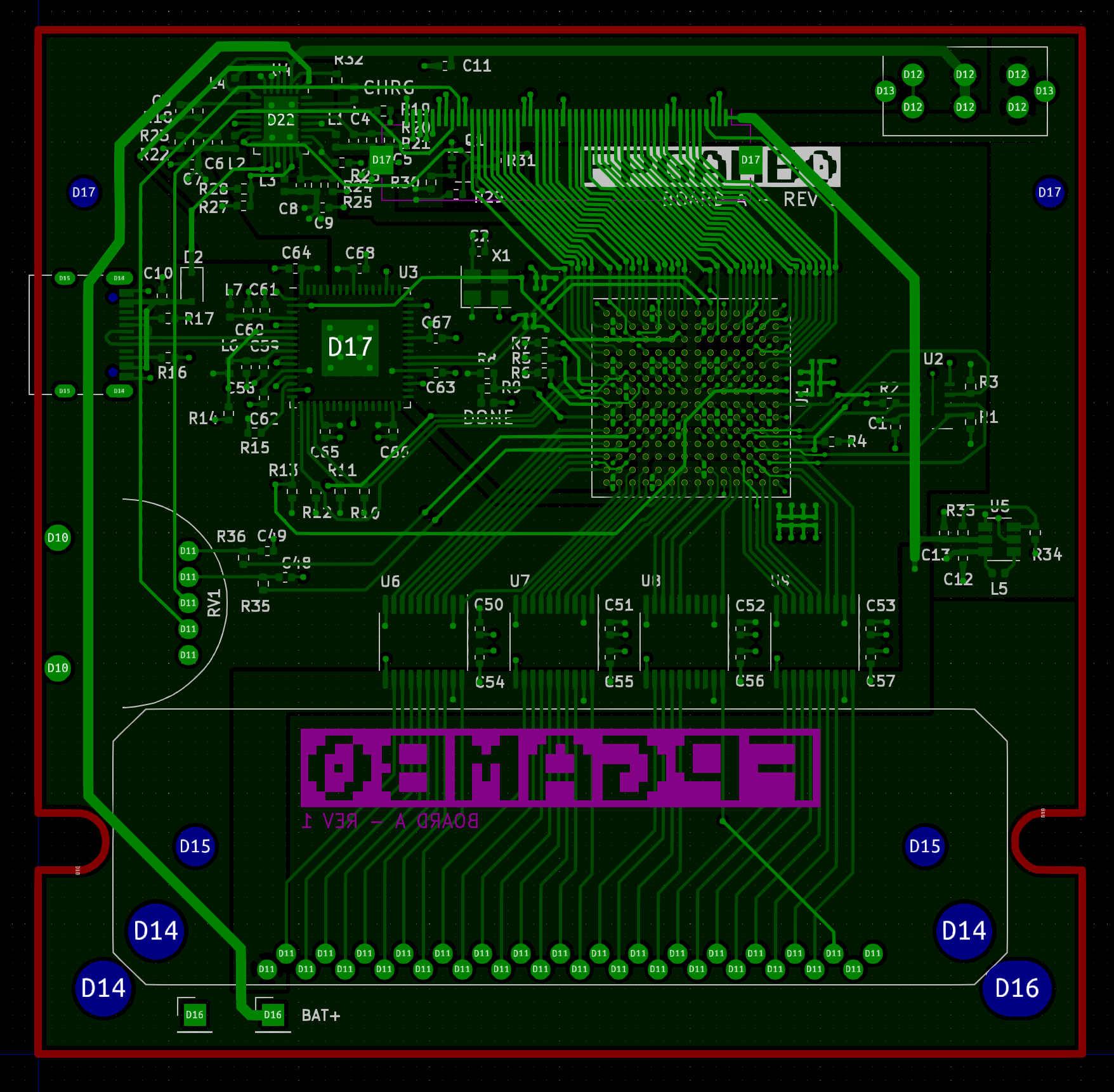

So, I first went and designed an equivalent to the original Gameboy's CPU board featuring a Xilinx Spartan 7 FPGA, an USB-C connector, and of course a cartridge interface:

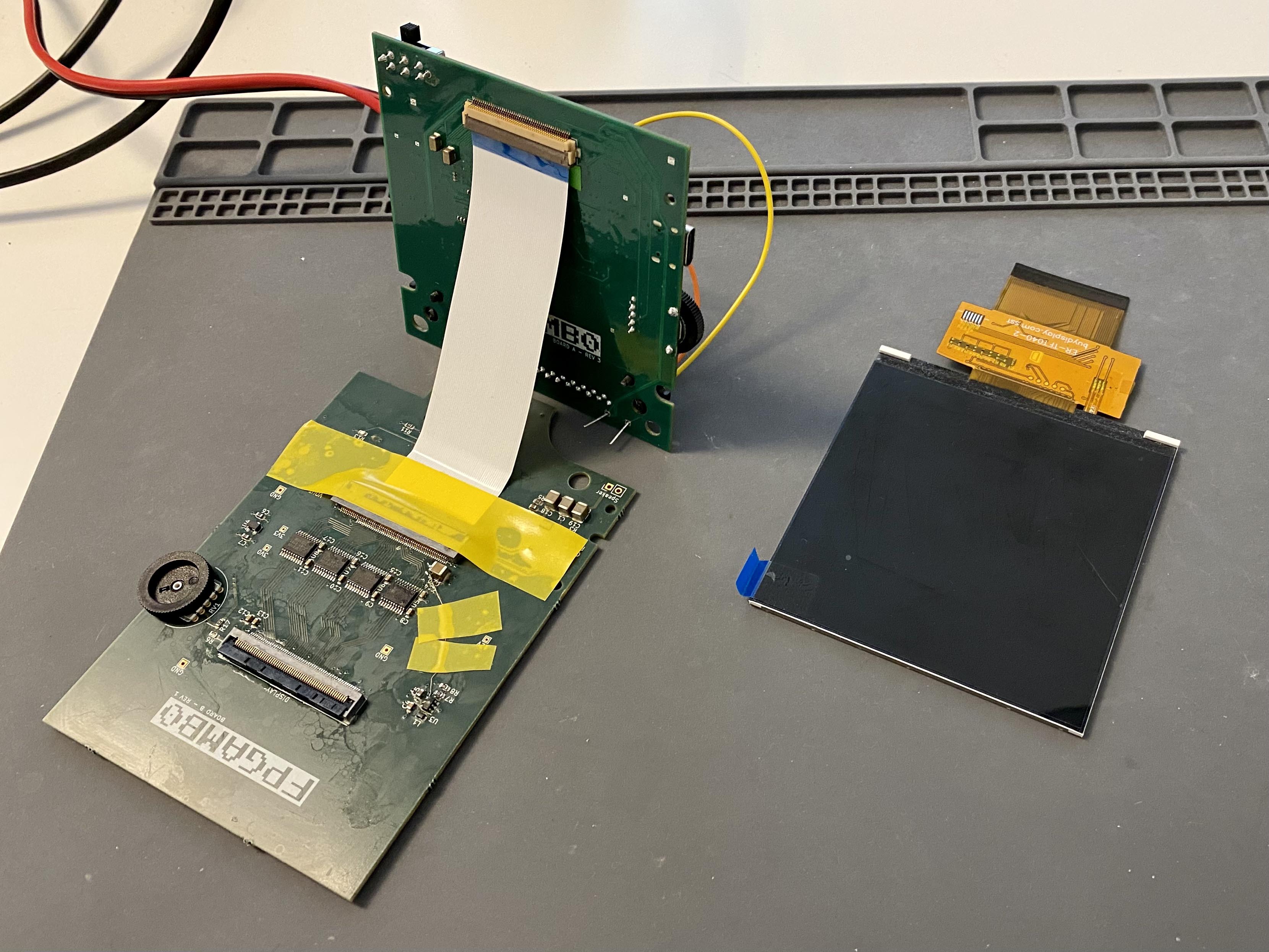

I then added a second board that will be responsible for video and audio output as well as button inputs:

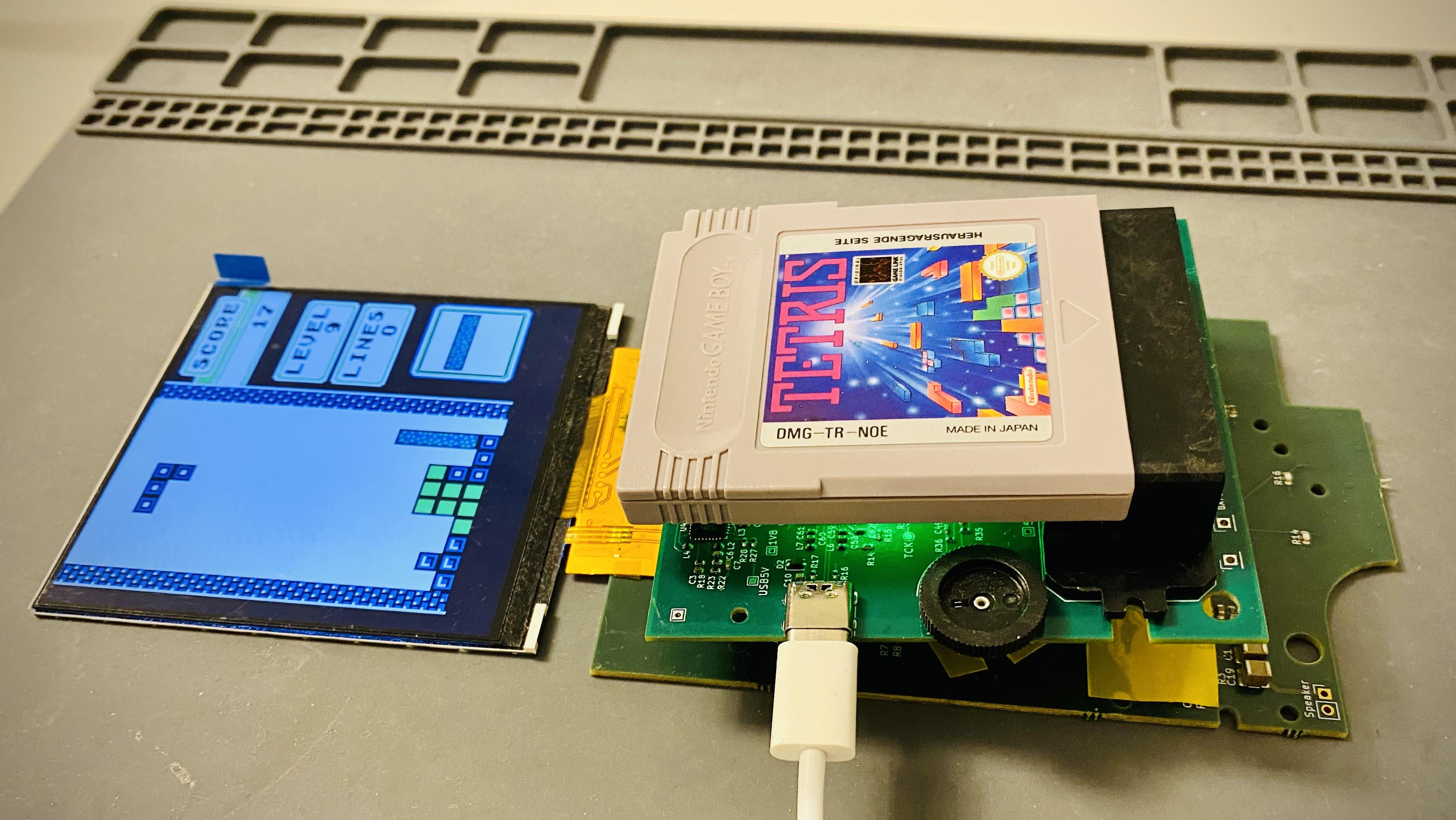

Both boards in action running Tetris from cartridge:
The Gameboy implementation that I used is not mine - it's called VerilogBoy and works very well so far.
