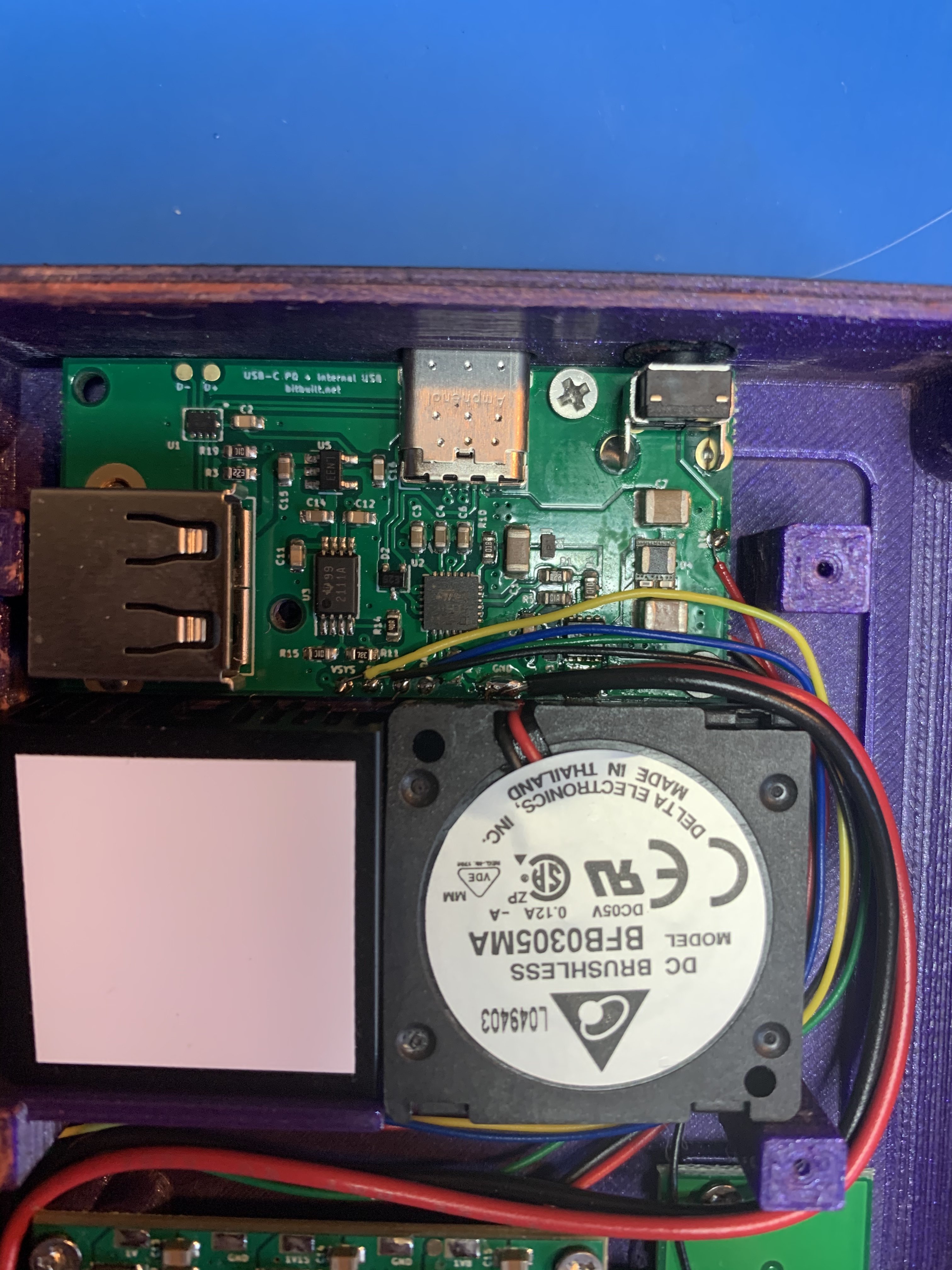

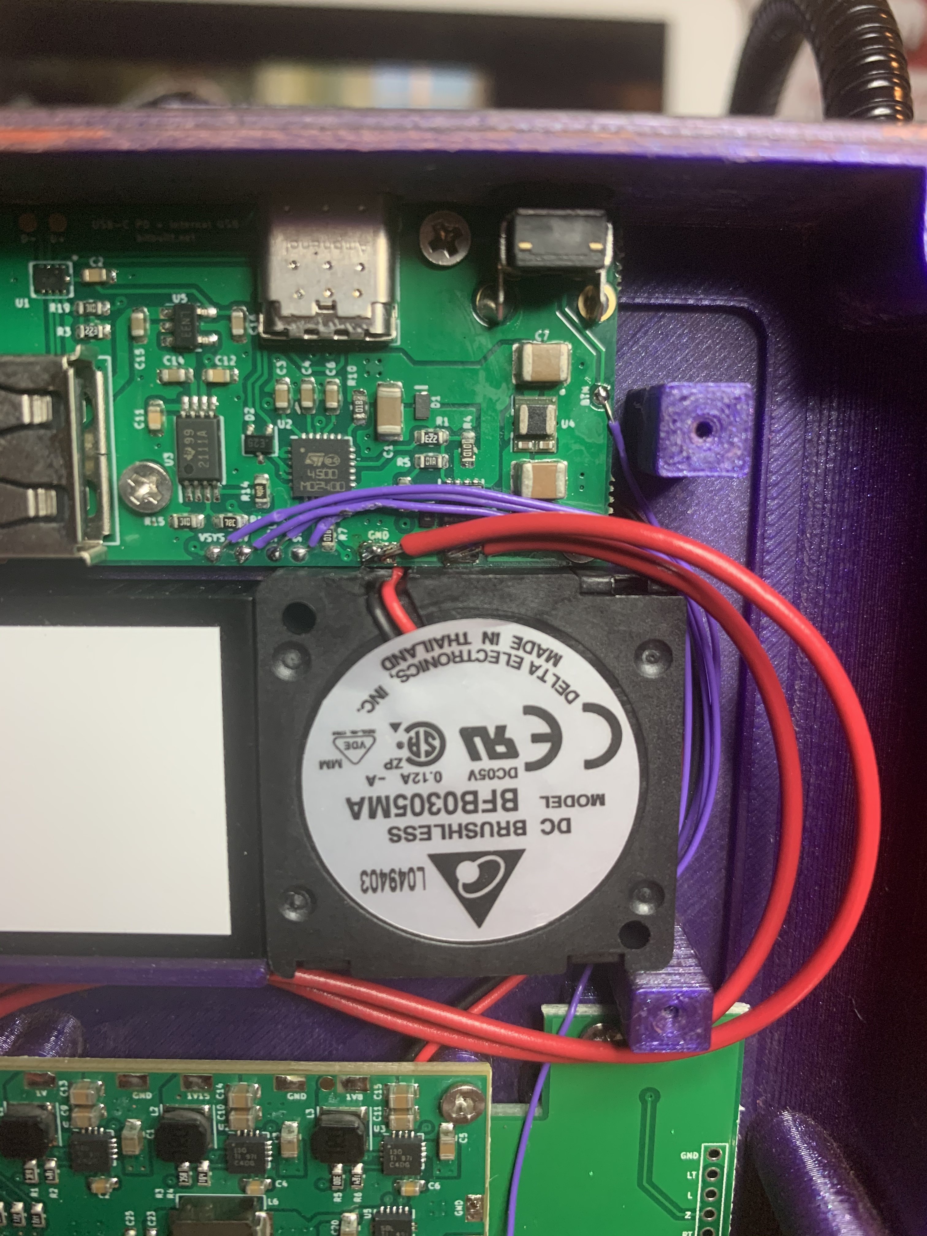

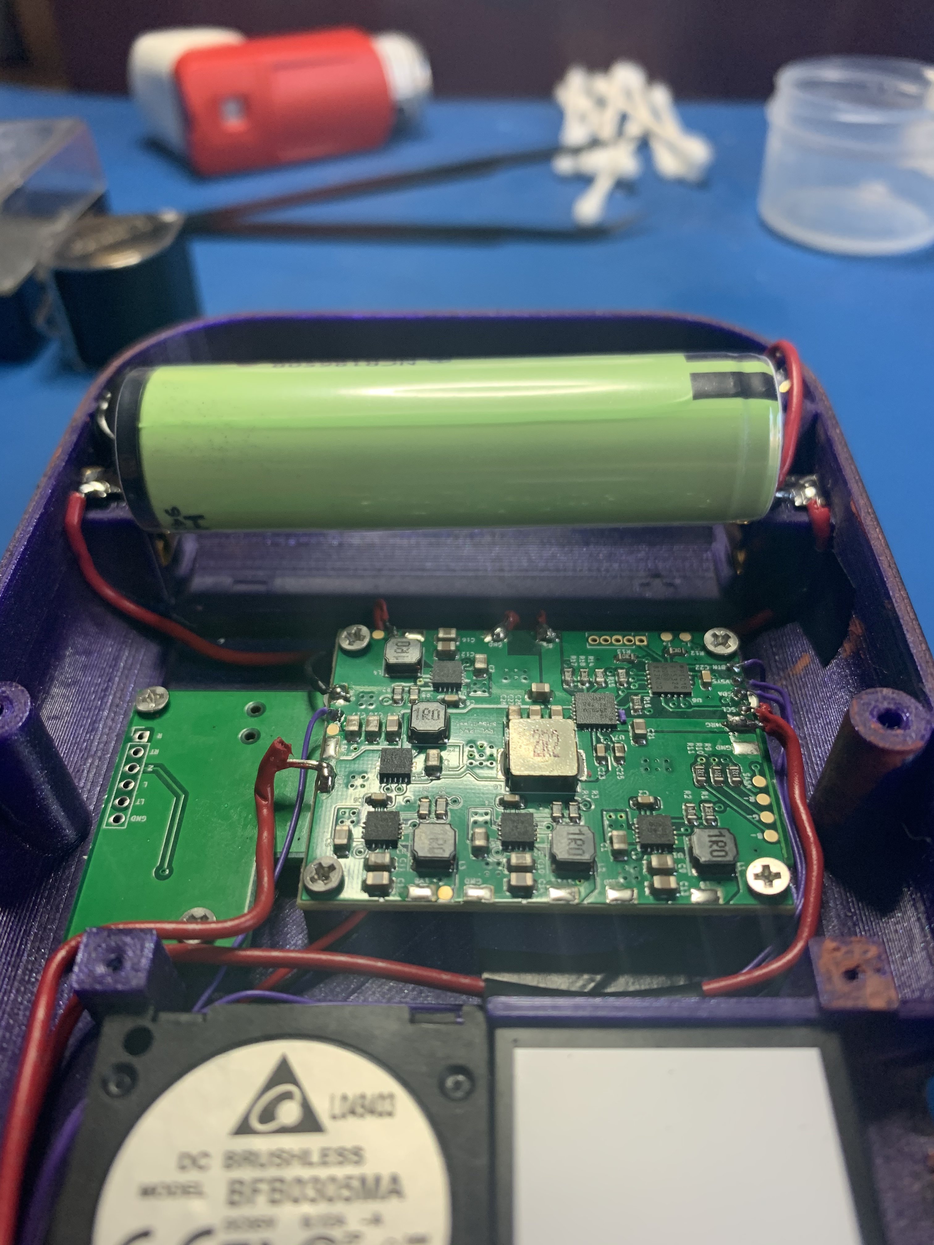

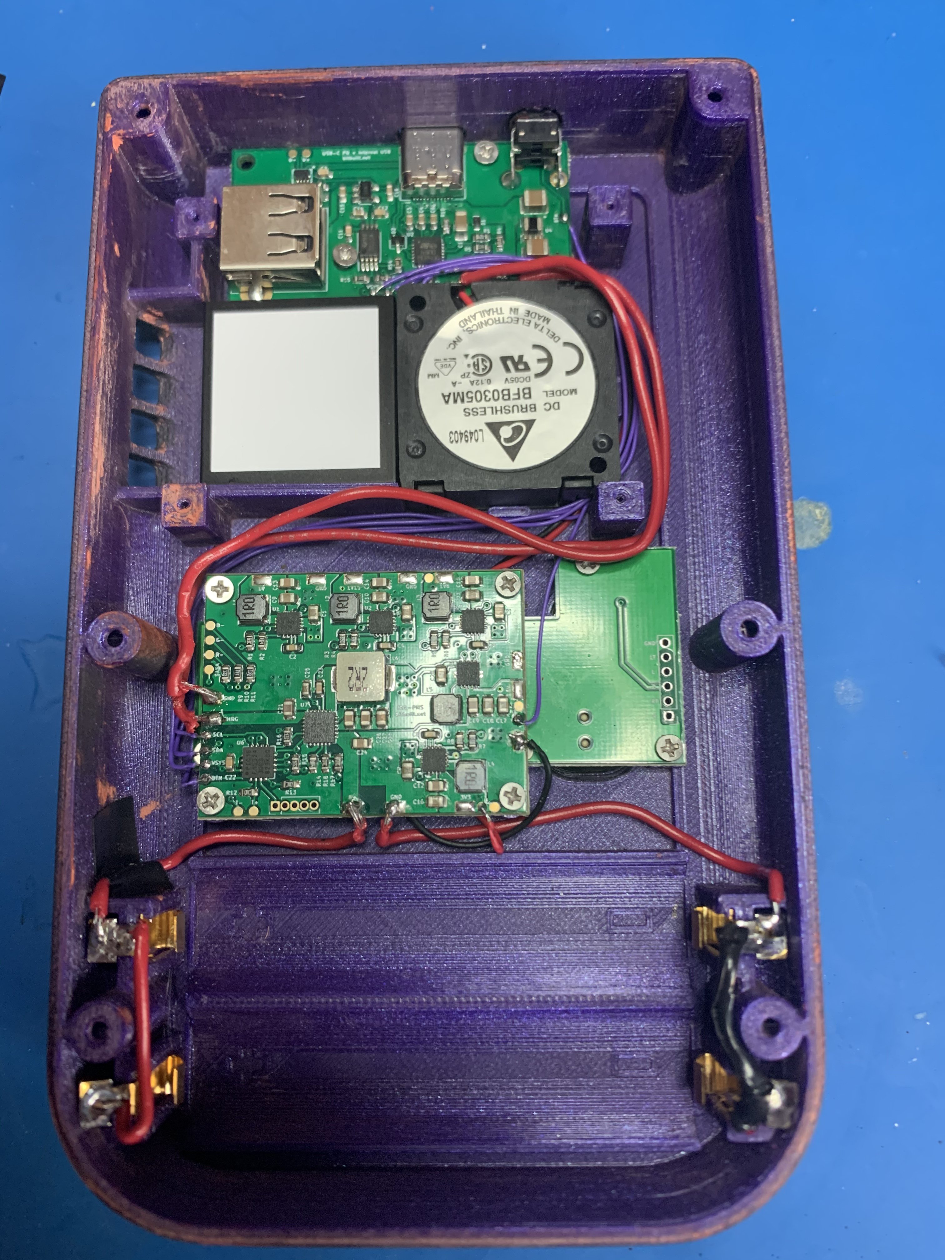

Gman RTFDS Staff member . . . . . Joined Feb 25, 2016 Messages 1,465 Likes 3,020 Jan 22, 2021 #21 the wires on the usbc board have too much wire exposed. See how the vsys wire looks like it is touching the pad next to it? Not good.
Fiddlesticks . Joined Sep 1, 2020 Messages 14 Likes 20 Jan 24, 2021 #22 Oh no. I’ll trim those up. If they did end up touching, would that mean the usbc or power board would be broken now?
Fiddlesticks . Joined Sep 1, 2020 Messages 14 Likes 20 Jan 30, 2021 #23 I shortened up the exposed wire, but no change.
