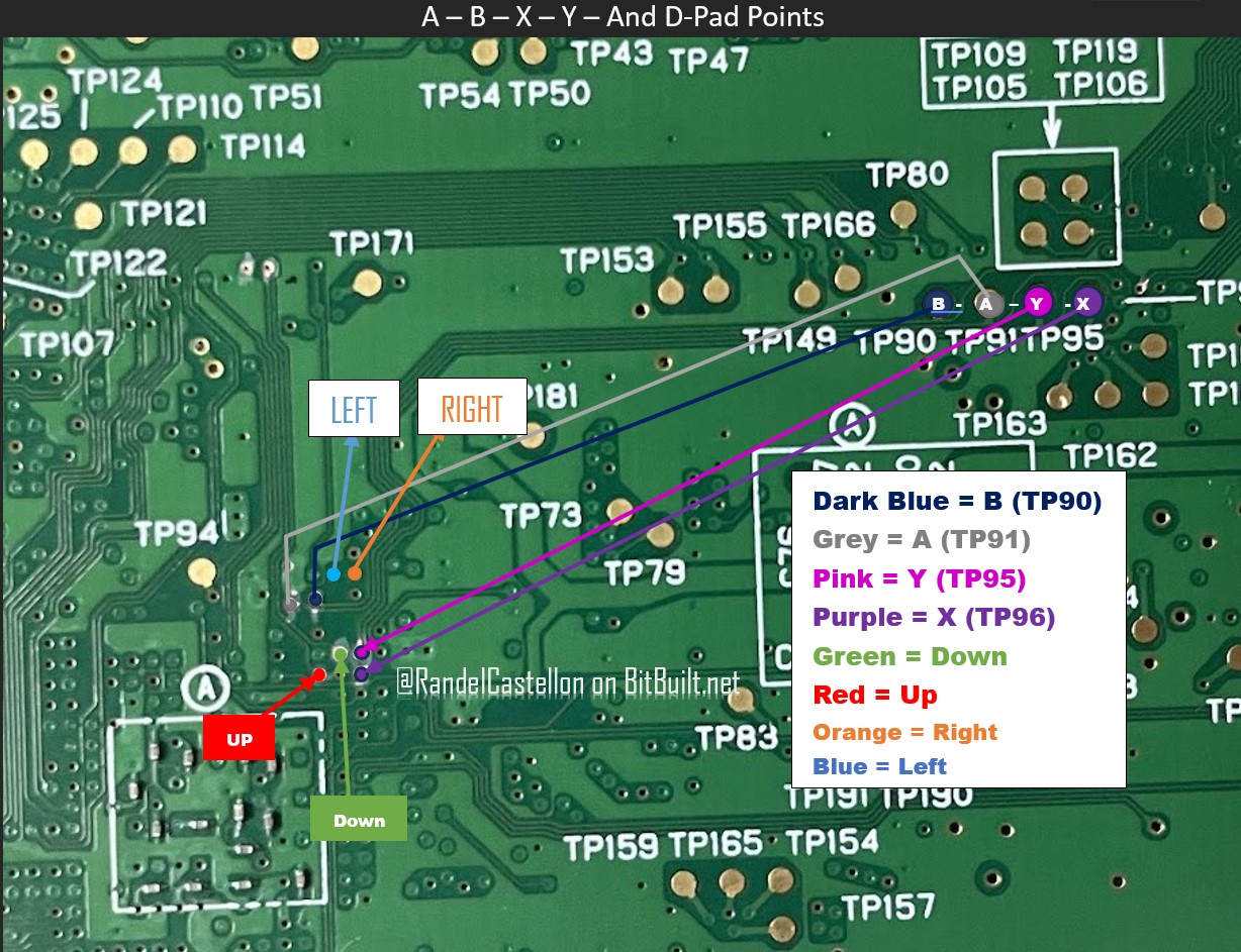

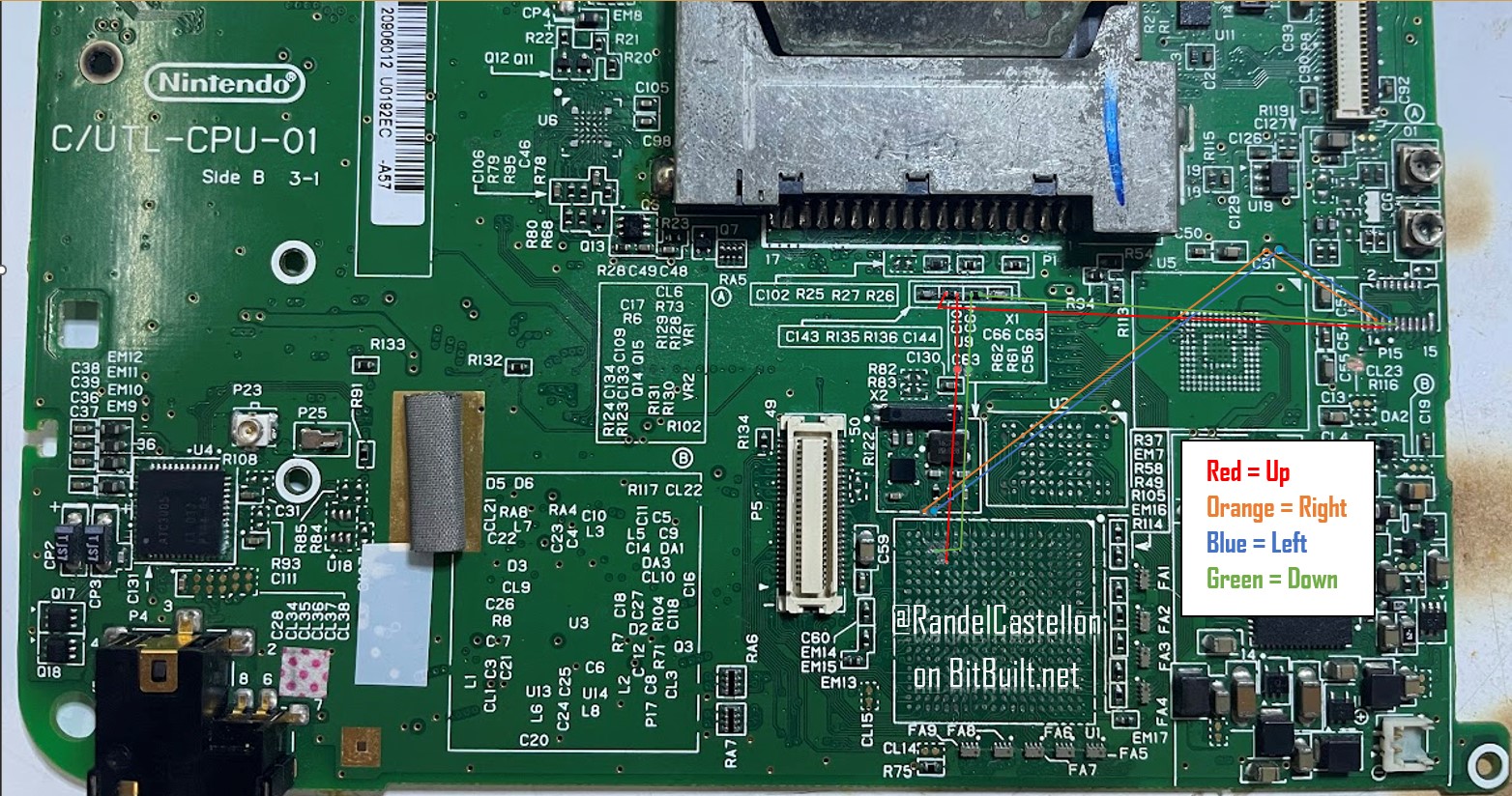

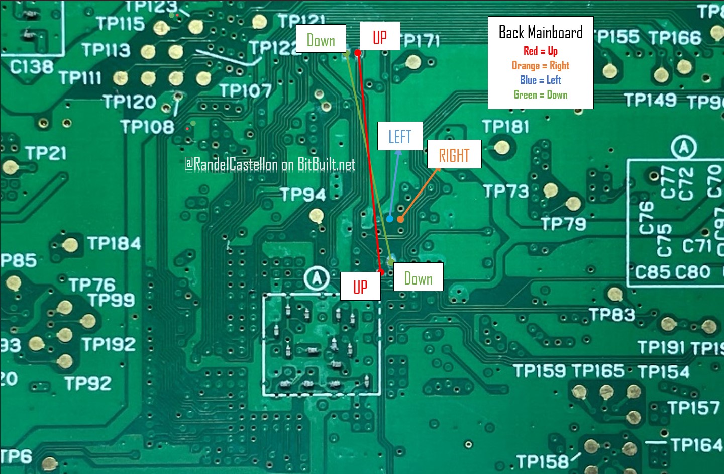

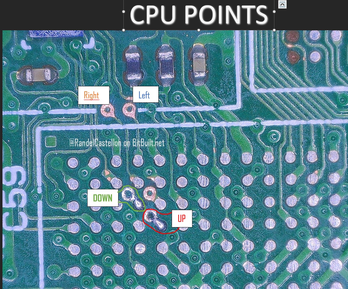

If you have a DSi XL that doesn't work, Up, Down, Right, Left, these are the testpoints to check if they have a connection with the CPU, I hope it helps you in some way so I can repair mine, a bit tedious but it was done
Pin 1 = Orange (RIGHT)
Pin 3 = Red (UP)
Pin 5 = Blue (LEFT)
Pin 7 = Green (DOWN)

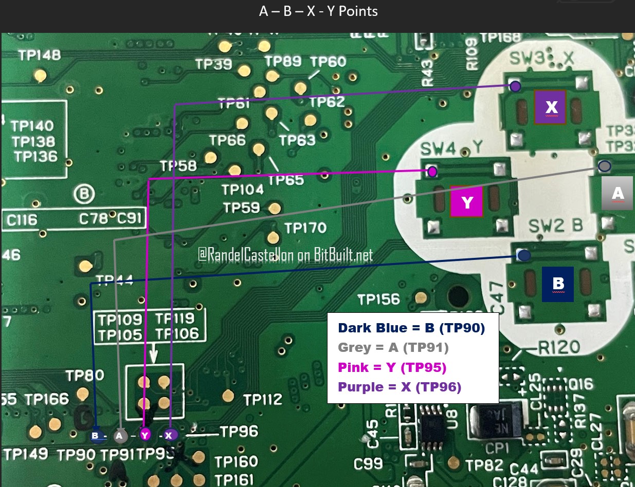

UPDATE Buttons - A B X Y
Dark Blue = B (TP90)
Grey = A (TP91)
Pink = Y (TP95)
Purple = X (TP96)
Pin 3 = Red (UP)
Pin 5 = Blue (LEFT)
Grey = A (TP91)
Pink = Y (TP95)
Purple = X (TP96)
