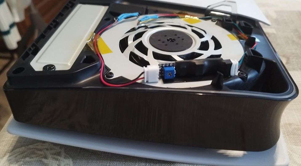

Hi all,
this is a tiny project to cool down easily every playstation.
Cost around 15€ (aliexpress)
7cm long size

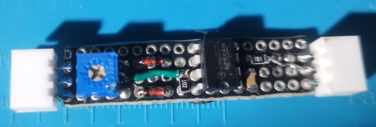

You need:
- 1 PCB 2x8cm
- resistors 1K and 100 ohm
- 1 capacitor 100nF
- 1 potentiometer 100K
- JST connectors
- wires red black and green 28 AWG
- ne555 (dip8)
- 2 diodes 1N4148
The video:

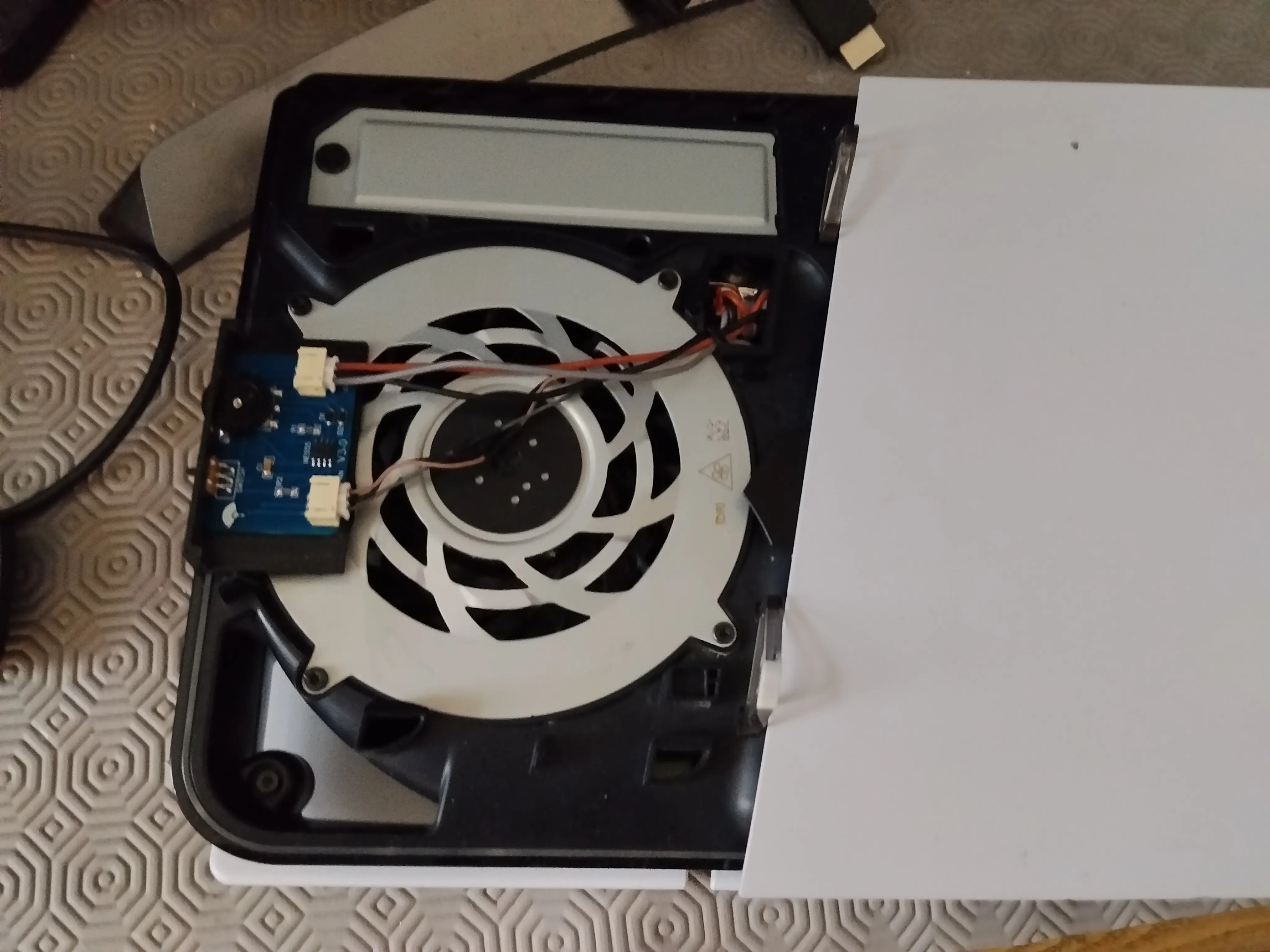

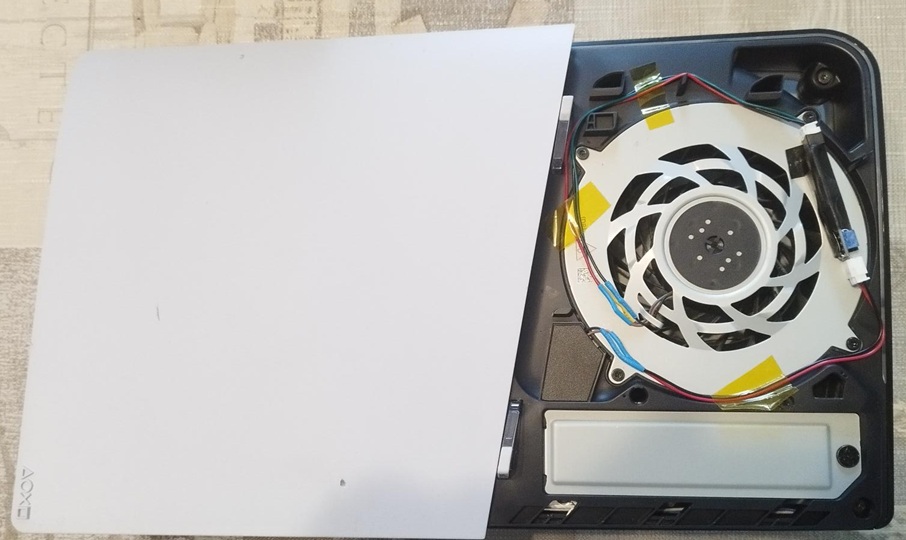

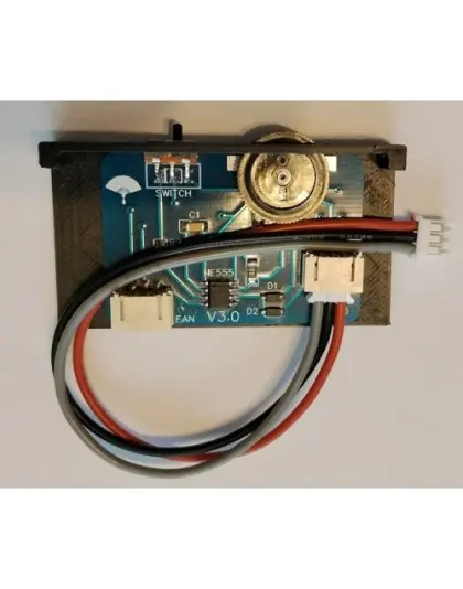

Update of the Fan Speed Regulator just for PS5 with the specific JST connector of the PS5 (slim, pro and fat: it's the same connector)
I have added a switch to stop the boost PWM because at the difference of the PS4, the 12V rail is always ON even if the ps5 is shutdown.
So the switch shutdown not the 12V rail but change the PWM route: the first route is our boost PWM and the second it's the PS5 PWM.
When the PS5 is OFF the PWM is 0v.
I have discovered a very interessting thing ! The PS5 PWM has 3 settings: Off = 0v, ON on the dashboard = 0.150V, in game = 0.5V

But before that, here is my new version of the FSR maufactured by JLCPCB:
in video:
