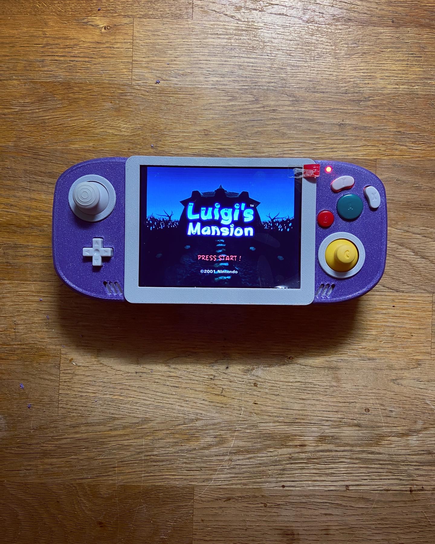

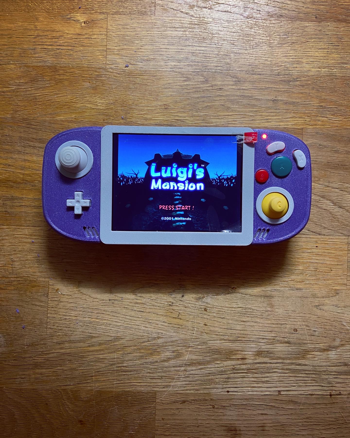

I have since last post printed an updated shell, I found out that there was a remix of the G-Wii where you print the entire front face down on the bed without any support and then you printed the bezel and joystick details separately which let you print these in a completely different color - I wanted to go for a slightly "stock" look, I bought gray filament and my god how nice it turned out.
I'll take a little better picture when Im done wet sanding, but look at this badboy!
I also printed out all the internals in gray, I really love the contrast and look it gives if you have to open it up one day.

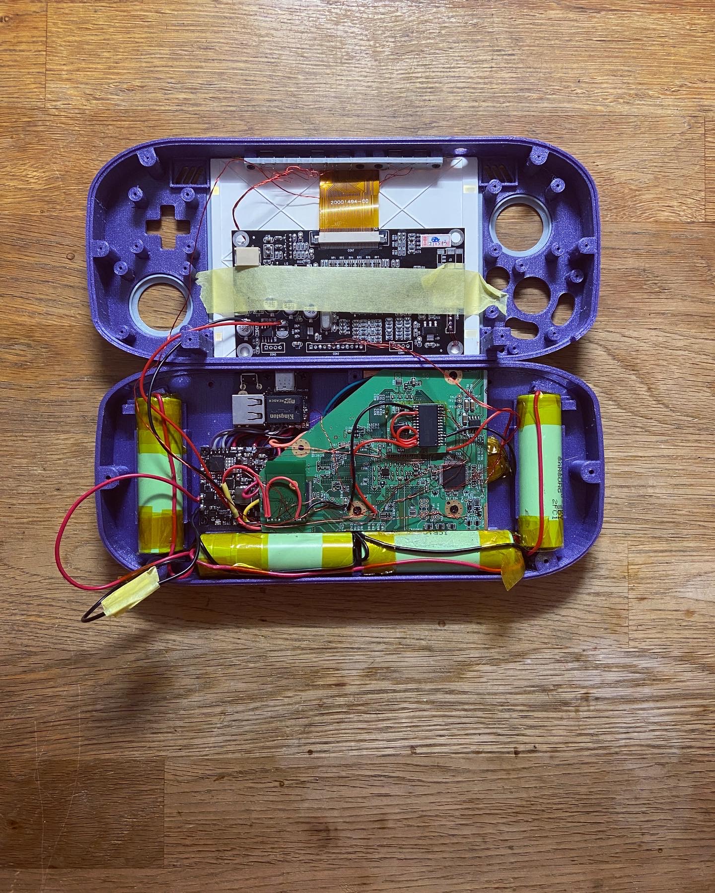

I installed rvloader, it didnt take many minutes and I tried to run GC, Wii and VC games without any problem, now the wii is ready to be disassembled and have its mobo cut!

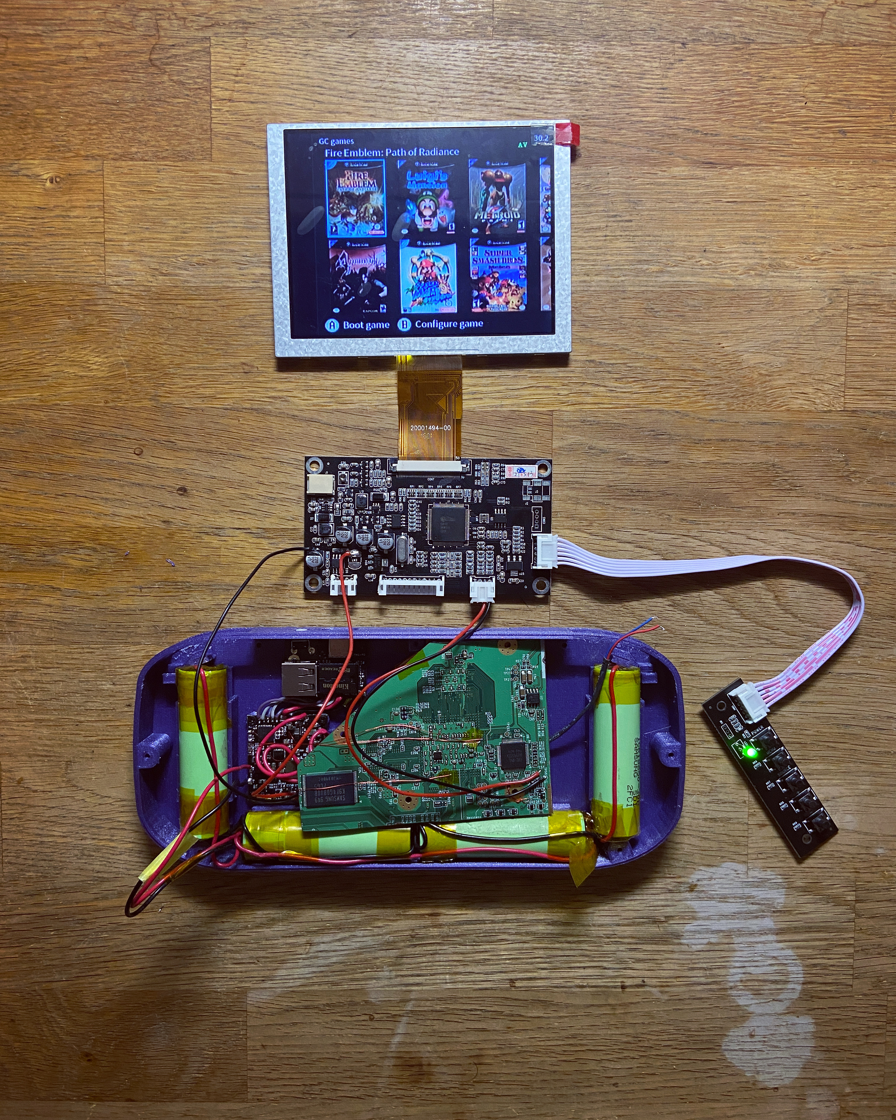

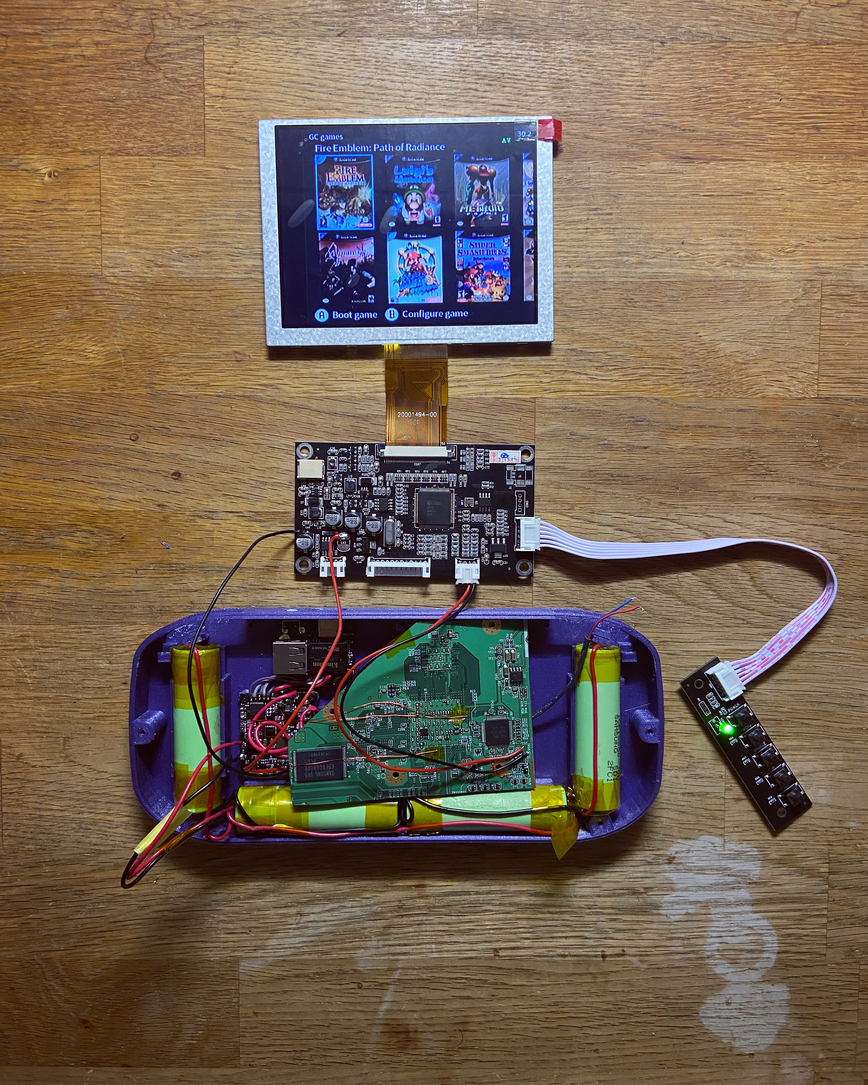

Before I cut, however, I wanted to get my small 5" screen to show image from the wii and be connected to 5V instead of 12V.
I threw together a small " guide " if someone buys similar screens and needs to modify them.
Success!
The next step is to disassemble the wii and cut the mobo, until then I'll wet sand the shell, I'veve bought 240, 360, 800 and 1200 grit sandpaper but I do not know if I will use all of them in the end - we'll see when I'm satisfied! It takes time and is a slow process but it will be fine in the end.
Update #2: - 211004
update #2

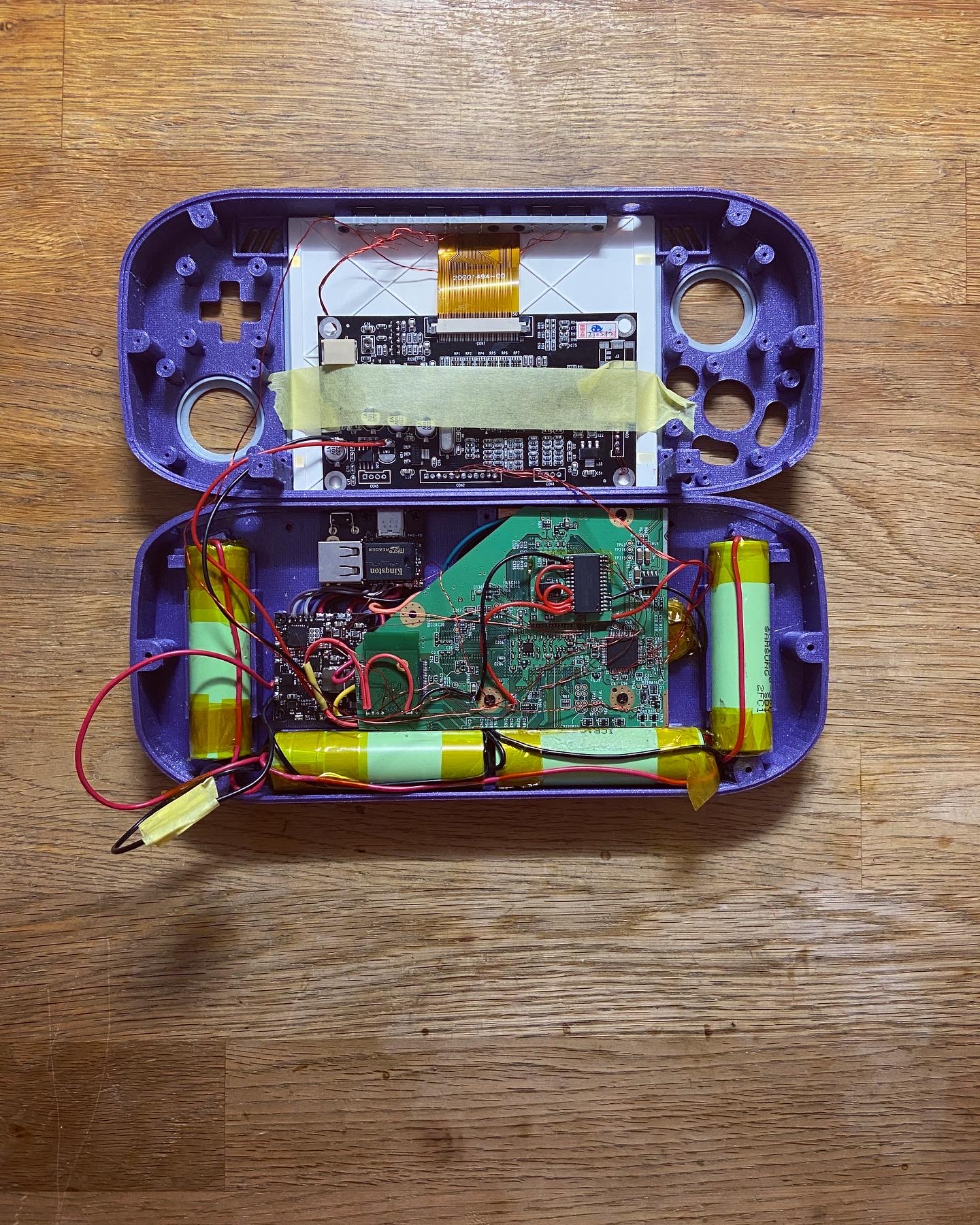

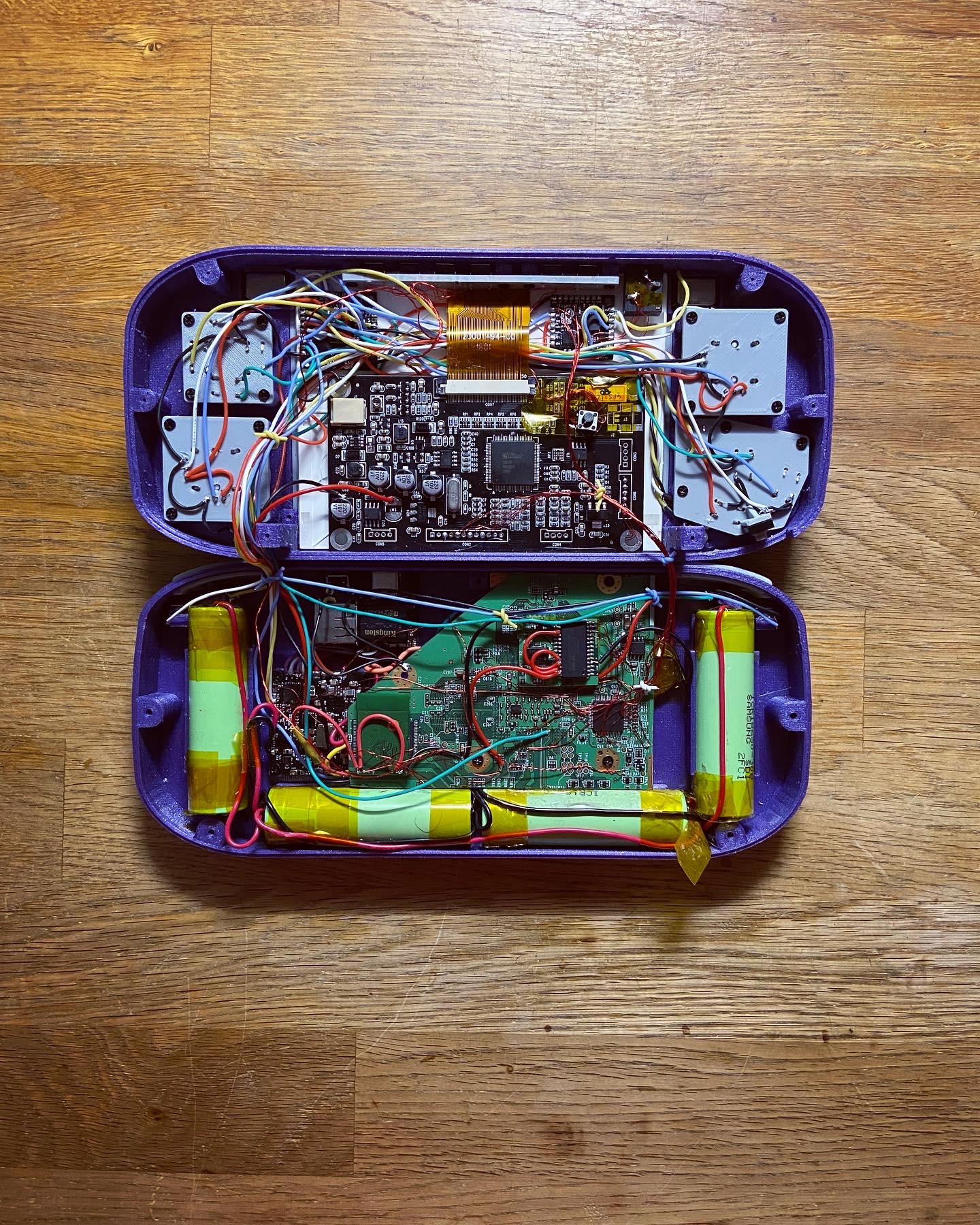

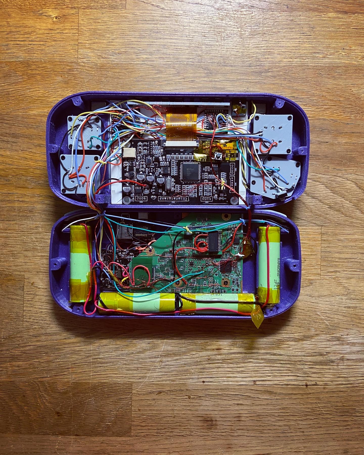

sience the last post I had big problems to get the trimmed wii to even boot... after days and hours spent of troubleshooting I desoldered everything and did another trim, soldered everything with some thicker cables and it booted without problem - leason learned! use correct cables for wiring. - I bet my old trim works but I'll check that for next build!
When everything was confirmed to work I then soldered the BT module and MX chip - continued to confirm that the wii wanted to boot after each new module!
now that everything was working in the back I then started working with the frontpiece - everything is soldered in place and the GWII functions as intended!
I've got som tweaking to do with this build - I want to change out the soft tactile buttons in the dpad for more clicky buttons just because I like that more (used to the xbox controllers)
I need to switch out the 3rd party joysticks for some stock gc stickboxes and also rewire everything so I can close up the gwii as intended - theres a presure because of the cables that I used
all in all Im happy with the build so far :)
