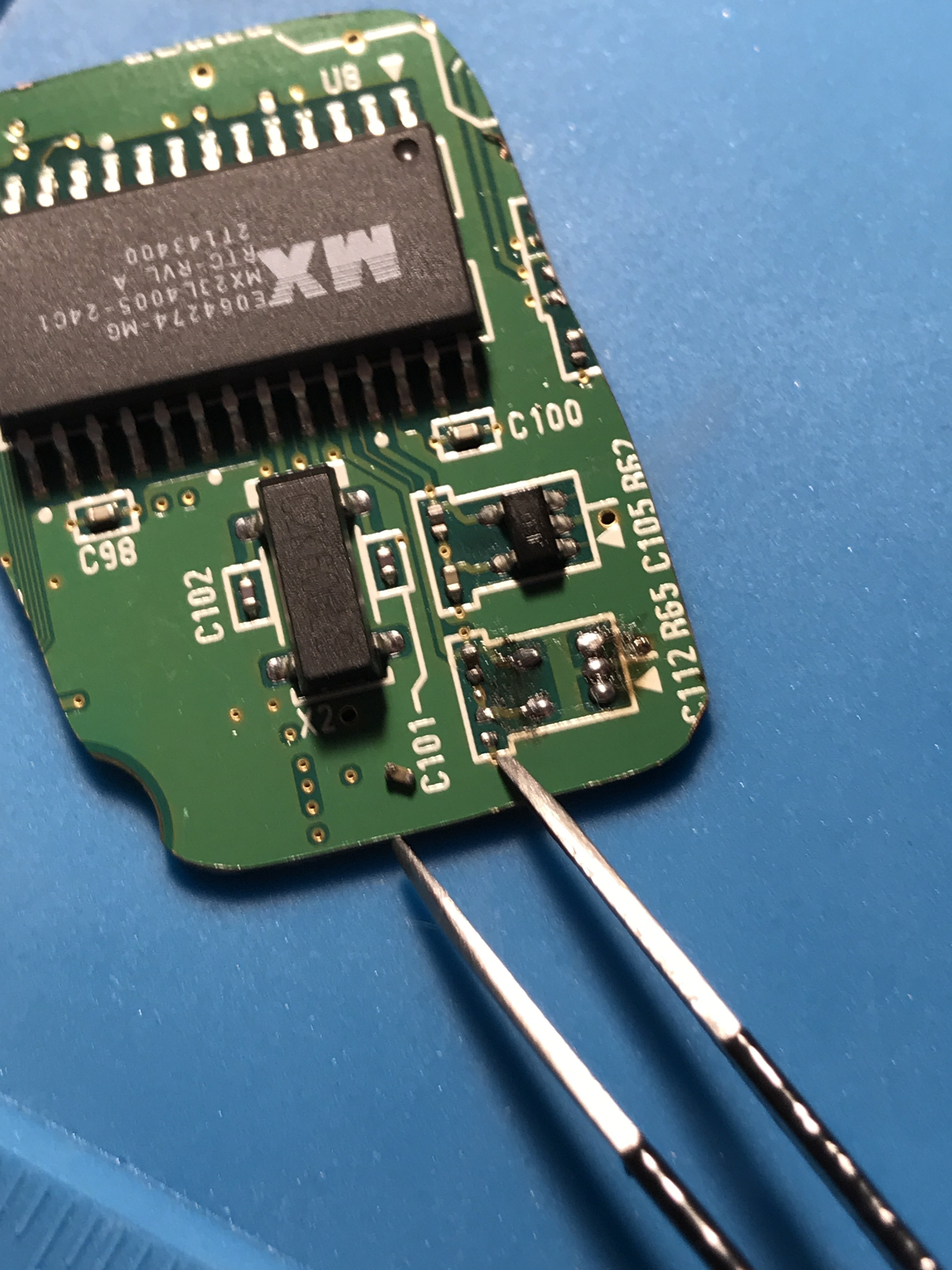

When desoldering the U10 near the MX chip, I accidentally removed one of the resistors next to it, it is a really small resistor and I am not sure I have the tools to solder it back on. Is this something I shoud be worried about fixing?
The component is a capacitor and no it's not needed it is OK.

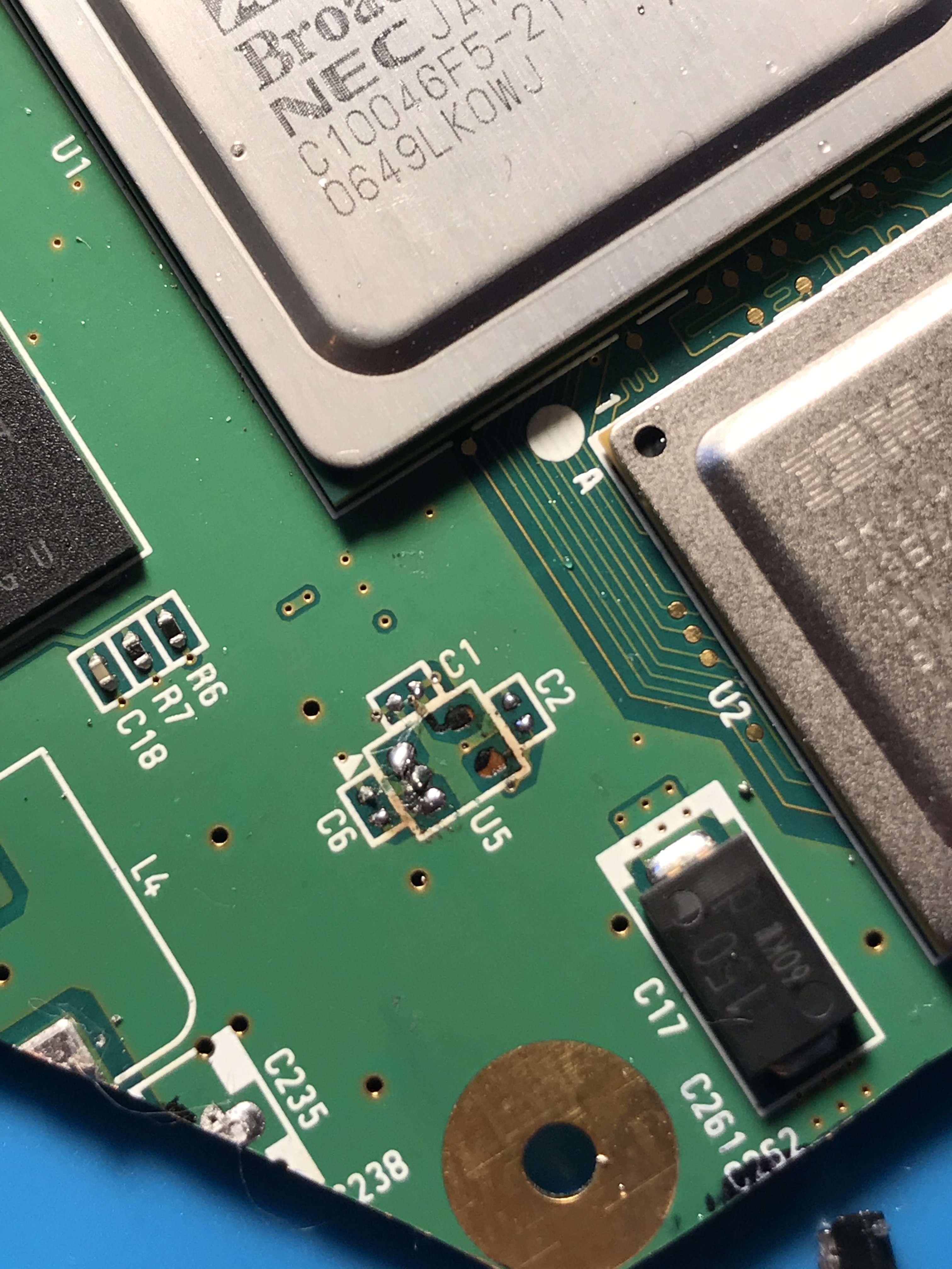

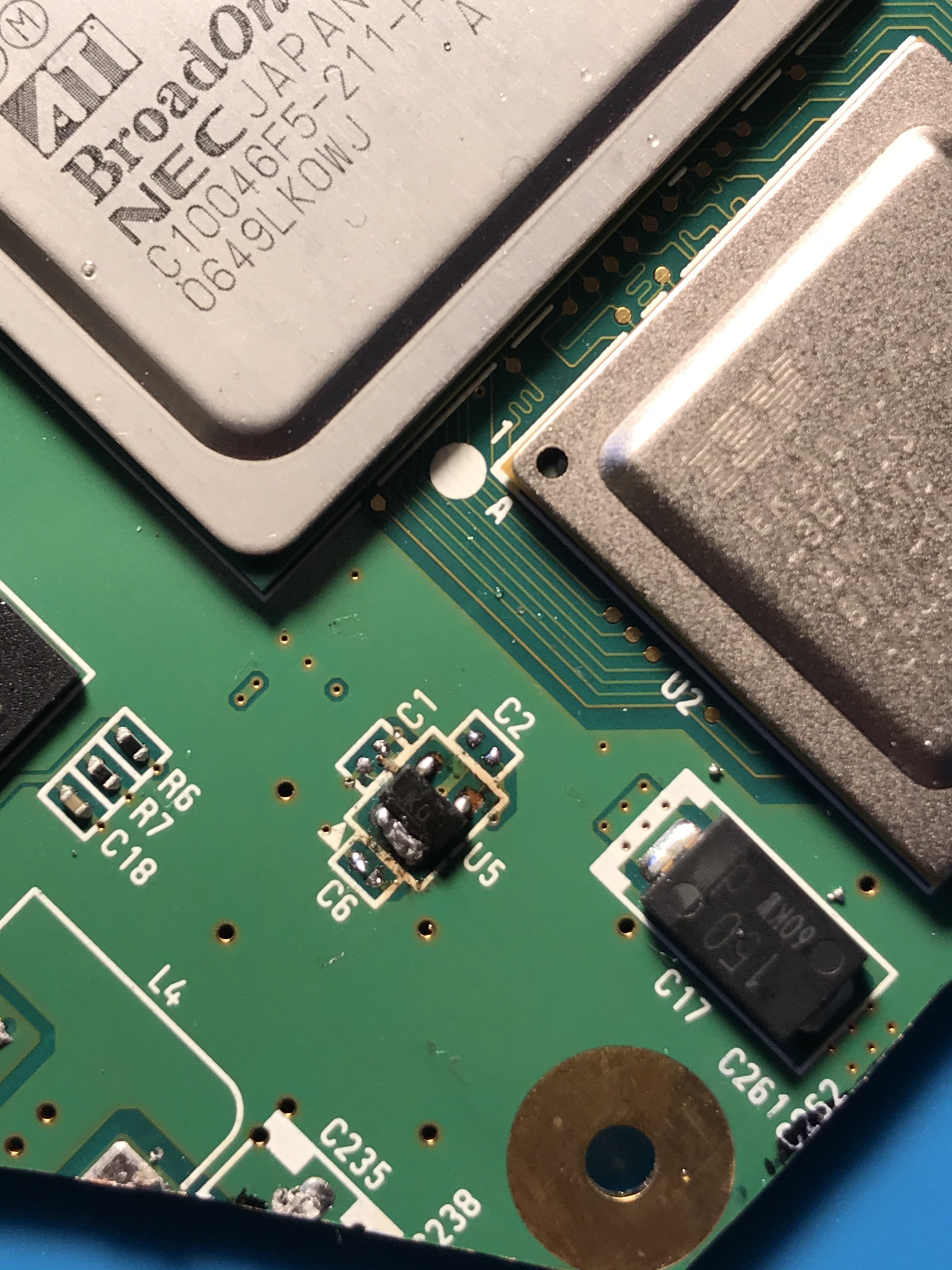

perfect, thanks! I did it again on the U5 next to the GPU, so that is good to know

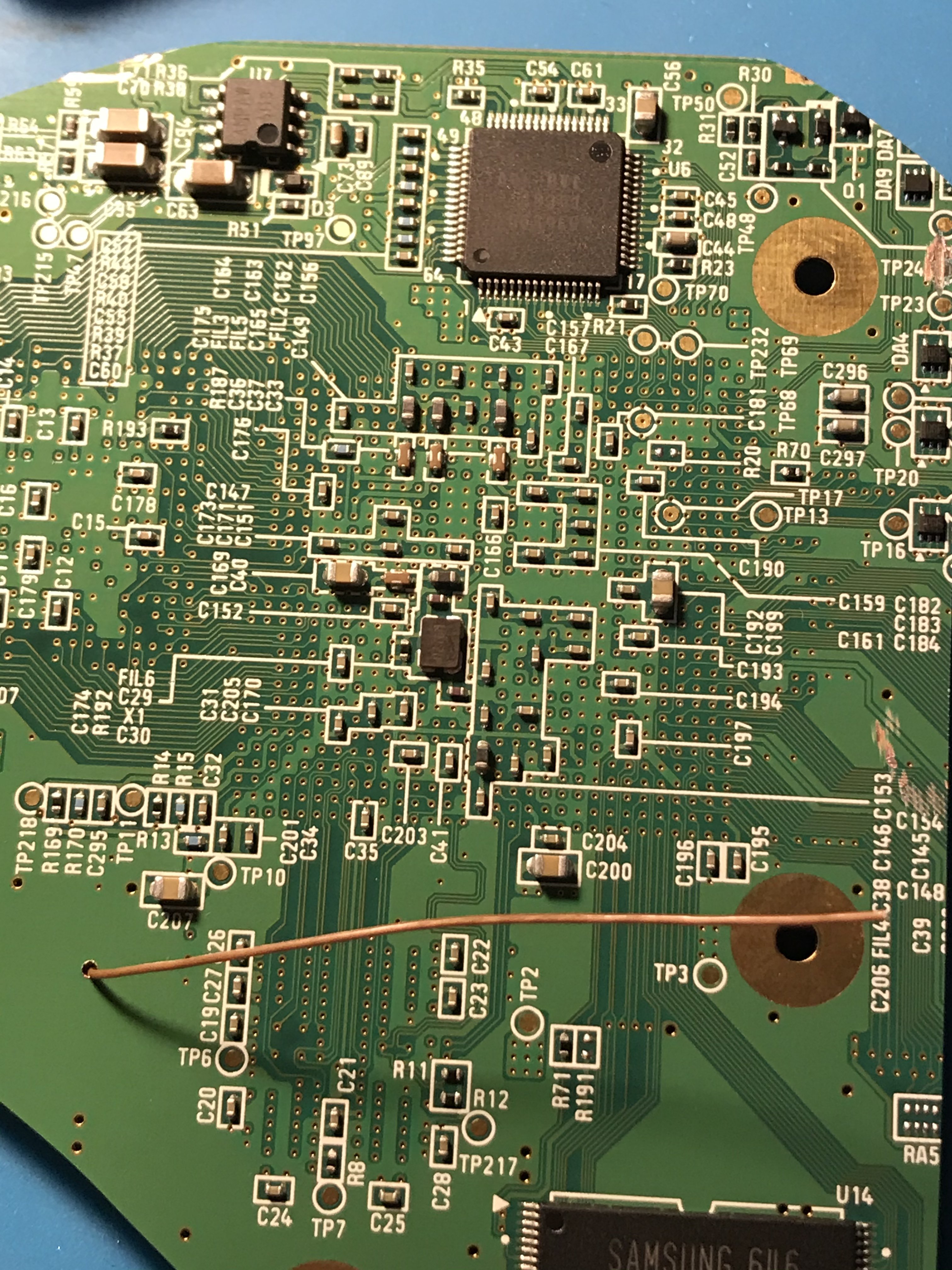

One last question (for now) the back of the mother board looks different then the pictures for soldering the wire to the GPU pin. The mother board is a C/RVL-CPU-01 which I know isn’t the recommended one to use, is that a problem?
If not where do I need to solder the wire?
