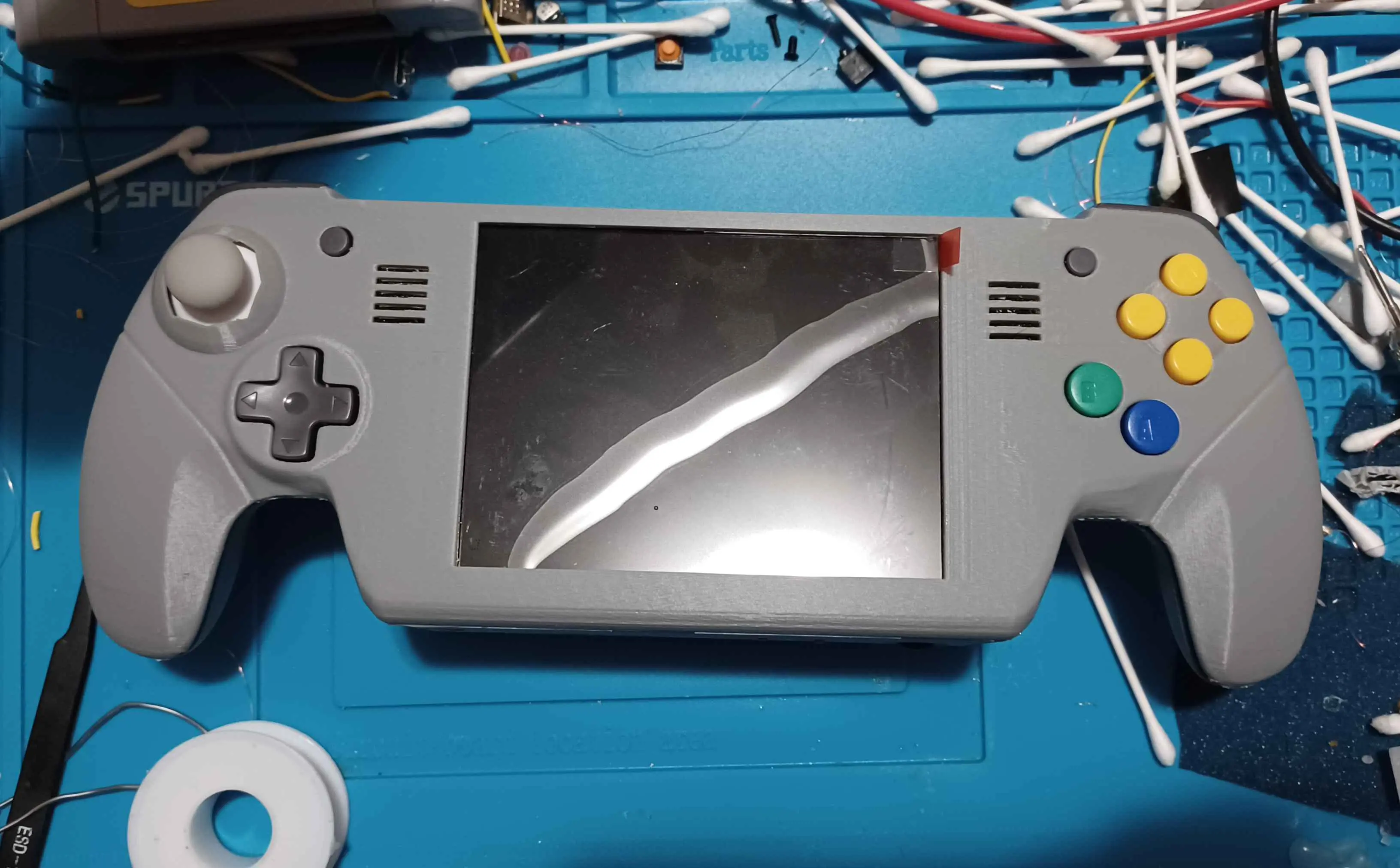

Now that OpeN64 is finished, it's time for the fun part: Making cool stuff with it!
After much deliberation, I settled on making a second revision of Cyxty Four for my first N64 AIO project. Cyxty Four rev 1's internals were okay at best, and downright unacceptable for modern standards at worst... Here's what I'm talking about:
Under the motherboard, it's looking a bit like the G-Wii almost. Some things are like the charging board, PMS, U-Amp, and RGB LED are okay. Other things like the Volume wheel, USB port, and tact switches have a ton of room for improvement though.
And then we have the front internals...

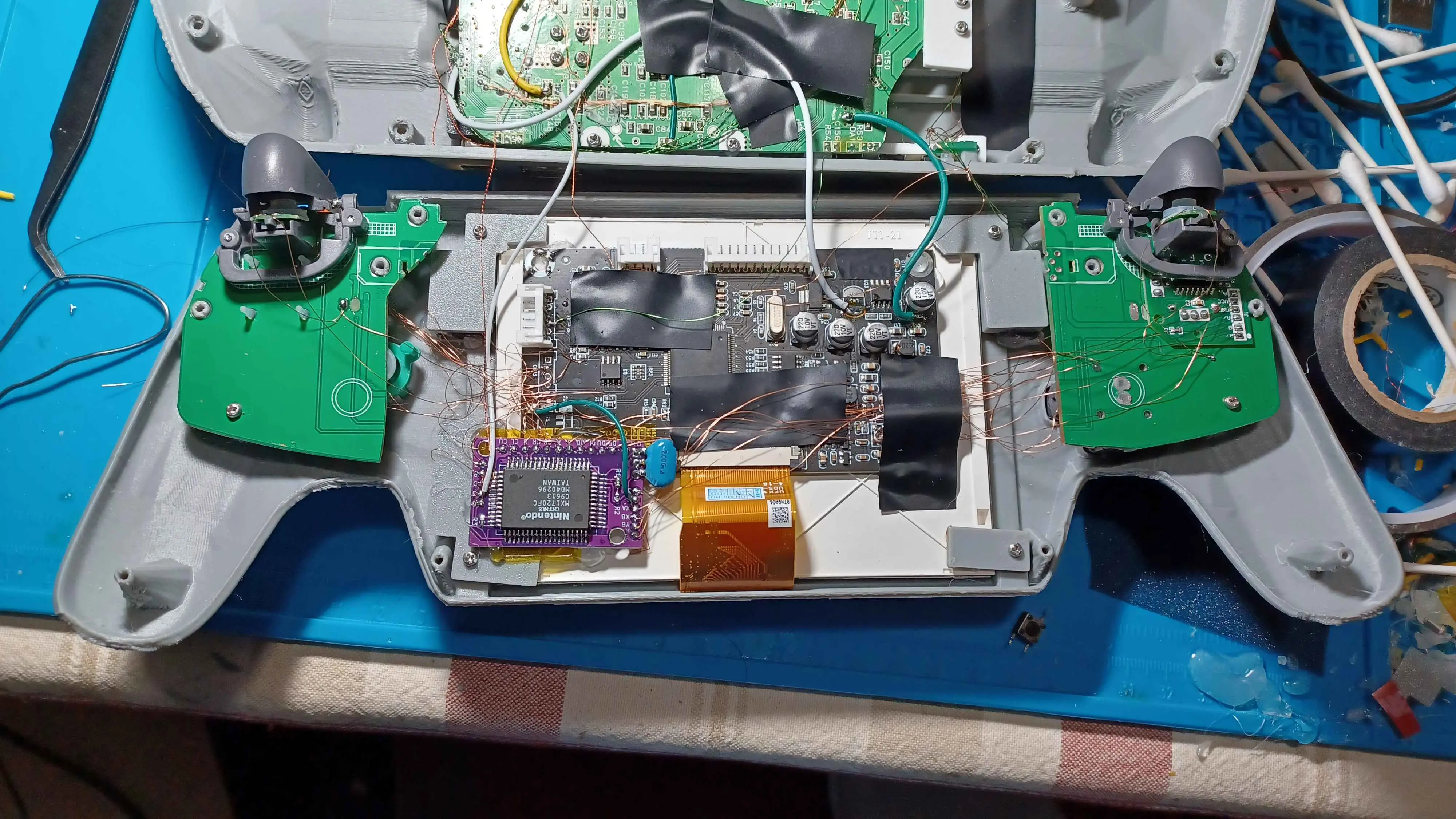

This is just sad... Trimmed controller PCBs with a magnet wire for every button? And what the hell is going on with that joystick PCB being stacked over the trimmed controller? Yeah... This project was rushed and the internals show it...
As a proof of concept, and a lazy "I just want an N64 portable" type system, Cyxty Four does it's job. And that's fine, because that's exactly what Cyxty Four is! But it's not a good portable for modern day portablizing standards. Cyxty Four Rev 2 is setting out to fix this first and foremost!

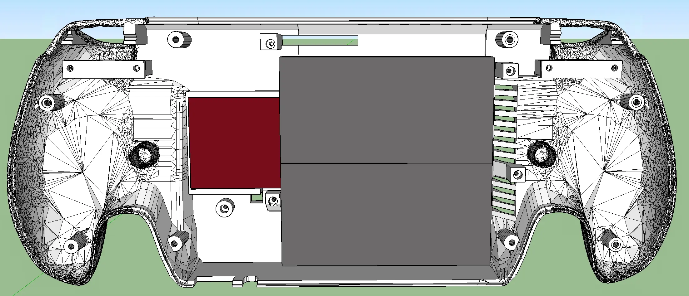

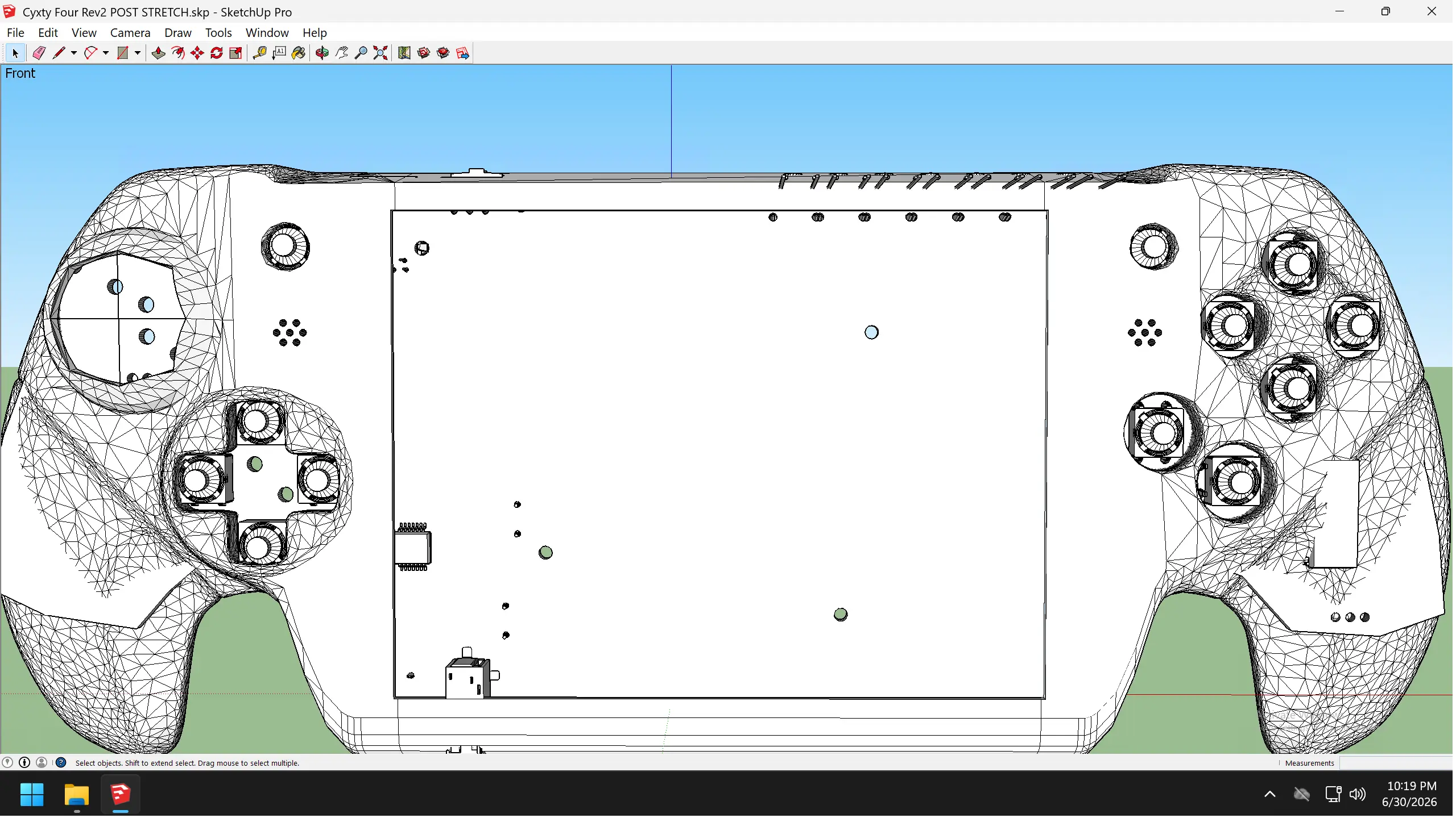

Next up, Cyxty Four is REALLY large, and kind of heavy... Let's analyze why this is...
Okay, so we're actually doing extremely well on the Y axis! The console isn't any taller than the original controller or the screen which is great! I'd dare to say there isn't any room for improvement here!
On the Z axis, the Cyxty Four is also around the same thickness as the N64HH, we can replace the 21700 with an 18650 though and we can actually gain battery life in the process of doing so thanks battery advancements! This will also lead to us reducing the overall thickness by a few millimeters, and the weight will also be reduced!
Finally, let's look at the X axis... Oh wow... There's actually a lot of room for improvement it seems. What can we improve though? There's a decent bit of wasted space on the inside, so there's no reason we can't make this design a bit tighter from an internal perspective - especially with an AIO motherboard!
What about on the outside? Well, I learned during the process of iterative design that the grips need to come out quite a ways in order to ensure this portable is comfortable. So lest we make the console uncomfortable, reducing how far the grips come out isn't really on the table. So what about the center body? Well, the center needs to be decently long here in order to accommodate the cartridge slot...
So is all hope lost? Well... Not just yet. After a ton of brainstorming, I came up with a way to save up to 20mm of space along the X axis! This should reduce the console's overall weight, and will hopefully improve portability on the console's most offending axis... I'll get to how we'll be saving all this space in a bit though.

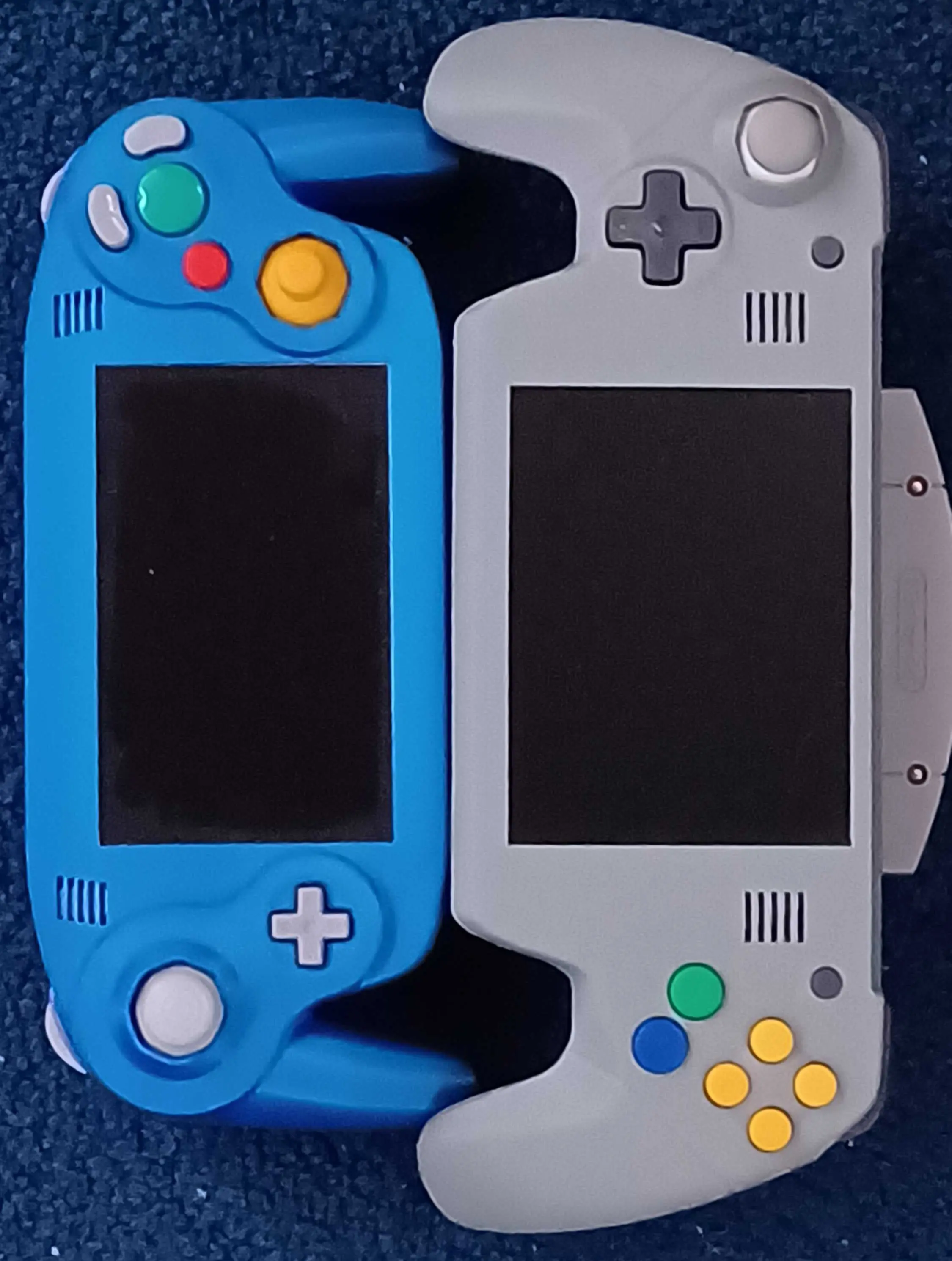

Before we move on, let's also compare Cyxty Four to the Ashida, this should benchmark Cyxty Four a bit allowing us to see if Cyxty Four is even a good portable by comparing it with a console that is widely accepted to be good by the community. Cyxty Four is quite a bit longer than the Ashida, but the N64 is notoriously difficult to make small, so maybe this is due to the mid section of the Cyxty Four? Let's have a closer look...
Wait what? This can't be right?! The Cyxty Four's mid section is actually around the same size as the Ashida's mid section?! One could even say that it's smaller... So are the grips on this console (the only non-negotiable) really holding it back that much? It looks like maybe they are! But there isn't a ton I can do about this without completely redesigning this project and arguably turning it into something it's not supposed to be.
So to answer my original question here, "is Cyxty Four even a good portable?!" ehh, it's okay, It feels great in the hands! I've spent many many hours enjoying N64 games on it and from my experience of using it extensively, the length of the console is what holds it back more than anything else. The console is also a bit heavy which is a little annoying, but it's weight feels very similar to the Ashida, so it isn't that bad. The grips will be a huge challenge to work with though, and it's length needs to be reduced by quite a bit (which will be a HUGE uphill battle) if we want to end up with something good. So I'll see what I can do with that...

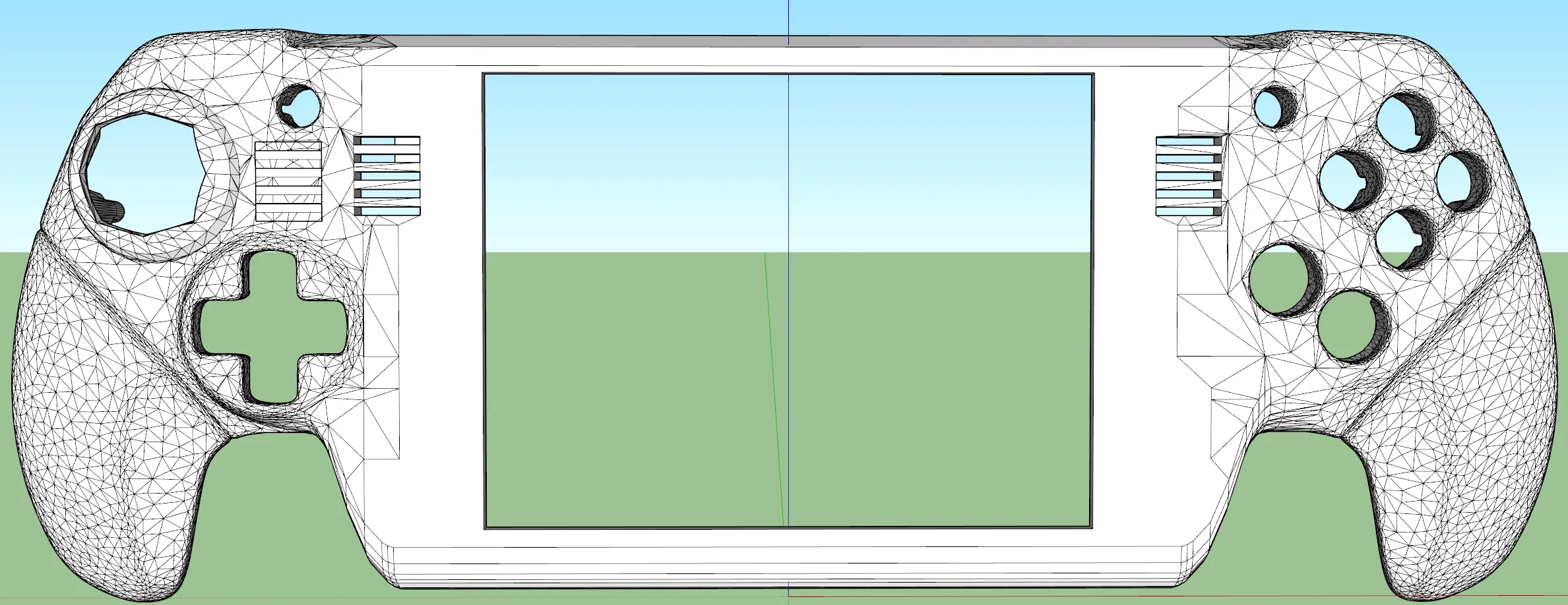

By comparison, this is the original front:
As you can see, I'm still trying to figure out how to handle where the speakers will go. But hopefully this drives home the difference between how rev 2 is looking compared to rev 1. I think this is going to be a lot more comfortable in the hands!

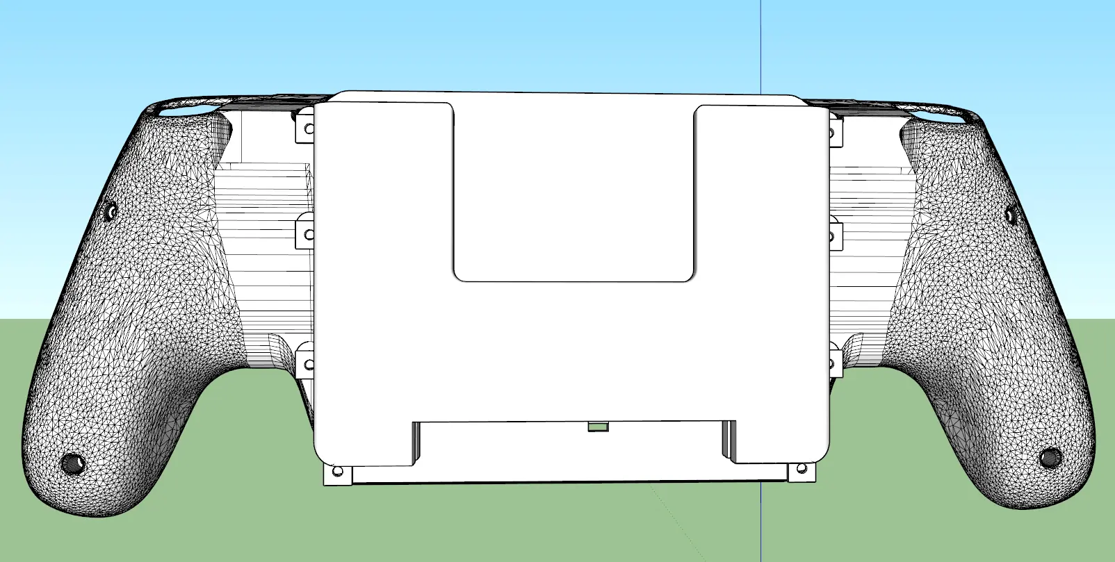

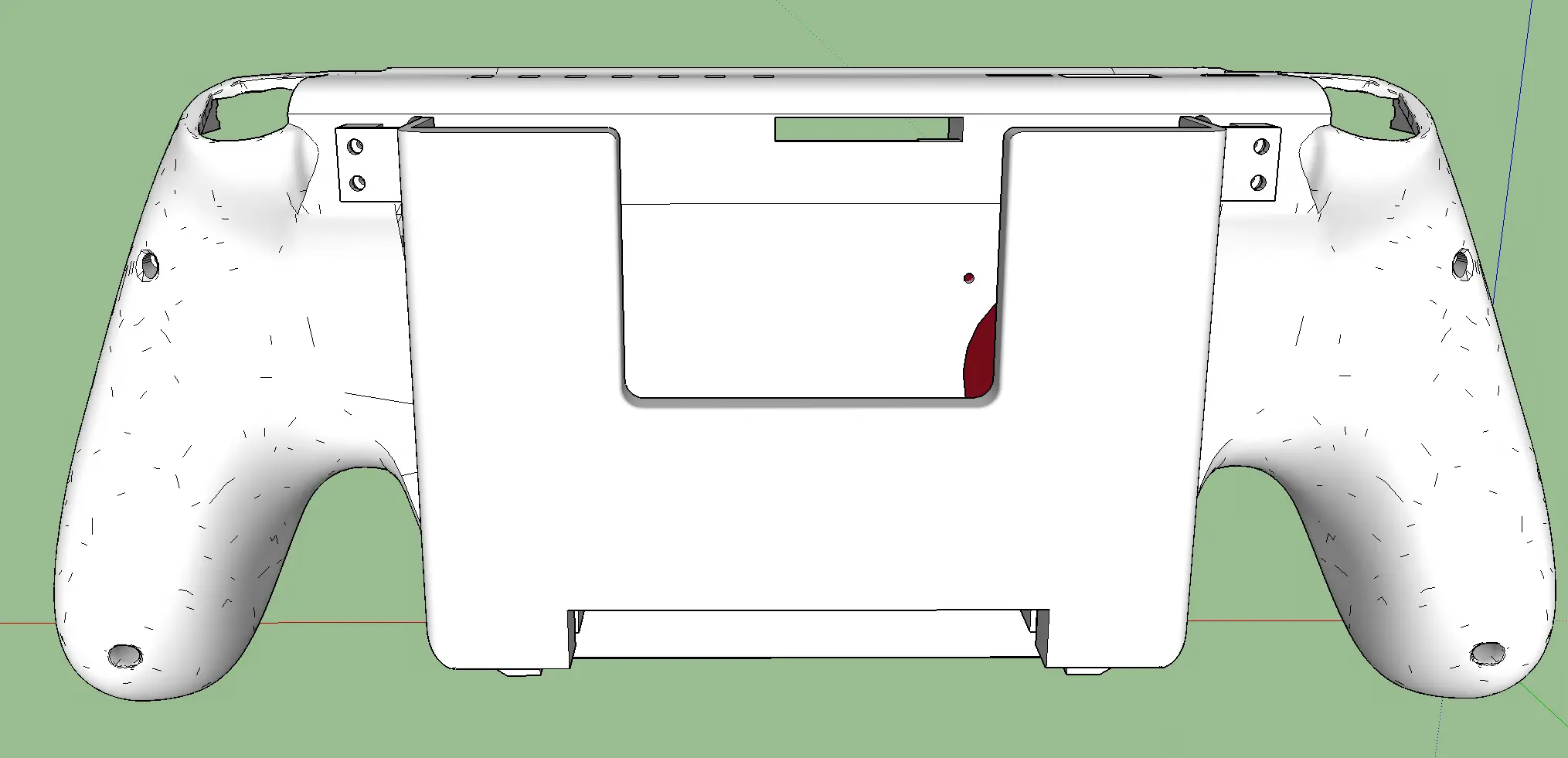

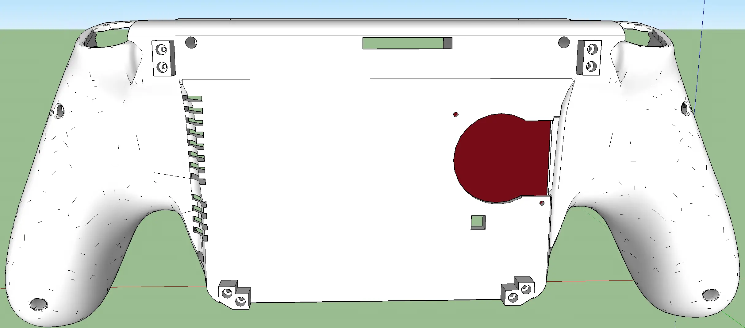

Now for the back on rev 2:

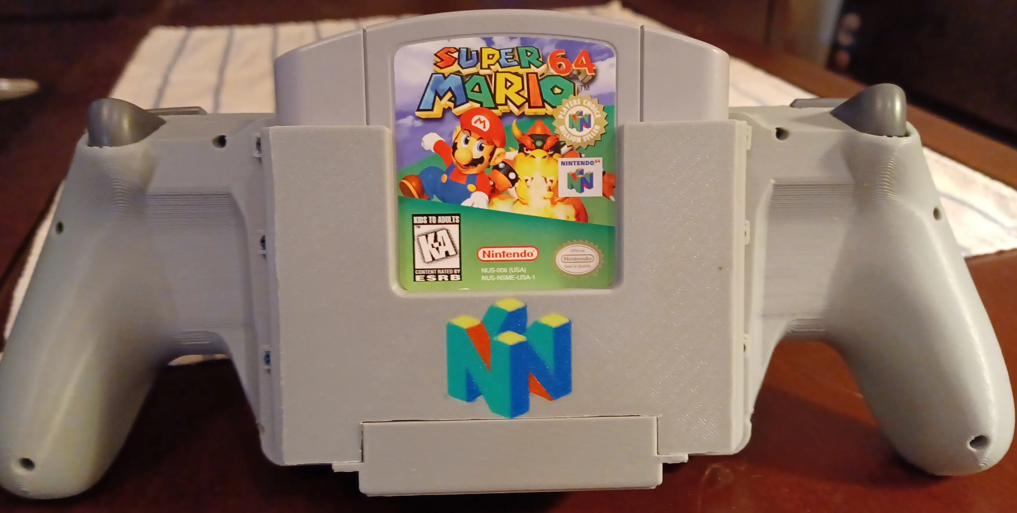

This doesn't look too different at a glance, but it is shorter. The cartridge slot housing can't be reduced which is really going to make this difficult. As you can tell by the floating screw posts, I also need to rework how it'll mount on the back. I have a few ideas on how I can reduce the size of the cart slot housing by a bit though.

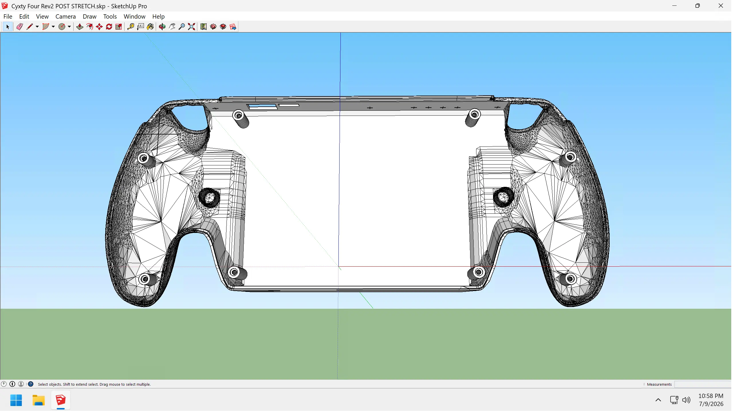

Update time! I managed to reduce the internals another 10mm making this build 30mm shorter in width than the original:
This is an amazing savings, and makes rev2 look tiny by comparison! I needed to rework quite a lot to make this happen, but it's still comfortable in the hands, and I think I'll be able to make this work! Still really not sure about if I'll have room to add video out into this seeing how that'll involve working in two switches, a port for video out, and controller pass-through. I also want to work in screen controls into this, and I'll need to work in volume controls, a headphone jack, and a charge port as well as a power and reset button, and finally an charge indicator LED.
That's a lot of IO with not a ton of space to work it in, so we'll see...

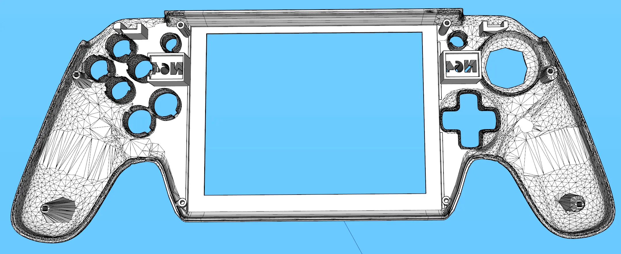

Exterior of the front has been cleaned up a lot:
Internals for the front are looking like this:
The speakers sit up super high in a calculated effort to try and make them line up with the PCB so I'll be able to make use of the spring contacts. This is only going to save more wires if I manage to line those up on the motherboard. Would love if I can keep the wire count for this in the single digits, but we'll see.

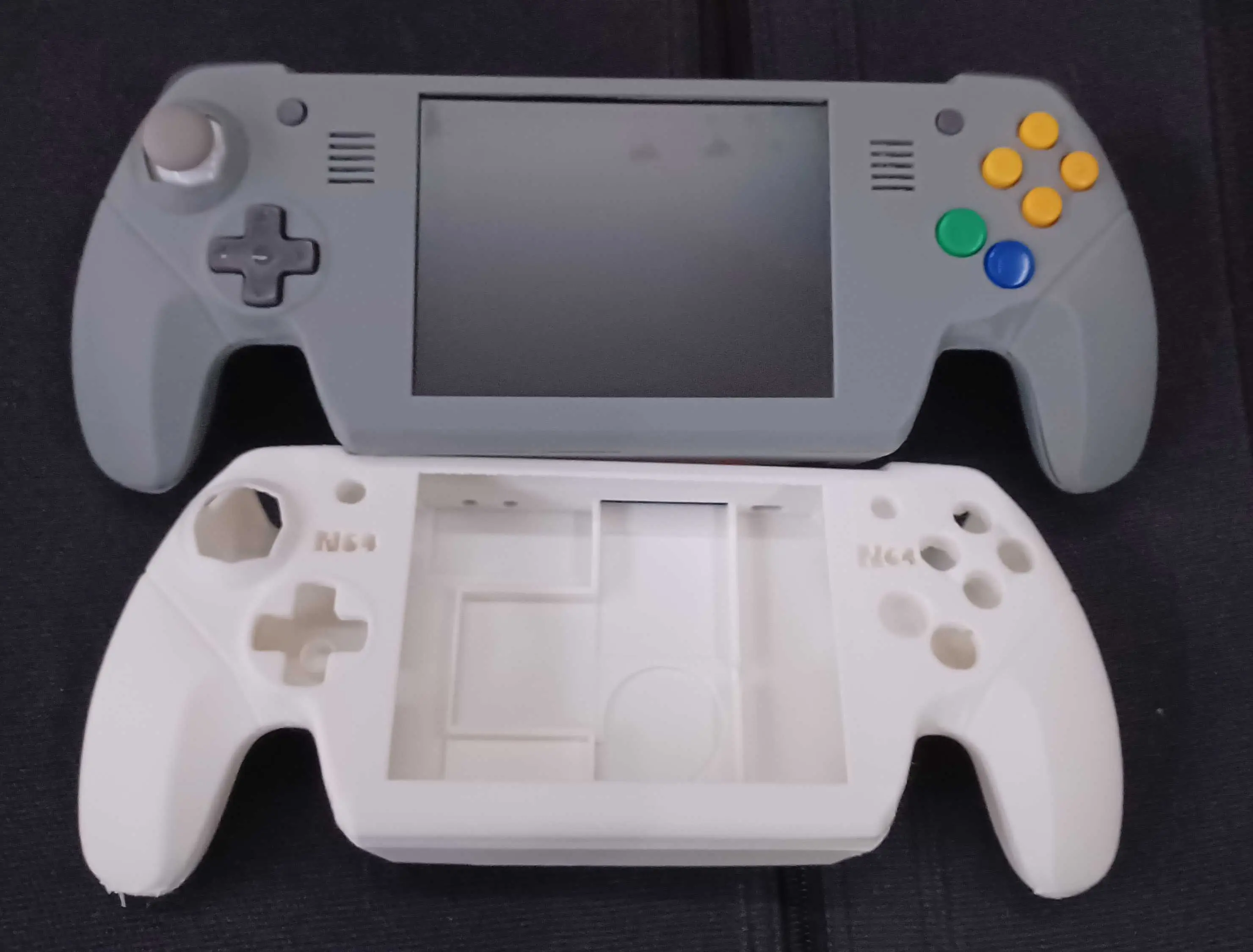

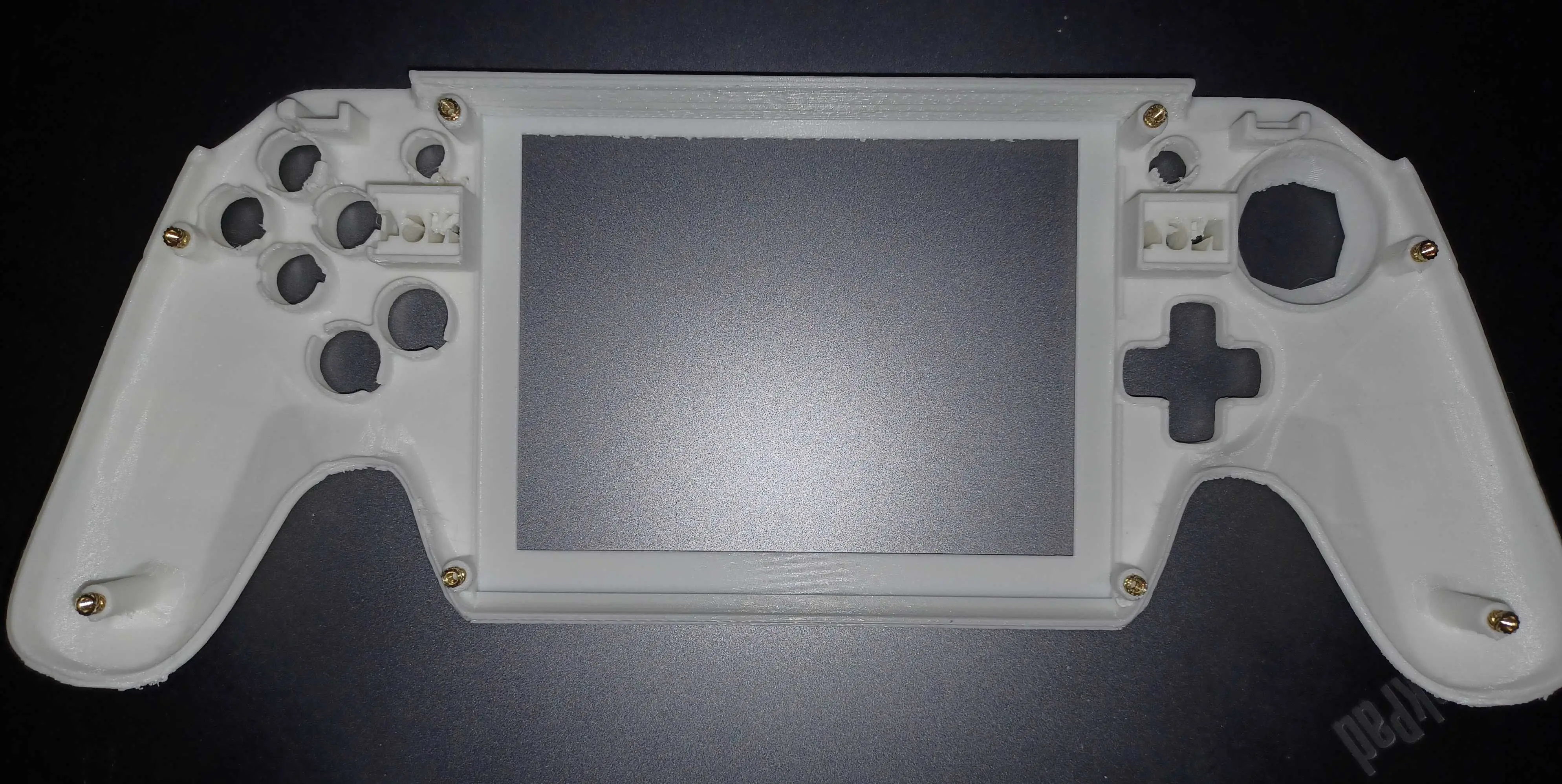

Update time! I've been continuing to iterate through the front and back revisions of this on and off in an effort to line up the screw posts and other various things. Somewhere along the way @Bubberiffic @Shank and @buzzyc inspired me to replace the screw posts with brass inserts:
I haven't melted the brass inserts into the plastic yet as this is simply an iterative test print and is far from the final revision. These fit in well enough though, and should make the entire unit more serviceable - something this project is striving for!
Along the way, I also decided that the "N64" speaker grills look tacky and I opted to go for a more stealthy approach for the speaker grills:
This not only looks better, but it should be easier to print!

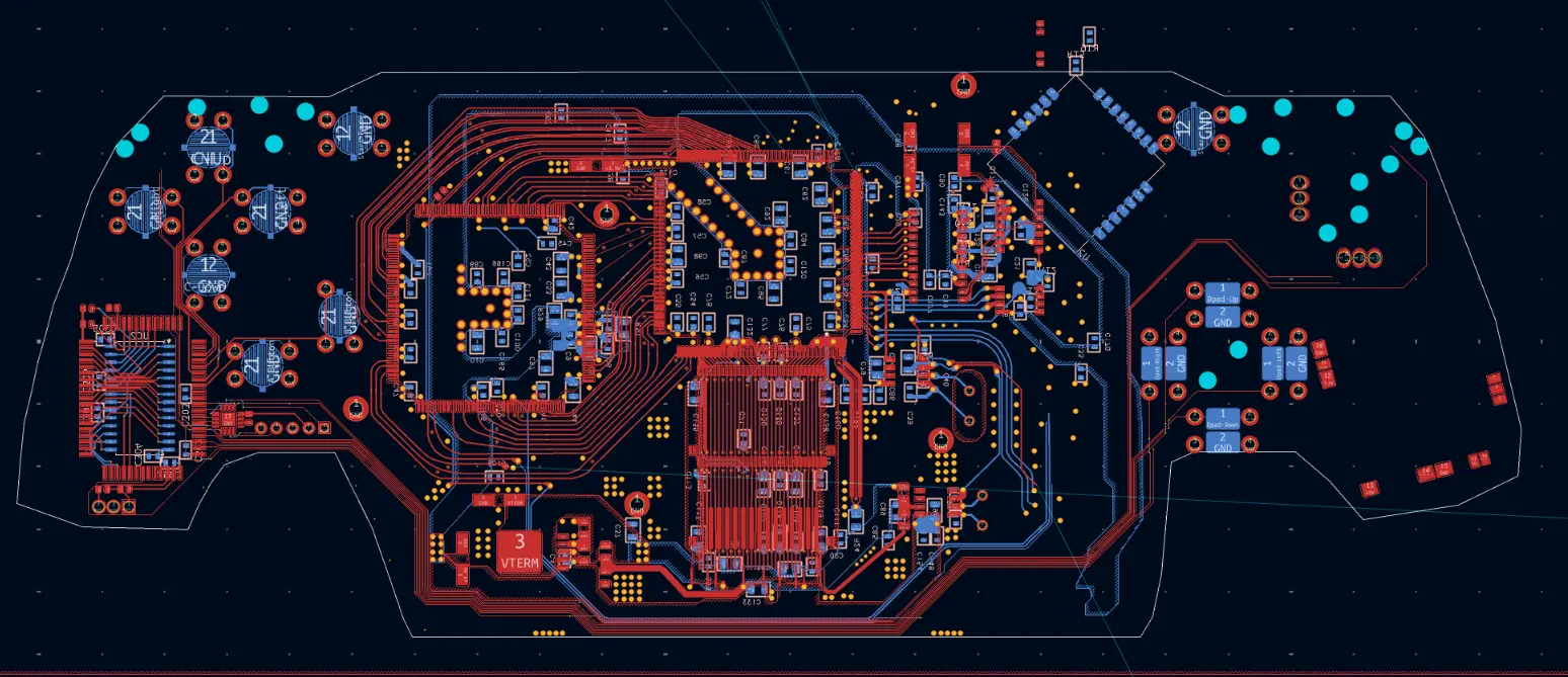

I have removed the PIF since that'll need to be reworked/rerouted from it's original positioning. But my main focus for this session was routing the traces for the buttons. If you look at the bottom center where the edge cuts are, you'll see a bunch of traces being crammed that travel from the left side of the board to the right side. These are all controller related traces, and is functionally me reconstructing the internal controller part of this build.
I've also reworked the 3.3v plane a bit, made connections between the micro controller and the controller chip, and made other connections between the button contacts and the controller. This routing is by no means final, but it's a start! I still need to put pads for the L, R, and Z buttons onto the board, make connections for them, etc. I'll also be routing a 3.3v on both sides of the board since one side has the controller requiring 3.3v, and the other side has the PMS. I'll also need to route the 5v trace, and ensure that the GND plane is still intact enough, but that'll come later.

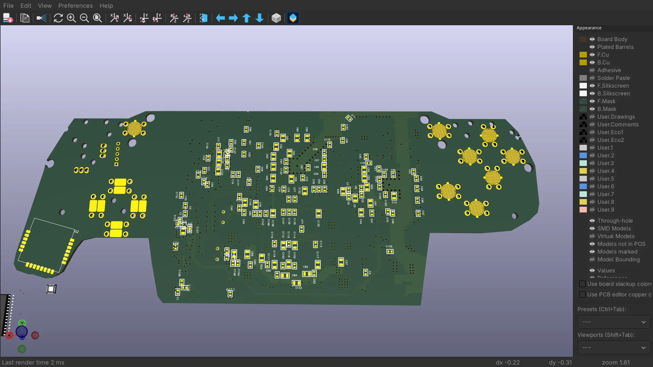

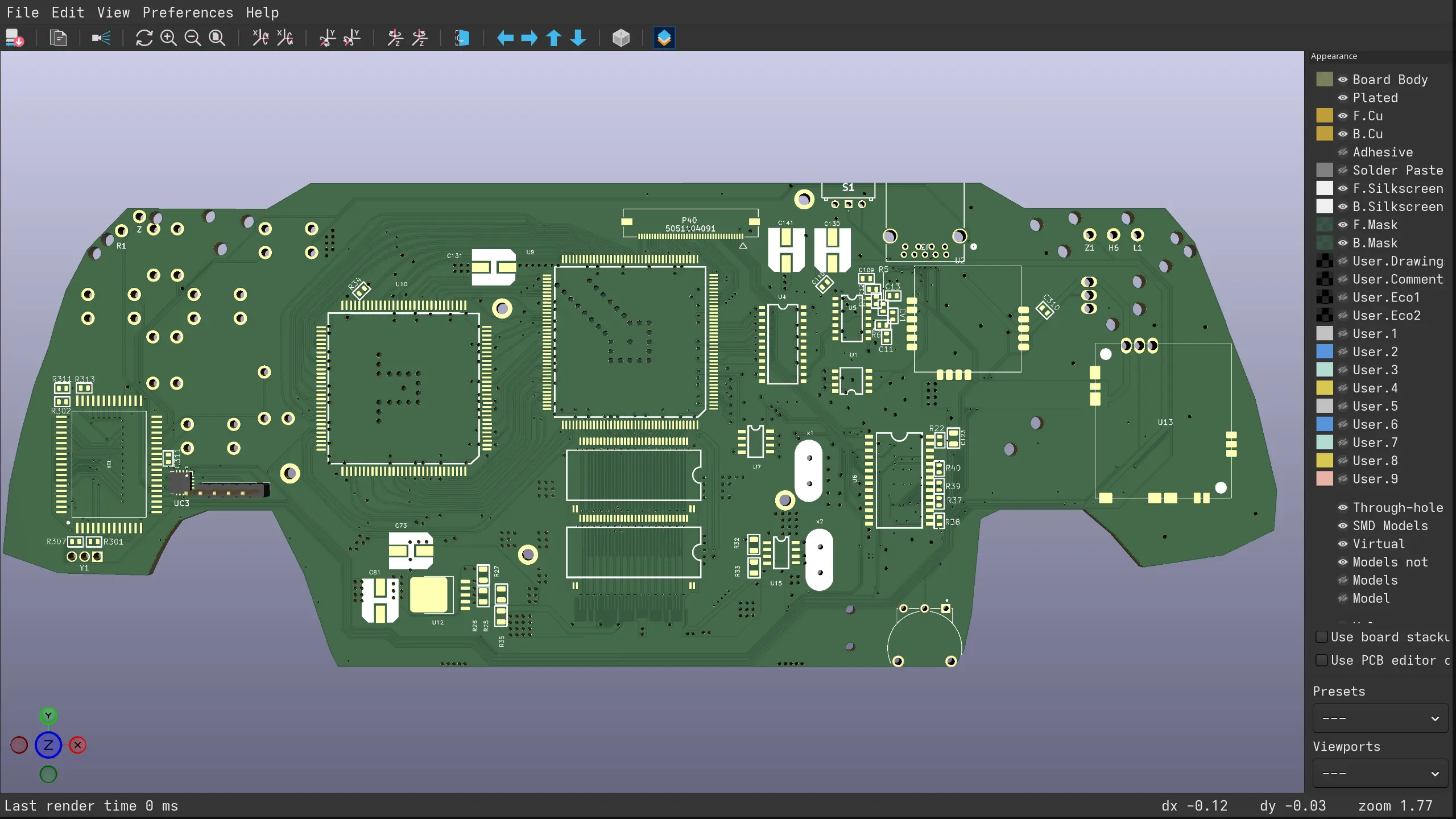

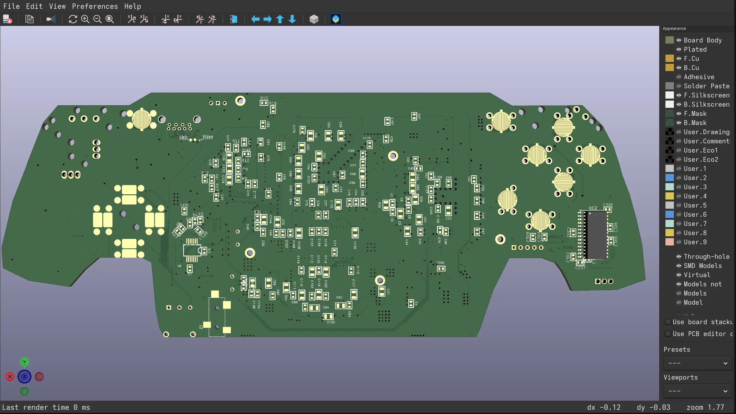

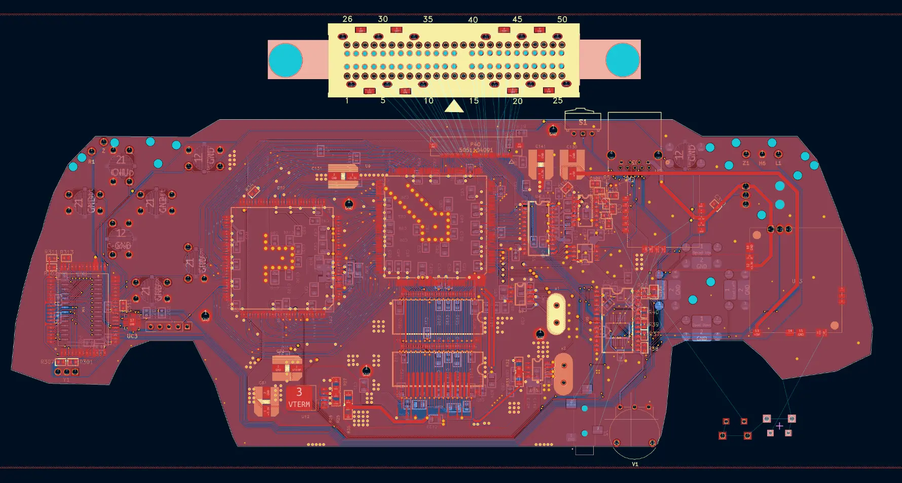

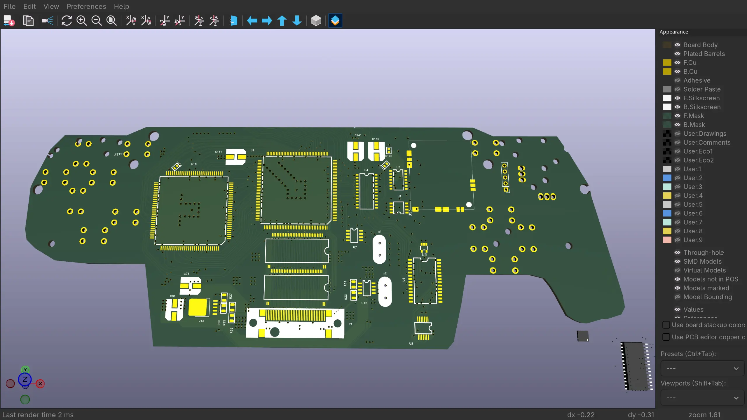

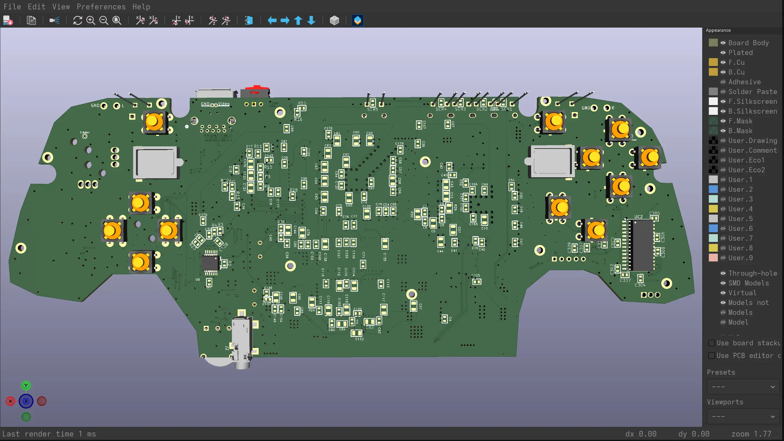

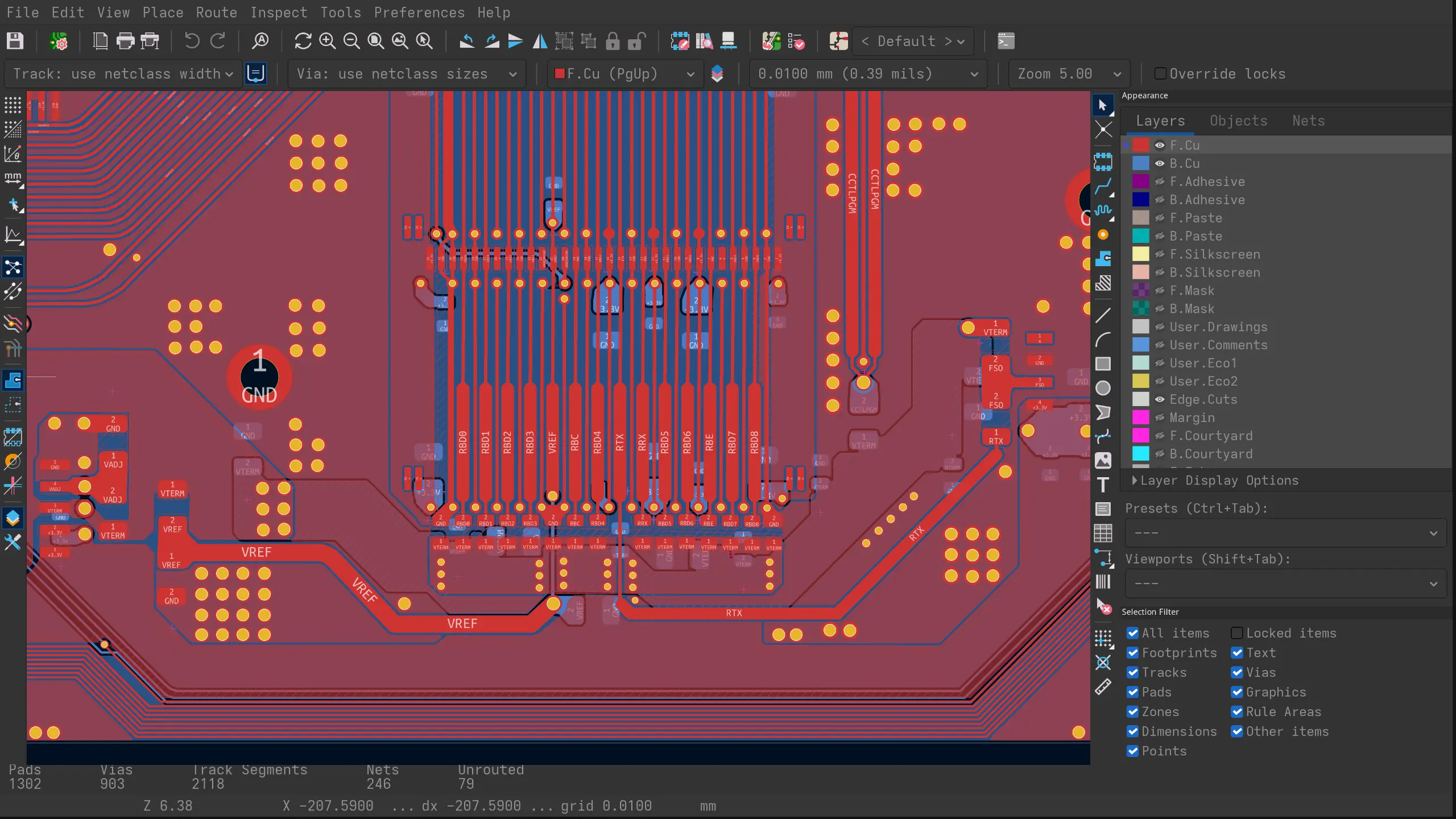

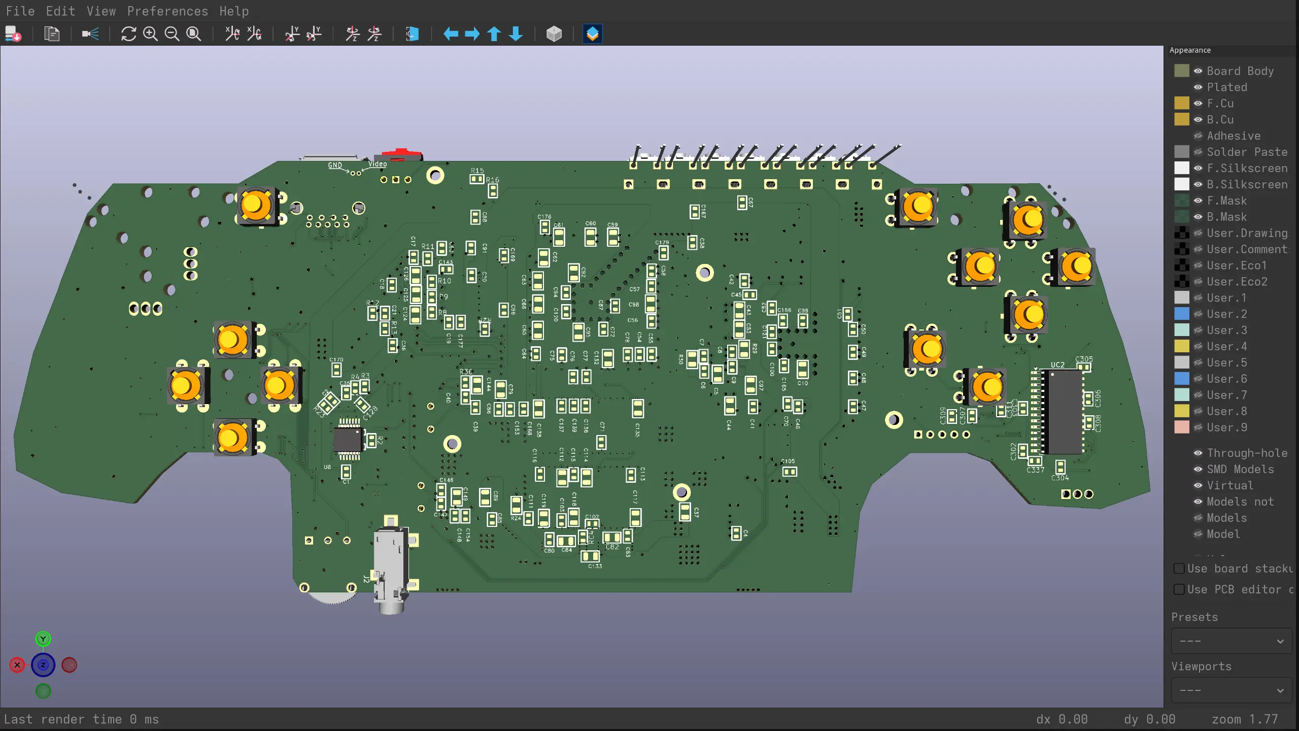

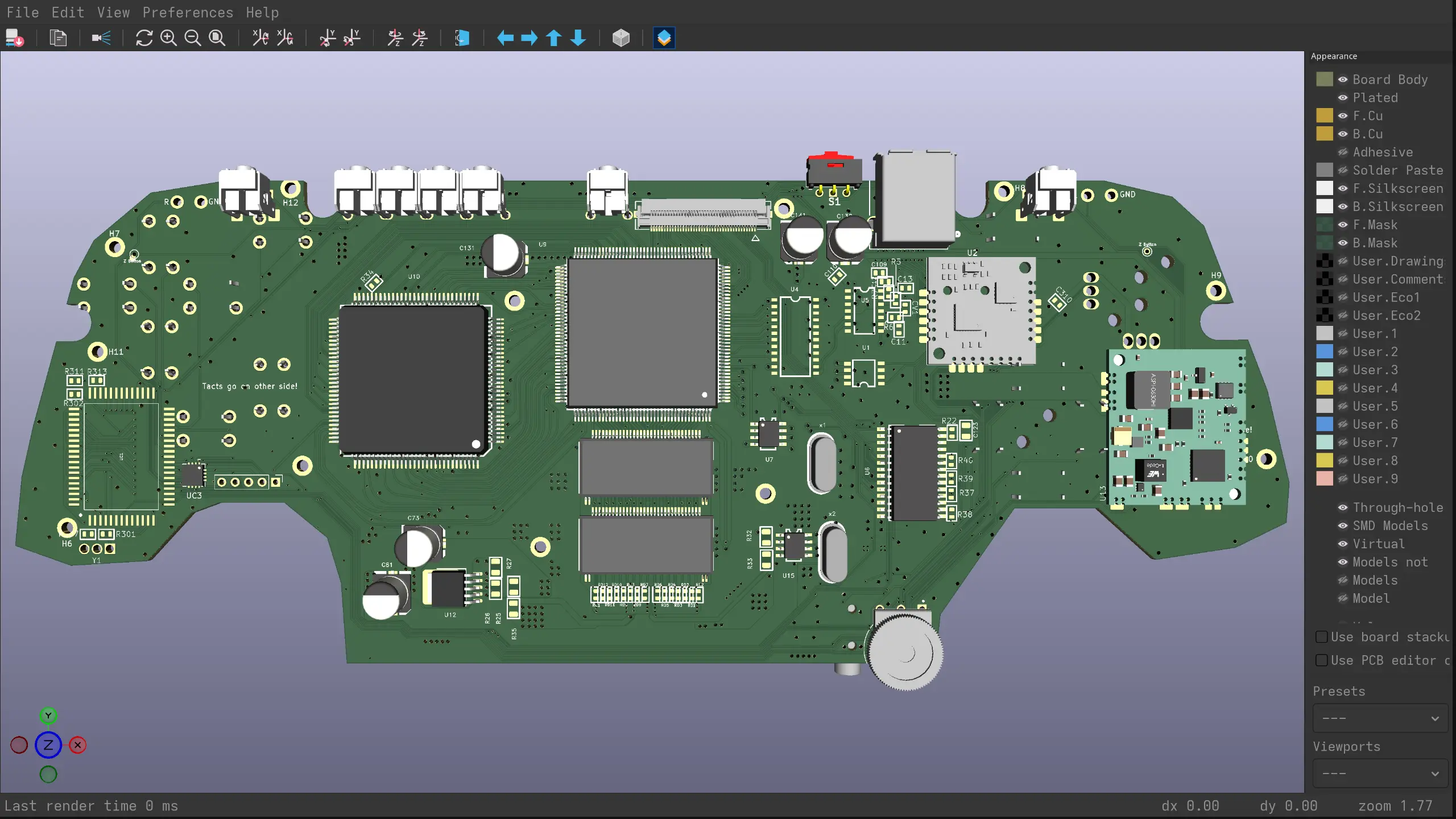

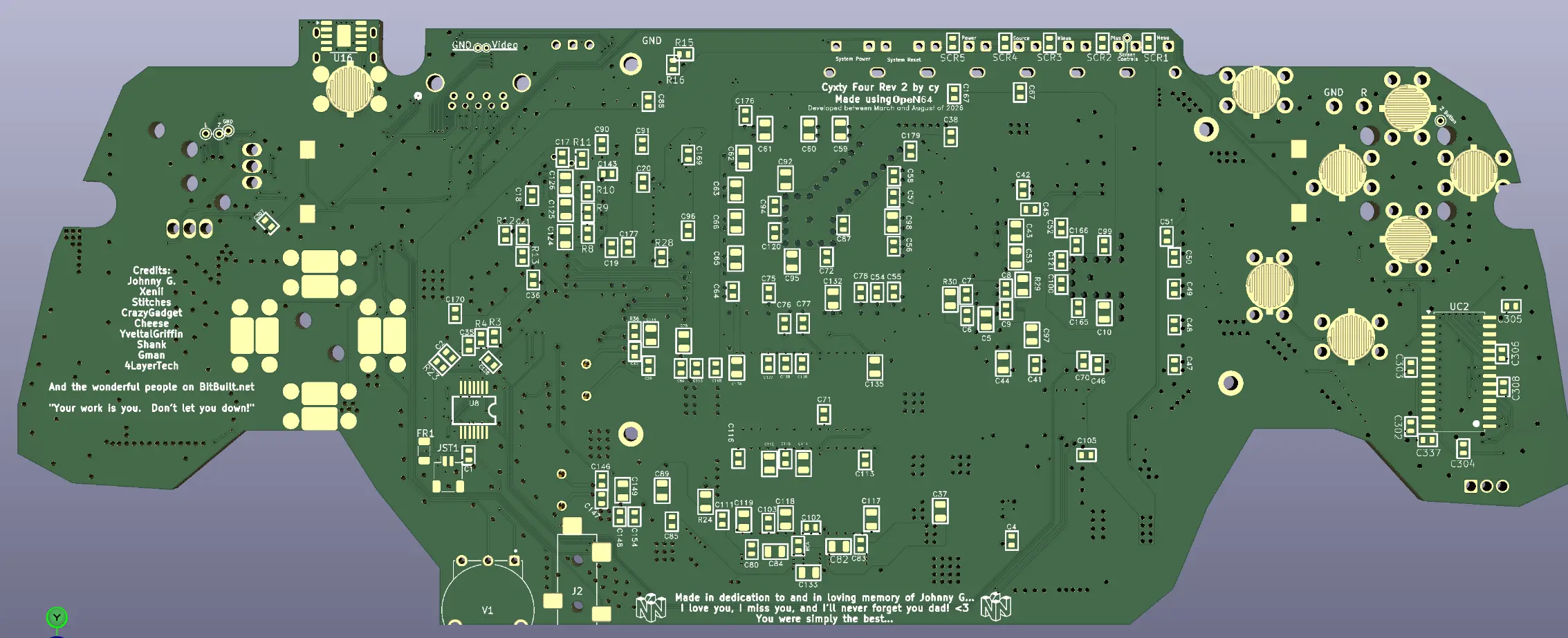

Since the last update, I've managed to route the FFC connector for the cartridge slot, the PIF, all the controls, the PMS, the U-Amp, and I've even managed to work in video out with a switch for the controller! I would like to thank @Shank for giving me advice on how I could avoid needing a secondary switch for video out. This could easily make the difference between video out happening and not happening at all!

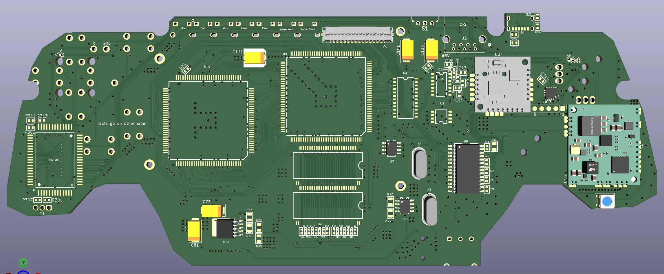

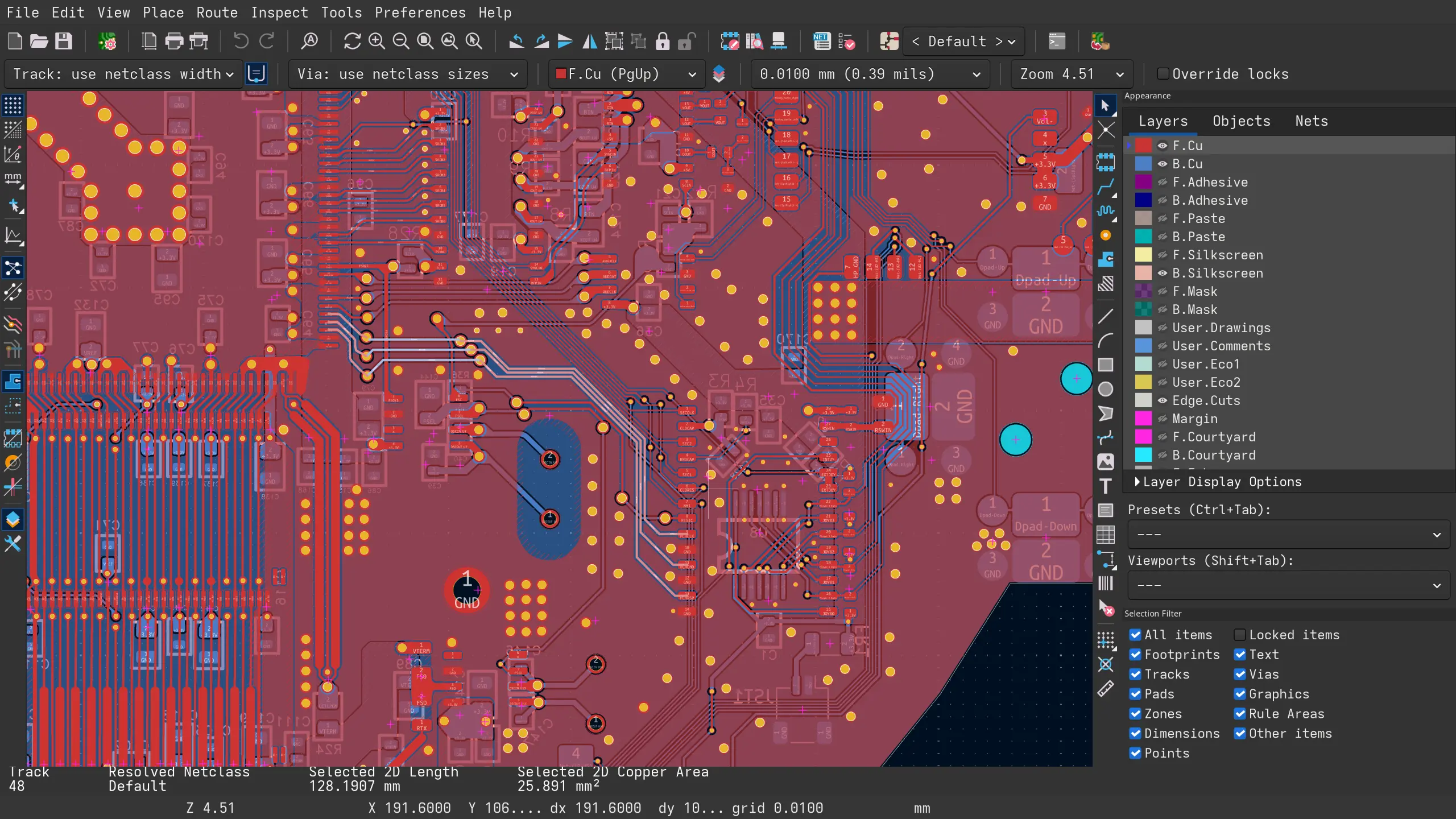

Here's a shot of the PCB in the 3d viewer:
The only things I haven't really figured out and routed at this point are the RGB LED (which... I may or may not include due to inconsistent wiring diagrams in the PMS2 that I expect may also be present on the N64 PMS), the USB-C charge port (which won't be included on this board, and will instead be hand wired), the speakers (which I may use spring contacts for, we'll see), and all the buttons (power, reset, screen power, other screen controls, etc).
I've been having troubles with my 3d modeling software, so I haven't made any more progress on the case design, but I'm thinking it's best if I finish routing this board first so I can account for the board's final shape, size, IO, and screw hole mounts.
I also still need to route the headphone jack, but I'm thinking I might start test fitting the board in software again before I go too much further with routing the IO. I want to design this board so it'll fit in the shell without me making the shell any bigger, but I also need to be able to fit everything on it. Normally it's best to design your shell around what your internals are gonna look like, but there are certain constraints the original Cyxty Four had that I wish to follow, so I'm still figuring the design approach out.
I also still need to get the resistors and capacitors in place so the RAM bus can be terminated properly. That shouldn't be too difficult however.
Hopefully I'm able to get my modeling software working on Linux again soon. I wish I could say the next update shouldn't be too far away, but my life has become very unpredictable and very unstable over the past 2 or so months, so I can't say for sure that'll happen. Either way, this is a huge step forward. It's safe to say most of the PCB design work is done at this point.
This is the Department of Unhinged Thermals & Defiant Engineering signing off.

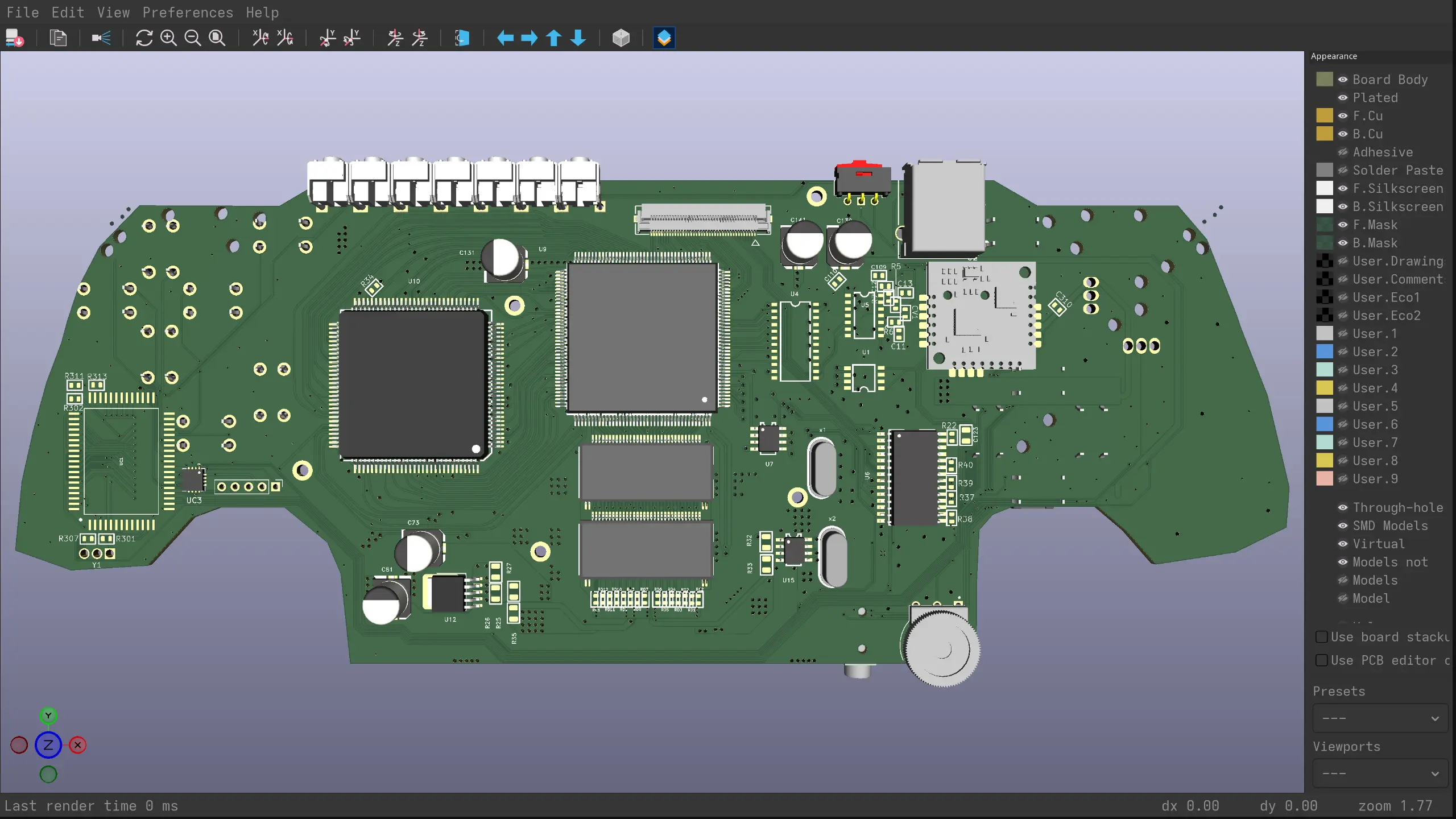

Time for a quick update. I terminated the RAM bus with help from @cheese @YveltalGriffin and @Xenii :
This took quite a while, and I needed to do some research to get it right. Yveltal was nice enough to share some documents for two layer routing on the RAM bus, and that helped a ton!

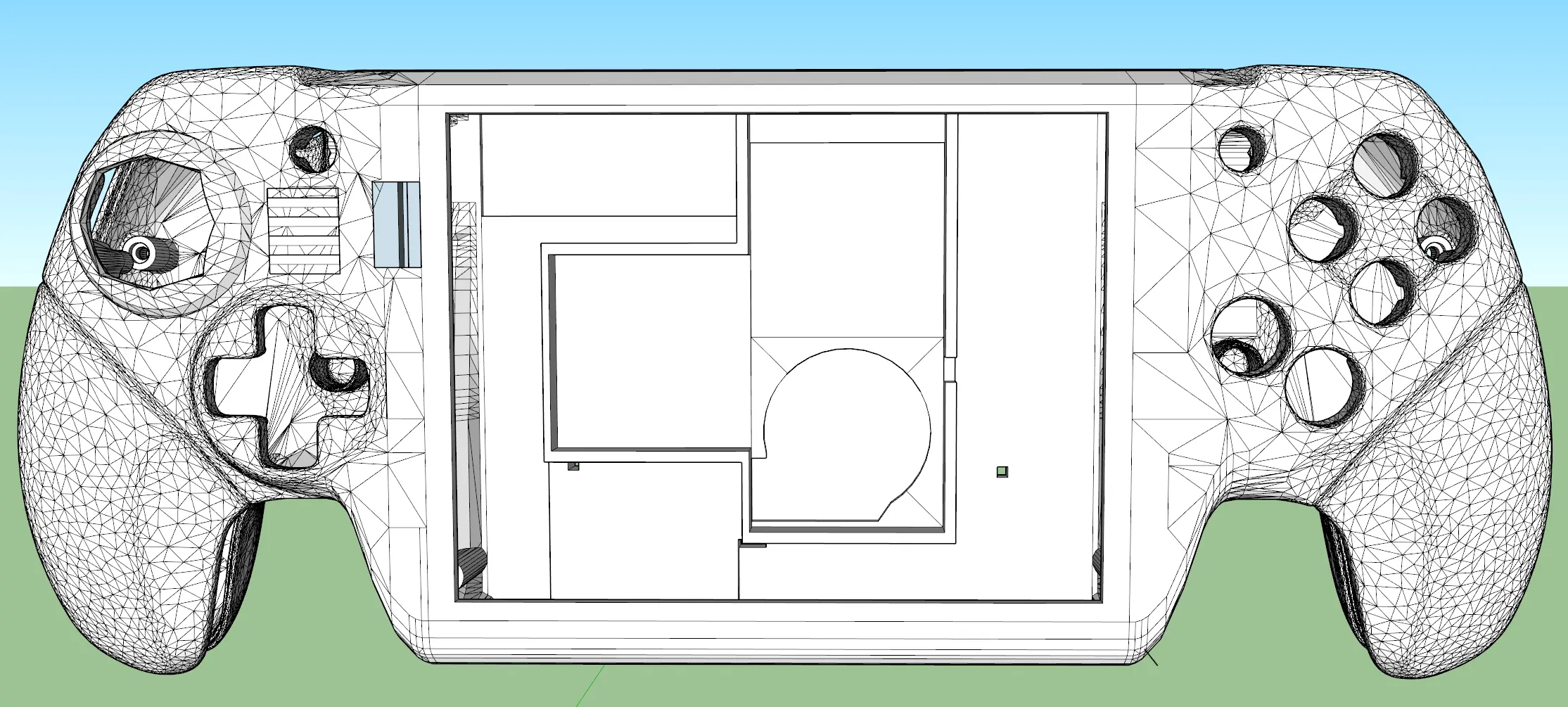

With this, it's time to seriously start looking at test fitting the PCB into the current shell design. So I populated all the important footprints with 3d models:
I want to thank Xenii again for providing me with models for many of the chips here. I also want to thank @Bubberiffic who was nice enough to 3d model a very accurate volume wheel neither of us were able to find or download a model for it (seriously, Mouser's website is terrible for downloading 3d models, it was completely broken).
With all of this, I spun up a VM with Windows 11 on it, got my modeling software up and running, and I started positioning the PCB in the shell to see how things were looking:

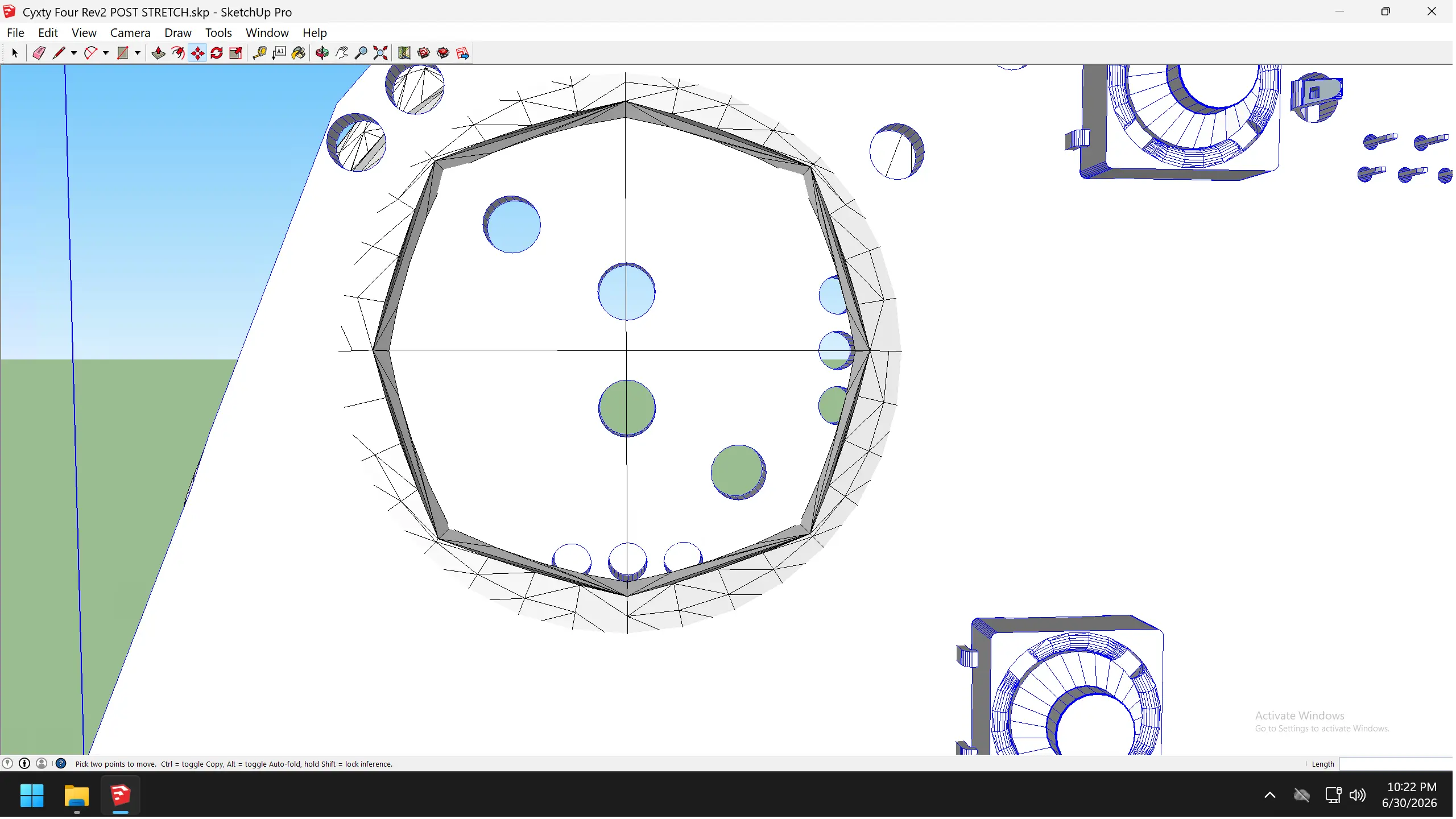

It took me quite a few adjustments, but after a bit I lined the tact buttons up for the controls. Not too sure how they became offset so many times when I was messing with this. The tact switches are also lined up with the button contacts for the membranes, so this helps with ensuring that the button membranes will actually be making contact.
As for the joystick...
I didn't manage/didn't care about finding a .step model for it since the holes here are perfectly centered and can be used as a reference for centering it. This should be pretty much dead nuts on as far as centering it goes, but I'll obviously test fit it with a 3d printed mockup of this PCB before I order anything up.

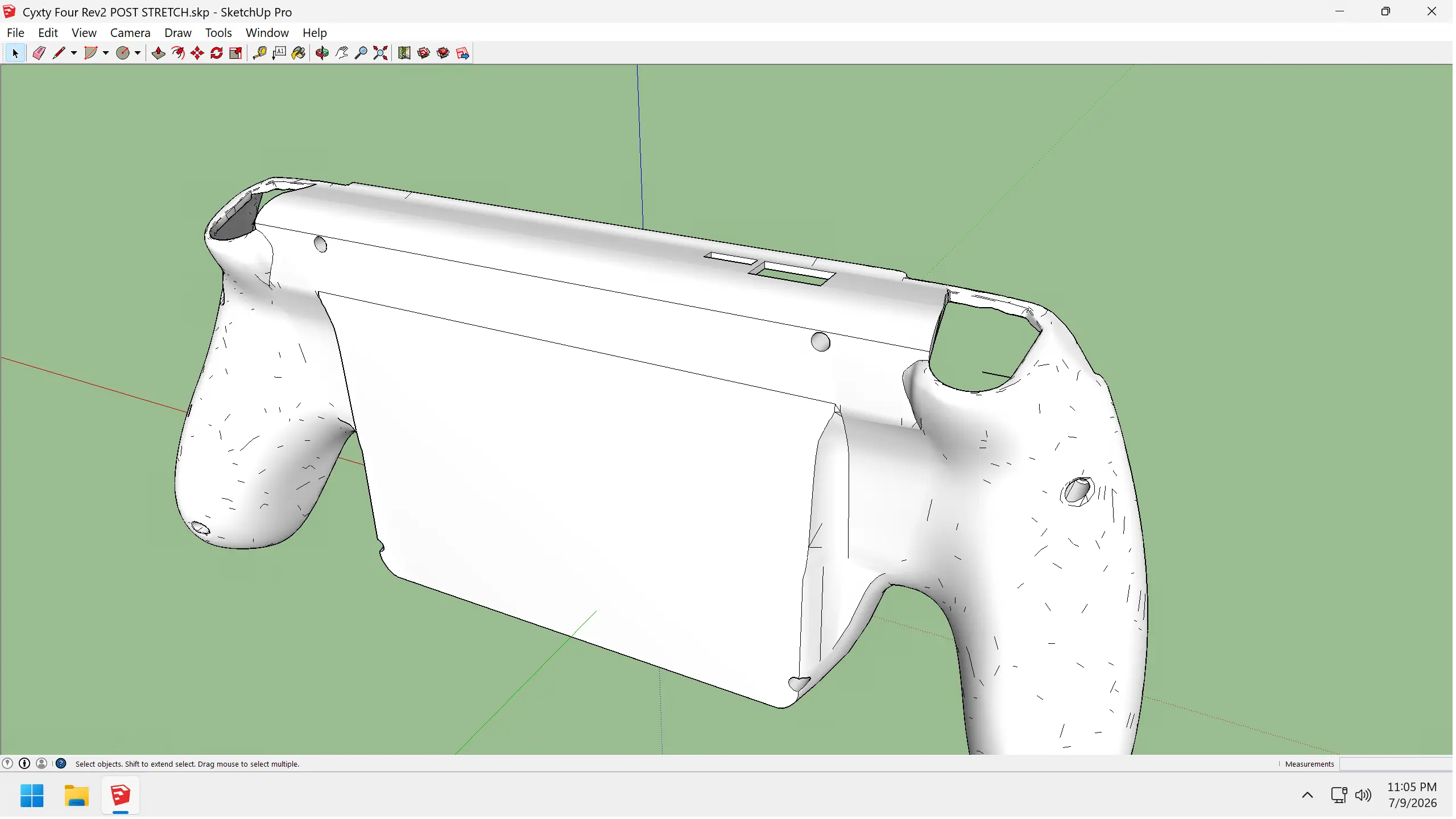

Time for a quick little update. I've gotten things into position to fit nicely inside the shell and I've re-routed it all accordingly:
I forgot to add the RGB LED, so I'll throw that in there, but I don't have any big plans with it. Probably just gonna slap it inside and call it a day Ashida style.

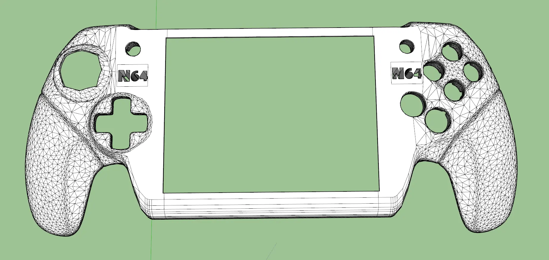

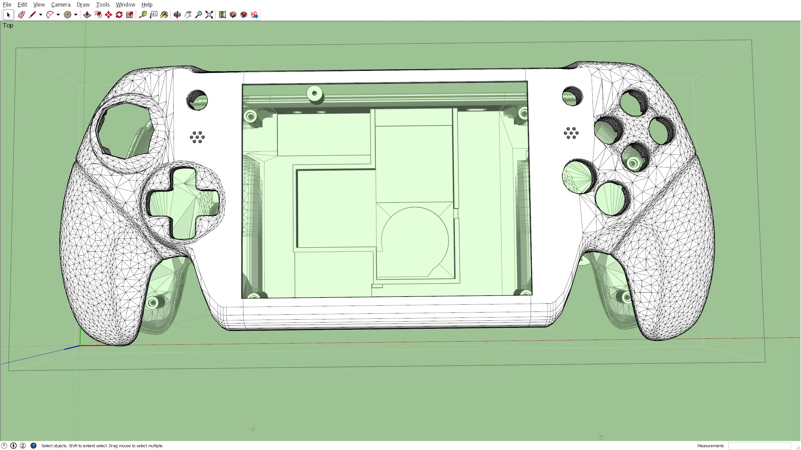

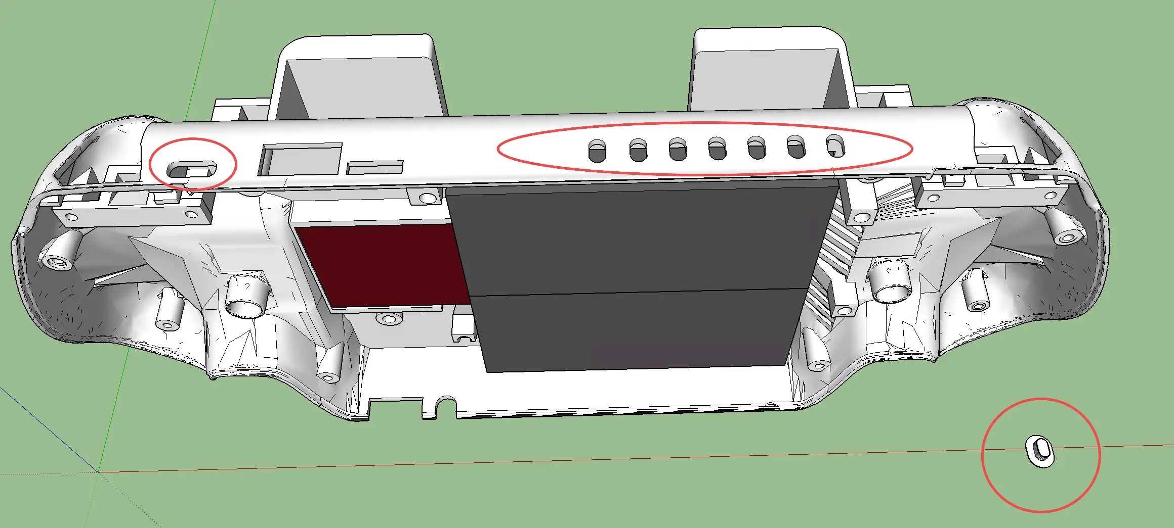

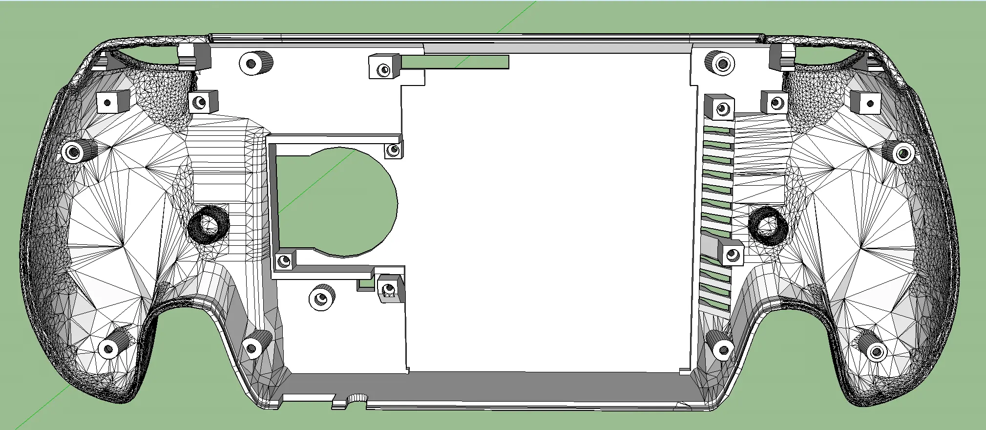

Since the last update I've done some good work on the case. The interior of the back is now hollowed out so I can work on designing the cooling system and working in the charge port:
I've got cutouts for the IO, although I still need to do the cutouts for the tact switches:
And I've also adjusted the geometry to accommodate the new IO while also cleaning things up nicely:
There's still quite a lot of cleaning up I'd like to do to this shell, I'm not sure if that's going to happen though. It's a lot of very difficult and time-consuming work especially in Sketchup 2014. There's certainly better software for this, but I don't feel like learning Blender just for this project when I'm gonna need to learn something like FreeCAD for the next one. We'll see where I am after I get the rest of the modeling work situated.

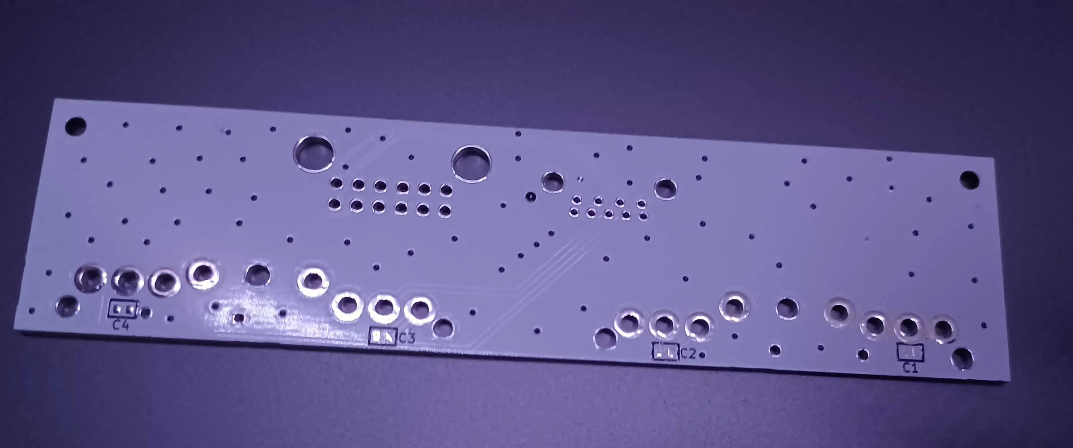

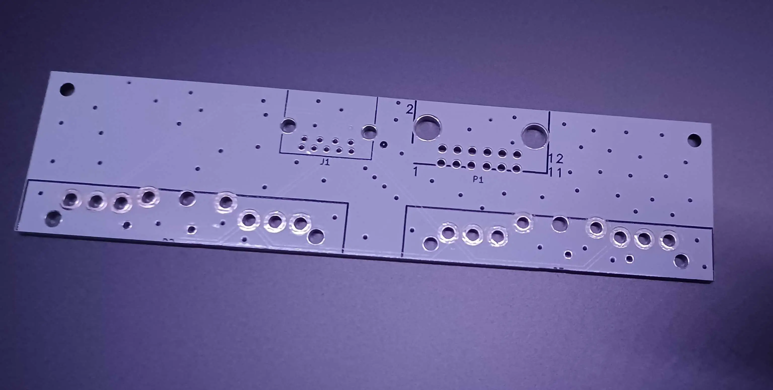

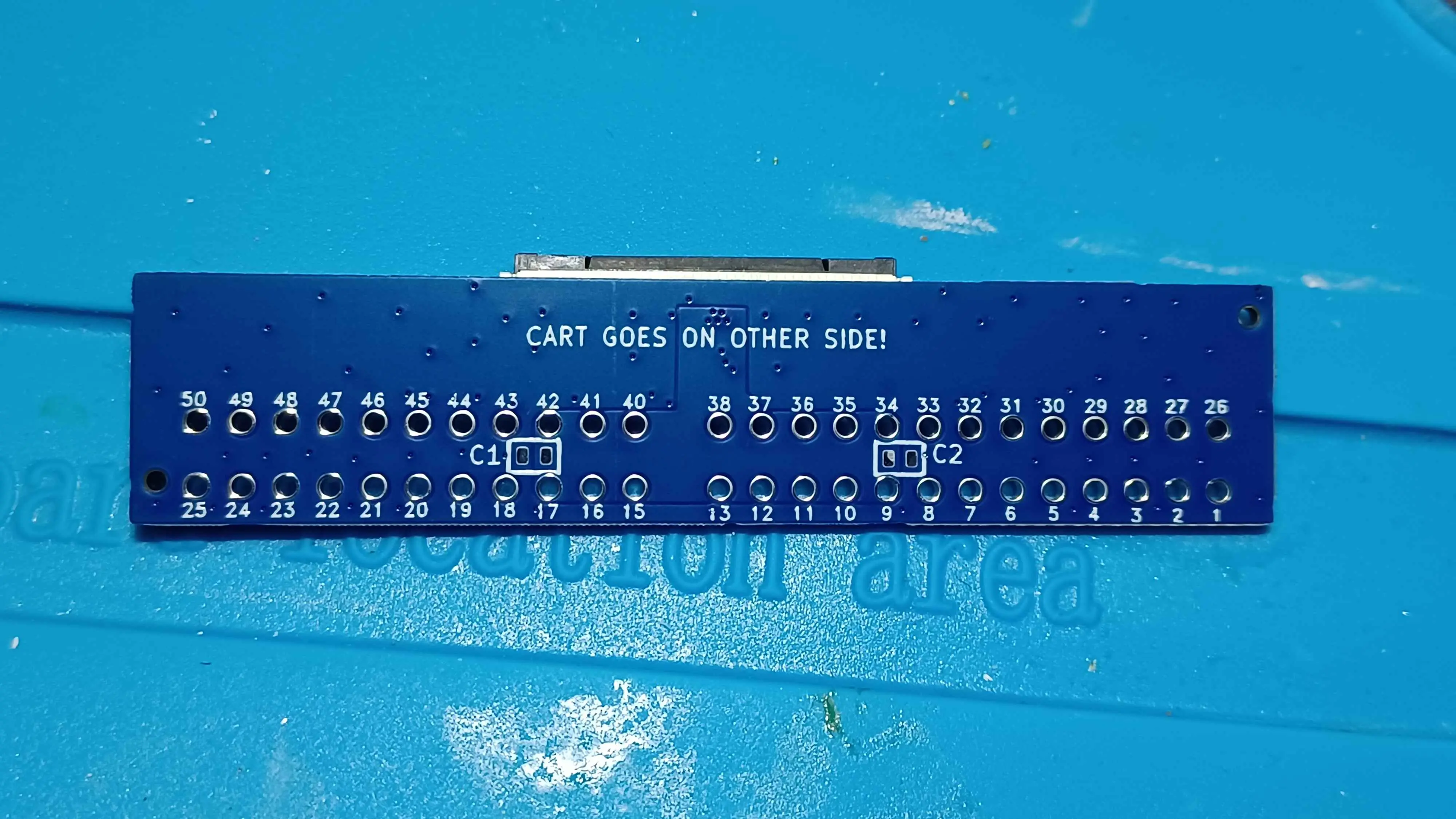

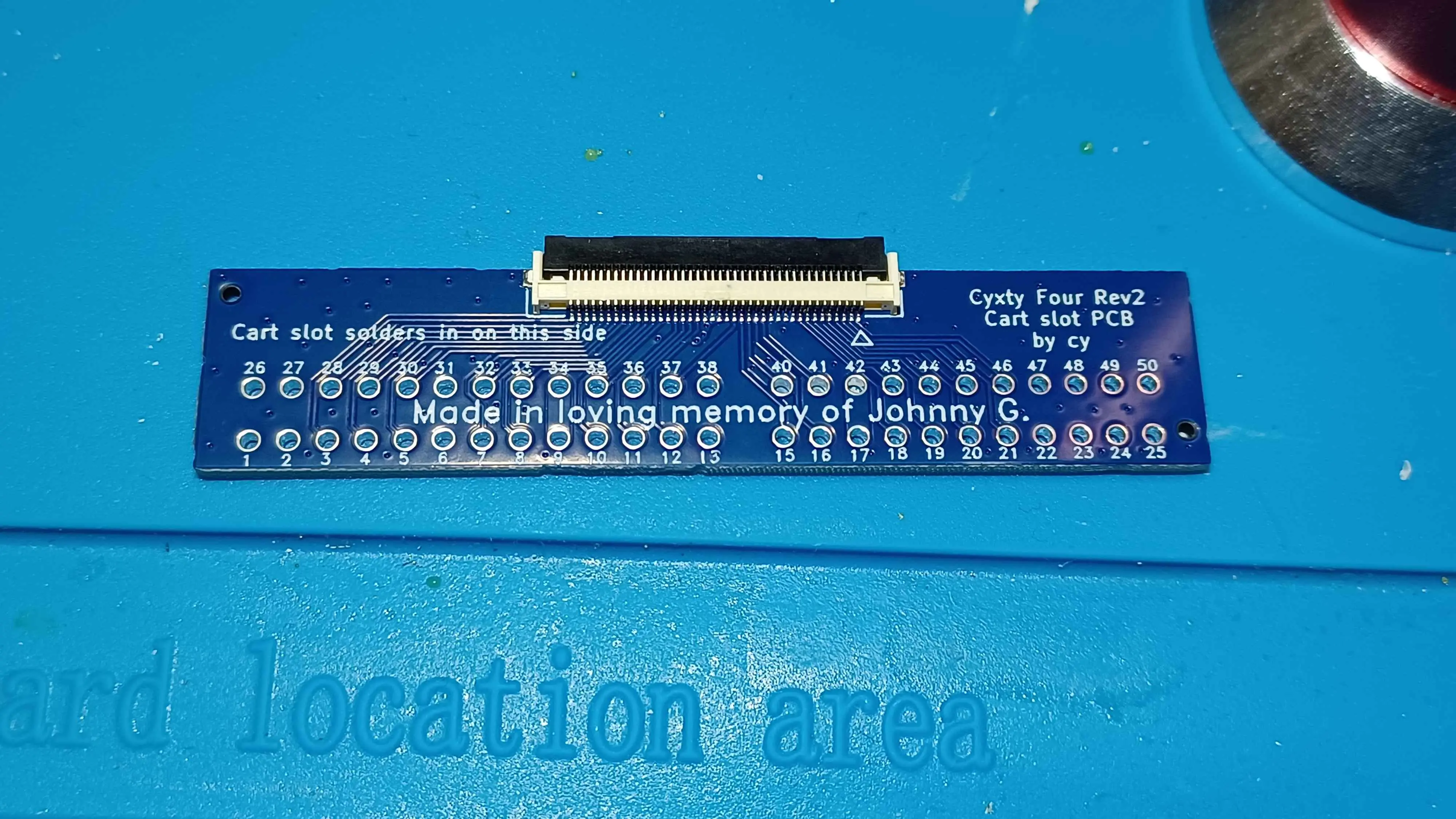

I'm gonna have to design a PCB for the breakout box as well as one for the cartridge slot, but that'll come in due time. That's stuff I'll be able to get together in like an evening probably. I might take a bit of a from working on this after this post, we'll see. Either way, lots of really good progress here!

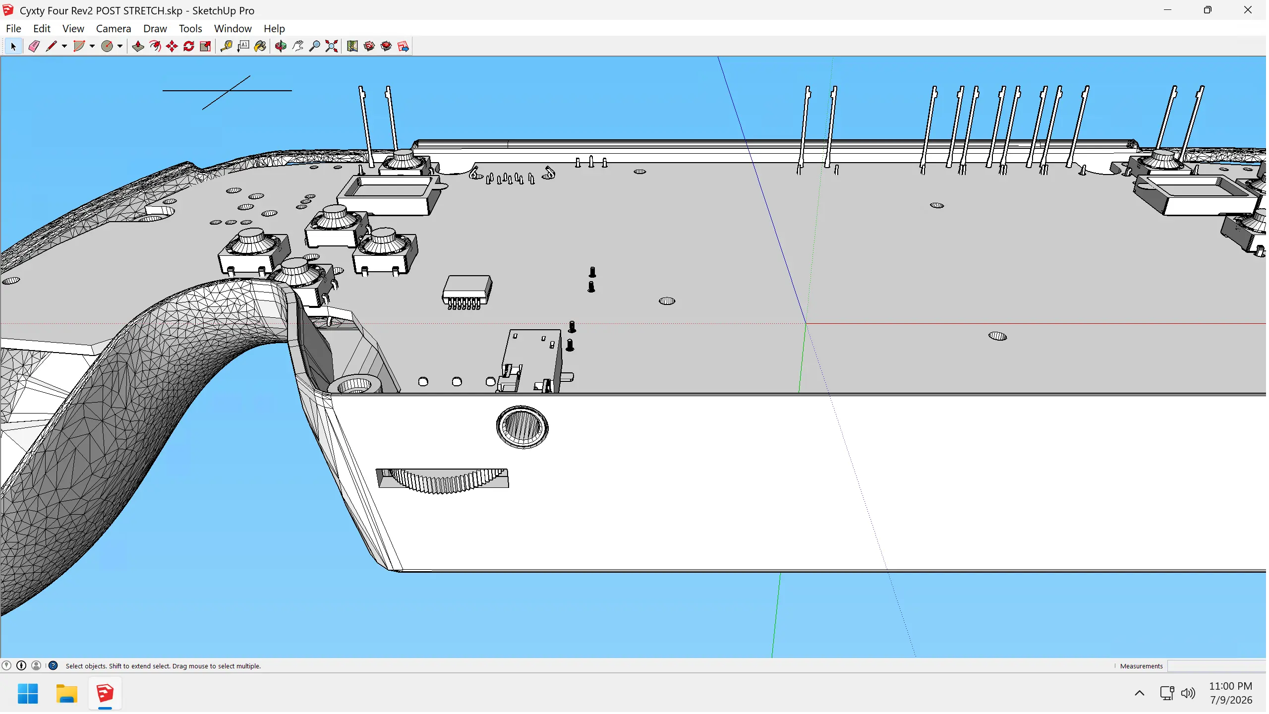

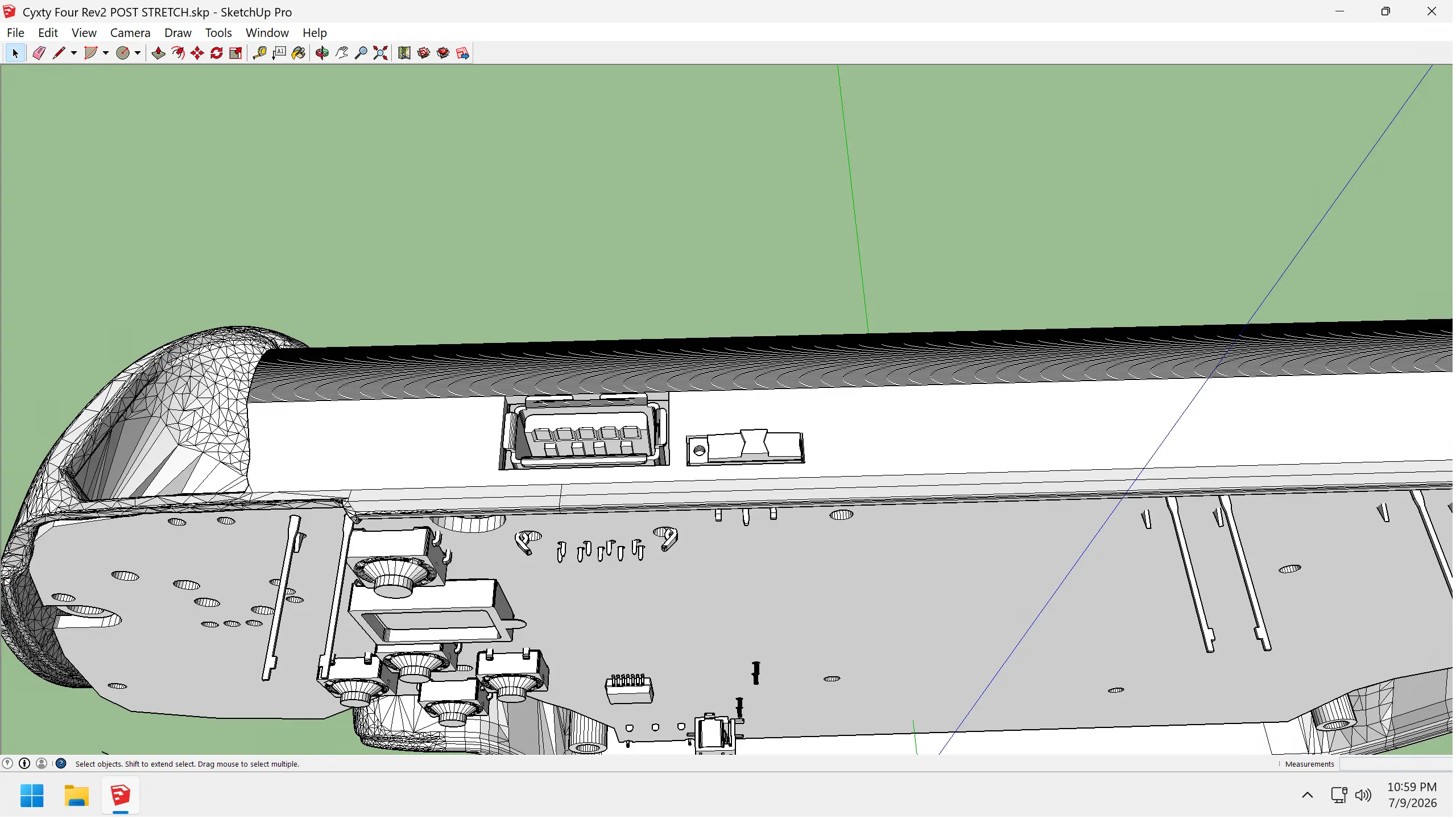

It's high time I post an update! Cyxty Four rev 2 has been coming along very well! The IO being routed on the motherboard (instead of under or above it like in most designs) has left me with a TON of extra room for cooling! It left me with so much extra room in fact, I came very close to trying passive cooling. I opted against this however as the N64 does get real warm, and rev 1 having a fan was definitely something I did right. So after much deliberation and a ton of fiddling with the design, I settled on this:
This design uses two MASSIVE 80*40*11 aluminum heat sinks. Together they're just under 30 grams, so they're surprisingly light for their size! I've got them colored gray and the fan colored red in this screenshot just to give an idea of how they're supposed to sit in here:
I already covered how this build was redesigned to work with brass inserts, and that's visible on the interior where I intend to mount the motherboard. But this does have additional design implications as I want the back that holds the cartridge slot to also use brass inserts. I also needed to rework the positioning of the screw posts as in revision 1 of this build there was plenty of extra space for them. Not so in this revision. Eventually I settled on this:

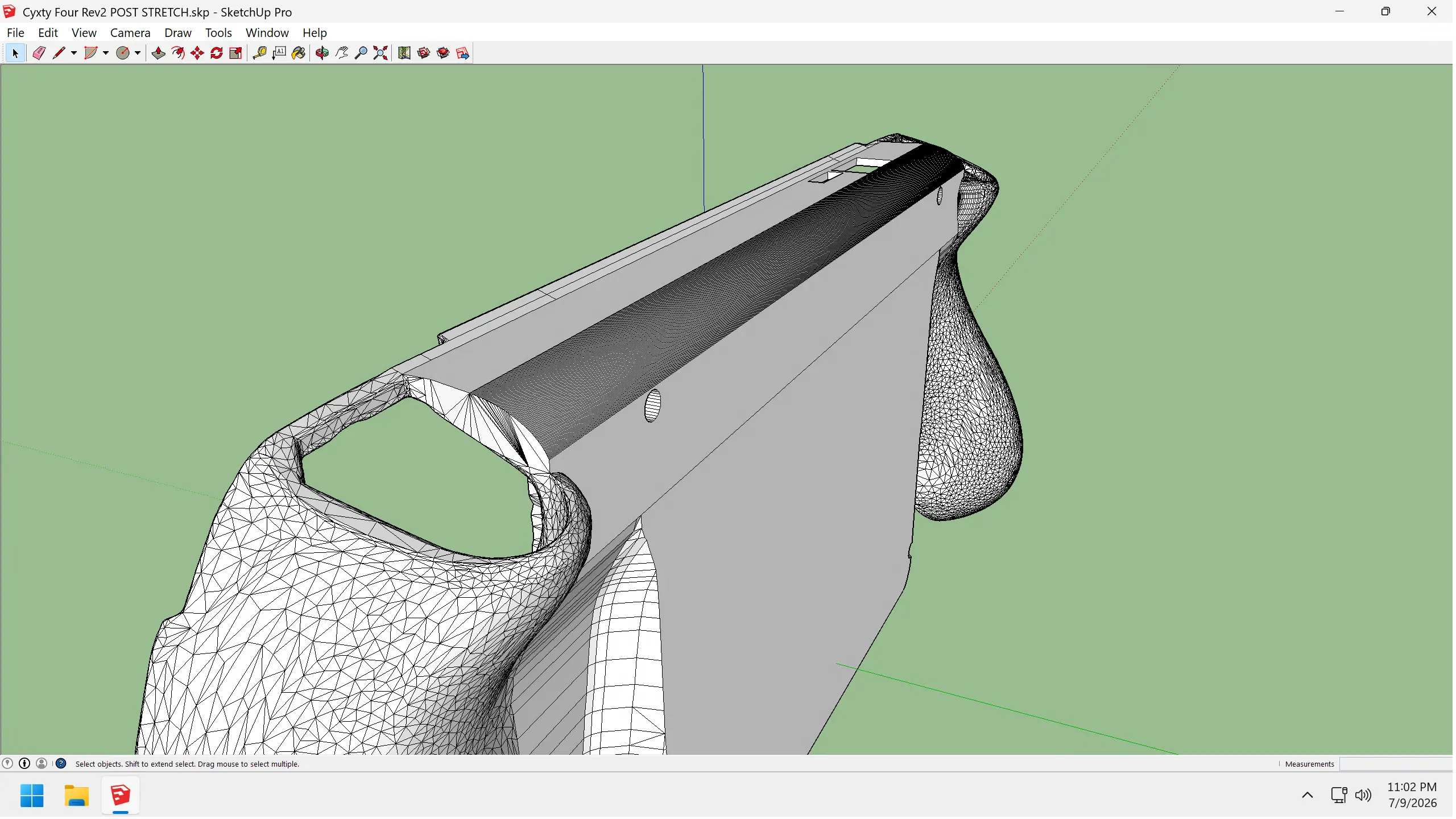

Here it is with the cart slot holder:
Something I'm only now realizing is that the ribbon cable is going through the top back in that little cutout, and while that's acceptable and will be obstructed when a cartridge is in the console, I really don't want it to be visible in the final build. So I'll be modifying the cart slot holder to better cover that up. I might go for something that exposes the cartridge a bit more beyond just the label might give a bit more venting room for the fan, we'll see.
Along the edges you can see the fan intake and exhaust:
I'm aware that this positioning of the intake and exhaust may end up blowing warm air towards the user's hands, although I'm not terribly concerned with this. I can always rework this if it becomes a nuisance like Subierekt in the BitBuilt Discord.

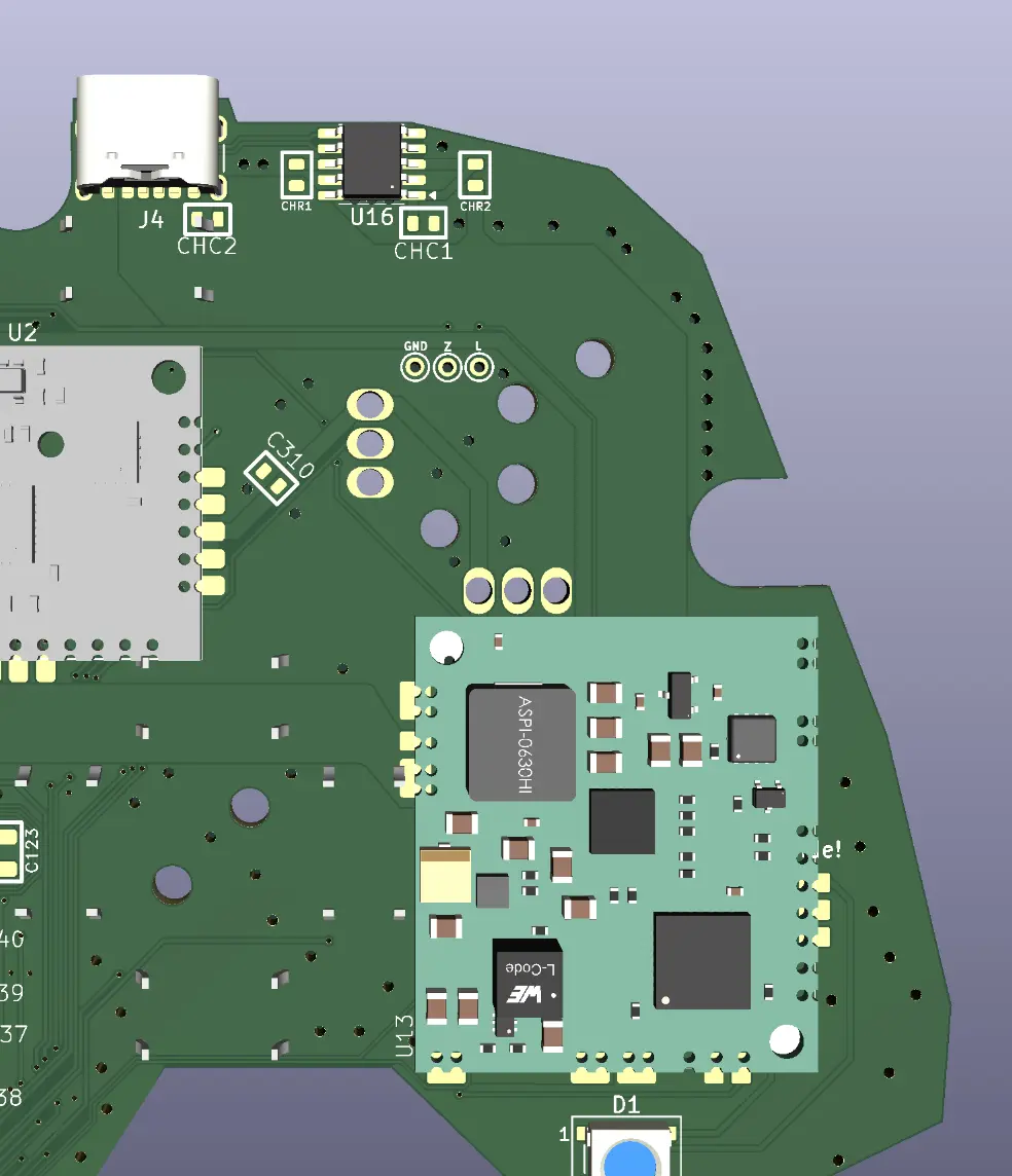

On a more positive note however, I've gotten USB-C charging onto the main motherboard! This is a huge accomplishment since it saves two big wires, an ugly mounting solution, and it'll make the entire unit even more serviceable!
At the bottom, you can kind of see D1 which is an RGB LED for the N64 PMS. It's just kind of tossed in there as a battery indicator. I'm expecting it'll shine through the back, or you'll be able to see it through the cracks enough to tell how charged the unit is. I wasn't too keen on trying to work in a light pipe into this design, so I figured this would work in a pinch.
Working in USB-C charging did mean drastically reworking a bit of the design however. I re-positioned the side mounting tact switches to all be in line with one another, and I also made and lined up a cutout for the charging port. In the bottom right, you can see the tact switches that'll be printed separately allowing you to color code power, reset, etc.

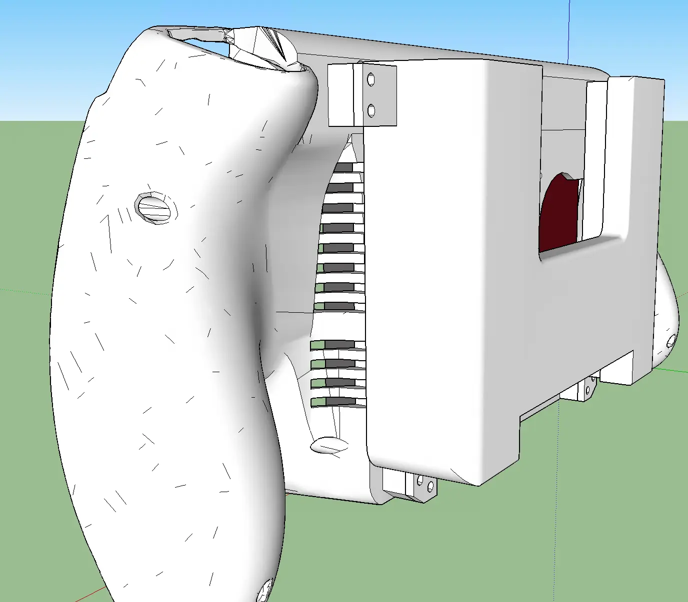

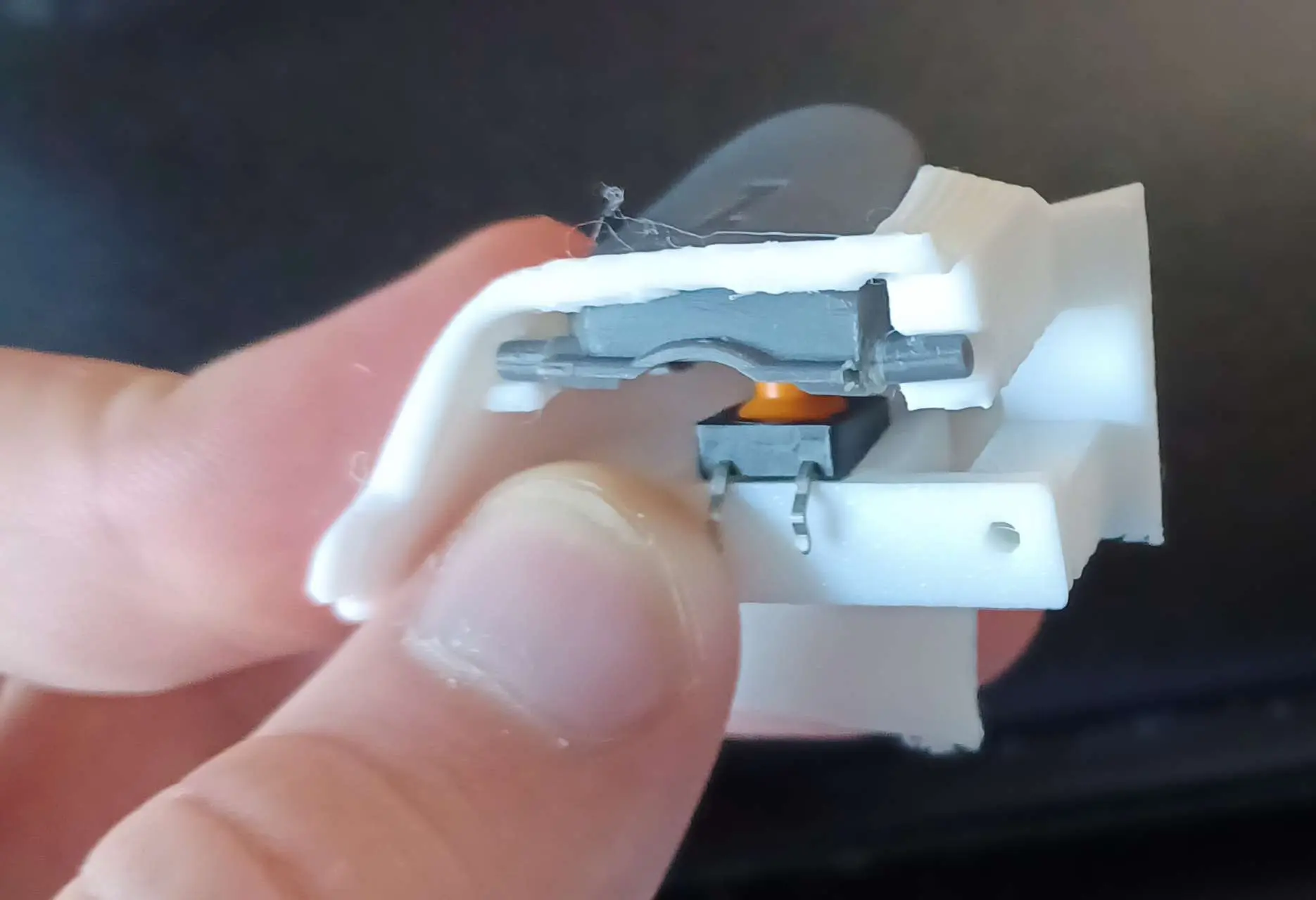

I also recently finished reworking the Z triggers! I've got a mount and a 3d printed cutout section here to demonstrate:
The switch mounts with a friction fit, and the Z button hinges and actuates perfectly on it! It took a bit of fiddling to come up with this, but the bracket works for both the left and right Z triggers and the tact switches that go with them.

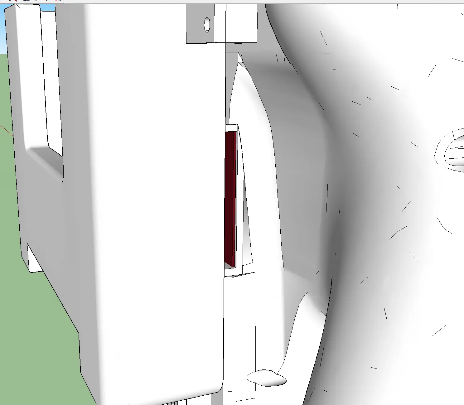

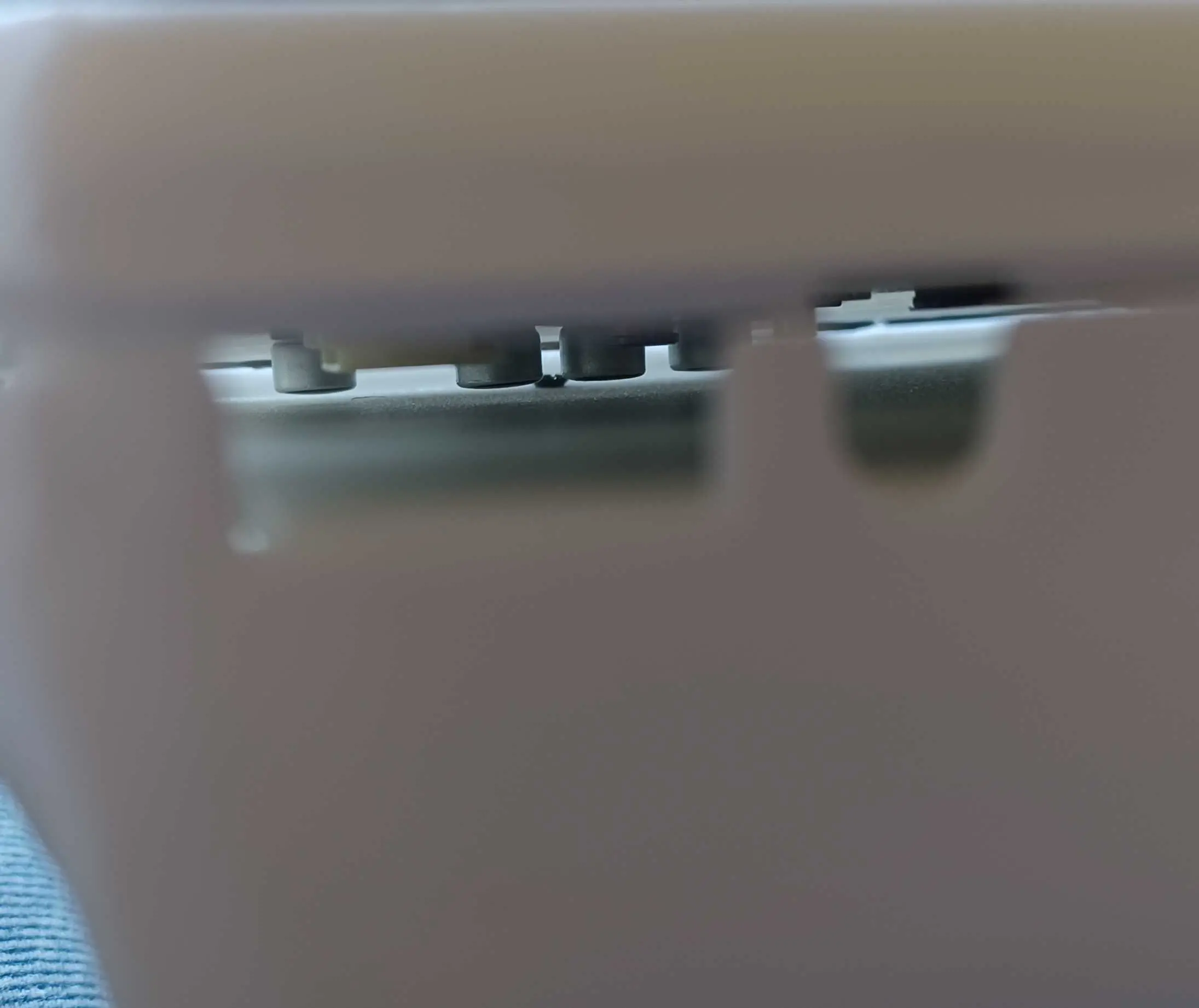

Not too long ago, I did a bit of a test fit of the buttons and the speakers with an iterative test print I did of the front shell:
The C-Left button (the C button on the right that's making out with the speaker) JUST BARELY clears the speaker! It clears! But JUST BARELY! This really goes to show the sorts of constraints I'm working with in this build. It's really been a challenge getting everything this far! And even with all of that, I've still got quite a lot of work I need to do before all is said and done. I've got the first new iteration of the back printing on my printer now, and soon enough I'll be printing a mockup of the motherboard to help with verifying that everything should line up the way I expect it to.

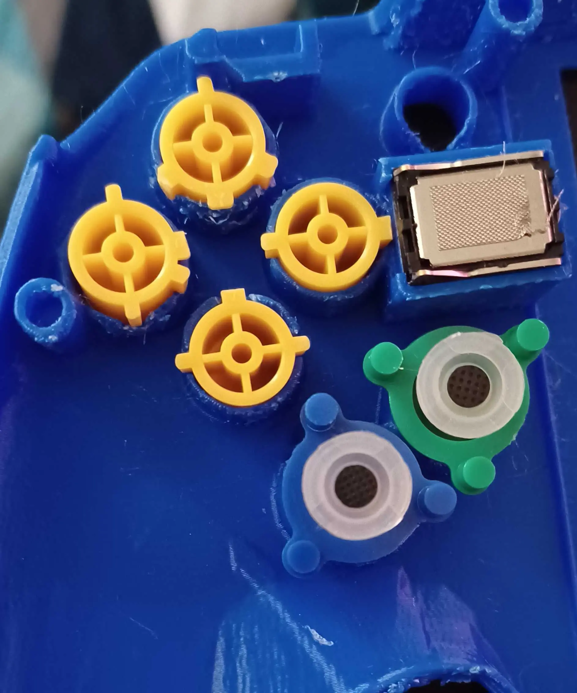

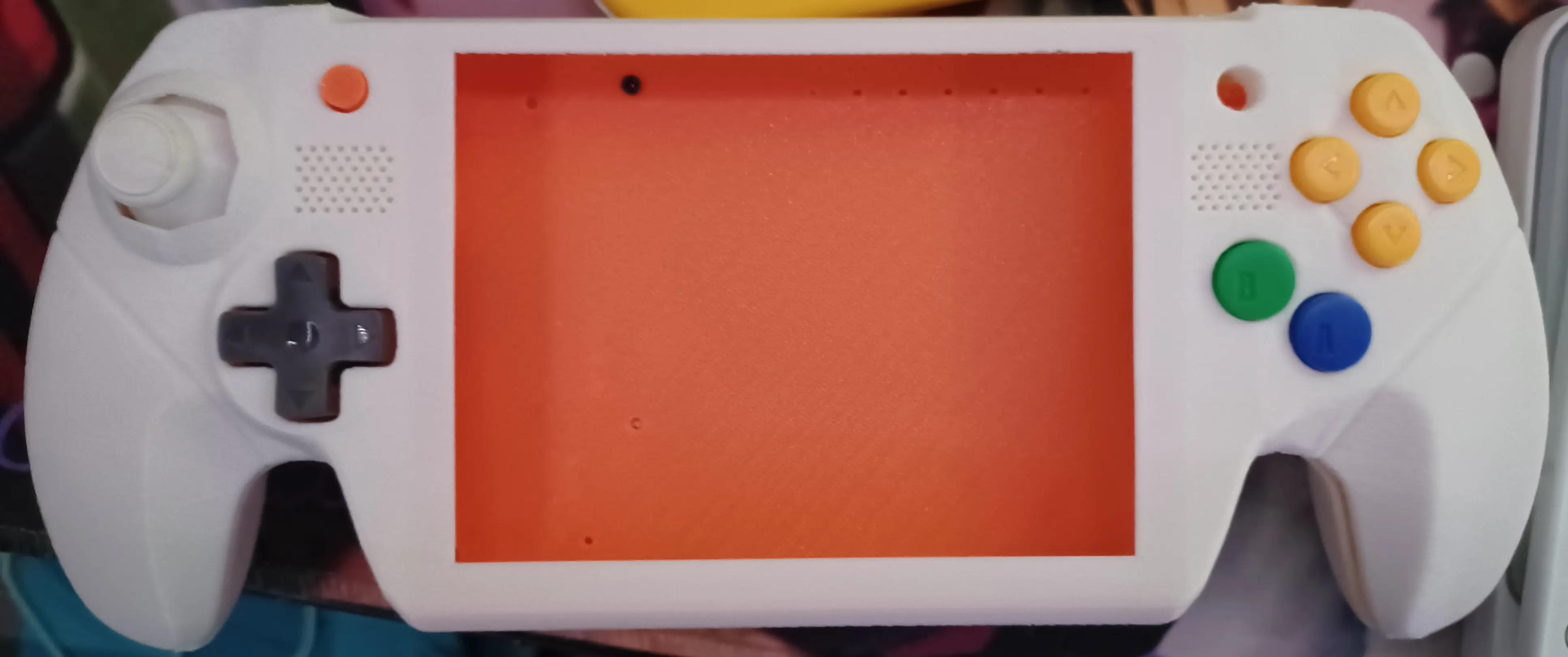

I've been test fitting the buttons:
Everything feels good to press! I had to model and print my own pause buttons due to how far down the original pause buttons want to go. At some point it'd be good to have 3d models of all the buttons and Dpad. That was one reason I bothered with the tact switch mounts on the motherboard - I don't want anyone who builds this to NEED to buy an original Brawler controller for parts. It is very nice having all original brawler buttons though!

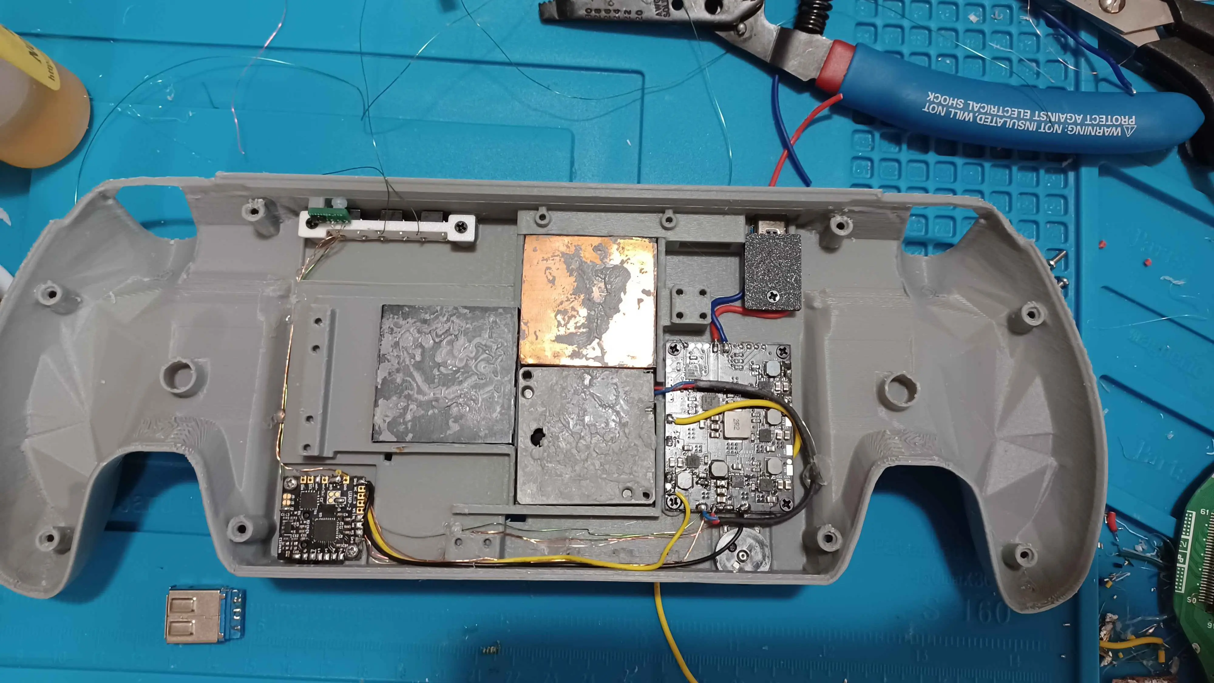

This is what the inside of the case looks like with the screen driver board, motherboard, and essentially everything that could cause any clearance issues in the case all in position. The screen driver board wasn't mounted properly for this test fit, and is hanging down a decent bit. So I'm expecting it might have an additional milimeter or two of clearance. Hopefully this picture gives an idea of just how tight the fitment of everything in this build is though. Aside from the handles, there really is almost no wasted space! The picture I posted in my last post also illustrates this well with how the C and B buttons almost don't clear the speaker!

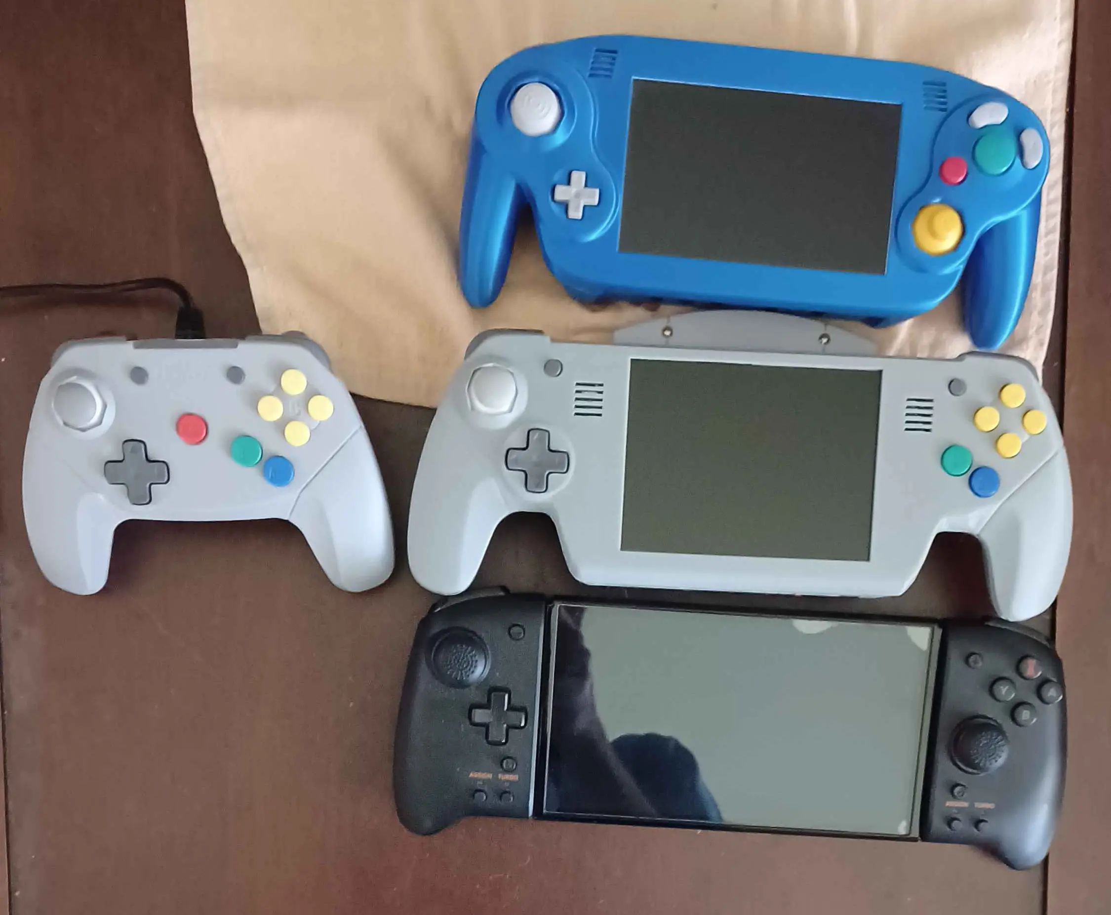

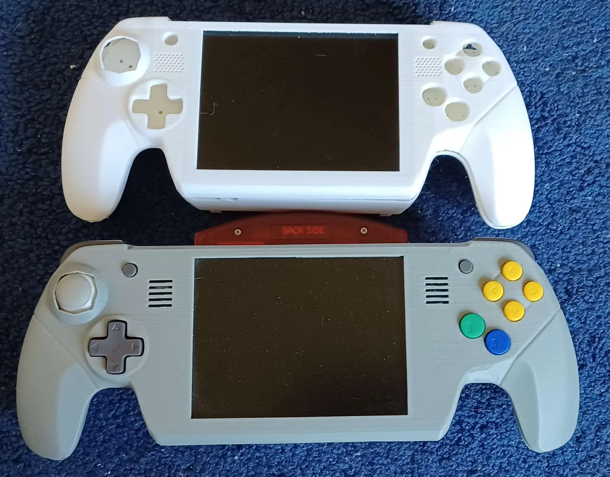

I've also got a picture here that compares this revision of the build to the original:
The AIO motherboard in this project isn't strictly necessary to get this build down to the size it is now, but it helps a heck of a lot, and I believe that through it, the internals will be about as streamlined as a 2 layer AIO portable N64 board design can be (or at least close to it!). And honestly, getting the build down to this scale with good old fashion board trimming would be difficult and probably would require a lot of practices that I personally wish to avoid.

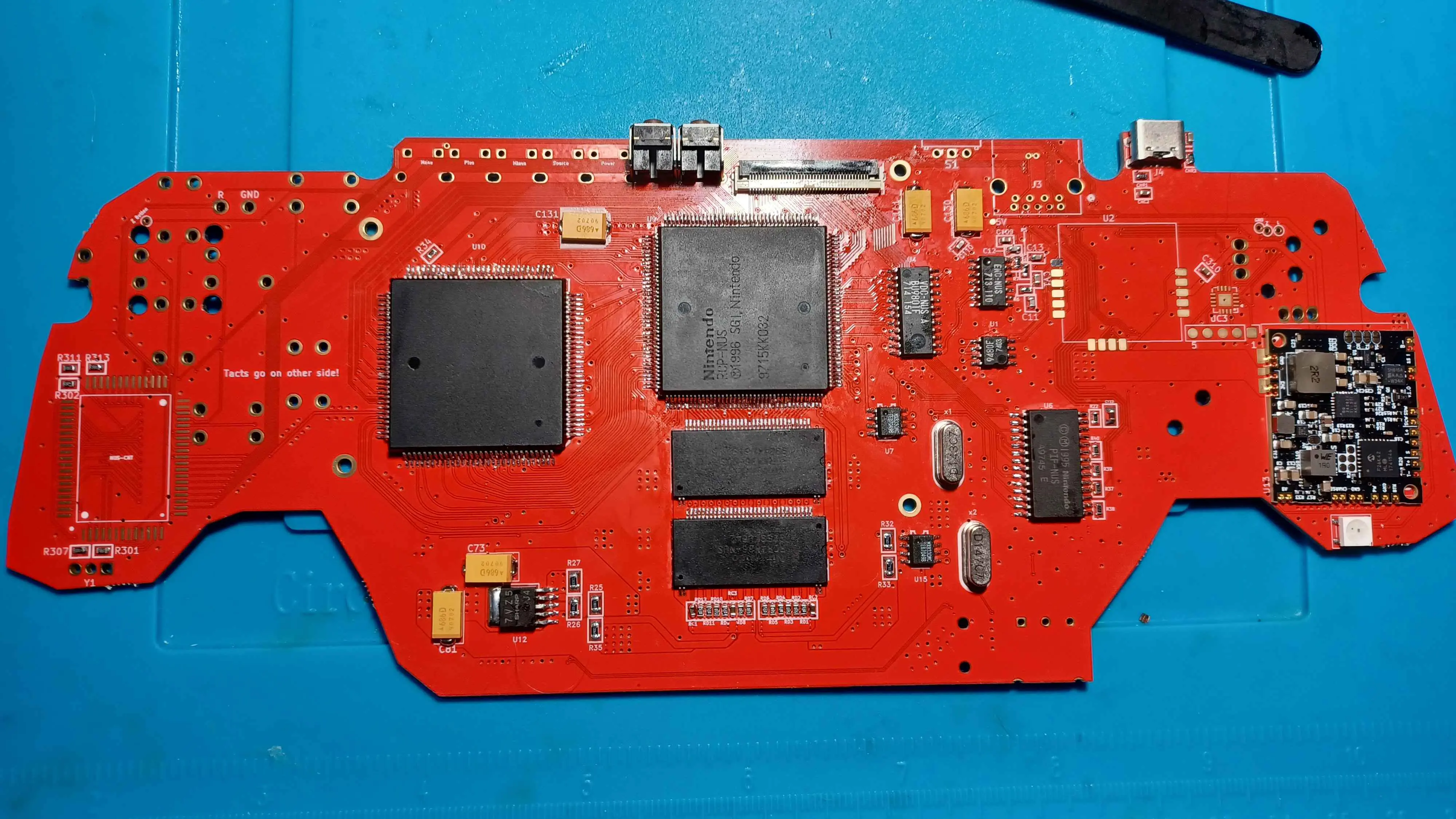

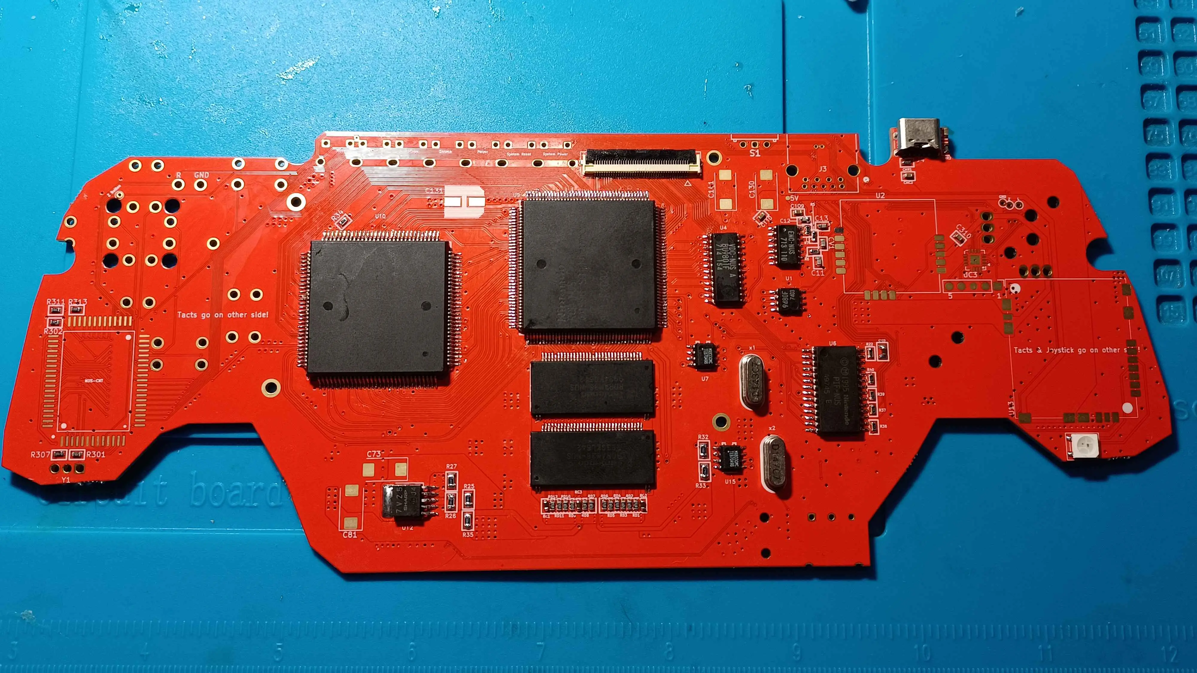

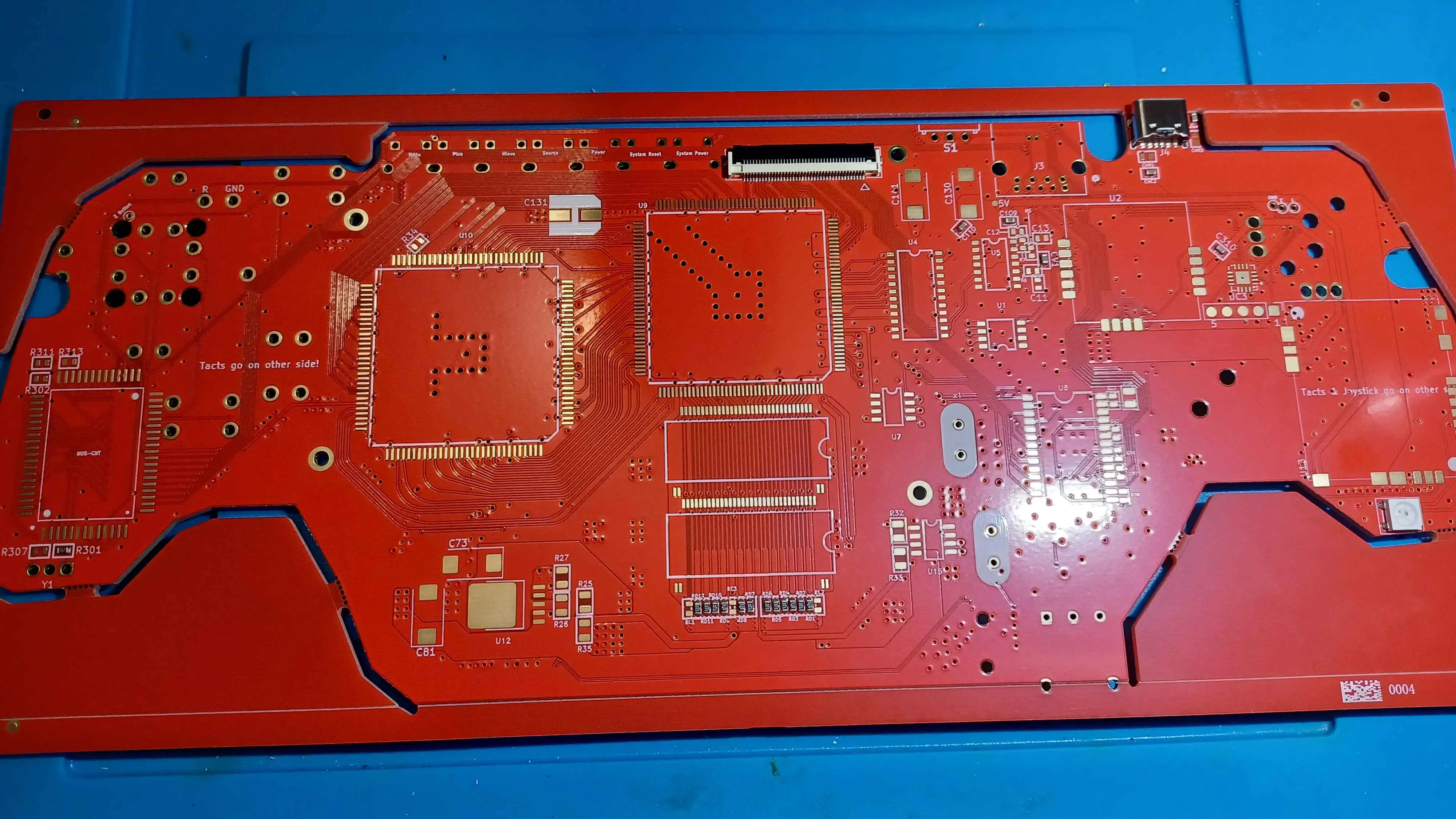

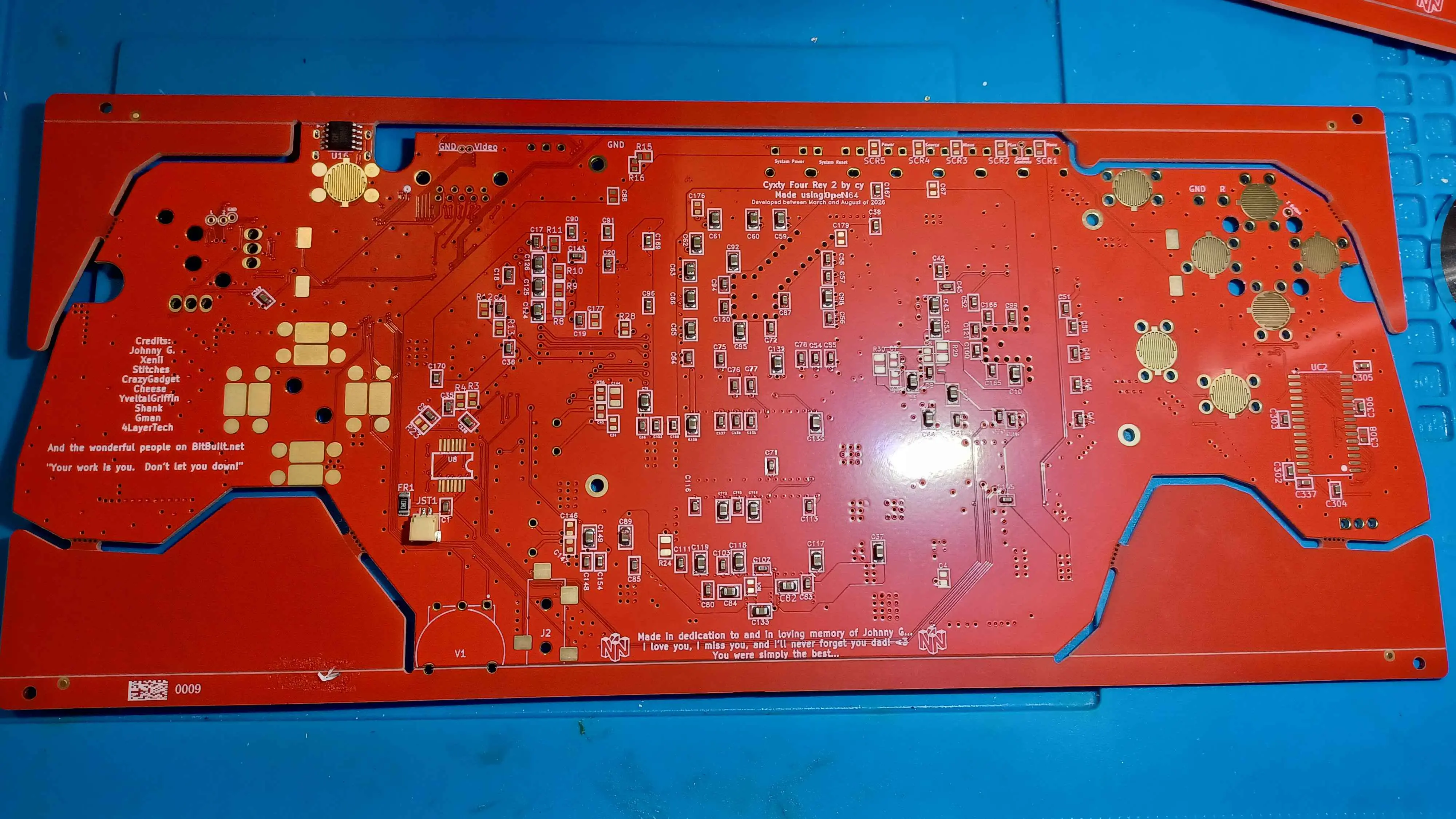

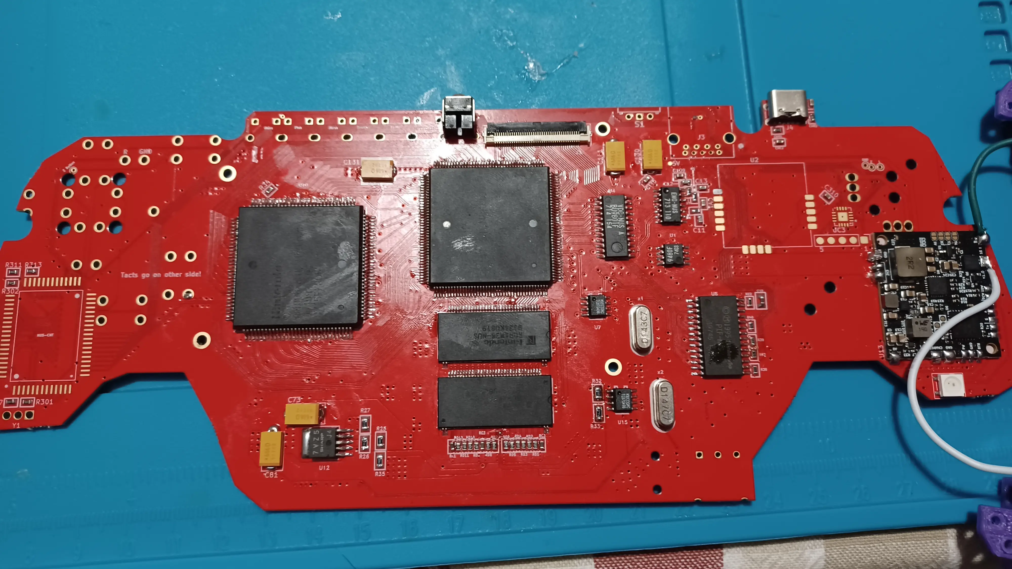

It's update time! The boards arrived in the mail:
This was my first time ordering in white and blue from JLC. I thought a nice red, white, and blue color scheme would be nice for this. As you may have noticed, I opted to have the motherboard partially pre-assembled by JLC. Doing so was a bit pricey, but it saved a ton of time, and it ultimately made a lot more sense due to there being some components I didn't already have. And so began assembly work... I went ahead and finished populating the back of the board (I forgot to get a photo of that, but it's really not all that spectacular). And I slowly got to populating the front of the board:

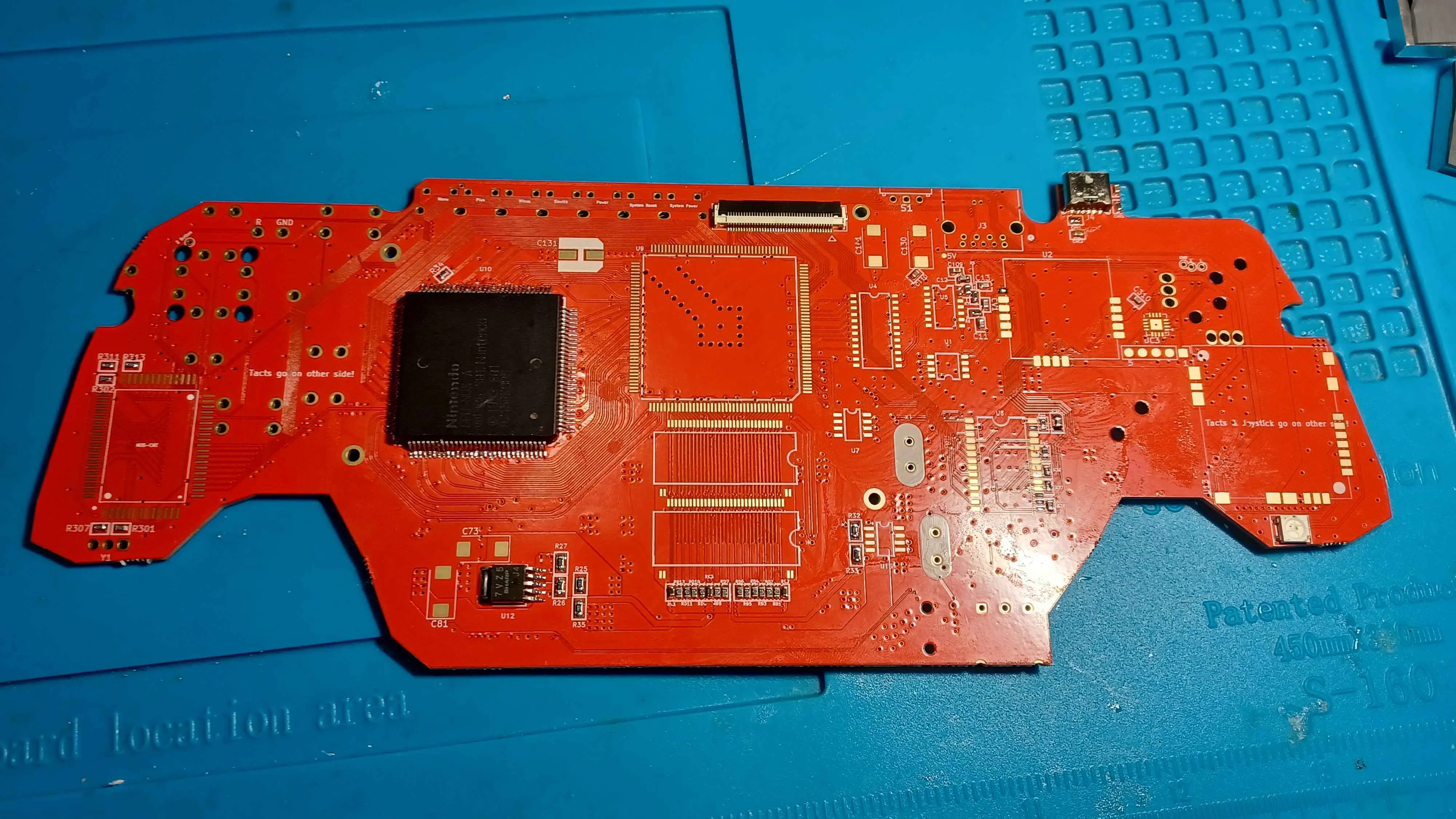

After eventually getting it into this state, I was pretty much ready to test. I went ahead and plugged in the cartridge slot PCB, and decided it was a good idea to do a probe test to ensure everything lined up the way I was expecting. After probing for a bit, it became abundantly clear that something was horribly wrong with my pinout. It turns out, I actually mirrored the pinout from what it was supposed to be. I'm so glad I decided to probe before testing!!!
@Redherring32 suggested I buy a ribbon cable that flips the pinout before I try ordering a new board, and after probing more extensively and looking at my files directly, I was able to verify that the pinout was indeed mirrored. So I've decided to take Redherring's advice here, and I ordered the ribbon connector and some filament for this project on Amazon. They were offering free Prime, so I went ahead and got that meaning that the connector and filament should be arriving tomorrow. Hopefully I'll have some good news sometime then...
All of that aside. As can be seen by the photos, I've got the RCP, CPU, RAM, PIF, and all the main chips on the board without any bridged pins, and I ensured that each pin is properly soldered by doing the pin test on each leg of each chip. My soldering appears solid, and it's looking like this has a good chance of working. Fingers crossed!

A lot has happened with this project since my last post. I acquired the proper ribbon cable, and I was able to confirm that the pinout with the flipped ribbon cable is indeed correct! It's really nice that such a major mistake could be fixed so easily!
So I got to testing and... Nothing. I went into video troubleshooting mode because when this stuff doesn't work, that's always the first thing you want to rule out. Unfortunately, after extensively troubleshooting the video output, (as well as blowing on the cartridge and cart slot), I was unable to get any of the 3 games I tested to boot. I also tried cleaning the cartridges and nothing.
From here I wanted to verify for certain that the console is indeed not turning on properly. Conveniently, I've got an old model of the Everdrive 64 that does a great job of this. It's got an internal LED that turns on and starts strobing while it reads the SD card data, and then the light shuts off when it's done. If the console is booting, then the Everdrive's LED should start strobing and I should see that it is booting correctly. Unfortunately, no luck there either, it just goes on and stays on at a low light level. This behavior is very consistent and easily confirms that the console is indeed not booting.
So troubleshooting time. Why isn't the console booting? I copied the original board layout almost 1:1 making changes only when necessary, so what gives here? I tried all sorts of things to try and sanity check this. I double checked a lot of my pinouts, and everything seems to check out. Here's a picture of how the board looks:
Front:

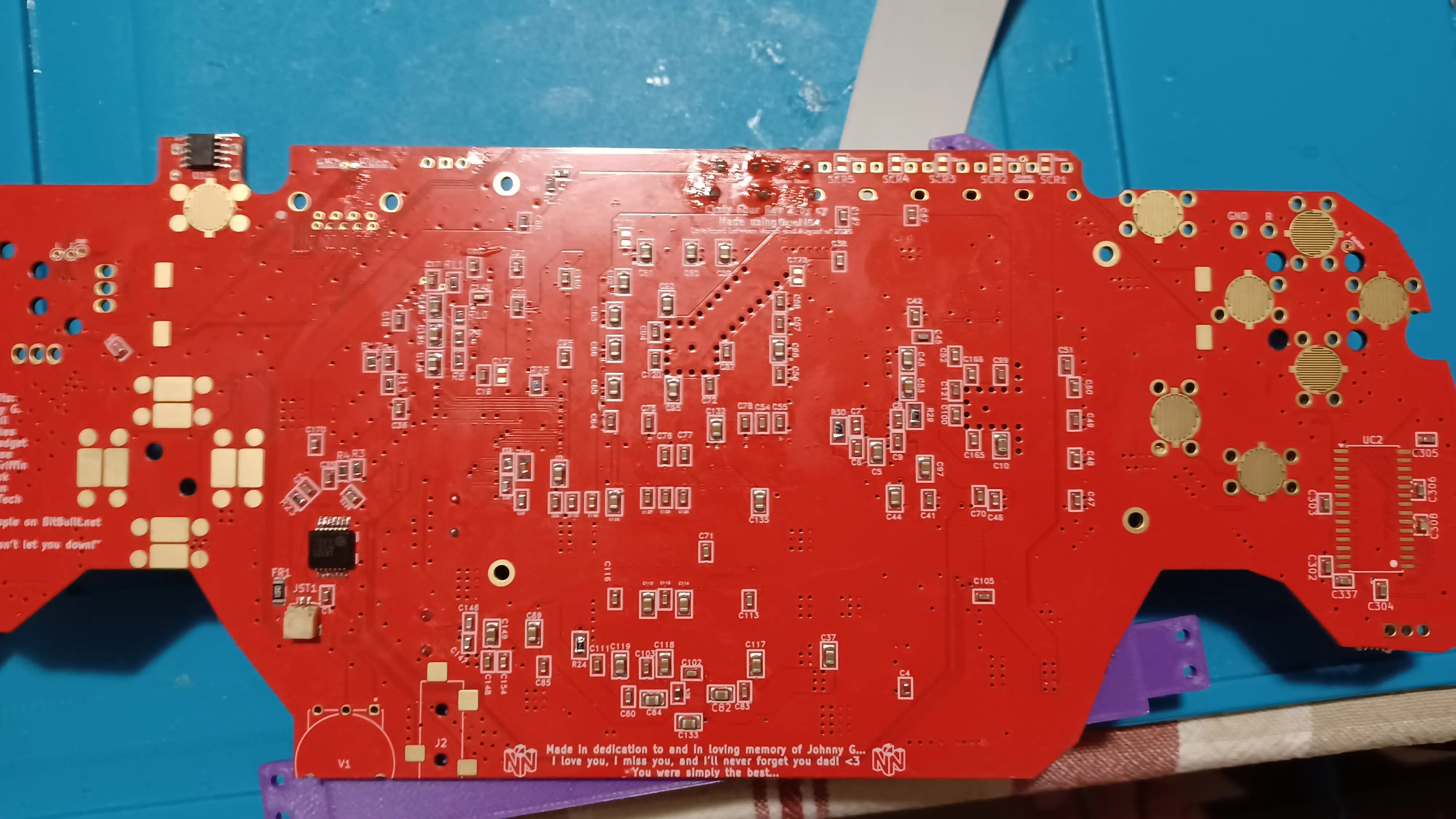

Back:
As far as I can tell, everything checks out. For quite a while I thought it could just be my soldering or something really silly and stupid. But I went over all the chips with a pin, I looked at everything under my microscope, and I probed everything to ensure nothing is shorted that shouldn't be, and everything checks out. So this leaves the burning question - Why isn't this working..?

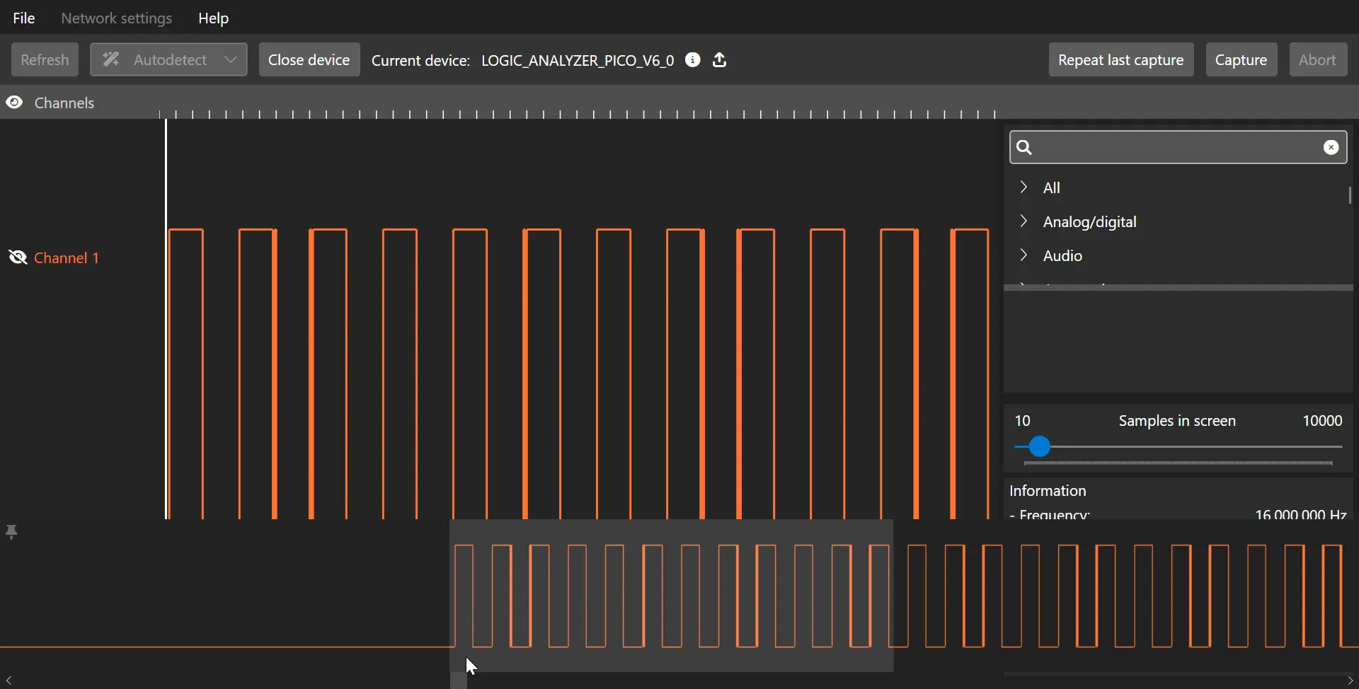

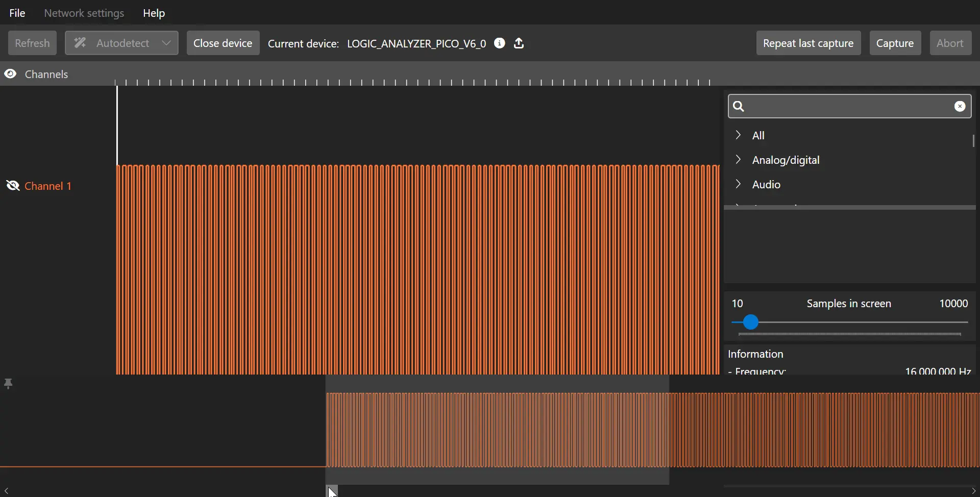

Frustration aside, I started logic analysis, and within a short time, I was able to confirm I absolutely no clue what I'm doing. I want to say I did a bit of this capturing correctly, but Cheese was telling me I need to bump up the frequency to be double the frequency of the line I was measuring, so these readings are probably not good. Here they are regardless:
Here's what OpeN64's PIF 9 leg looks like when captured in the logic analyzer:
And here's what Cyxty Four Rev 2's PIF 9 leg looks like when captured in the logic analyzer:
I don't even know if I'm looking in the right place, or if any of this was captured properly, but I do know that there is a very real and noticeable difference between these two. Something is definitely off, and I investigated this line along with the other lines next to it on the PIF, and I noticed that I routed this and the other two lines next to it right next to an Oscillator:

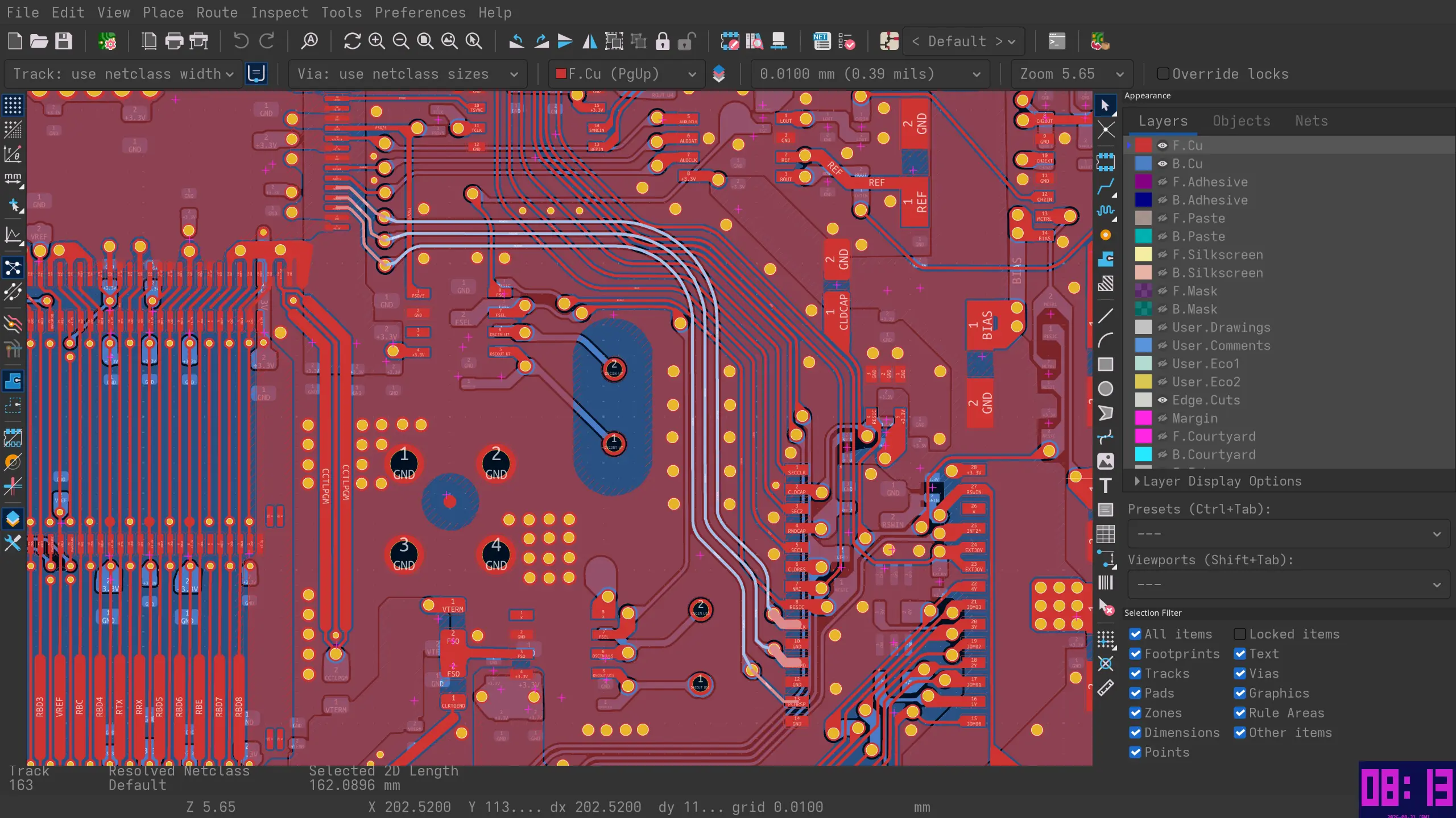

For reference, here's how the original motherboard routes this:
(Note how the OpeN64 routes it on the back end of the board while my AIO routes it on the front right next to the Oscillator)
Yveltal told me that this is definitely not a problem, but in an effort to ensure that he's right, I went ahead and severed the traces and put in a few bodge magnet wires that I carefully routed on the back making certain to avoid any sources of noise. Still no dice, looks like Yveltal was correct. I wanted to be sure though, and this satisfied my skepticism.

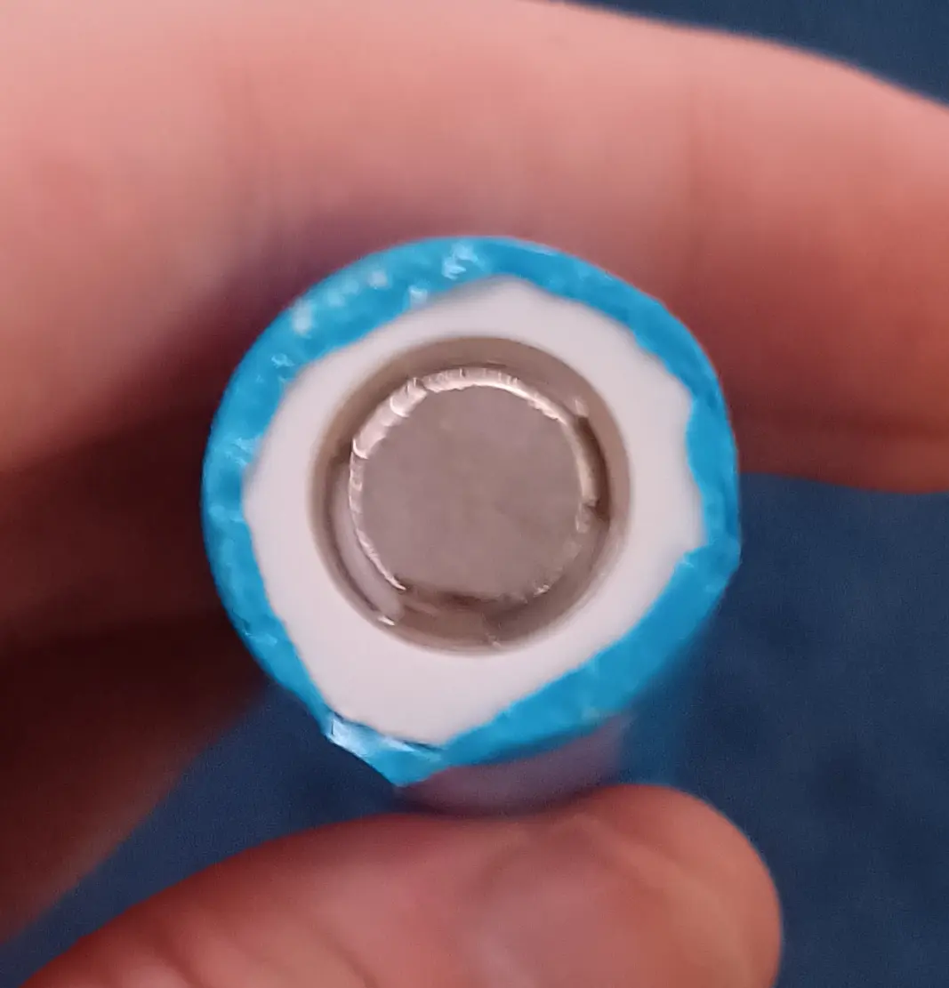

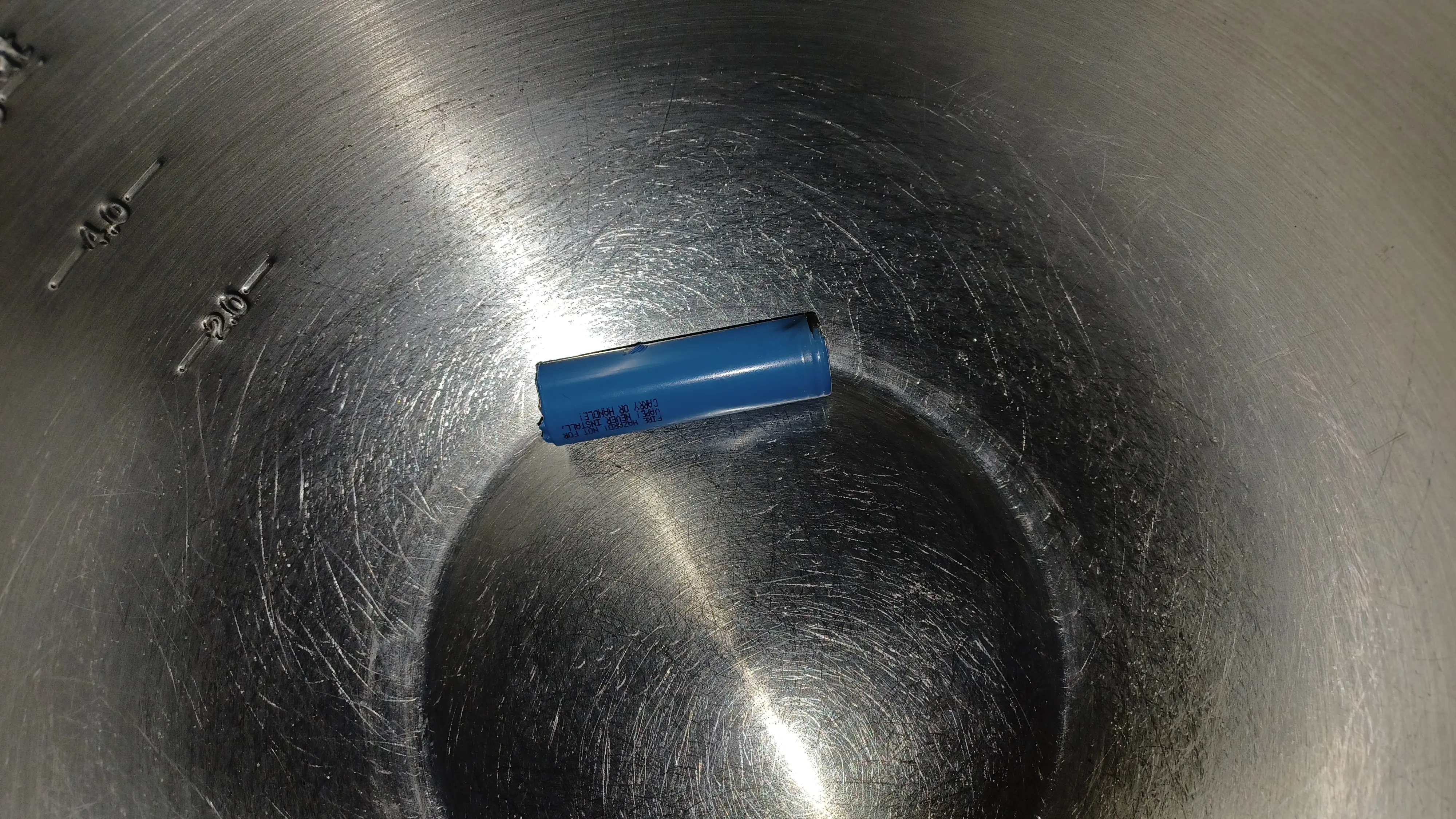

After this, I was going to start measuring some other lines to see what sort of output I could get from them, and when I went to put the battery in for testing, something went HORRIBLY wrong... The battery clip cut through an insulating plastic ring around the edge that insulates part of the battery between the positive terminal and the negative terminal, and in doing so, started shorting the battery while it was reasonably tightly gripped by the battery clips... This caused a fair bit of magic smoke to come out of the battery, and in a mad panic, I rushed to get the entire project outside. Along the way, the battery ended up falling onto the floor, which means it fell out of the battery clips and stopped shorting. Thankfully, the 5 to 10 seconds that the battery was stuck shorting like this didn't cause it to explode, and my house is still standing. But this just goes to show how crazy wild things can happen with batteries that you may have never even accounted for.

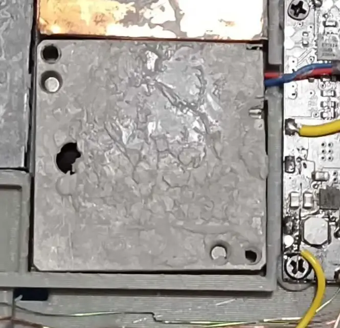

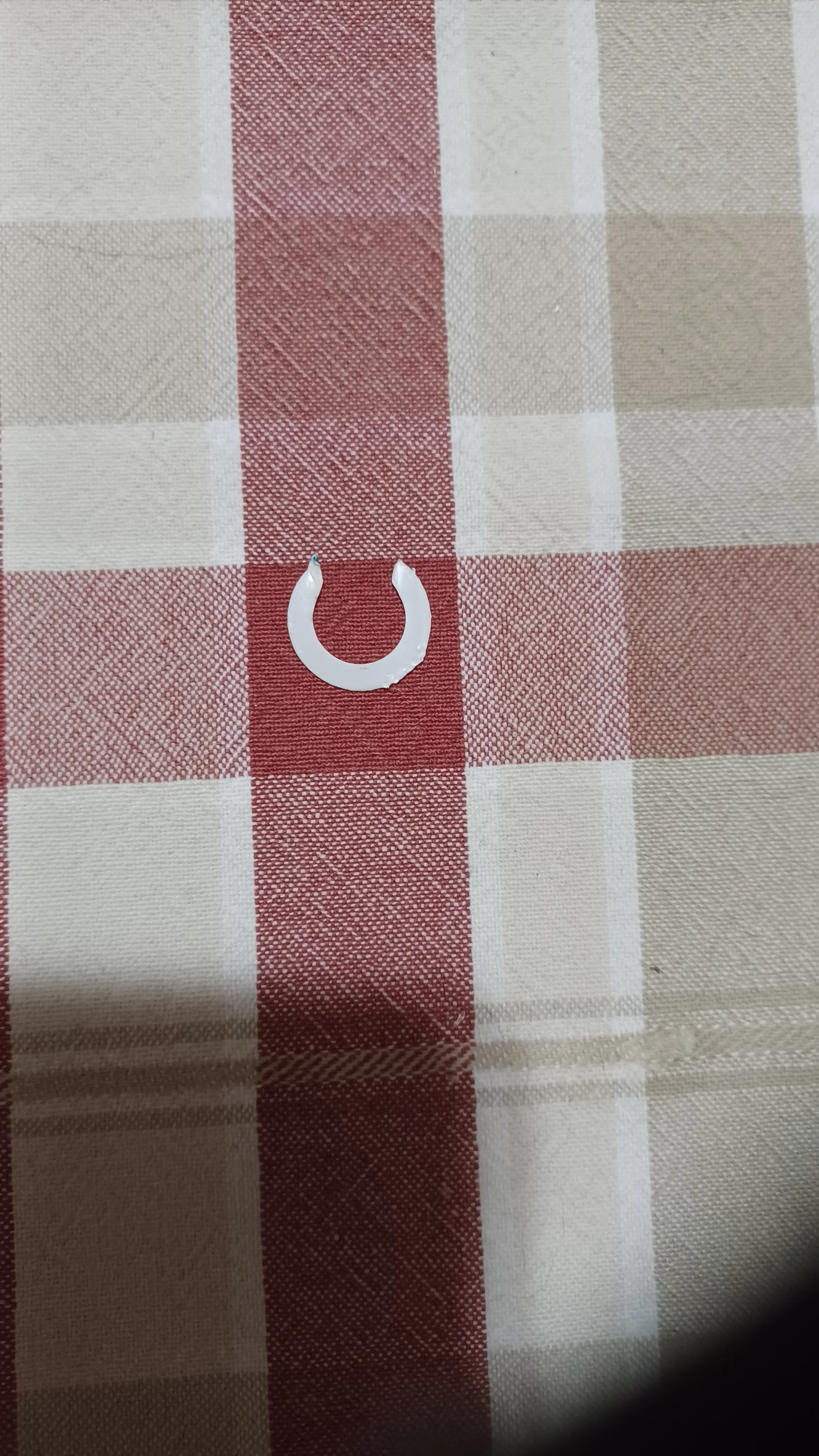

Here's a picture of the 21700 in question:
It's in a metal bowl in this shot due to it likely being very unstable after being shorted. It spent the night in my garage and I quickly discarded it at my nearest Home Depot the next day at my earliest convenience.
This right here is the severed ring that gave way when I put the battery in for the final time:
Finally, this is another battery I have that looks almost identical to the one that got shorted:
I've put it in and taken it out of battery clips quite a few times as you can tell by the distorted blue wrapper. It's very clear that a similar risk is present with this cell...
So what have I learned from this? There is a limit to how many times you can put batteries in and take them out before the plastic ring fails, and I found that limit! Moving forward, I'll be MUCH MUCH more careful. I'll be storing the battery inside a metal bowl at all times when I go to test. I'll put the battery into the battery holder in my garage and not in my kitchen, I'll leave the battery in the clips moving forward and to connect power and ground, I'll just hold two ends of the ground wire together rather than pulling the battery out every time.
So yeah... this was a very exciting and unexpected turn of events...
So where does this leave the project? Did it even survive? Yes! It appears as though everything survived and is completely unharmed somehow after that... It kind of makes sense because the battery clip is what shorted the battery and not anything in the project, but still, after something like this, it's kind of a miracle that it survived. I tested the voltages of the N64 PMS and the outputs all check out exactly how I'd expect them to.
So as far as I can tell, nothing was damaged, everything is still working exactly as it was before this happened, and we're right where we left off. The board still isn't working, and I probably have some extensive logic analyzing work to do on this thing. Hopefully my next update for this will have a lot more success, and a lot less... dire threats to my house and my own well-being?
Please learn from my mistake here, and stay safe everyone! Lithium batteries are NOT toys! Even when you're extremely careful with them, things can and do happen. Remember that your own well-being is a lot more important than some silly modding project!
