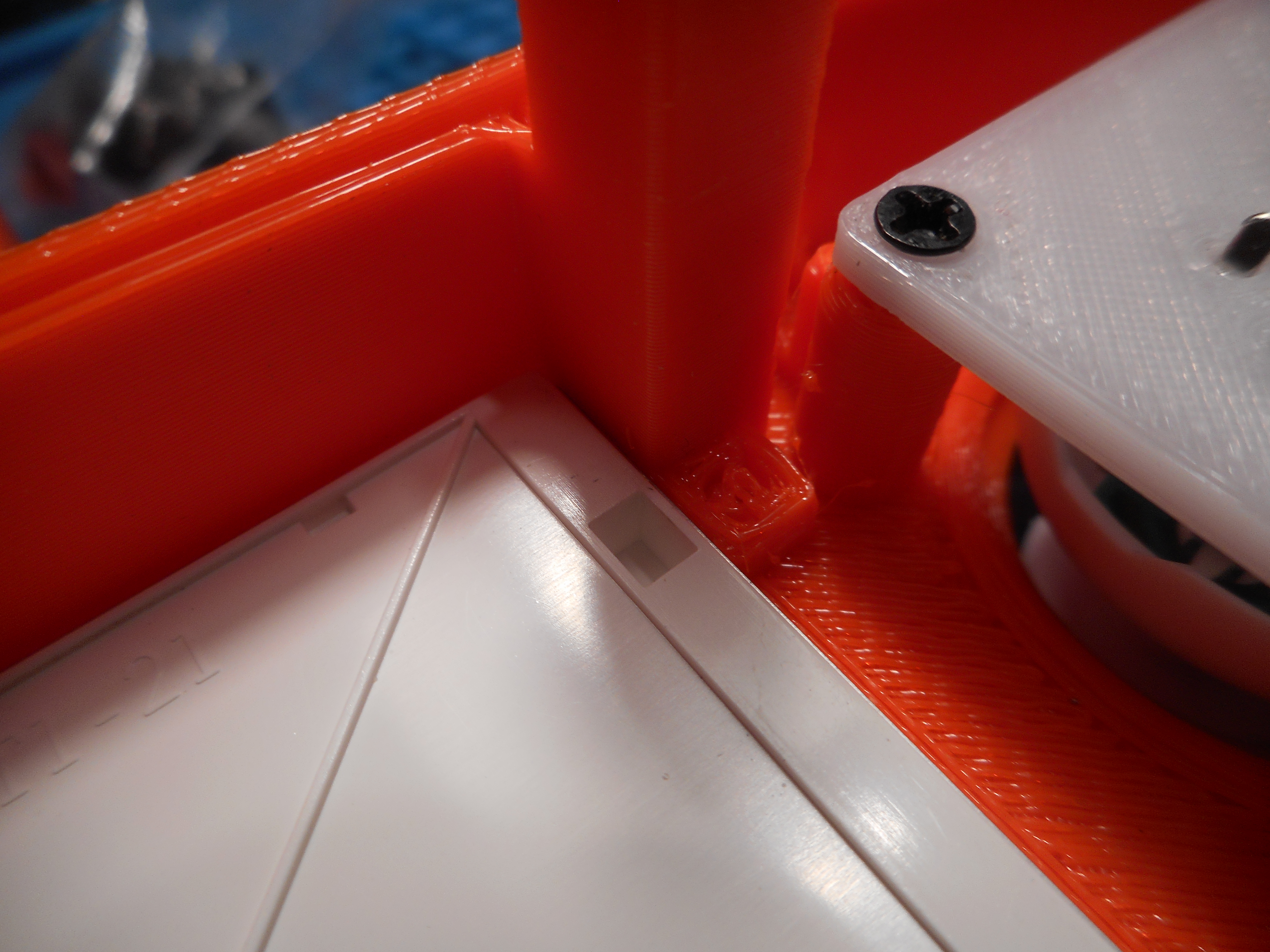

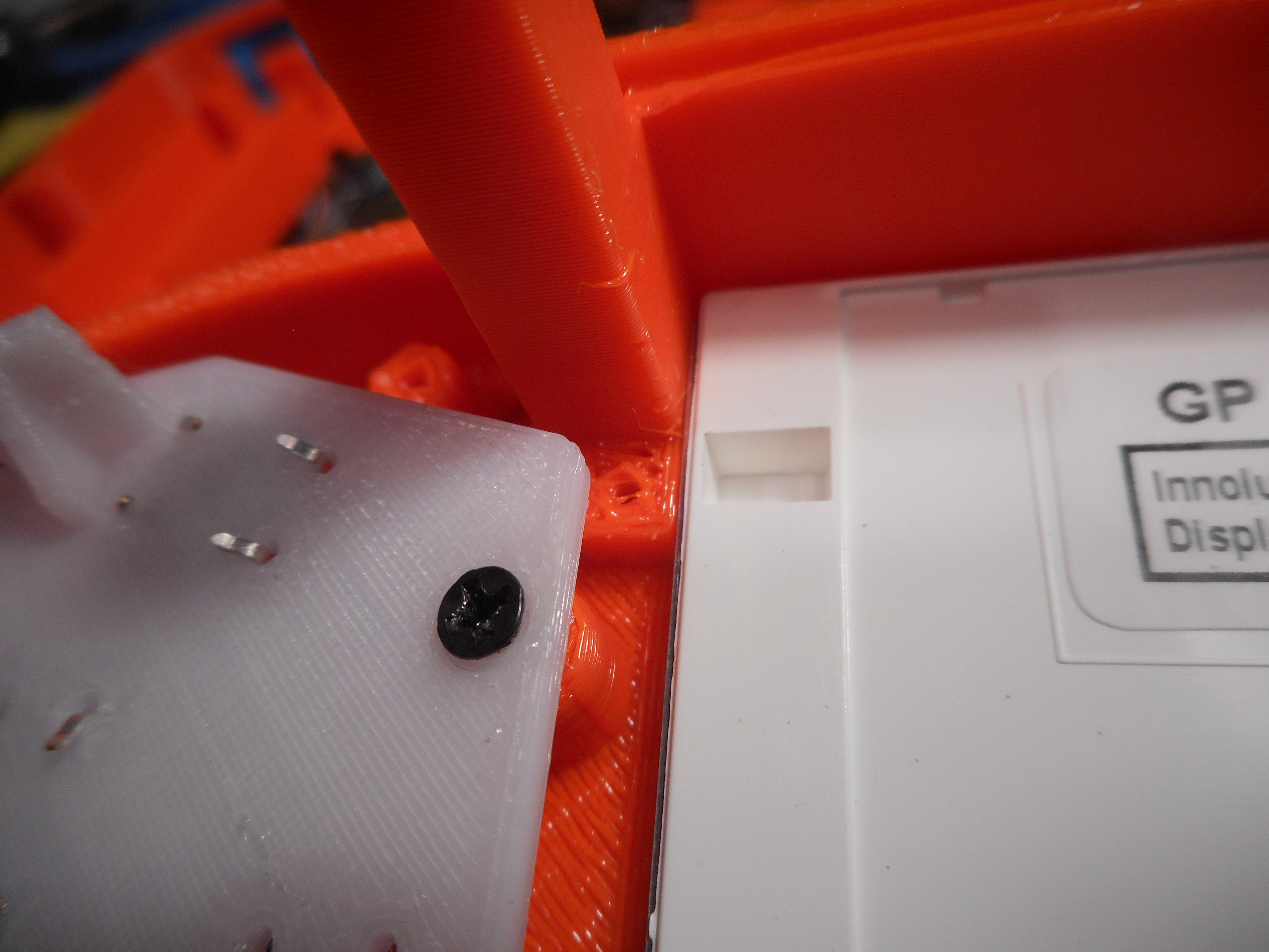

So I put together everything that I could figure out, and there were a few things bothering me.

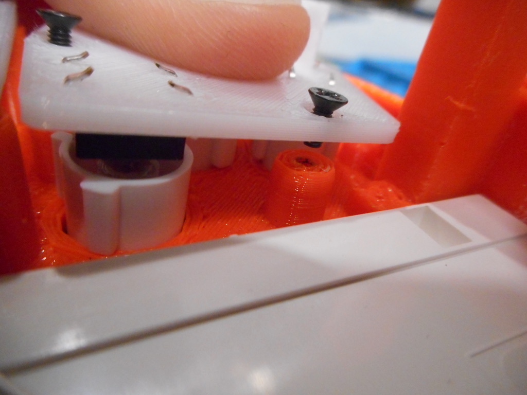

1. These little screw holes. I've seen a couple other builds with little tabs that screw in and hold the screen and LED in place, but I didn't see these in the files. Are they completely essential? I don't have super easy access to a 3D printer, but I could maybe get something small printed. Does anyone know where I can find the files for these tabs?​

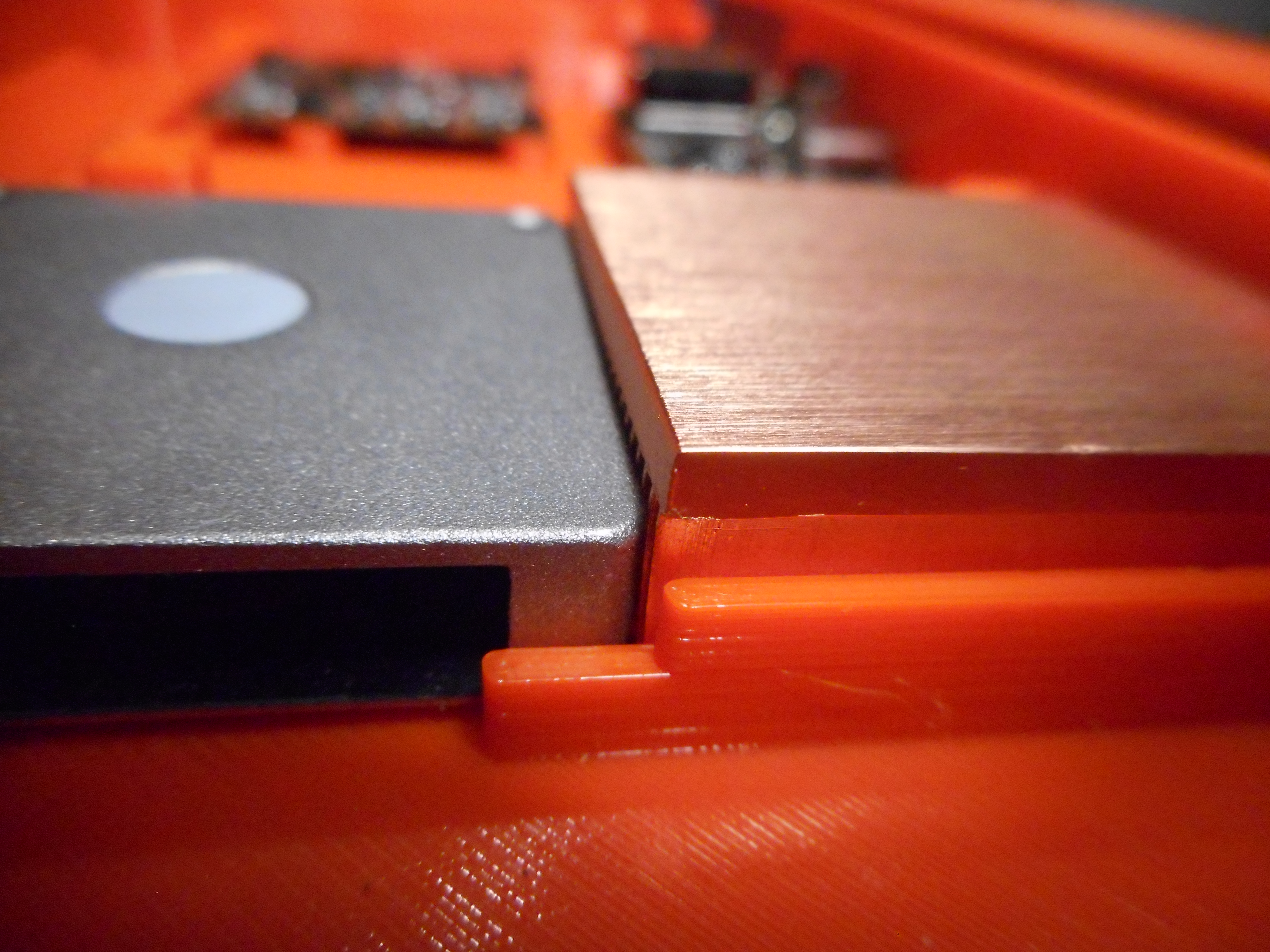

2. My heatsink is a little taller than my fan. Will this be a problem? I also don't have any thermal paste, will that be a problem?​

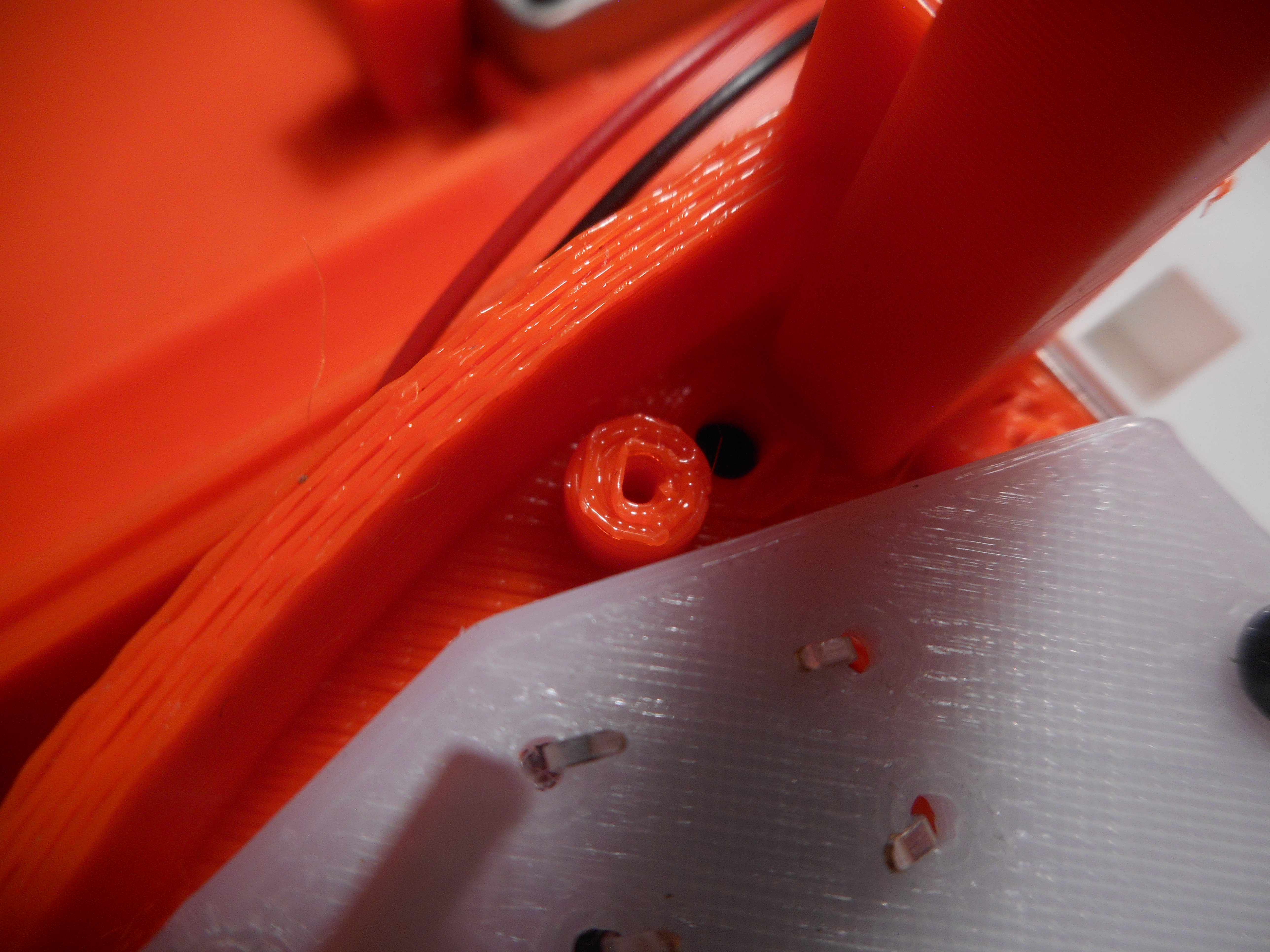

3. My face buttons won't fit. It's really weird, because the D-Pad worked fine, and the shoulder buttons worked as well. But I cannot physically get the buttons in with the caps on. Are my buttons too big? Are they too tall? Are my screw posts too short? I have absolutely no idea. Any advice would be MUCH appreciated.​

For the screen tabs you can cut up a plastic card and screw in little pieces.
You will need thermal paste so the wii does not overheat. At the very least, make sure the copper plate is making good contact with both the cpu and gpu.

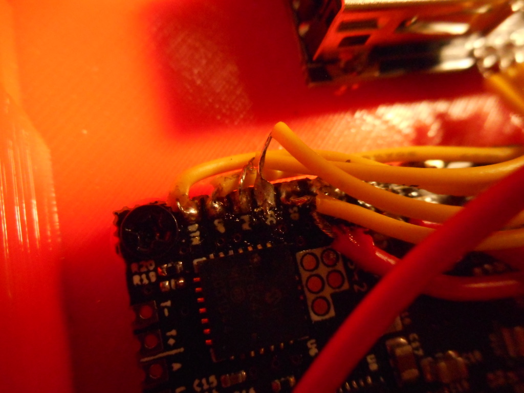

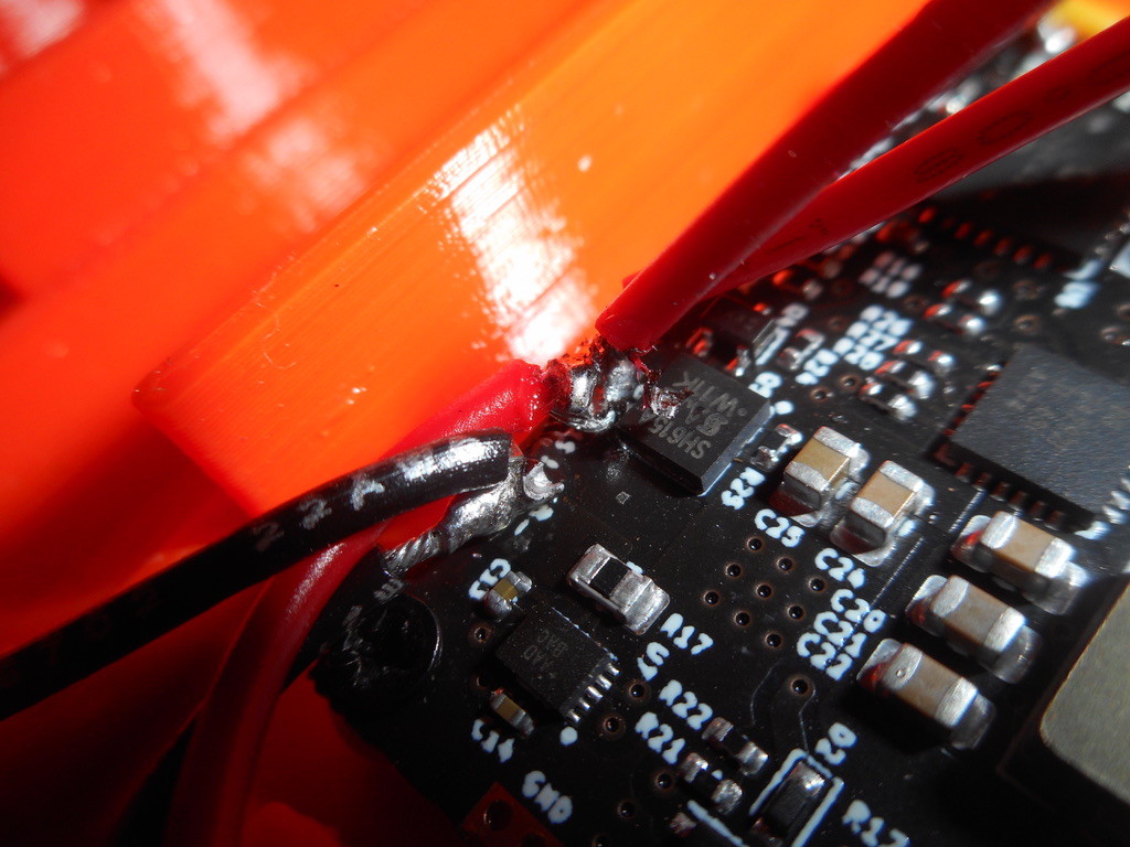

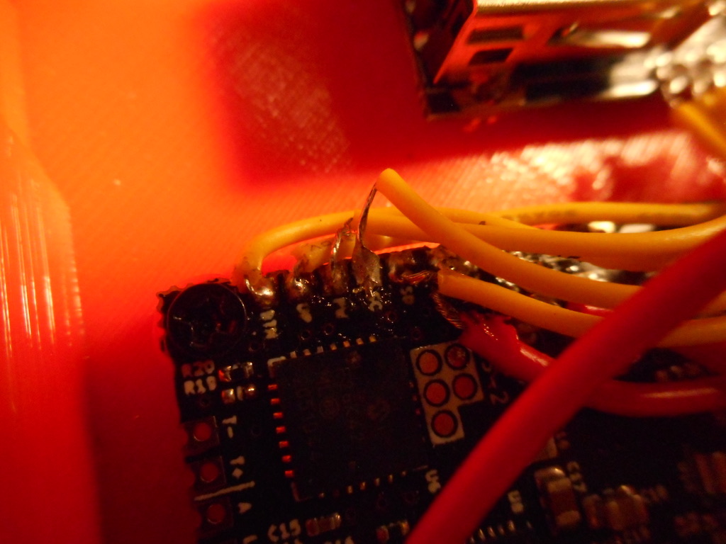

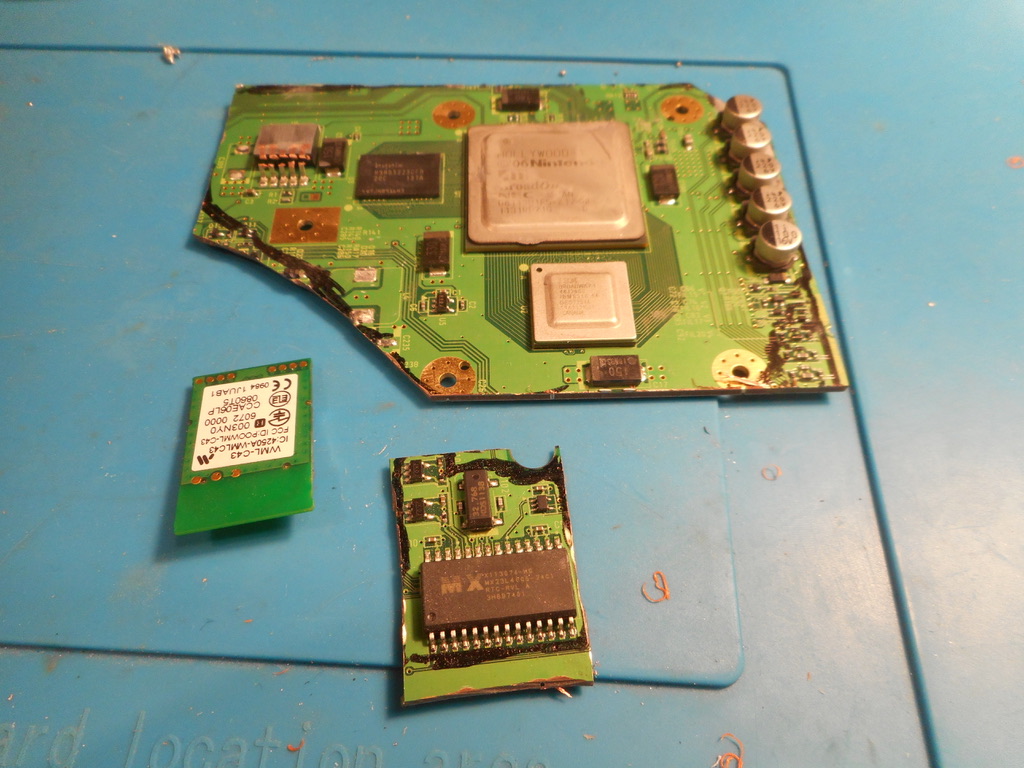

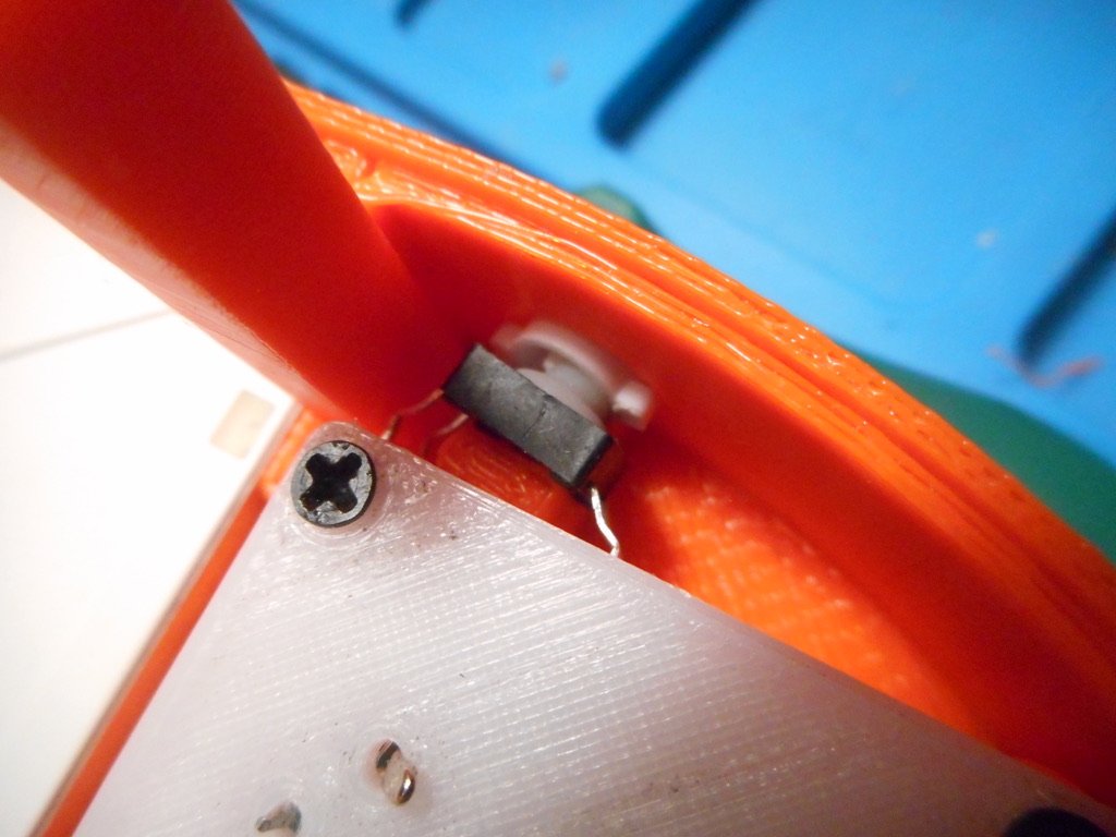

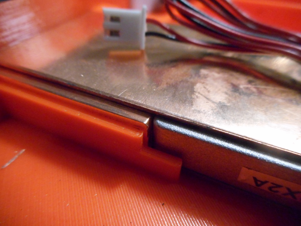

Hello everyone! Sorry for the big gap in between updates.
I've been really busy lately, but I've done some work on my portable!

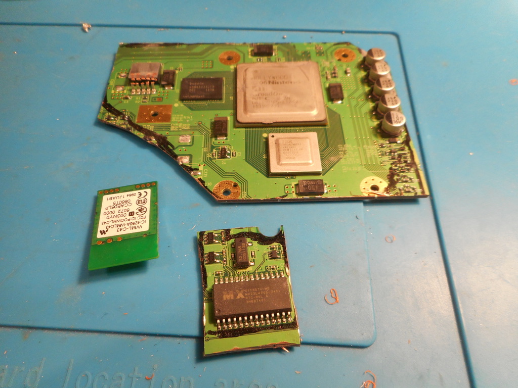

Specifically, I trimmed my Wii motherboard...
Used a grinder on my heatsink to make it nice and level...

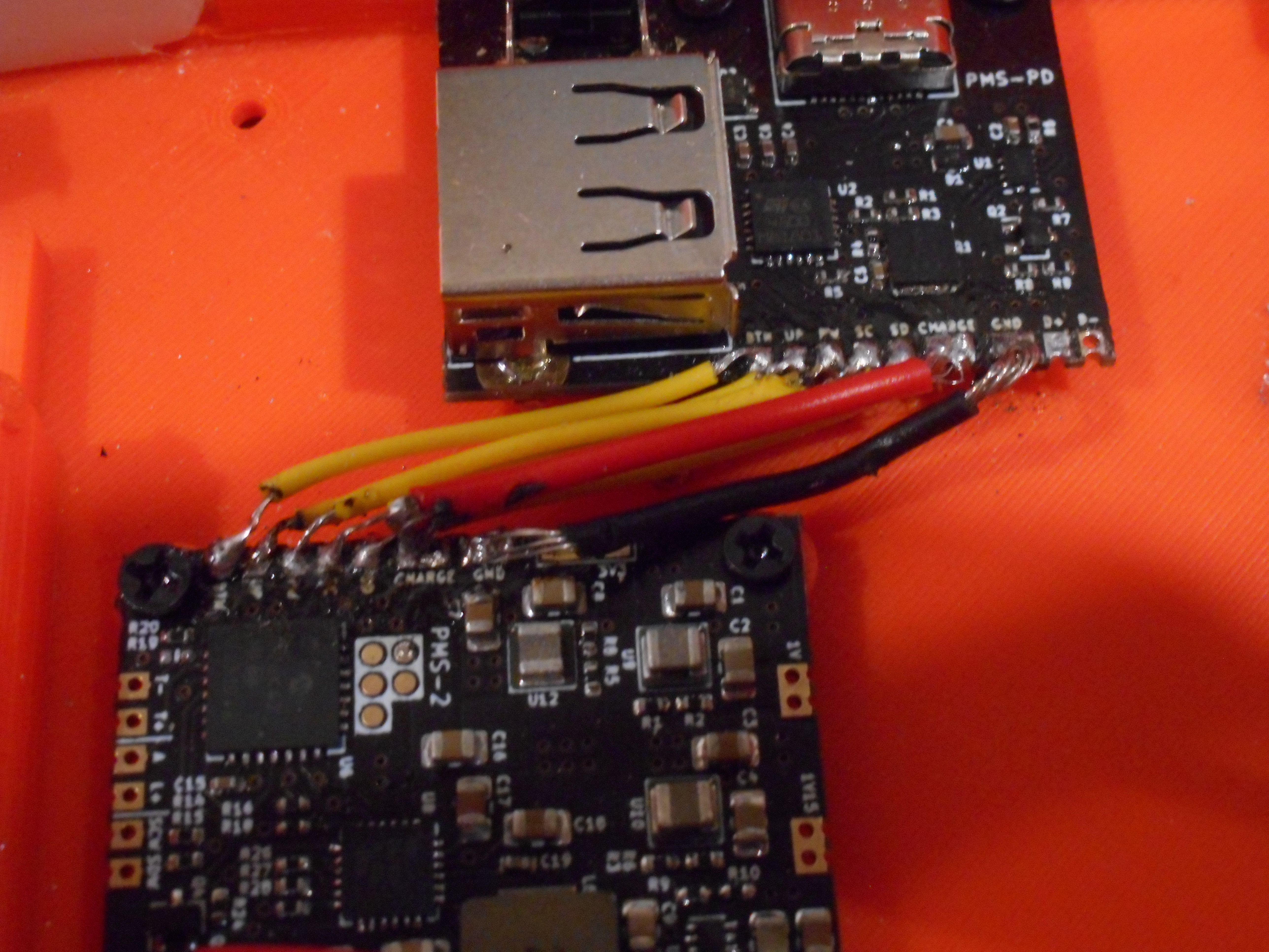

And did the worst soldering ever done by man!
I'm 100% going to redo this, as it is absolute garbage.
I'm kind of proud of the fan wires and the PMS-PD wires though.
I have some new questions, however.
  1. My face buttons still won't fit into the G-Wii case, and I've been having trouble with the start button as well. Do I need to cut/shorten the buttons so that they'll fit? Am I just doing it wrong?

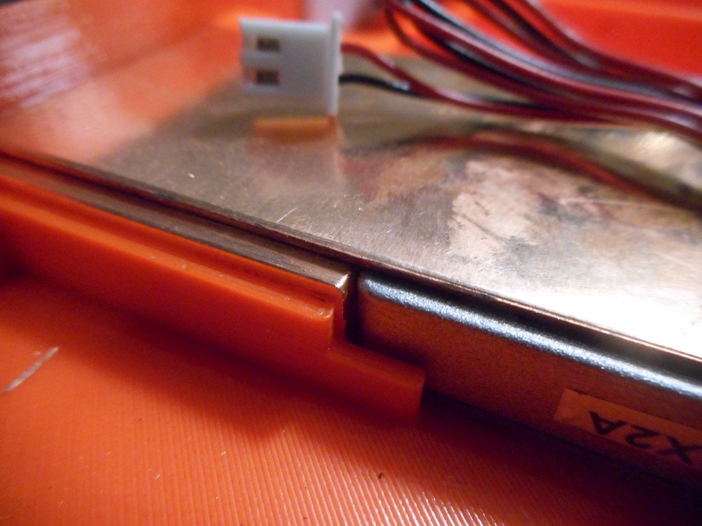

  2. I'm just going to use kapton tape to hold the battery wires onto the batteries, is that what I'm supposed to do?
Thank you all so much for staying with me, and I'll do my best to make more frequent updates soon.
Schmeeker
View attachment 19425View attachment 19426

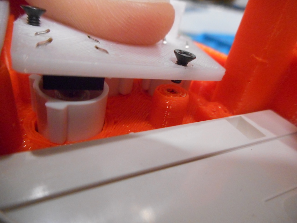

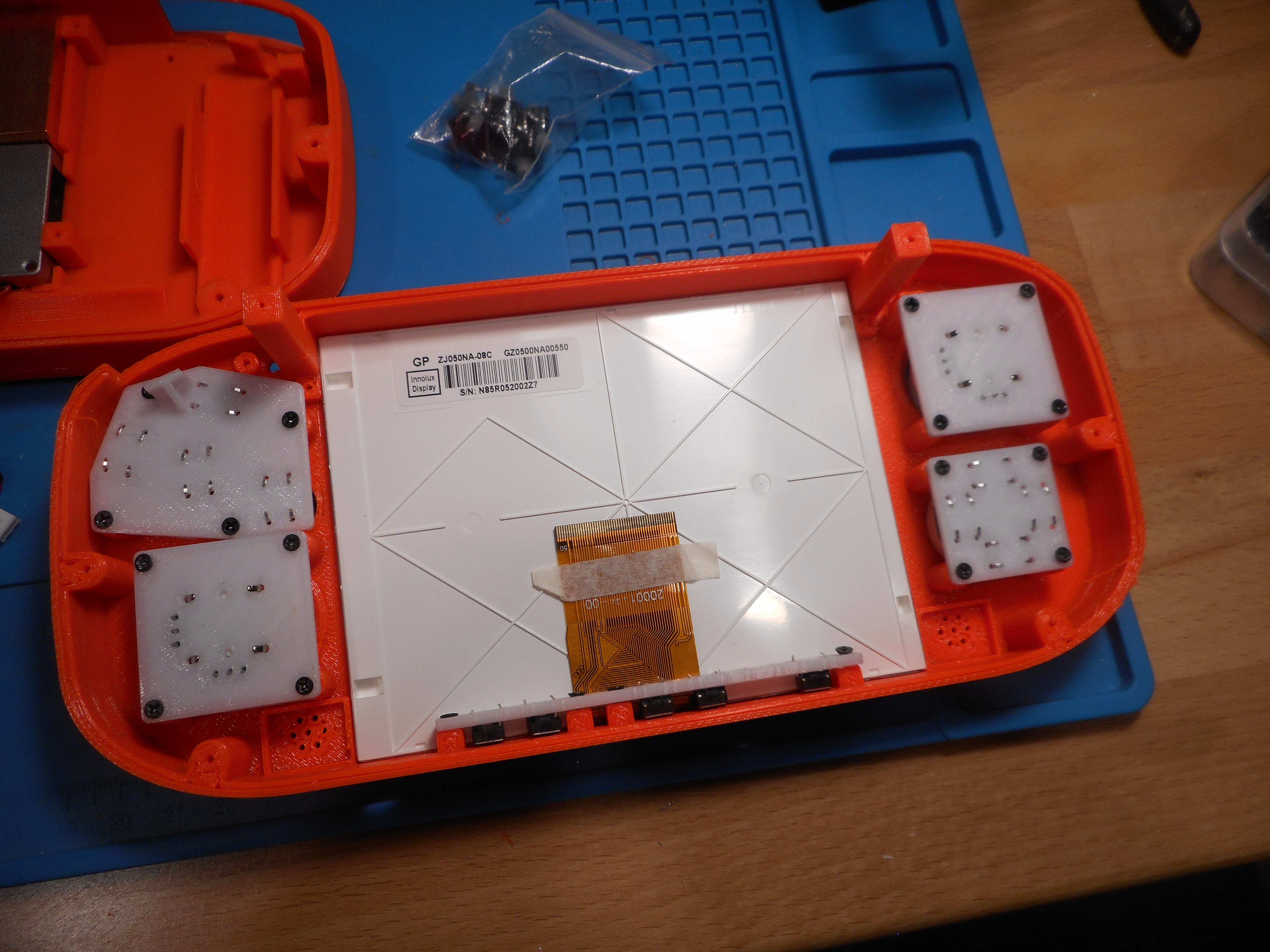

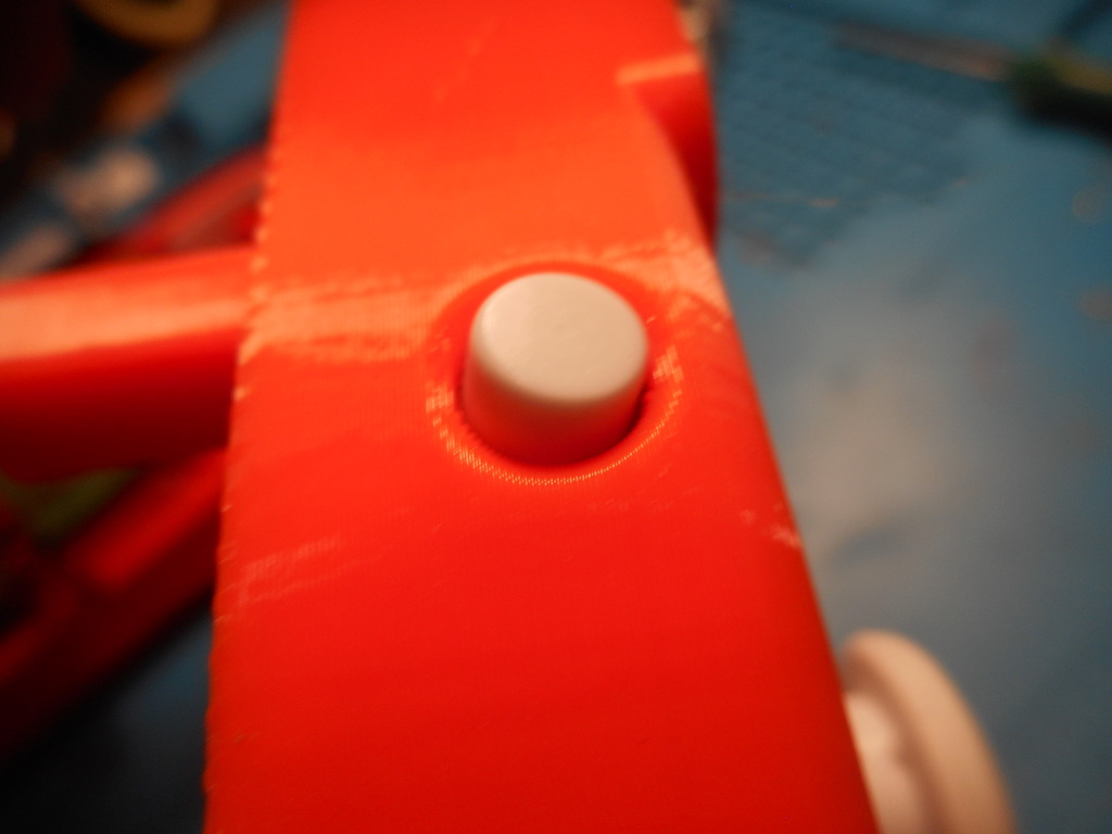

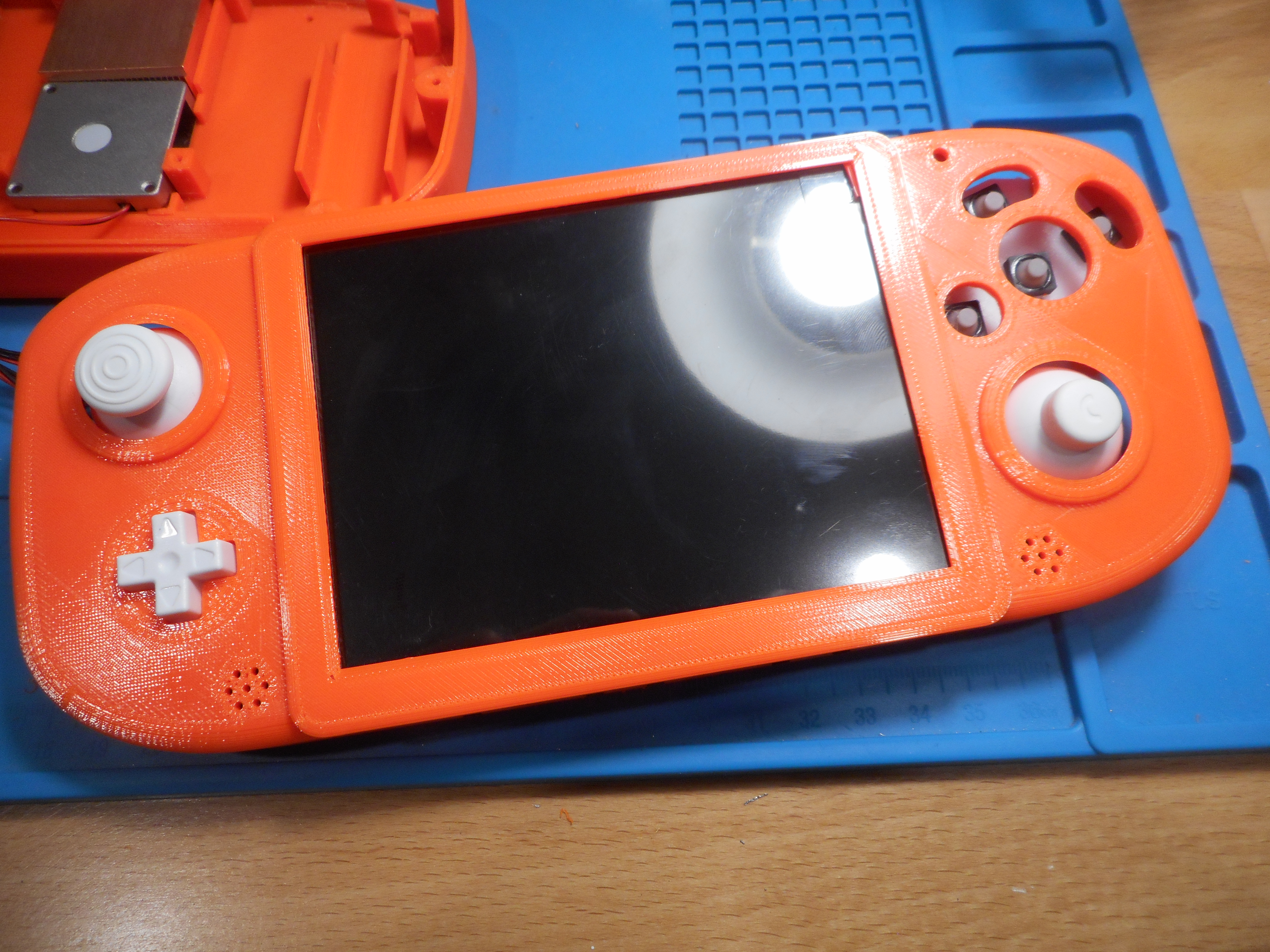

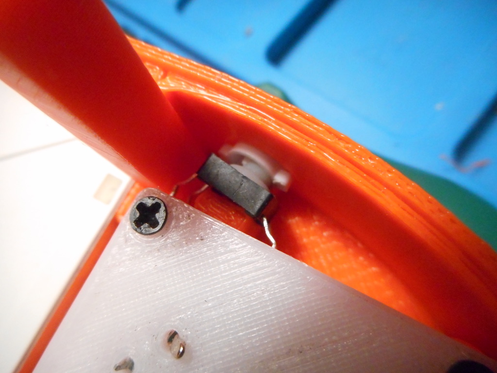

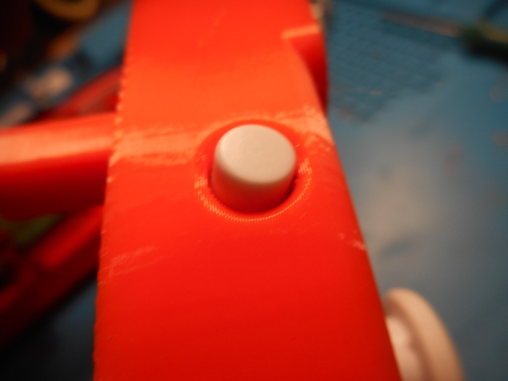

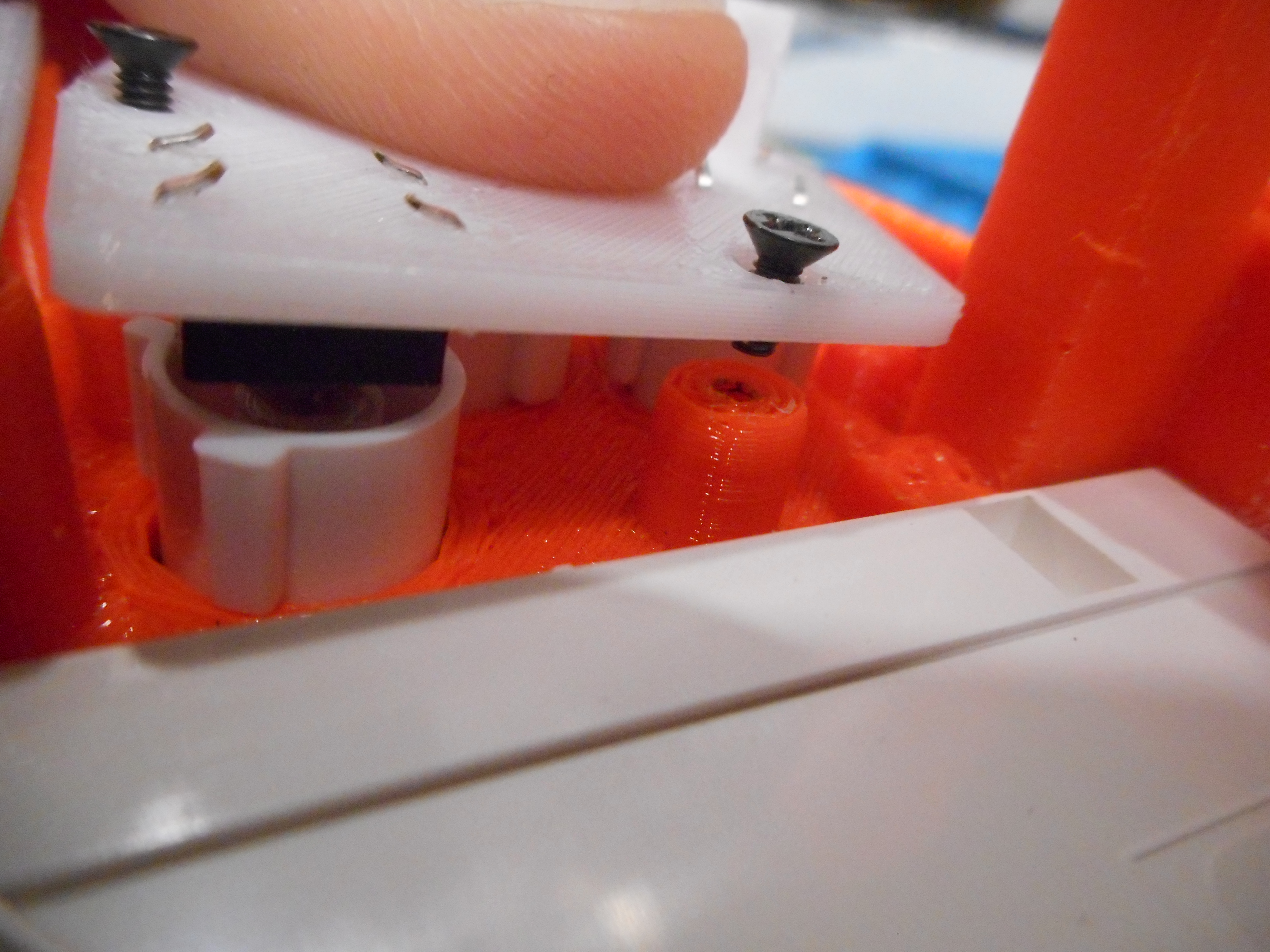

View attachment 19427View attachment 19428View attachment 19429

What up my brother!!!? So let me tell you... it took me 2 sets of gamecube buttons to get my portable right. I failed a lot on this process because I was new to it.
So for all your button questions.. let me tell you. In my opinion its the toughest part of the build to get the buttons just right.
What need to do it cut and dremel and sand or just sand a whole bunch. I had cut my buttons too short at one point... and had to use a small washer underneath my A and B buttons lol..
You can use electrical tape or normal tape to have a good grip will cutting or sanding. Just take it slow because you can't put plastic back on.. (unless you want to build up with ghetto washers like I did lol).
Here are some pictures to show you what I mean and the struggle. PICTURE DUMP TIME.
Btw.. I could use that D pad I trimmed down. I ended up using the other one and redoing the trim and sanding on it... The D-Pad is tough to get just right.
Also.. its really a matter of what you want for the, "feel" of your X & Y buttons. I ended up sanding a little bit of and angle for them so my thumb glides from the A & B button right up to the X & Y without too much trouble. Also for the start button on top you can use that squishy tact button but you got to cut off the side peices and sand down a bit so the button doesn't smash the crap out of it like it is right now.
Also for the A and B button once you have it right.. you can carefully superglue the squishy tact in place on the back plates of the buttons. I would suggest a small amount and then having the buttons face down when they adhere to the glue because you DON'T want superglue in your tact switches.
@SparkleBear gave me all this advice and without it I would not have great buttons!

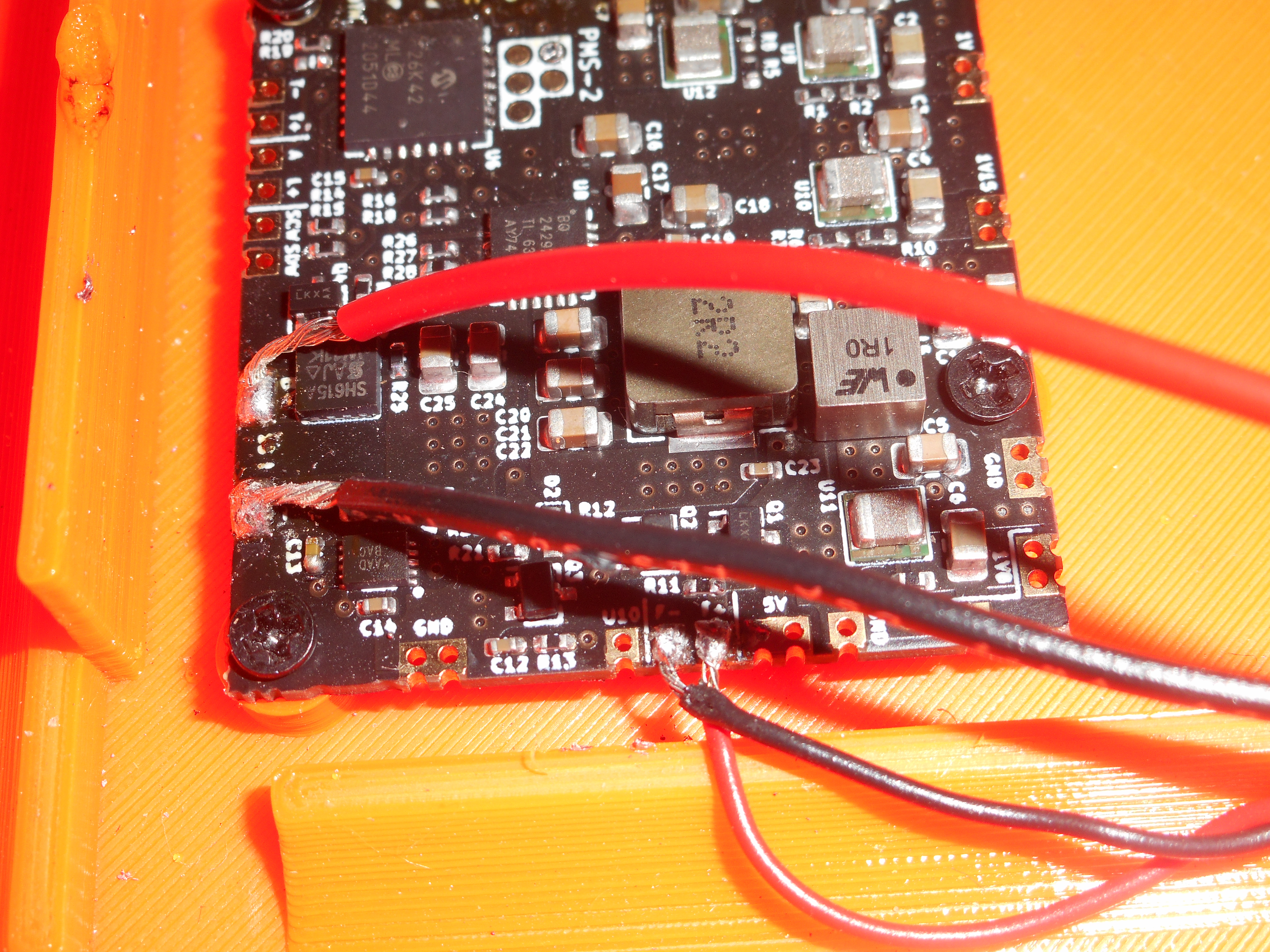

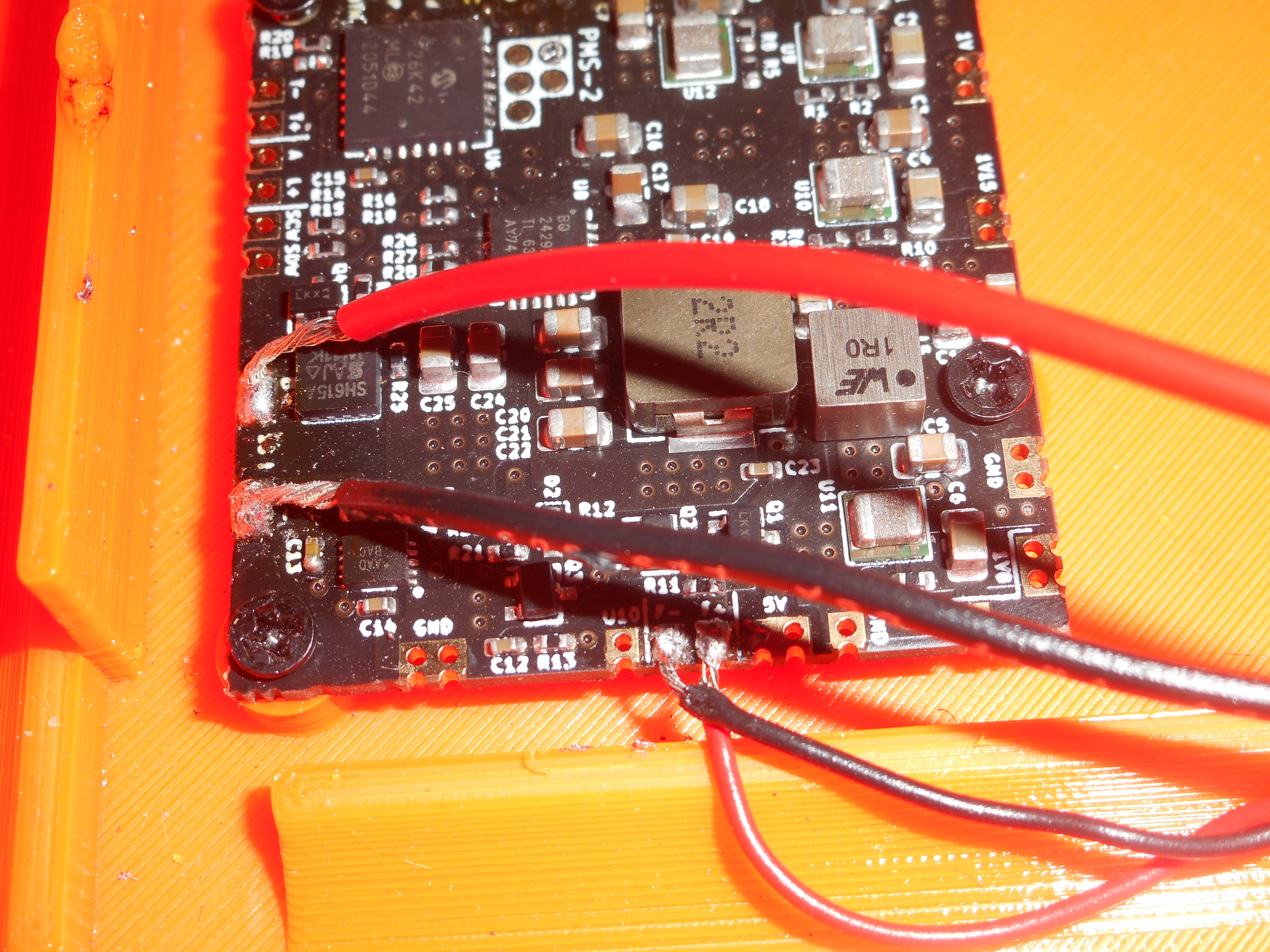

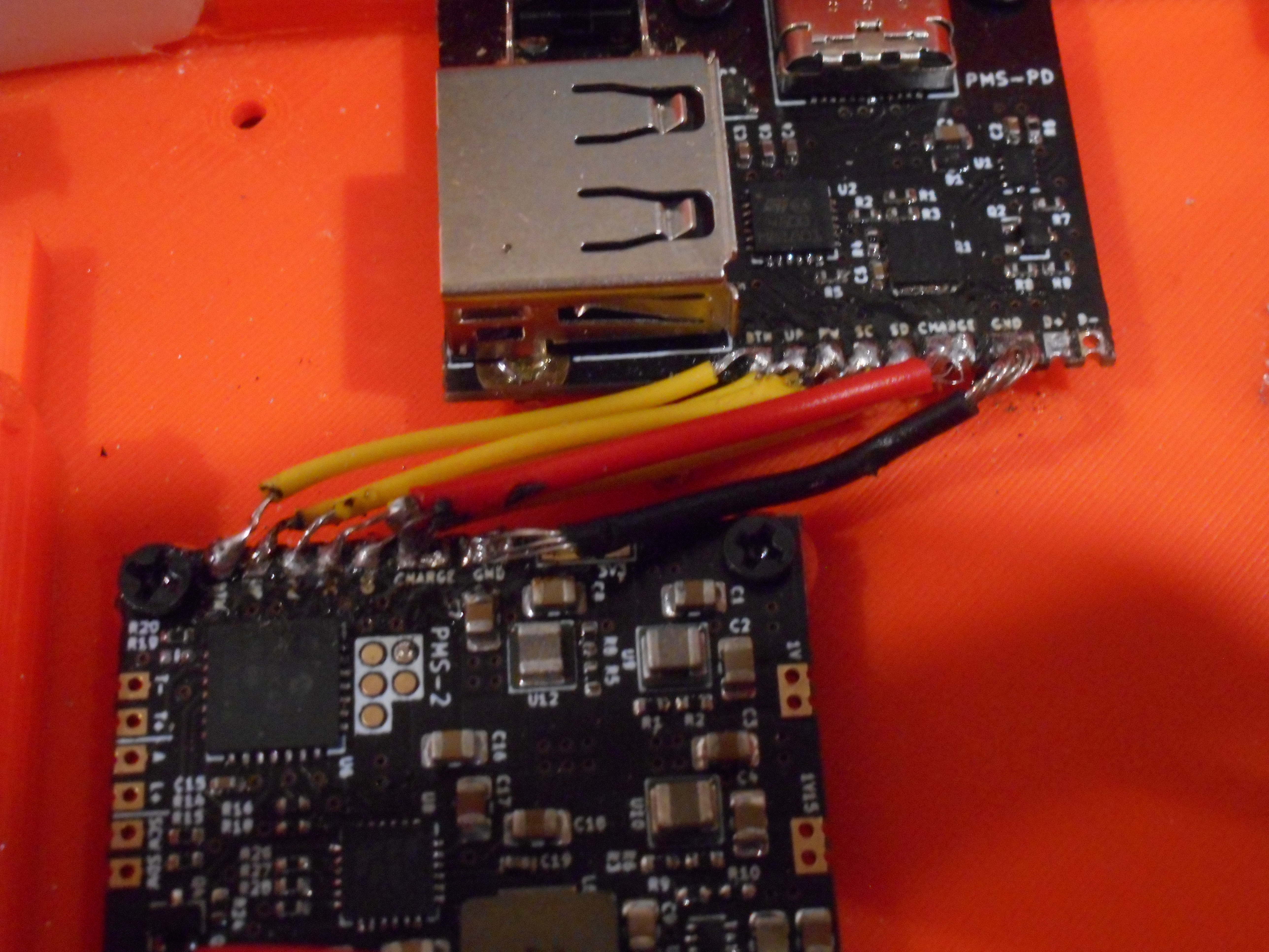

I'm back again, and I unfortunately have barely progressed.

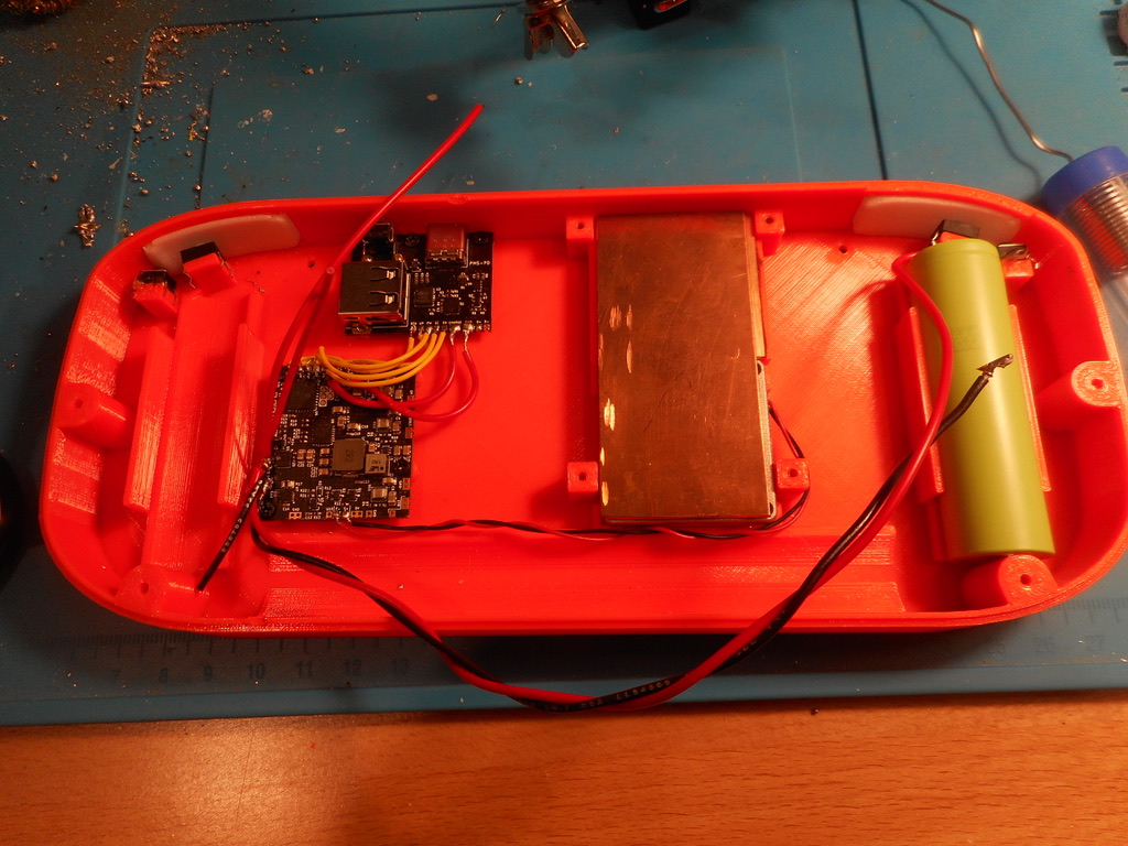

I re-did the PMS wiring and I'm way happier with it now. However, when I taped up a battery and pressed the power switch, all I got was a faint, high-pitched noise that stopped when I released the power button, and then I couldn't recreate it. Then, I left it (without the battery connected) for a couple hours, reconnected the battery and got the same result. I've tested with a multimeter, and the PMS was not outputting voltage from any voltage pads after the noise, and I didn't test it during the noise.
Did I fry my PMS? Any advice would be MUCH appreciated as I have no clue as to what is happening.
Here's my new, prettier (not good, but better) wiring:
Thanks again for staying with me throughout my slow progress. Sorry!

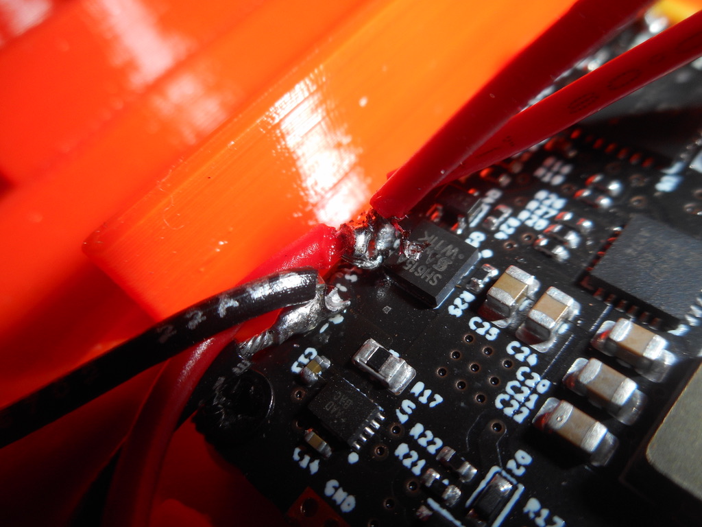

View attachment 20073View attachment 20074
Schmeeker
I think it might be the exposure of wiring from each connection potentially being the issue. Also the connections need some more love.
I would suggest shortening the exposed wire and having a solid solder point. Check out some tutorials online on correct solder points. I messed up a lot with cold soldering at first. Good luck! Send more pictures after!
Your wire is WAY too exposed and can easily short out components and fry the PMS or other components. You only need to trim the insulation off the wire like 1mm or less for small connections and maybe 1mm-2mm max for large connections. Essentially, the insulation of the wire should be as close to the pad you are trying to solder to as possible. Here is an example of small and larger wire. Should look more like this:
Make sure to use flux as well to disburse the heat evenly and to help the solder flow better to get a clean connection!

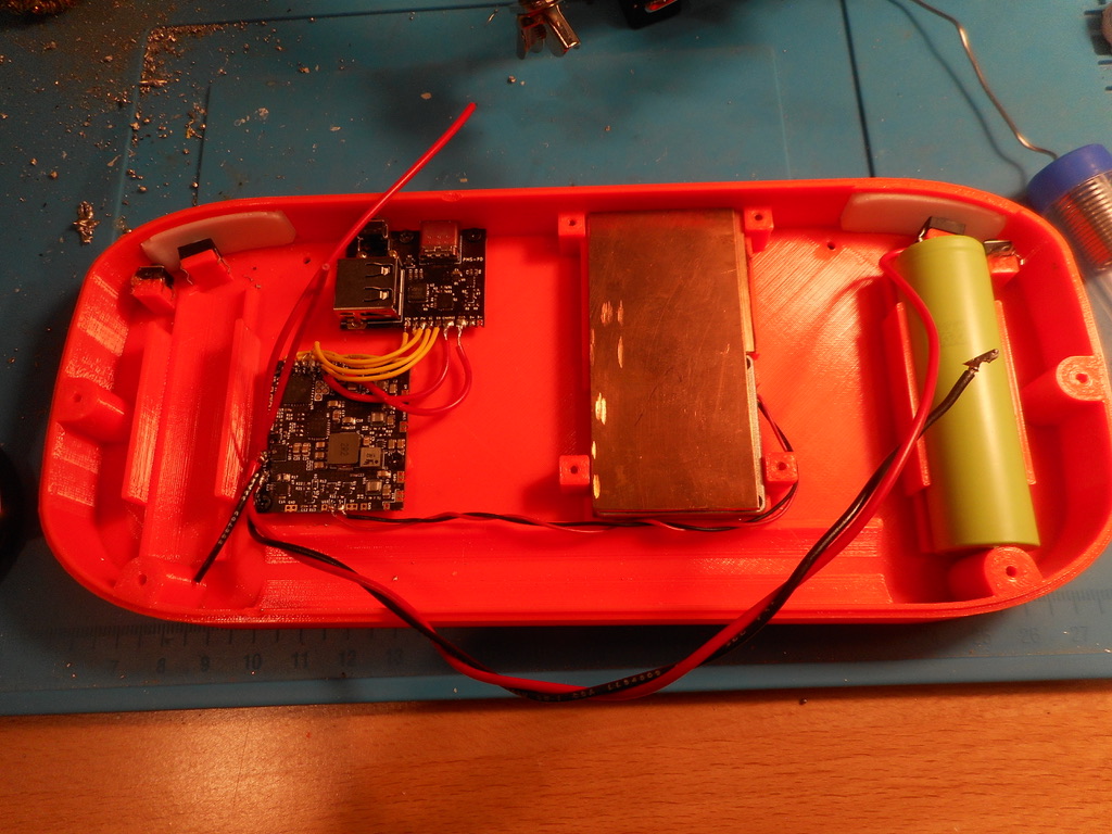

Hello everyone!
Sorry for being the deadest thread of all threads, but my life has been... somewhat insane lately.
I re-did all of the connections and am really pleased with how they came out! I was a little confused as to how I was supposed to wire up the batteries, but I tried it anyway. At this point, what can I do to test the connections? Would I just use a multimeter on the pads of the RVL-PMS?
@thedrew thank you so much for the tip about flux, I brought out some rosin-core solder and it was so much easier!
I've attached pictures, and I'm sure you guys are tired of seeing the same boards wired together over and over, and I plan on actually progressing through this build at some point. No promises, however, as school threatens to take all of my free time this coming year.
Thanks to everyone for helping me and guiding me through this, I hope to make you all proud.

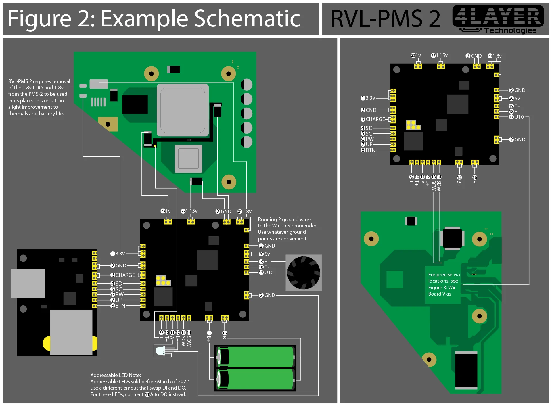

Yeah just turn it on and probe it with a multimeter. If the voltages look goodly, you can connect it to the Wii.
Btw your battery diagram concerns me. The PMS is a 1S system, meaning all the battery positive wires should be together, and all the negative wires should be together. If you put any of the cells in series it will kill the PMS.

Crap. By 1S, you mean all the batteries need to wired individually to the pads? Okay. Thank you, that would have been bad, especially considering how hard it would be to find a replacement. In order to test the PMS, would I need to charge the batteries with a USB-C cable?

They don't neccessarily need to be wired "individually", you can daisy chain the wires from cell to cell if it's convenient. You just have to make sure all the positive wires go to B+ and all the negative wires go to B-.
As shown here
