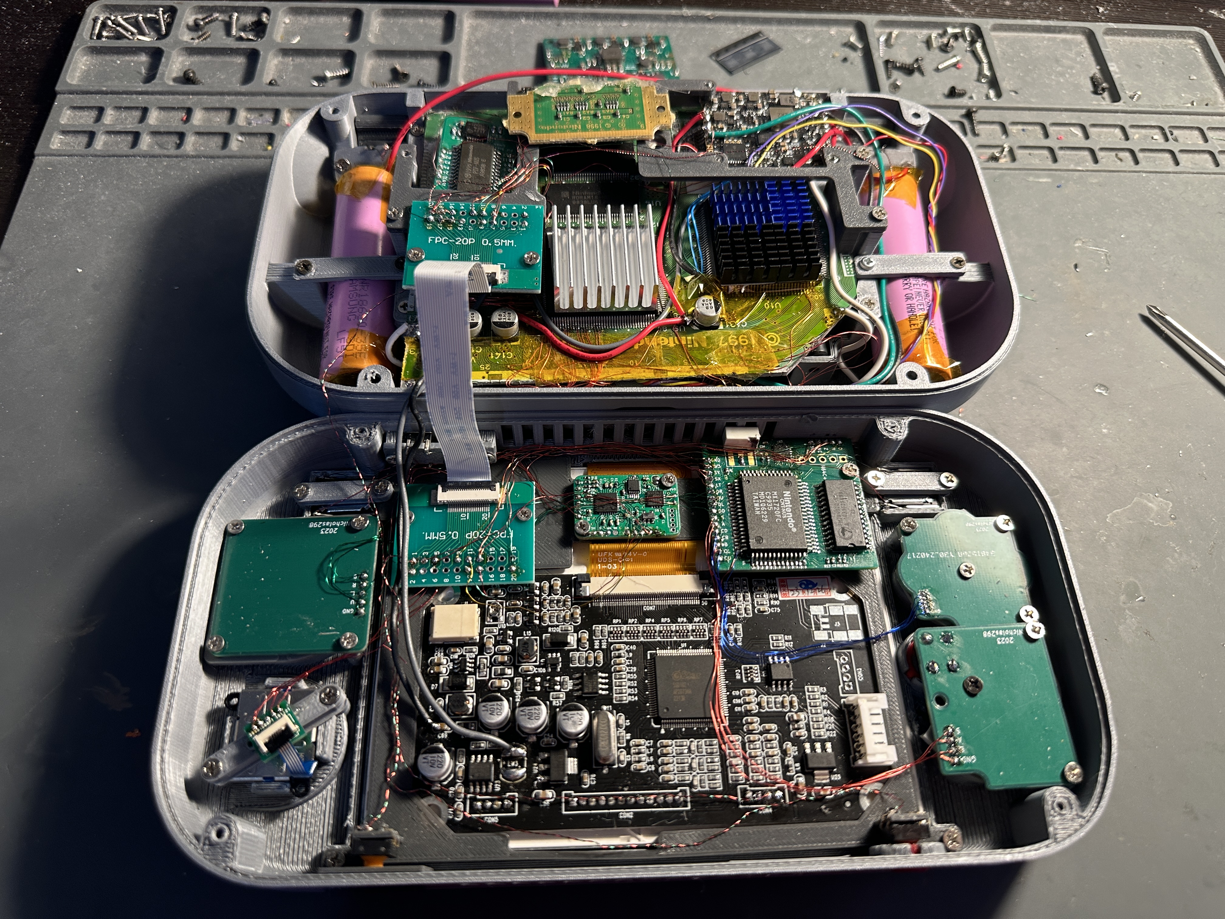

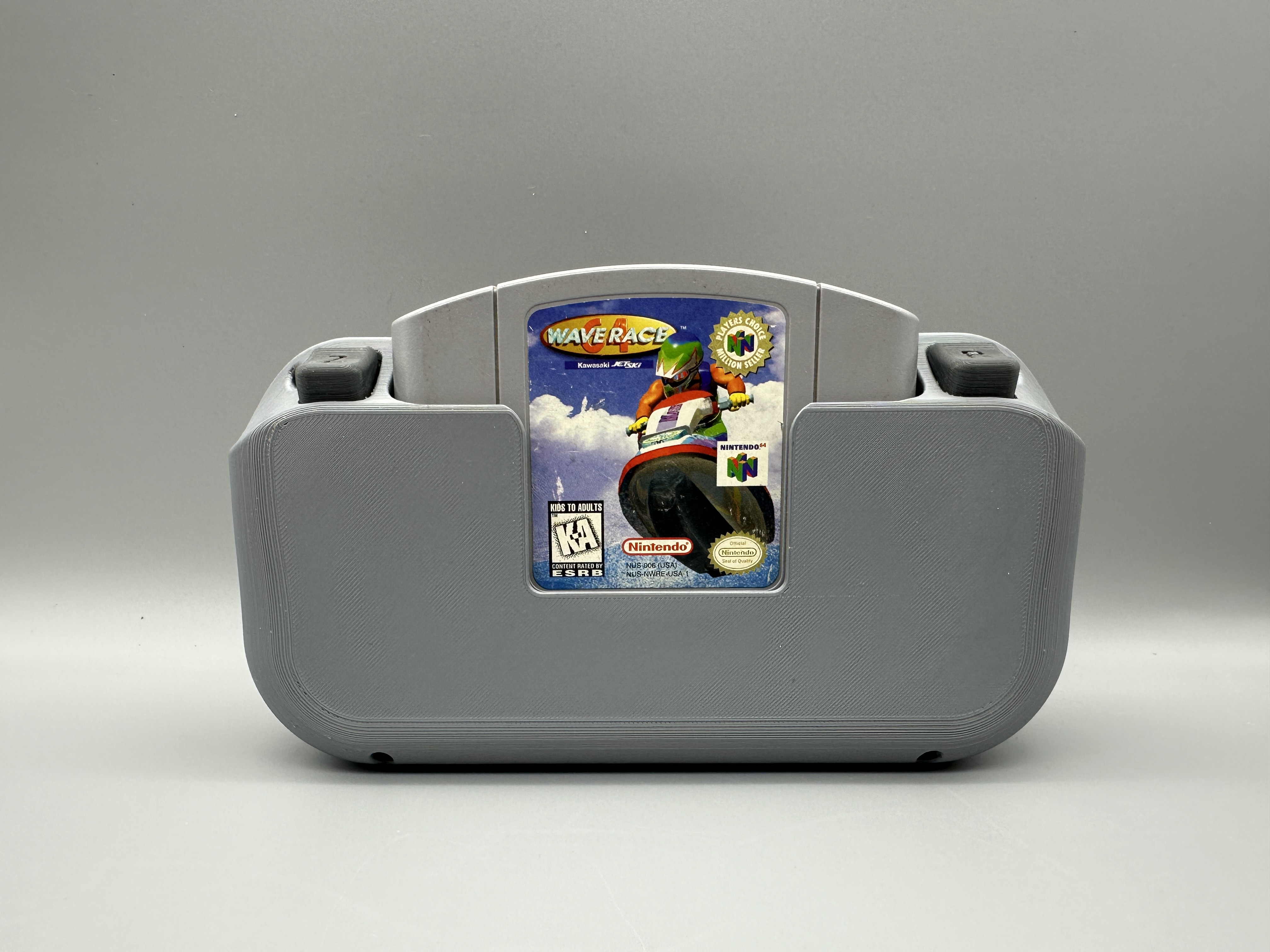

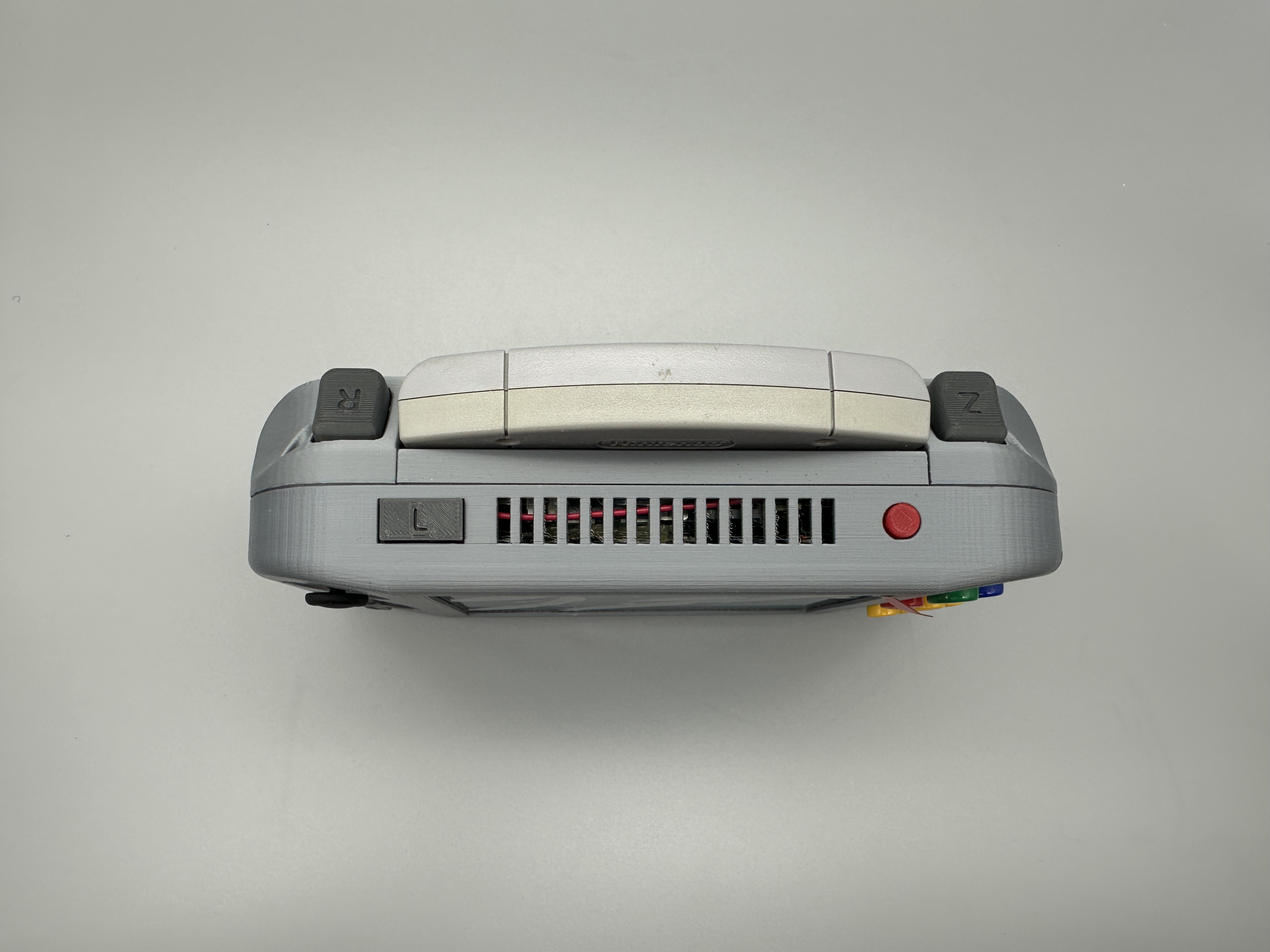

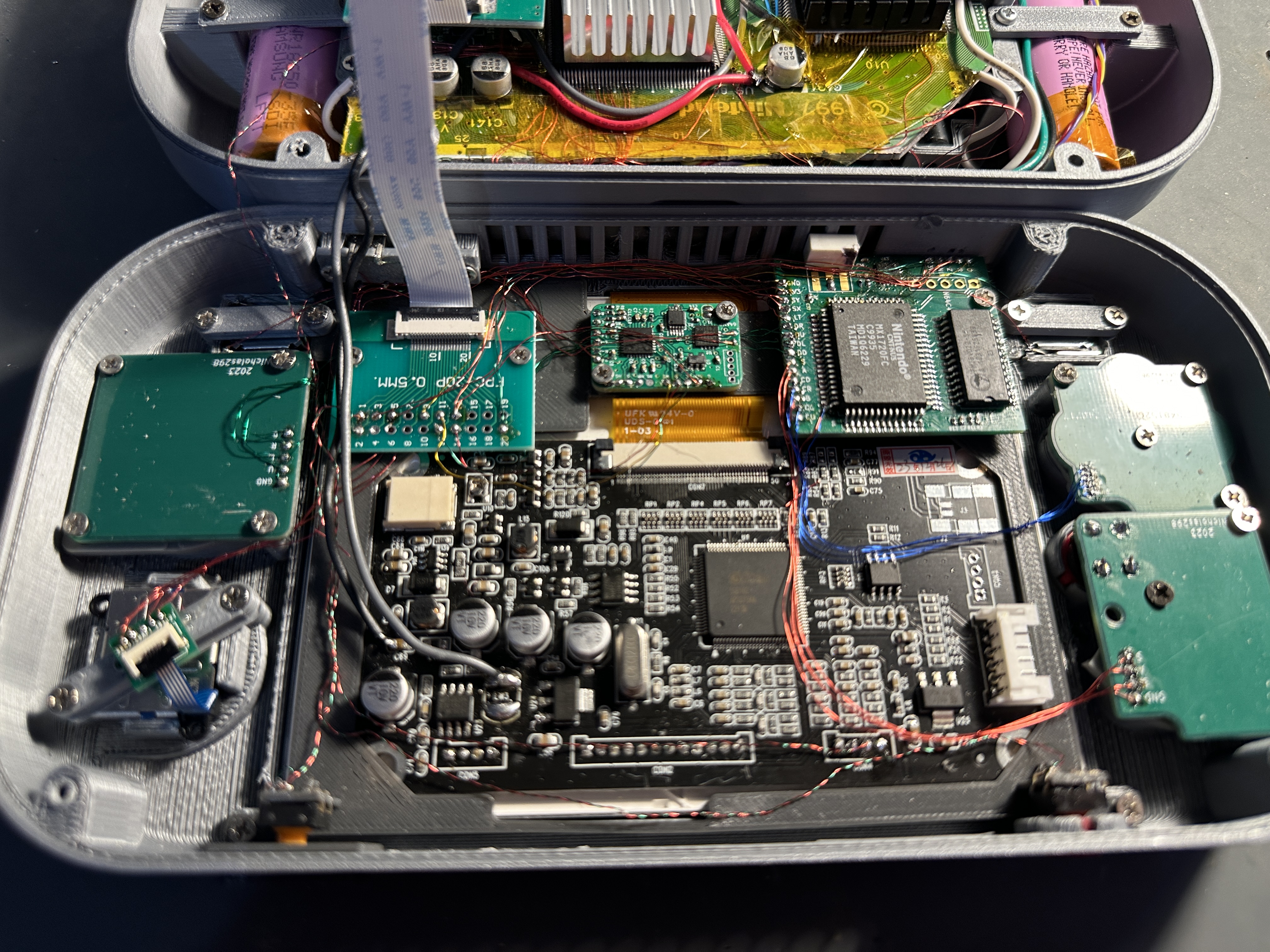

This is not a joke I built my own N64HH!
Features

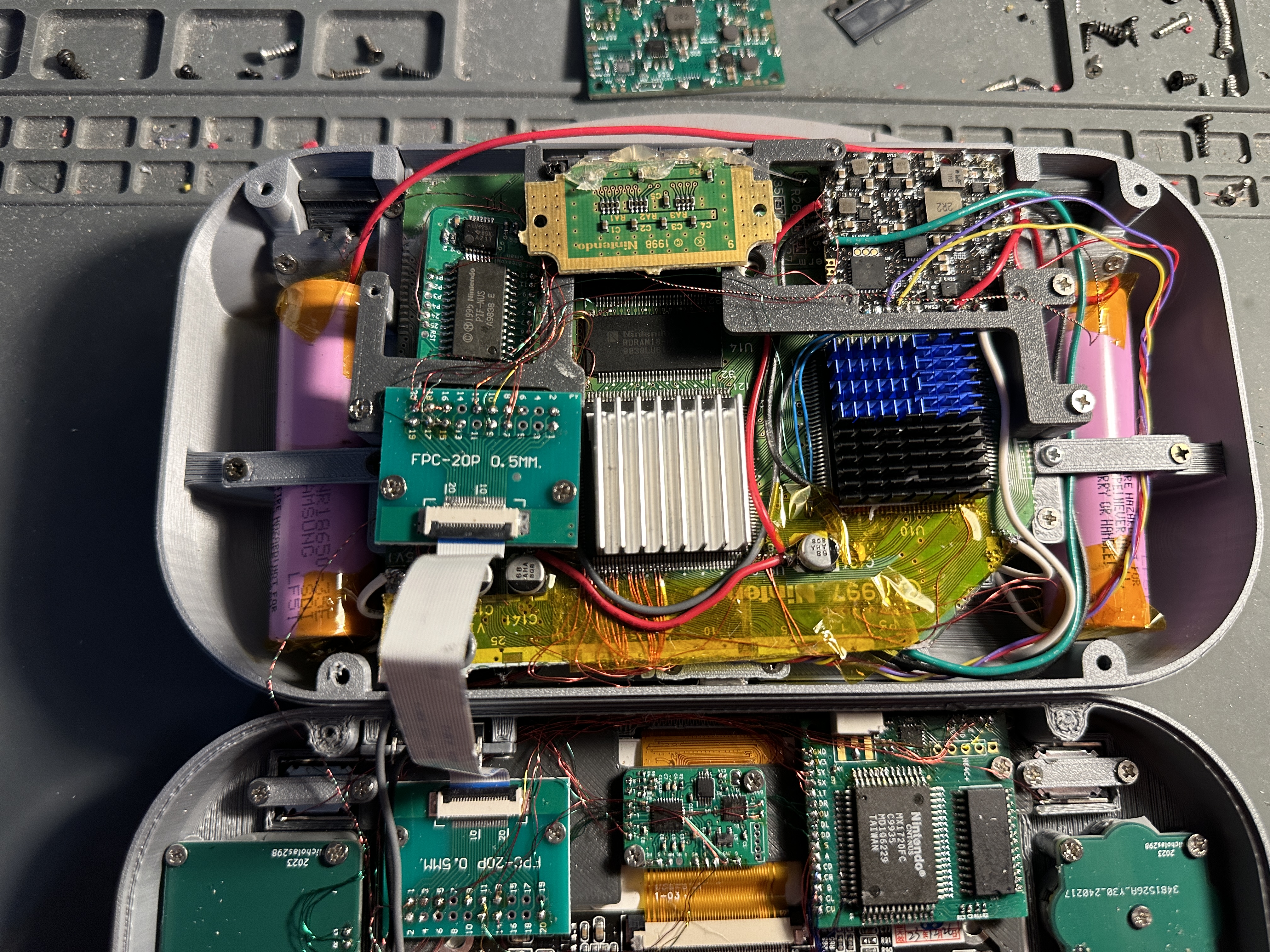

  • N64 Advanced Trim with RCP wiring
  • 5 inch 4:3 Screen
  • RVL PMS 2
  • 64 Amp
  • N64 Controller Module by Gman
  • 2x 18650 Batteries
  • Controller button PCBS

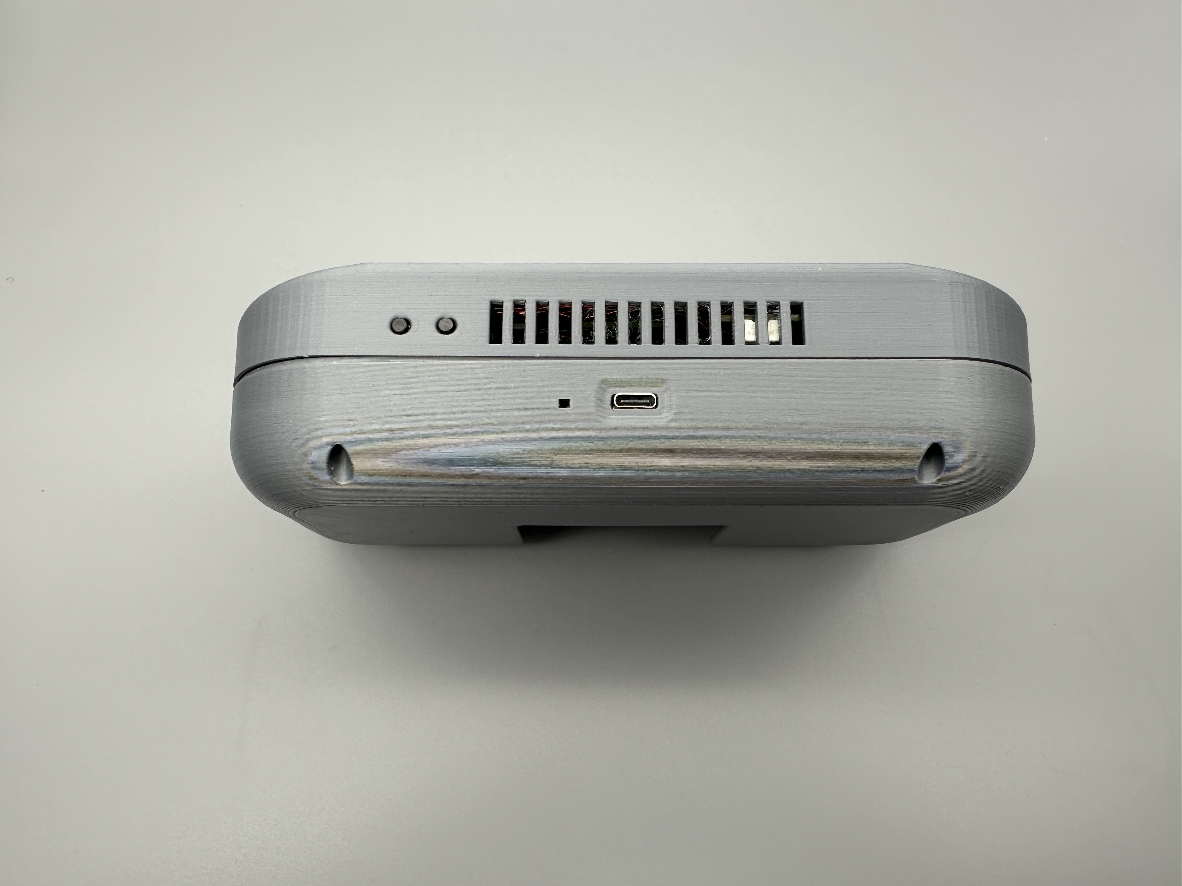

  • Added volume buttons and L Button
This build was a lot of fun and also my first time attempting an RCP wired N64 which was very tedious. I was able to get Gmans N64 controller board to fit by using slightly slimmer heat sinks on the cpu. I also opted to do the expansion pack bend just because of the rarity of the expansion packs and I figured if I ended up not being able to bend it I'd just buy another one anyways. You also have to get as close to the edges as possible especially on the cart slot side of the N64 or else it won't fit in the bracket correctly. My wiring isn't the neatest but the ffc bridging the halves make things a lot cleaner. I like the addition of the volume buttons in this build but the L button was unnecessary and probably not worth it.
Thank you @Nicholas298 for sharing the files and open sourcing the build!
