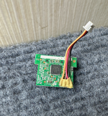

SD card reader recommended, reader can use 3.3v input and costs 2 RMBTF卡外接-淘宝网

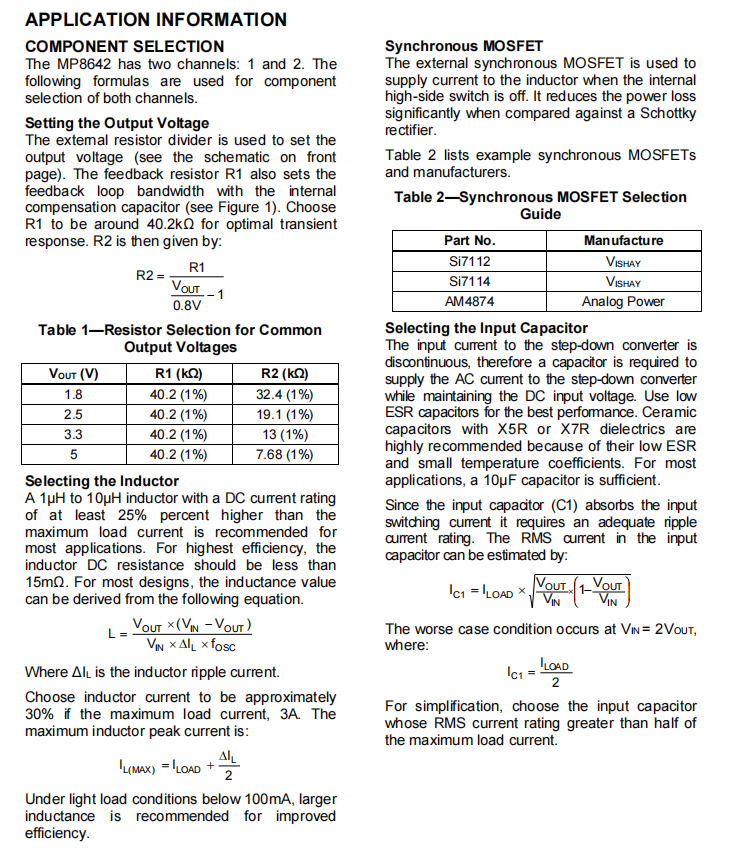

Recommended power supply module: three-way regulated power supply module, the module's main chip for theMP8642DU 12V-9V input, can output 3.3V, 1V,1.1V voltage, and three-way voltage is 3A, also can change the output voltage by adjusting the resistance value, the cost of 3.99 RMB
三路同步降压模块MP8642DU FDMC7696 芯片模块 三路稳压电源模块-淘宝网

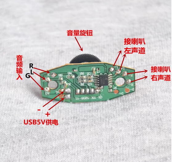

Recommended audio module: can use 3.3v to drive a two-channel 2w amplifier
USB供电diy微型功放板3W 8403升级模块5V小功放板迷你音响音频放-淘宝网
Cost 5.50 RMB (cheaper options available)

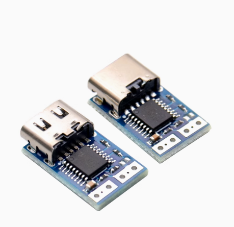

Recommended for decoy modules: 12V mainly for power supply modules
.PDC004-PD诱骗器 PD23.0转DC直流触发转接线QC4充笔记本912 1520V-淘宝网
Cost 1.90 RMB
微信图片_20250422141137.png Better husb238a can also be used Cost: 10 RMB or so

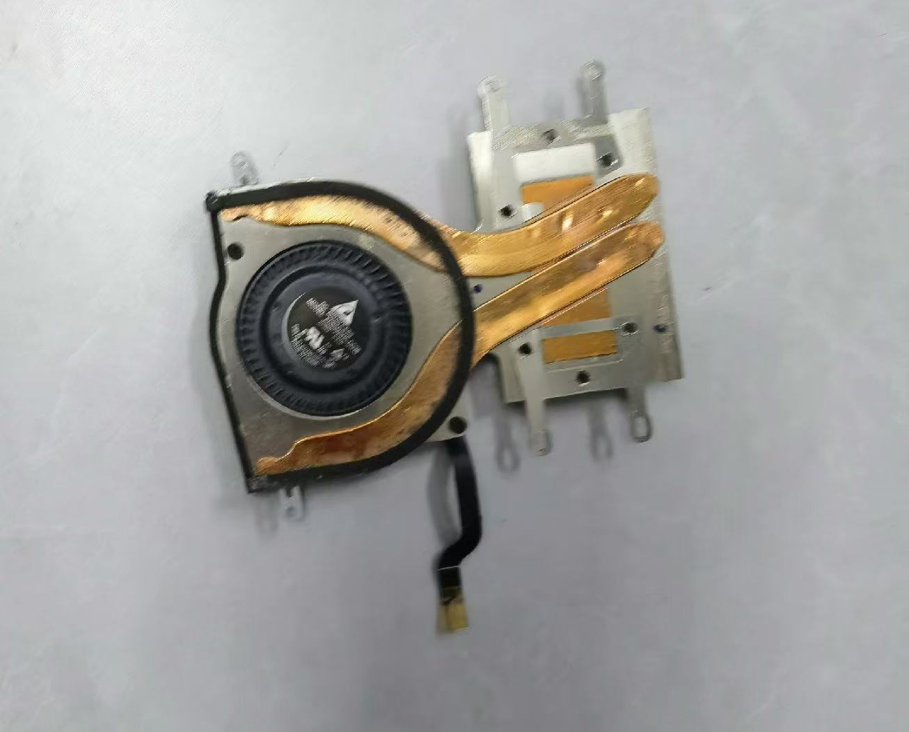

Cooling recommendation: surface pro3 cooler Cost 10 RMB a piece

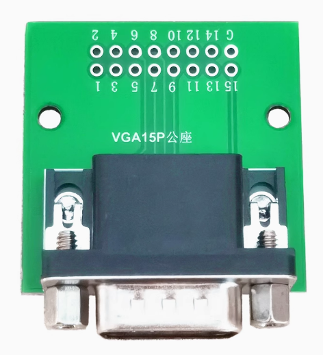

VGA interface (optional) DB15 HDR15 DR15卧式公座测试板VGA接口转DIP2.54 三排针DB转接板-淘宝网 cost 3 RMB

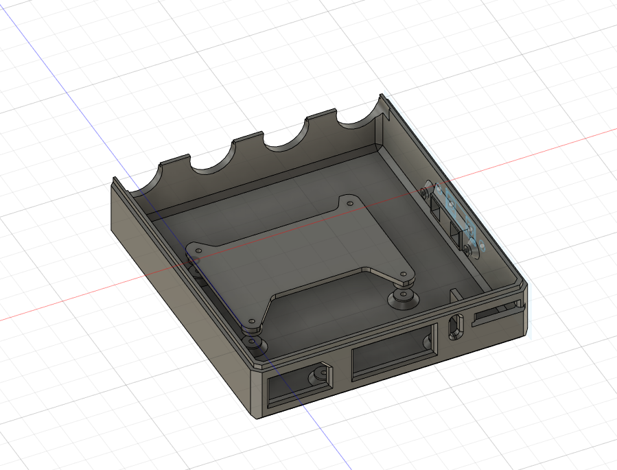

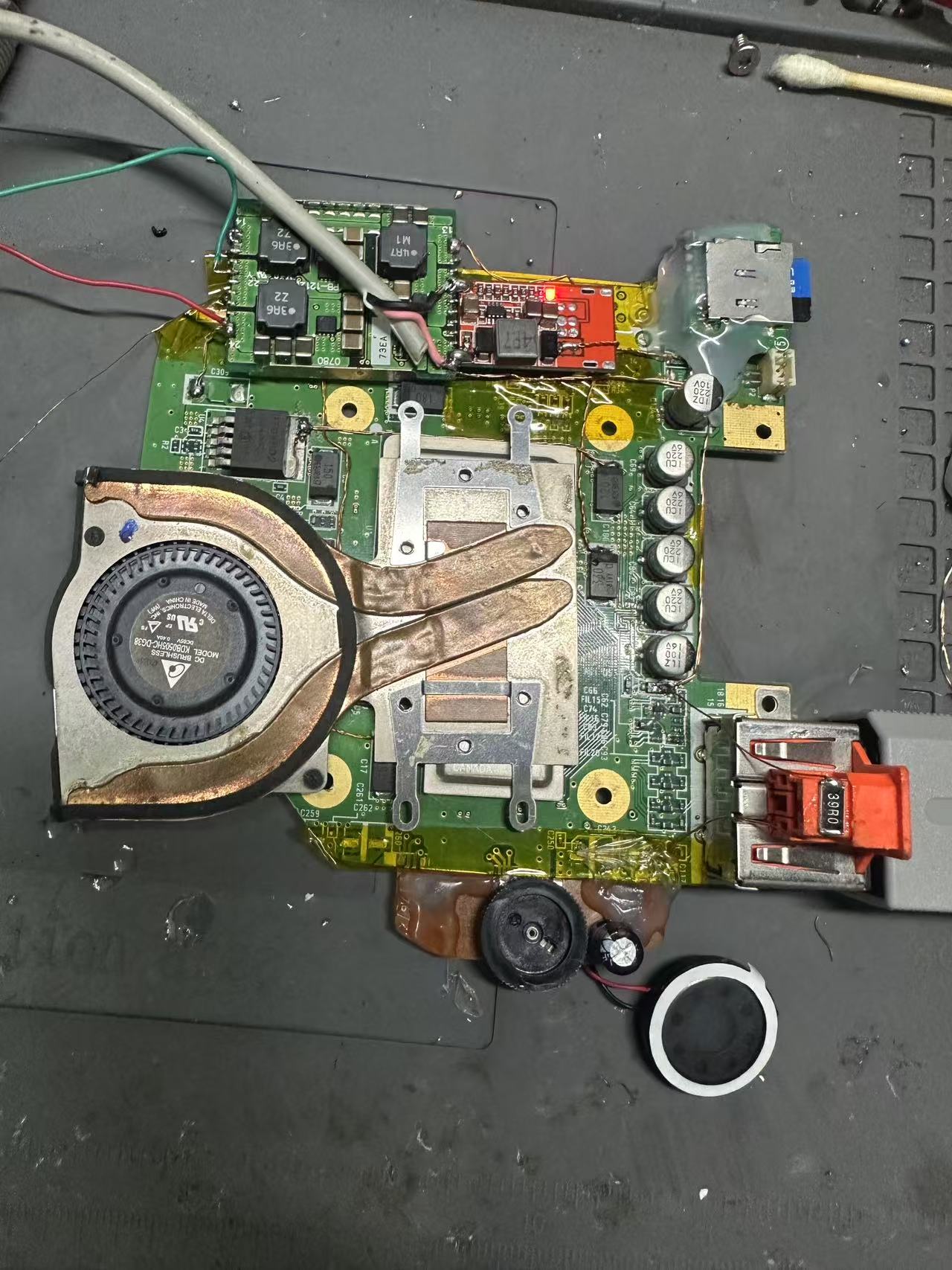

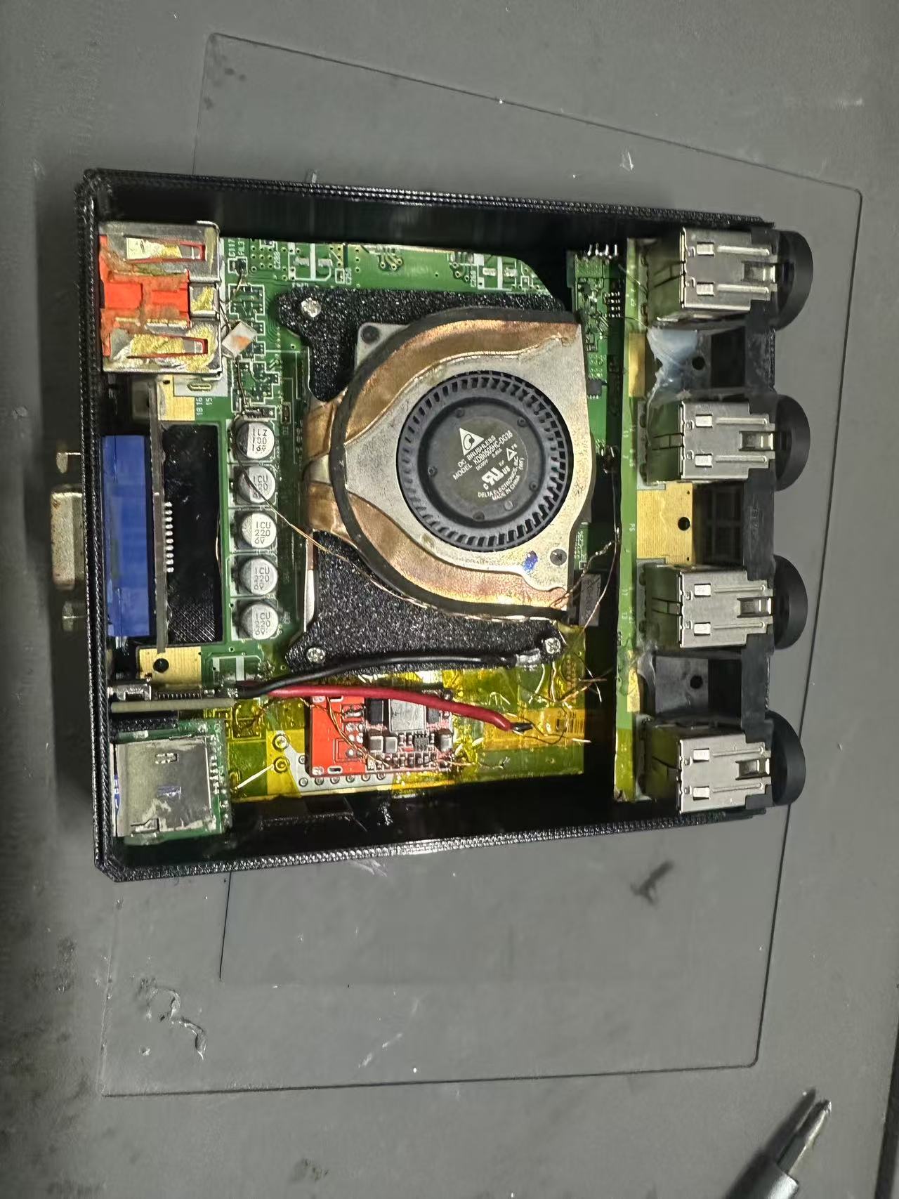

Using a surface pro3 cooler can keep the overall thickness of the wii to about five centimeters, I will be building a 3D model based on this project.

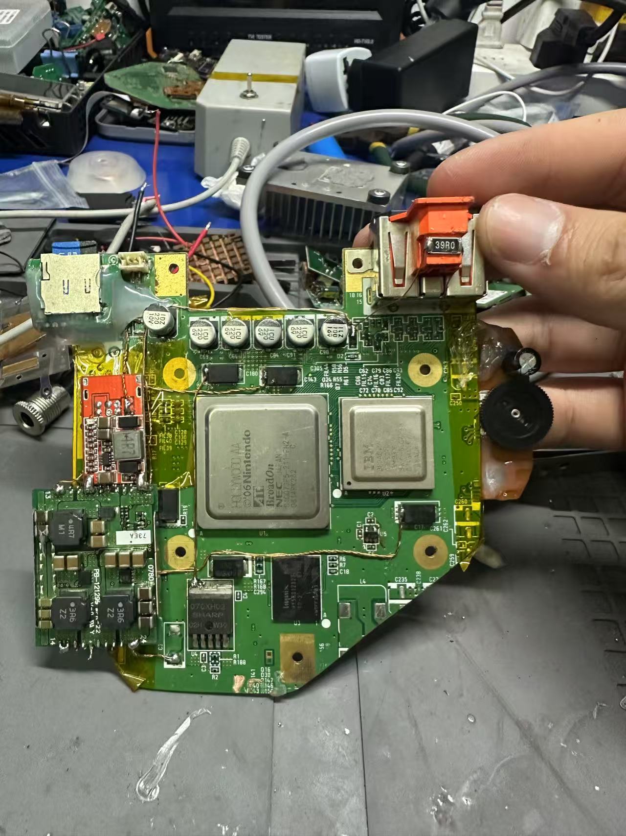

Front view wiring example: the front needs to remove the usb port and replace it with a tf card. Back need to remove the infrared interface, further reduce the overall thickness, the subsequent built-in infrared light
Example on the back:
Conventional wiring

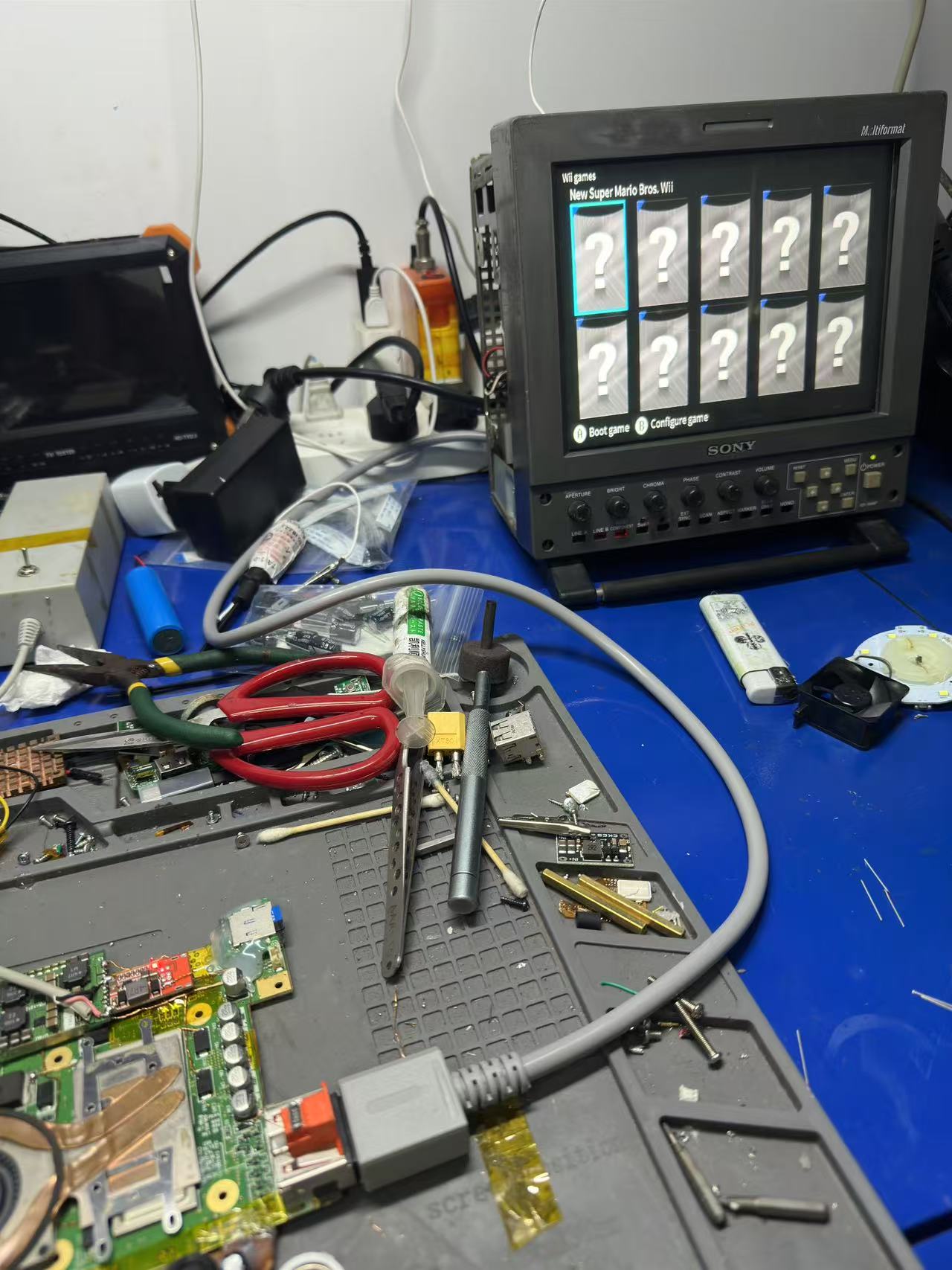

Lighting Test:

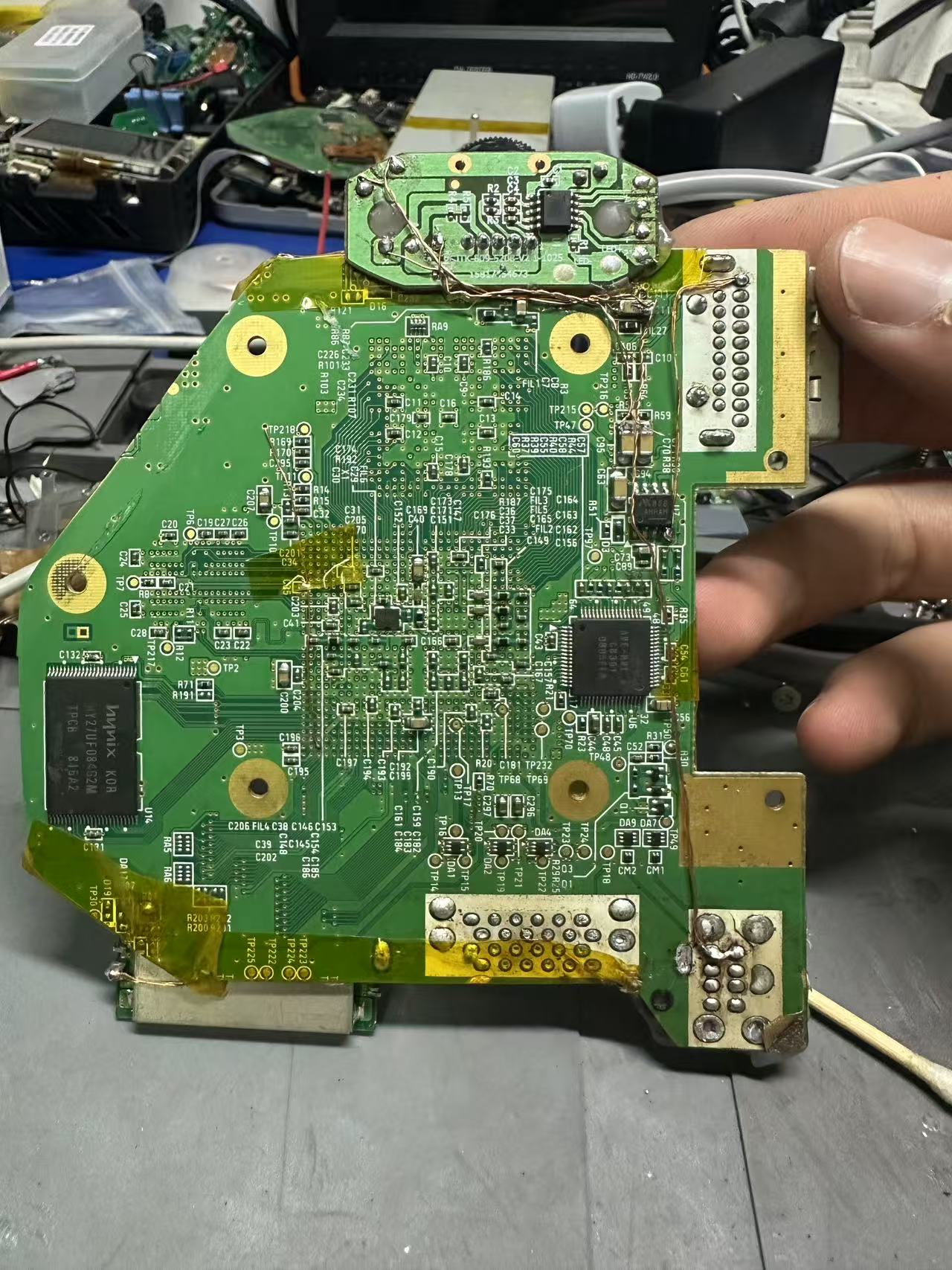

Sorry to bother you. I’m currently filing down my Wii motherboard and have a question I wasn’t sure if I should ask, but I’m really curious.
I recently bought 4 buck converter modules and was wondering if they would be suitable for this Wii Micro build.
Specs:
- Input voltage: 4.5V ~ 28V
- Output voltage: 0.8V ~ 20V (adjustable)
- Output current: 3A
I would really appreciate it if you could let me know your thoughts. Thank you so much!

According to the parameters of the power module you sent, this is okay.

If you send me a picture of your power supply module and the wii you built, I can help you better.
Thank you for the quick reply!
I’ll try to take some photos in a few days when I have time. I’m a bit busy right now.
My current progress is still at grinding the motherboard.
I forgot to relocate U10 first, so I’m basically walking blind here and have no idea if I’ve killed the chip or not.
