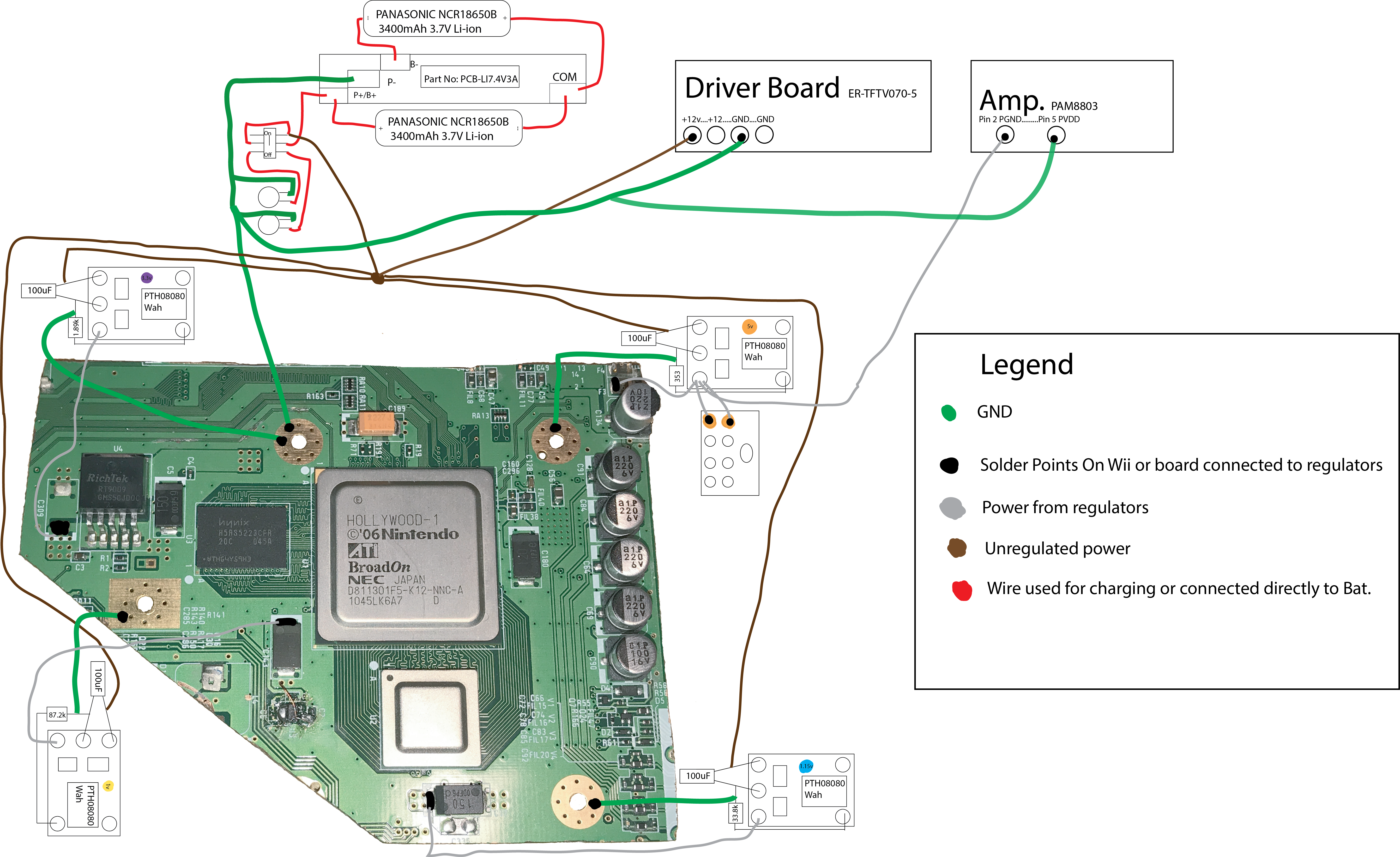

Hey,
I've been lurking around here for almost three months, piecing together how to make my portable. The one thing I couldn't work through is the circuitry of a portable. I understand segments, like custom regulators and the Charge and Play, put putting it all together has been an issue. Since it's so hard to explain what I think is the right circuit, I made a crude diagram.
index.php
I tried to be as detailed as possible. I know it is a big ask. I assume there are many mistakes. If anyone can help that'll be great.
**Things to note**
Not to scale
Placement of regulators, battery, etc. on diagram is not where they will actually be placed
The Wii board above is my trimmed Wii with U10(really a U9) relocated. Not going to relocate Bluetooth

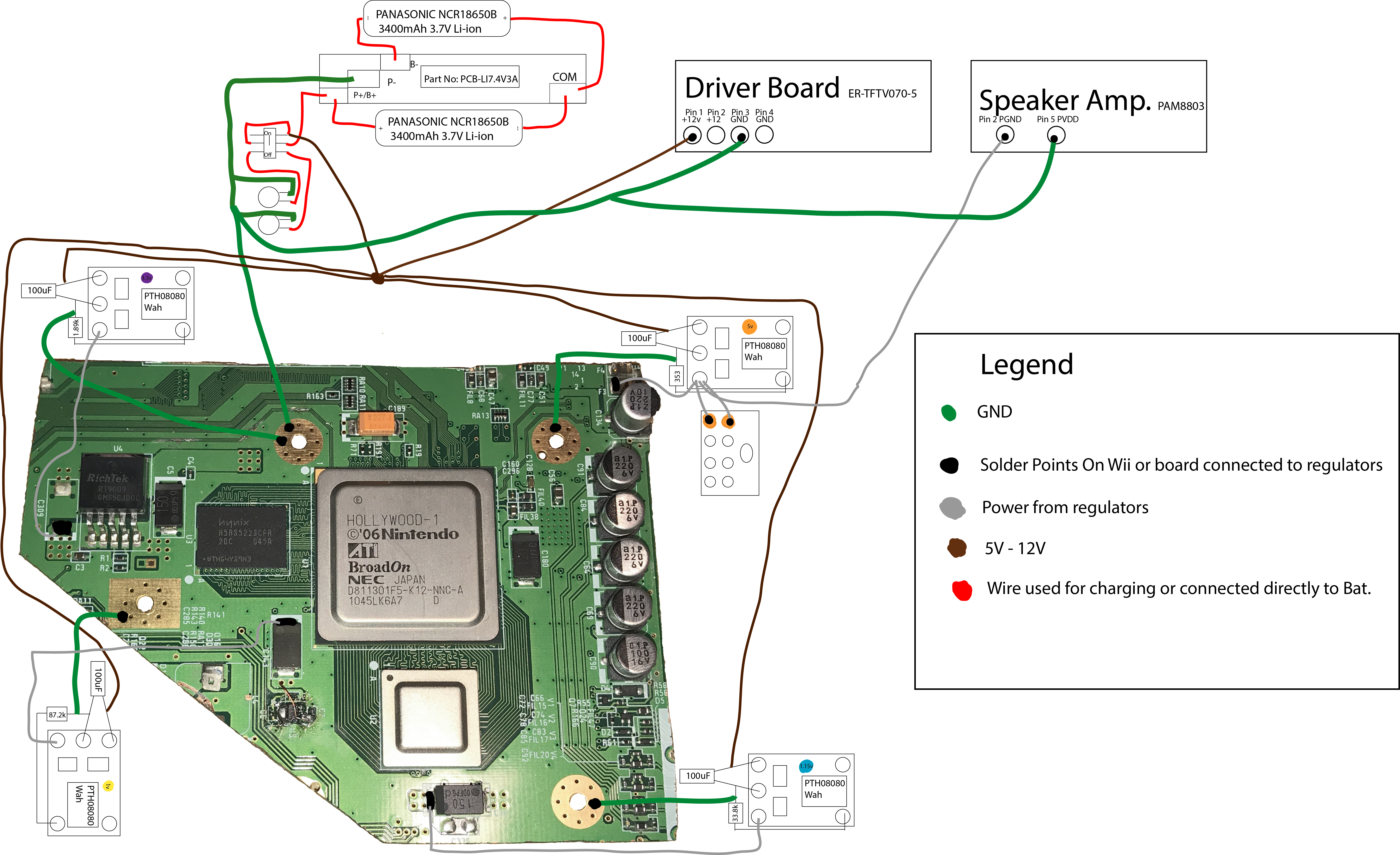

Nice! just a small suggestion
instead of saying "unregulated power" put in "5v through 12v" which is the range for the pth regs I believe.
