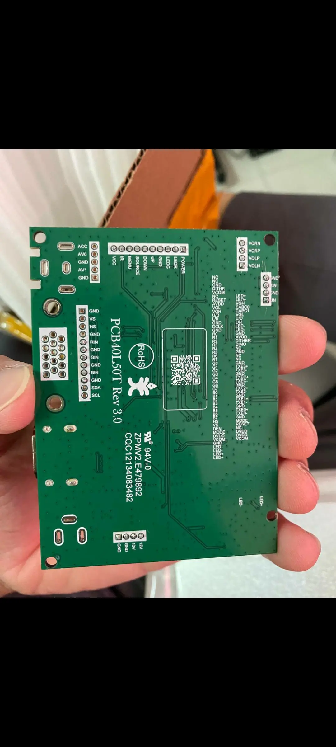

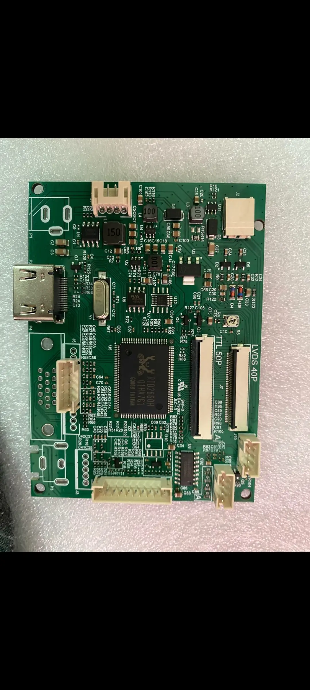

I recently buy this board specific for my ps2 portable project. Dose this board can be power using only 5v .if yes my plan to use 560 mini regulator to power the board

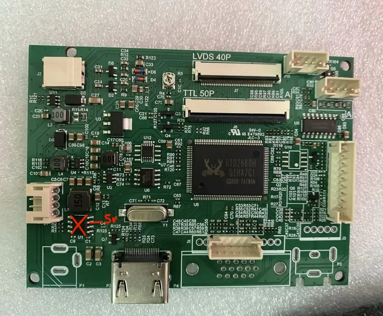

Hey I saw you posted on my worklog about this screen, it does look like the one I used I got mine off a Chinese portable. I would read thru this first as I don’t want to be responsible if something were to happen to screen.
On mine I removed the chip marked with red X and supplied 5v to the 2nd pin on right side

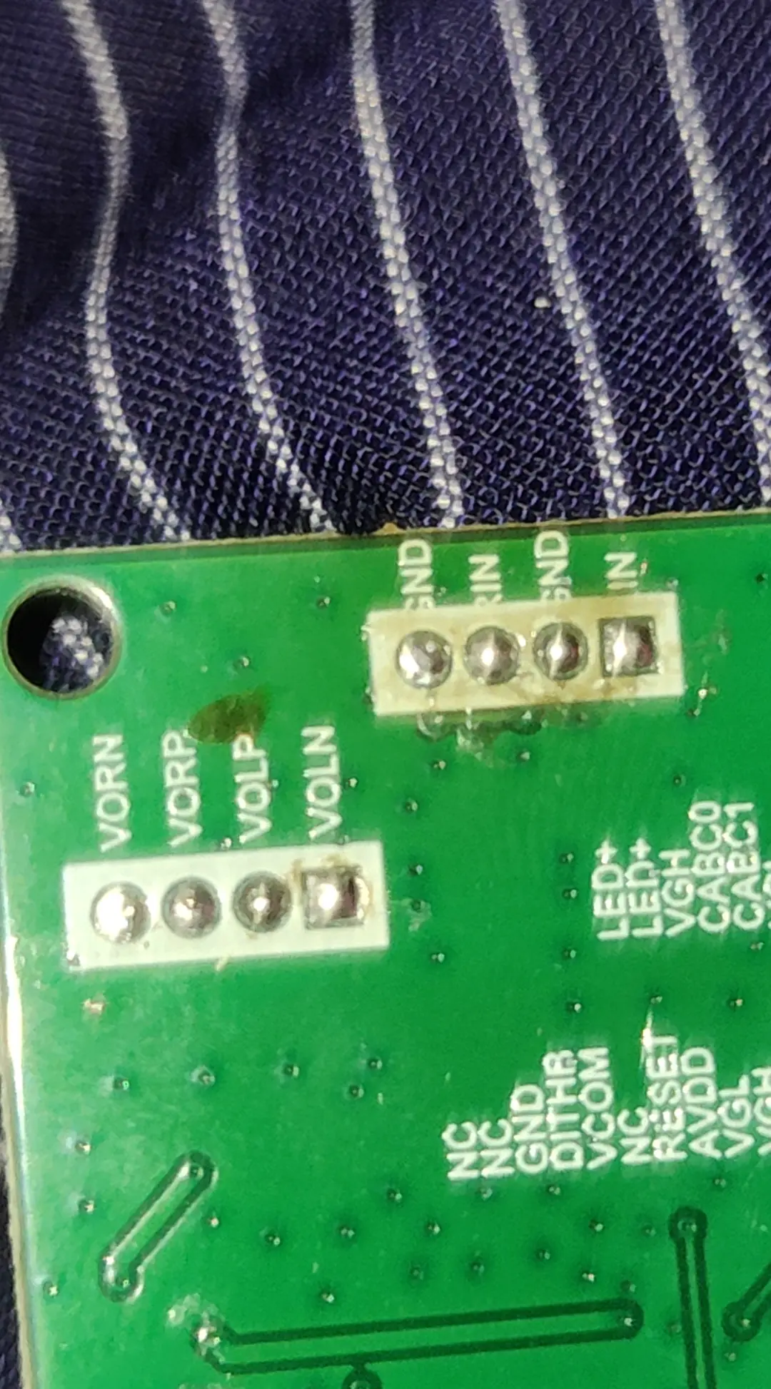

can you help me what those pins for scene I want to add speaker and volume control
View attachment 44211can you help me what those pins for scene I want to add speaker and volume control
The top row look to be analog audio inputs. RIN would be right audio in and LIN would be left audio in.
Second row I think are output lines for speakers. I am guessing VORN is Right Negative and VORP is Right Positive, which would make VOLP Left Positive and VOLN Left Negative.
If there is volume control I would assume it to be via the OSD.
Thanks you so much for very clear explanation and fast response.
