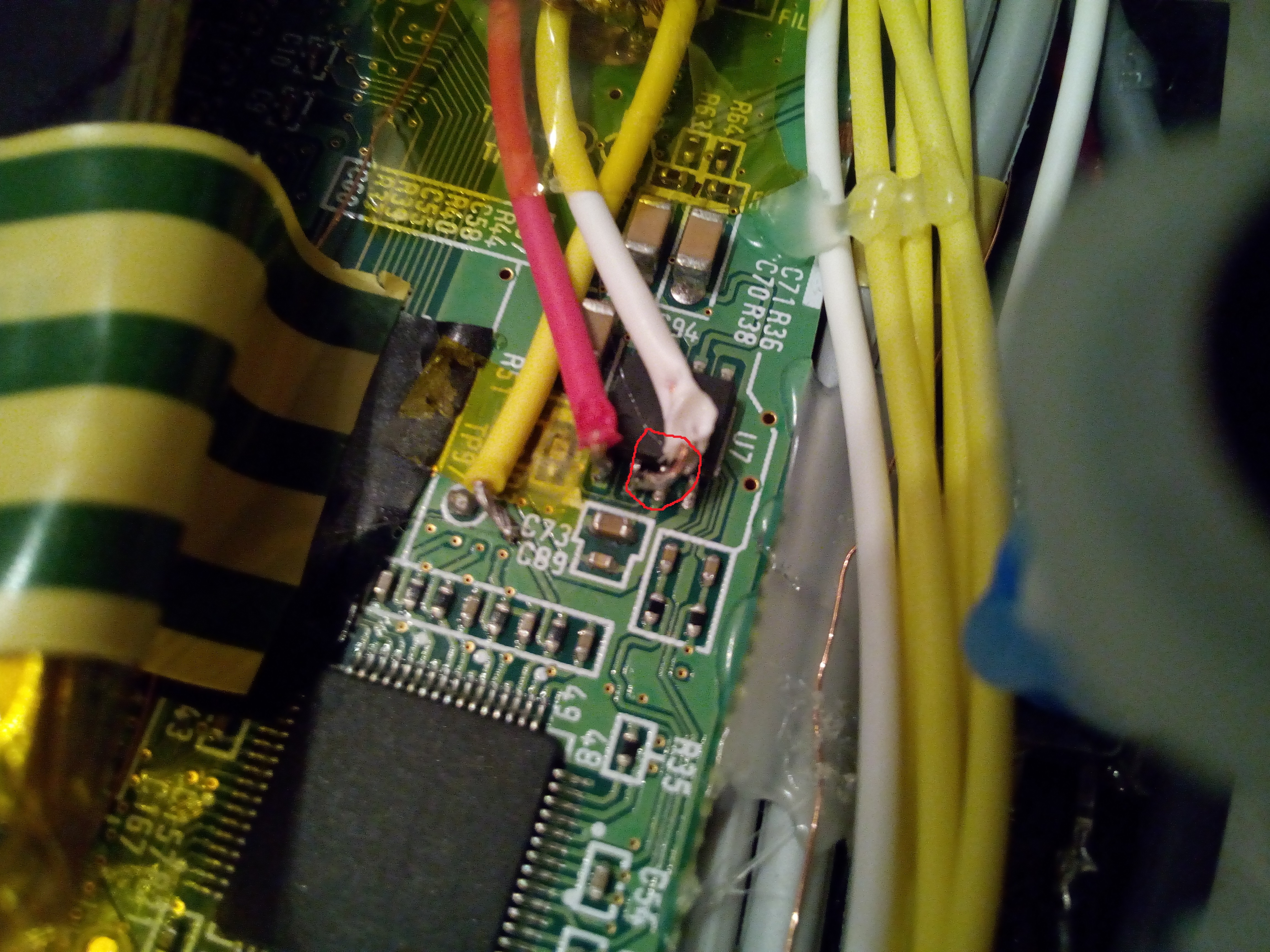

Got pictures? If it's not working, clearly something is wrong. Where are you grabbing audio off the wii, and did you use shielded wire?
The audio comes from the first two pins below the ampaw chip on the Wii.
Im using wire with ground, actually is a piece of wire cut from the AV wires that comes with the Wii.
I use the same wire for video and works fine with no interference.
As for pictures, I tried to take some of the amp itself but my controller wires are going on top of it and also hot glue everywere to hold everything in place so its hard to see anything on it.
Also, in the Wii wiring it looks like the white wire is shorting with the pin 3 but it isnt, I double checked.

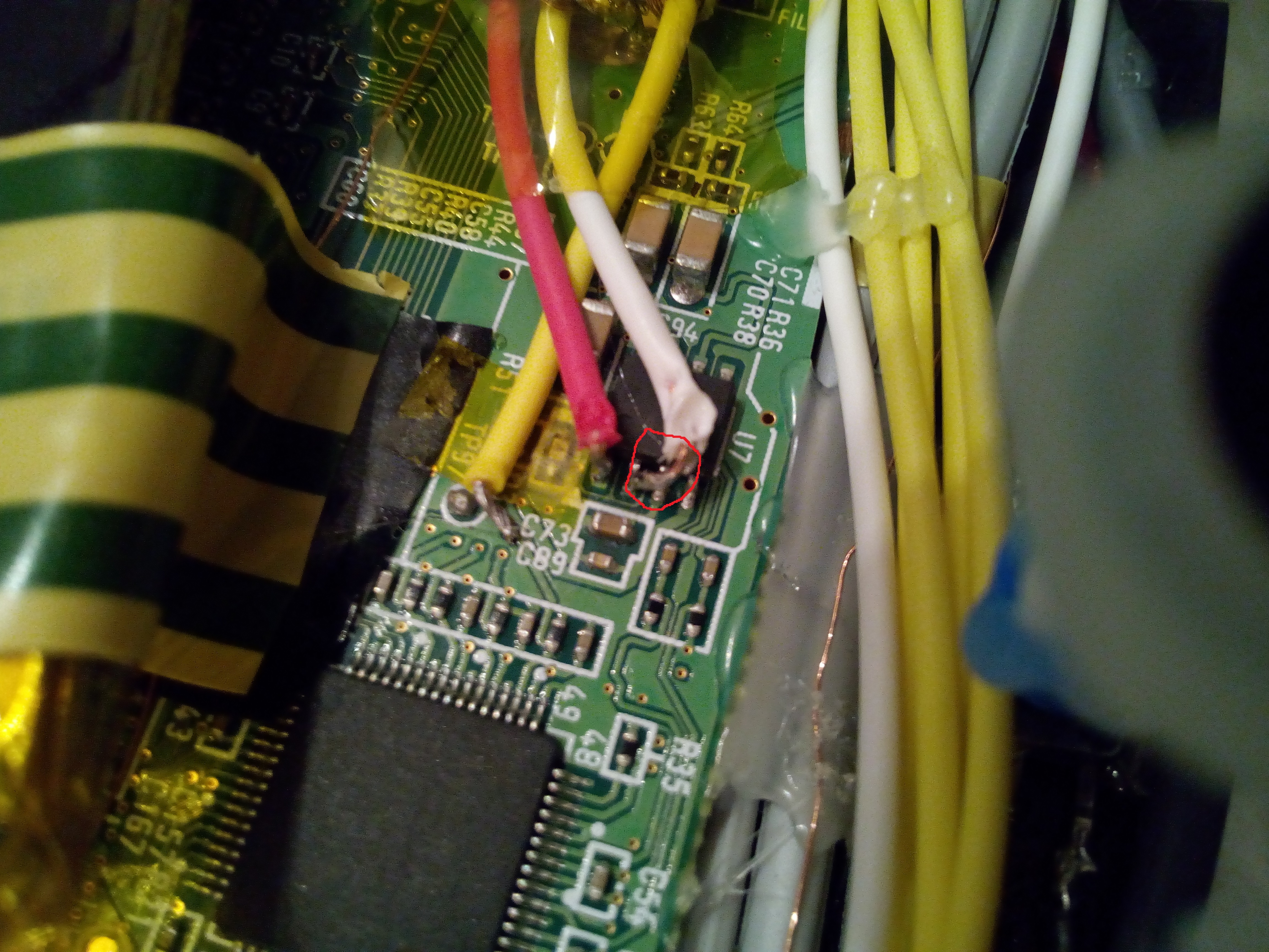

Did you perhaps put the audio into the wrong connector? From the third picture it looks like you're putting audio into the left connector, but according to the ebay listing it goes in the right connector
Yeah, looks like you've connected the Wii audio into the amplifier's volume control connector. If you're using a picture of the underside of the board as reference, remember you've got to think backwards to make it work :)
Unfortunately it is wired correctly.
The red , white and black wires on the left you are seeing in the 3rd picture are from the buttons.
Also the buttons work fine wich confirms that I wired everything in the correct place.

One thing that I noticed is that it looks like your white wire coming from the Wii's audio amp is touching the ground pin as well? Maybe try resoldering that wire. You can also remove the onboard amp entirely and solder to the pads if that makes it easier.

Thanks for the reply.
I double checked and it is not touching the 3rd pin.
From this angle you cant see it but it is slightly curved to the front so it doesnt touch it.

Knowing that often static noise comes from some sort of ground problem I've checked continuity between all the sound soldering points on the trimming guide and the Wii GND and found something.
If I check for continuity between the points in the blue arrows on the picture below and the Wii GND the multimeter beeps!
Is it suposed to beep or are the sound traces somehow shorted with ground??

Try wiring to the points right above that, I wanna say that is the ground side of a pull down resistor
