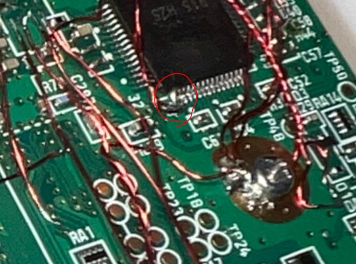

Can you test if there is a short between your H and V sync cables on the AVE chip? It's common for those to get shorted because they're quite difficult to solder.
The VGA output will not work if the H and V are not properly wired. Looks like you might have a blob that could cause that signal to short:

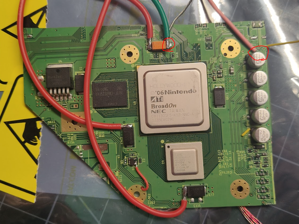

For troubleshooting video, I'd recommend you remove 3.3 volts from mode and wire in an AV cable. You can take the stranded wire and solder to ground, and the single wire and solder to pin 3 on the wii board.
This is what I did for bench testing my wii:
