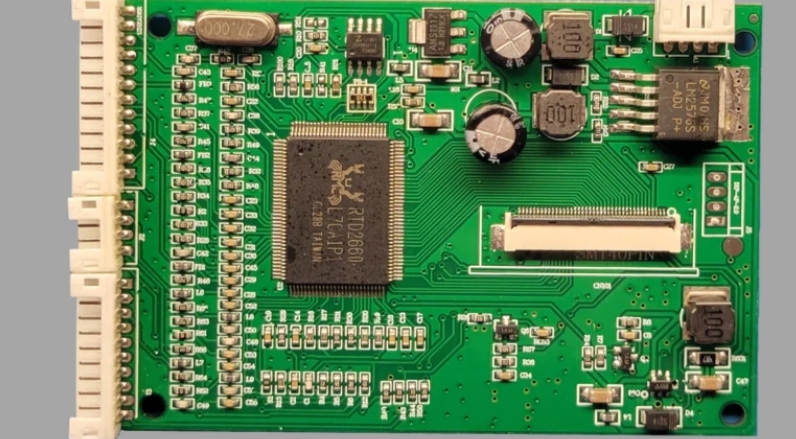

Does anyone know if the blue driver board from 4layer tech have the optoins to use screen controls?
The green driver board isn't availbale anymore. No information or refernce came with my purchase of it, just what is listed on the site's description.
The green has more pads/pins to connect to as oppose to the blue driver board.

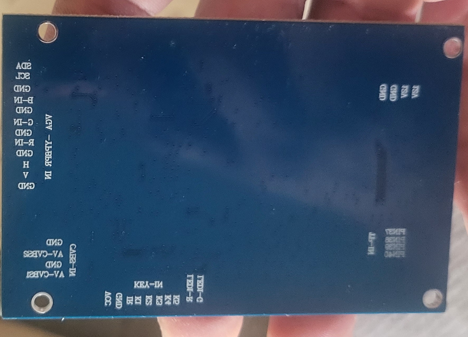

The labels on back of the blue driver board. I don't know what labels are are the back of the green driver board.

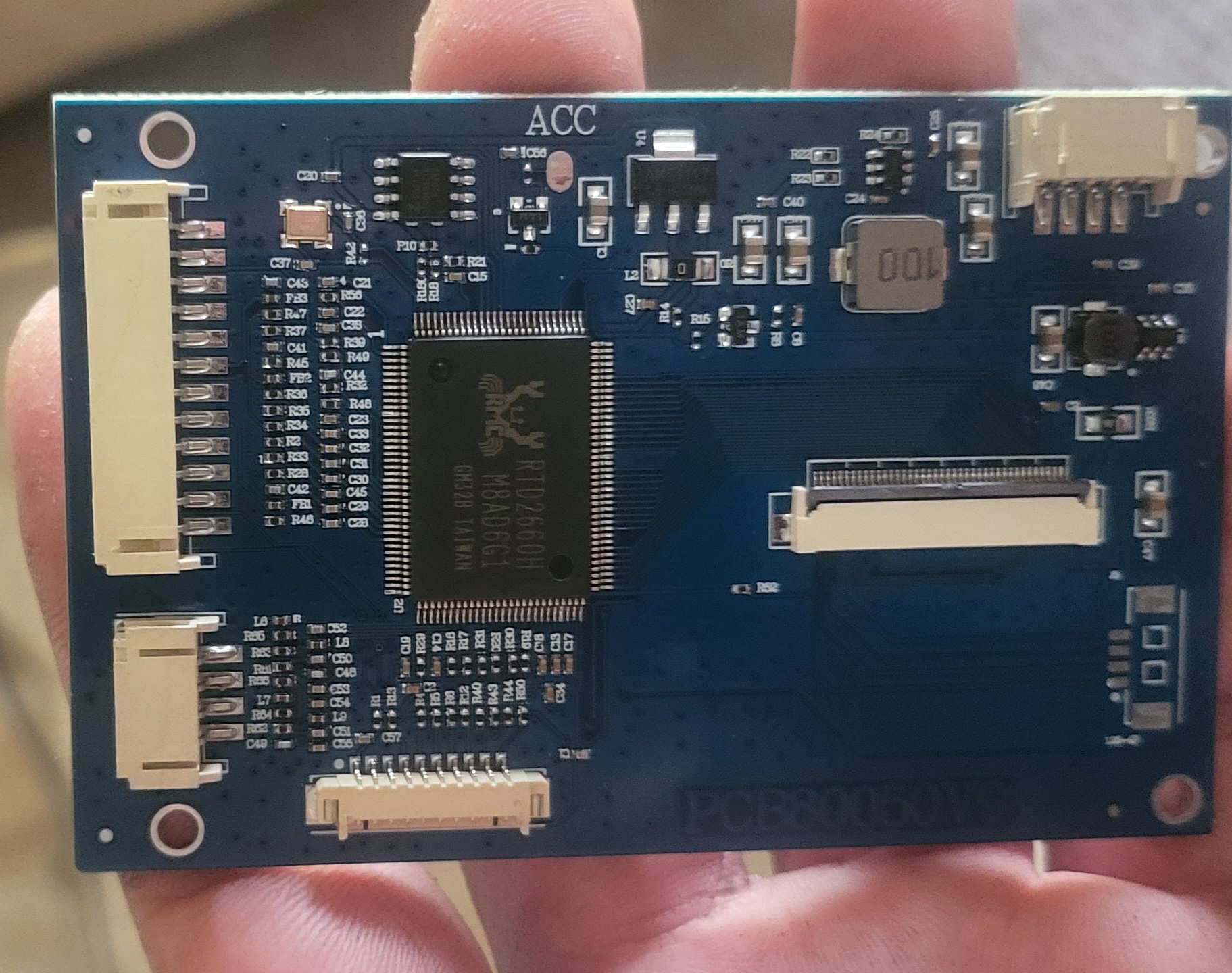

You just received the PCB800050v9 revision of the PCB800050 board with the RTD2660 / RTD2660H (RTD2662) chip, and you're wondering about the silkscreen labels for input buttons.

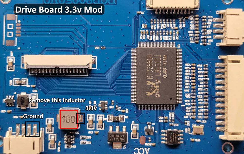

You're asking about removing components to run of 3.3v, as shown here:
You haven't (yet?) encountered the silkscreen label problem from this thread:

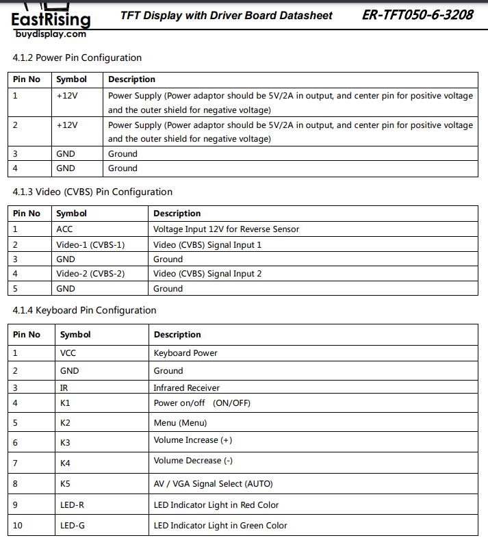

K1: Power
K2: Menu
K3: +
K4: -
K5: Source
You can do the same thing Ginger did with cuttting the trace between the 2nd button and 3v3, then wiring it to gnd.

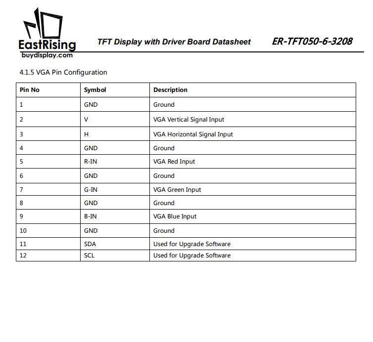

Thanks for the info. I kept digging earlier and I believe I found the data sheet for this board so anyone can reference if they come across this post.

for the audio and video. I guess if I encountered this silkscreen issue you have supplied a answer pre-emptively .
And yes someone mentioned to me where to run the 3.3v line after removing the inductor(both were shown on 4 Layer).
