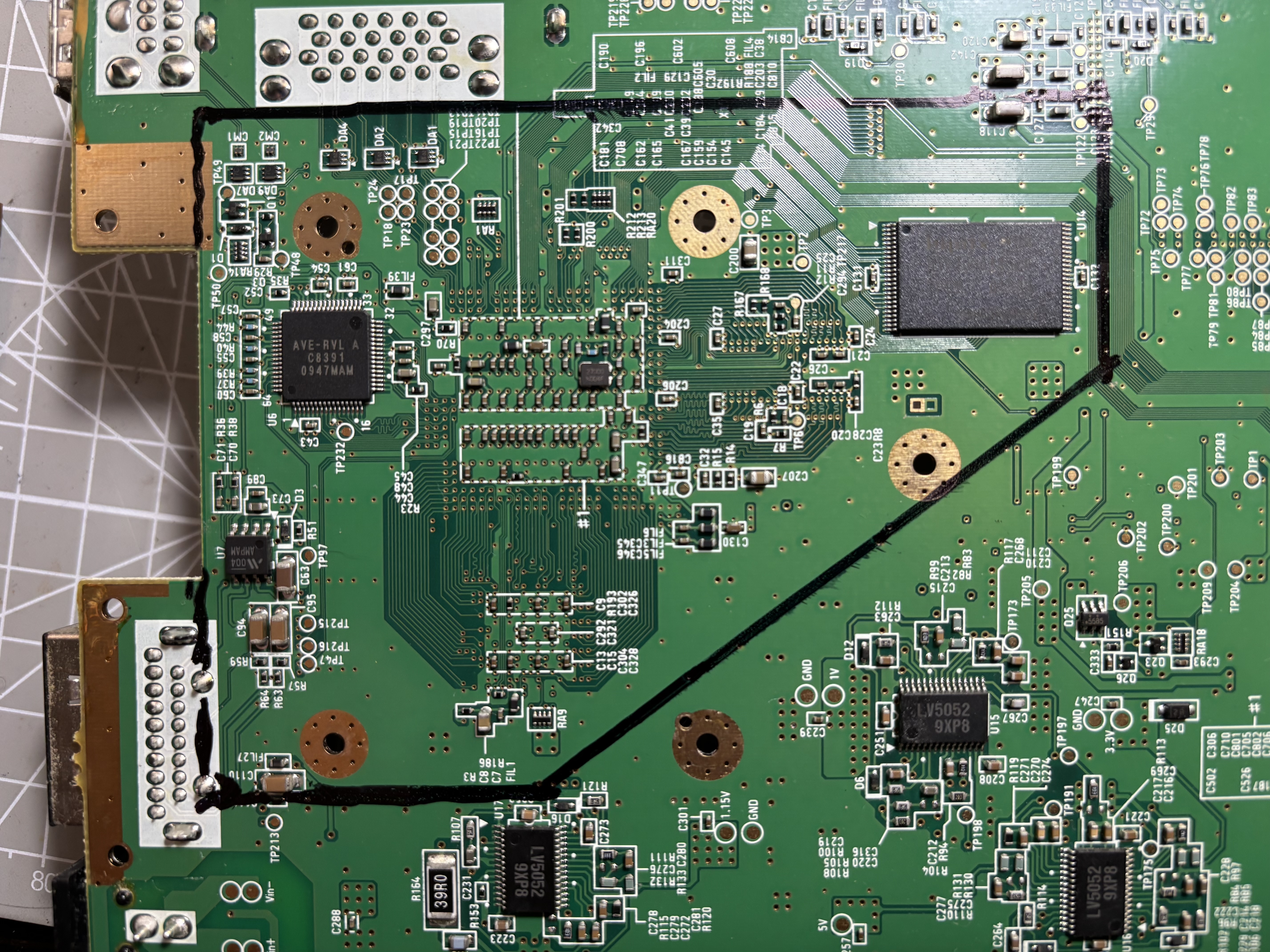

Hey, I know this is a basic question but I just wanted to get an outside opinion on if the lines I drew for a basic omgwtf trim are safe. I don’t want to risk anything after I flew a little too close to the sun last time.
thanks!
Send it. I trust you already know to trim outside the lines then sand in?
Also- remove any components that's through the trim line on the top. Usually that's a round capacitor near the USB ports and a voltage regulator of some sort as well.
Alright! Also I do know how to prep for the trim and how sand the mother board thanks to GingerOfOz's VODs. Thanks
