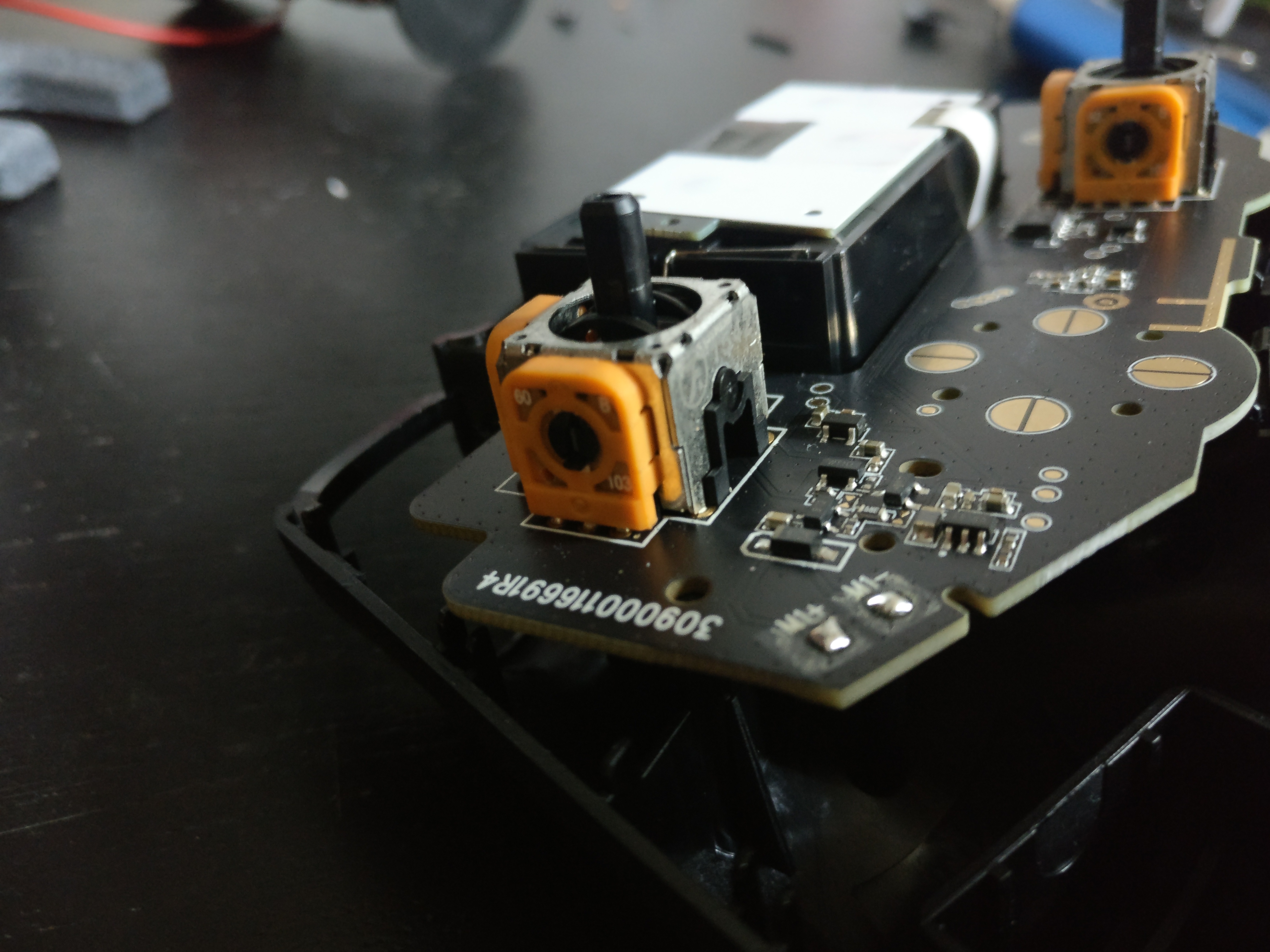

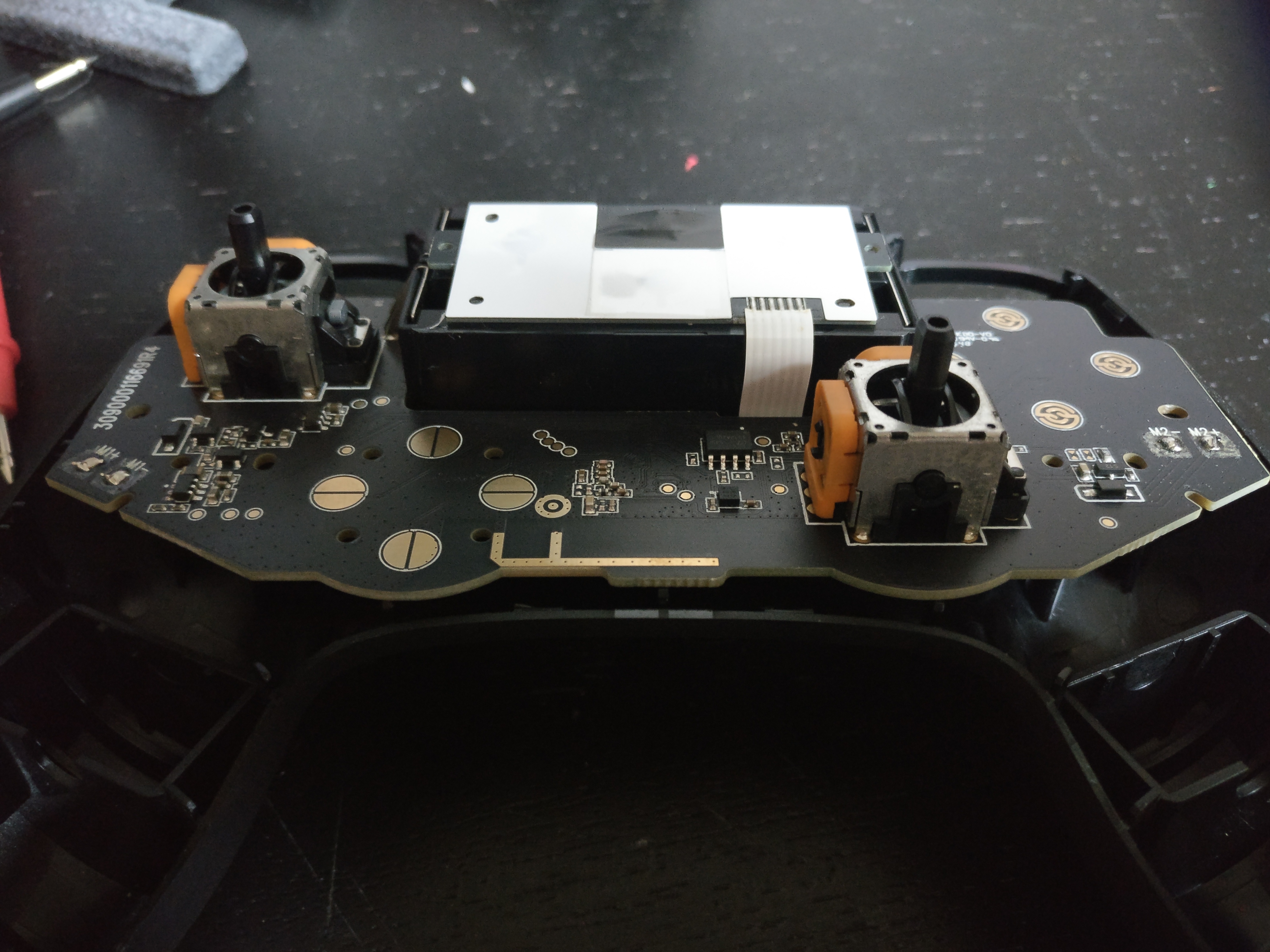

Hey everyone,
I'm trying to build a gamepad for my phone base on a mi gamepad (refer to as mipad for the post) board i found on kijiji.
I want to replace the stick for 3ds sliders to minimine heights, I read a bunch of documentation about replacing joystick with 3ds slider but I'm a bit lost as to what would be the best course of action.
From what i saw the 3ds slider are different than regular pots of a joystick so i tried to measure the maximum and minimum value of each but the numbers given are weird (example: the Y axis of the mipad gives me 2.9 k for up, 3.2 k for middle and 0.4 for down) so maybe I'm not doing it properly
I attached pictures of the mipad below, any help at all would be appreciated, thank you

I think that it is probably much easier to use a different micro-controller than the one on that board, as 3DS sliders are just really weird. If you choose to do so, you can still use that board; just cut the traces from the button pads and then rewire the pads to the other micro-controller. The TeensyLC is likely the best micro-controller for this purpose, as it is only 12 USD, is very small, can be found at shops like MicroCenter, and most importantly has built in HID Joystick functionality. I have already developed some pretty extensive code for this purpose, and I will attach it to this post. It is still a WIP, however it likely has more than you need anyway.
