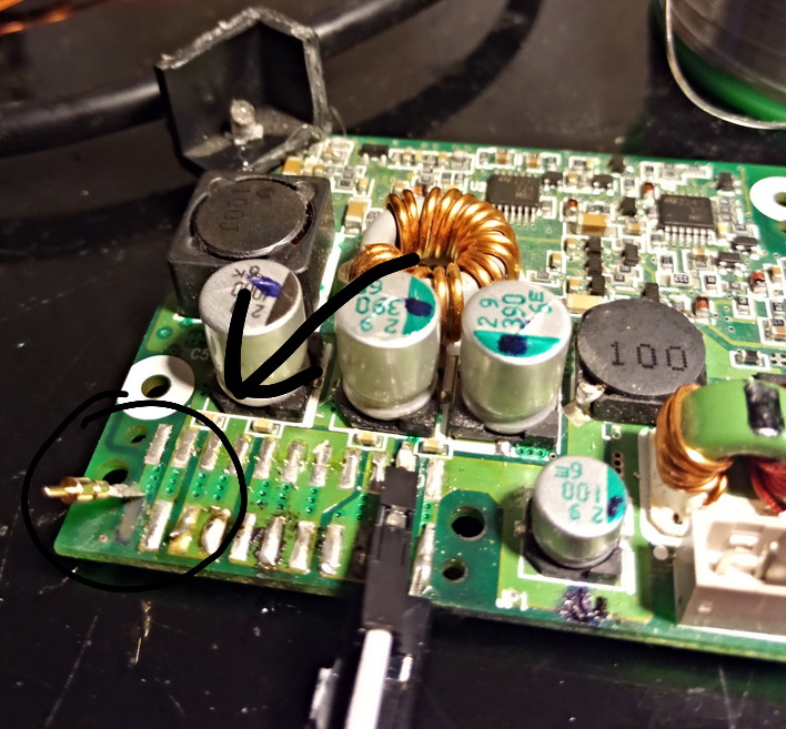

I was rewiring the regulator for the gamecube portable I'm working on because a couple wires broke, and I accidentally bumped a wire and the pad for the ground pin on the regulator lifted off the board.
Can I use any ground point on the regulator board and wire it to the GameCube? I was thinking of using the continuity function on my multimeter to find another ground to use.
Uhh, Pic of the board? you can scratch the trace, and then solder it to that.
Most likely the thing has a ground plane, and you can just solder to that.

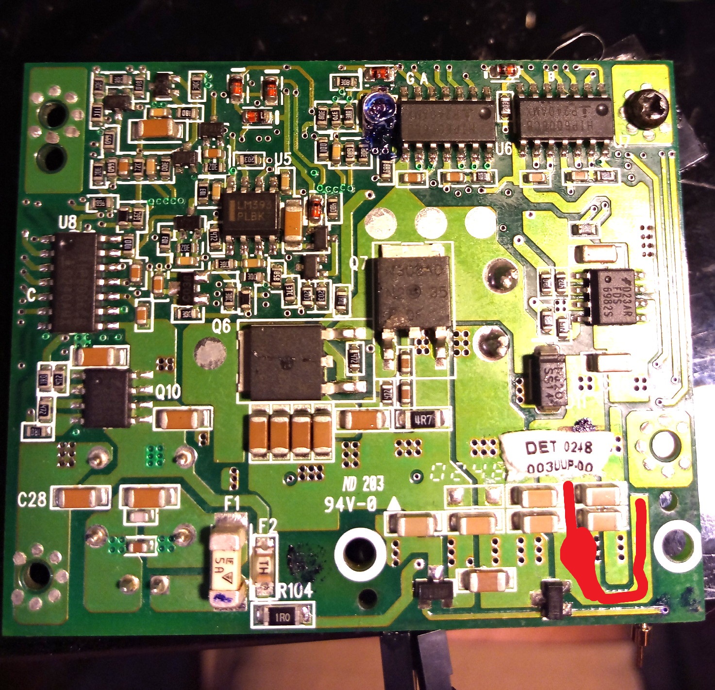

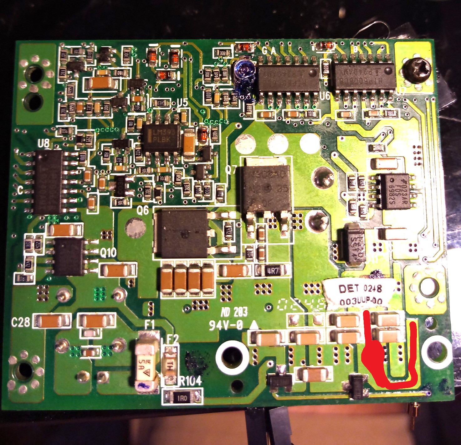

Sorry, shoulda put a picture with it. Here it is, I circled the pad that is damaged. IMG_20180701_211735-picsay.jpg
Uhh, can I have a pic of bottom and top? to find more ground places(best way to find is with a multi meter)
You should be able to scratch that trace in red
for ground

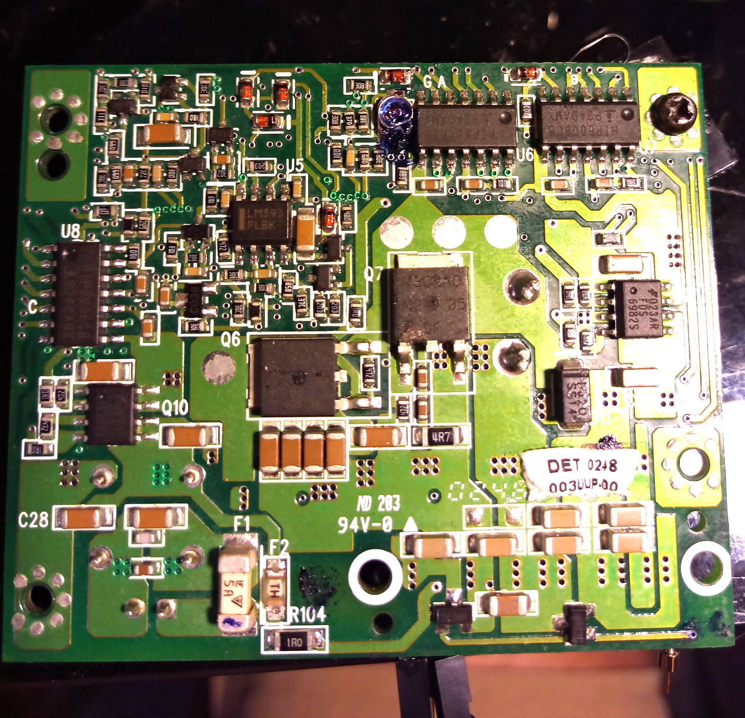

for ground

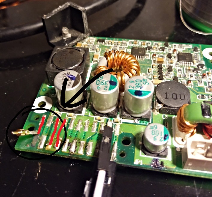

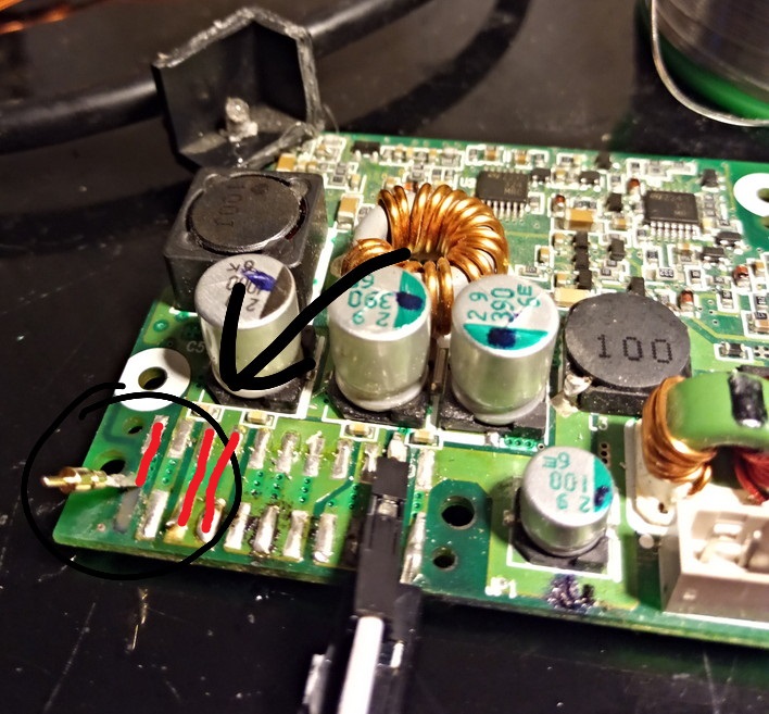

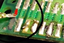

Sure.
So I did a continuity check and some of the other pins shown, including the one directly above the damaged one, are also grounds, so I should be able to use any of those pins alternatively, right?
Looking at the pictures, you should be able to use any of these points marked in red.
