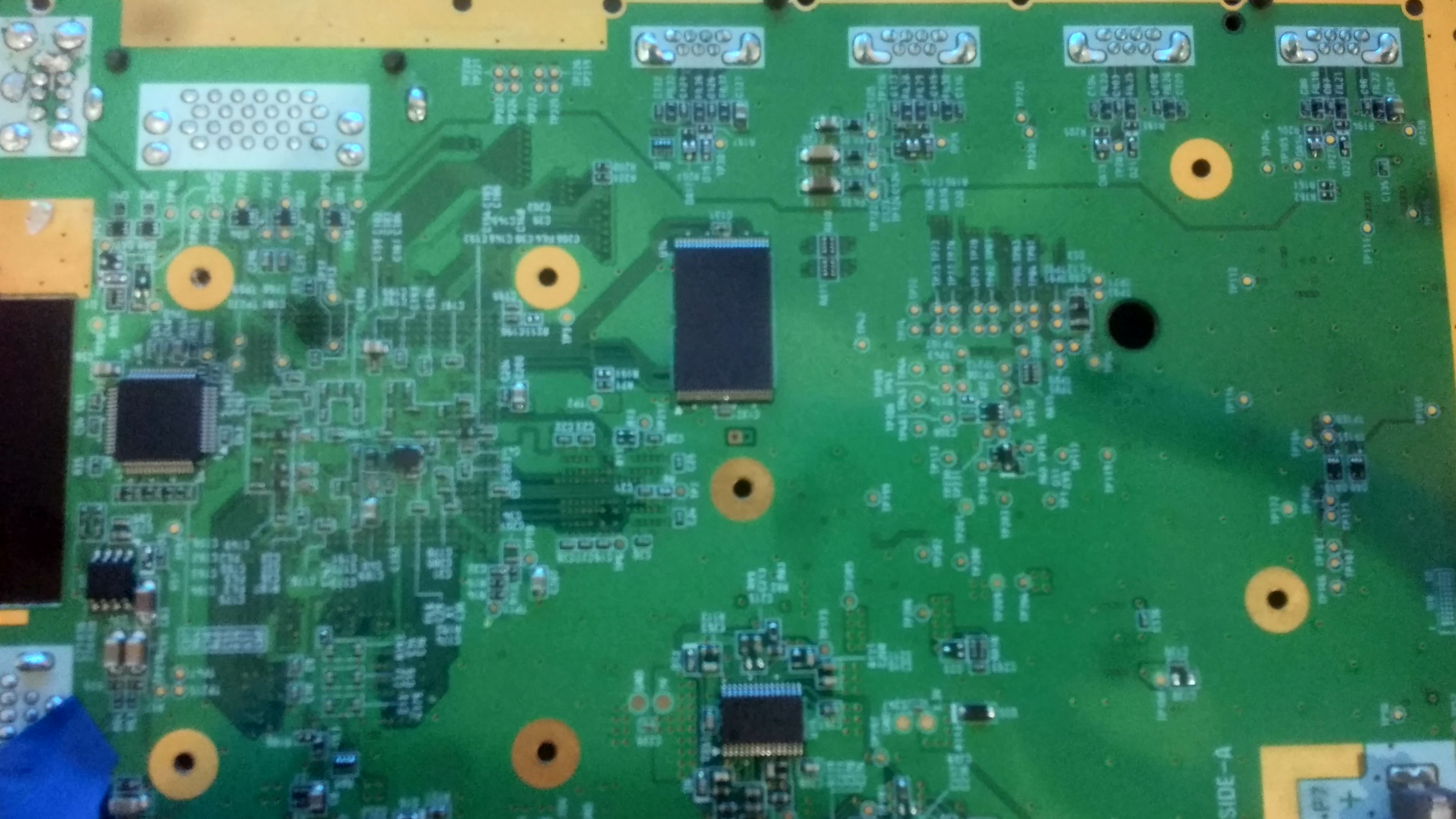

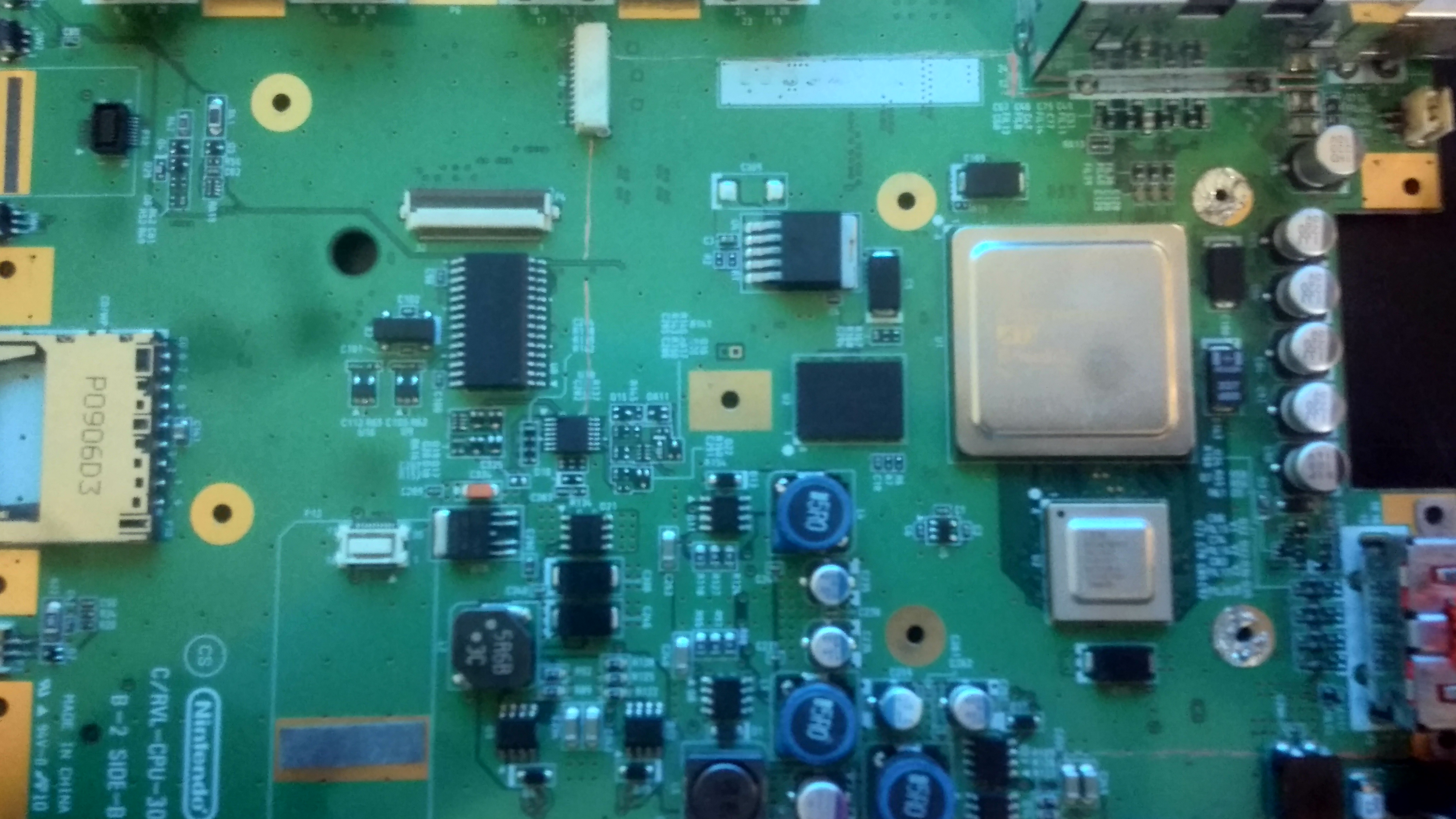

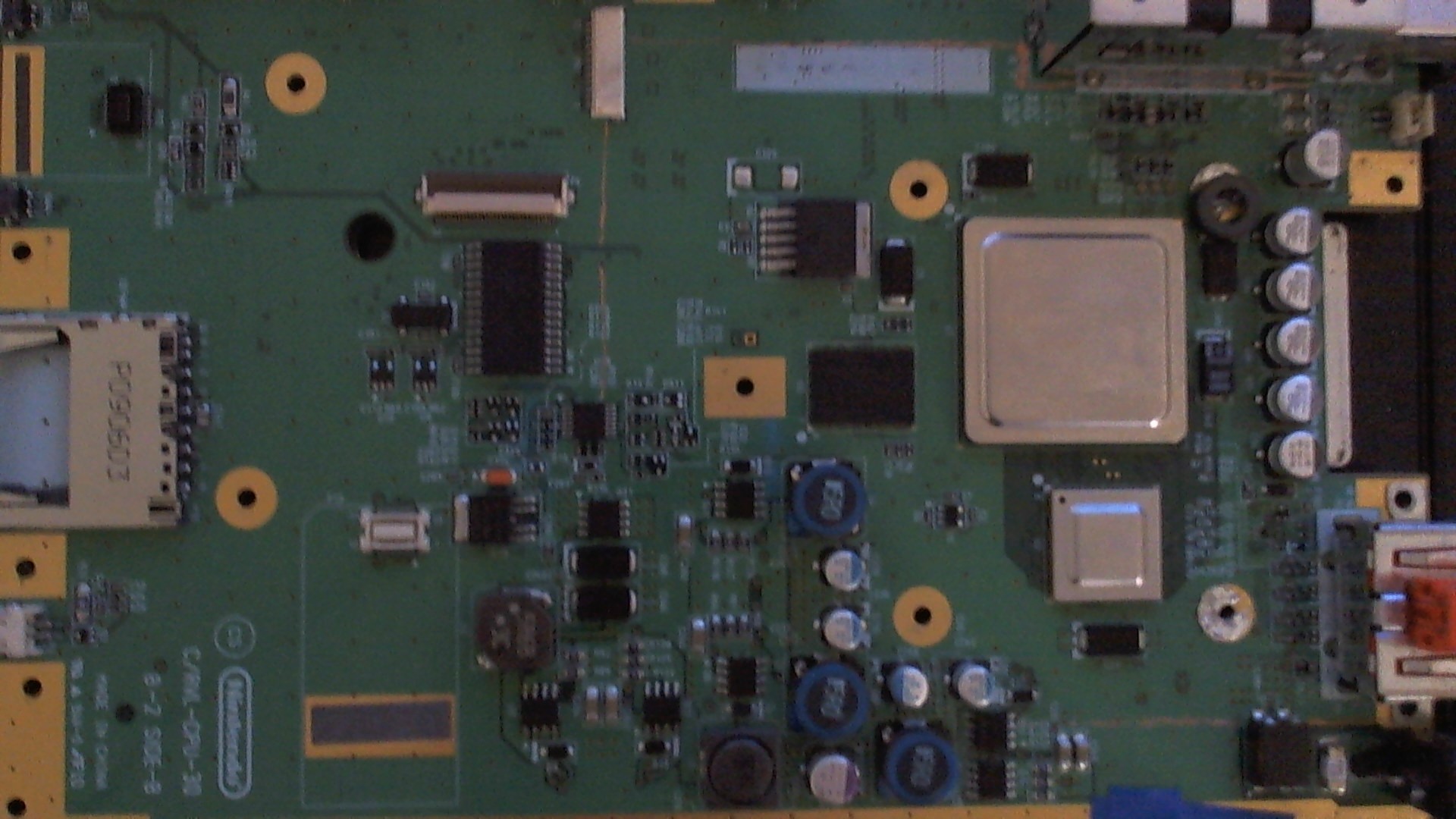

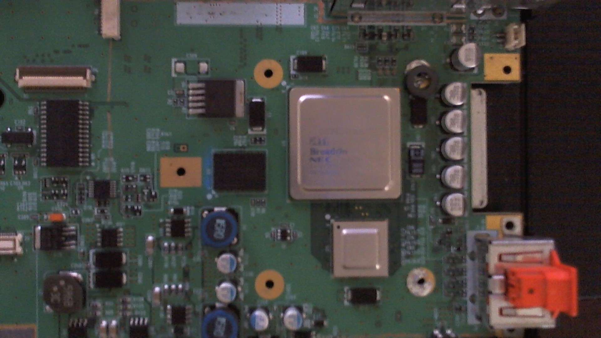

That's a very vague issue. Some photos of the current state of the board would help
Sorry for the poor image quality.
We need clear images to see if something's amiss. Also what about the back side of the PCB?
Is this better?
I don't think there is anything wrong with the back side of the motherboard.

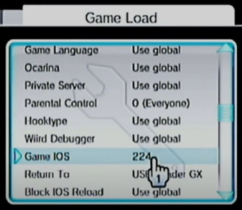

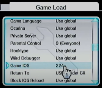

If wii games started before and now they don't, and everything else works correctly, (if you use USBLoader) it may be that you have misconfigured the game's IOS number incorrectly, or at least that happened to me, that when I wanted to enter a game it would freeze and go to the start or I would stay on a black screen, if this does not help could you provide more information.
how to configure game ios:
enter options> Game Load> Game IOS> enter one of the following combinations of 3 numbers: 222-224-248-249 -250-251
at least this is the solution that worked for me
