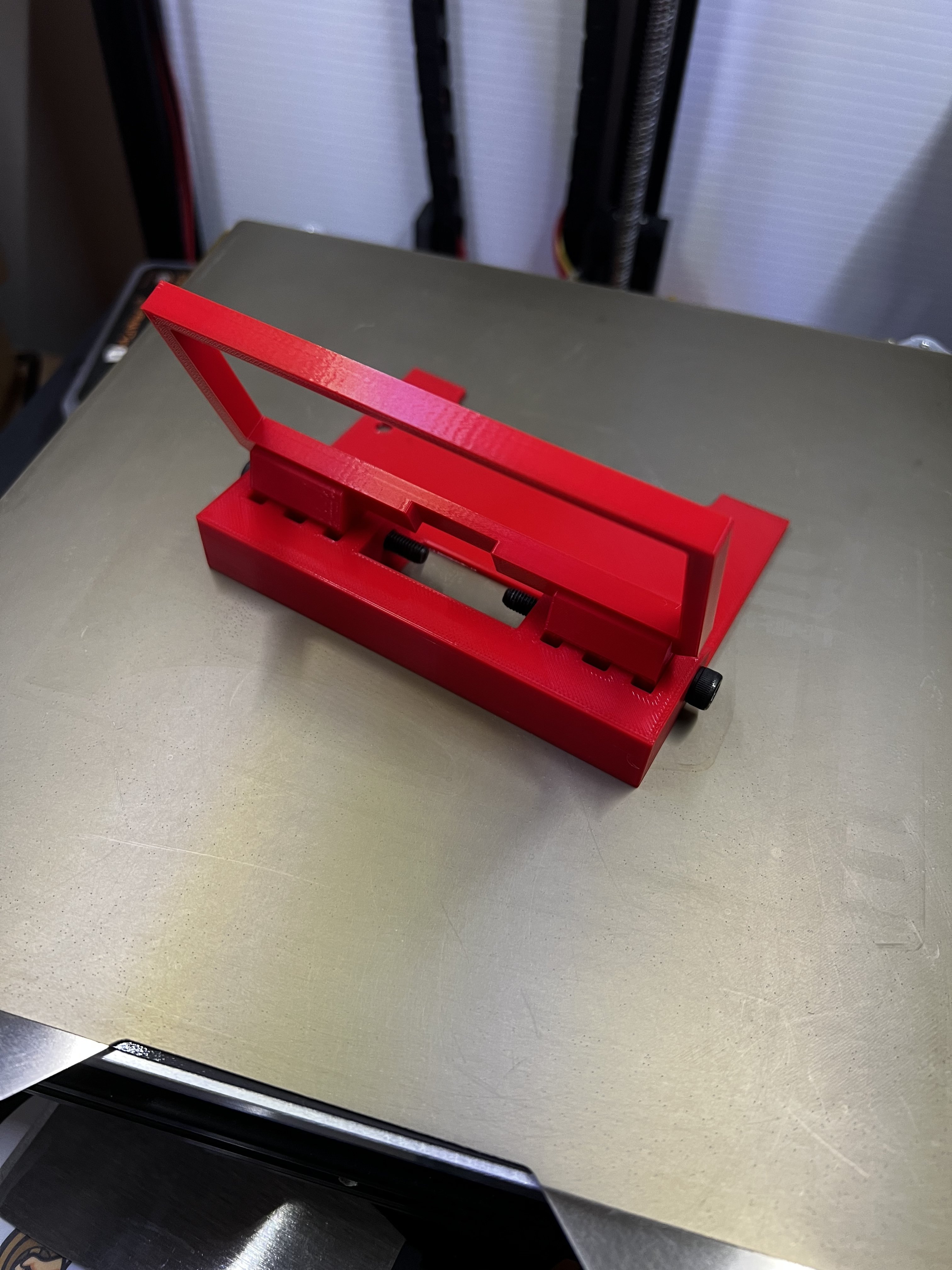

For now I’m content with case design and have a mini mock-up

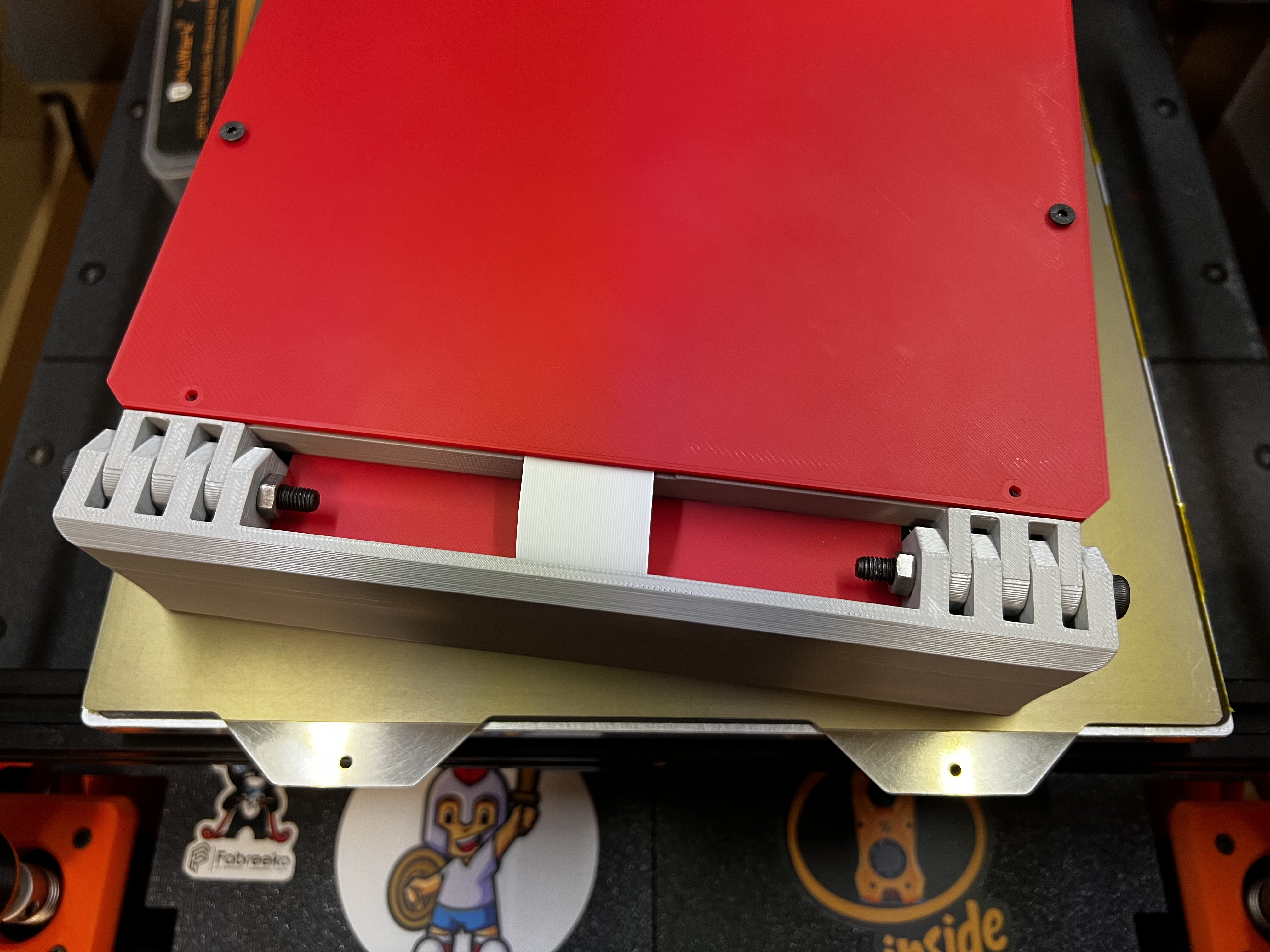

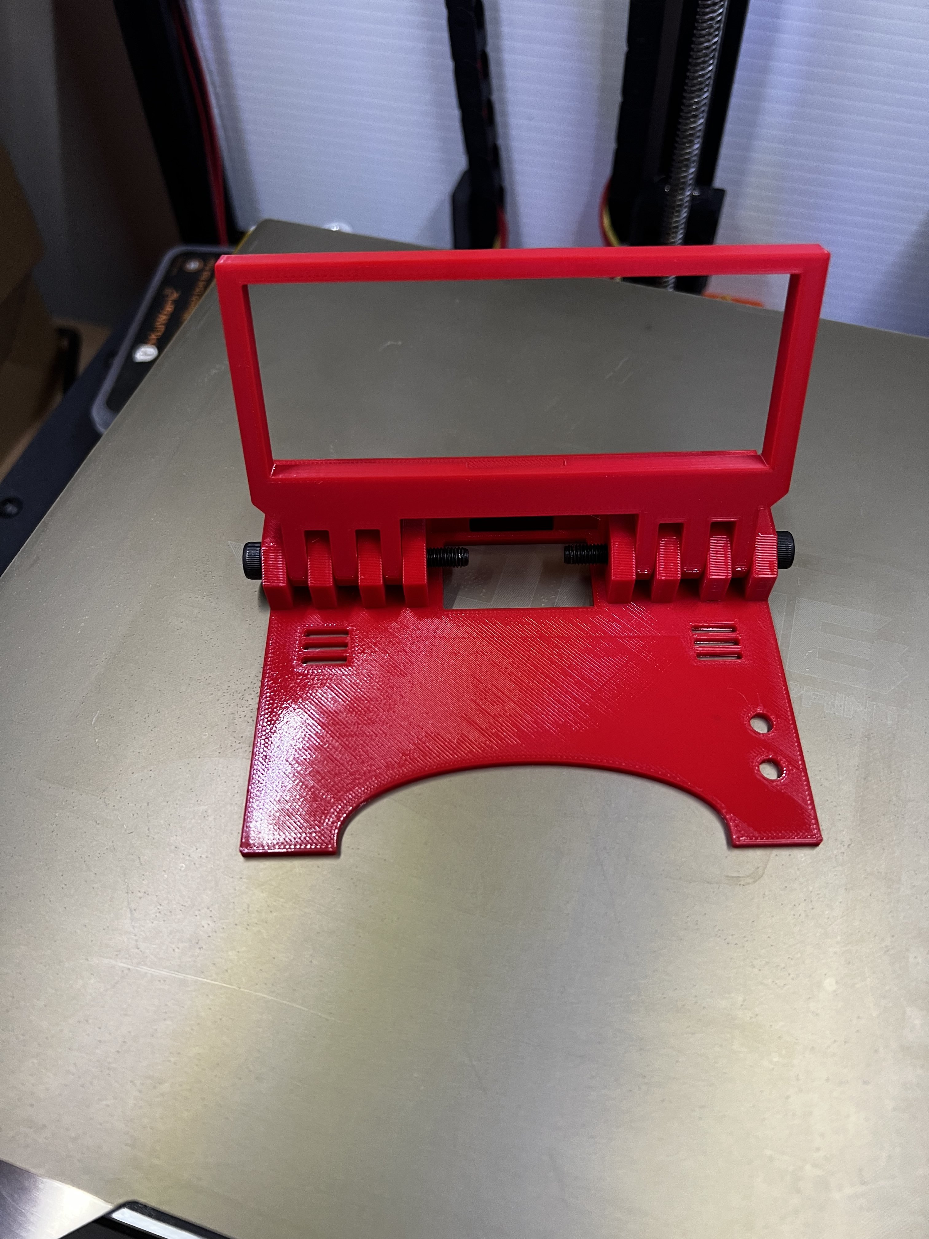

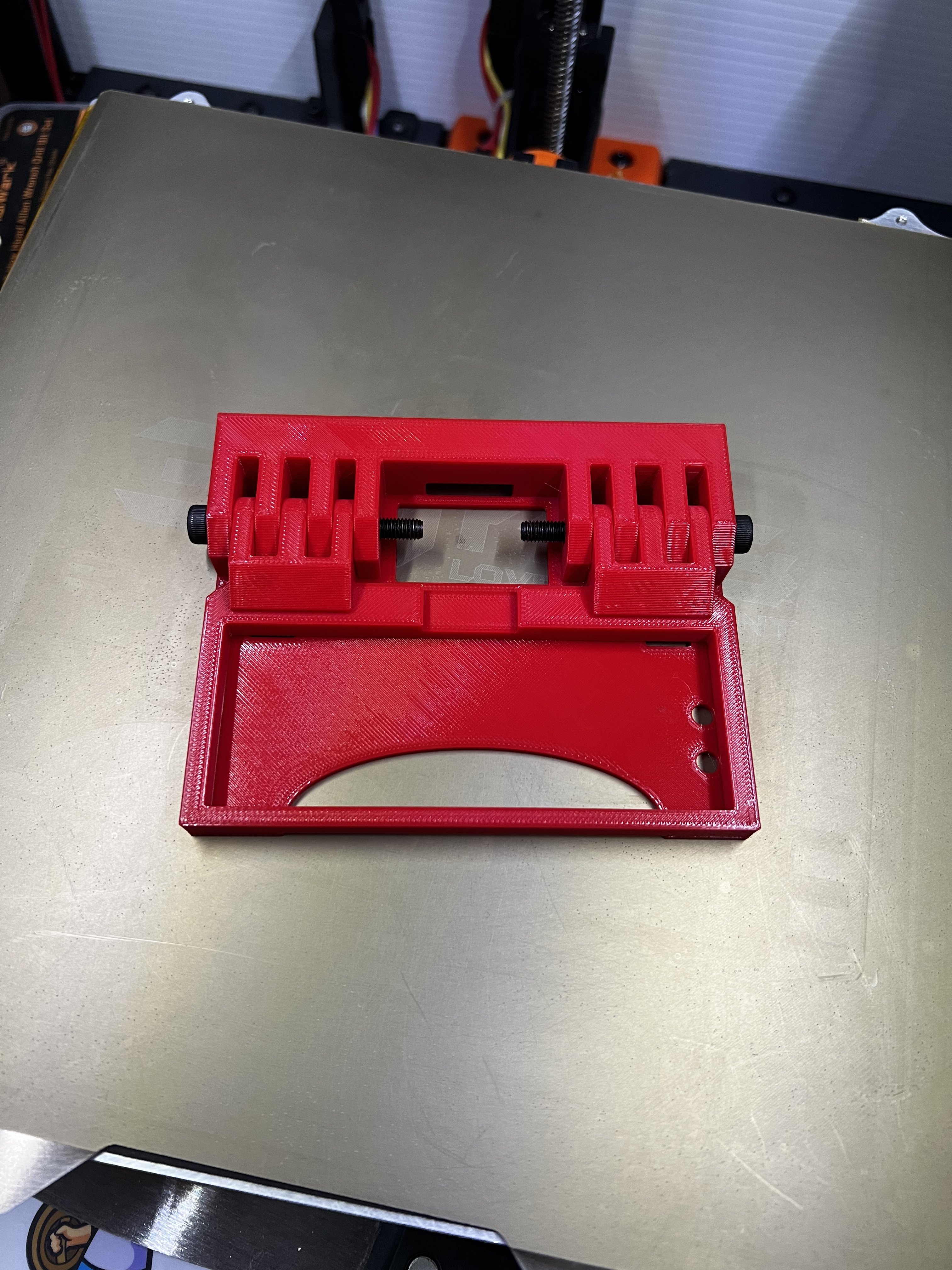

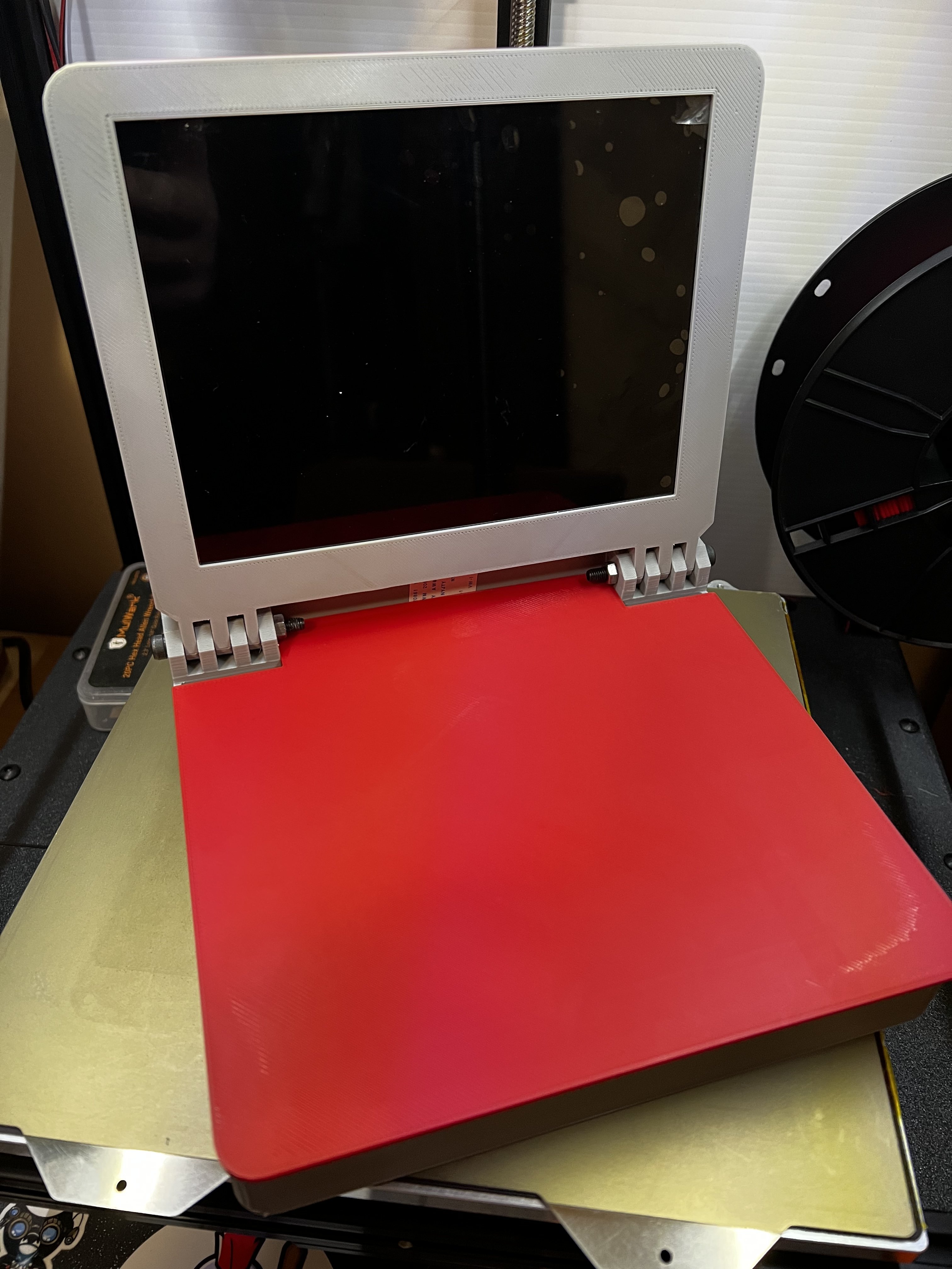

Progress: LCD top portion should be done now, easiest piece since i'm reusing one from a previous project but toss the idea of keeping the cartridge slot and the portable grows in size a hurry

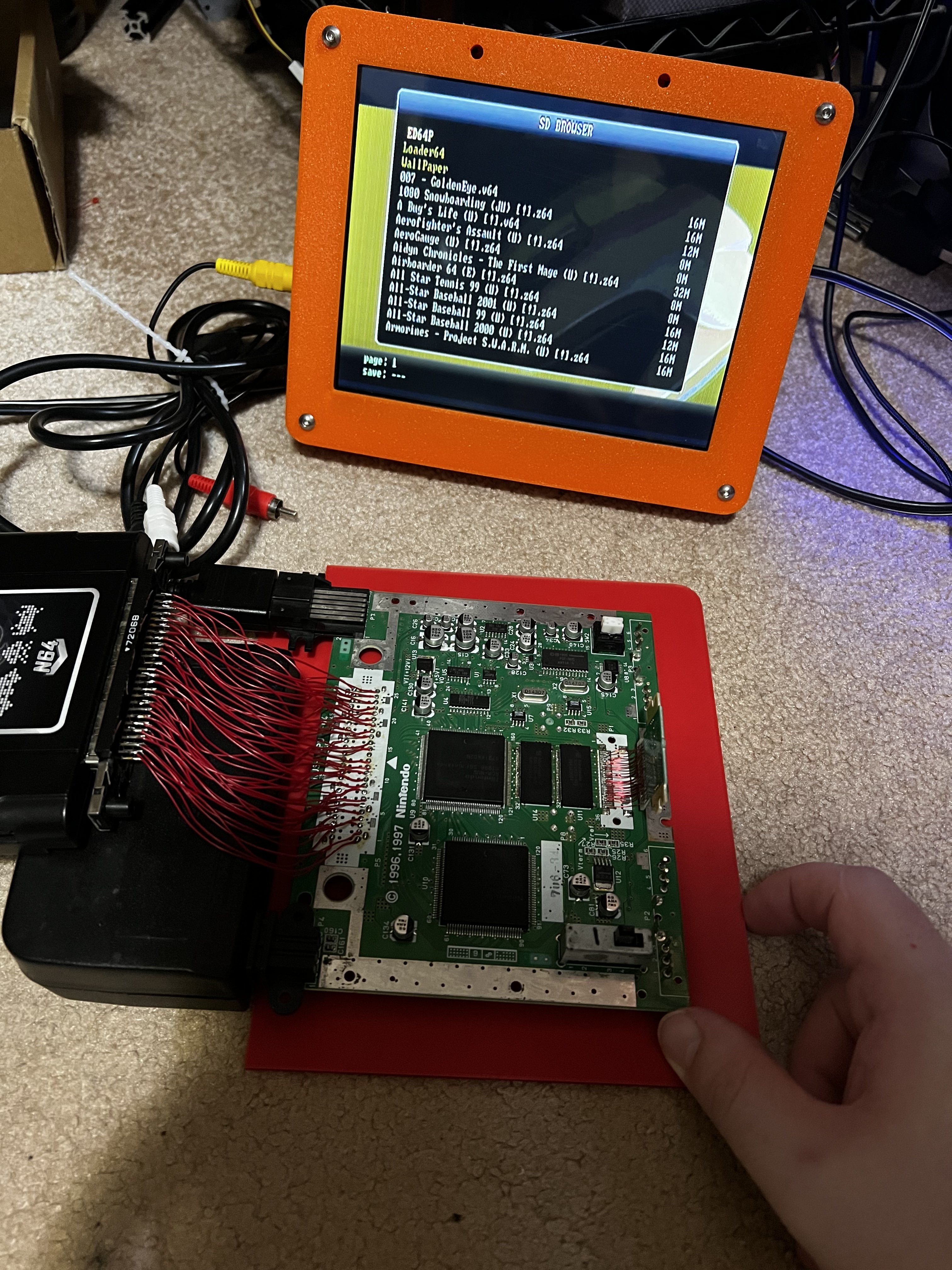

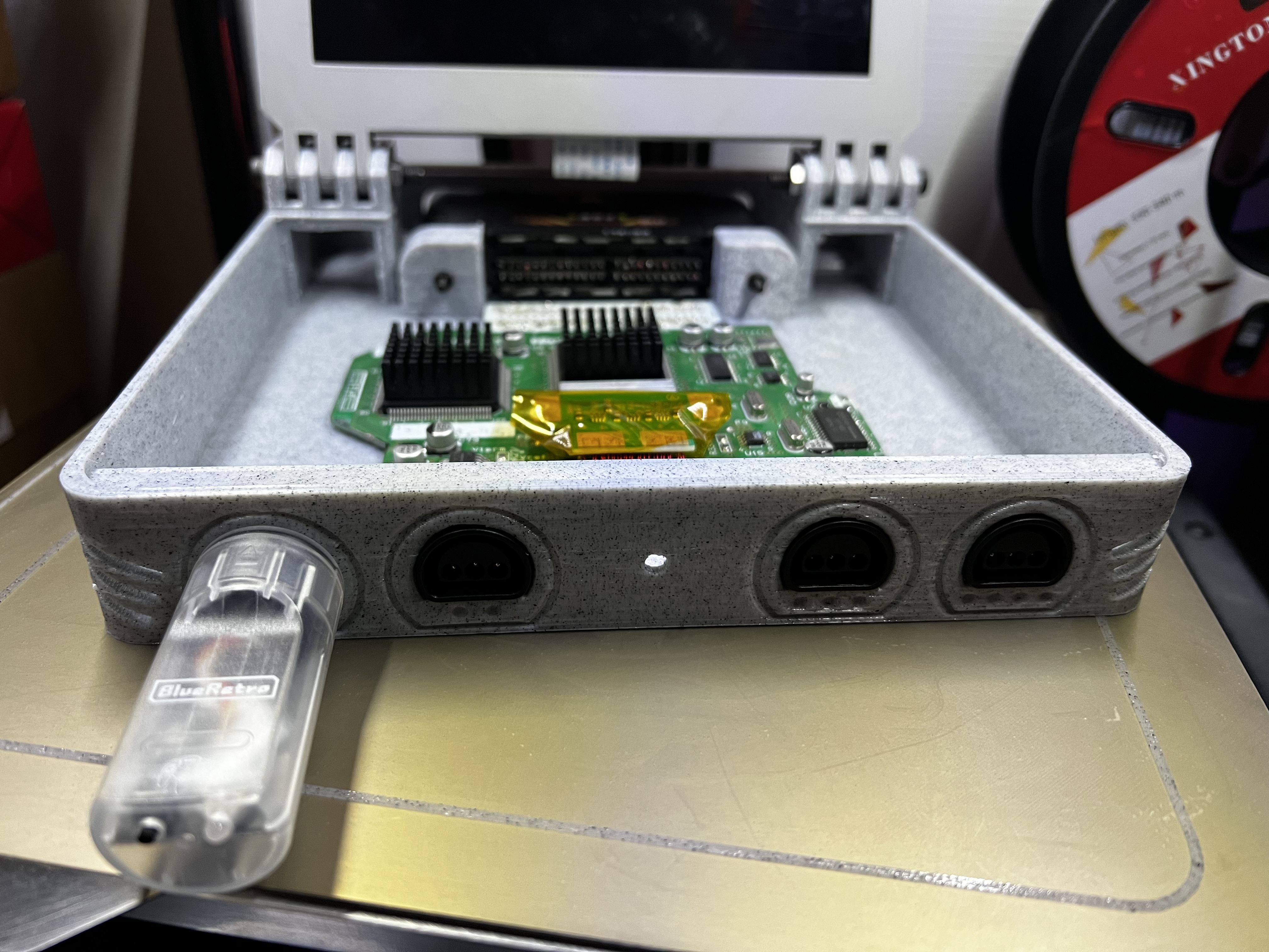

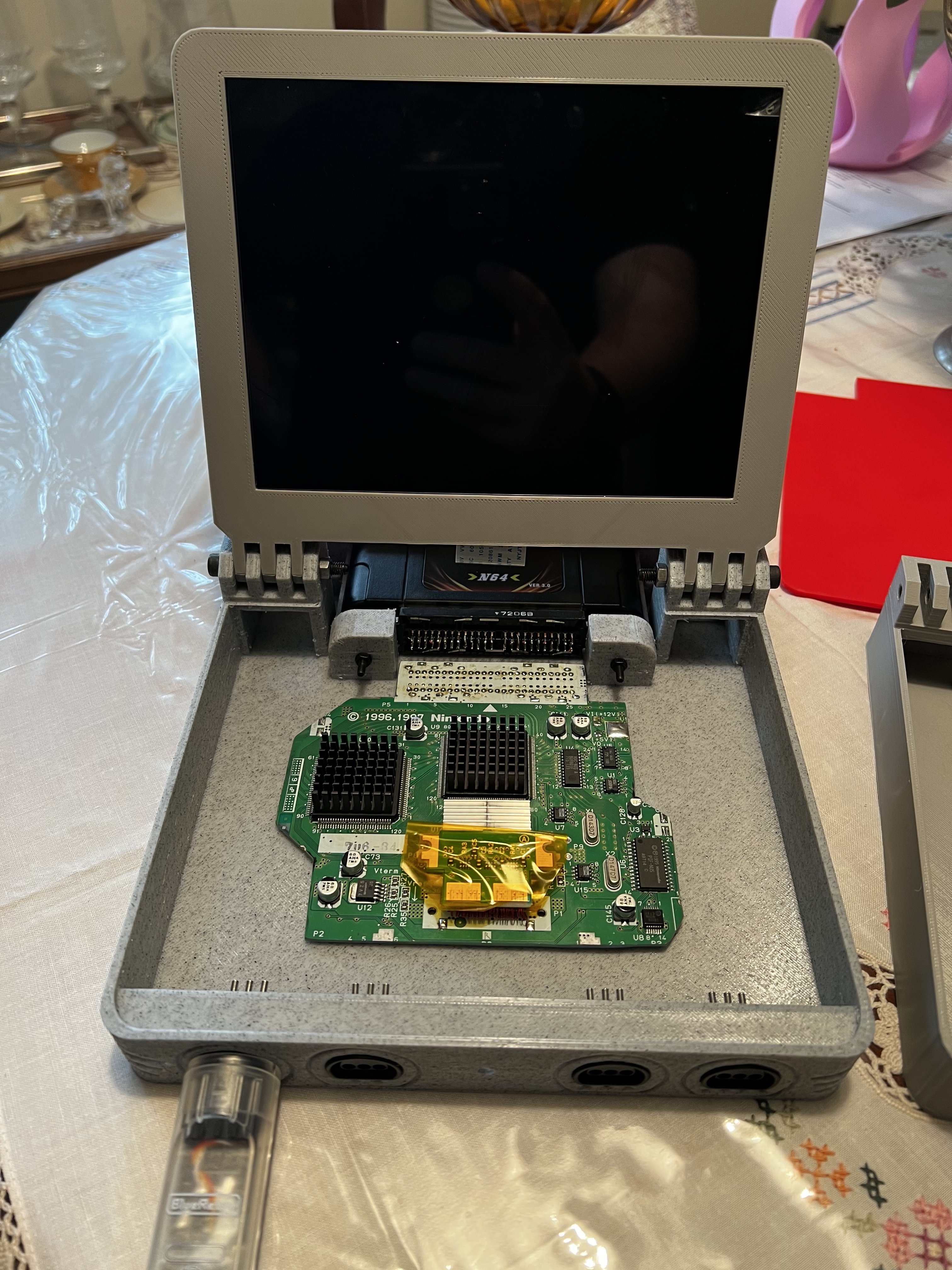

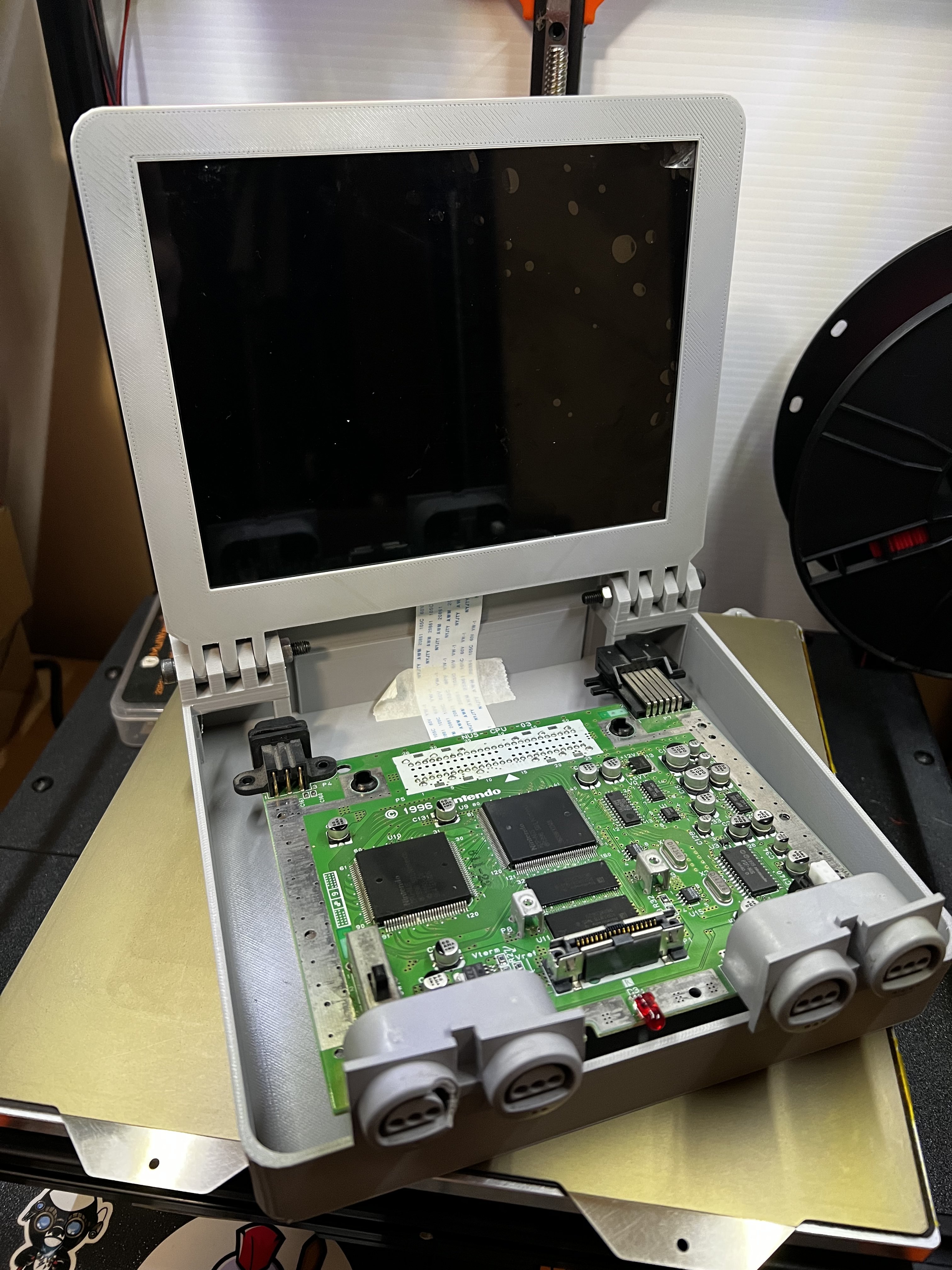

Tested out a sample of what I have so far to get the idea of the feel of the whole setup.

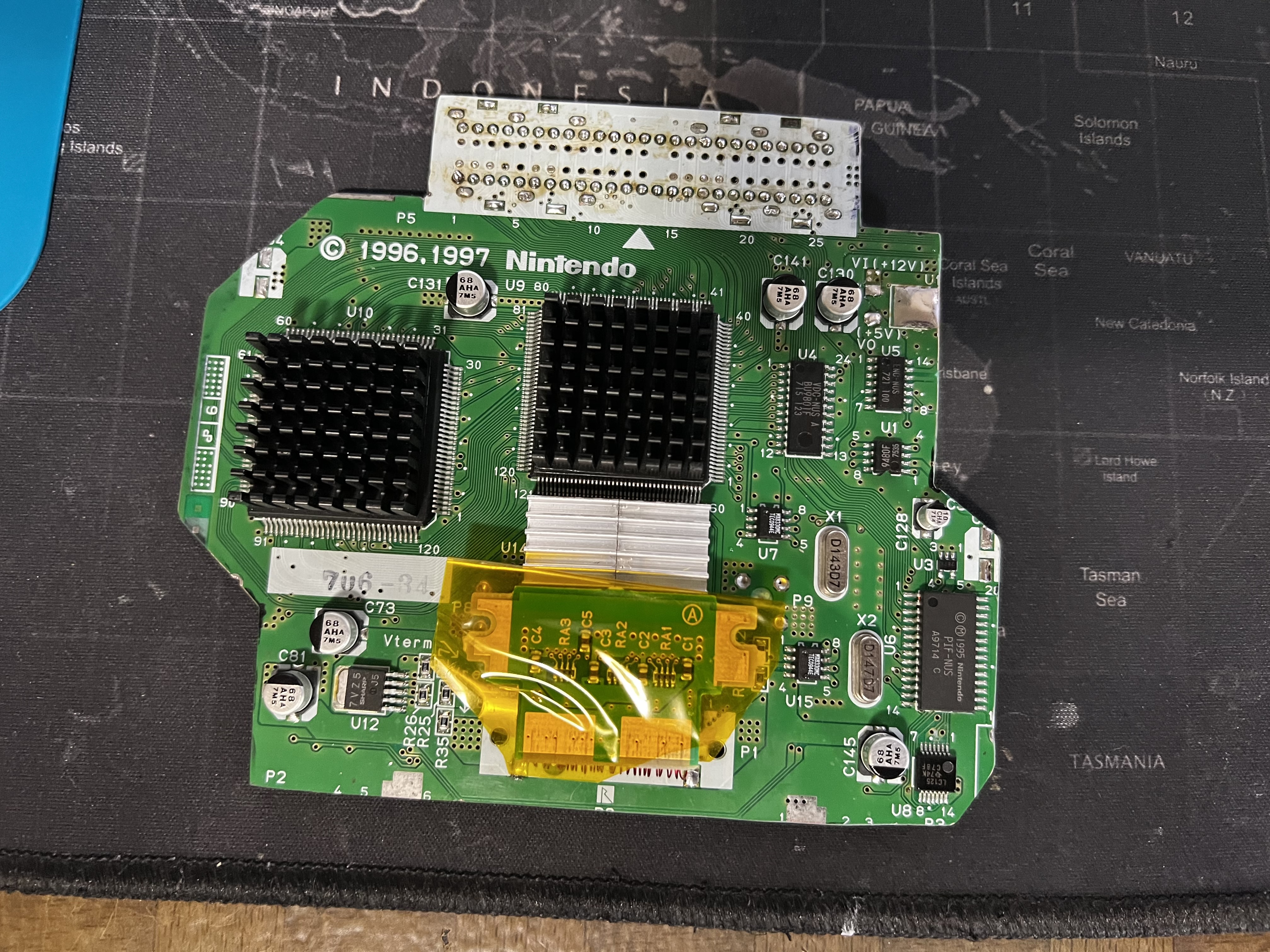

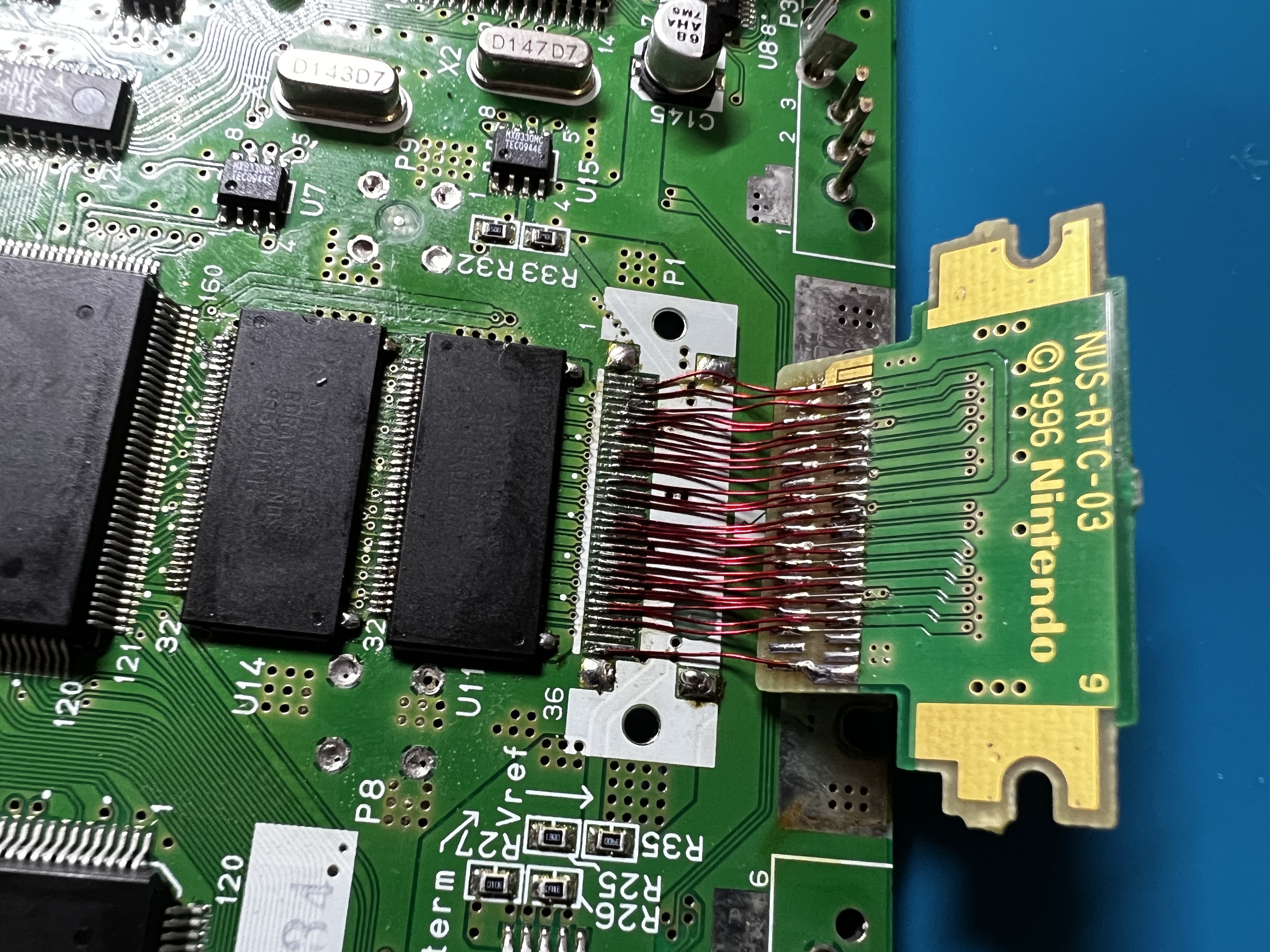

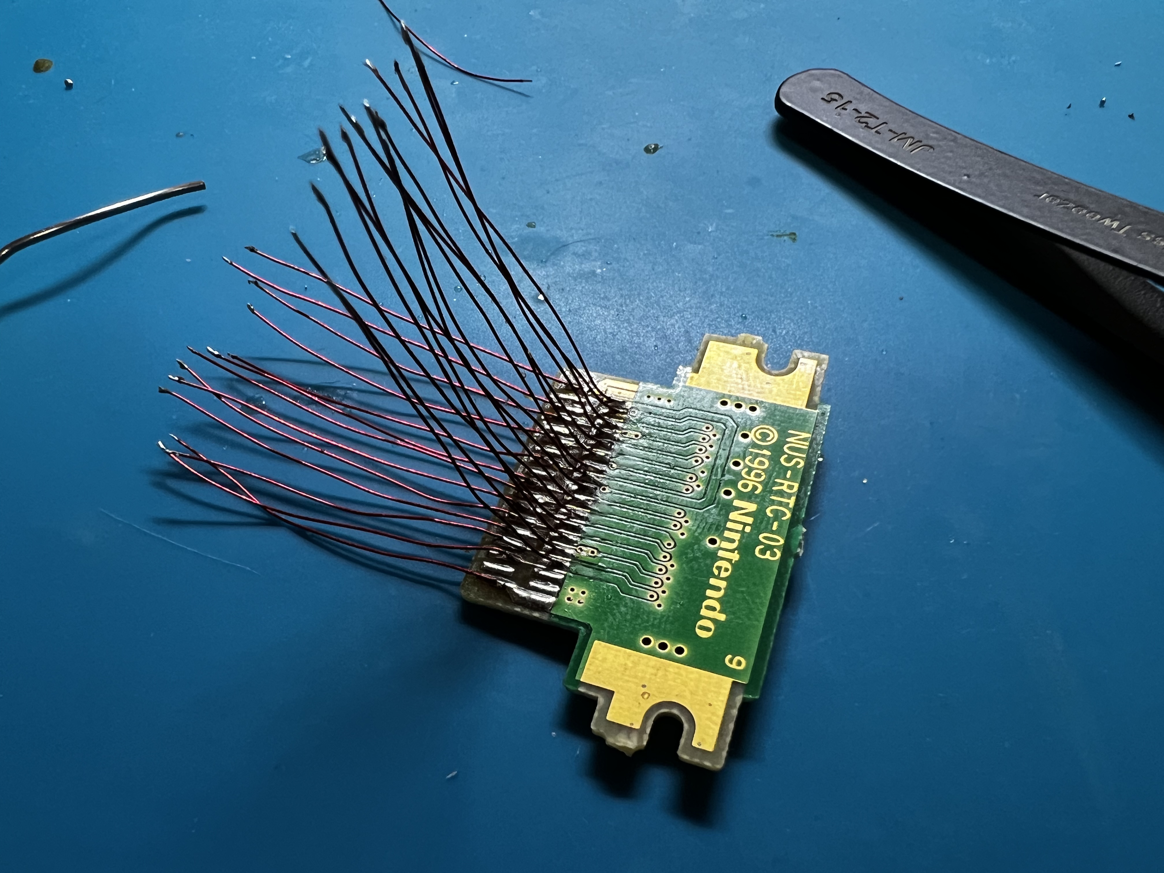

Ram swapped, jumper slot wired up can say that at least until this point I’m in working order

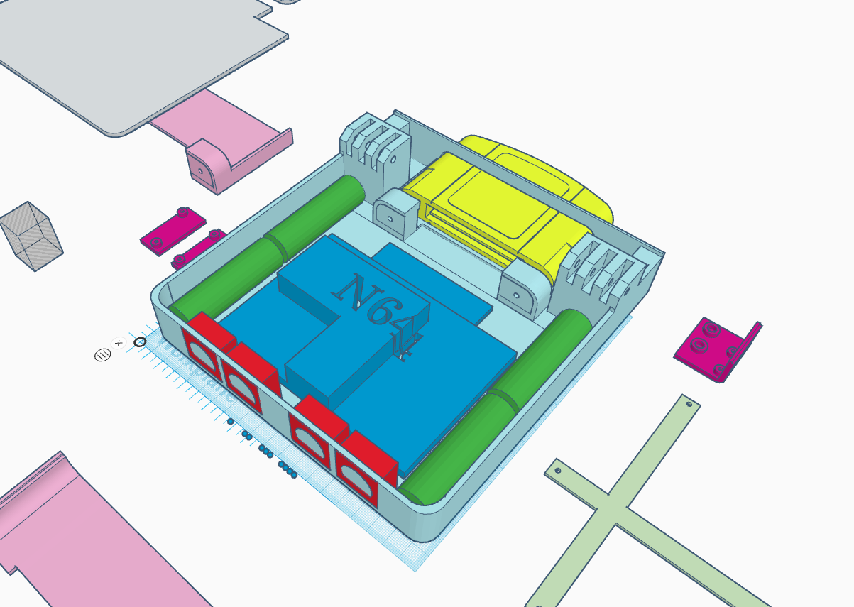

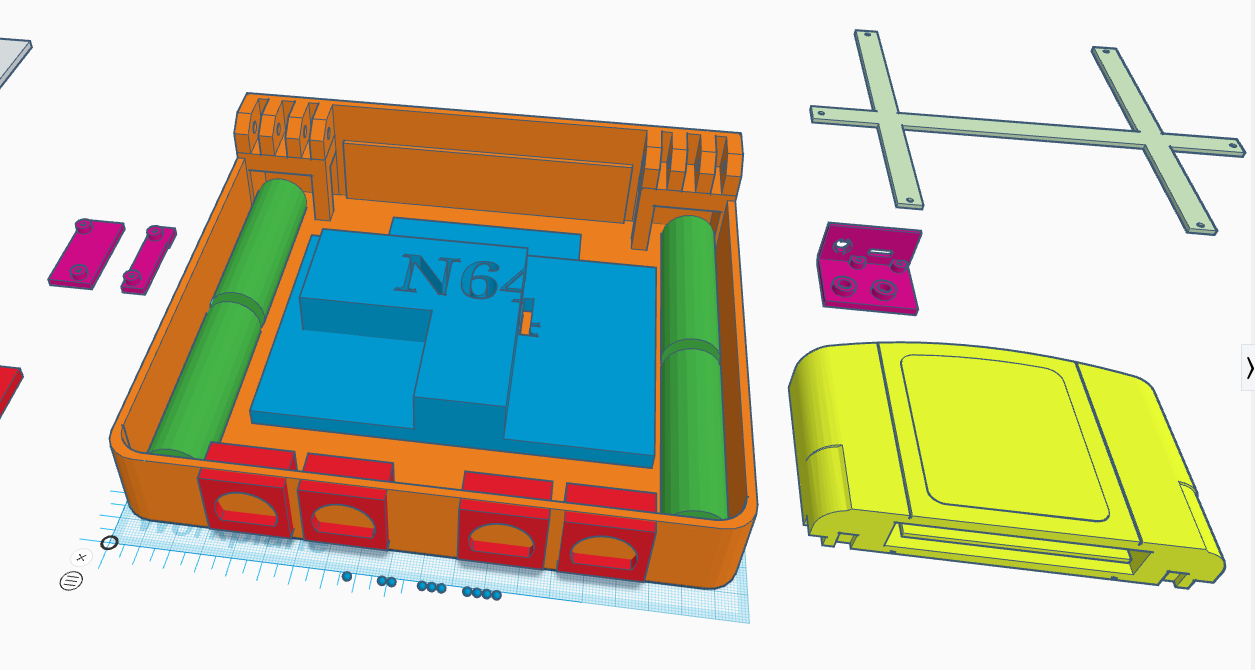

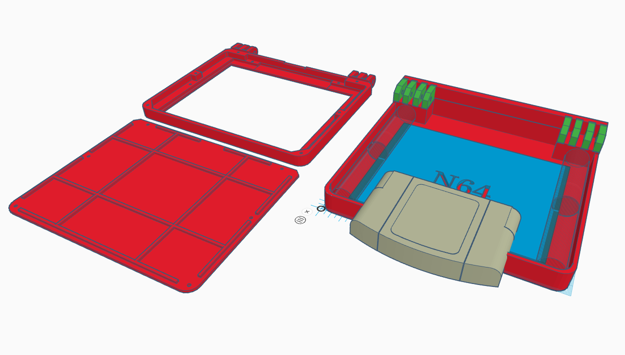

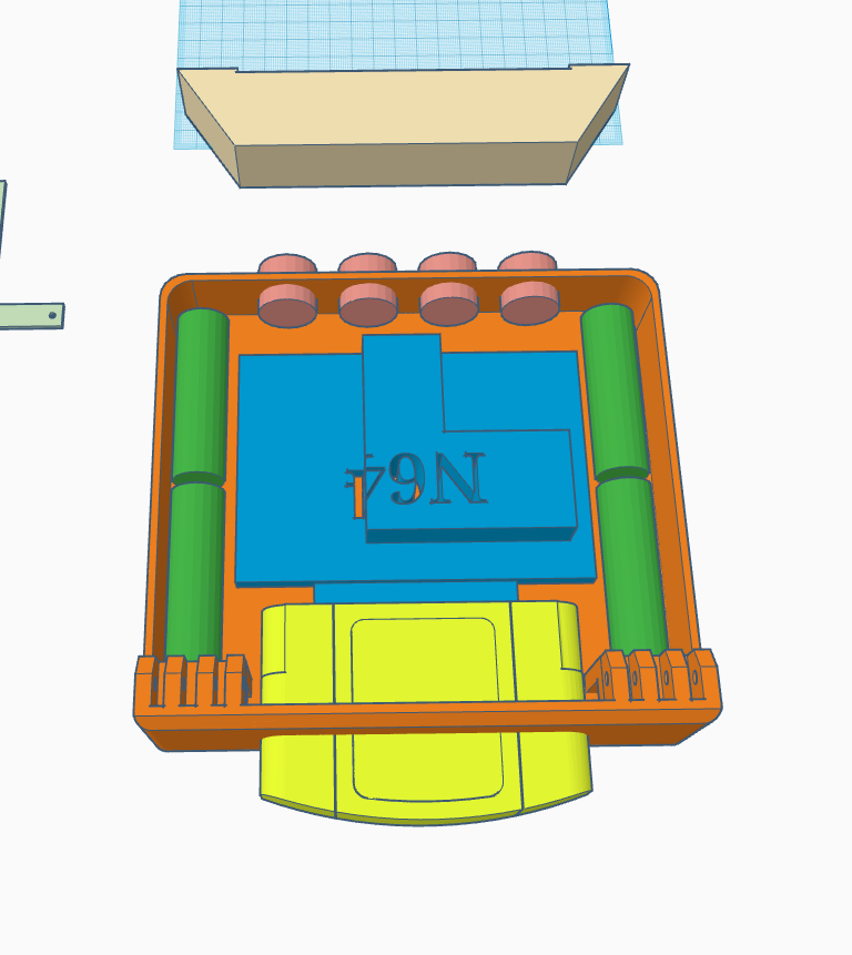

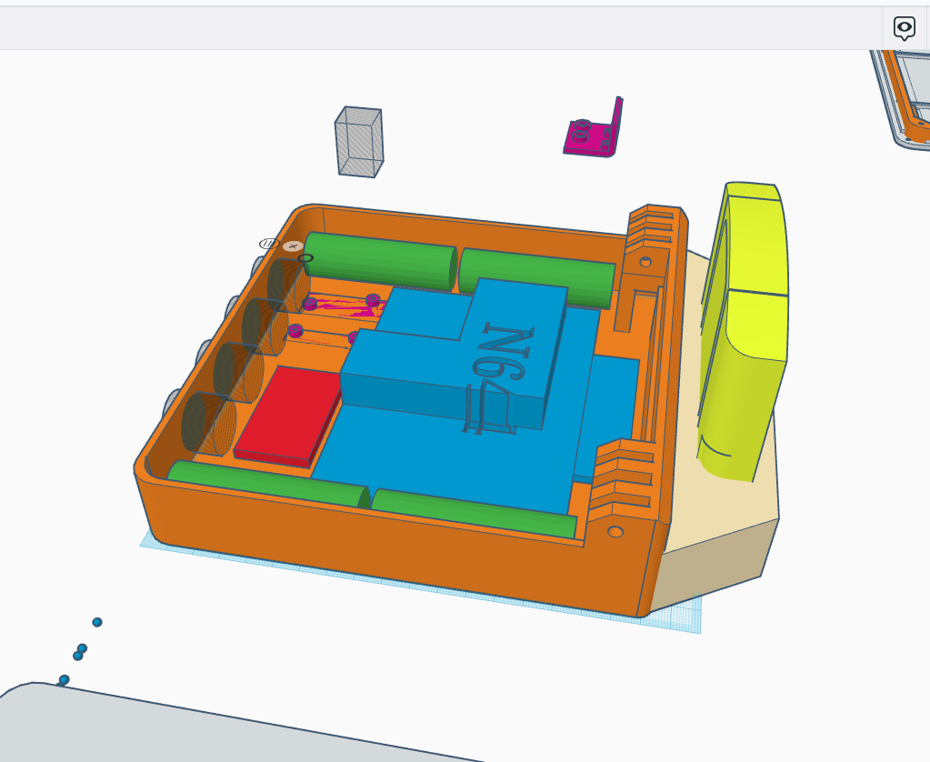

Well might as well update some cad stuff, tossing around the idea of the cartridge vs embed an ed64

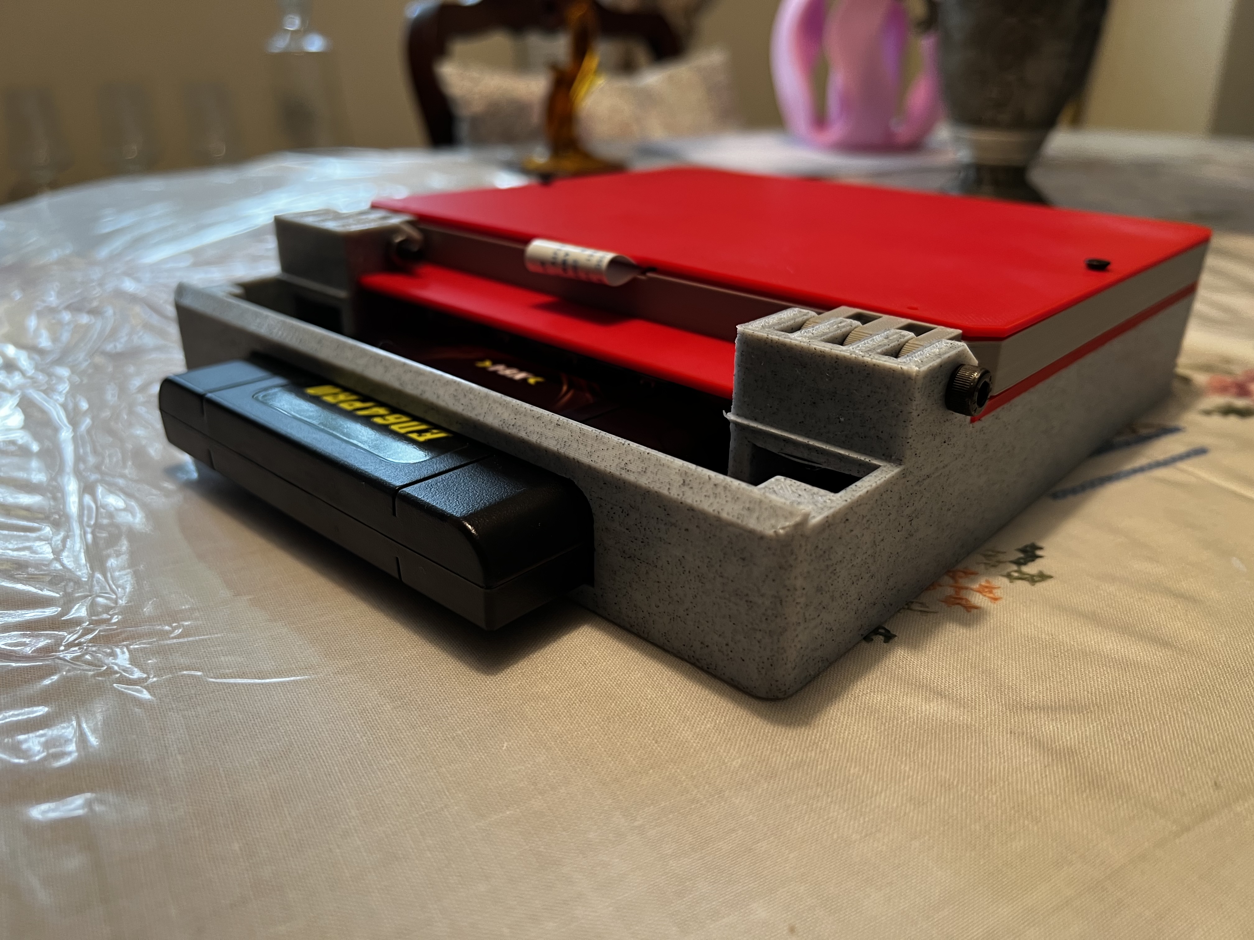

I'll always side with the real deal, otherwise it just feels like an emulator. I vote cartridge because you can always insert an everdrive lol

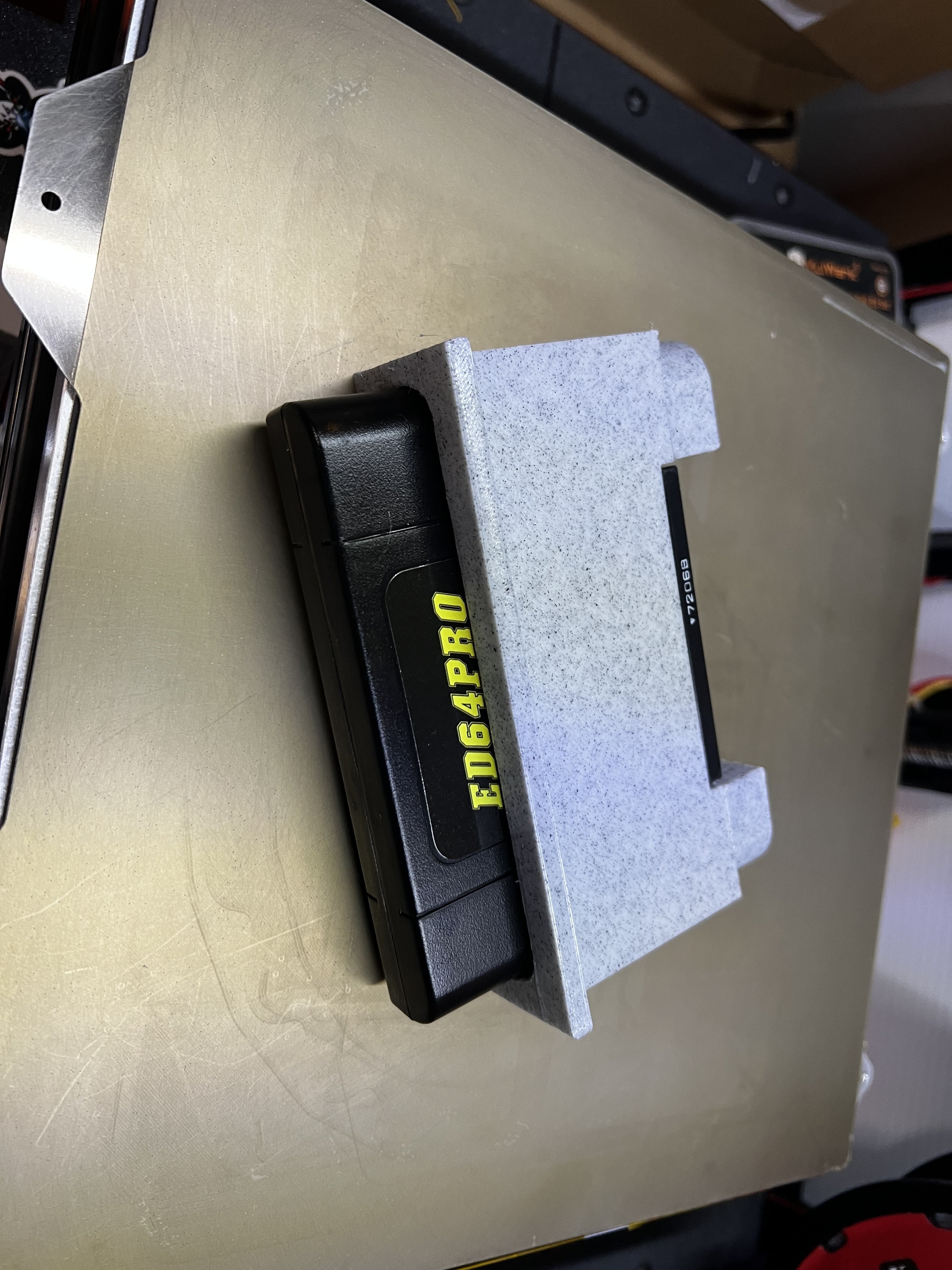

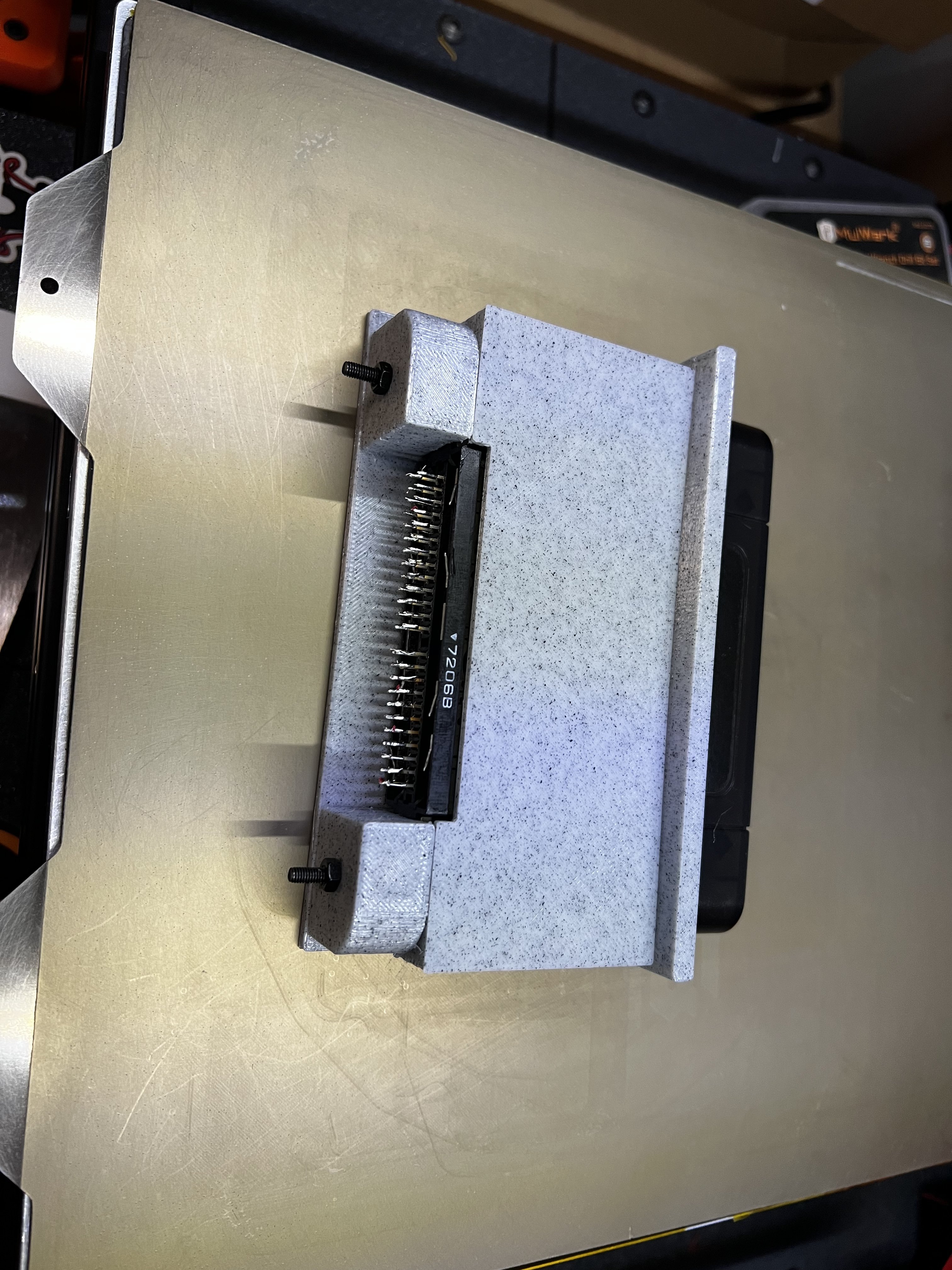

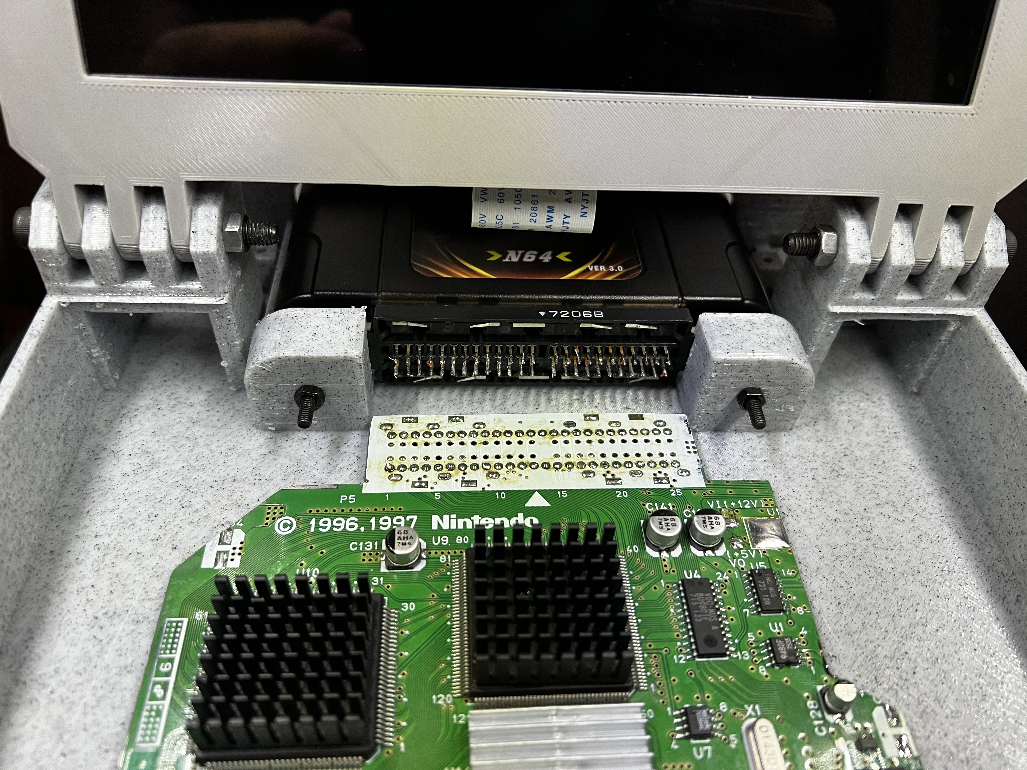

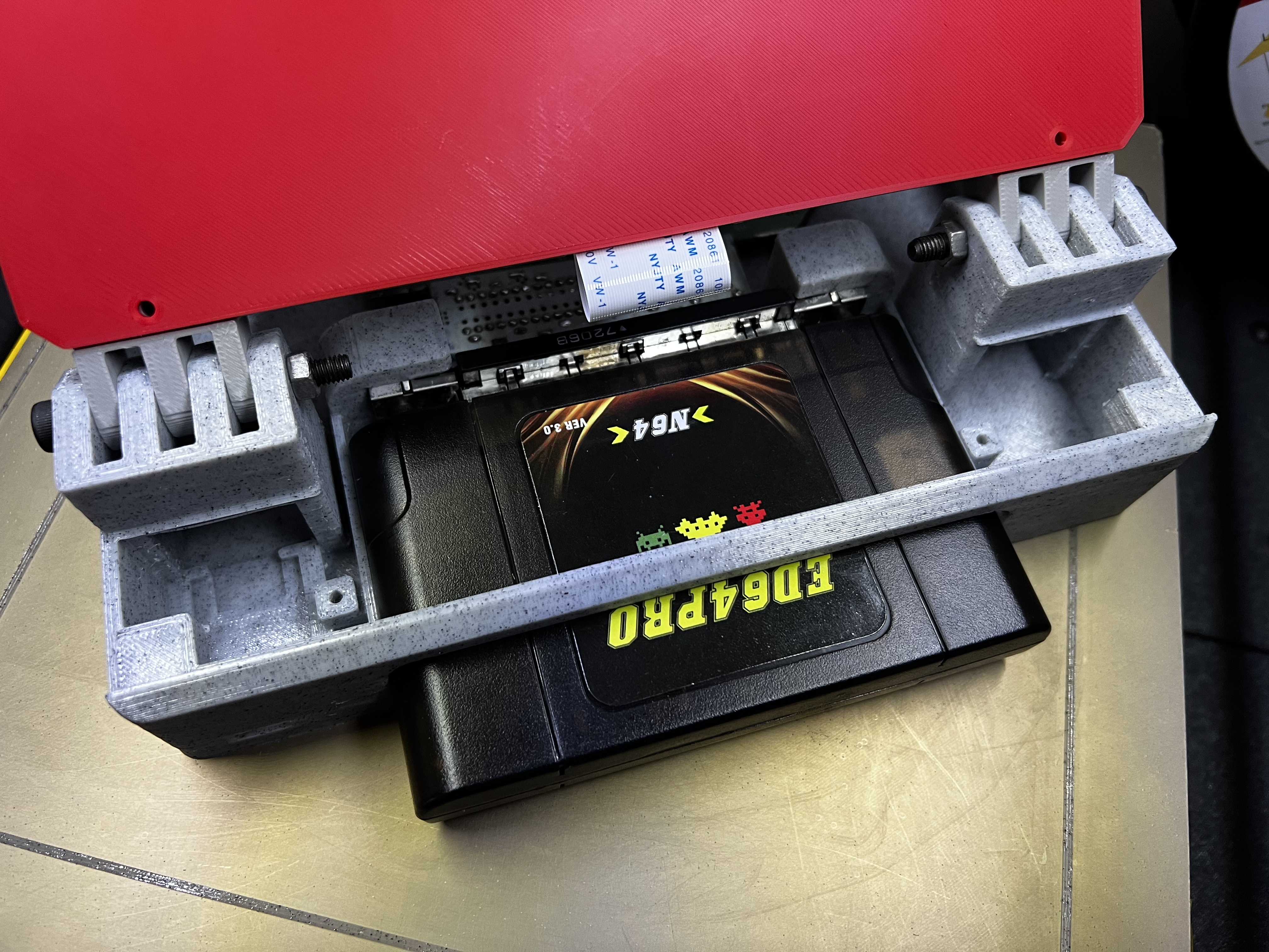

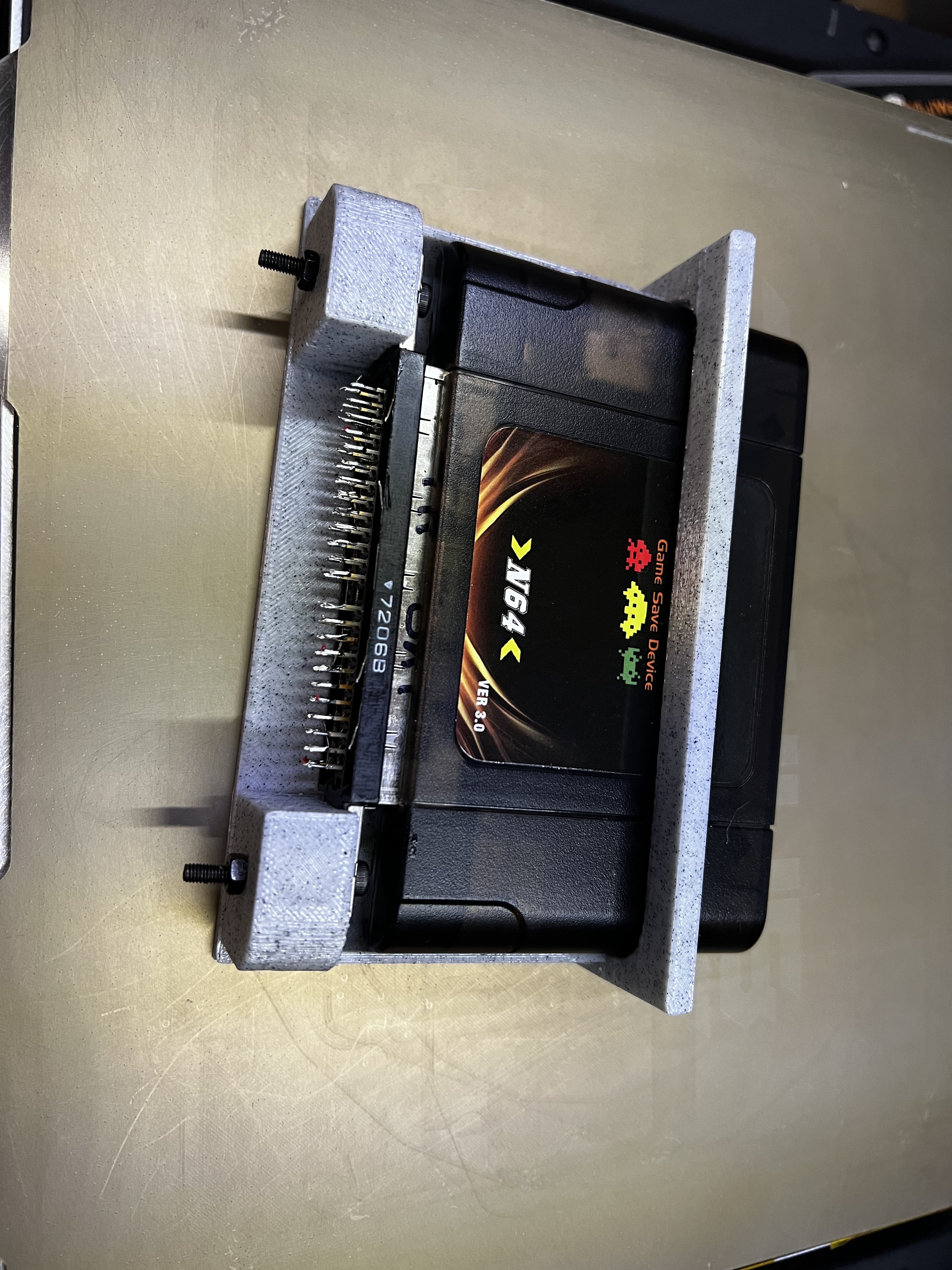

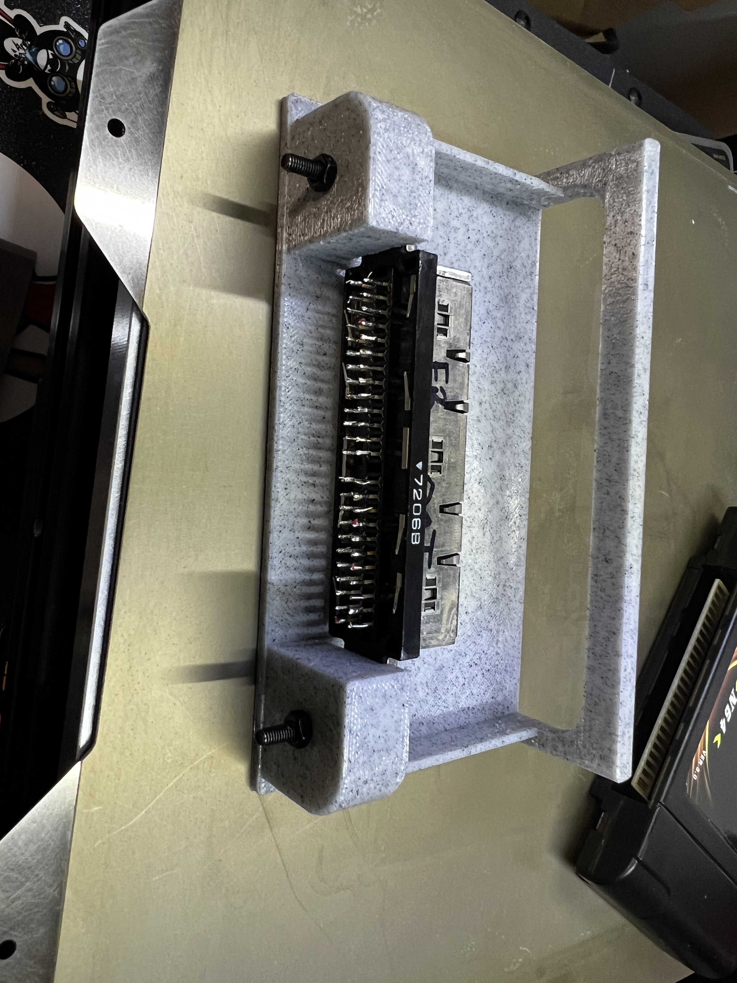

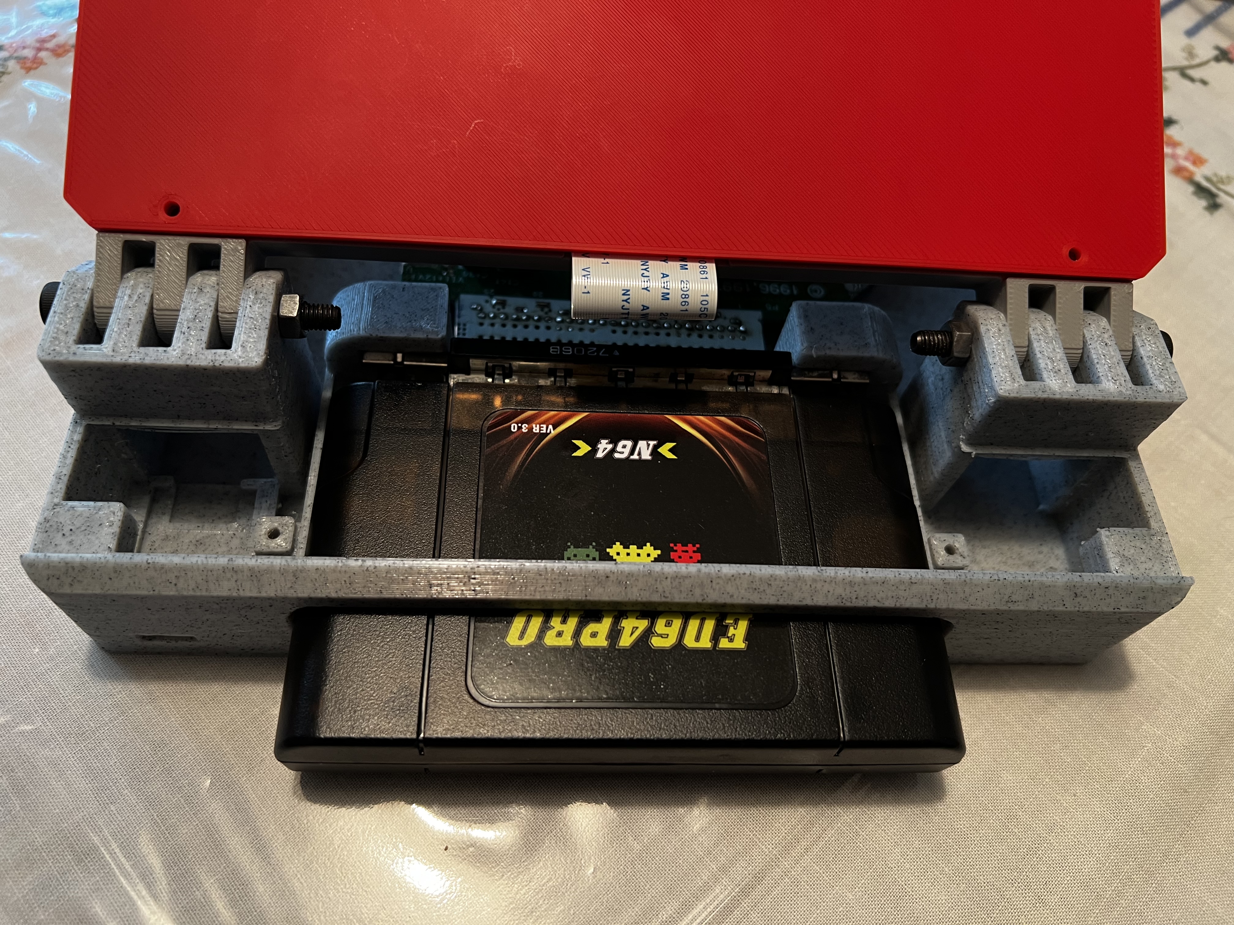

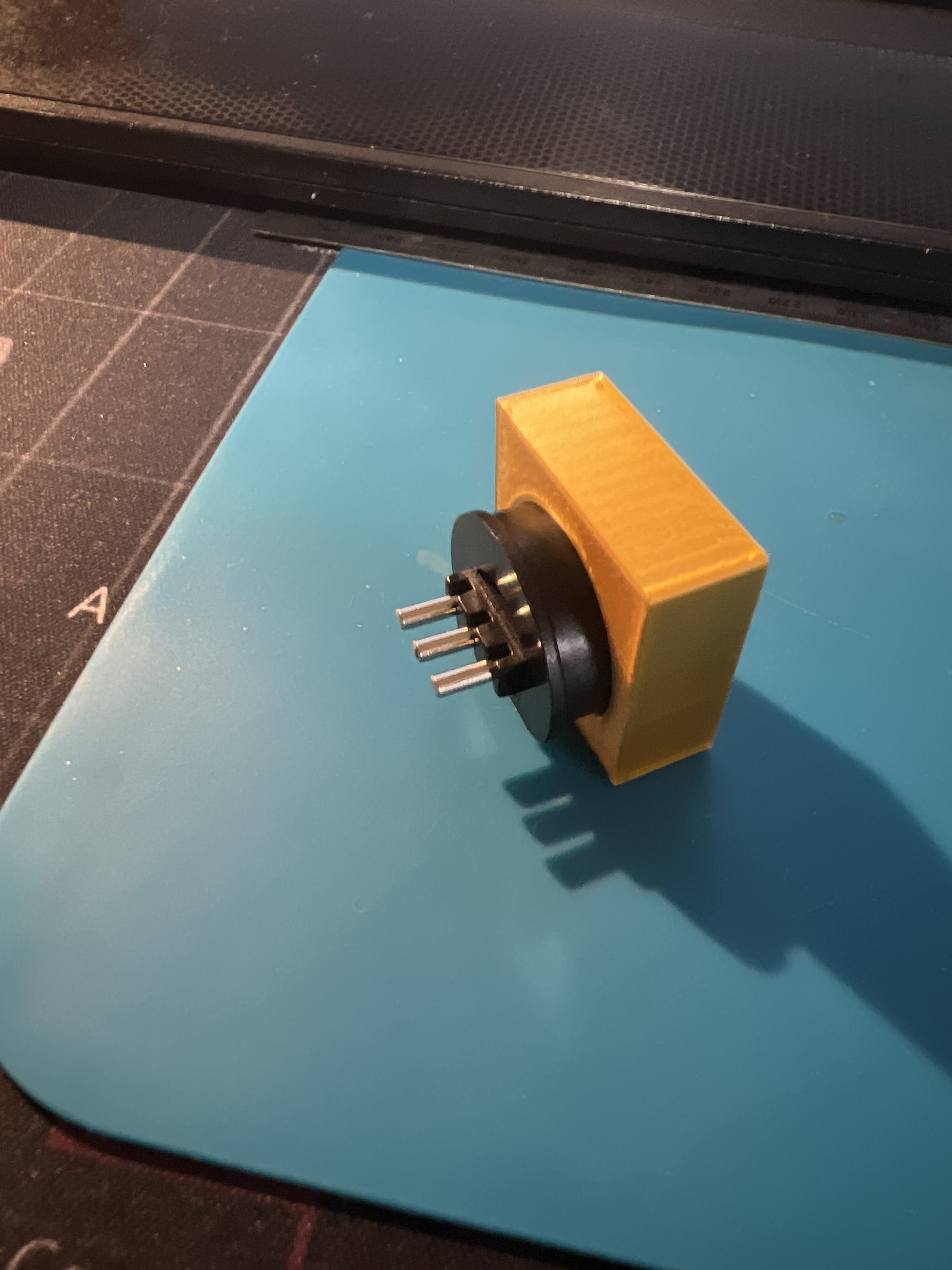

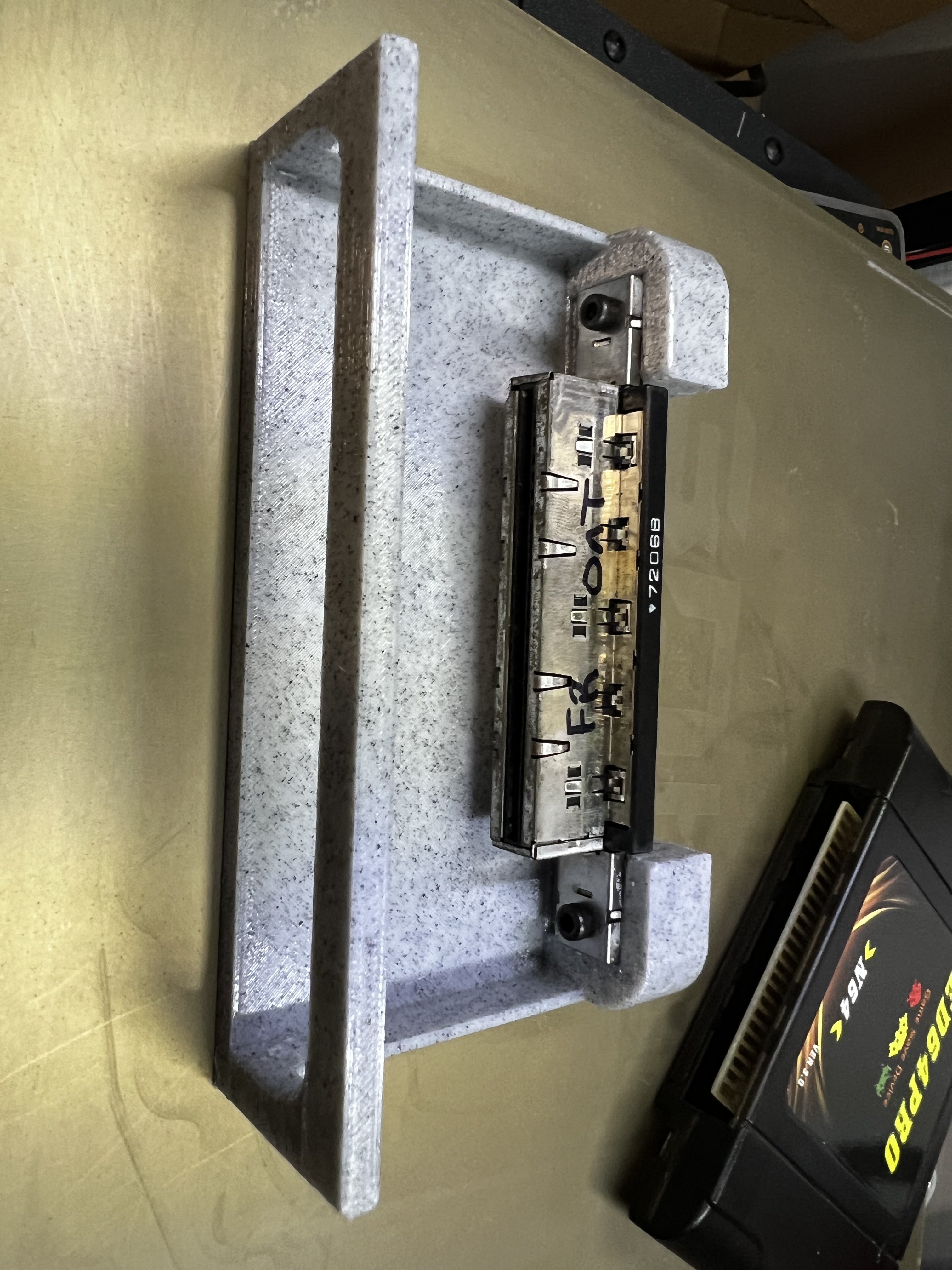

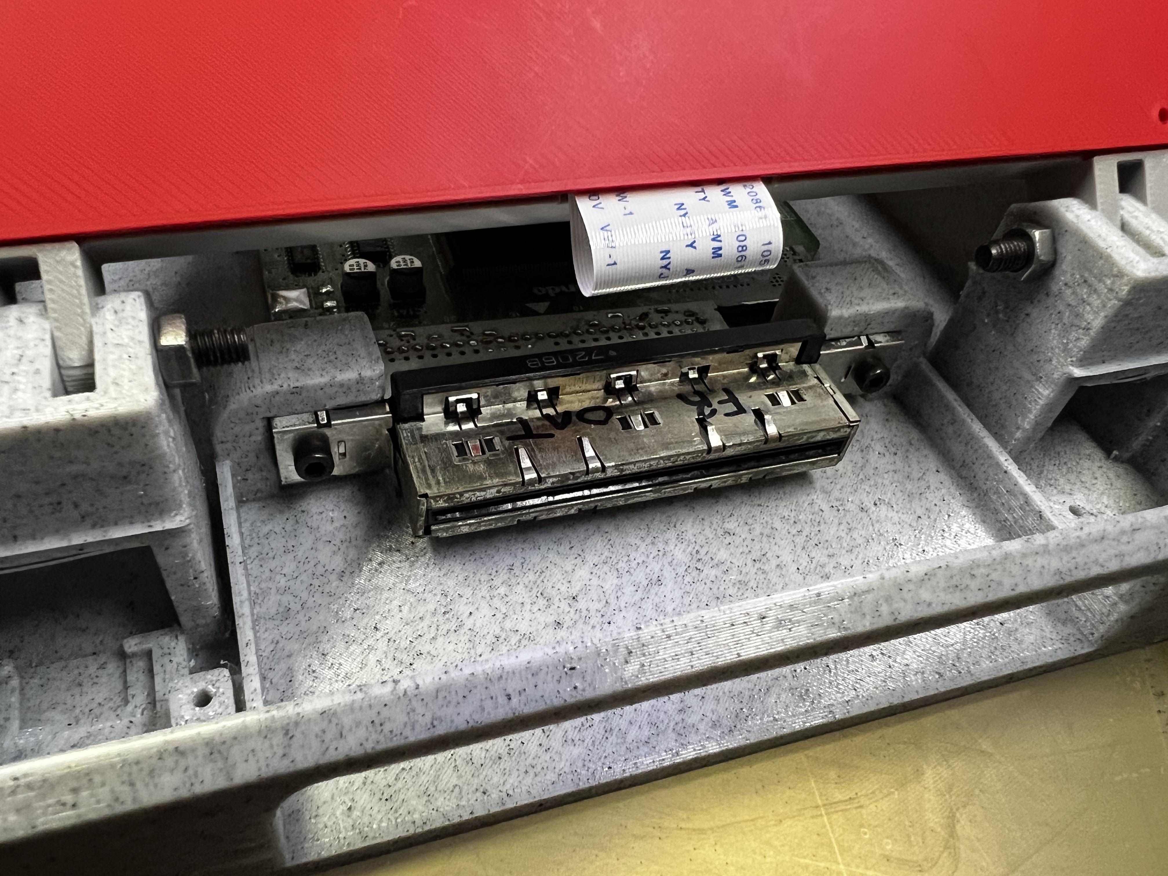

Well I suppose I can go ahead with a cartridge slot now, I have something that actually test printed ok and is pretty solid. Took a few tries but it’s there

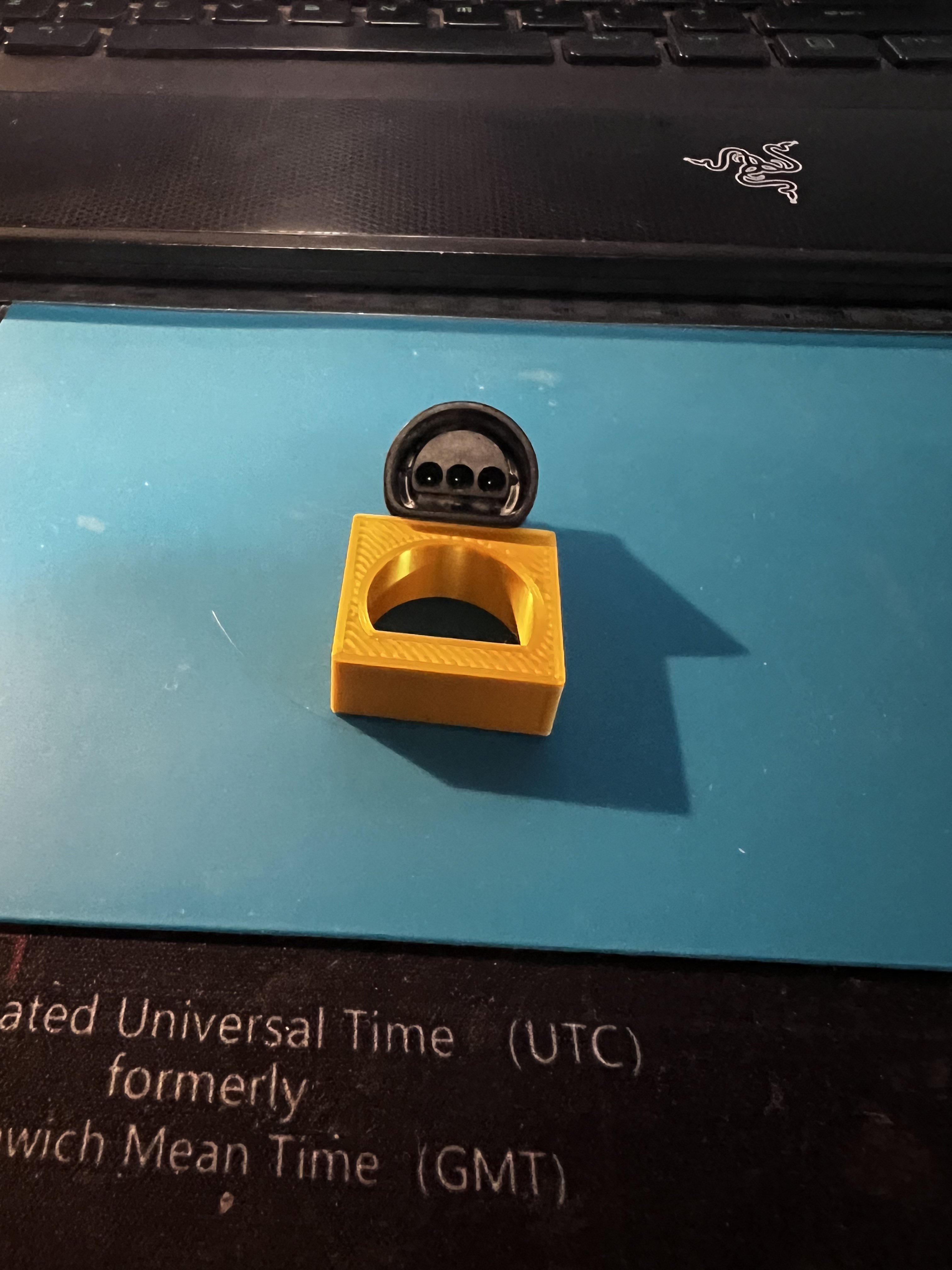

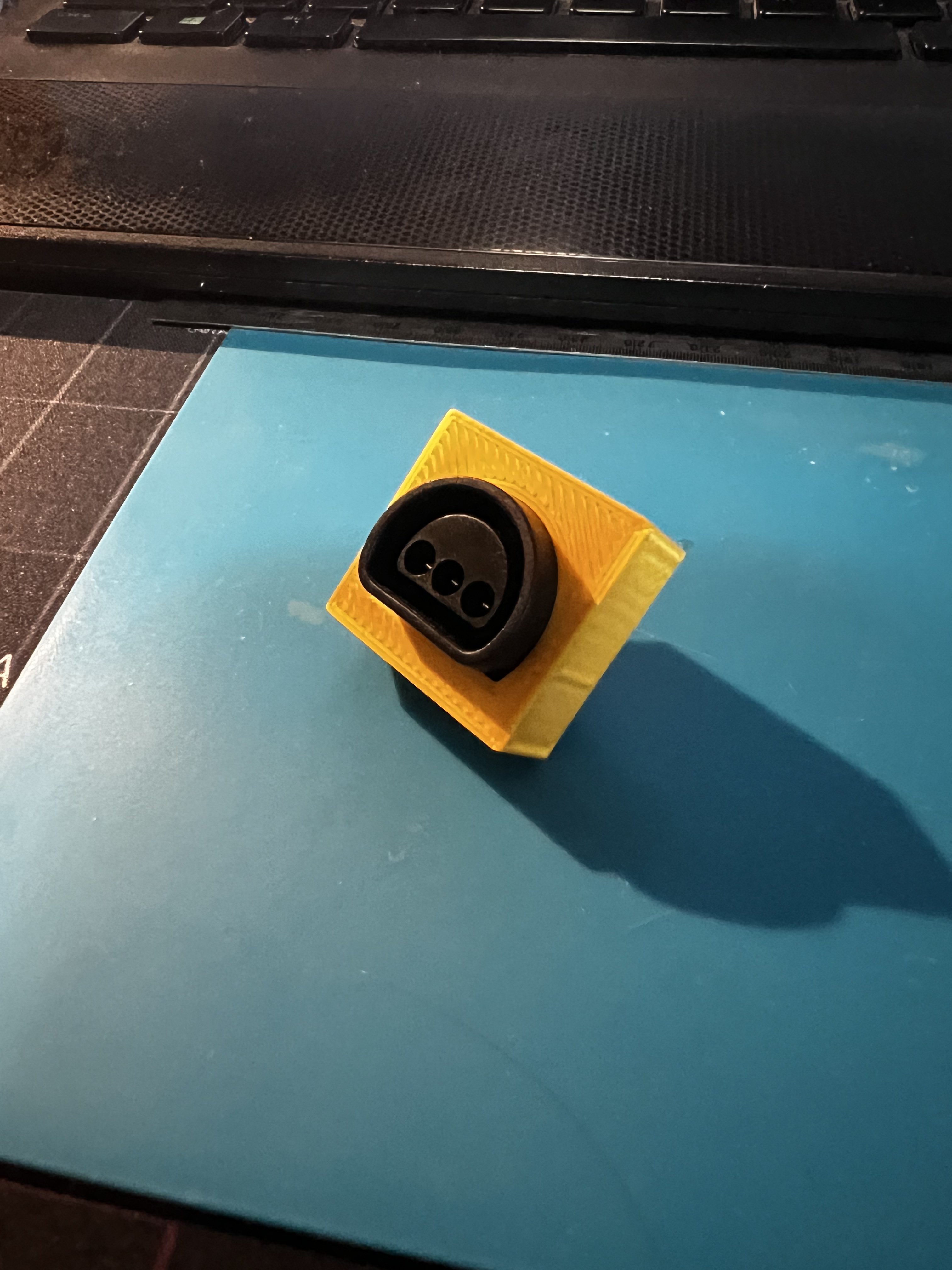

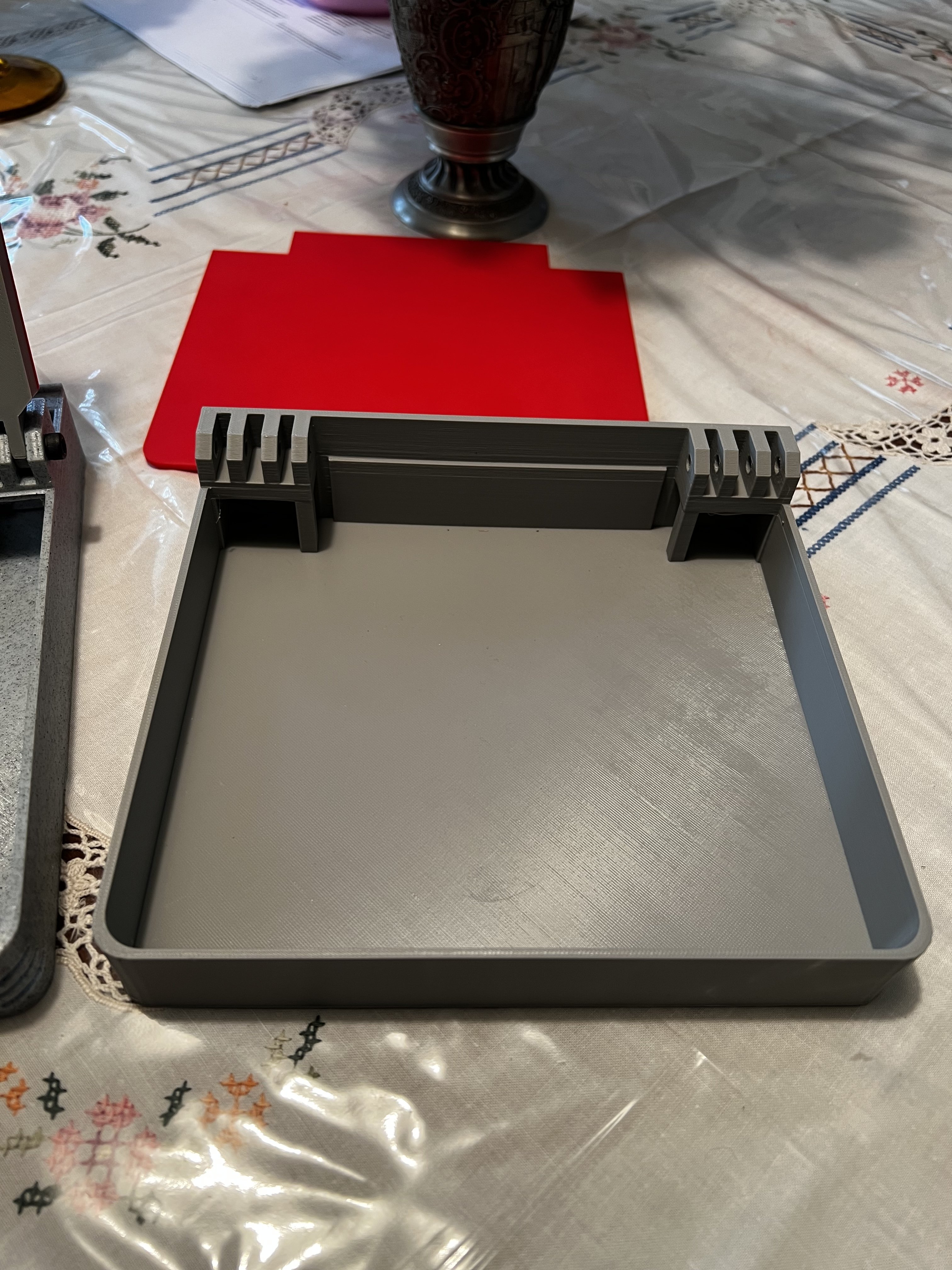

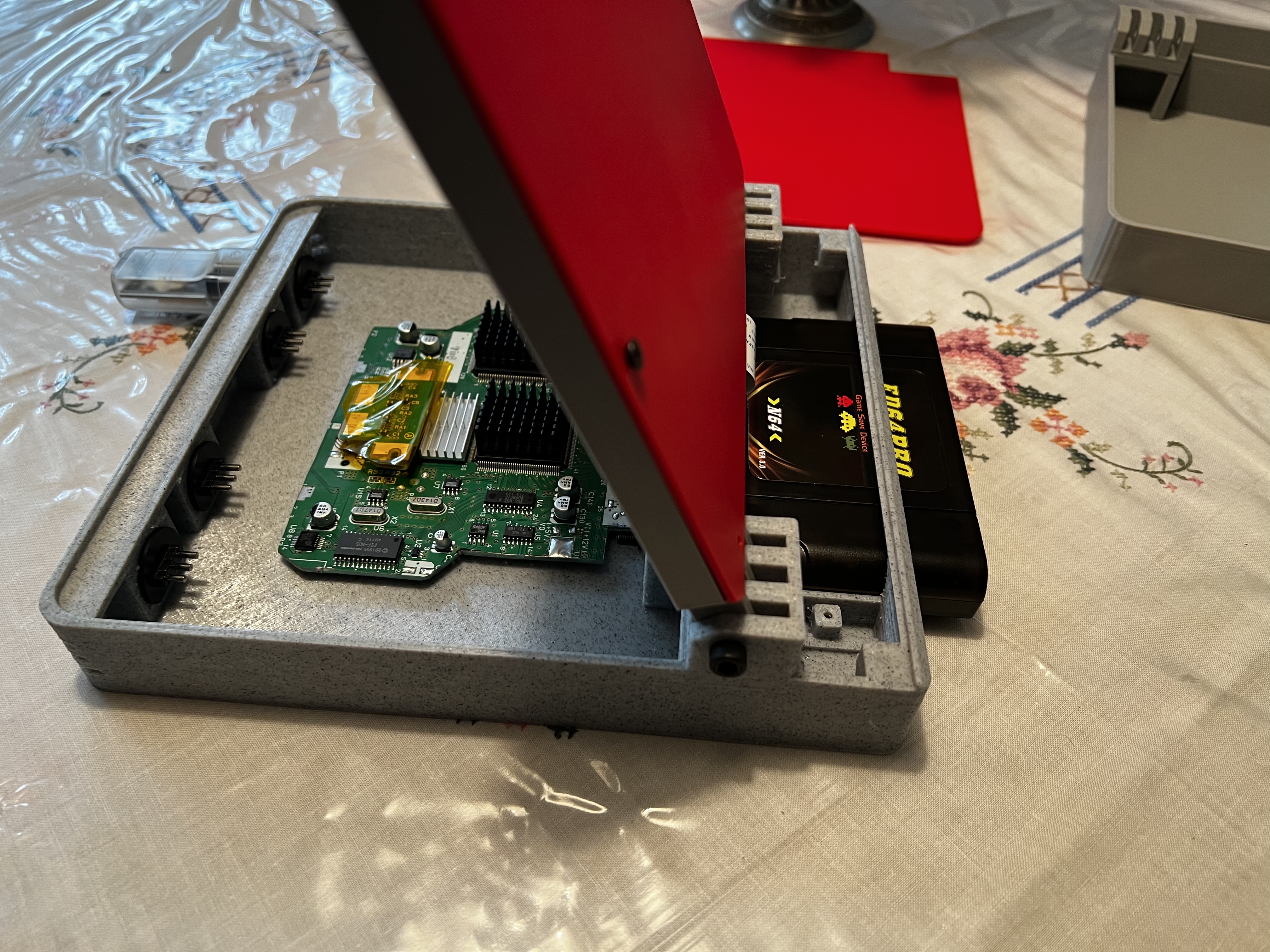

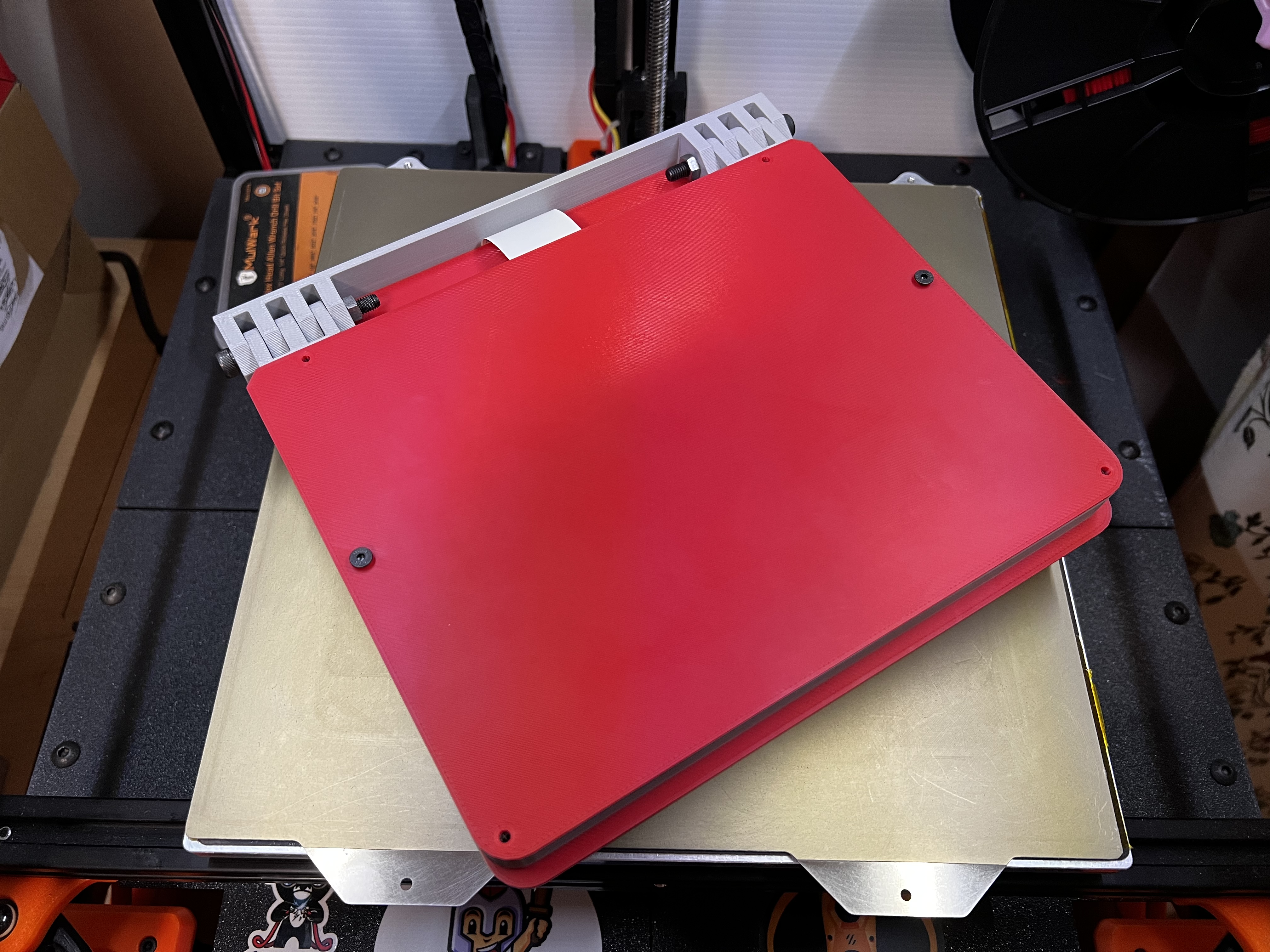

Tested a base print for what I have so far, I like it more already
