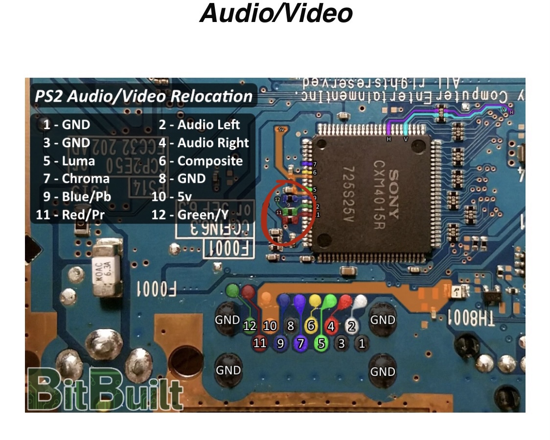

Customledmods . Joined Nov 9, 2017 Messages 874 Likes 836 Location CA Portables 8 Apr 24, 2022 #41 You could solder onto here.

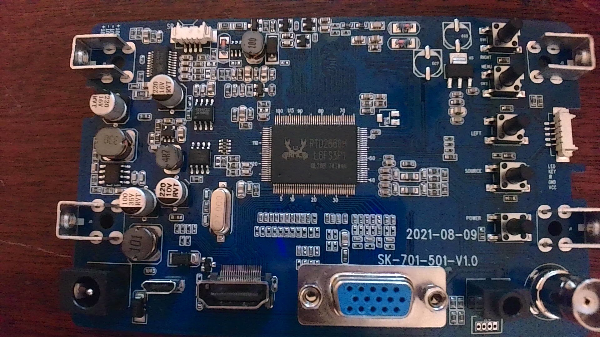

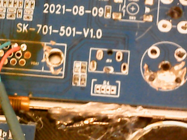

caxtilteca . Joined Aug 17, 2021 Messages 40 Likes 6 Apr 24, 2022 #42 can i just wire the screen in AV mode instead, i get no video with component,this is where the AV input was

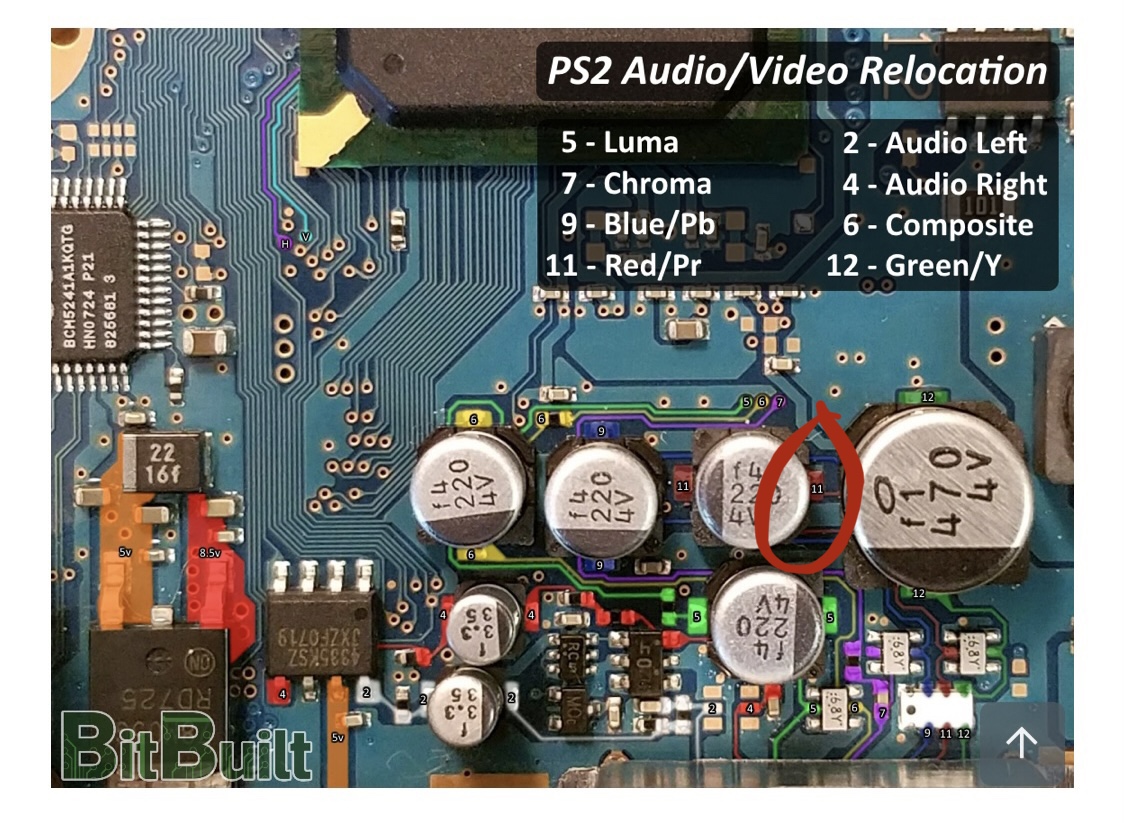

Customledmods . Joined Nov 9, 2017 Messages 874 Likes 836 Location CA Portables 8 Apr 24, 2022 #43 Yea that’s up to you if you just want to do that. You could also solder to here just don’t bridge anything. Last edited: Apr 24, 2022
