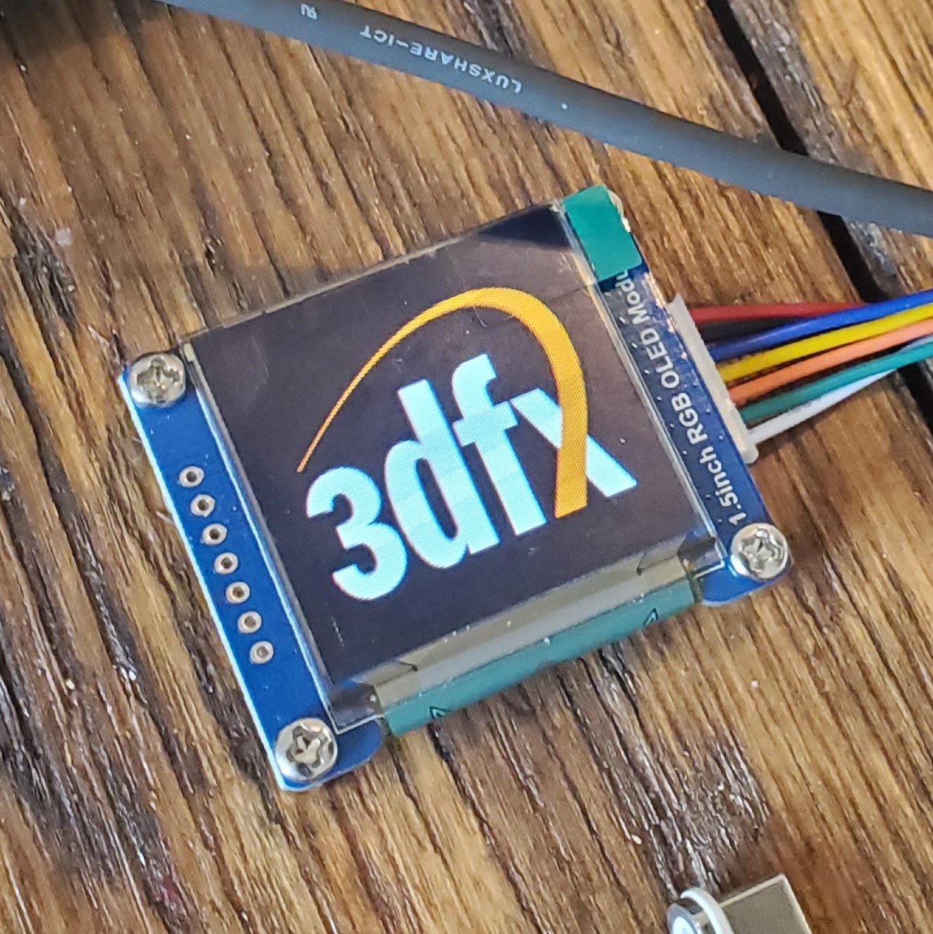

Finally, to capture what it felt like to be a PC game in the late 90's, I felt that a case badge was equally as important as the case itself. However, this is 2020. We can have a bit more flair with our badges. We have access to things like 128x128 1.5" OLED displays:
Stay tuned :)
