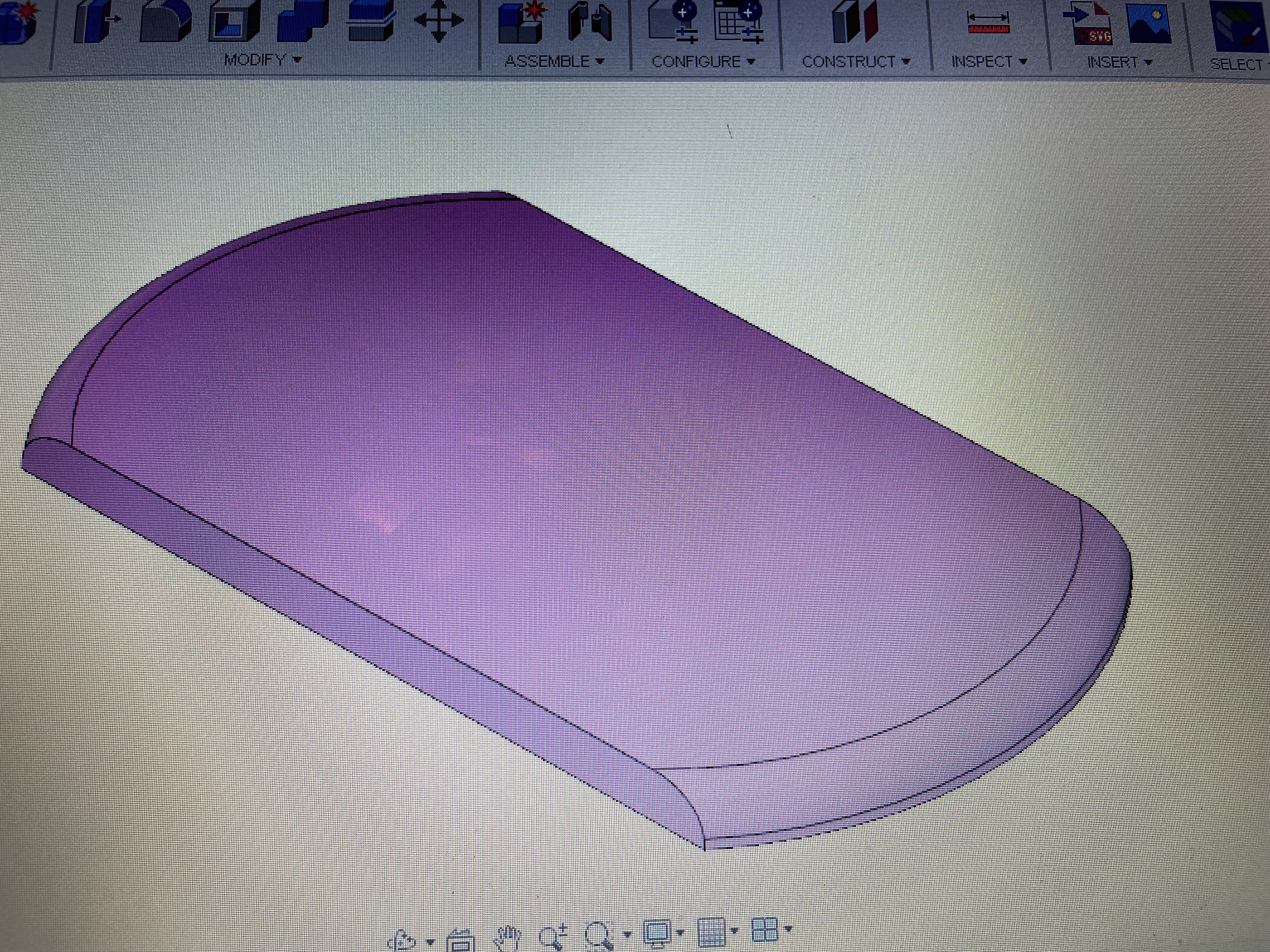

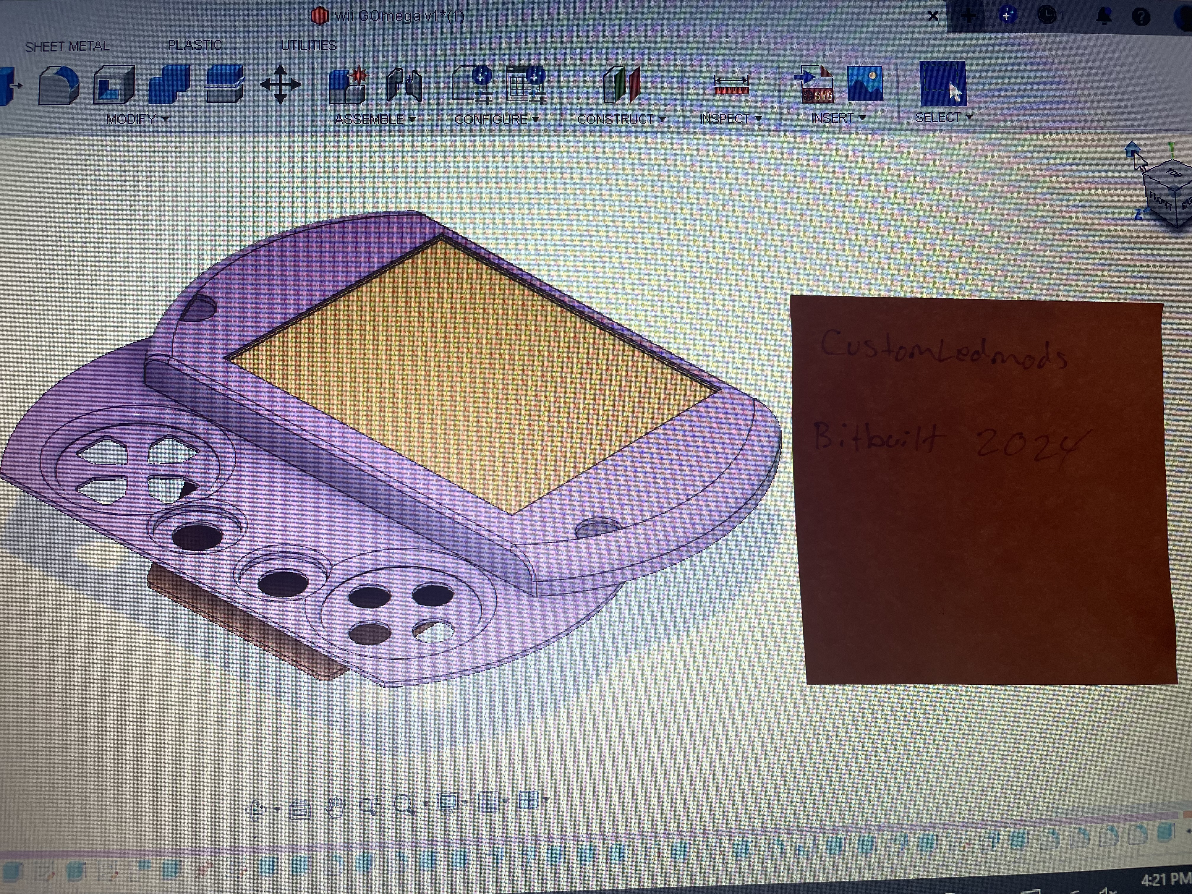

The whole program won’t start up the only option I had was to uninstall and re install it. I’m worried now that all my data will be lost.
If you didn't manually mark the projects as local only, they should cloud synchronise and redownload after an in-place reinstall. Otherwise, you can backup your local cache files at:
C: \Users\{your windows account here}\AppData\Local\Autodesk\Autodesk Fusion 360\USER-ID\
Back up everything there to a safe spot and after a reinstall you *should* be able to just copy them back and after logging in you'll have everything still.
Awesome will try that tonight, I hope that works and I can recover everything it would suck if all files are lost. Thanks for the help man.

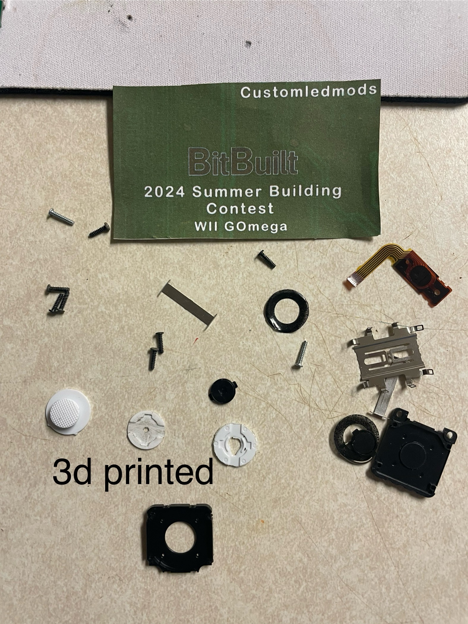

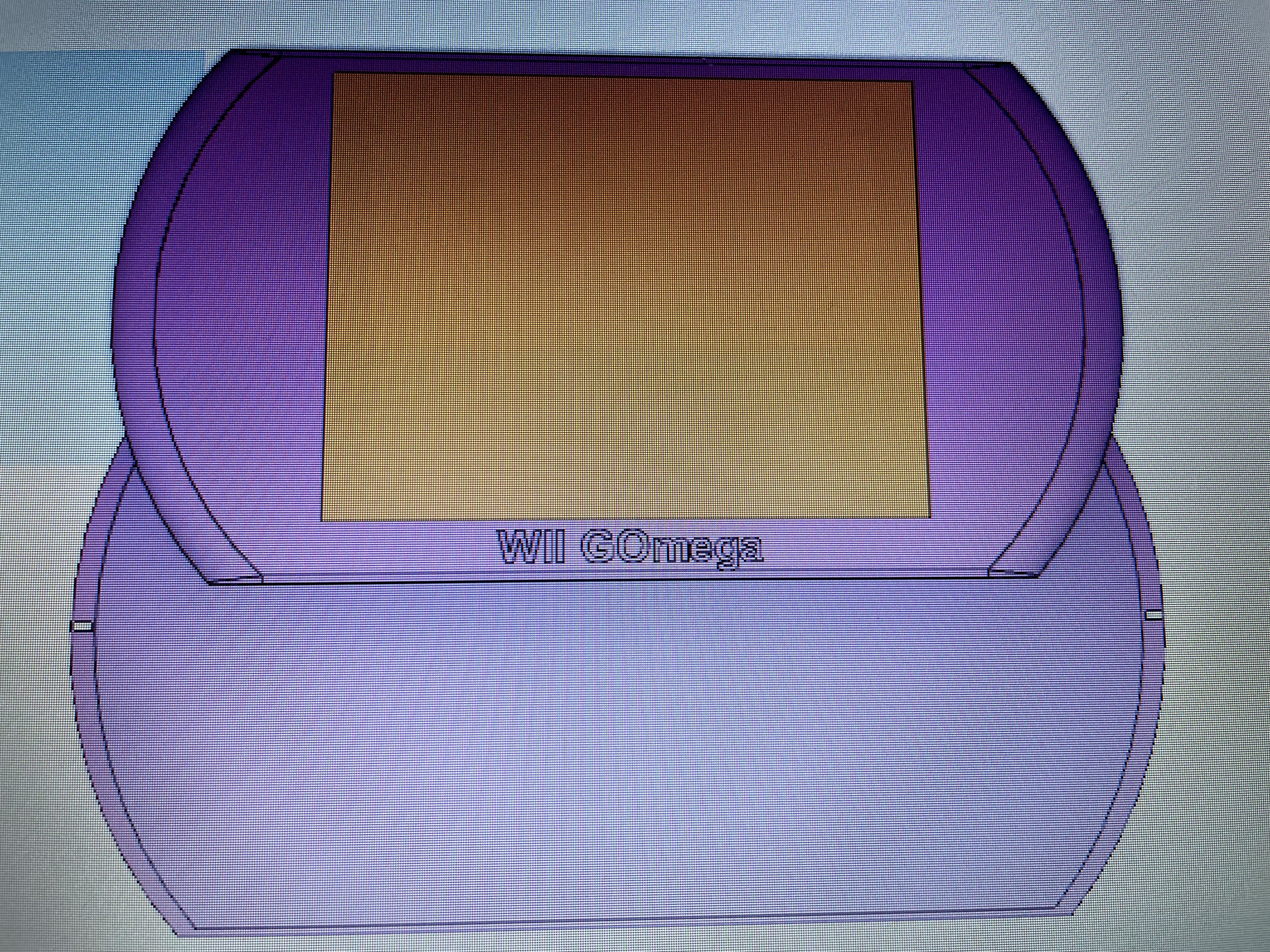

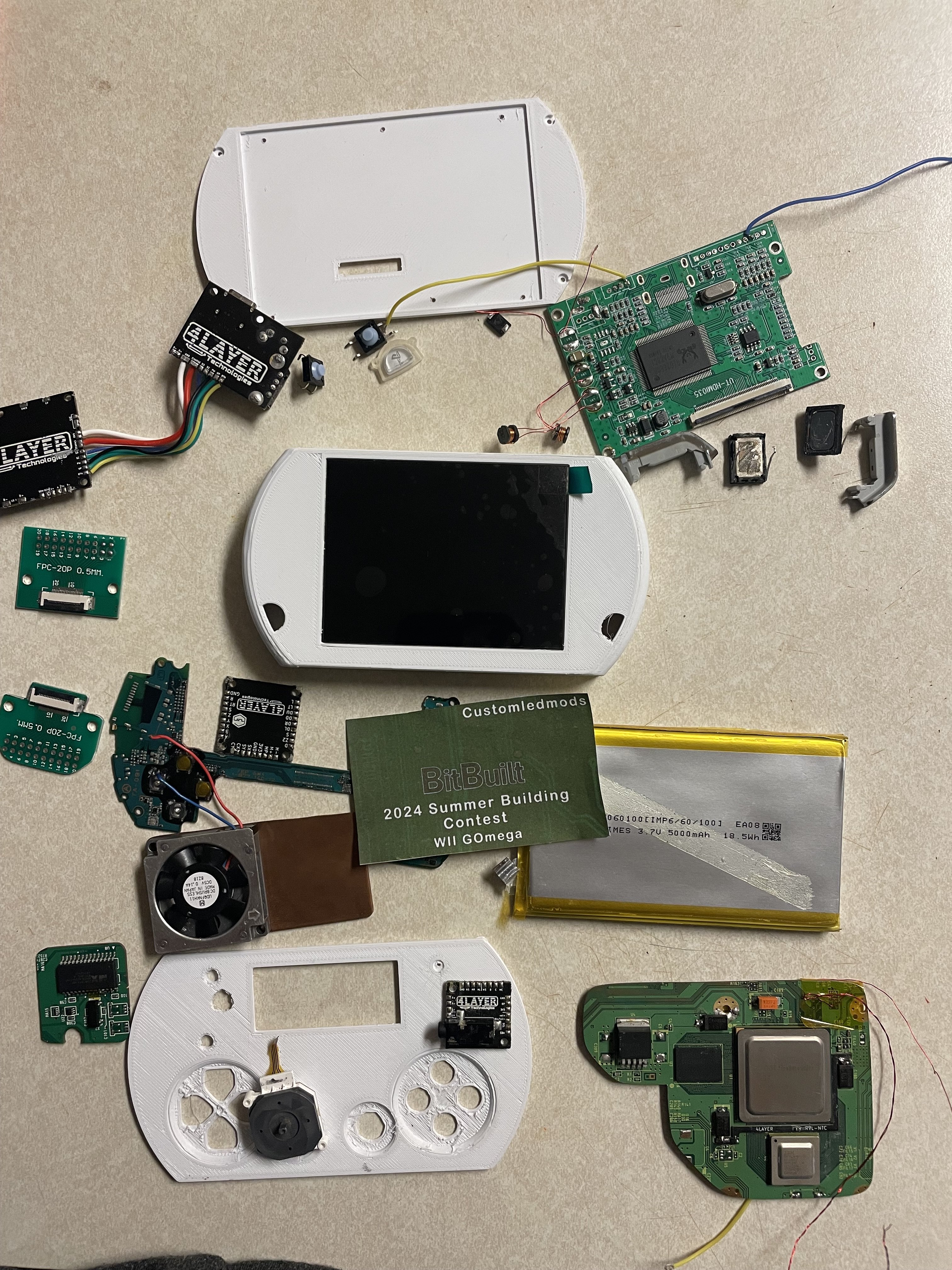

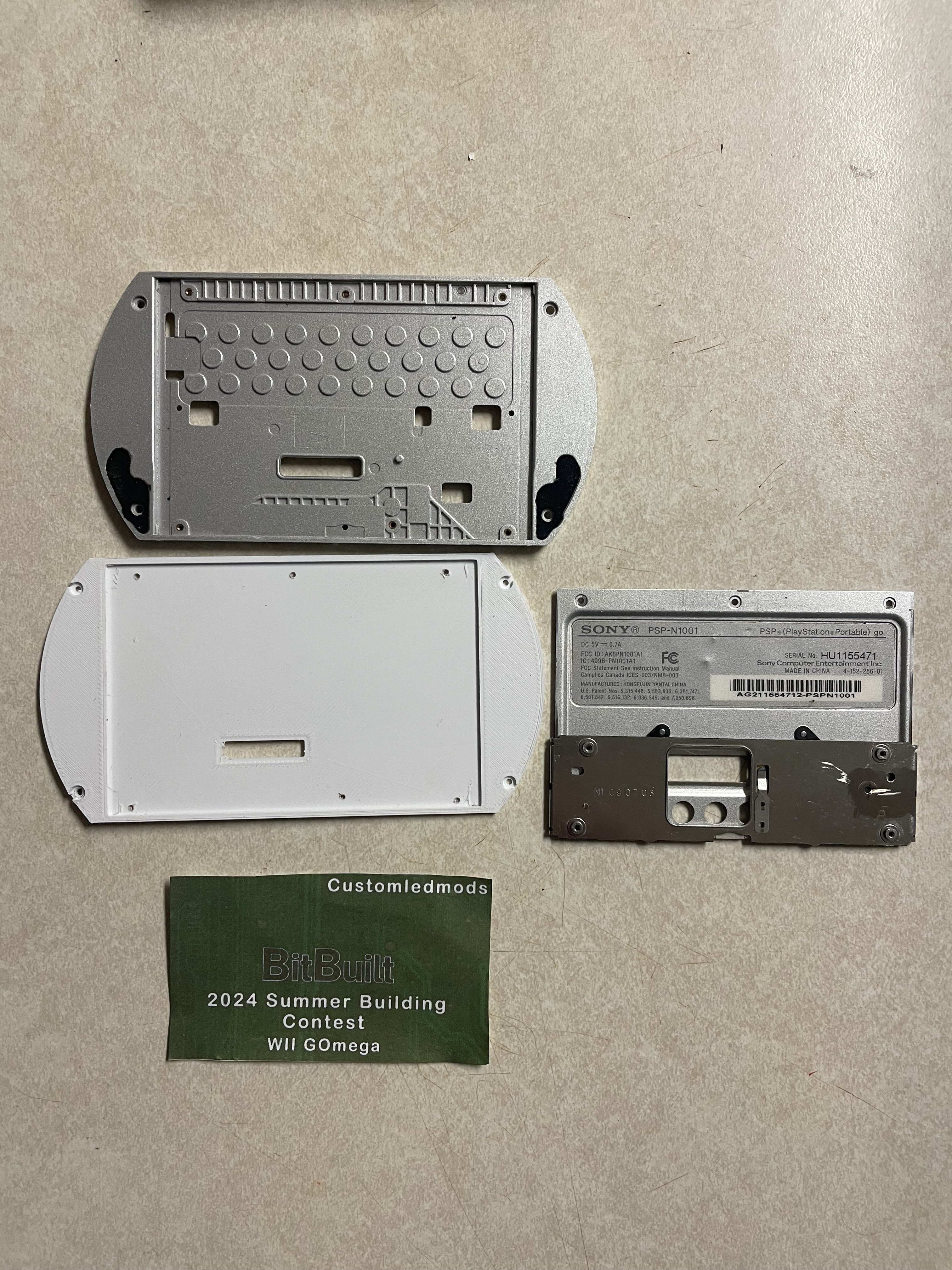

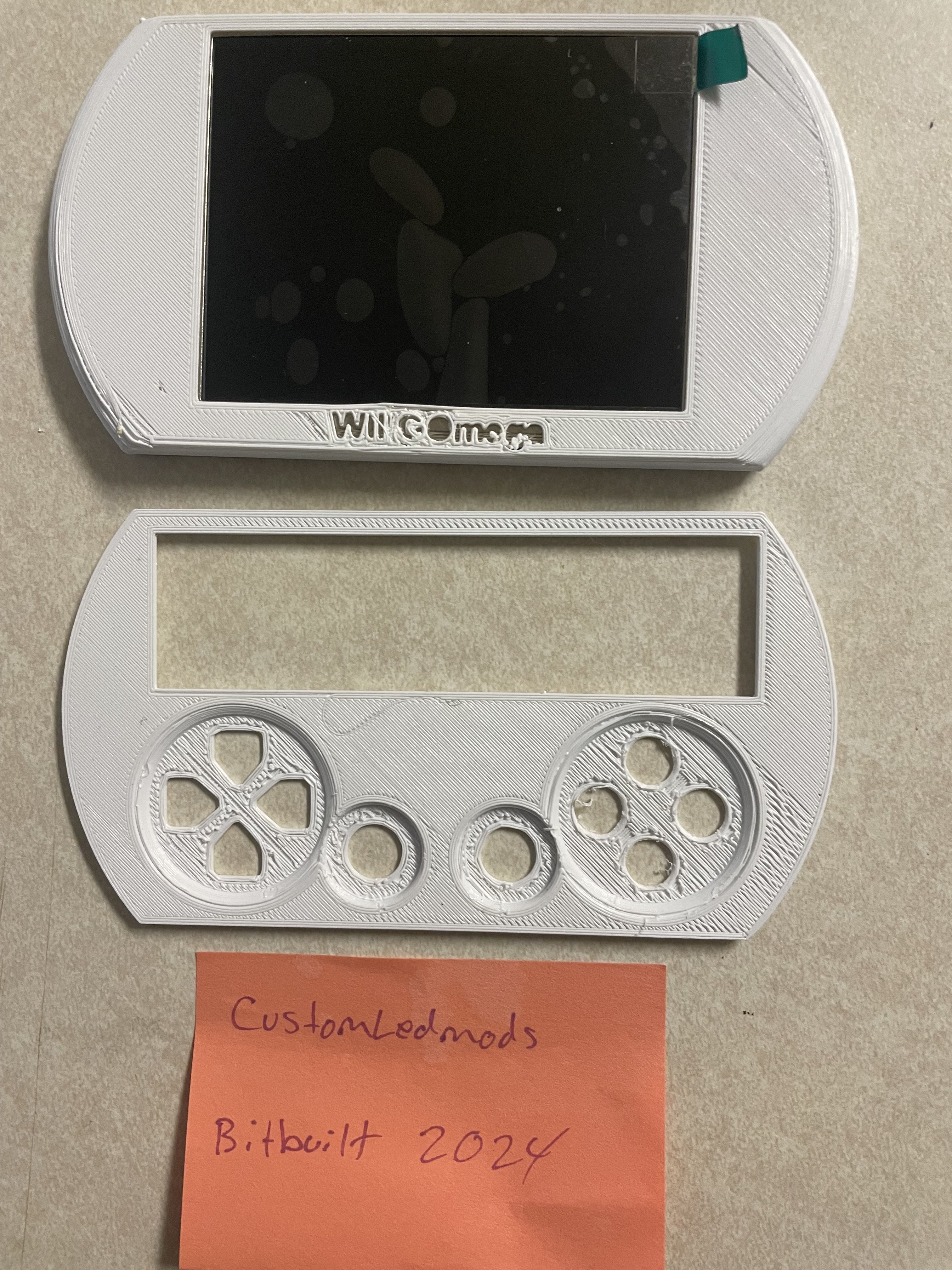

I was trying to print the bottom piece without it I don’t have a way to put it together. I just have those leftover pieces from previous test prints.
Im in the process of re-installing fusion fingers crossed.
@Customledmods, I really hope you got your files back!

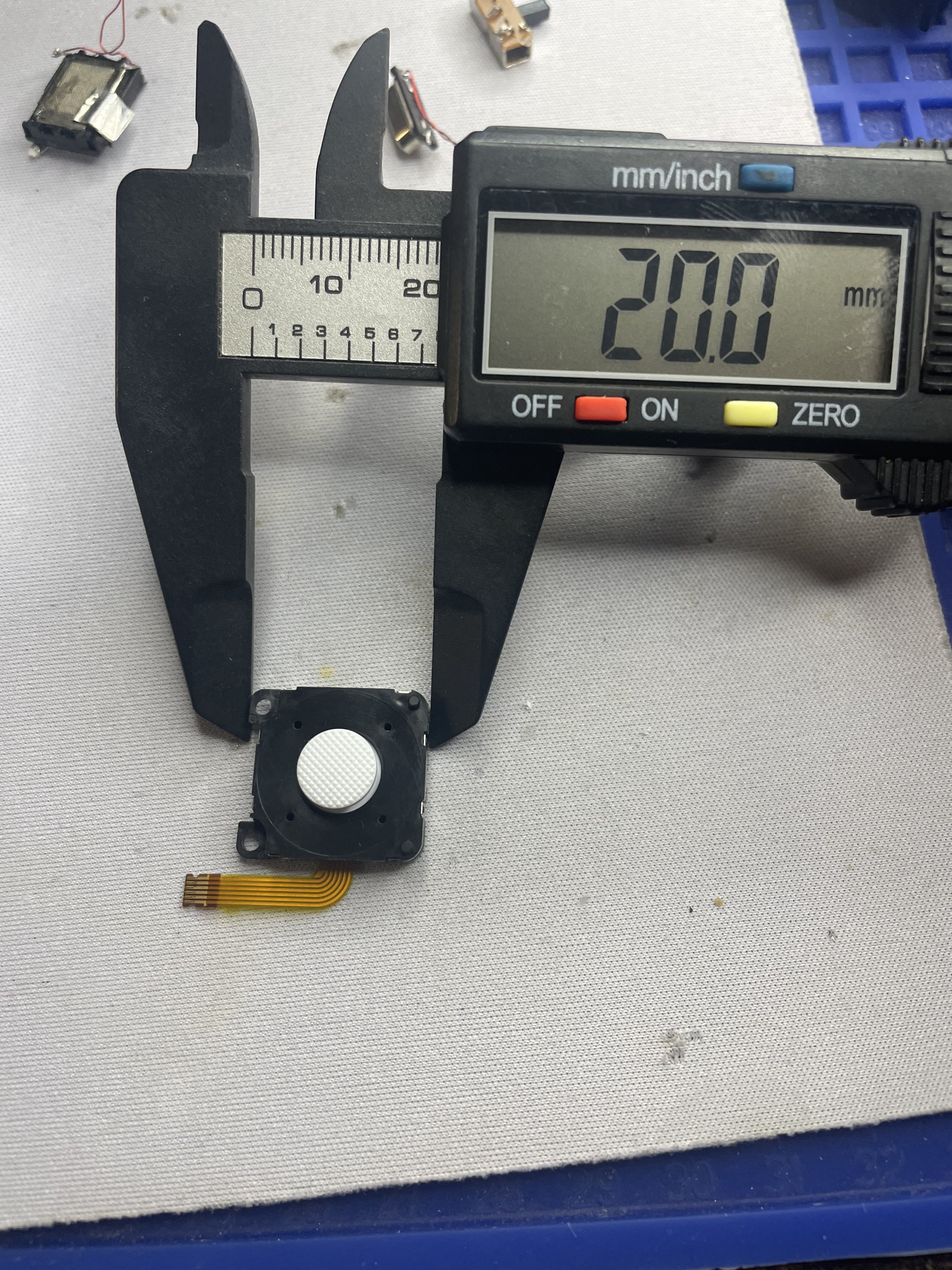

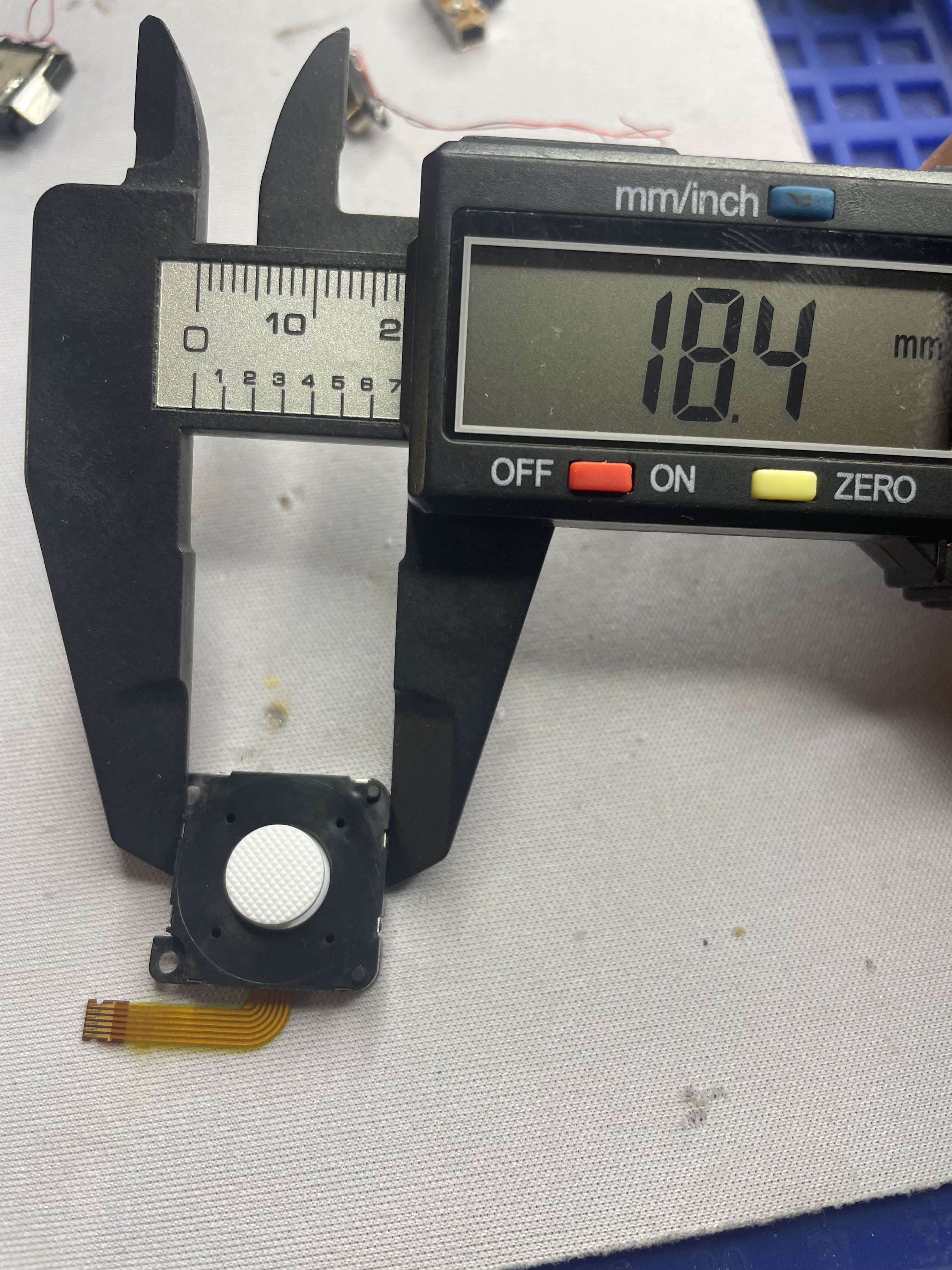

If you get them back would you be interested in sharing your PSP Go analog model? I've been trying to find out what size footprint they have and I can't seem to find anything online. Even just thickness, height of stick, width and depth would be a big help!
Quick update so I’m still dealing with this problem in some way, after installing fusion i was able to recover my files which is amazing.
the problem is when trying to export my files fusion crashes, the only way i was able to export was to go to their website export and it sends me an email then i can download stl kinda annoying.

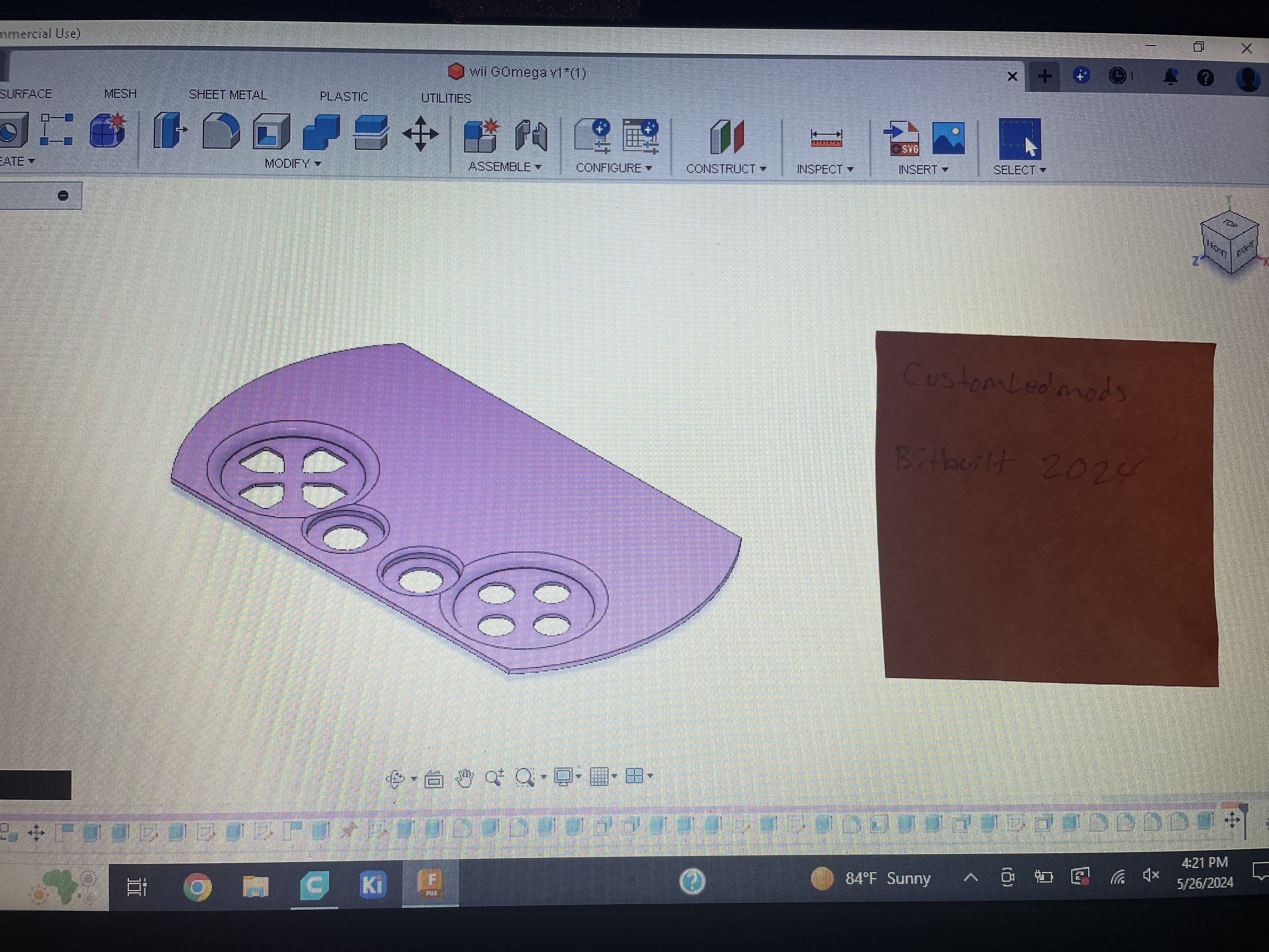

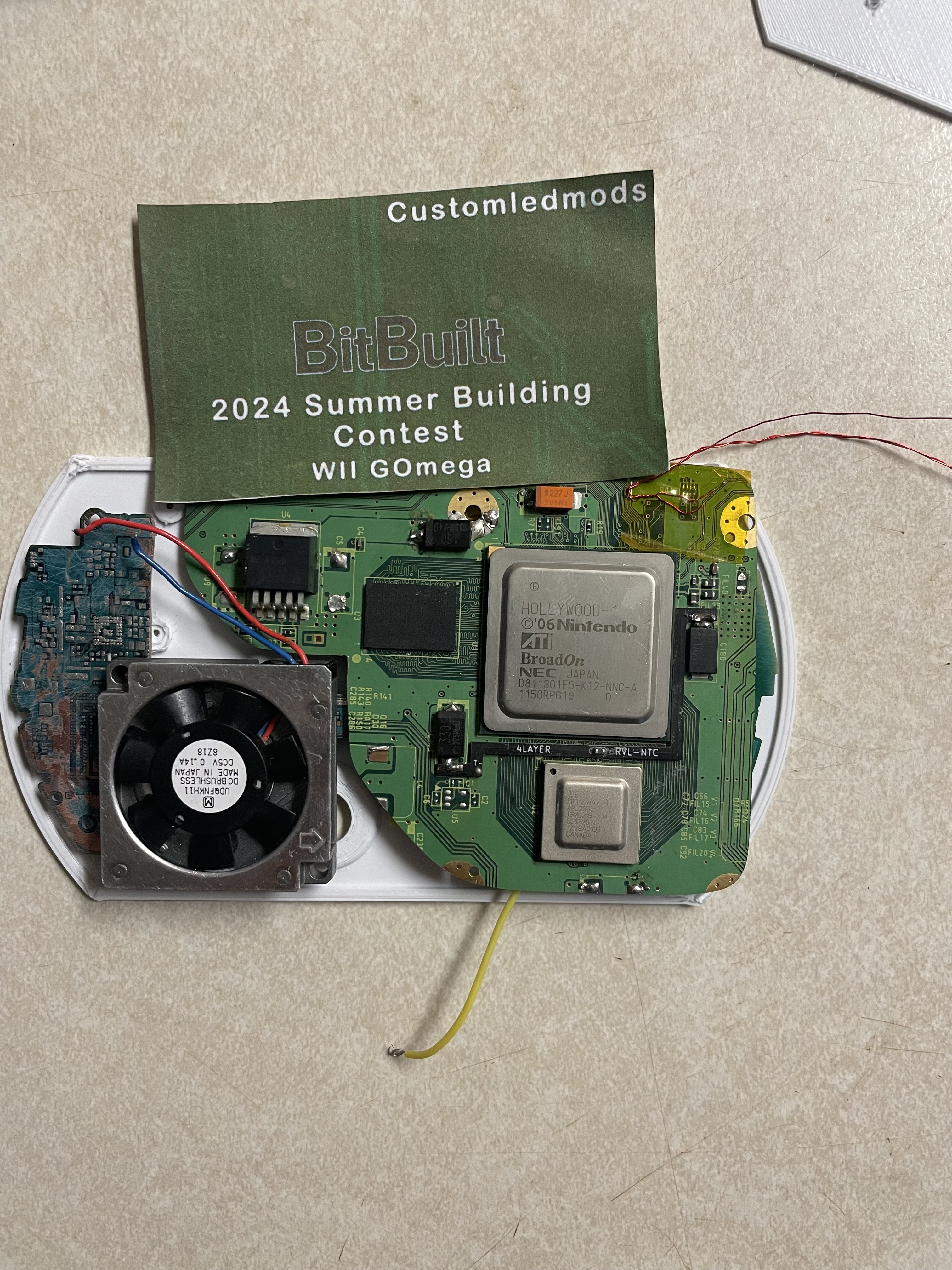

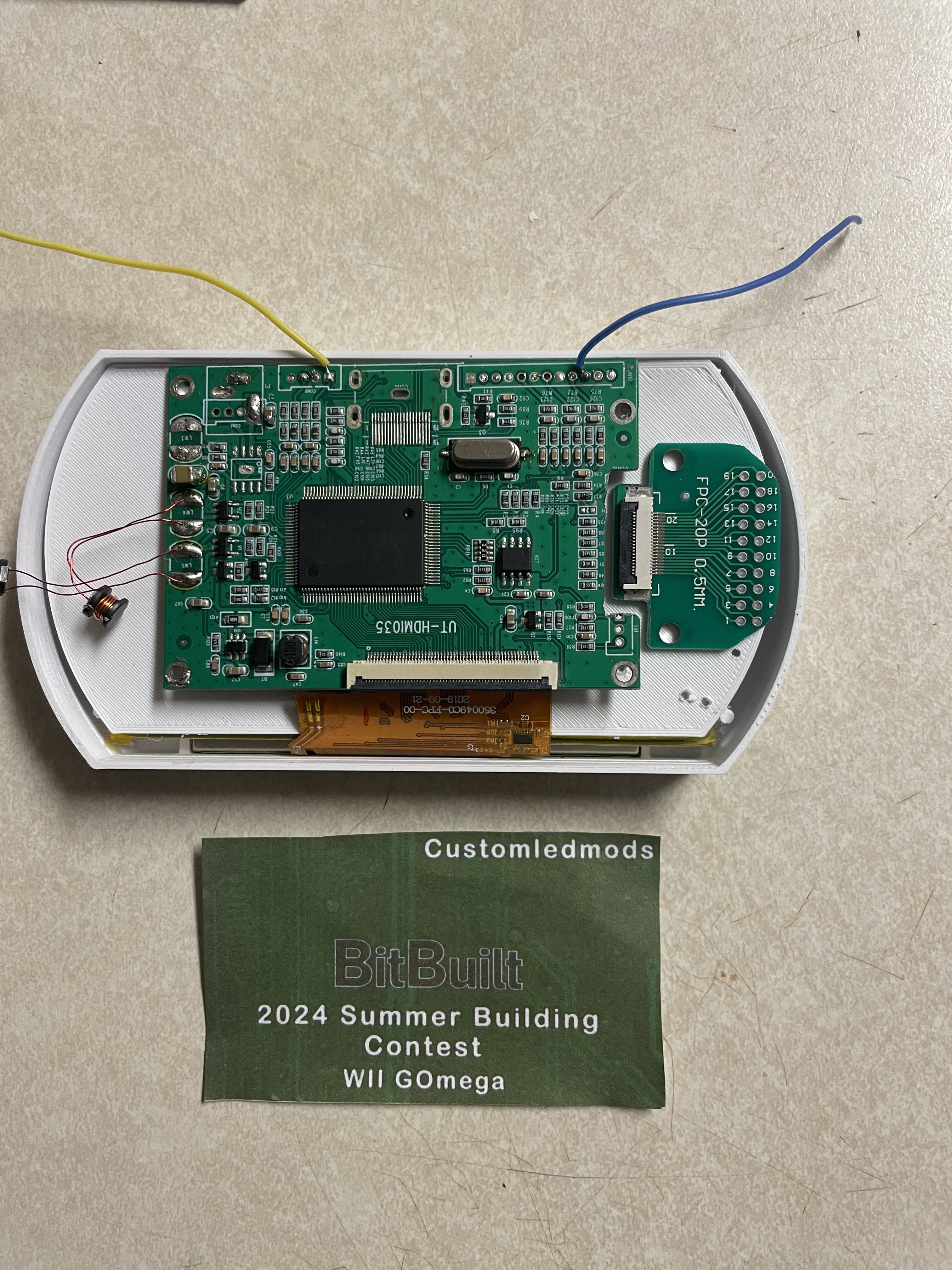

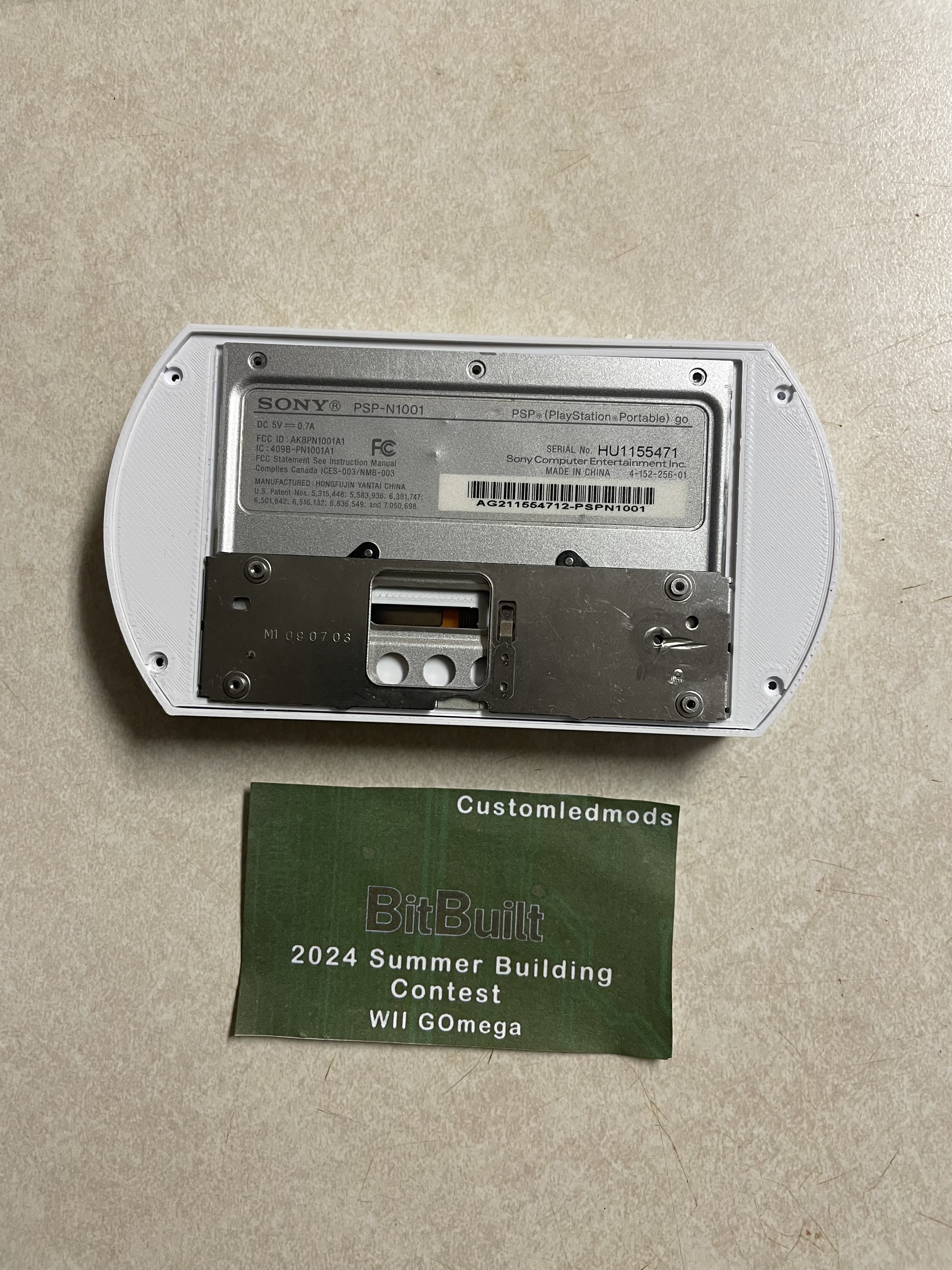

When I get some real work done to it I will post here until it is complete.

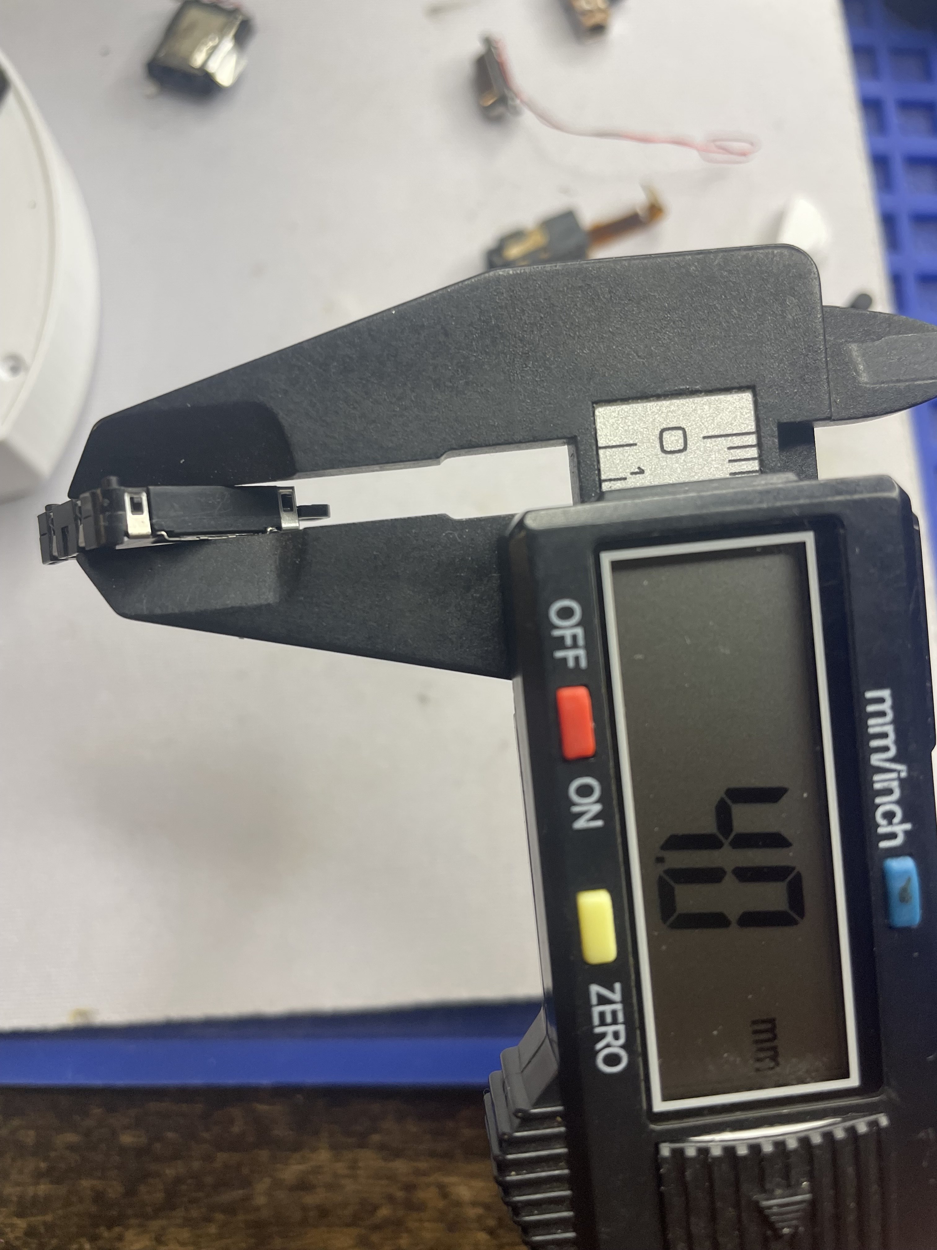

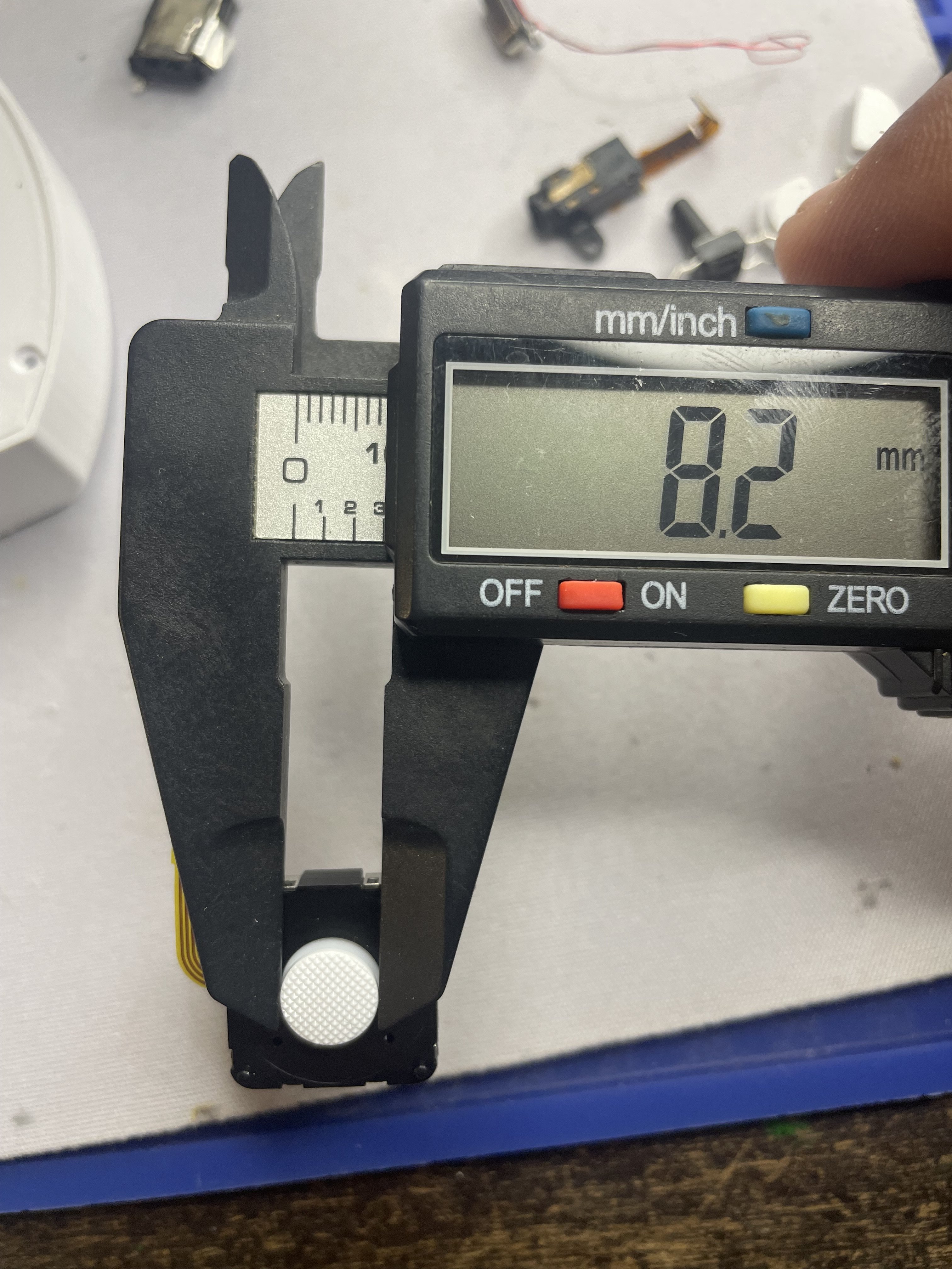

also @TheHow7zer I never did create a model for the analog since I moved onto using 3ds sliders, I can however get the measurements of the analog and upload info here.
That's a pretty interesting instability issue that you've got there! I've been using fusion for a few years now and I've never had it crash on open or fail to export.
I would be really grateful! I'm trying to make a little slider for my phone like a PSP Go or an Xperia Play, but PSP sliders are almost to big. If the Go sliders are smaller i think I would splurge and get some.

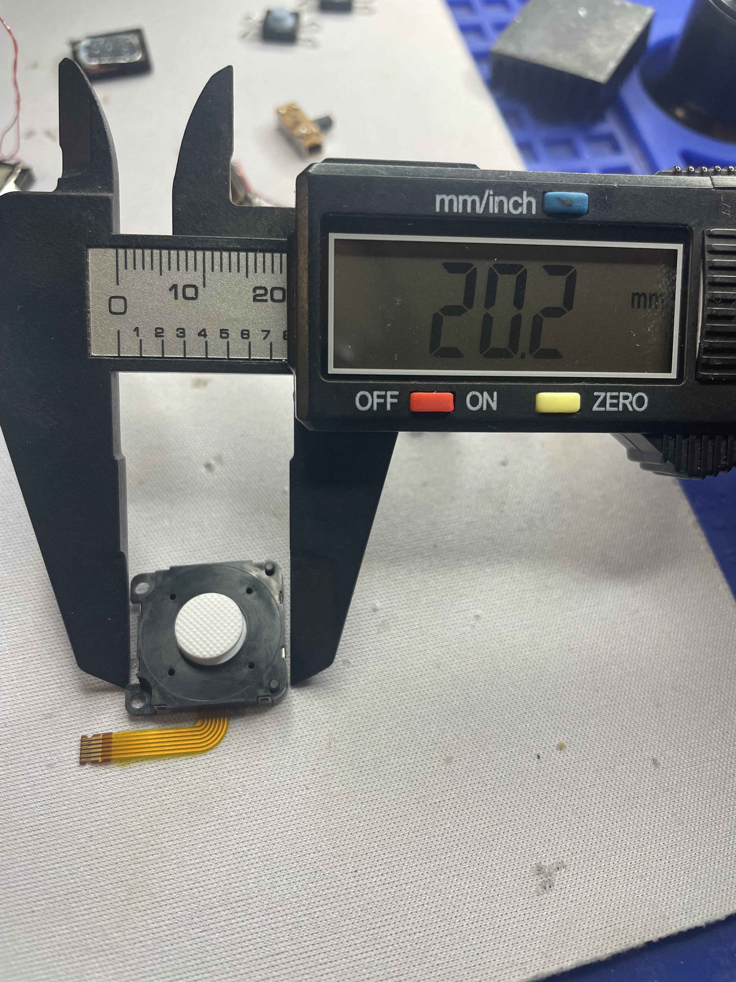

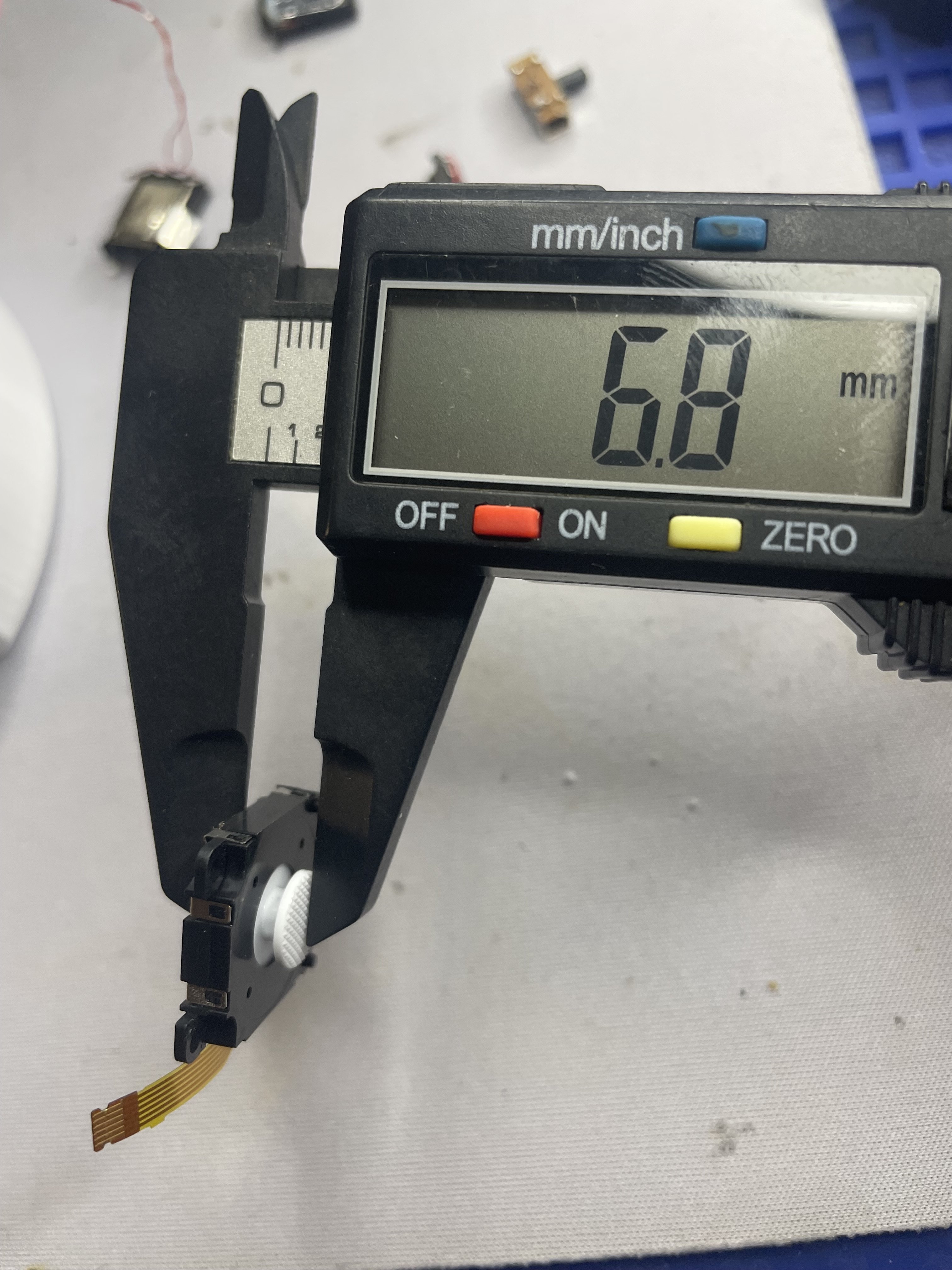

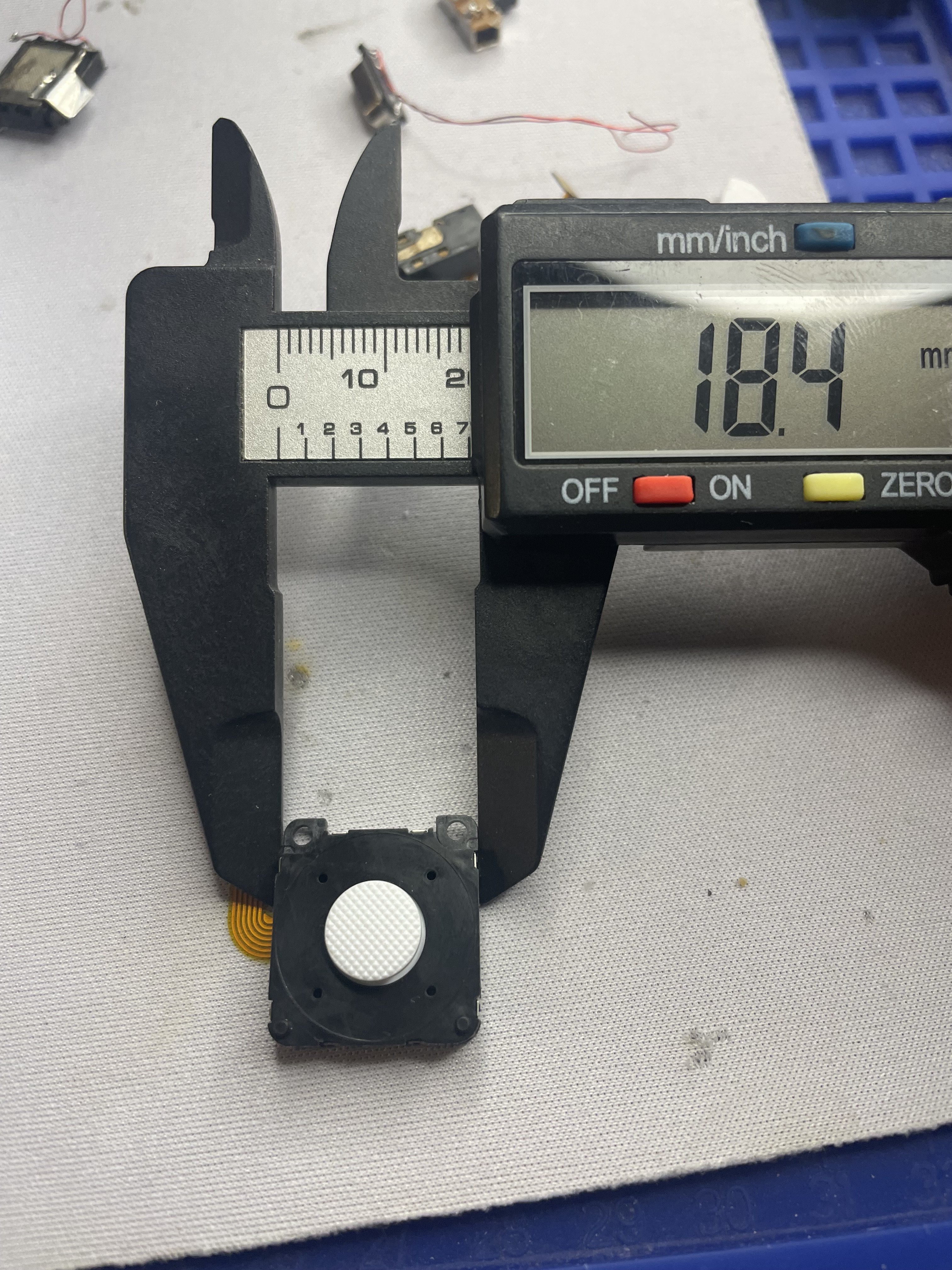

Heres the analog measurements.

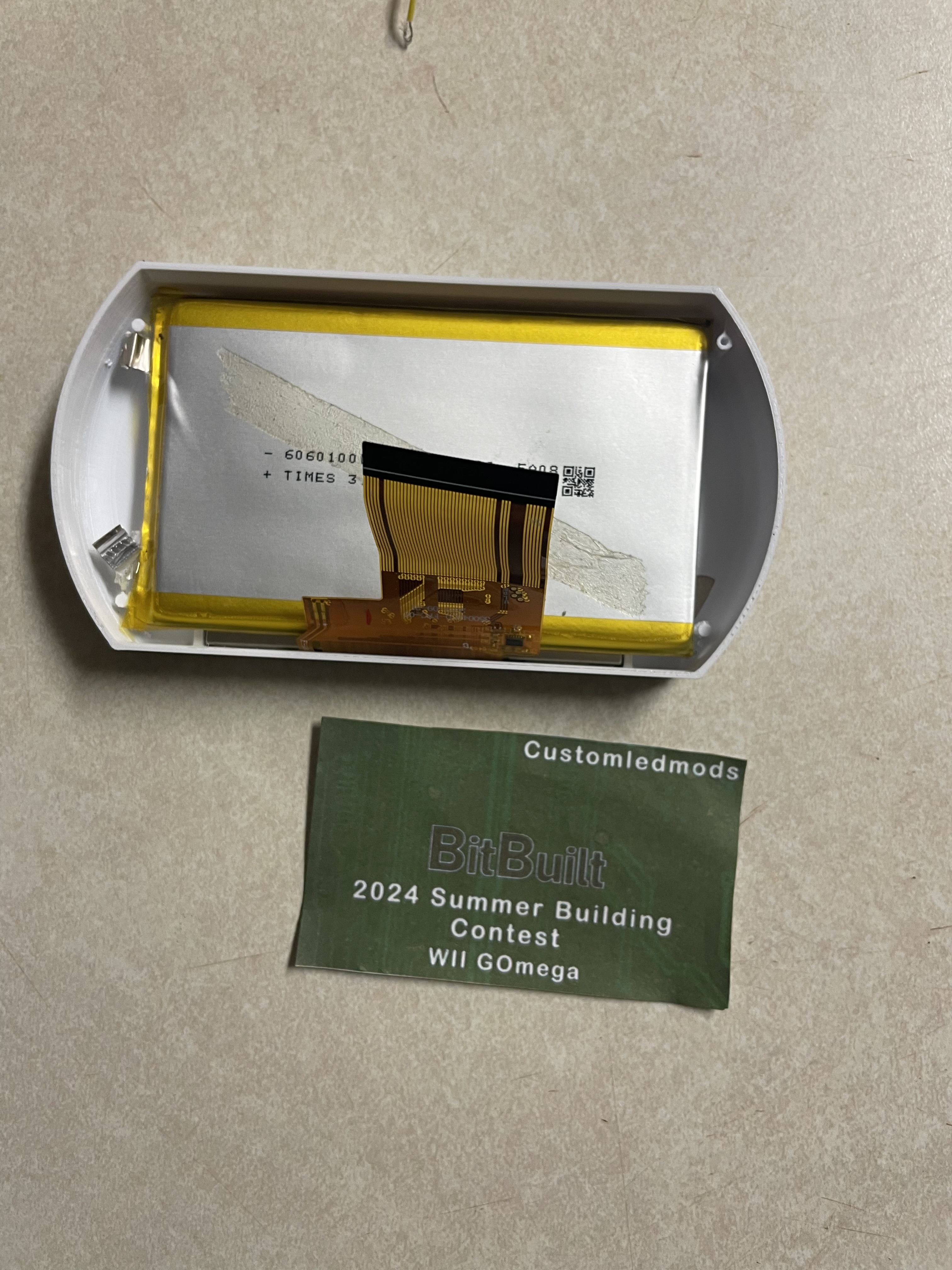

I've made my purchase, including one extra for taking apart, modeling and uploading pictures of, haha.
Good luck with your build!
