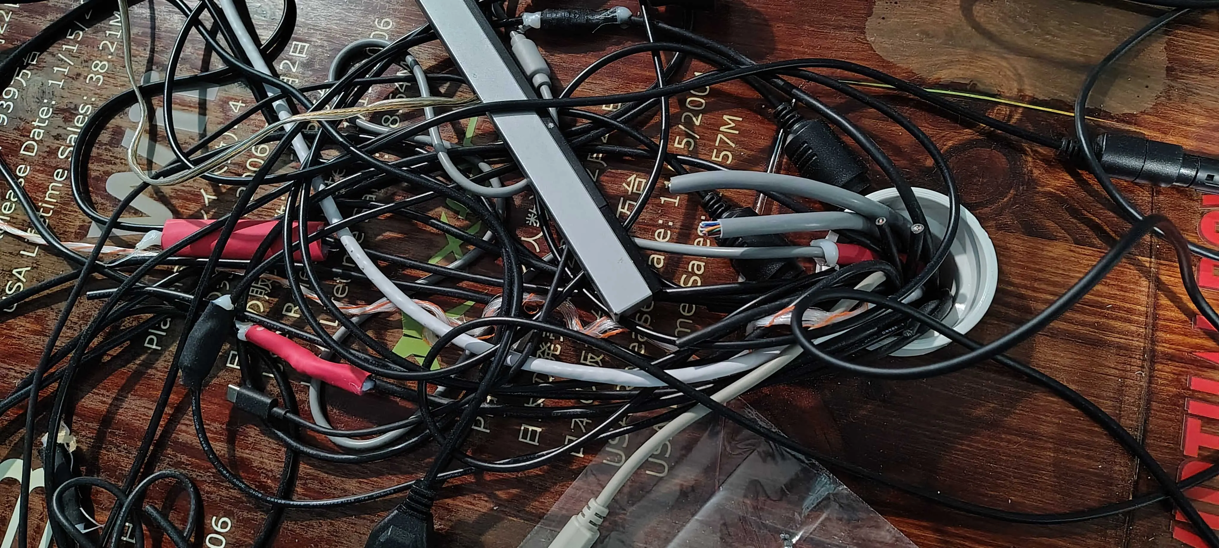

My current setup for controllers is hand making long extension cables, and running them in some conduit under the floor, and having them pop up in a table. This works fine, but:
  • Creating cables is extremely time consuming (splicing wires sucks)
  • It is extremely messy looking (see picture below)
  • My two 1” diameter conduits are now at full capacity, and my newest edition to the collection (PC-FX) cannot have wires run because of this.

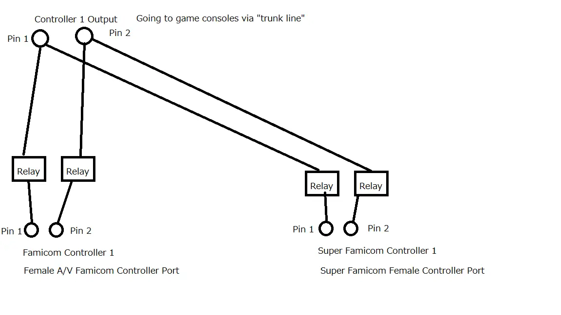

The solution I have come up with is two transceiver PCBs that can toggle relays on and off to connect the desired controller(s) to a “trunk line” of wires, which then connect to the game console. This is in contrast to the current method of running one cable per controller. Below is a simplified example of what I am trying to accomplish (I have excluded the microcontroller that will determine which relays need flipped, the second PCB connected to the game consoles, and the other 5 pins needed for Fami/Super Fami controllers for brevity):
On the game console end, there will be the same PCB that will flip the appropriate relays on to allow a connection from controller <-> PCB <-> PCB <-> console. Again, the microcontroller determining which console is on and how that signal propagates to these PCBs is omitted. For the “trunk line” wiring, I’m going to be using CAT 6 shielded ethernet cable. I’ve ran some tests at the lengths I need (~20 feet) with various controllers and it seems to work.
In this example, the final product would look like this on the controller side (assuming I only had the Fami and Super Fami, the real thing will have more ports):

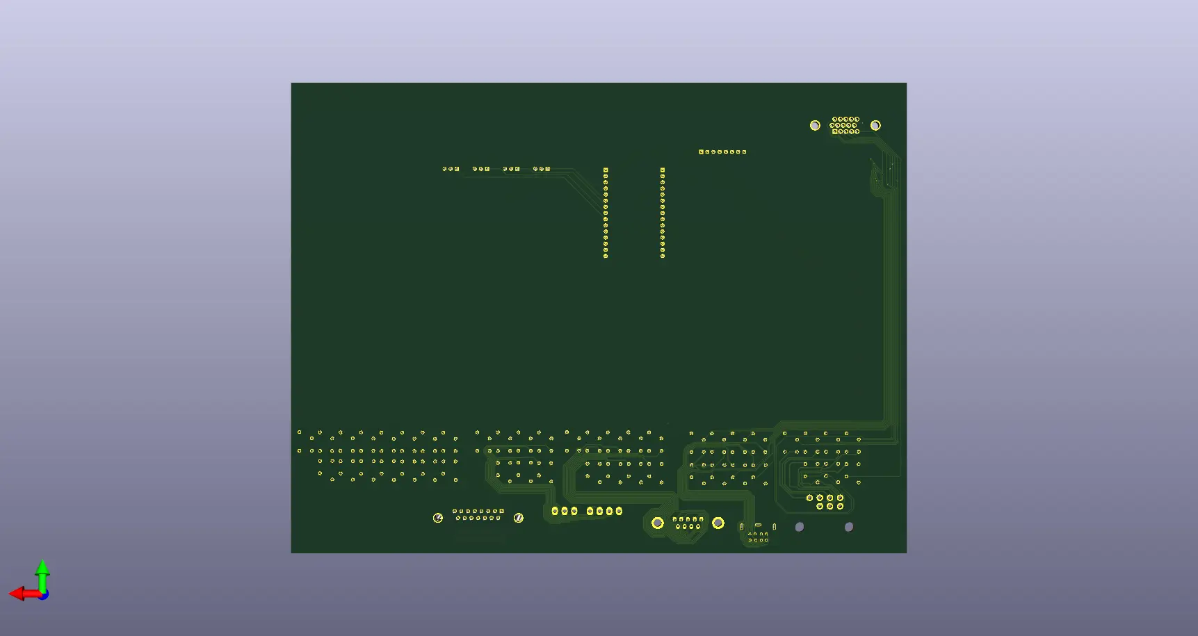

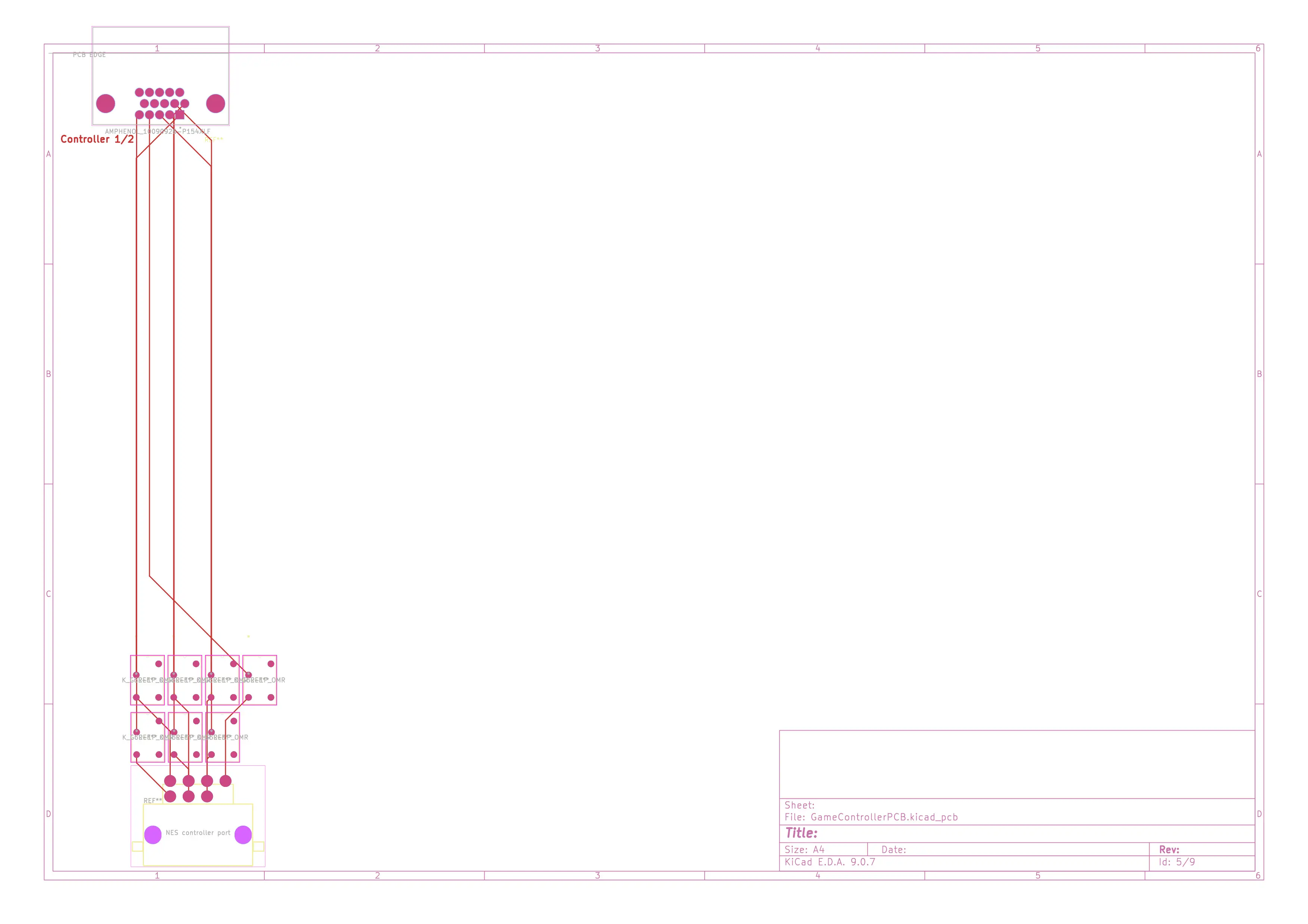

I've got 1 controller port (famicom) added as well as the relays + trunk output port (just going to use a DB-15 connector). I haven't added the controller yet, but I'm using an ESP-32 board for this project (will add the footprint later). The relays I'm using are these: https://www.digikey.com/en/products/detail/omron-electronics-inc-emc-div/G6L-1P-DC3/413440
I'd like some feedback on what could be improved, whats wrong, whats good etc. I'm only ~5 hours into KiCad and PCB design so sorry in advance. Thanks!
Another update post! Routing so many traces is way harder than I imagined, but it gets kind of addicting when you get going. I've got four ports done (Fami, PC-Engine, MegaDrive, Super Fami). Starting on the big one (Neo Geo) now. Looks like I'm going to have to shrink the boards height and increase its width. Also need to line up the ports at the edge of the PCB for proper overhang.
Only 13 more ports to go! Going to stack 2 of these boards on top of each other to get the full 2 or 4 controller count.

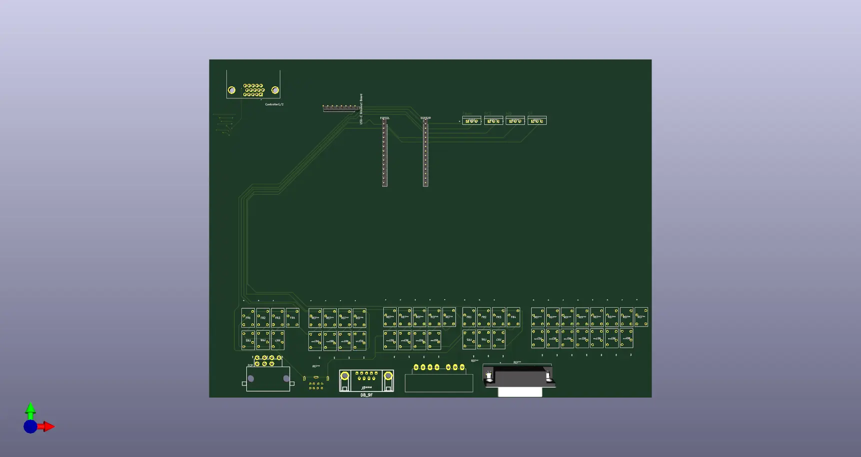

It looks like the PCB is going to be ~670 mm long, which is bigger than what I was hoping for but it looks like it can still be manufactured so I guess I'll keep it like that. Hopefully early next week I can print out my PCB design and verify all the footprints I've made/found all line up! After that its back to trace routing and then designing a case for this puppy!
Got the xbox footprint done and added! I've printed out (part) of the PCB onto some paper to confirm the connectors will line up properly with the end of the board/pins will line up with the through holes. So far the Dreamcast and PS1 ports look good!
I also got the pins into the pc-fx connector and confirmed they mate properly. Looking for suggestions if I should do anything with an epoxy or glue to hold the pins in with more than friction. The connectors were printed in resin.
If all goes well hopefully I can start routing the traces this week!

The xbox and PC-FX pins are not lined up properly, but everything else checks out! Going to adjust those this week and get routing! And this will be my 10th post so I can share pictures freely :p
Routed the Fami and PC-Engine traces tonight! Compared to my last build, the traces are feeling super spaghetti, so tomorrow I'm planning on cleaning them up. I still need to re-print out the pcb for verifying if my fixes to the xbox and PC-FX alignment issue is resolved, but wanted to take a break from lining those up :p.
