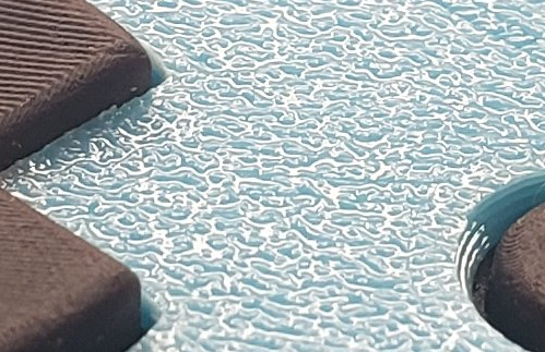

I recently acquired a Form2 which I've been having a blast with. So rather ordering the buttons from Shapeways I was able to print them myself and then mold them.

That texture is from a print??? O_o
