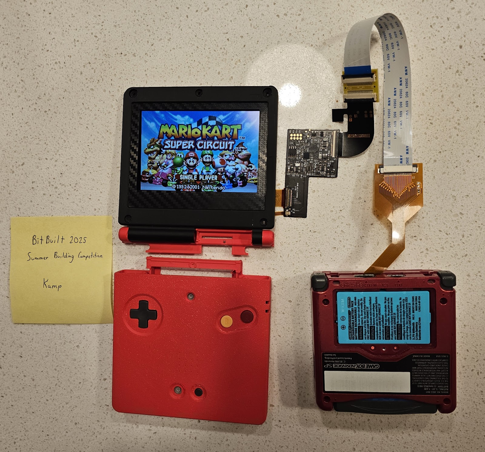

The idea behind this project is to leverage the FunnyPlaying ITA screen kit for the GBA to output GBA video to the DSi XL screen.
This will be different from my previous attempt in that I won’t be reusing the main board from the GBA SP. Instead, I’ll be designing a custom board that will use real GBA CPU and RAM chips (not chips from the GBA SP, just because of convenience).

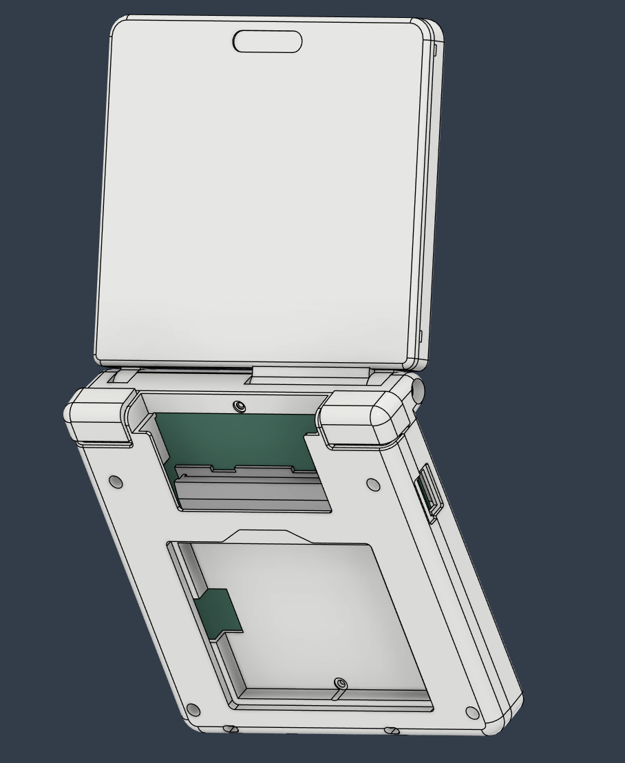

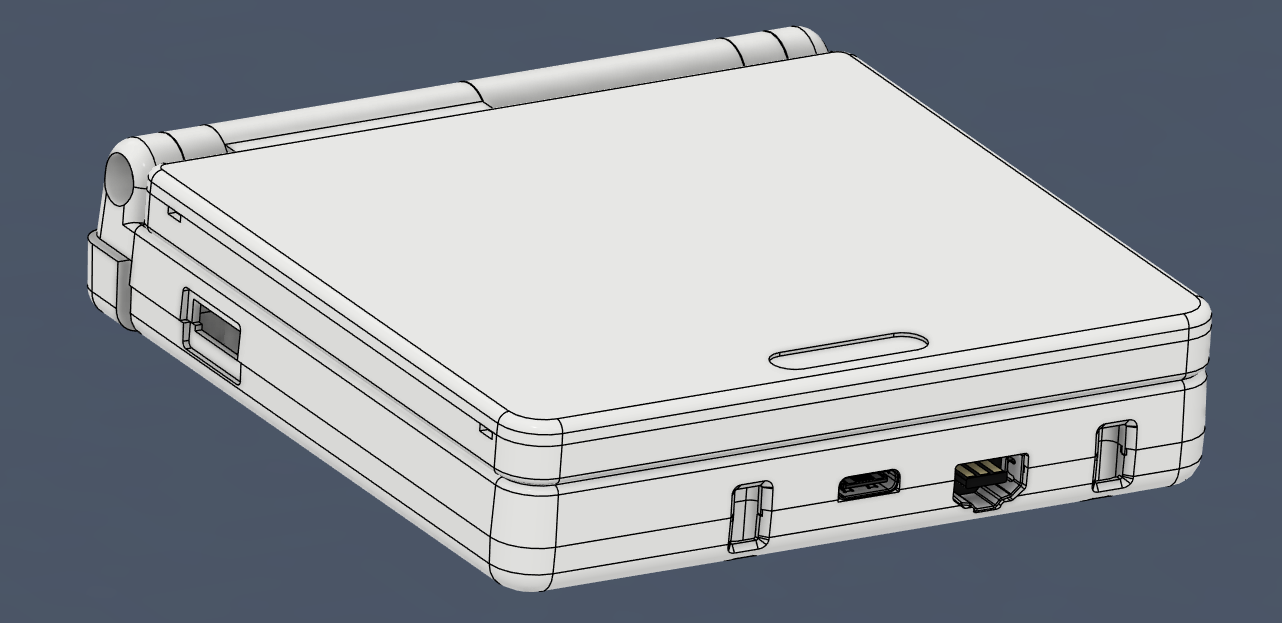

The shell will be 3D printed and modeled to have similar design notes as the GBA SP, much like how the DSi and DSi XL have a similar design language.
Below are some screenshots of the prototype CAD models I have.

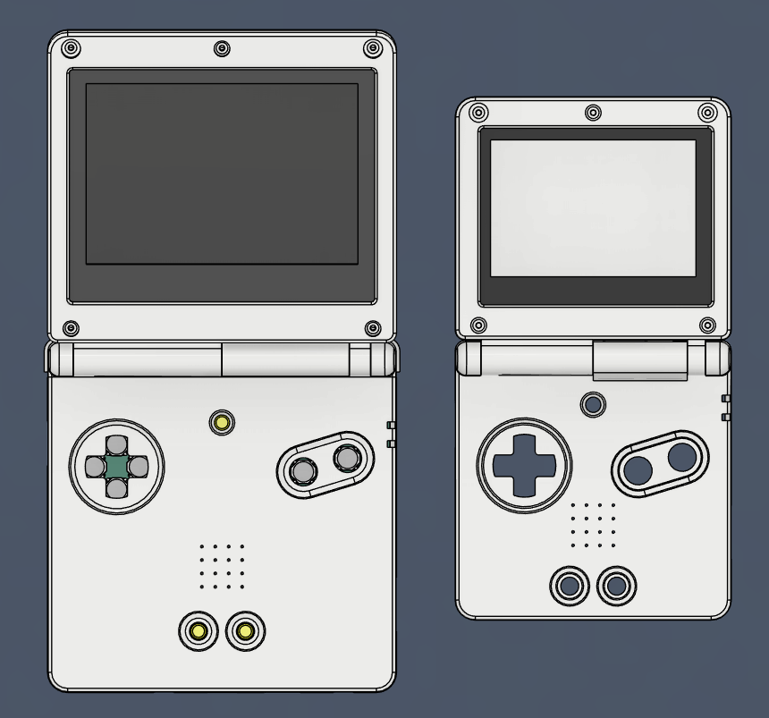

Here’s a size comparison with the GBA SP (which I reverse engineered for this project)

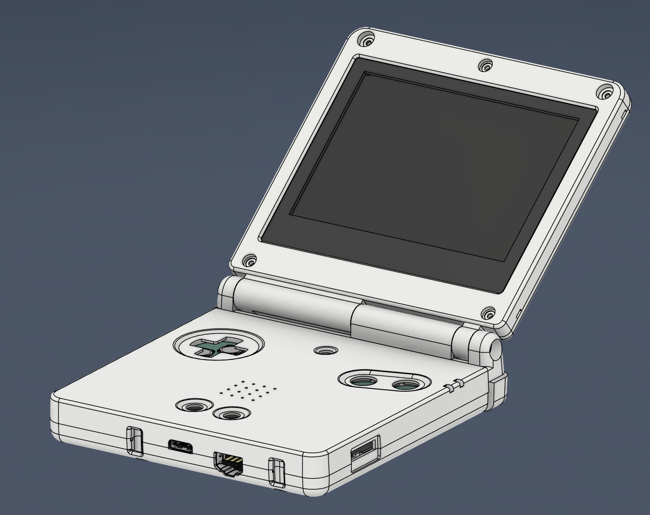

I was also toying around with a version of the shell that takes design cues from the DSi XL, here’s a quick preview of what I started for that, which (hopefully) conveys the vision:
